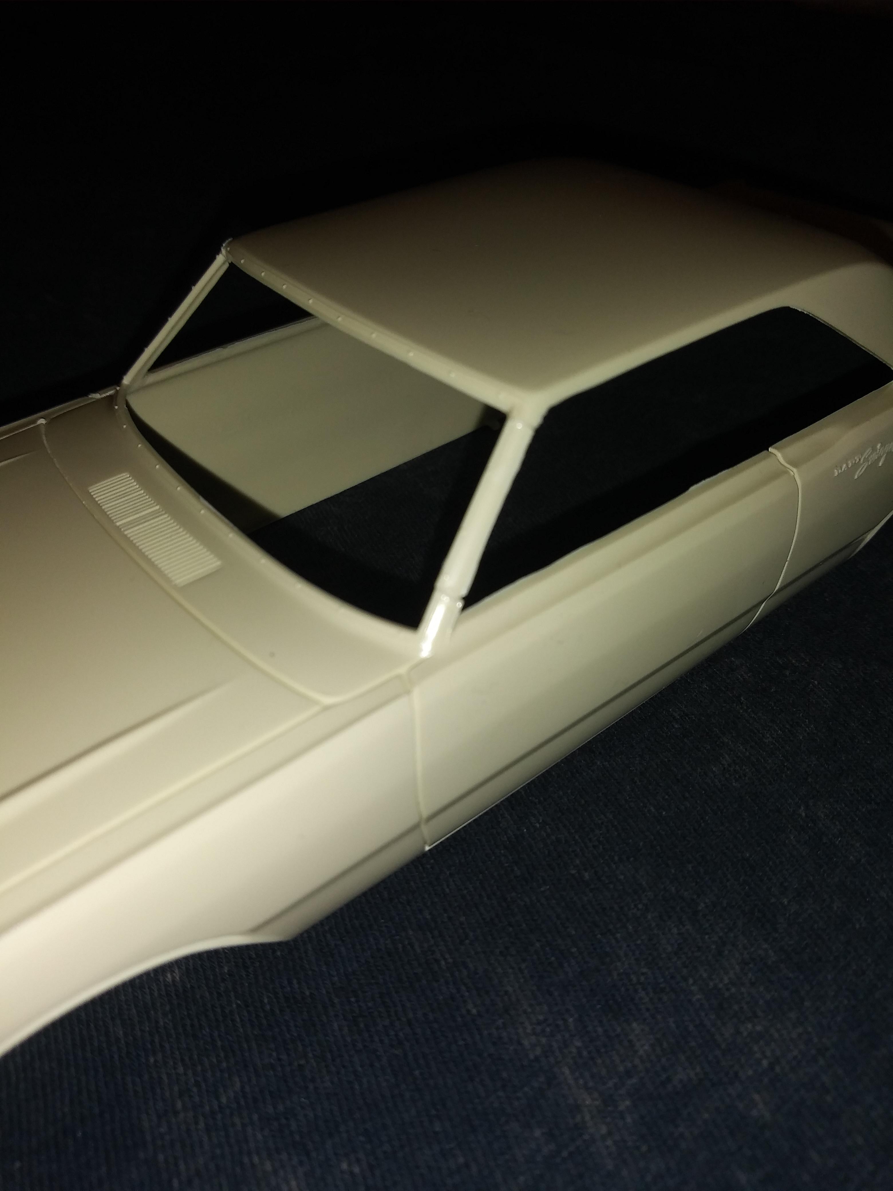

A modeler named mike Posted August 23, 2023 Author Posted August 23, 2023 34 minutes ago, stitchdup said: It probably will but you can also put the channel in the frame itself. it would make the repair stronger. You might still need to do a channel in the glass too depending what you use for the support and how much plastic there is on the frame. A flattened staple from a magazine might be good option for something thin After going back to look at exactly what I've got to work with it appears that a rod would workout better in this situation. I attach 2 photos.. Not happy that I found both pillars had been broken once..? that could be under the what irked me today topic.. Anyway the pillars have a concave channel that runs the length of them making the rod a perfect choice. Time to order some rod or take a look at my electrical wire remnants. 1
Bainford Posted August 24, 2023 Posted August 24, 2023 Yup, a little metal support will work well there. As you suggest, some small mod of the glass may be required to accommodate the support rod. As Les mentioned, there are many materials that can be used, and thinner materials will help with the glass install. I mention 1/32" brass rod only because I have a bunch around and use it for a gazillion things. A thin strip of pop can aluminum may work as well, though sand the thin plastic coating from the can before cutting and gluing. Many other things can be used, too.
