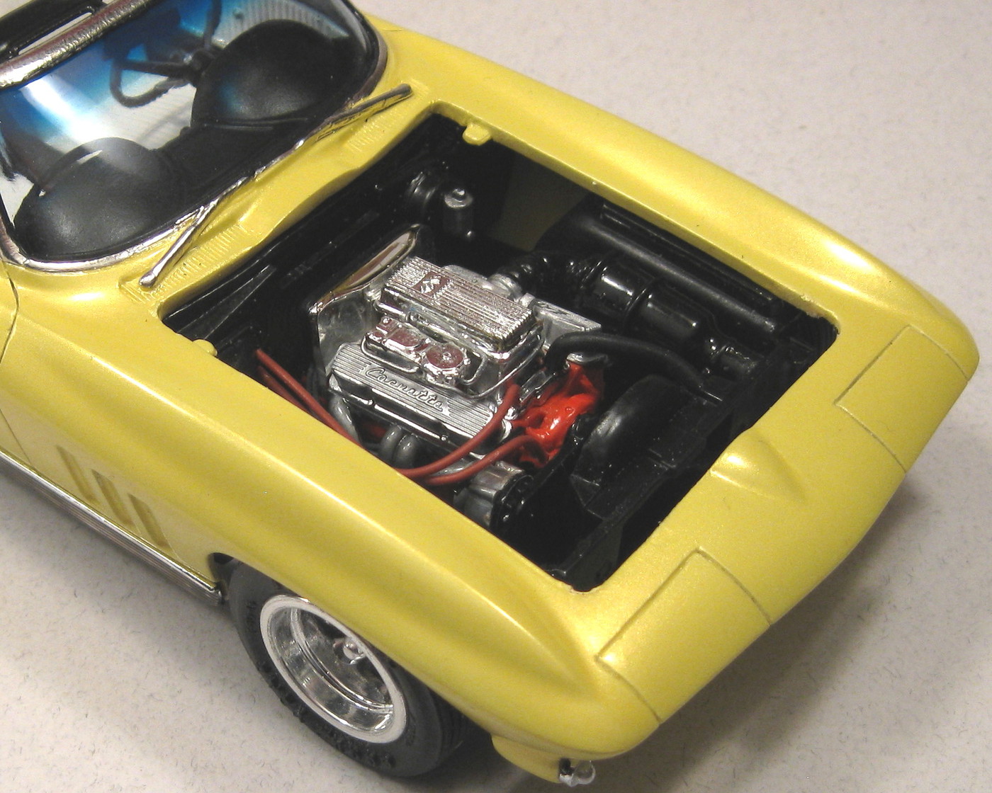

Force Posted August 23, 2023 Posted August 23, 2023 1 hour ago, Fat Brian said: Interesting, I was probably going to use the engine from the Revell 62. The fuel injection from the 1962 is wrong for 1963, they are different. 1962 1963 2
