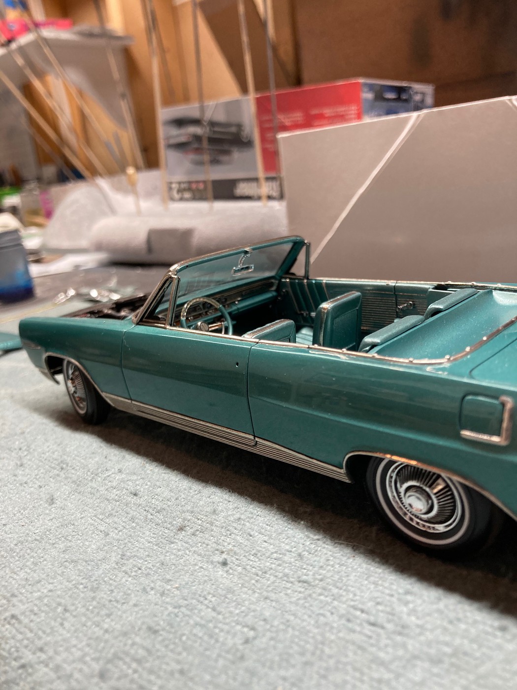

Monty Posted August 26, 2023 Posted August 26, 2023 I've got a convertible kit body that will be using the front "glass" from a hardtop body. The windshield wraps around to provide glass for the vent windows, but I'd like to cut that off and make them separately (from acetate?) to make it more like a 1:1 car. In my few interactions with it, clear styrene always seemed more brittle and less capable of being easily cut or shaped, so any suggestions regarding this would be appreciated.
