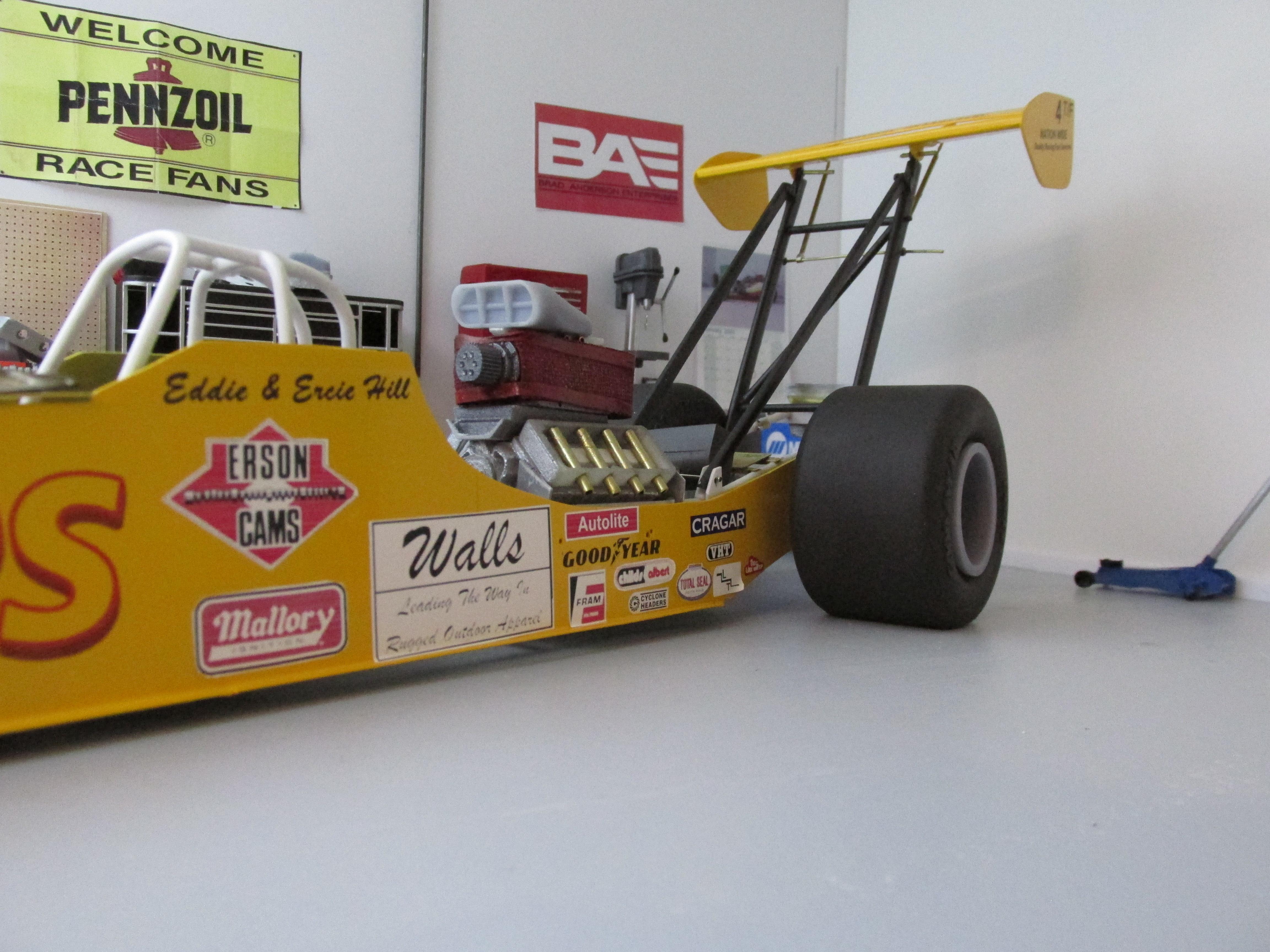

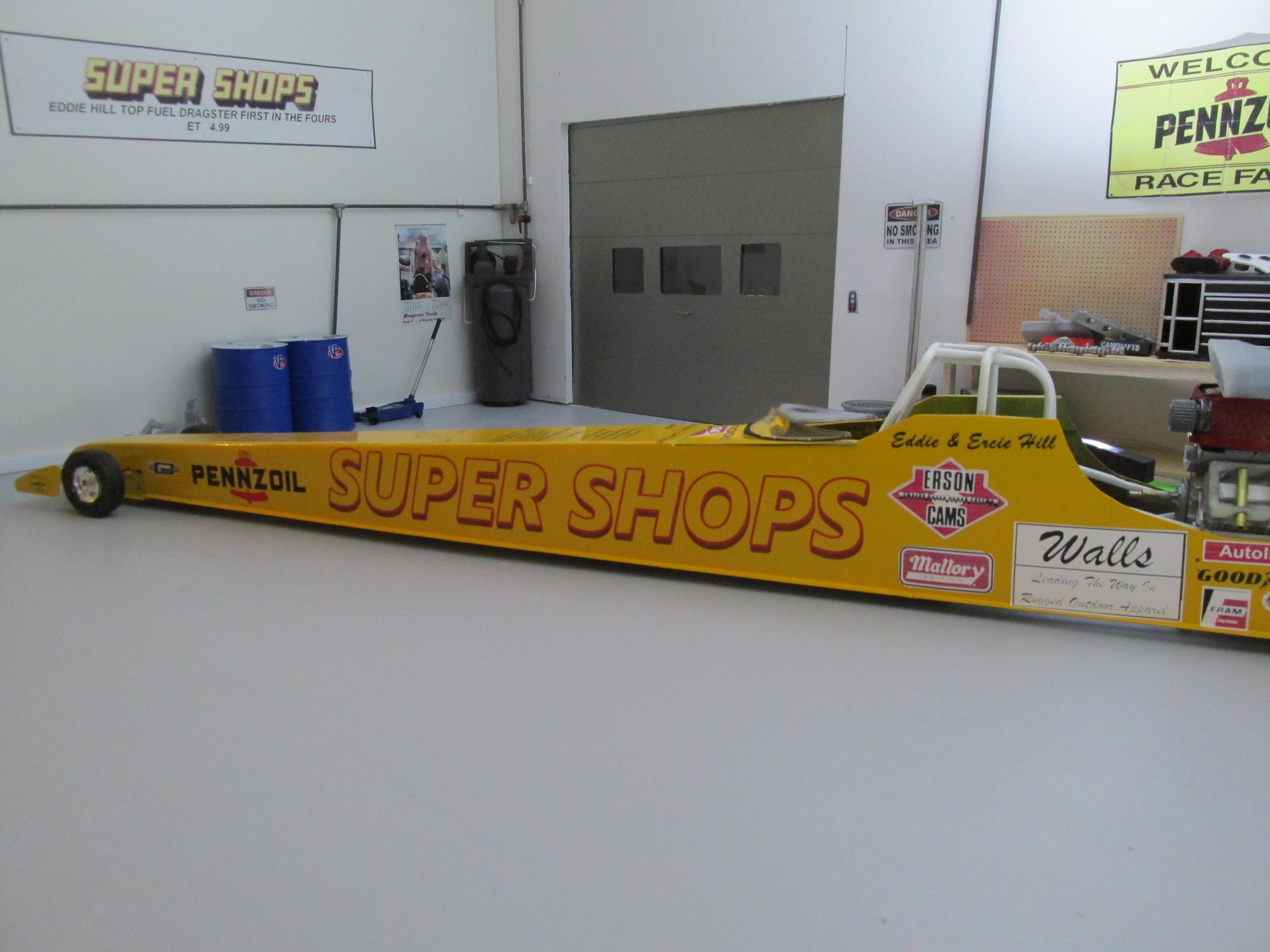

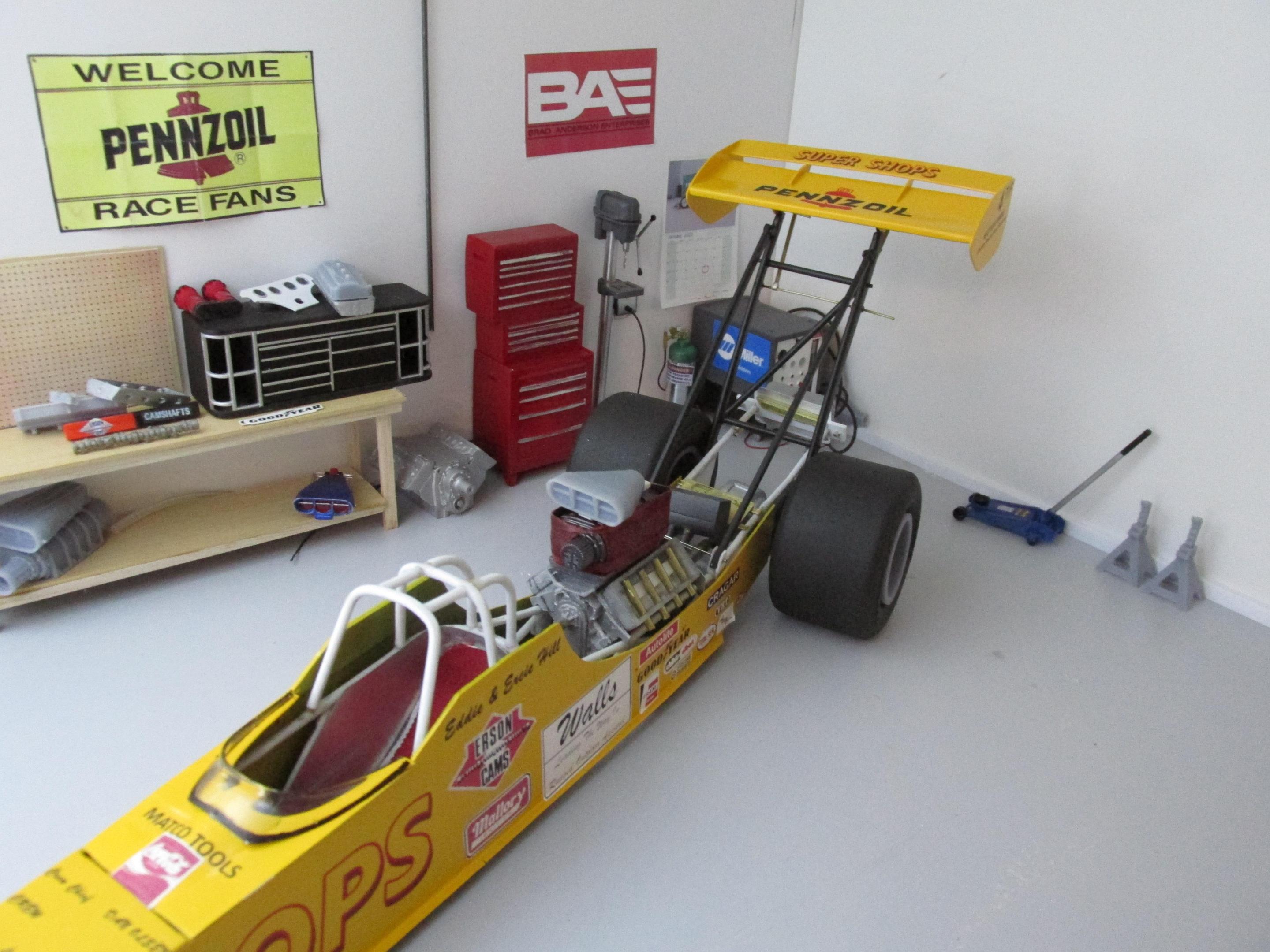

Ian McLaren Posted December 19, 2023 Author Posted December 19, 2023 As I said earlier I'm going to basicly finish the majority of the body, here it is with most of the decals printed and installed. Except for a couple of minor sponsor decals everything else was producde in GIMP and printed by me at home.
