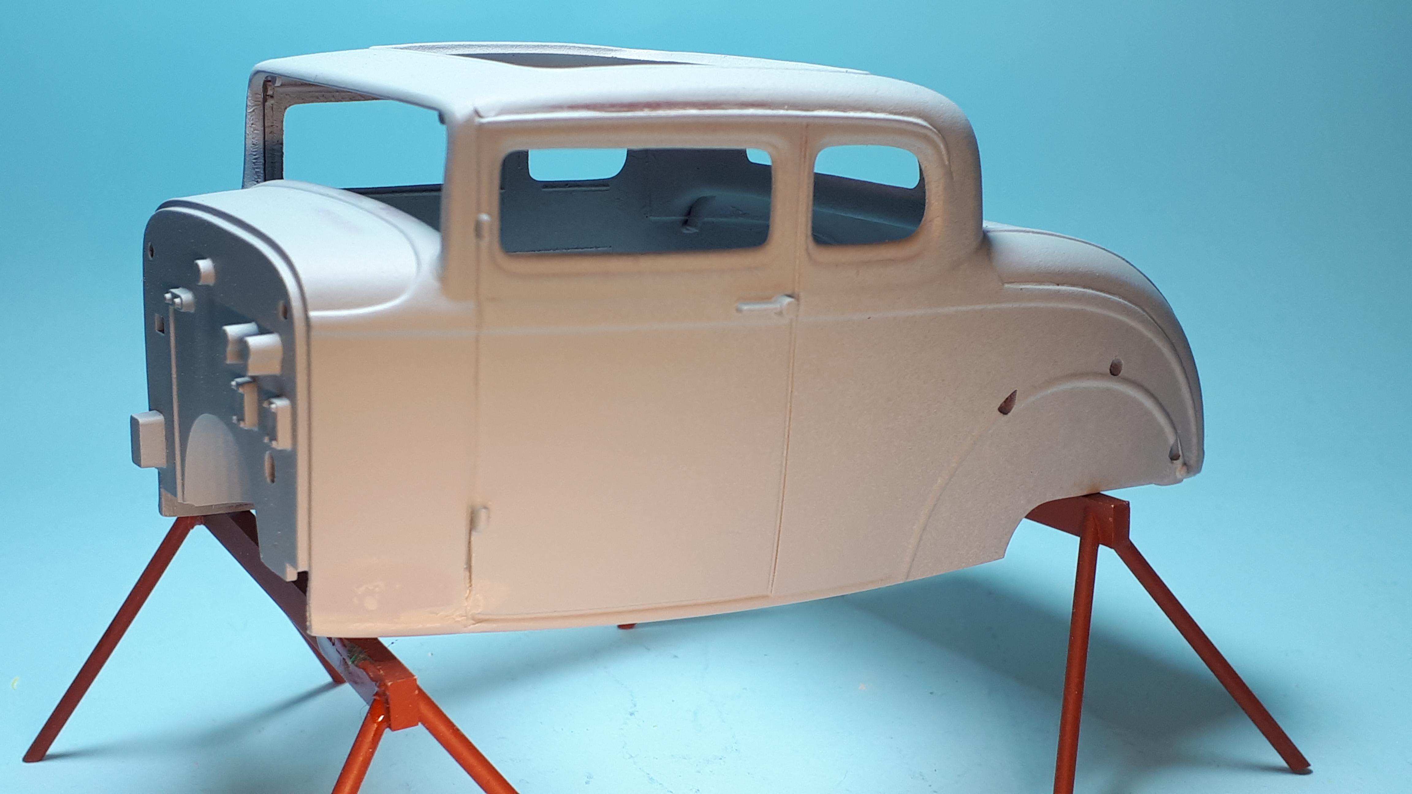

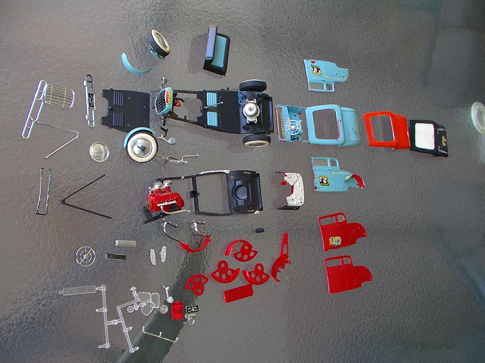

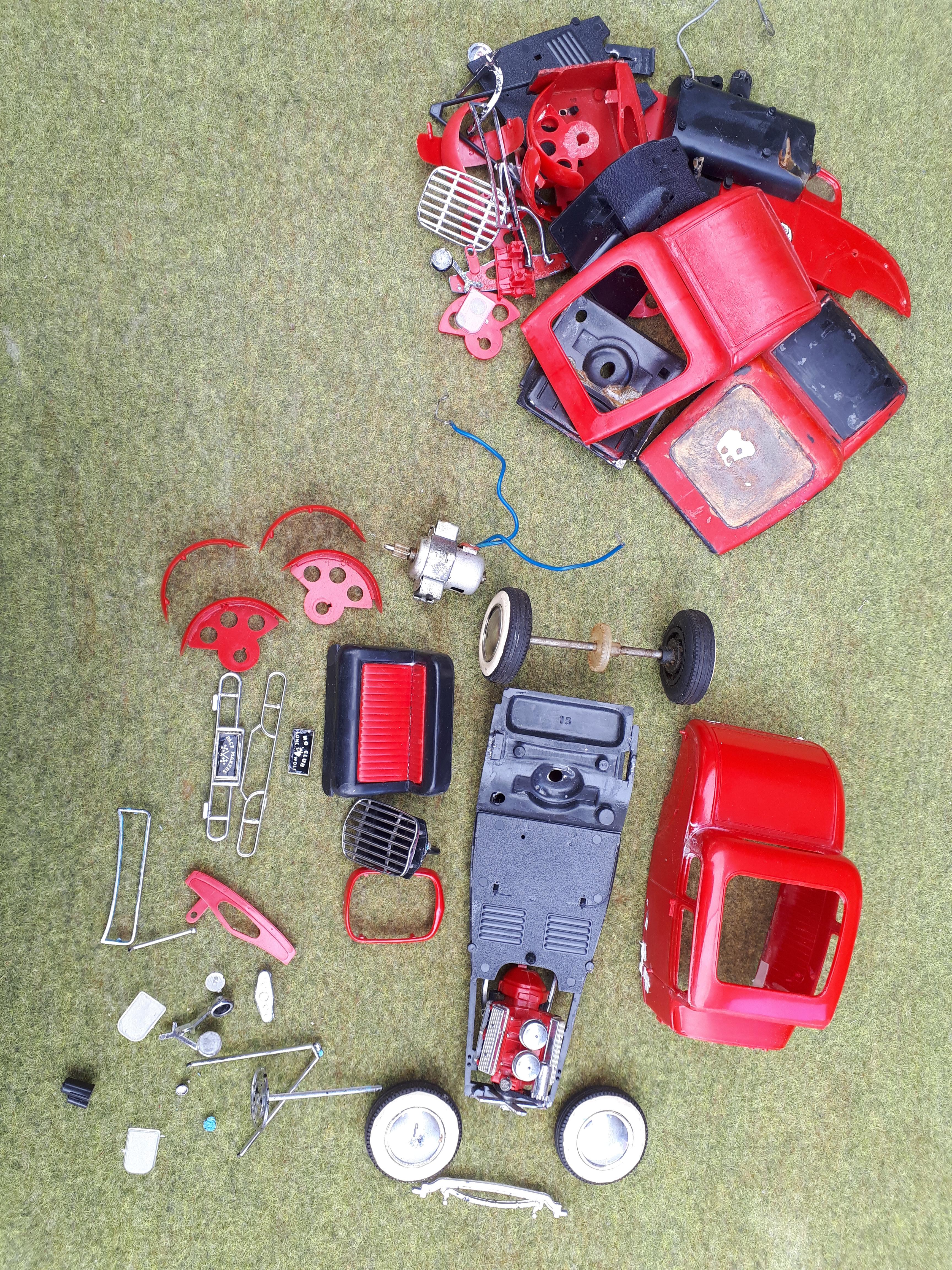

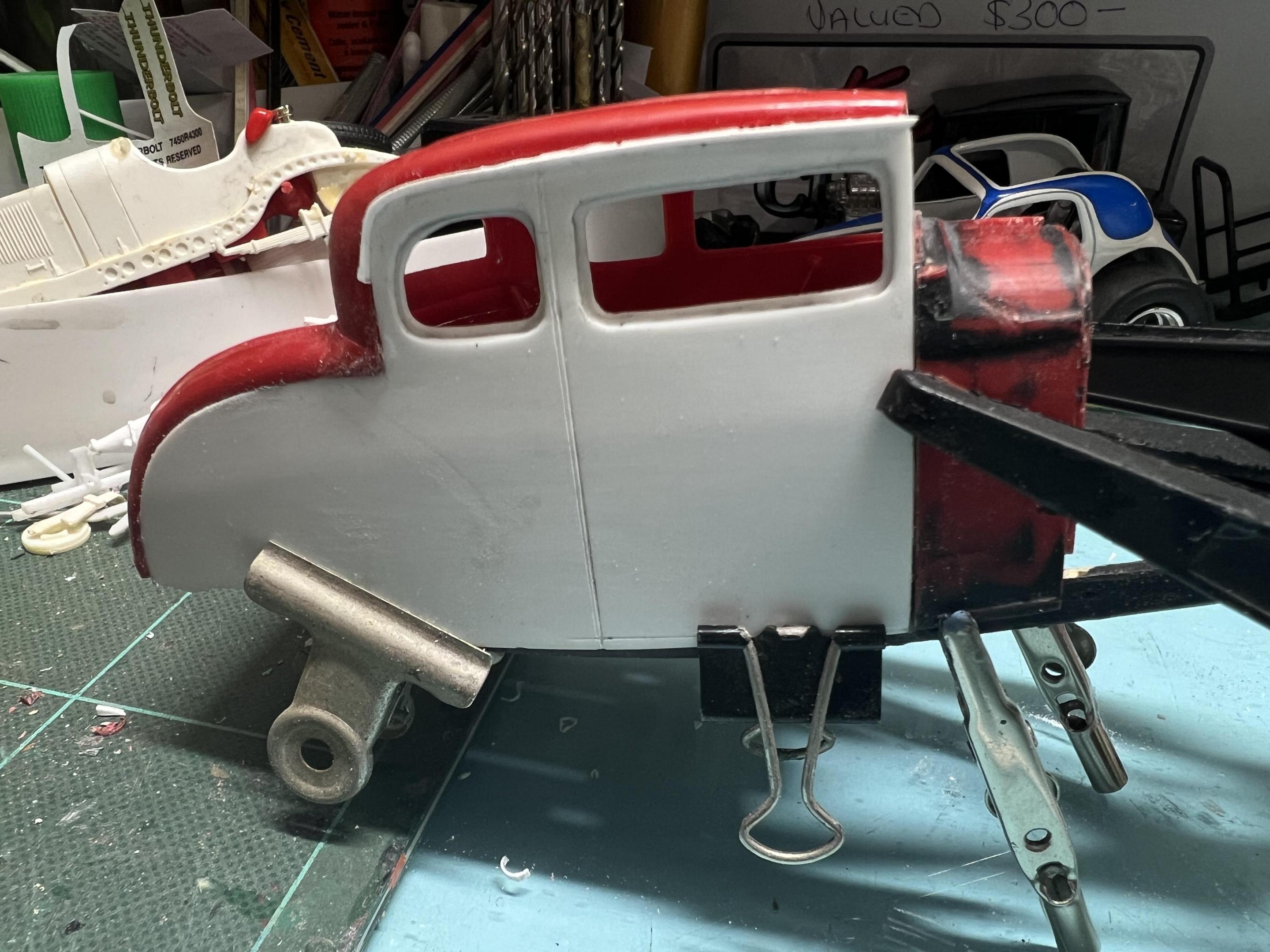

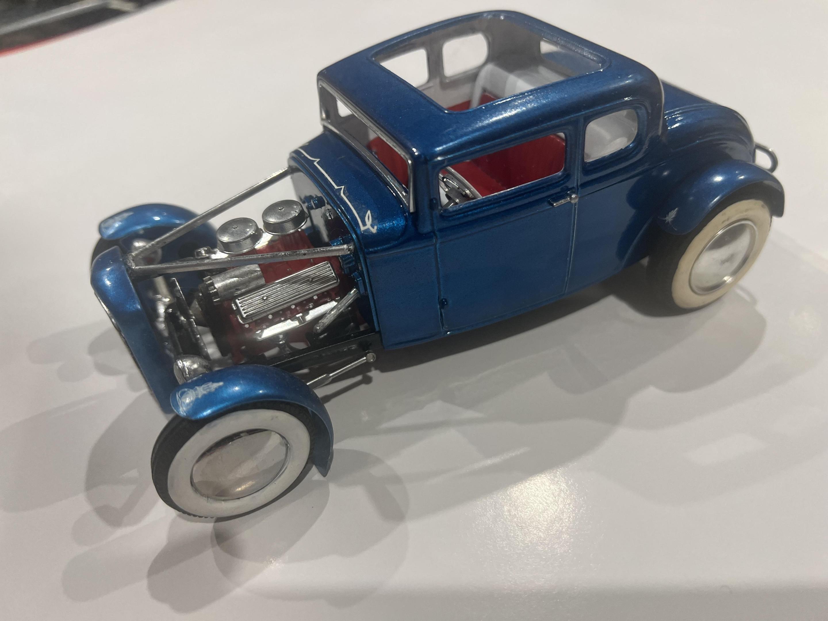

alan barton Posted August 29, 2023 Posted August 29, 2023 Some years ago I bought a box of gluebombed Monogram Sport Coupe parts for $25 in an Adelaide antique store. I figured there were enough decent parts in there to build one of my holy grails. recently I had another look in the box and figured I had enough to get another one out of those parts if I combined them with other parts in my stash. Before we start, for the benefit of newcomers to the hobby, this is NOT a model of a 1932 Ford Sports Coupe. It is a model of a five window coupe. The sports coupe had a fixed fabric top behind the doors, where the quarter windows are on a five window coupe. Just thought I would clear that up for those who weren't aware. The first photo shows the contents of the box. Plenty of old enamel paint, plenty of glue but the bones were there. Second photo shows the results of paint stripping in caustic soda. I got the basic body panels assembled although they needed a bit of tweaking. There were some broken pieces of plastic missing plus some fairly rugged glue joins to contend with. 3

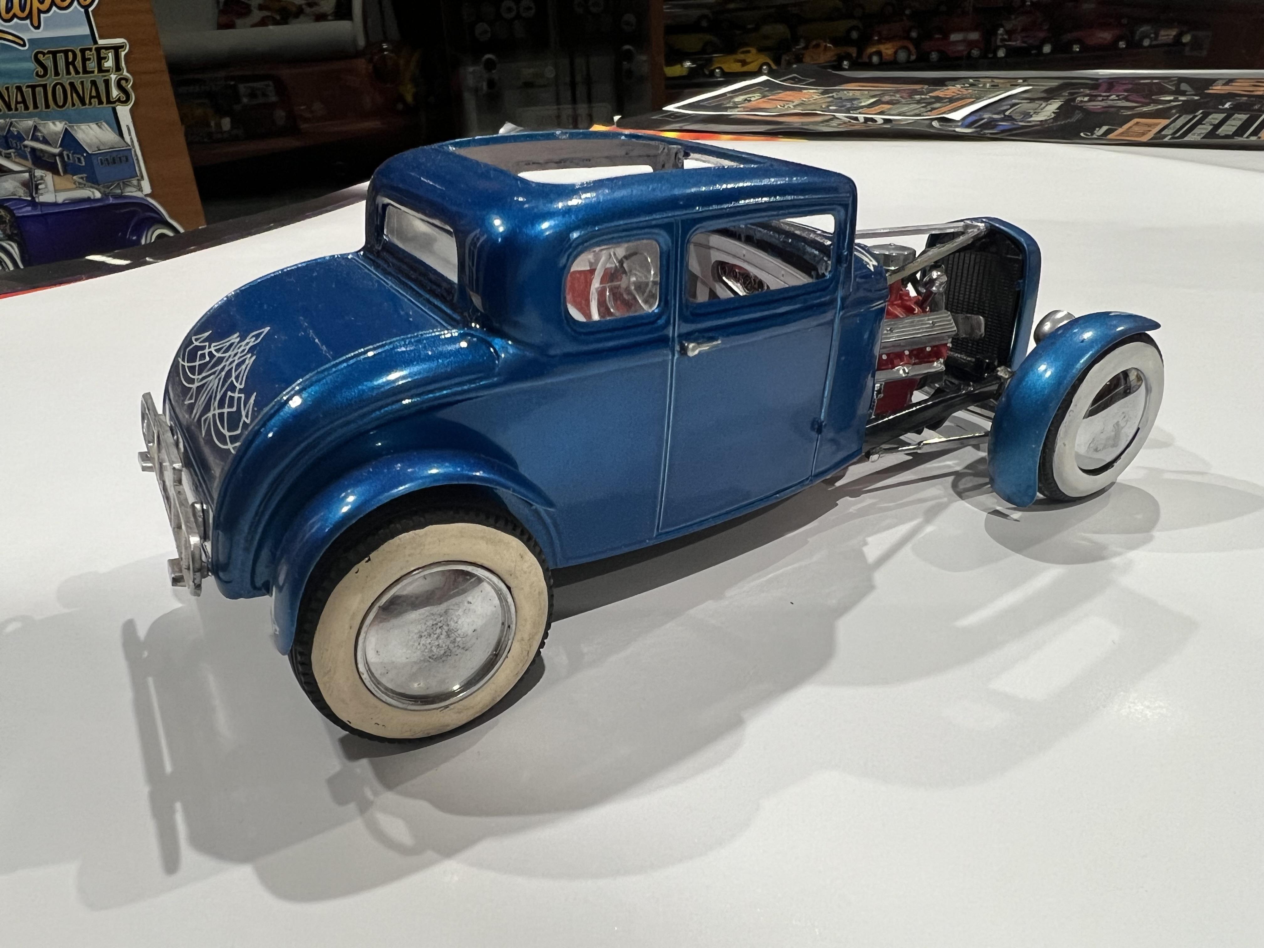

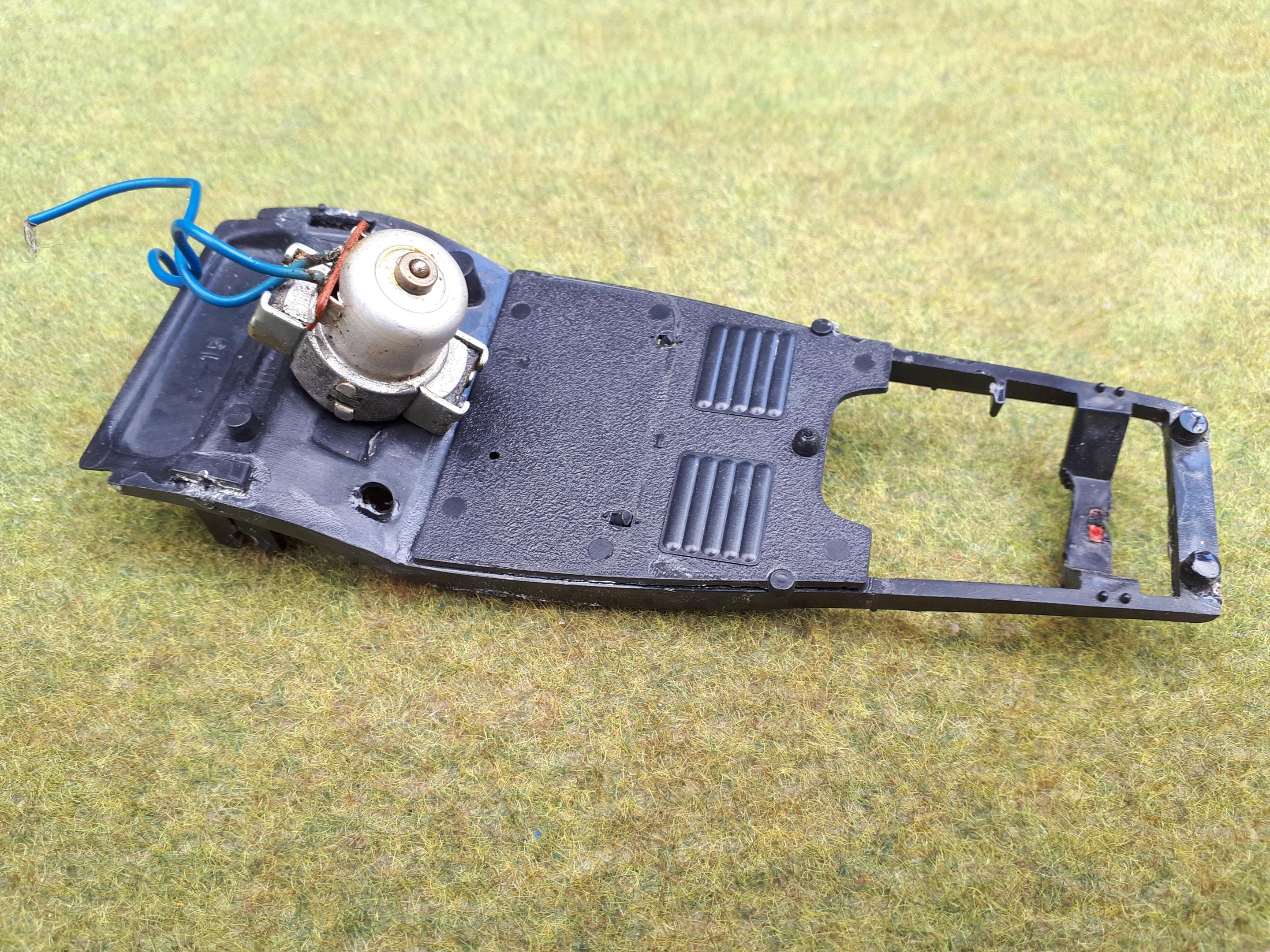

alan barton Posted August 29, 2023 Author Posted August 29, 2023 The chassis had a broken front crossmember that needed reinforcing. Otherwise all the parts were there to get it back on wheels. I considered fitting the original electric motor but decided it would only complicate things and left it out. I was missing some of the original wheelbacks so had to use short lengths of K and S aluminium tubing to make the replacement items fit the axle. Some of the tyres had handpainted whitewalls so I did the same on the replacement one that I used. Its a lot whiter but maybe it will yellow with age to match the others? Engine assembly went well and it was great to see it all together. 2
alan barton Posted August 29, 2023 Author Posted August 29, 2023 It took a few rounds of putty/sand/prime before the body was ready for paint. Considering what it looked like when I started, I was pretty happy with these results. The front cycle fenders also needed a few telescoping sleeves of aluminium tubing to get them firmly located on the axle. 2

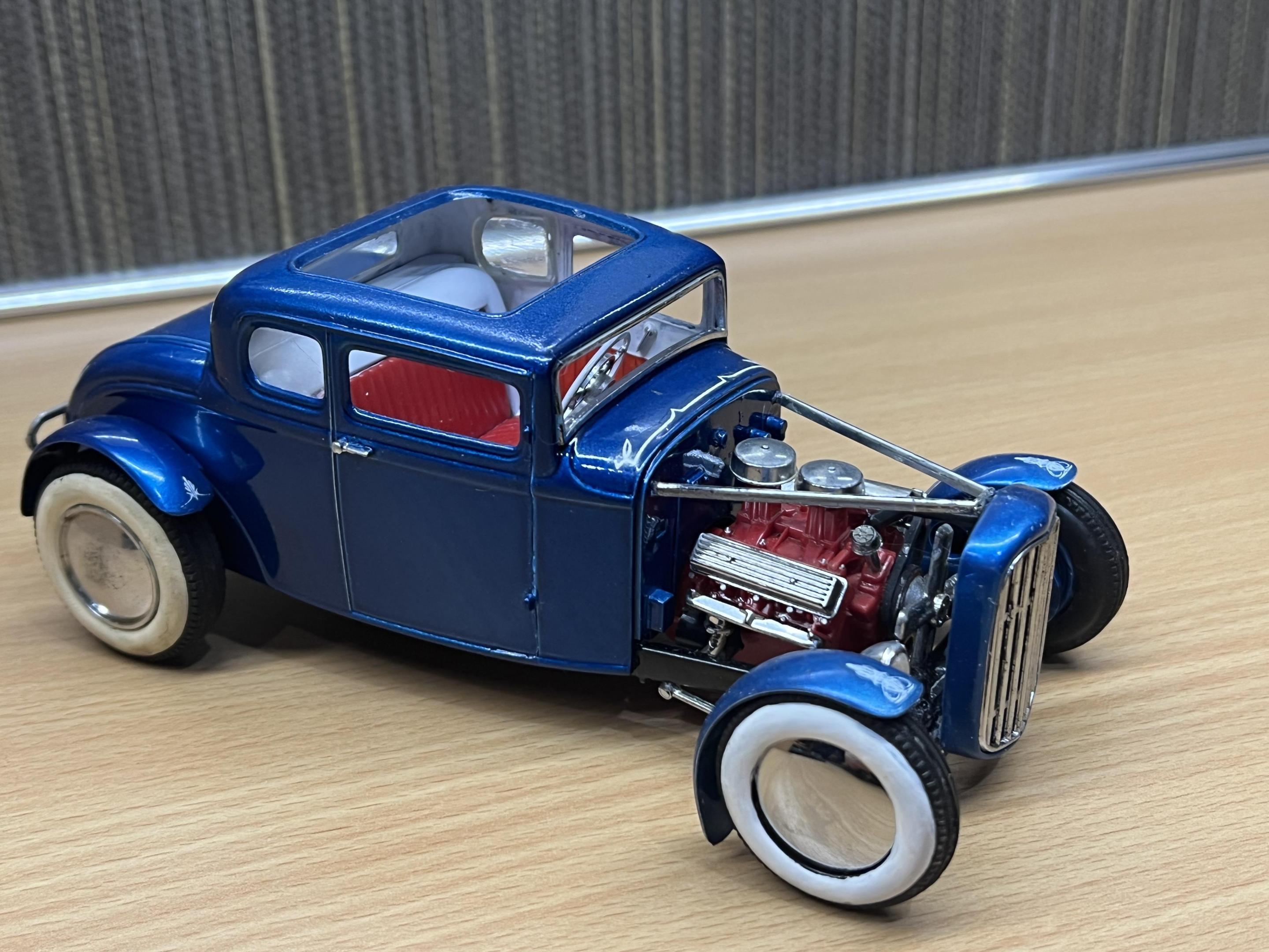

alan barton Posted August 29, 2023 Author Posted August 29, 2023 Finally, after a lot more fine sanding, it was painted in a Dupli colour Mazda metallic blue with plenty of clear. Considering that this is the only one I had ever come across for sale in Australia, I was very happy to finally park this one in my collection. These old Monograms are a great window into the history of modelling and I treat them as such - I see no point in attempting to super detail or accurize these models as there are plenty of far nicer examples of these cars in model form, especially the Revell version. Cheers Alan 6

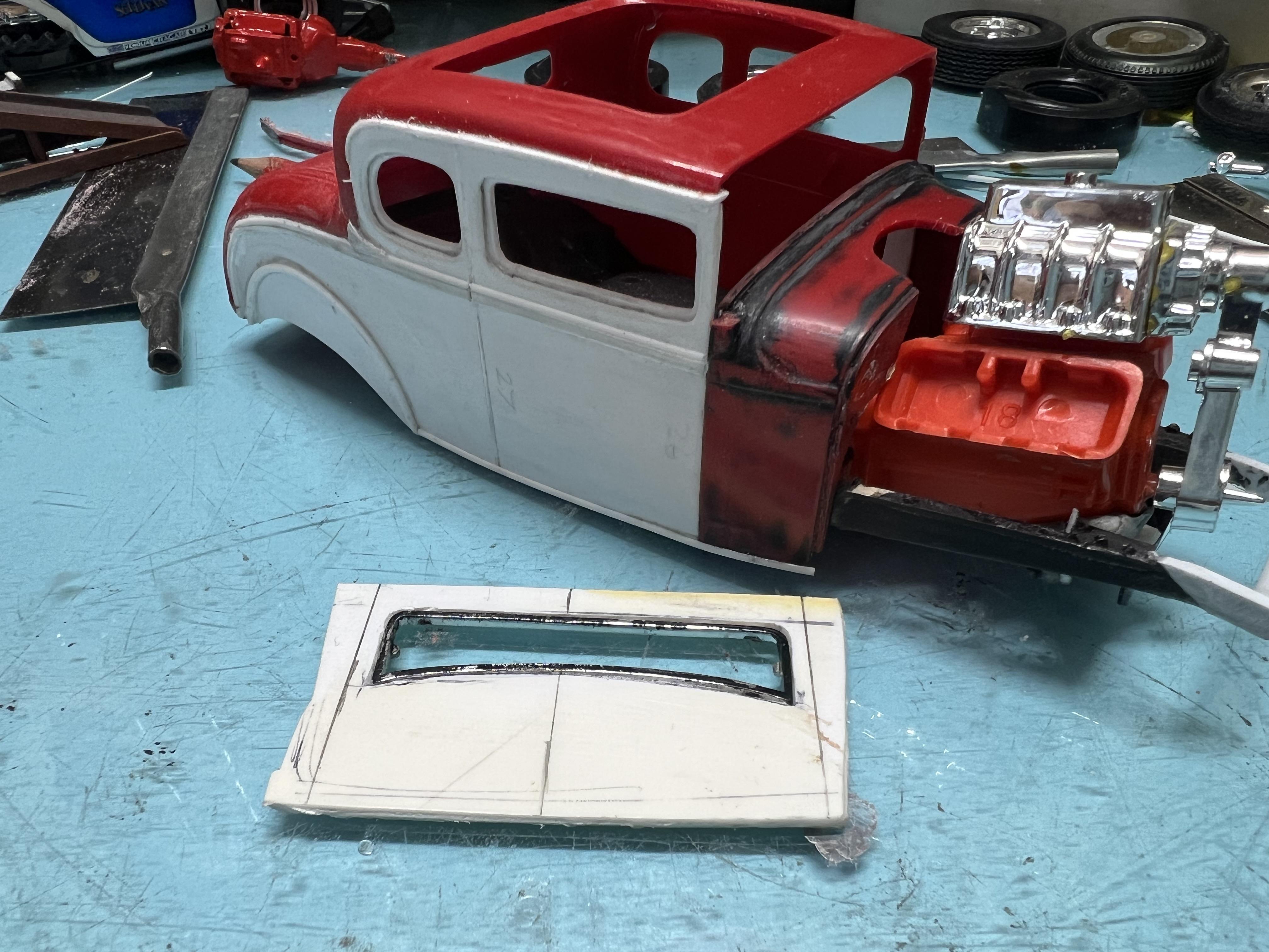

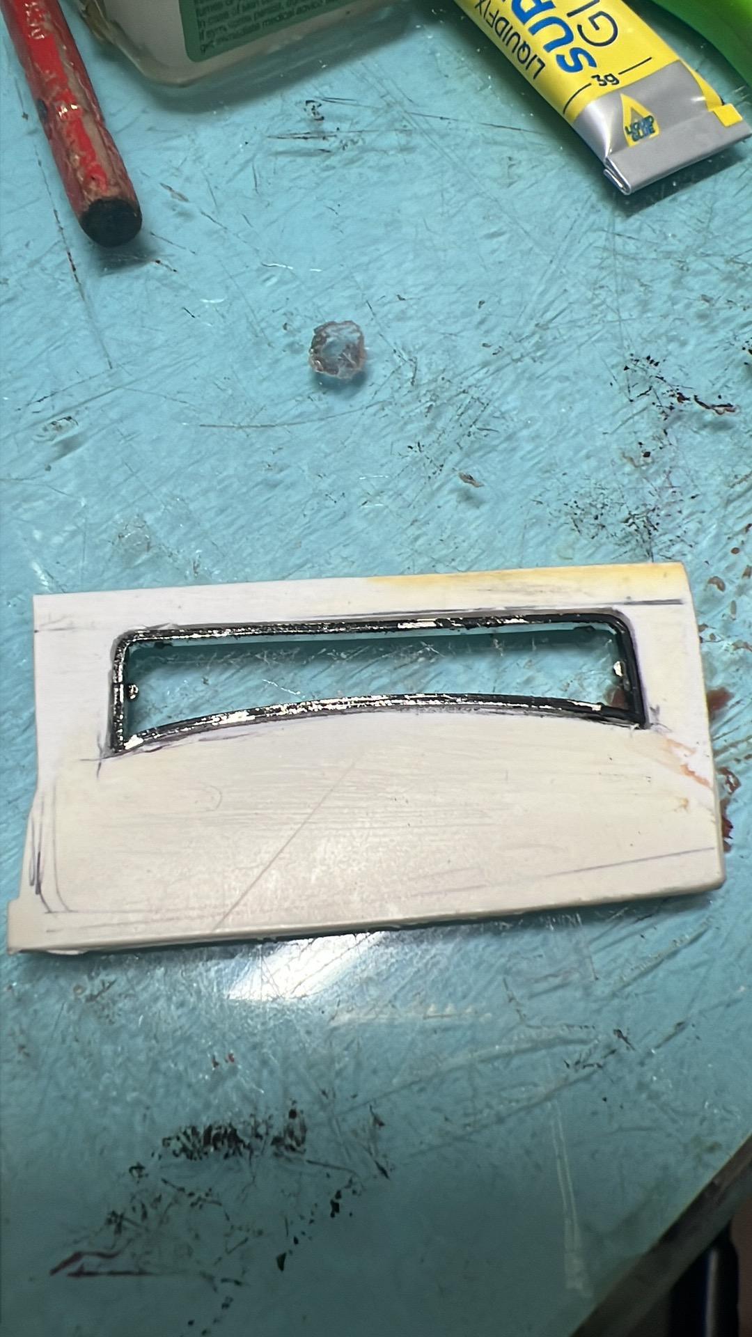

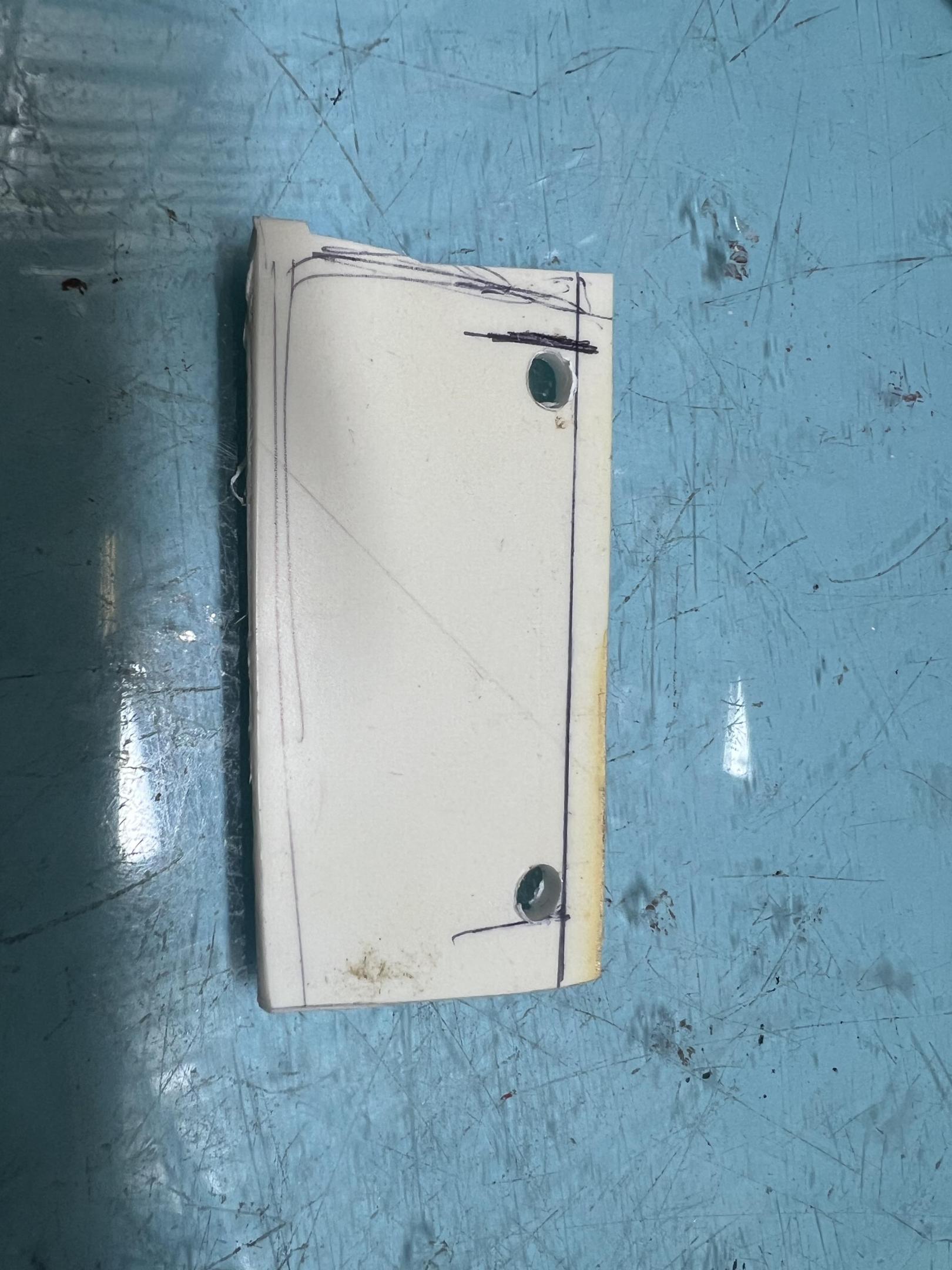

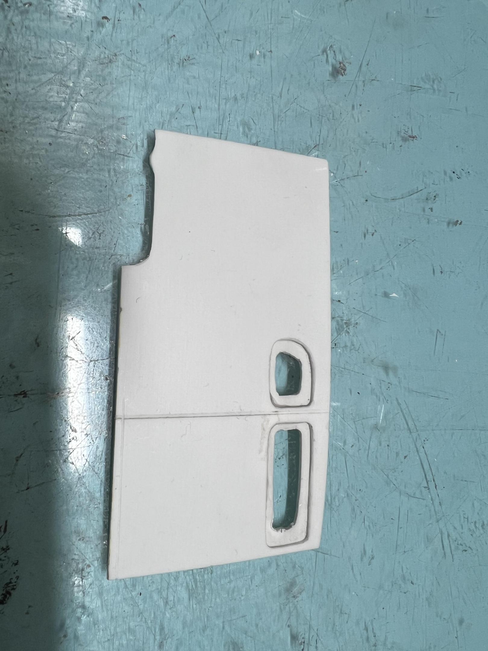

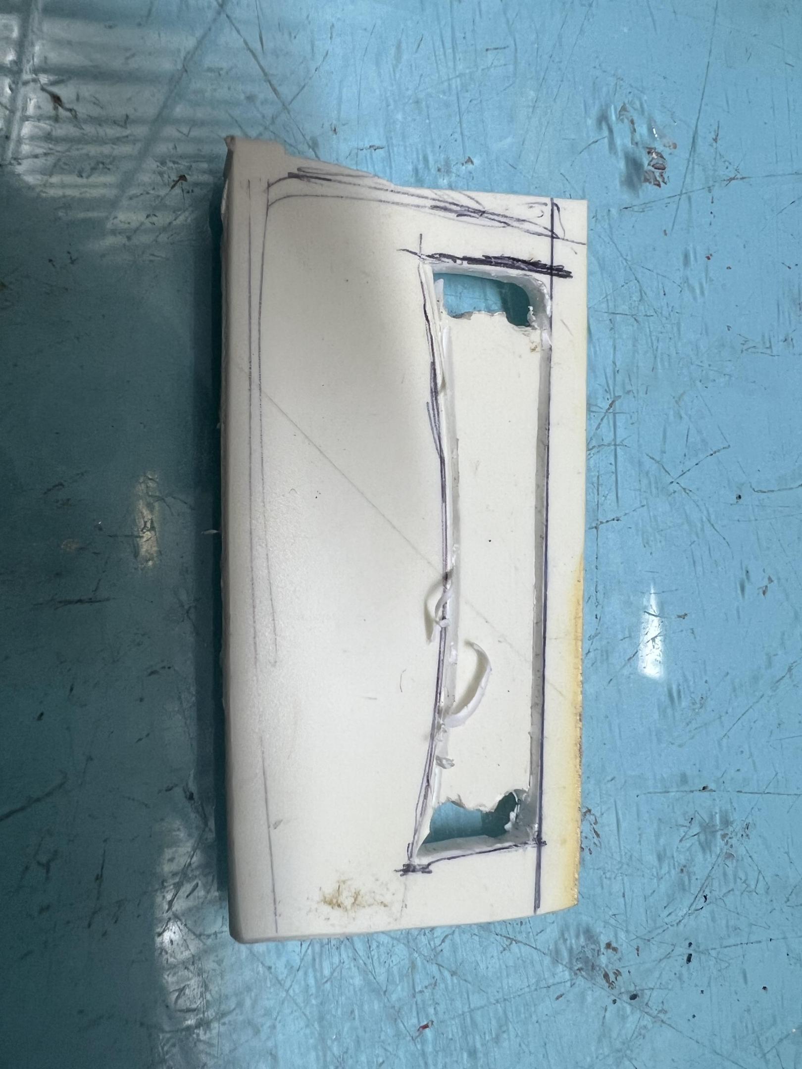

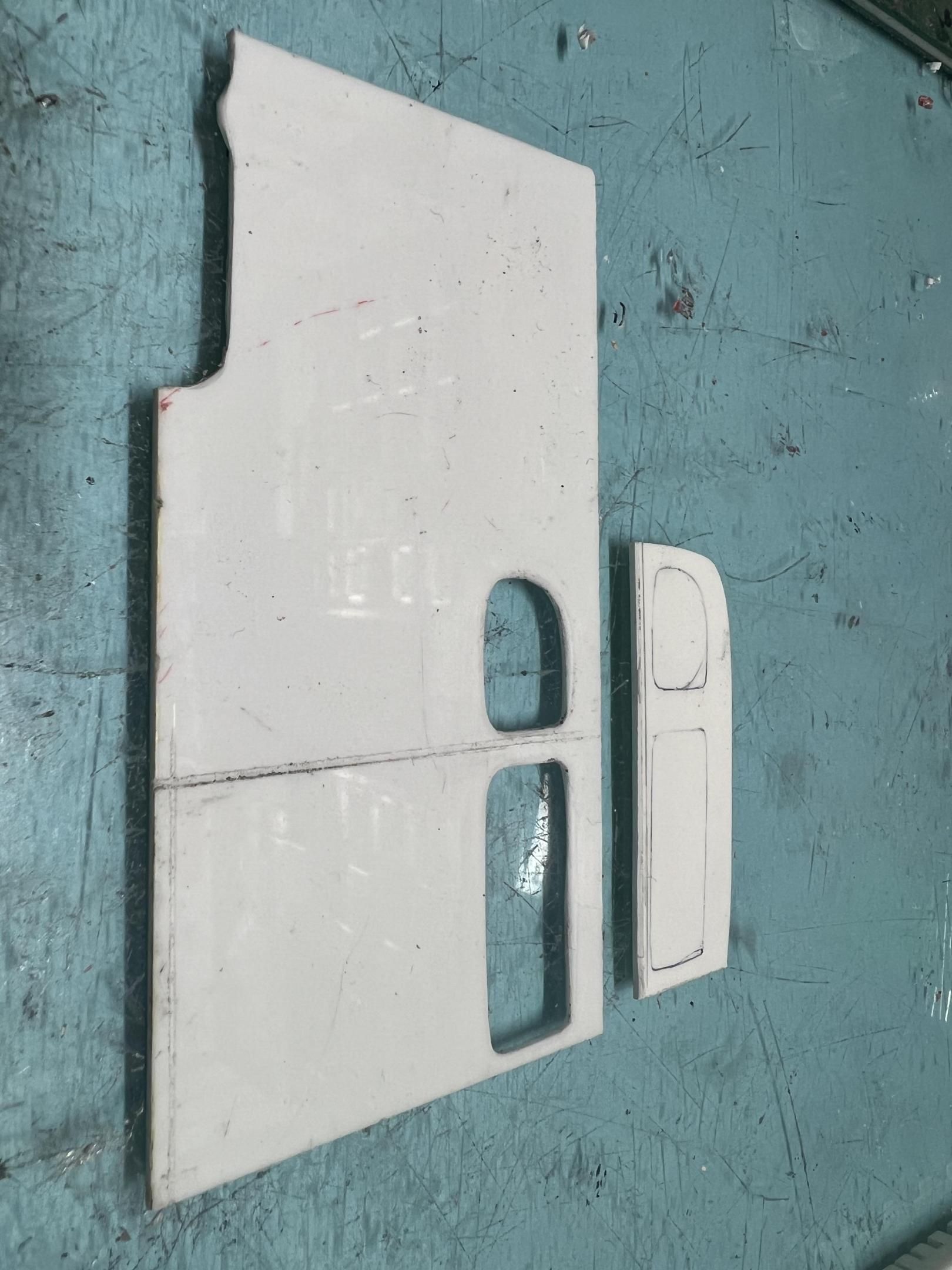

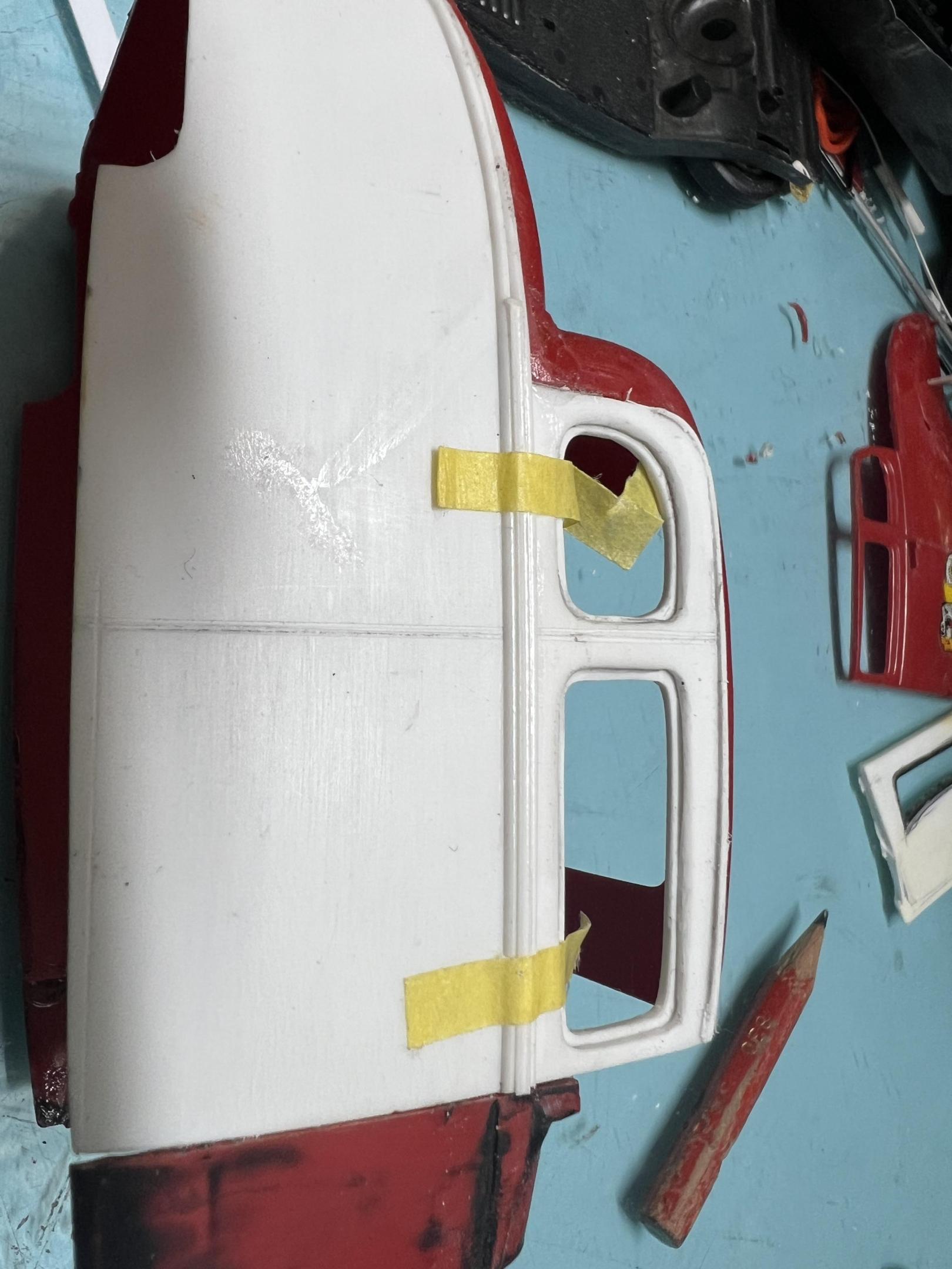

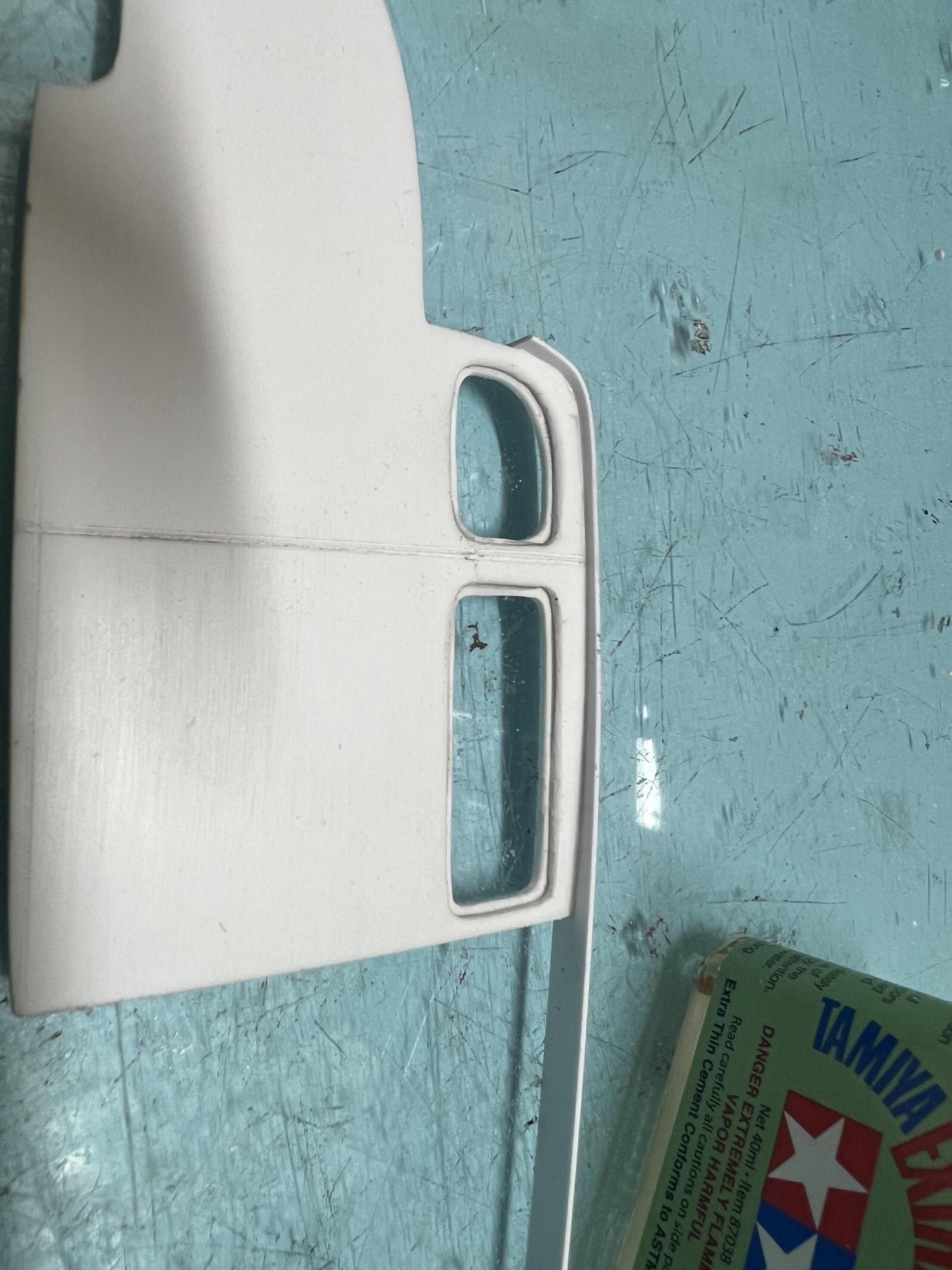

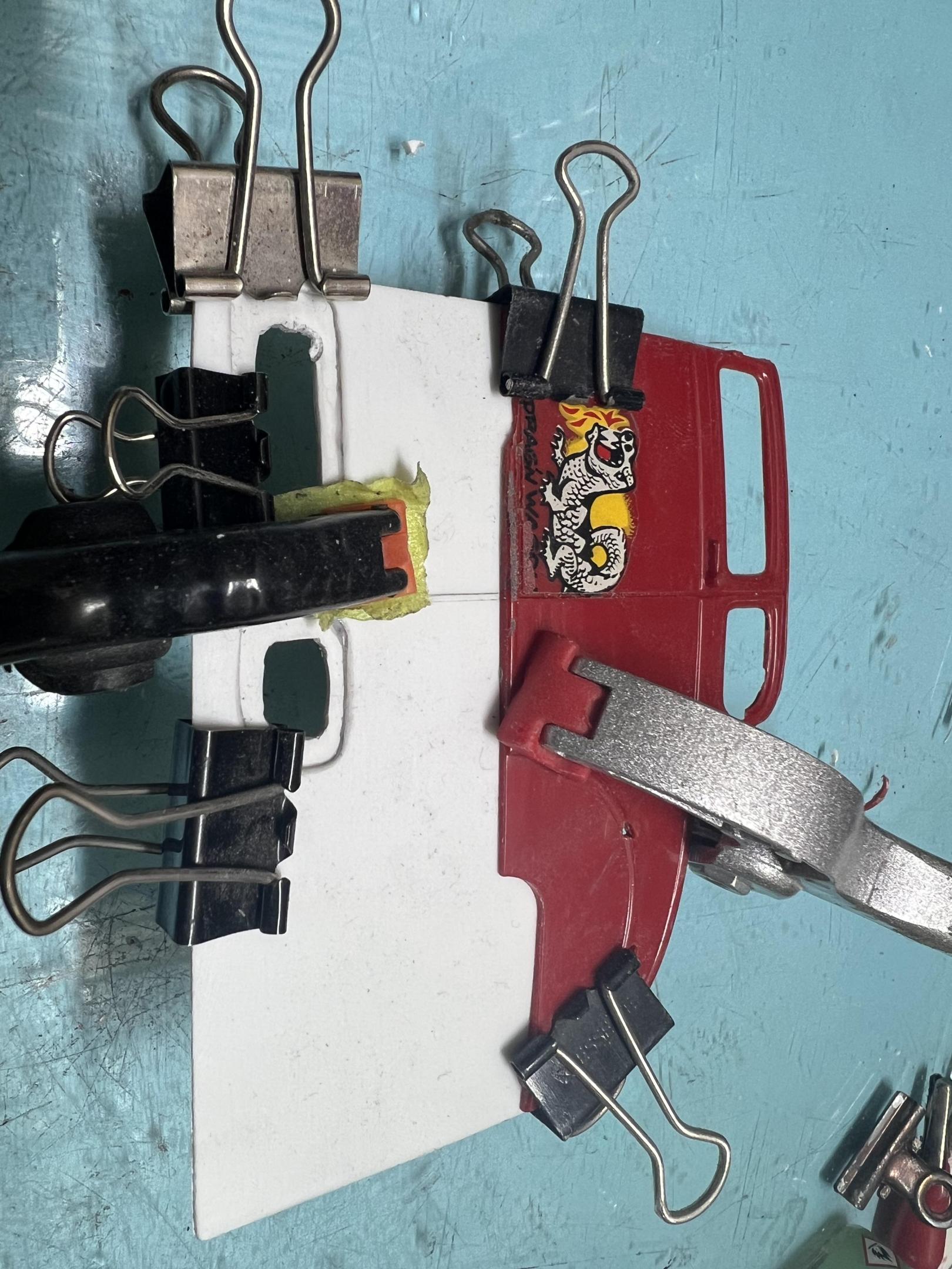

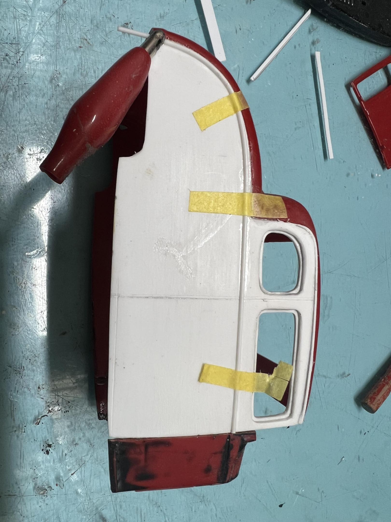

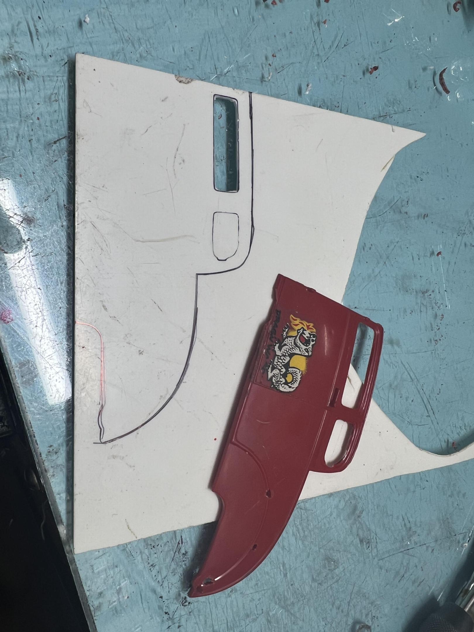

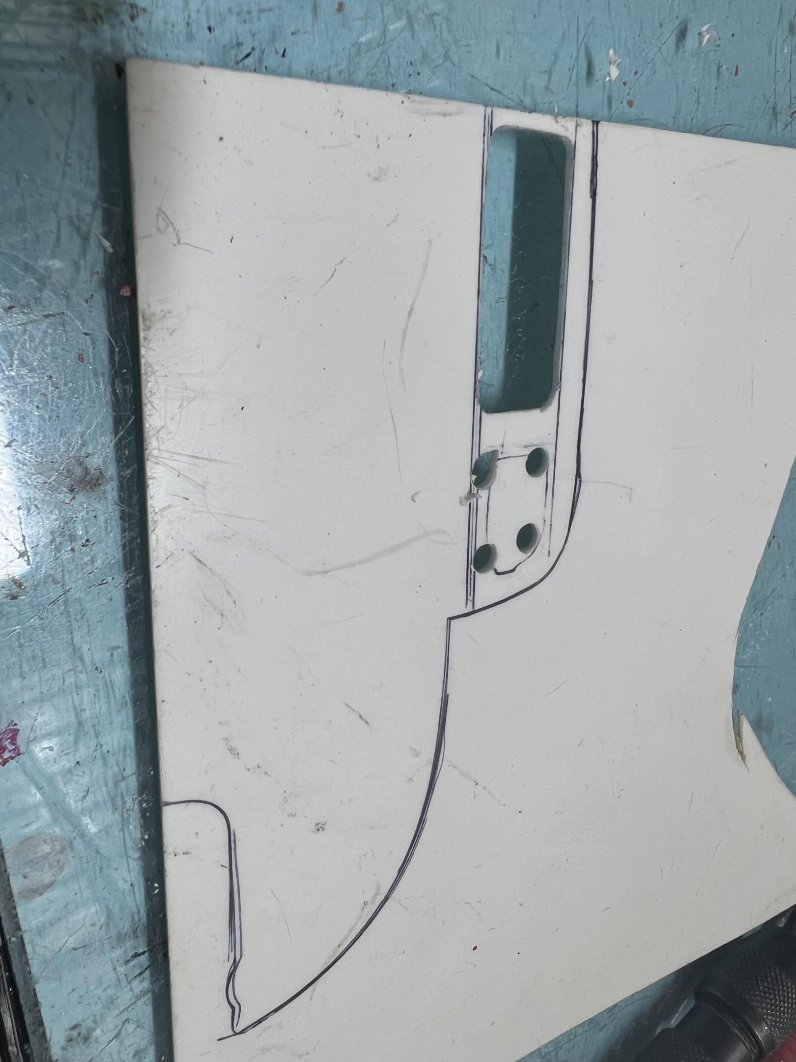

alan barton Posted August 29, 2023 Author Posted August 29, 2023 So last week, I started thinking about tackling another build. The first issue was that the box had contained three left hand side panels and 1 right hand side panel - so in effect I only had 2/3rds of the second body. There are plenty of other parts missing but I figured there was no point starting to look for parts if I couldn't replace the missing side. I started by tracing the spare right hand side onto a sheet of 1mm white styrene. Before attempting to do any shaping, I began cutting out the windows. I started by drilling a series of holes in the waste area and then trimming them to size with a sharp X-Acto. The thing is, if I was going to duplicate the window mouldings, I had to cut the window opening to the larger size of the moulding. I checked regularly with the spare left hand side to see how I was going. When I was happy with the size I rounded the edges by sanding them smooth to duplicate the mouldings. Next, I cut a piece of styrene roughly the size the side window area of the coupe and then marked out the actual window openings, Again I used drills to hog the area out but I didn't trim them to the exact size. I felt it would be too easy to misjudge their size, shape or positioning. Tamiya liquid cement was used to glue the piece on the inside of the side panel. While this was drying I clamped it to the spare side piece to aid in achieving the correct curvature of the side panel. I was now ready to cut out the overall shape of the side panel and sand it to get as closes a fit as possible. Flat Evergreen strip was added along the top edge to form the basis of the gutter. The gutter would not be sanded to shape until the body was assembled. Small strips of flat strip were glued to the front edge of both side panels and the last step for this stage was to glue the cowl onto the body and clamp everything in position on the frame - a bit of a handful if I say so myself! 3

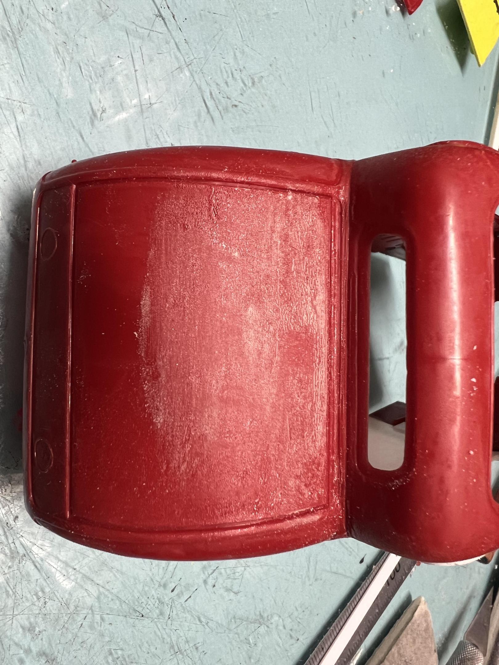

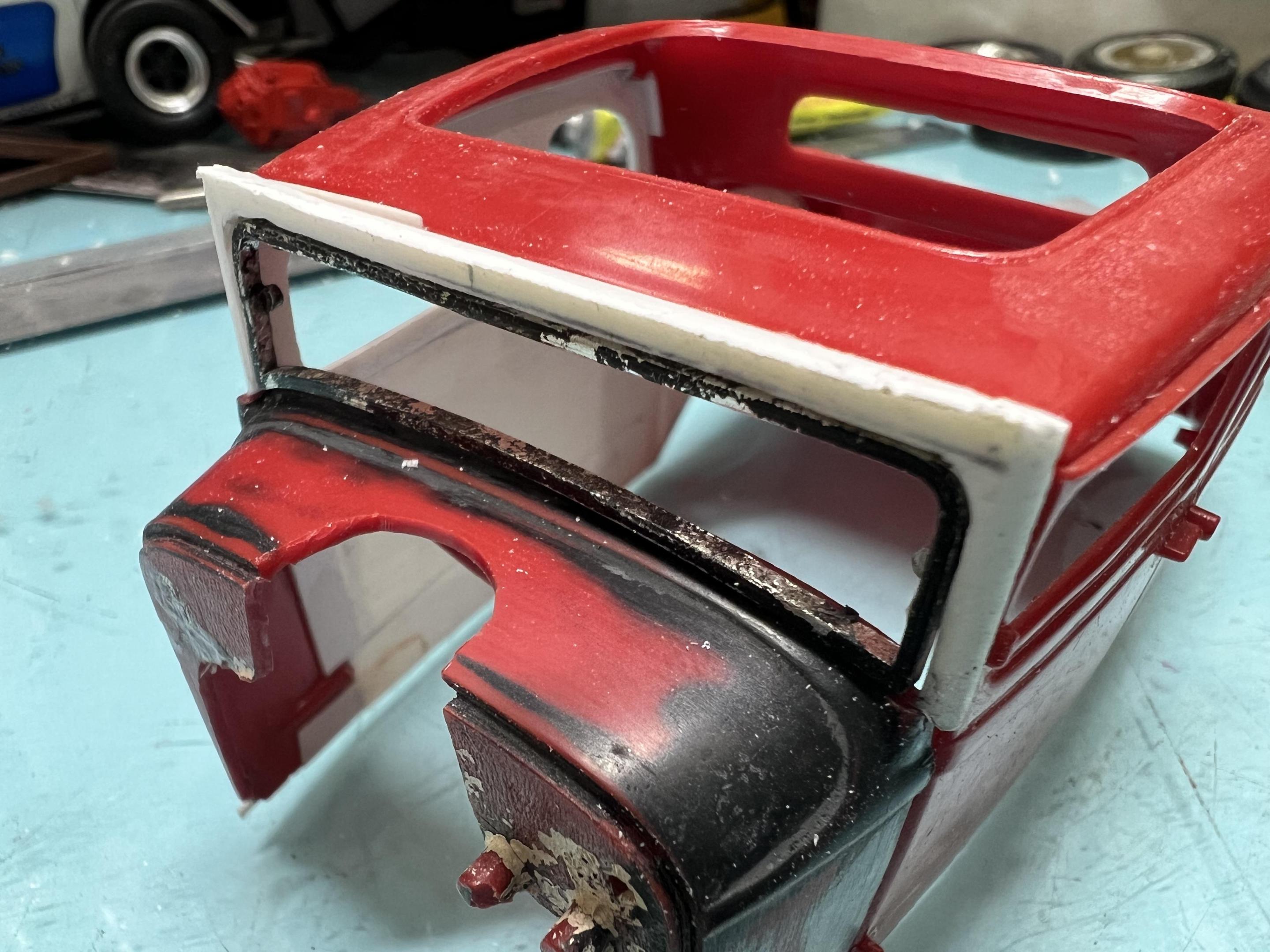

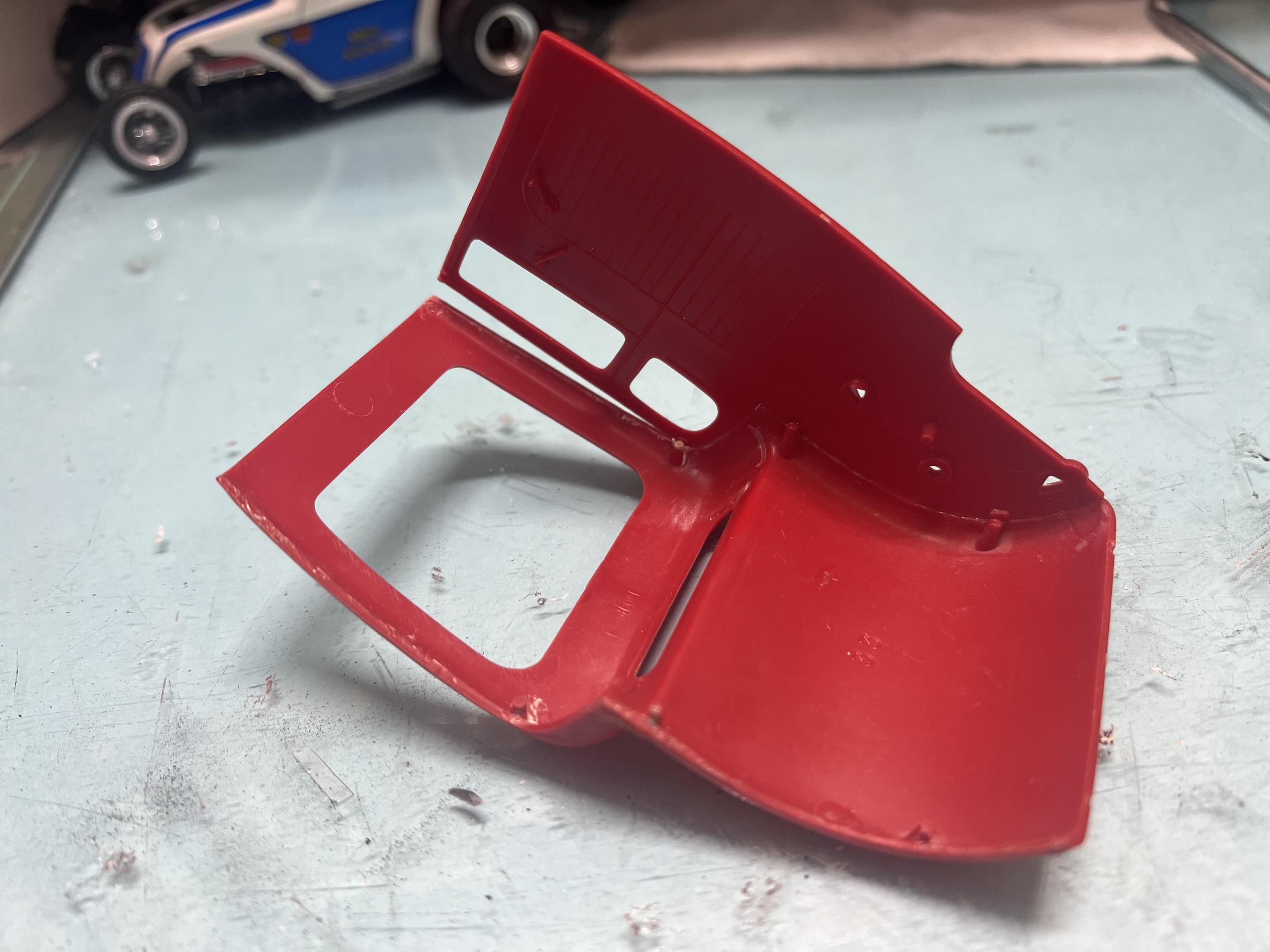

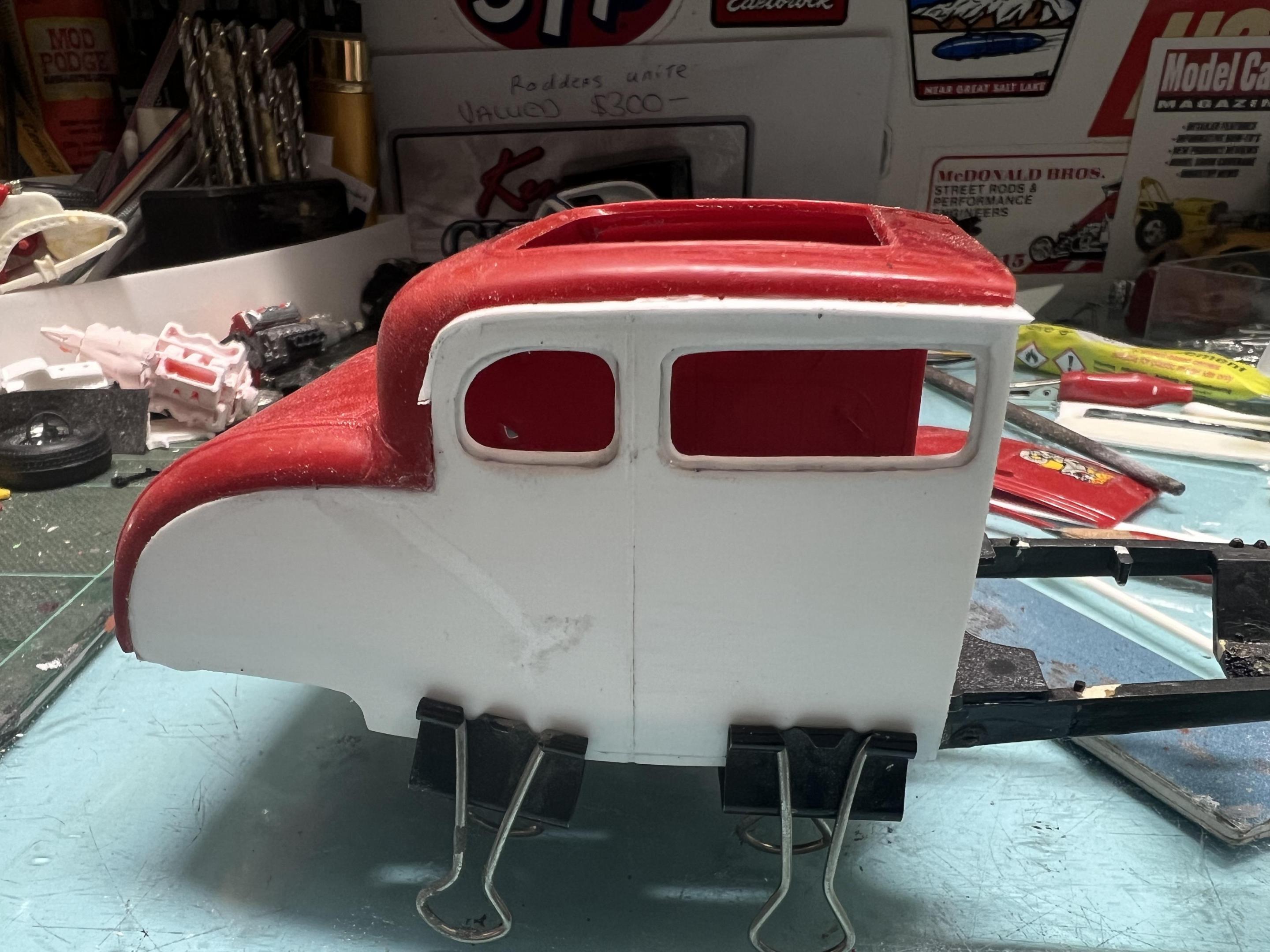

alan barton Posted August 29, 2023 Author Posted August 29, 2023 The spare cowl from the box of parts was split and cracked and missing the windshield opening. After a bit of thought I decided to start with a windshield shaped hole in a piece of thick styrene! After finessing the fit for a while< then cut way the lower section that would not be needed and glued it, slightly oversize, to the body. Once again, plenty of filing, puttying, sanding and priming followed. About the same time I tackled the swage lines or body mouldings on the side of the coupe. I was originally going to use either flat or half round styrene to form these - that seemed pretty obvious. The more I studied it, the more I decided an easier was would be to first run the whole swage line from firewall to lower rear corner using one strip of 1.5mm quarter round. When that had dried, I ran a second piece above the first piece, tapering it off as it began to curve. Finally I took a third piece of 1.5mm half round and glued it upside down in the valley between the first two pieces. The main reasons for this long winded operation was that a) the thin strips were easier to curve accurately and b) there is quite a change in thickness of the body moulding over the length of the car. Another strip of 1.5 was used to make the wheel arch. You will see that I also cut a huge gaping hole out of the firewall and cowl - hey, it was already split and broken so no crime here! These models are approximately 1/20th scale which restricts the amount of parts available for a project like this. I did have a big ol' Hemi lying around from a Monogram Sizzler so that led me to choose an early sixties altered coupe as the them for this build. 2

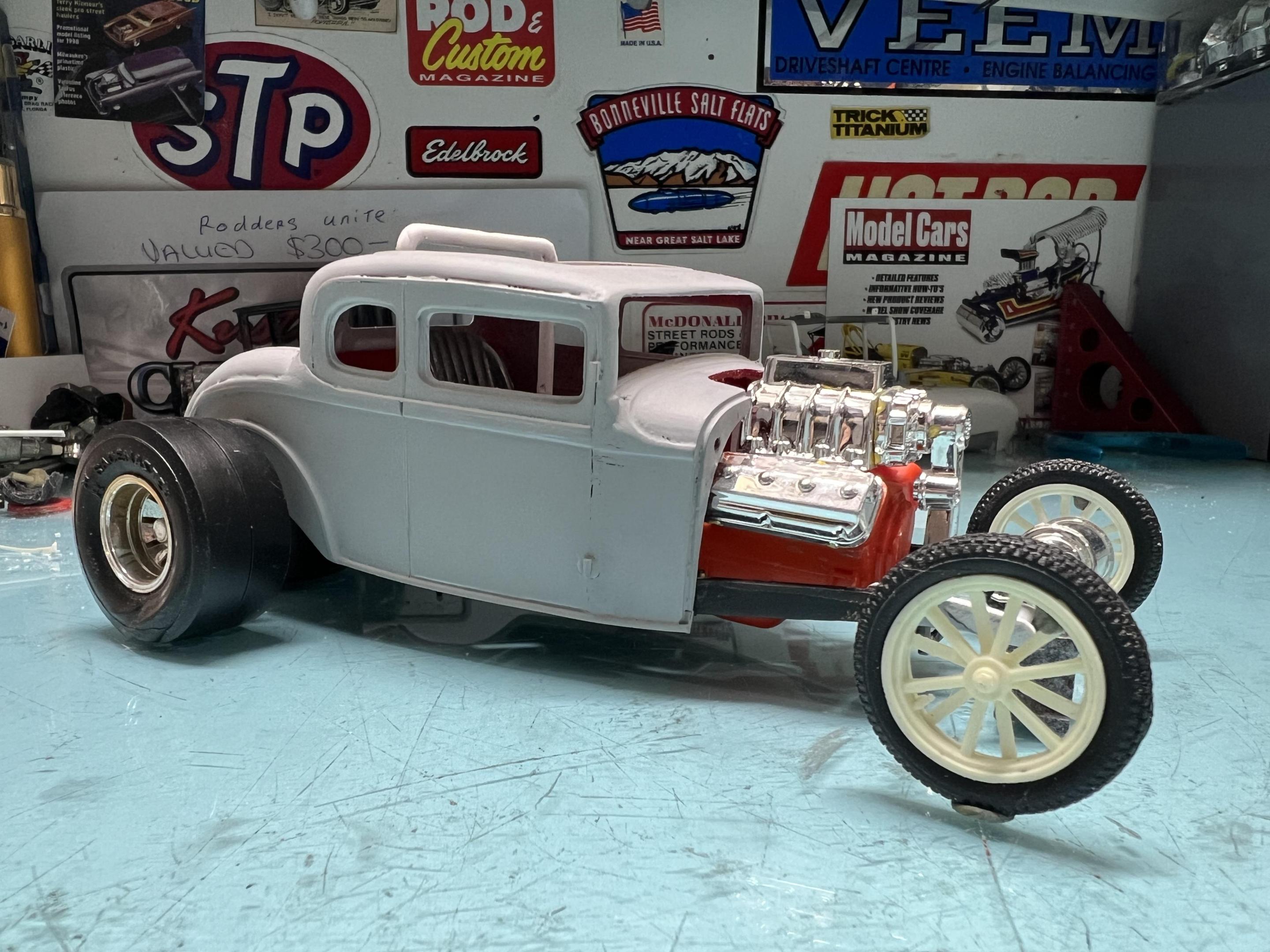

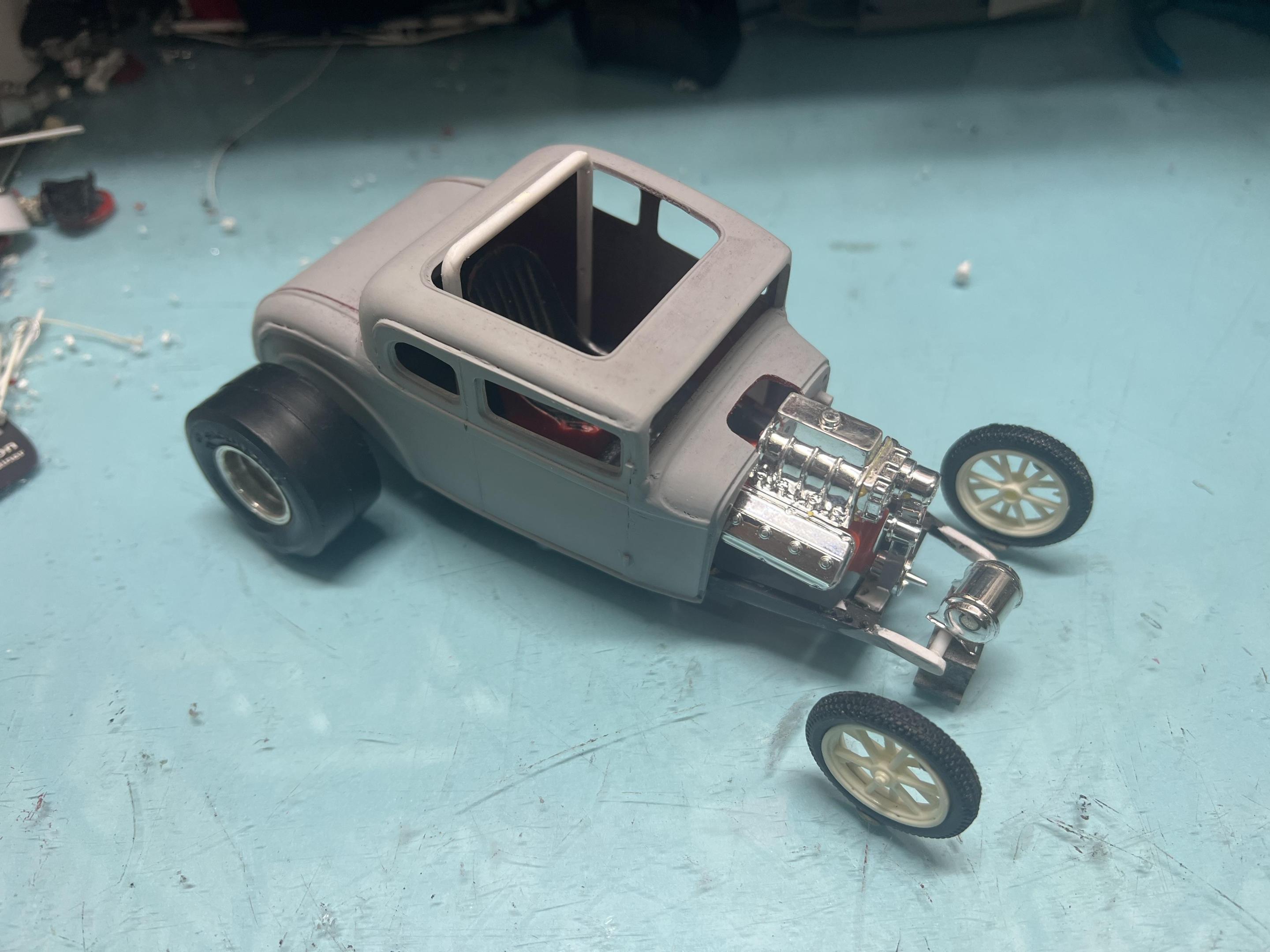

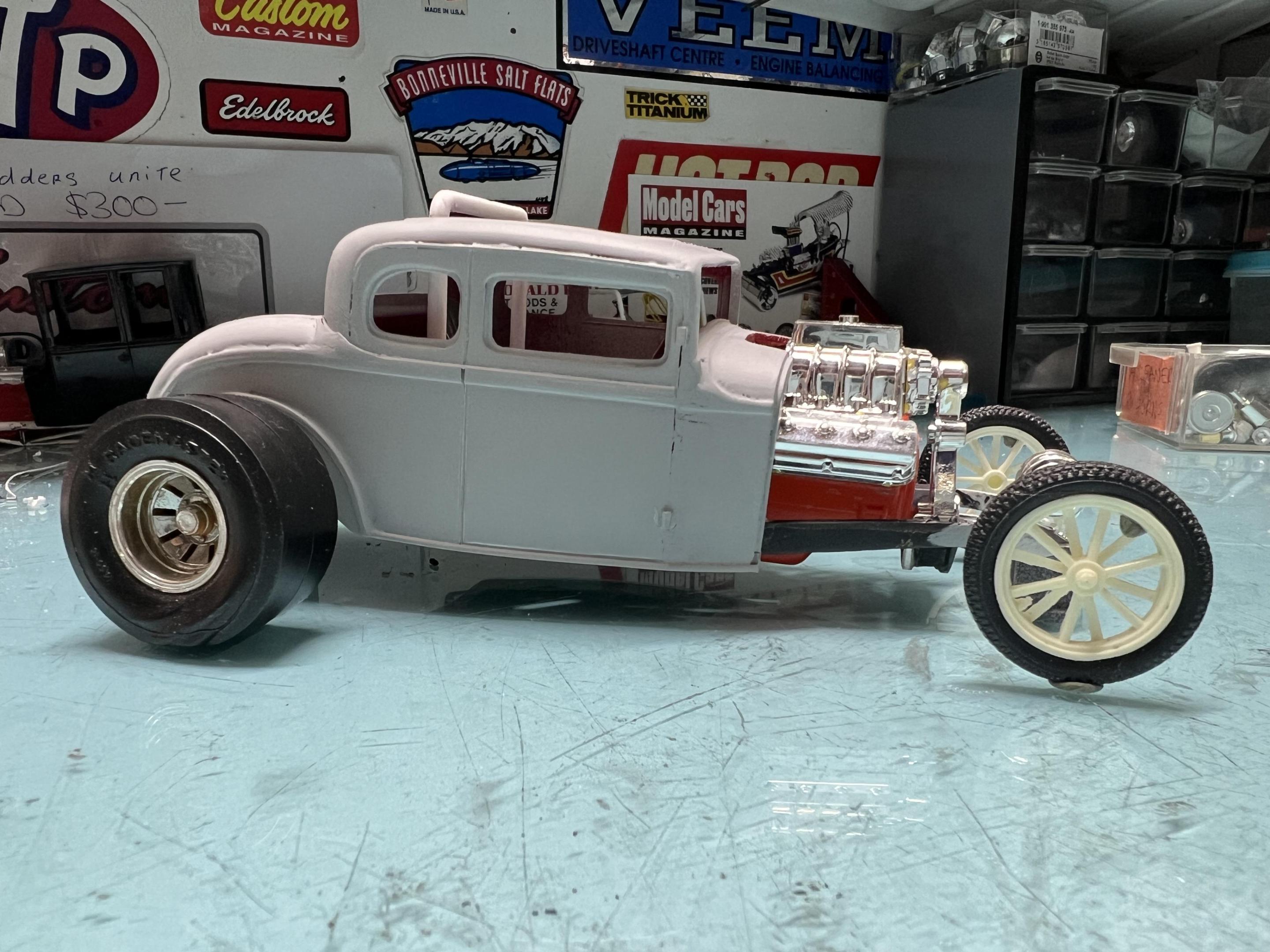

alan barton Posted August 29, 2023 Author Posted August 29, 2023 When everything had dried overnight I took a look at the car and it looked too fat, ie, tool tall in the height of the doors. Early Monogram kits were at best twenty footers - they weren't dead nuts to scale. After some serious eyeballing I elected to saw off 3mm or 1/8th inch from the bottom of the rockers and then replace the lower moulding, both sides, with 2mm Evergreen half round. I also rescribed the lower door line at this stage. After some more filing, sanding and puttying, it was time for the first coats of primer. So as of tonight, we have a mockup. The front wheels are resin versions of the Boothill Express front wheels and tyres form thepartsbox.com. The back wheels and tyres are Ice T but probably wont stay. It's looking pretty tough but there is a long way to go! Cheers Alan 7
