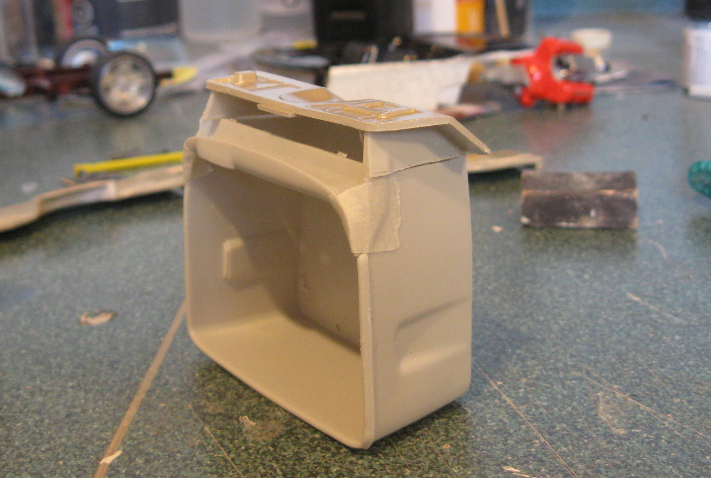

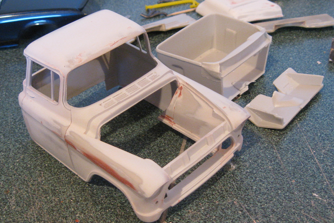

Can-Con Posted December 1, 2023 Author Posted December 1, 2023 Paint went south on me so I decided to make some alterations I should have to start with before I repaint it. First, I attached the filler pieces to the inner fenders and fill the seams. They're separate pieces so you can get the interior bucket in easily. I also glued the fire wall to the interior bucket and cut it off again back some on the bucket's side walls. This allows me to attach the firewall and then put in the interior. All this just to get rid of those seams on the inner fenders. I also addressed the fit of the windshield. It didn't fit too bad on my kit but it could be better and I also wanted to add the peak above the glass that's so prominent on the real trucks. I simply glued a strip of thin sheet across the top of the opening and another strip across the bottom for the glass to but up against. After filing the bottom back corners of the glass and the opening in the same area bit it fit a bit more snugly. Then I trimmed the strip I put across the top and tried the fit. Not perfect but a bit better and the top lip is now there
NOBLNG Posted December 1, 2023 Posted December 1, 2023 Nice fix for the ill-fitting glass on these kits Steve.? I really like the updated 409 too!? 1
espo Posted December 2, 2023 Posted December 2, 2023 On 12/1/2023 at 4:44 PM, Can-Con said: Paint went south on me so I decided to make some alterations I should have to start with before I repaint it. First, I attached the filler pieces to the inner fenders and fill the seams. They're separate pieces so you can get the interior bucket in easily. I also glued the fire wall to the interior bucket and cut it off again back some on the bucket's side walls. This allows me to attach the firewall and then put in the interior. All this just to get rid of those seams on the inner fenders. I also addressed the fit of the windshield. It didn't fit too bad on my kit but it could be better and I also wanted to add the peak above the glass that's so prominent on the real trucks. I simply glued a strip of thin sheet across the top of the opening and another strip across the bottom for the glass to but up against. After filing the bottom back corners of the glass and the opening in the same area bit it fit a bit more snugly. Then I trimmed the strip I put across the top and tried the fit. Not perfect but a bit better and the top lip is now there Expand Great job on reshaping the window openings. This has been a sticking point on an otherwise nice kit. I widened the window moldings slightly on a couple to try and compensate on the ones I built.
