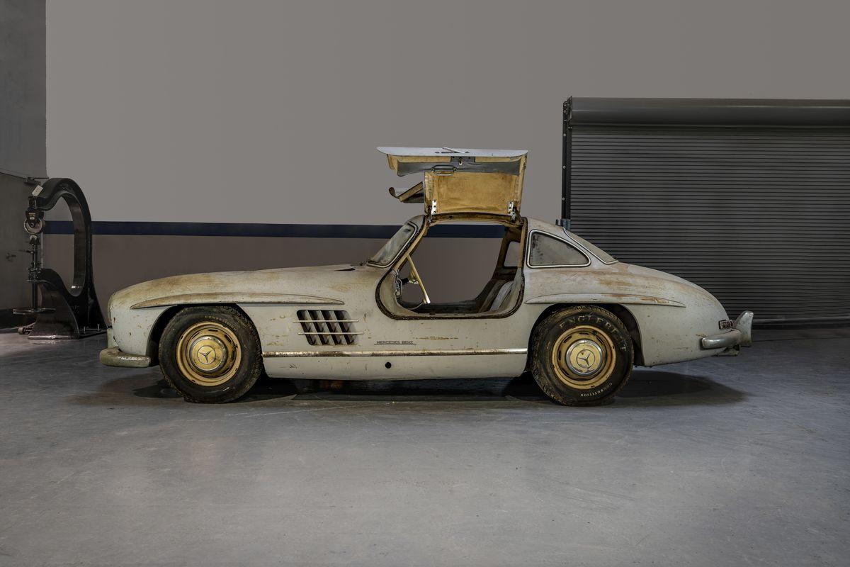

Mittagskind Posted September 21, 2023 Posted September 21, 2023 This will be my new project... ...and this is what it could look like. I'm not a big fan of Mercedes automobiles, but this model, built since 1954, is simply special. In Germany, a 300 SL is currently causing headlines and scandal. A German car dealer bought a 300 SL in Switzerland (certainly for a lot of money). When he wanted to register the car in Germany, it was discovered that such a car with the same chassis number already existed. That can not be really. Only one car can have this number, it is effectively its birth certificate. An investigation revealed that the car from Switzerland is the original. So the one that already exists in Germany is a fake. The police and public prosecutor are now investigating fraud. Now I build my model significantly smaller than the original. Then no one can say I want to cheat.? 3

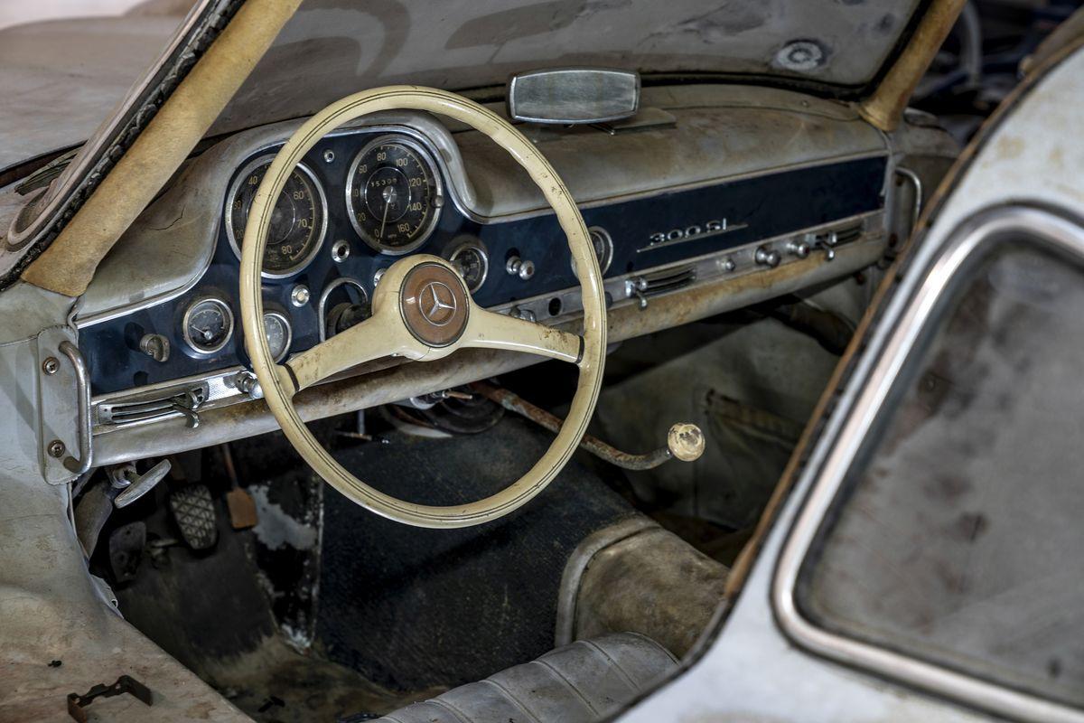

Pierre Rivard Posted September 21, 2023 Posted September 21, 2023 This should be fun and challenging with all the weathering involved. Something curious about this car. I've never seen this style of shifter arm (long, curvy) on a SL before.
Mittagskind Posted September 21, 2023 Author Posted September 21, 2023 1 hour ago, Pierre Rivard said: ... I've never seen this style of shifter arm (long, curvy) on a SL before. You are right. Maybe an early version. Look here.

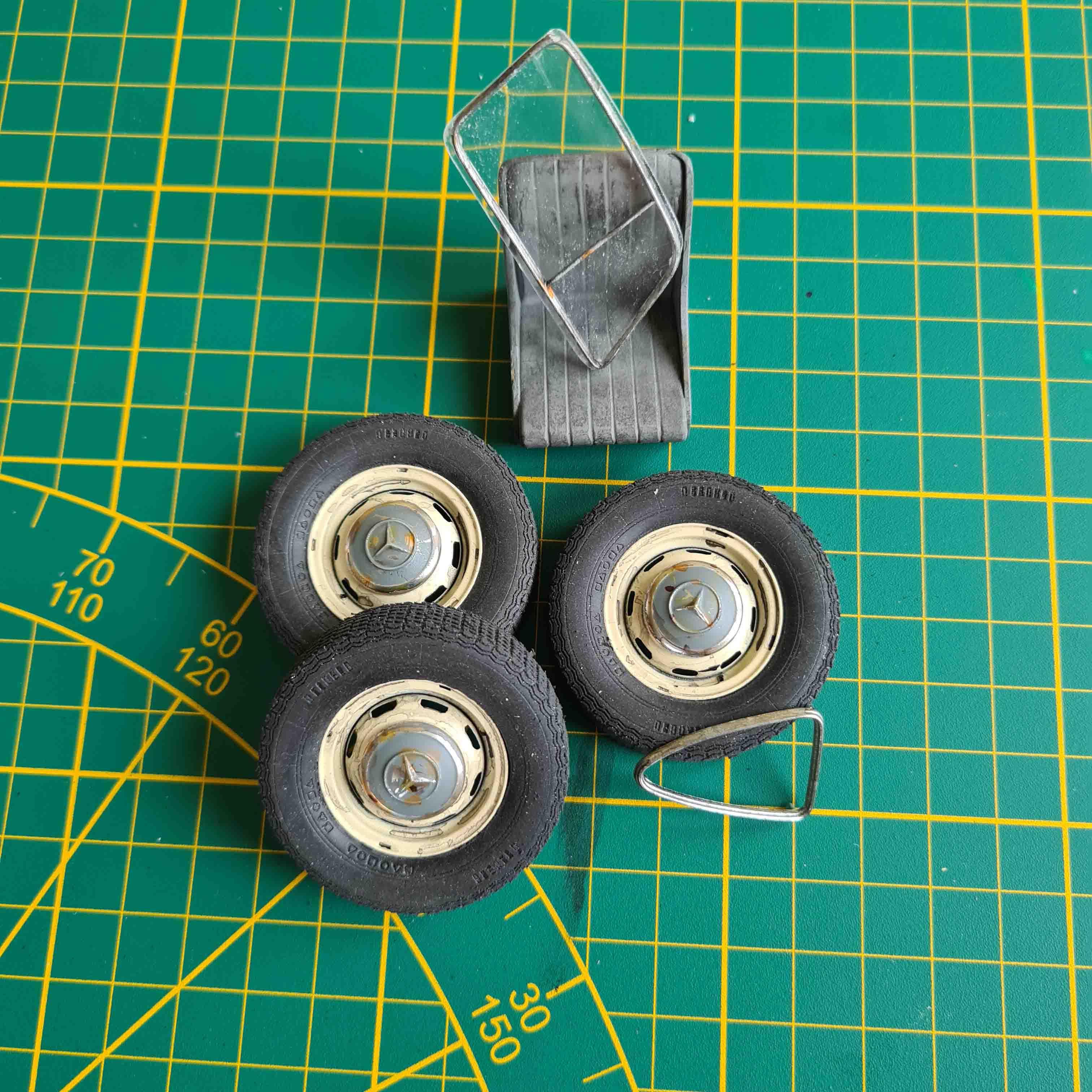

Mittagskind Posted September 22, 2023 Author Posted September 22, 2023 A few first sample parts. This is how it could work. 2
dino246gt Posted September 22, 2023 Posted September 22, 2023 WOW! It already looks fantastic, well at least those parts do! Great weathering skills!

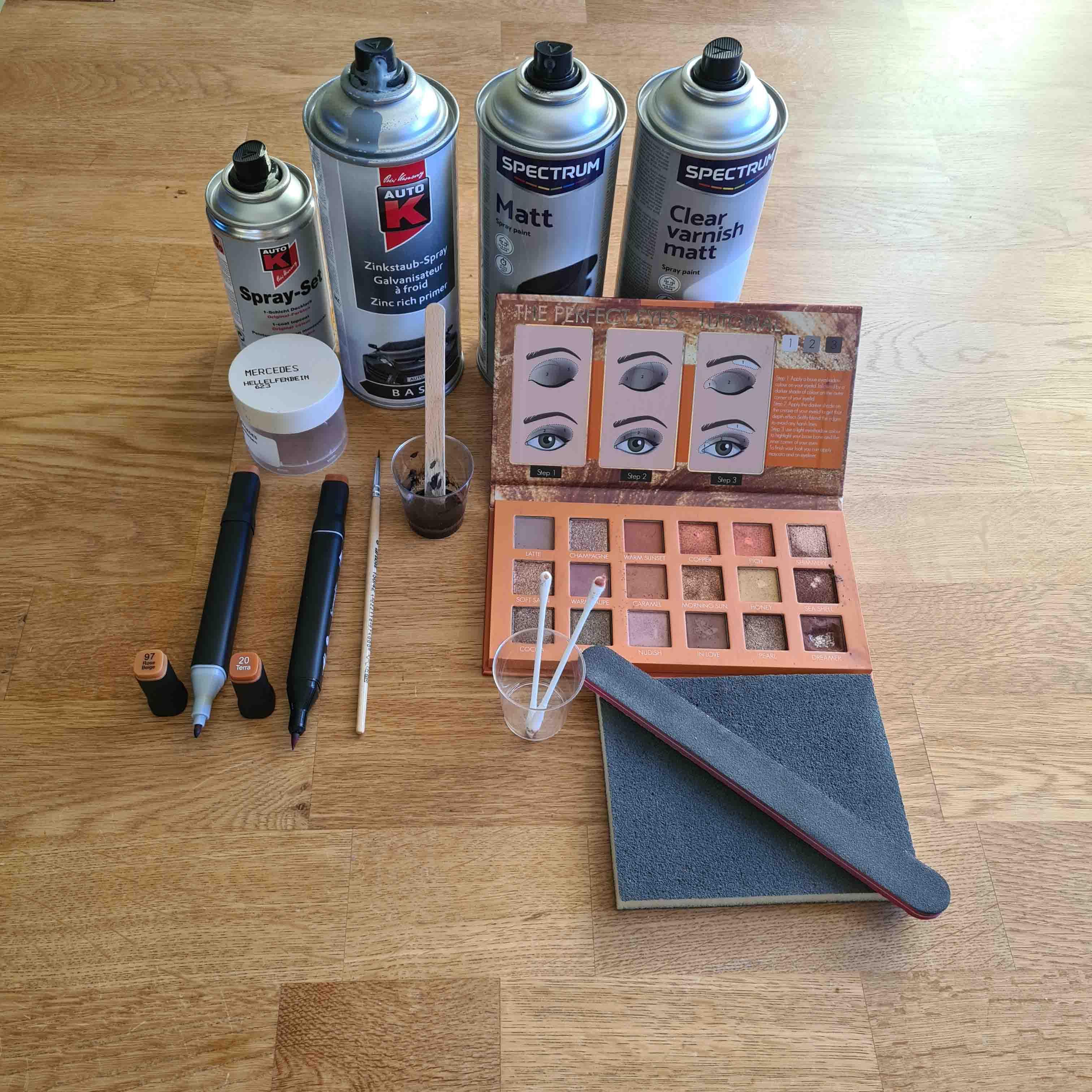

Mittagskind Posted September 23, 2023 Author Posted September 23, 2023 9 hours ago, Pierre Rivard said: Hanjo, the weathering you have done on these first few parts is absolutely gorgeous. Please share how you have done this. Please please please? Oh thank you Pierre, but my weathering skills are not so high yet. I always try to use simple and inexpensive tools and materials. On the following photo you can see these. Here my working steps: Tires: Only sanding/rubbing Rims: 1. Primer 2. Color spray 3. Black washing/ rusty coloring 4. Clear coat flat Rim caps: 1. Clear coat flat 2. Primer or zinc powder spray 3. Sanding/rubbing to make chrome parts visible again 4. Rusty coloring 5. Clear coat flat Seats: 1. Primer 2. Color spray black flat 3. Primer or zinc powder 4. Rubbing/sanding to make black areas visible 5. Black washing Window frames: 1. Clear coat flat 2. Black washing/rusty coloring 3. very very slightly spray burst primer or zinc powder 4. Clear coat flat That´s all?

sjordan2 Posted September 25, 2023 Posted September 25, 2023 On 9/21/2023 at 11:11 AM, Mittagskind said: You are right. Maybe an early version. Look here. The curved "gooseneck" shift lever was used only on the first 50 examples of the Gullwing. 1
sjordan2 Posted September 25, 2023 Posted September 25, 2023 I'm a bit confused by the photo. The dashboard looks like it came from a 300SLR or prototype. Not used in production cars.

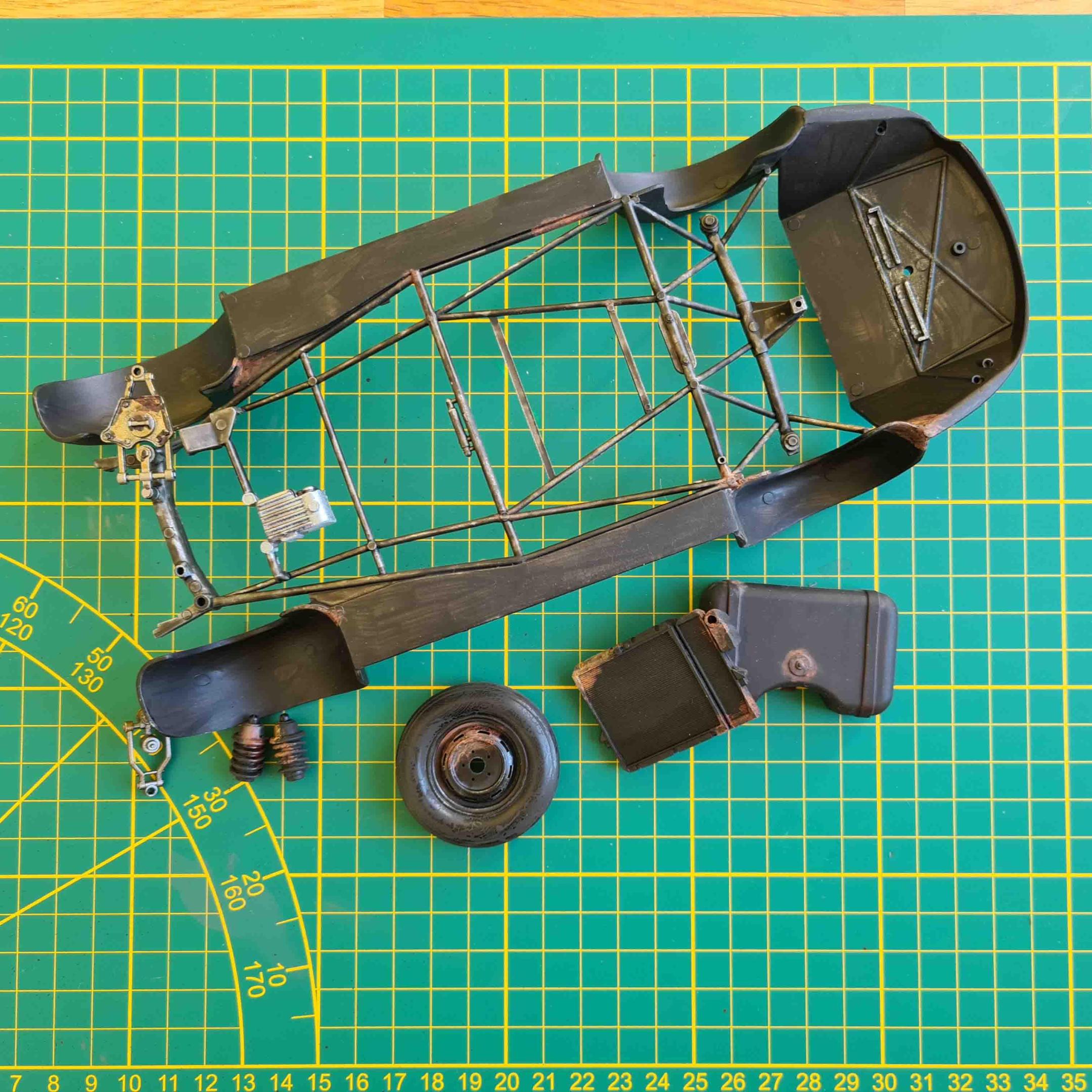

Mittagskind Posted September 26, 2023 Author Posted September 26, 2023 More parts completed. Feels like a restoration going backwards. 1

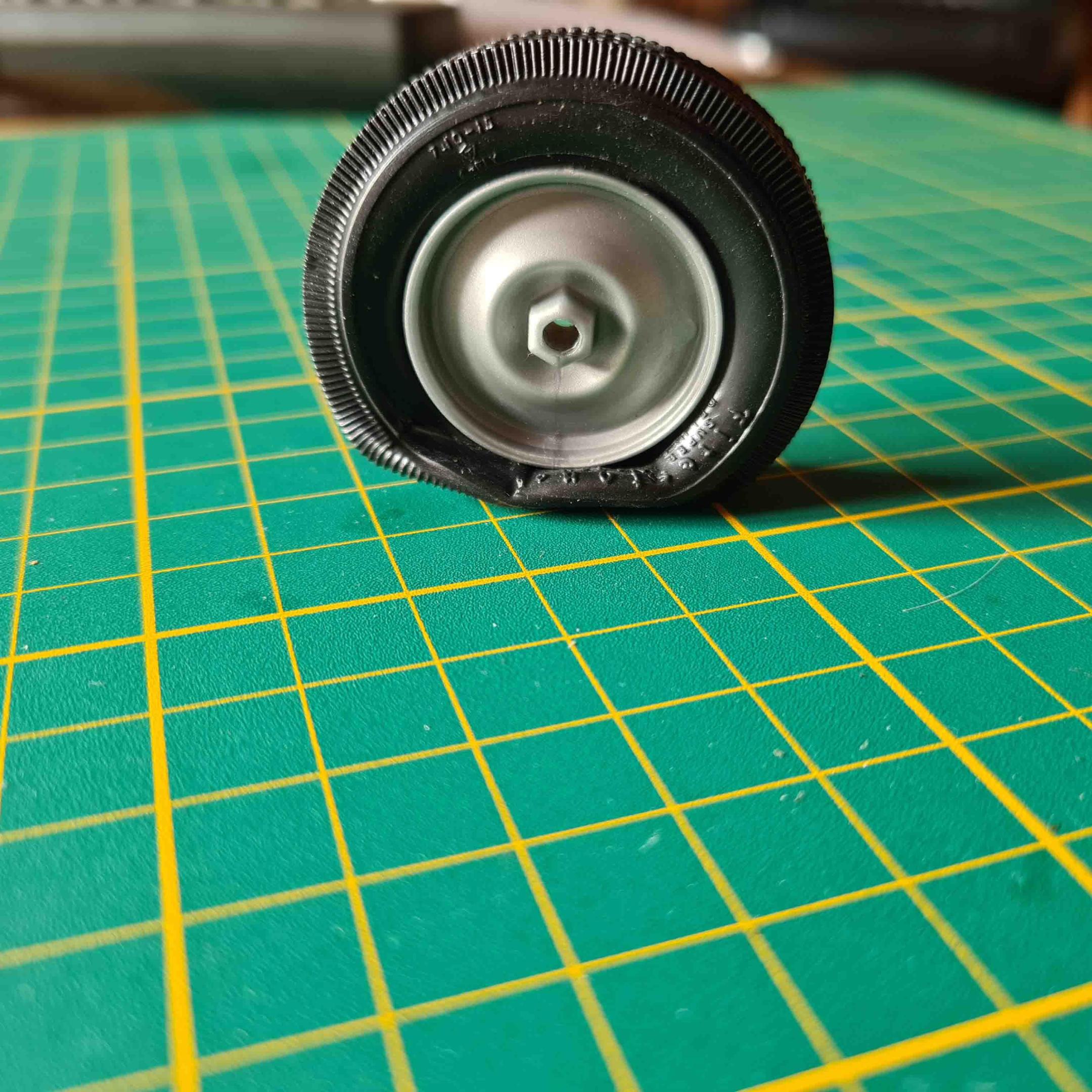

Mittagskind Posted September 27, 2023 Author Posted September 27, 2023 On 9/22/2023 at 9:42 PM, peteski said: If you have an old electric iron (the one you iron clothes with), and if you don't mind getting some melted plastic on it (or just buy a cheap one), then you should be heat it up then push the tire against it to soften, then distort it. You have to adjust the temperature to just before melting the vinyl. Just hot enough to soften it enough to be able to squish the tire. At least that is something I would try. But this will only work with vinyl tires if the tires in this kit are made from real rubber, that will not work. Rubber does not soften or melt like vinyl On 9/26/2023 at 4:46 PM, dino246gt said: I think if you slice the tread out of the tire, just a small part, then you can fold the remaining sides and fill with something to keep them looking like a deflated tire might be the way to go. Of course try it on spare tires from other cheap kits first to get the right look. I can't believe how cool this project is! I love it!! I found a way. I compressed this tire with a pliers and held it in boiling water for a few minutes. After cooling the rubber remains deformed. 2
