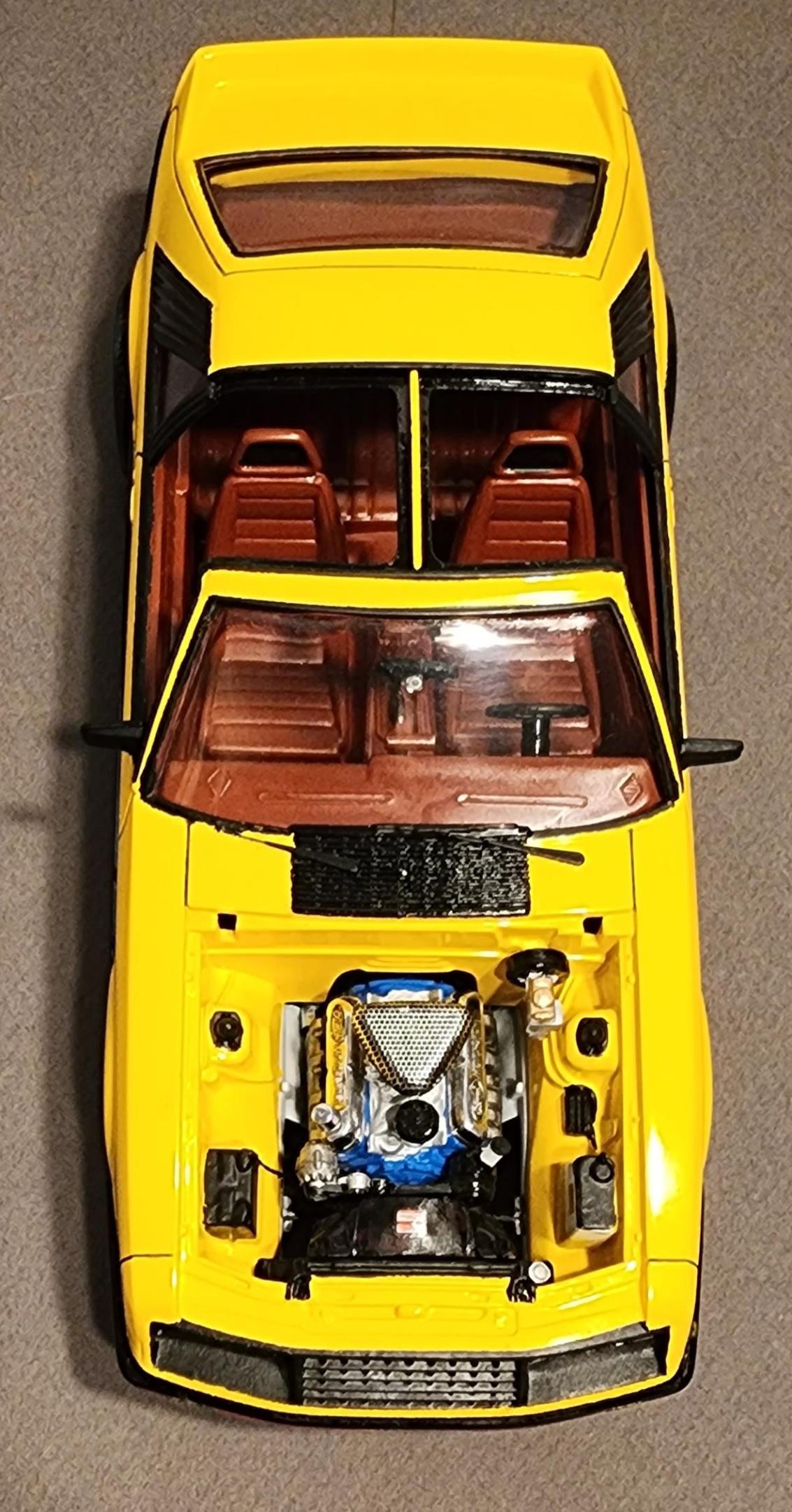

Fat Brian Posted October 1, 2023 Posted October 1, 2023 For painting on the body I use water based Tamiya paint so I can clean it quickly with a damp q-tip. For painting on the clear parts I mask the straightest sections one or two at a time and use Mr Color flat black. It cleans up with alcohol so it won't hurt the clear parts. Once I've masked as much as I reasonably can I free hand the rest. The trim on this car was an absolute nightmare buy it turned out better than I expected. 2

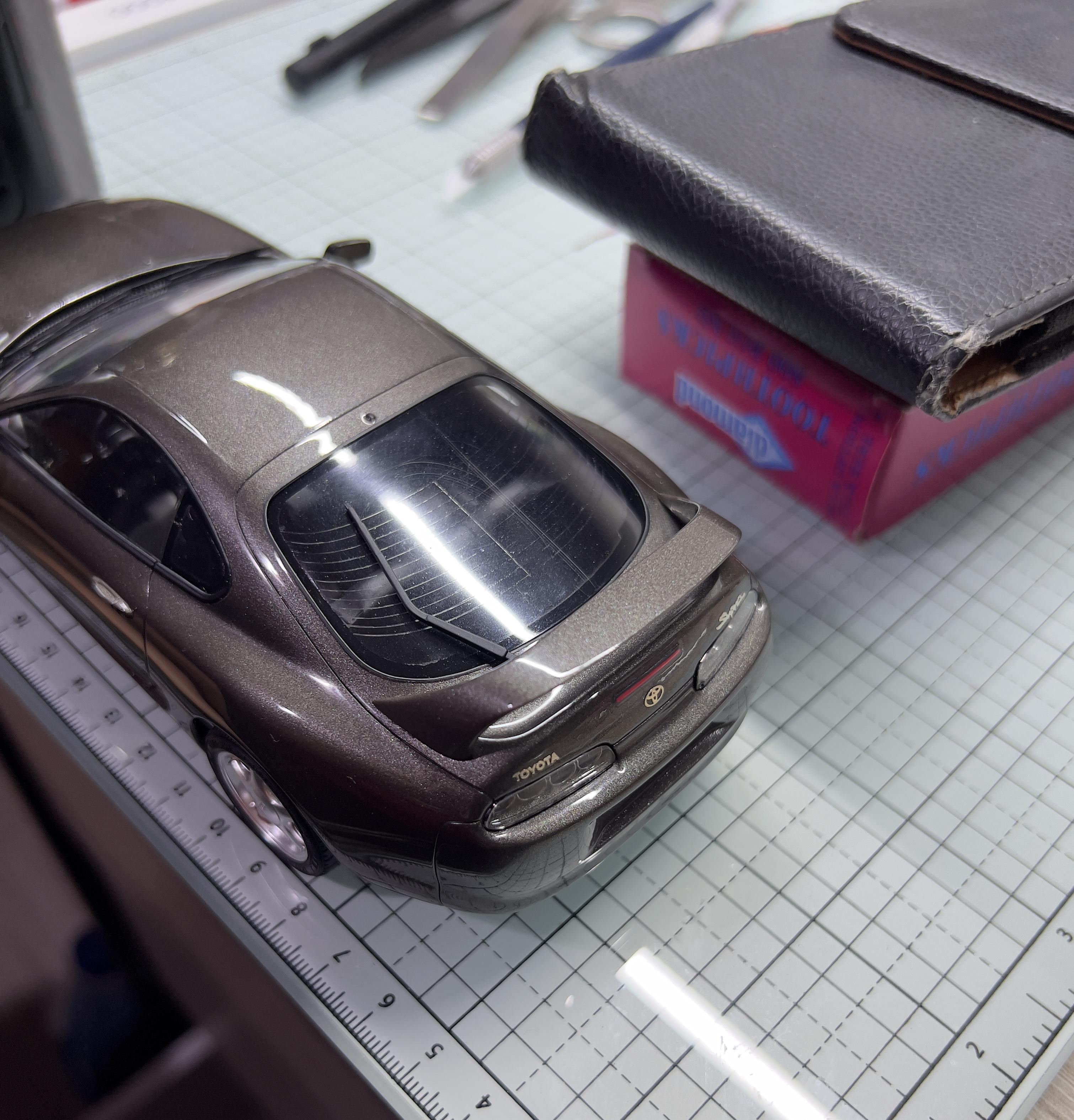

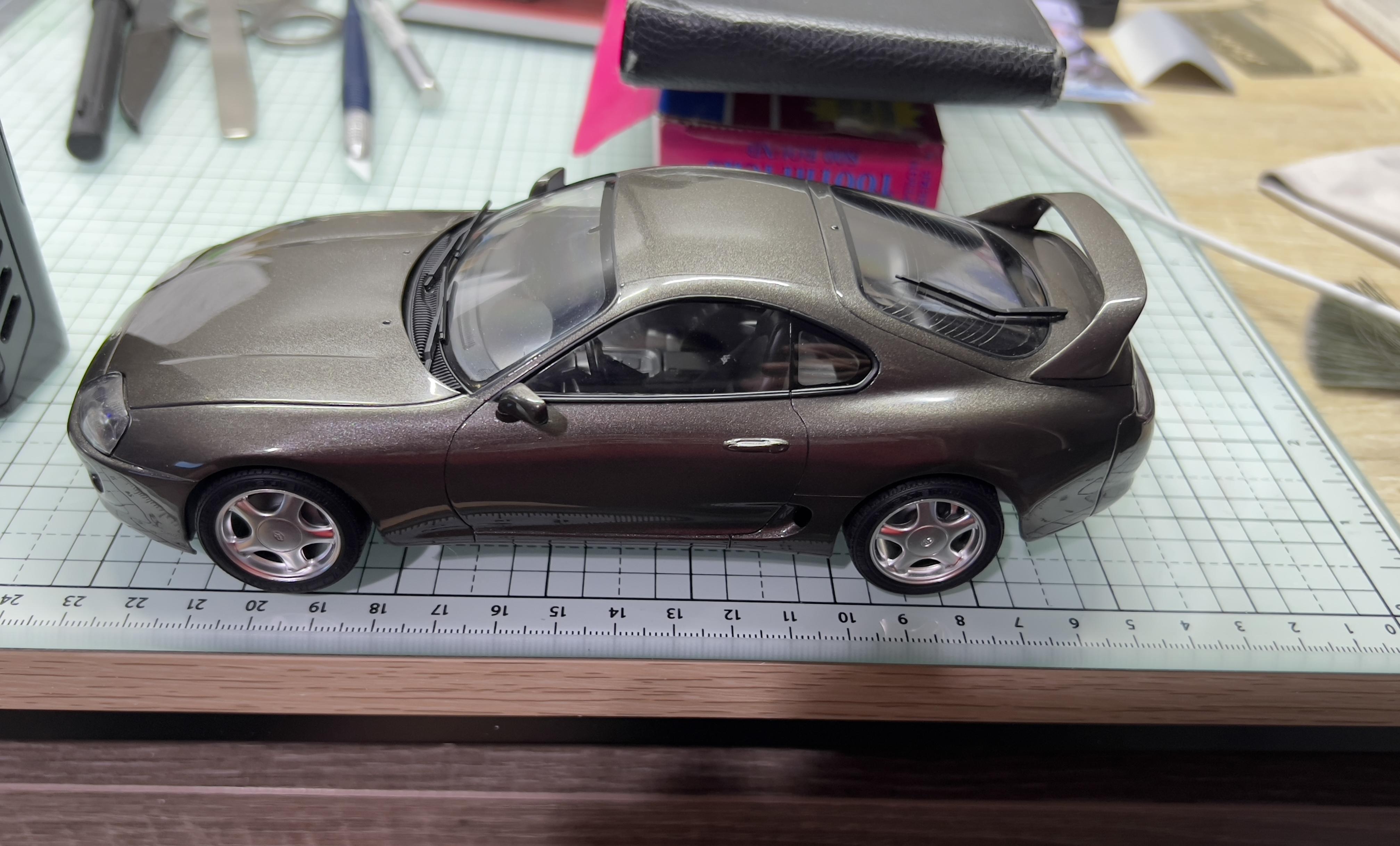

Dpate Posted October 1, 2023 Posted October 1, 2023 (edited) 3 hours ago, Roy L Frost III said: thanks for all your replies, I am sure i have done everything most of the time it's just fine. Imean if I couldn't pull it off most of the time I would not build sport cars, just looking for other ideas. The black bmf is garbage. I have used carbon fiber decals on some but that is time consuming and hard to pull off Your best best for a clean finish is masking, and using Tamiya LP-65 or LP-5. That’ll get you cleanest look and finish. Sharpies etc will work, but doesn’t look good imo. Even did the rear window the same mask, and airbrush. Edited October 1, 2023 by Dpate 1
Roy L Frost III Posted October 1, 2023 Author Posted October 1, 2023 looks real good, it's a different thing painting the inside glass frame and the masks are great. Do you really mask the outside frame like on the drivers side , as on your model in the photo then spray or brush. The inside glass I got it's the outside frame that troubles me. I have been building for a long time and like most of us have won contests but I am also my biggest critic as I'am sure we all are thanks for your help
Dpate Posted October 1, 2023 Posted October 1, 2023 (edited) 31 minutes ago, Roy L Frost III said: looks real good, it's a different thing painting the inside glass frame and the masks are great. Do you really mask the outside frame like on the drivers side , as on your model in the photo then spray or brush. The inside glass I got it's the outside frame that troubles me. I have been building for a long time and like most of us have won contests but I am also my biggest critic as I'am sure we all are thanks for your help Yeah it’s not difficult to mask especially if the panel line is good. There’s good videos on YouTube showing how it’s done. It’s no different than laying BMF imo. You’re just masking, and cutting along the panel line around the door. The rear on the Toyota Supra was a tad harder as the panel line around the window wasn’t the best, but I managed to do it. I also use an airbrush to do it not a paintbrush. The key is building up the coats, and not wet coats same as using an automotive paint . Edited October 1, 2023 by Dpate 1
