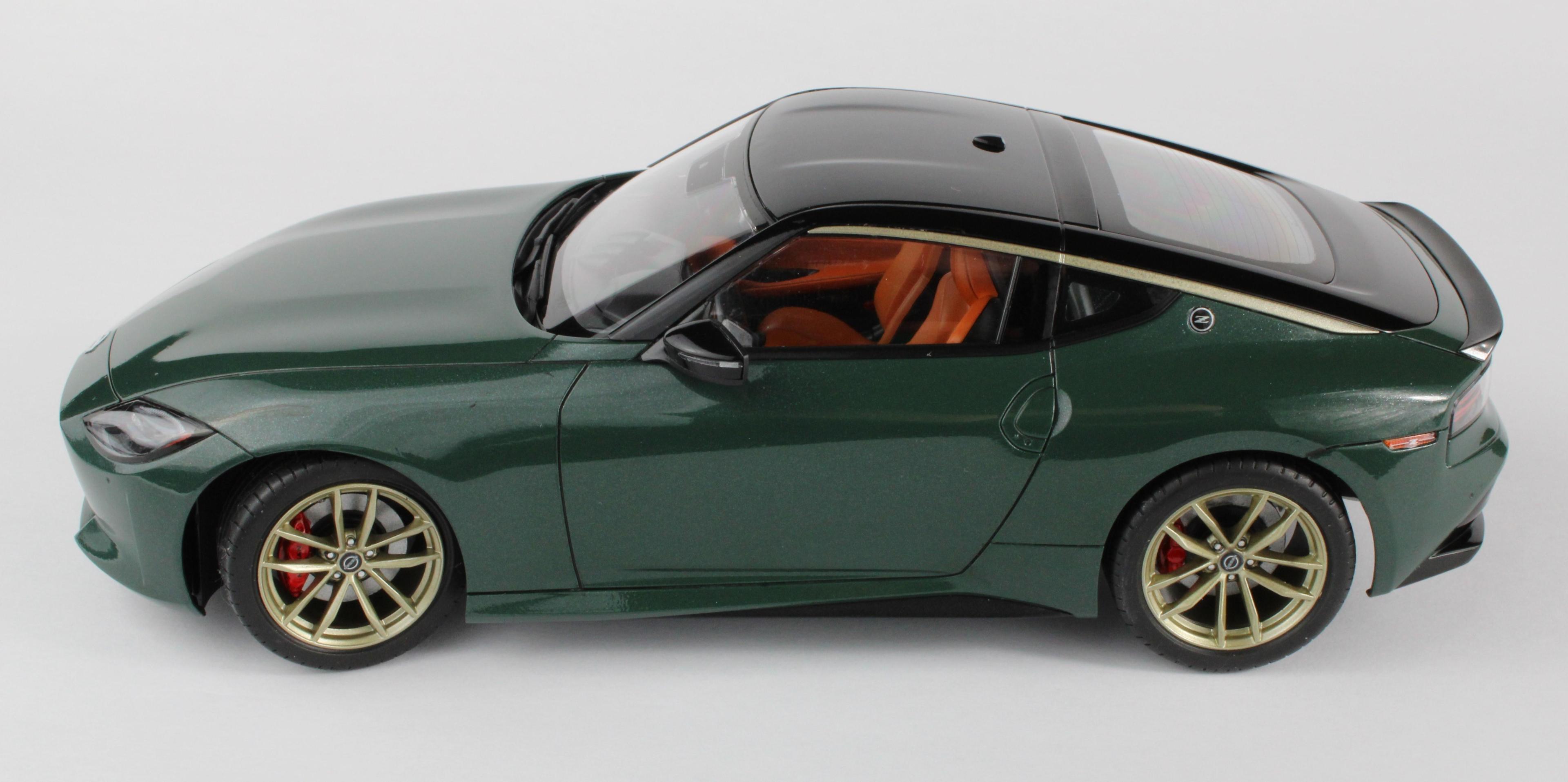

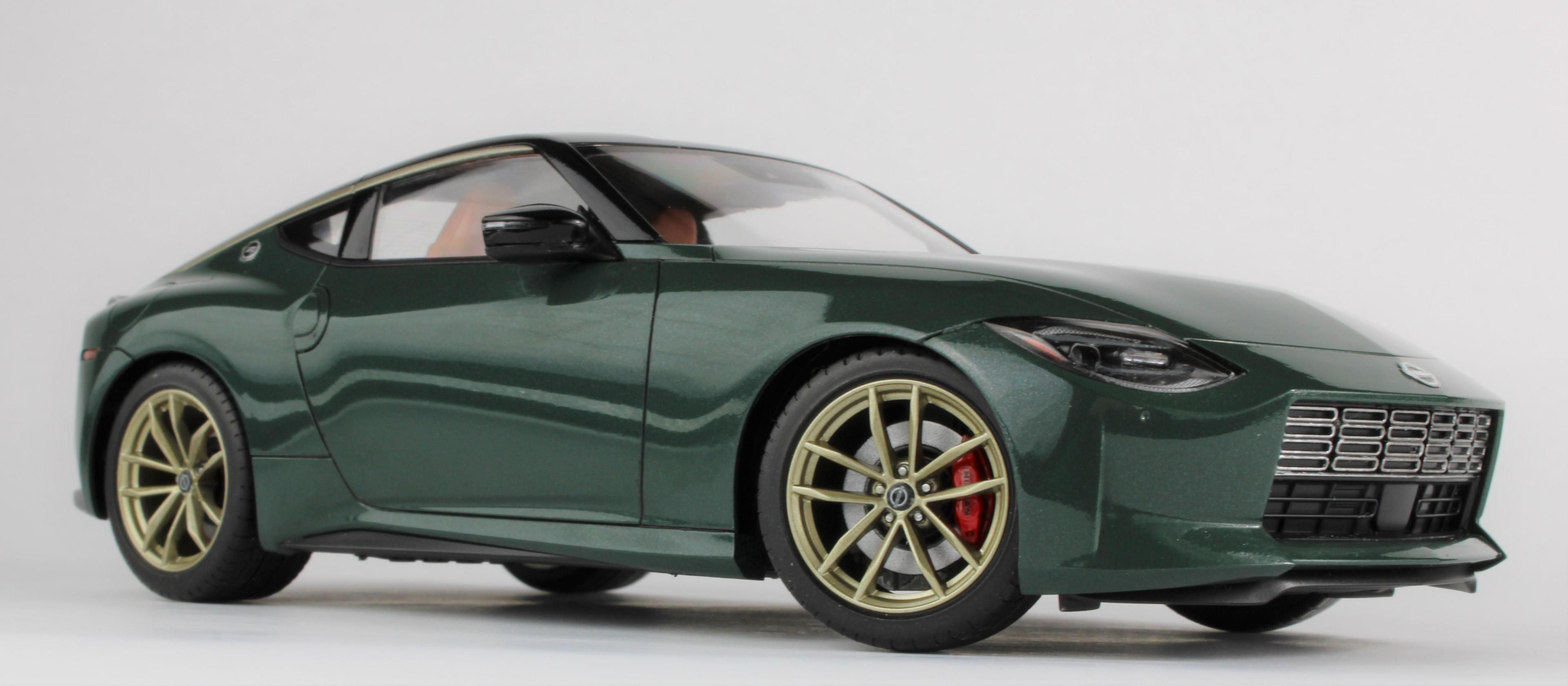

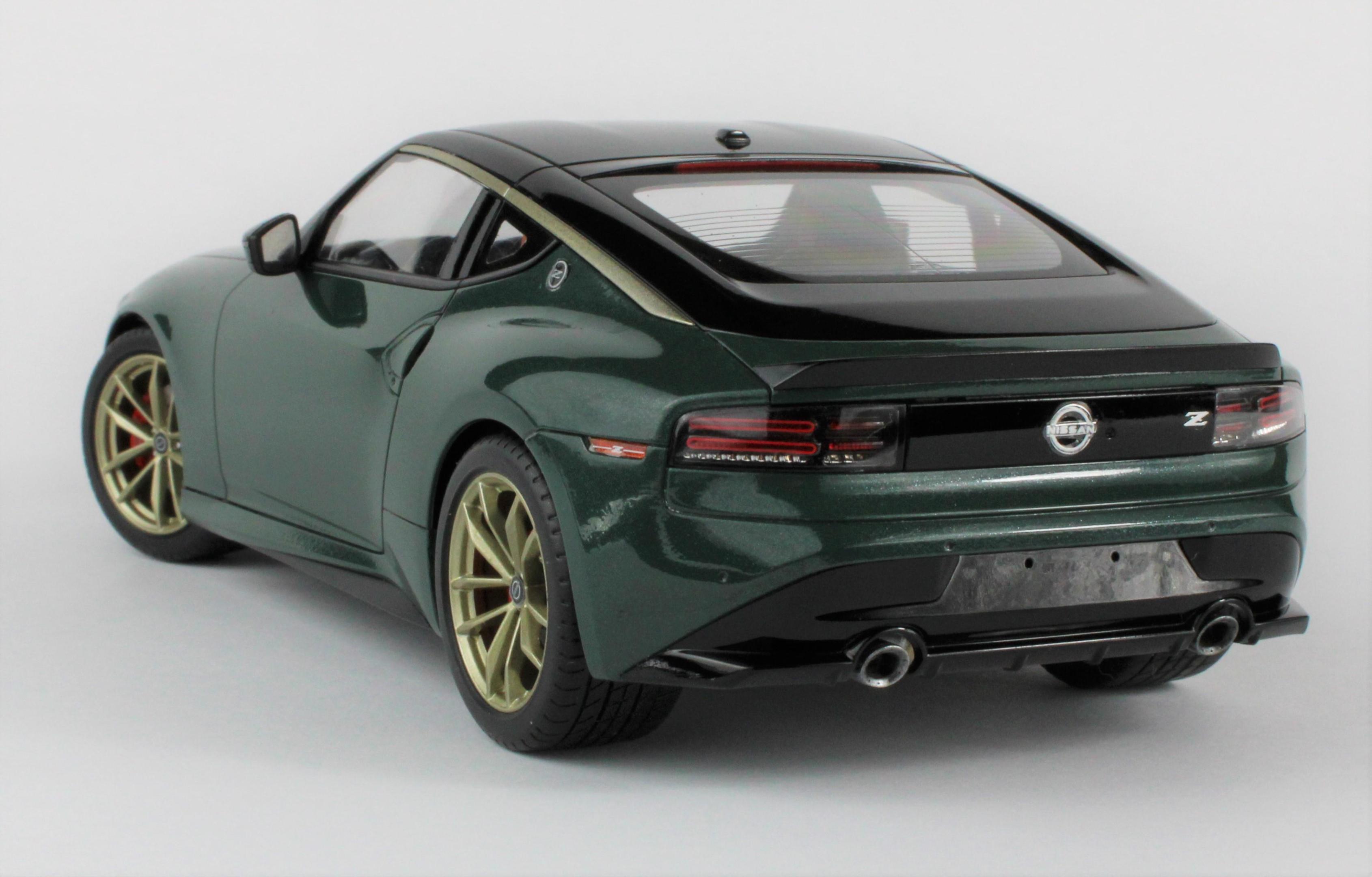

jaymcminn Posted October 1, 2023 Posted October 1, 2023 I wanted to experiment on the new Tamiya Nissan Z, so I tried using the pearl clear over one of their military colors, in this case IJN Green. I found that 2 coats of the pearl is the maximum you can get away with before it starts interfering with the base color. Additionally the pearl clear is more of an intermediate coat that still needs a top coat to come up properly glossy. Overall it wound up looking really good... 6
