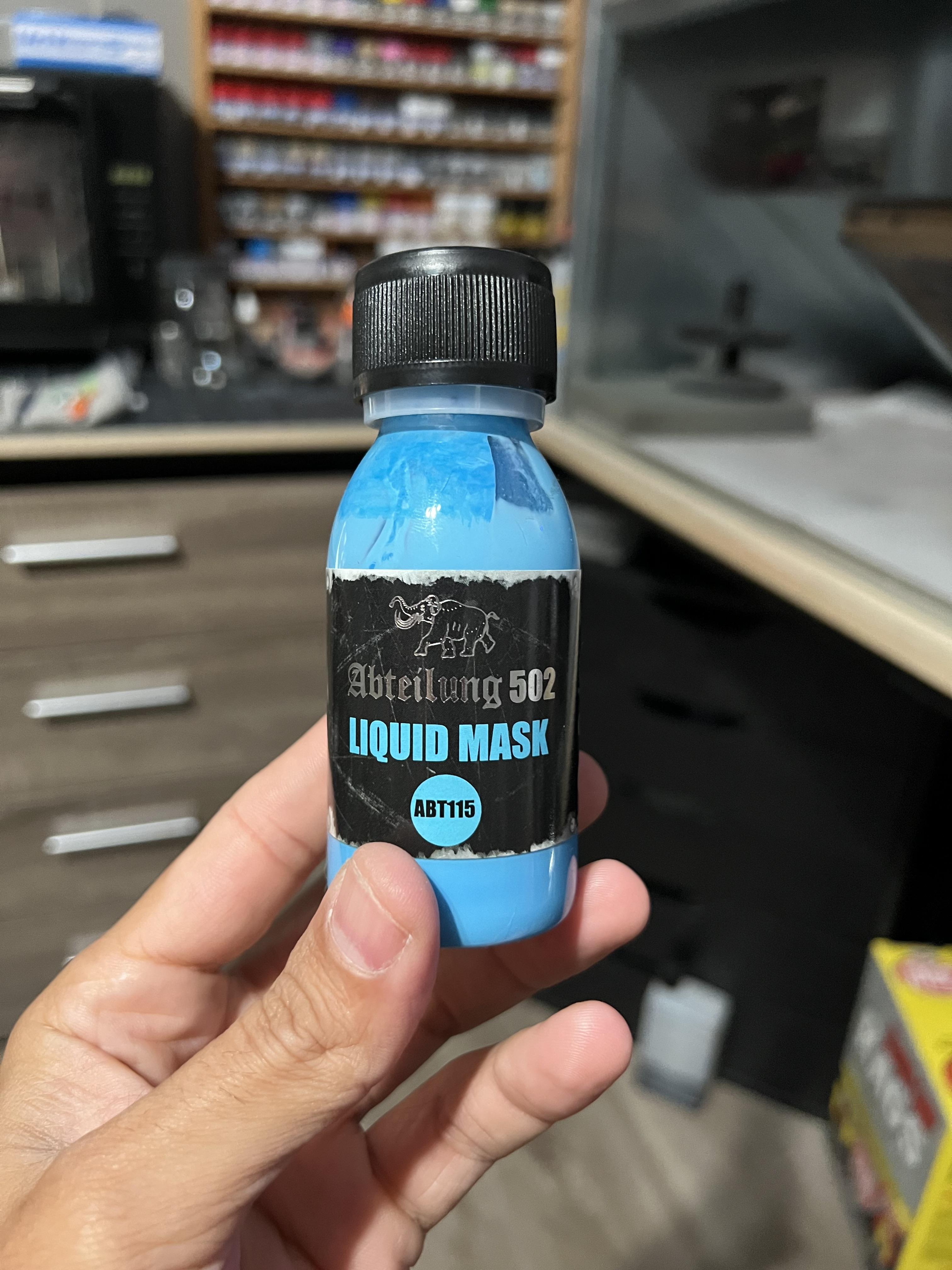

dragstk Posted October 5, 2023 Posted October 5, 2023 Lately I have been using Vallejo liquid mask. Im pretty happy with it I tried the Abteilung. The first time I used it, it worked great. But when I went to use it the next time, the whole bottle had solidified into a gloopy mess. But maybe I just got an old bottle.
