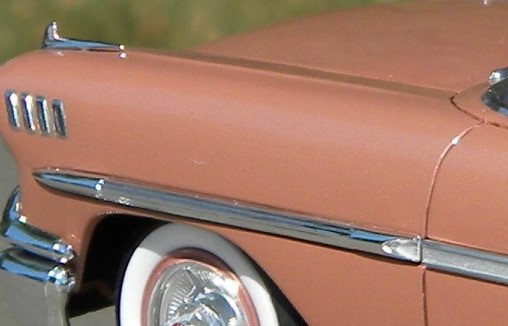

JET. Posted October 7, 2023 Posted October 7, 2023 (edited) I’ve discovered this paint recently and I think it’s quite a good in-scale silver metal flake base, Mr.color GX208 heres an example of it with a clear pink over, outside In the sun it sparkles just like the 1/1 stuff Edited October 7, 2023 by JET. 3 1
OldNYJim Posted October 7, 2023 Posted October 7, 2023 That looks great - you’re right, it’s a really nice in-scale flake. That candy pink is a nice shade too - didn’t realize they had a line of candies too! 1
Street Rod Posted October 7, 2023 Posted October 7, 2023 Thanks for sharing this. That silver will be perfect for some projects I have in mind. 1
JET. Posted October 7, 2023 Author Posted October 7, 2023 Here’s a quick video in the sun, should be even better once I sand and polish it My Movie 23.mov 1

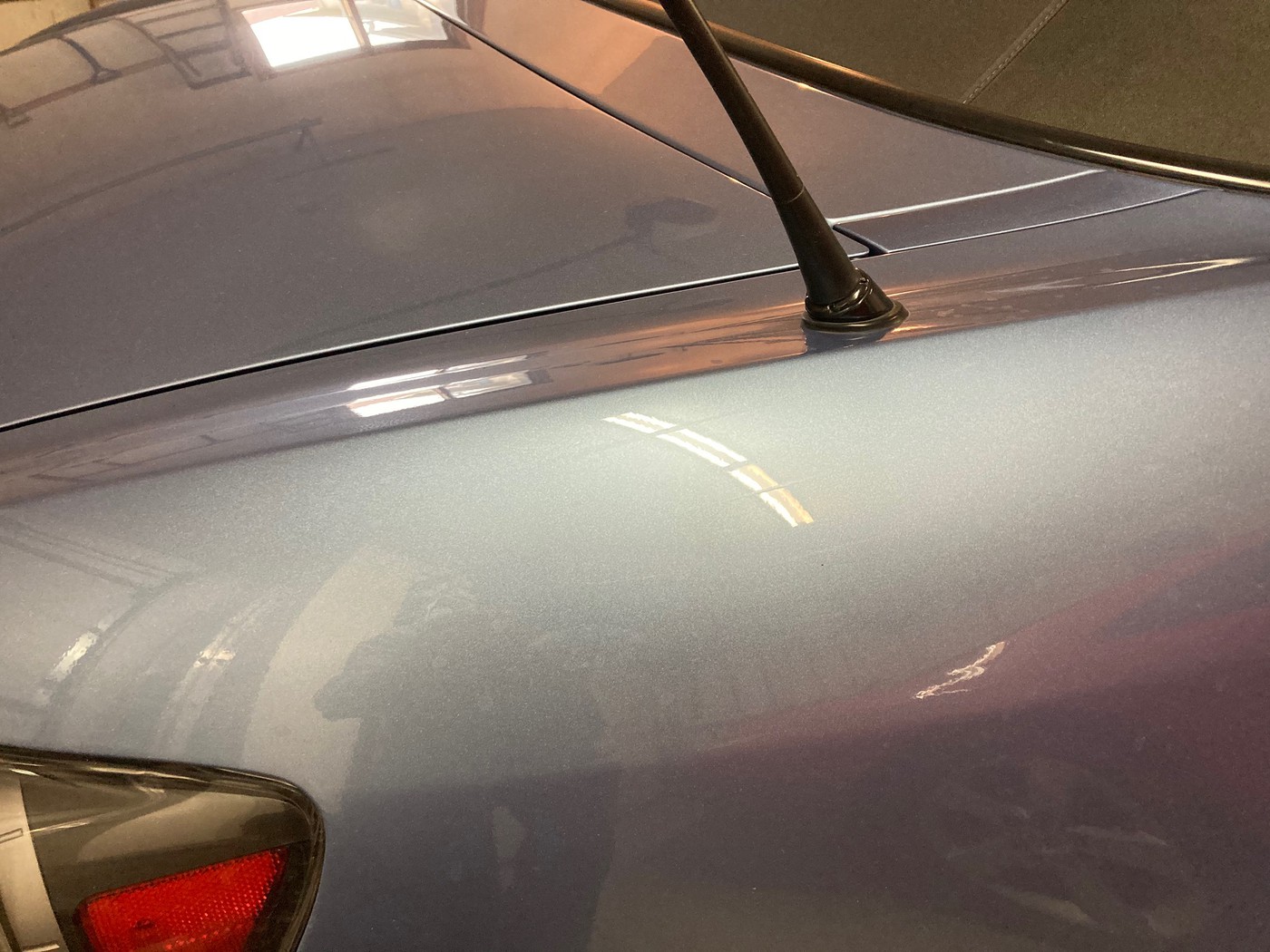

StevenGuthmiller Posted October 14, 2023 Posted October 14, 2023 I suppose it all boils down to what you're looking for. If it's an "as close to scale as possible" affect that you're after, it's really hard to beat MCW paints. Hobbyists have been in pursuit of in scale looking metallic paints for many many years, and they're still not always easy to find. If you're looking for a heavily metallicized paint, much like what is depicted by the OP above, it's really not that hard. If you want something as close as possible to a truly in scale metallic paint, it's much more difficult. As with a 1:1 vehicle, unless it's some sort of custom with what is often referred to as "bass boat" metallic paint, you should not be able to pick out individual metallic particles in the paint even fairly close up. If you walk out to your garage, and view your 1:1 vehicle, see how close you have to get before you can make out the particles in the metallic paint. I estimated that depending on the paint, you don't begin to see these particles individually until you're at least as close as possibly 2 feet from the surface. That translates into your eyeball being less than an inch away from the models surface at 1/25th scale before the particles become apparent. I know, that makes correctly sized metallics a near impossibility in scale, but some of the paint producers do as well as can be expected. One of these is MCW. Not every color is spot on. Some appear to have more, and heavier metallic than others, but I like to use this example of how a 1/25th scale metallic paint "should" look whenever this subject comes up. Believe it or not, this 1958 Chevy Impala is painted in #932 "Cay Coral Poly" by MCW. It is a metallic paint, but it's nearly impossible to pick out the individual particles, no matter how close. But it still has that nice metallic sheen that would be evident when viewing a vehicle painted with metallic paint in 1/25th scale, if the paint were truly "in scale". Steve 2
