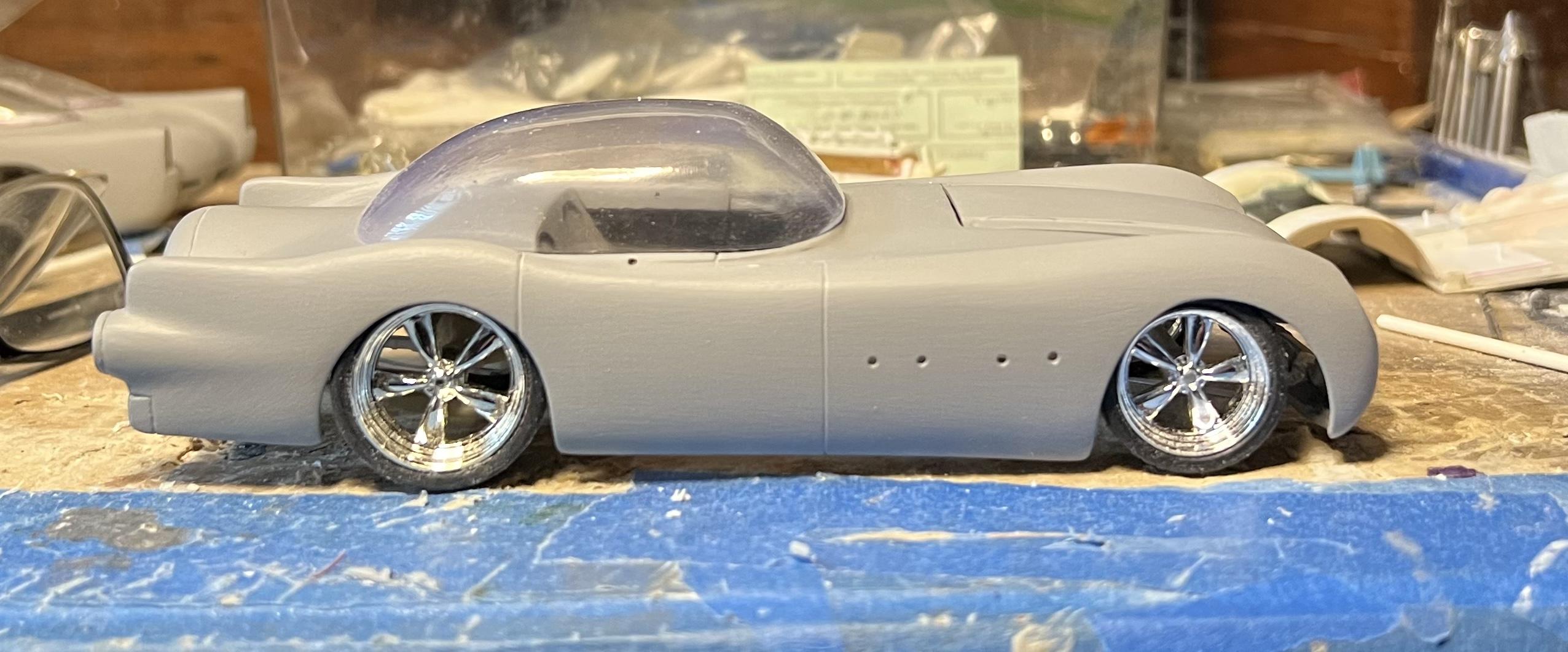

customsrus Posted October 10, 2023 Author Posted October 10, 2023 Any casters local to KCK wanting to produce this. 1954 Pontiac bonneville special. I do have a buck for the canopy. 1
Ace-Garageguy Posted October 10, 2023 Posted October 10, 2023 7 hours ago, customsrus said: Any casters local to KCK wanting to produce this. 1954 Pontiac bonneville special. I do have a buck for the canopy. If you get it done, I want one. If I was finished moving, I'd offer to do molds and casts and vac-forms, as I've done lotsa silicone molds and polymer parts for product development and presentations over the years...but alas, I'm not set up at the moment (though I have vac pumps, pressure pots, etc.). Good luck with that one. I'd like to see more showcars available in resin.

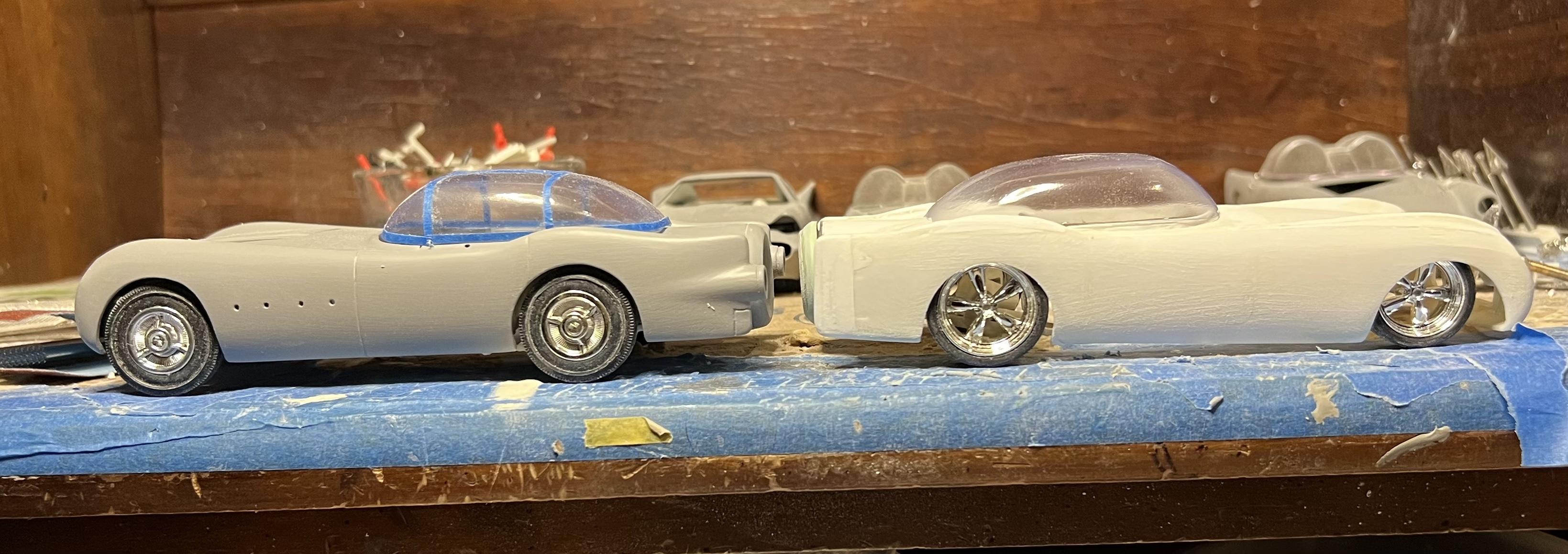

customsrus Posted October 14, 2023 Author Posted October 14, 2023 Hey Ace here’s the reason I decided I needed another one. I want to make one stock and one a little different. Lol 1

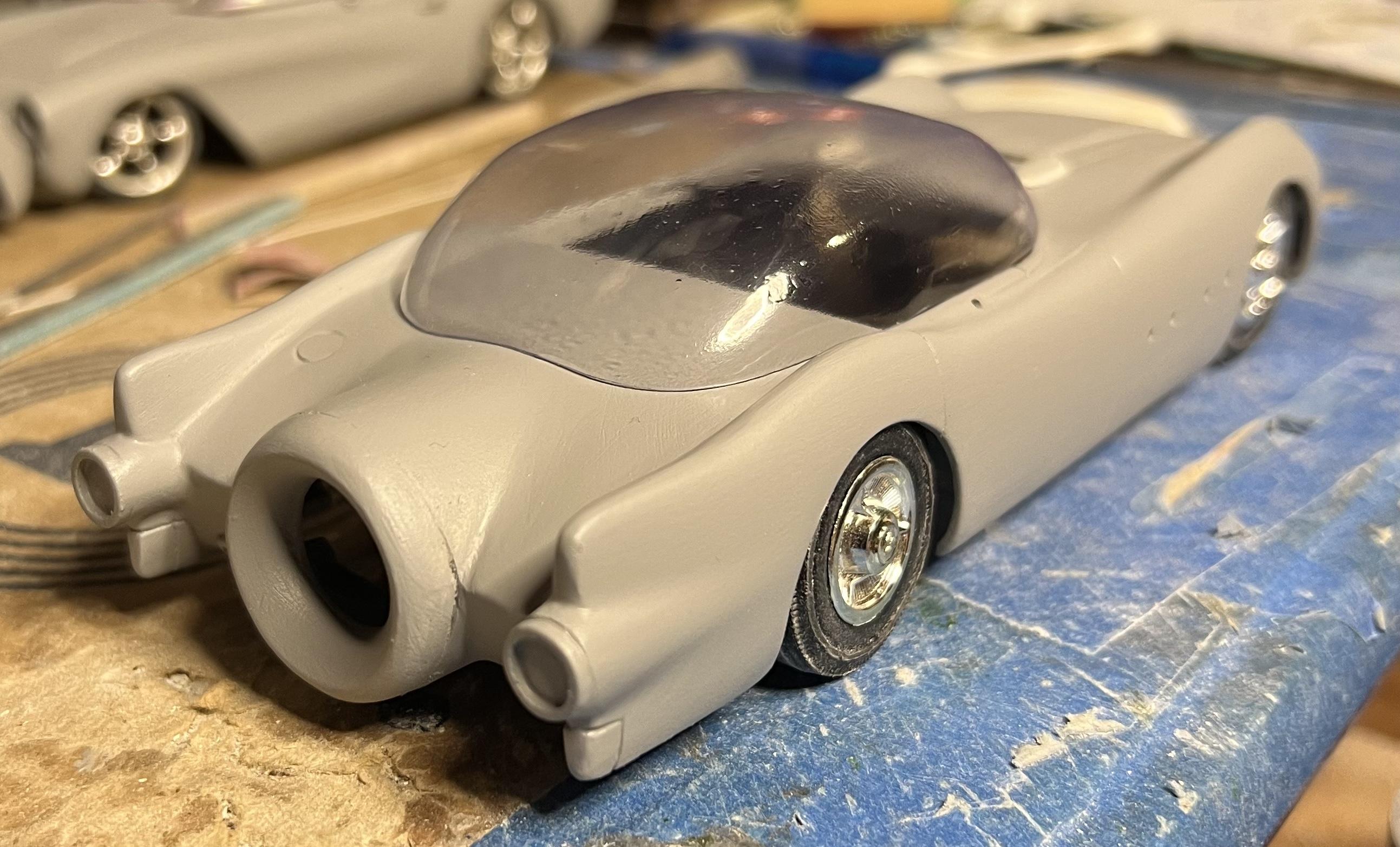

customsrus Posted October 14, 2023 Author Posted October 14, 2023 Since I had no takers on replicating this I decided to build another one. Still need to do more work to it but I’m getting there. I will try my luck at casting this in the future. 1
