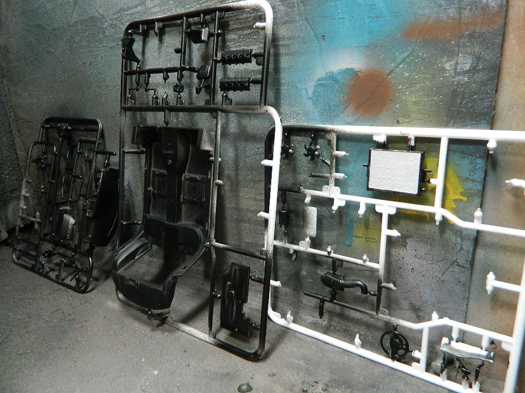

mrmike Posted October 13, 2023 Posted October 13, 2023 (edited) 2021 Dodge Charger R/T The Build Guilherme Rosa (my friend) gave me this kit last Sunday at the CPMC Expo and he suggested maybe to add my McNally character to it. What a great idea! I have changed my mind about the color though. I am using Tamiya TS-54 Light Metallic Blue instead of the Tamiya TS-89 Pearl Blue. No one is related to anybody living or deceased. The Story With the road chase ended, McNally has the time to sit and reflect upon his actions. A cop had wounded the last person who had tried to kill the Boston, PI and she was waiting to tell her story to Lt. Det. Adam Troy. What is true is that a contract has been issued on McNally and it has cost him his relationship with Attorney Charlotte Rothmann and now McNally is a man all alone in Boston. Edited October 13, 2023 by mrmike

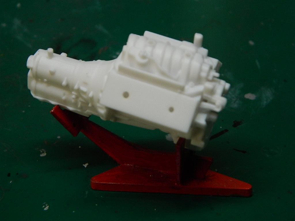

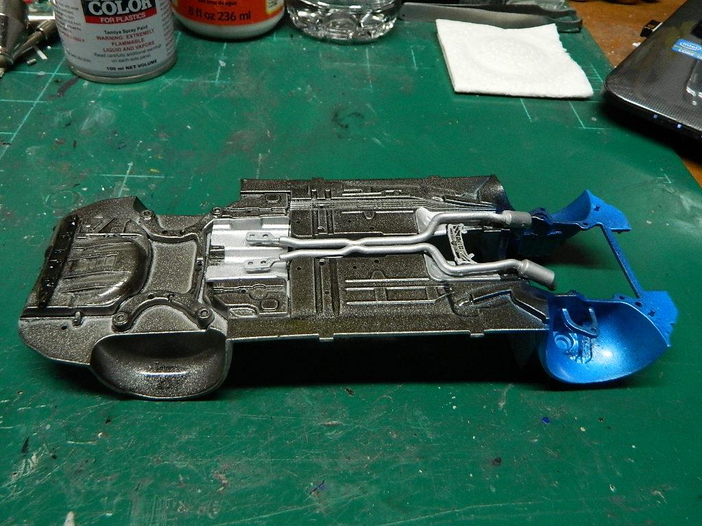

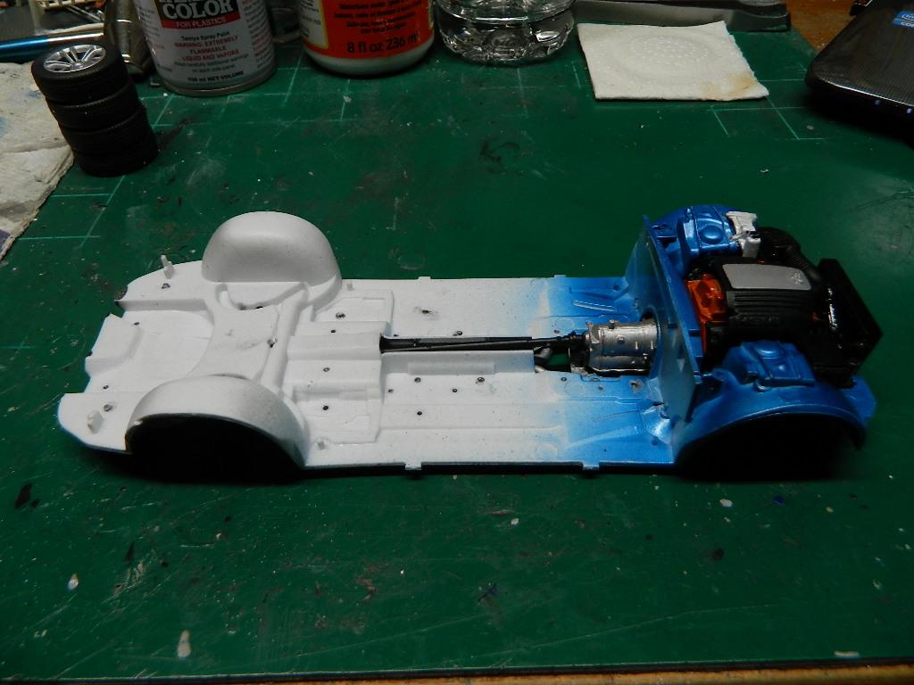

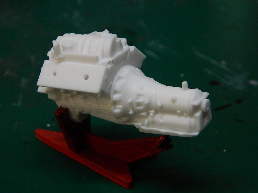

mrmike Posted October 13, 2023 Author Posted October 13, 2023 (edited) Thanks Dennis and David! David, I hope you can figure out your problem with the paint on your Charger! 2021 Dodge Charger R/T The Story The female cop was Casey Westerfield who has sold him her old 1996 Jeep Grand Cherokee LTD V8 and she has shot the man attempting to shoot him in the back. She had identified herself to McNally and they had chatted together for a few minutes. He even thanked her for saving his life to which she was extremely grateful. The Build The engine was assembled and already I am deviating from the instructions. The instructions calls for paint the engine an assortment of blacks and silvers, but I'm going to paint the engine block Street Hemi Orange. Edited October 22, 2023 by mrmike
espo Posted October 13, 2023 Posted October 13, 2023 Like the engine color idea, sort of a Hell Cat maybe?
mrmike Posted October 14, 2023 Author Posted October 14, 2023 I once saw a 3rd Gen Hemi in a new Charger and the Hemi Orange showed up in a small 1X1 inch corner of the engine. I feel that a Hemi is painted Orange no matter what generation it is. 1

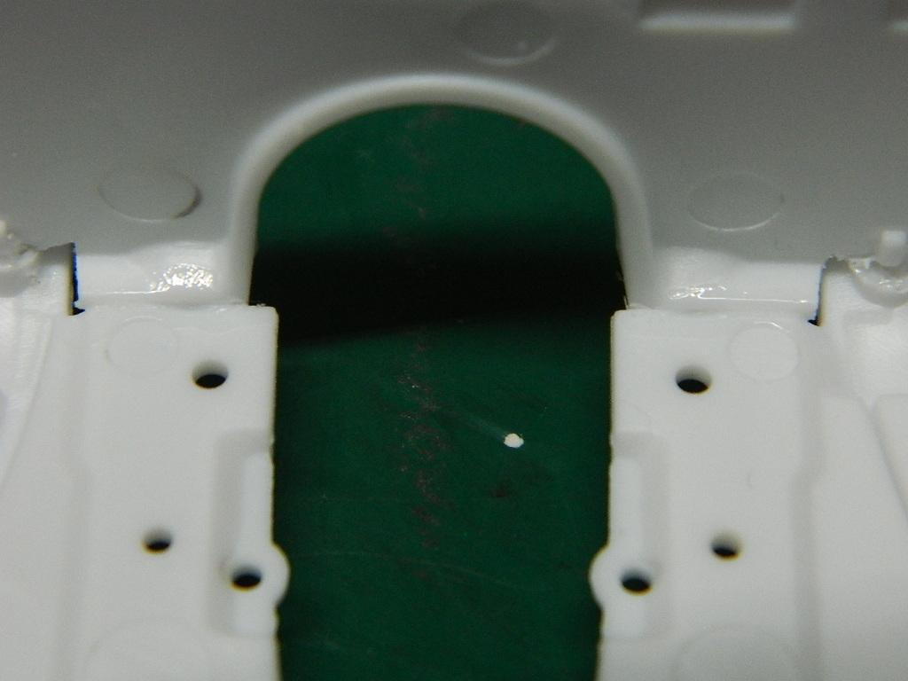

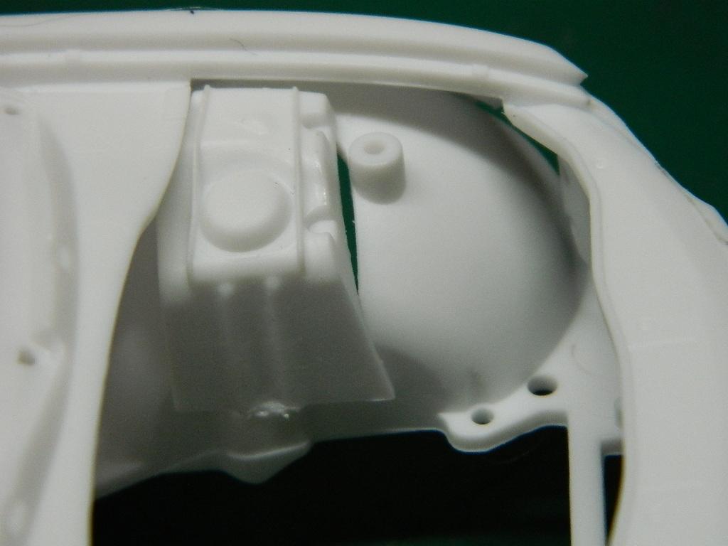

mrmike Posted October 20, 2023 Author Posted October 20, 2023 (edited) 2021 Dodge Charger R/T The Story McNally gets a ride to the Hospital to talk with the remaining suspect who is still alive. He enters the room and the cop guarding him steps out. He pulls his Smith & Wesson Model 4506 from his should holster and sticks the nose of the gun in the suspects should and causes him much pain. "Who sent you after me?" McNally again sticks the gun into the suspects should and the pain is unbearable and he repeats the question, "Who sent you after me?" "Dean MaComber and he works for Dean Anderson." McNally sticks his gun back in his shoulder holster and leaves the room and the cop walks back in to guard his prisoner. The Build Typical AMT! Fitment issues! The first picture is the strut cover on the left side with the body attached. Note the gap which I will have to fill. The second and third picture shows the firewall in place after I modified the firewall mounting points and lowered the firewall some. The unmodified firewall would stand as least the width of the plastic above the chassis. I wonder what else I will find? I thought AMT would have done away with these issues! Edited October 22, 2023 by mrmike

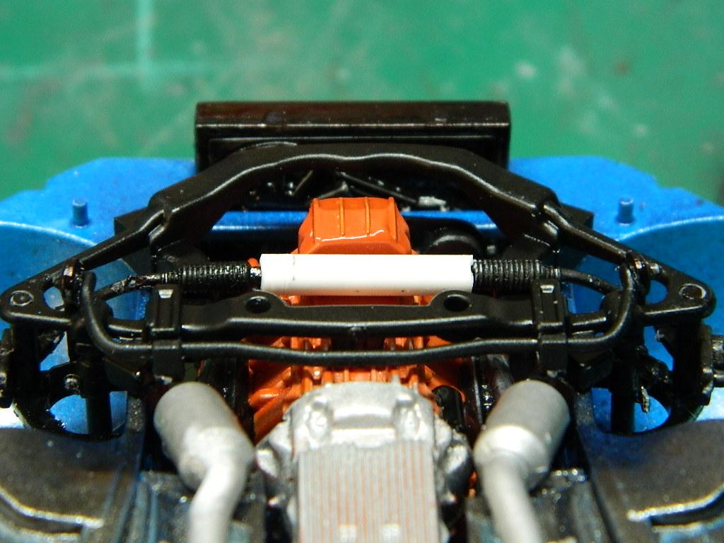

mrmike Posted November 12, 2023 Author Posted November 12, 2023 2021 Dodge Charger R/T The Story McNally decides that it would be best that he move out of his house and into his safe house which he keeps in Dorchester. He bought this old warehouse from the city dirt cheap and no one doesn't seem to know its whereabouts. He even installed a remote garage door opener so he could drive in and out at his leisure. The Build After adding the tie rod to the spindles, I noticed that the tie rod could have been a little longer by about 1/8 inch. I cut the tie rod in half and added a piece if styrene tube to lengthen the tie rod. I also notice that this is a 4-door and the interior side panels have a slot for a shoulder harness and I added one to each side of the interior. Maybe I'll try my hand at making the shoulder harness receiver for the other side of the front seats. 2

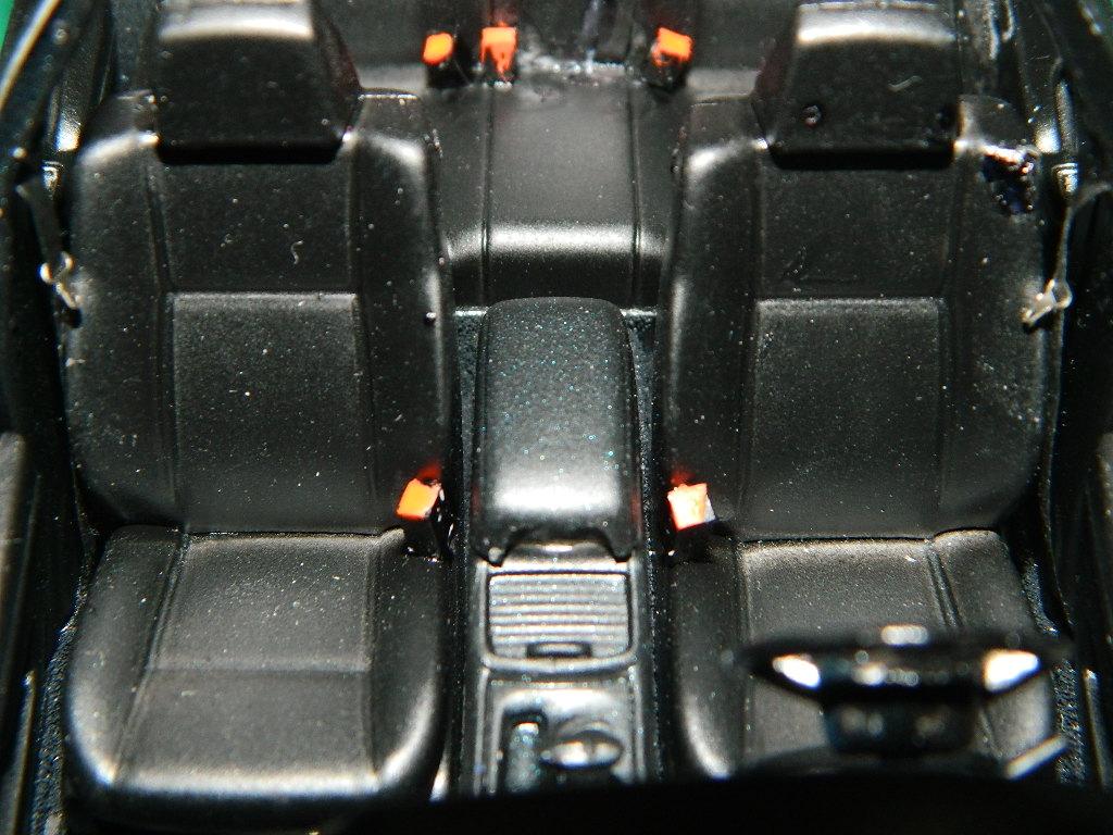

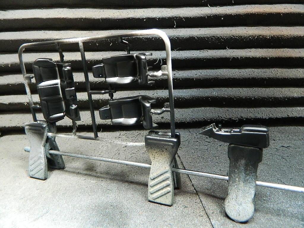

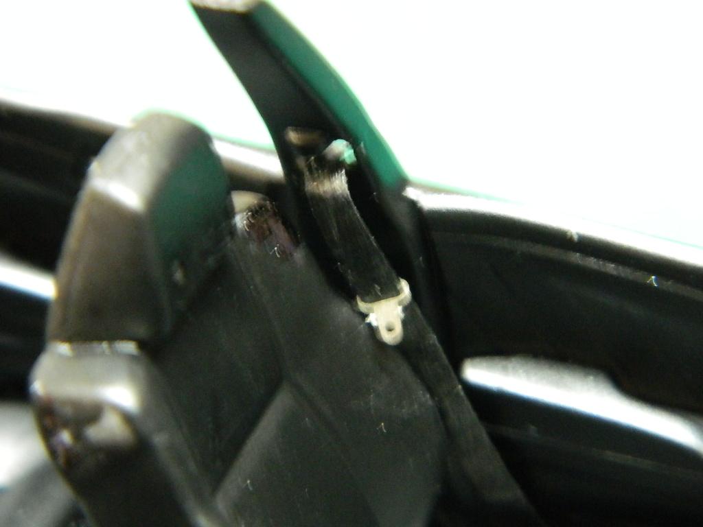

mrmike Posted November 22, 2023 Author Posted November 22, 2023 (edited) Thanks David! I was looking at pictures of a Charger interior and I decided to add the seat belts. Edited November 22, 2023 by mrmike
espo Posted November 22, 2023 Posted November 22, 2023 14 minutes ago, mrmike said: Thanks David! I was looking at pictures of a Charger interior and I decided to add the seat belts. With the black interior, which is sort of the only color out there, they do stand out. I own an '18 Charger GT with the black leather interior, of course. The interior appears the same as the kit, so if you need any detail pictures of the interior let me know.
mrmike Posted November 25, 2023 Author Posted November 25, 2023 Thanks David! At this point, the interior has been built and is completed. I do thank you for the offer of the interior pictures, but at this point, they are not needed.
