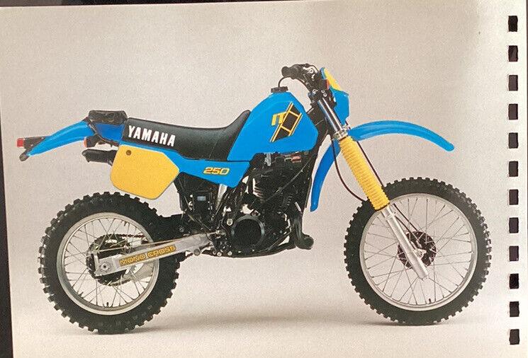

Mike C. Posted October 14, 2023 Posted October 14, 2023 I recently received a 1/6 Tamiya, Yamaha YZ 250 that I want to turn into a replica of an IT 175 that I used to have. The black fork boots appear to be real rubber. I want to paint them with bright yellow like the fork boots on my old IT. I have heard that lacquer tends to react adversely with rubber. Should I hit with common primer and then the yellow, or skip the primer altogether?
