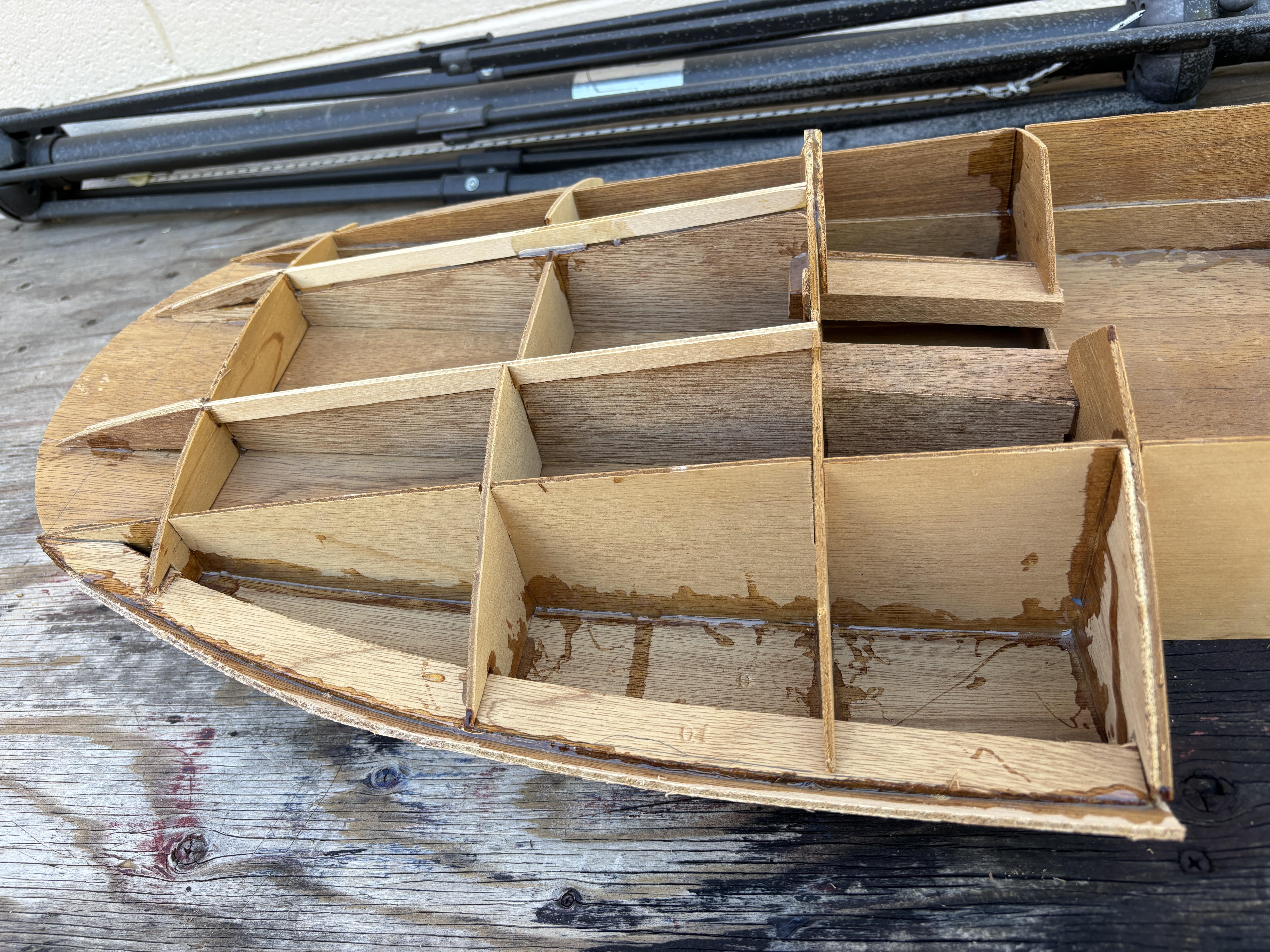

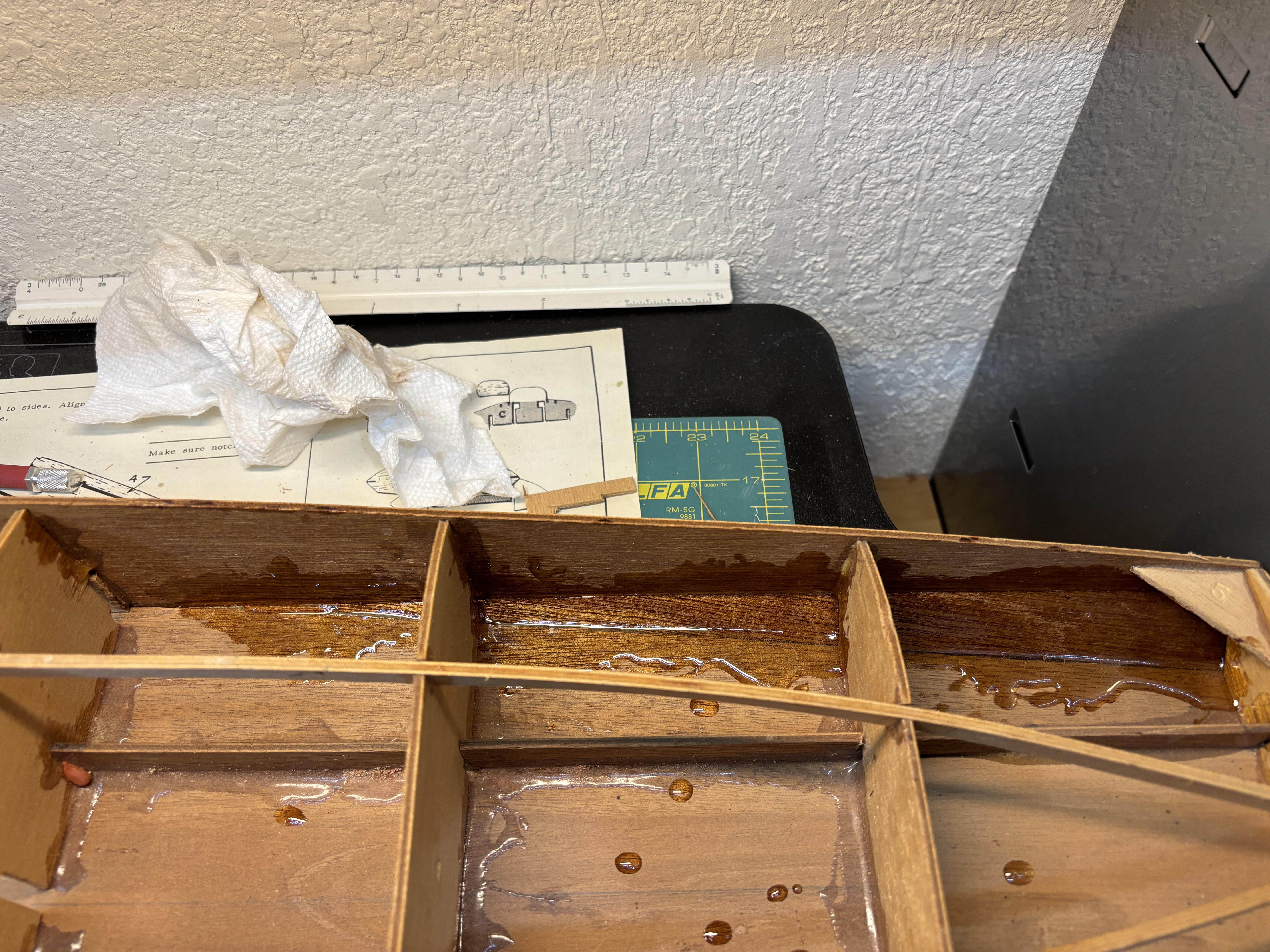

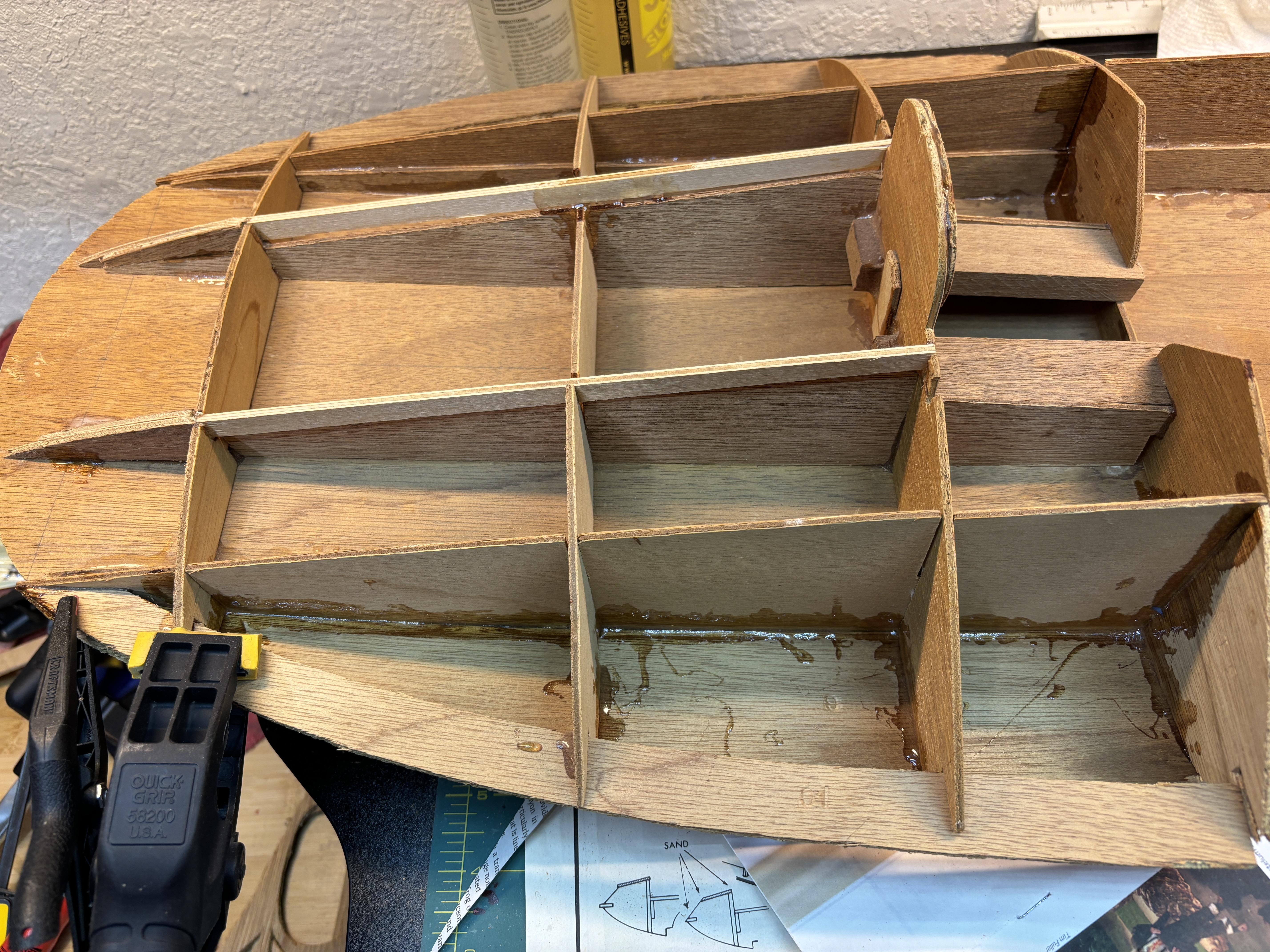

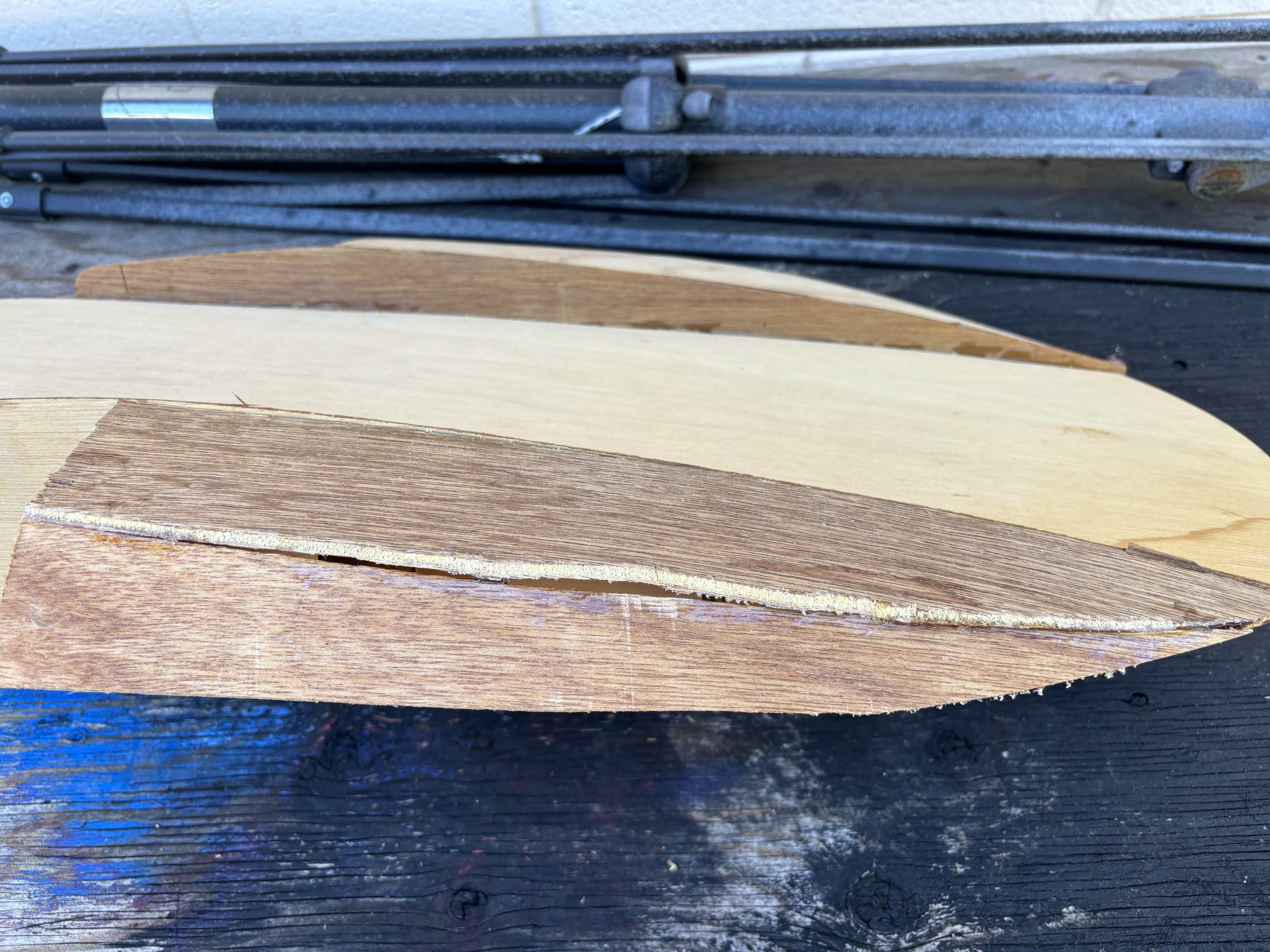

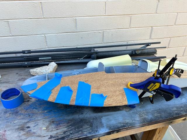

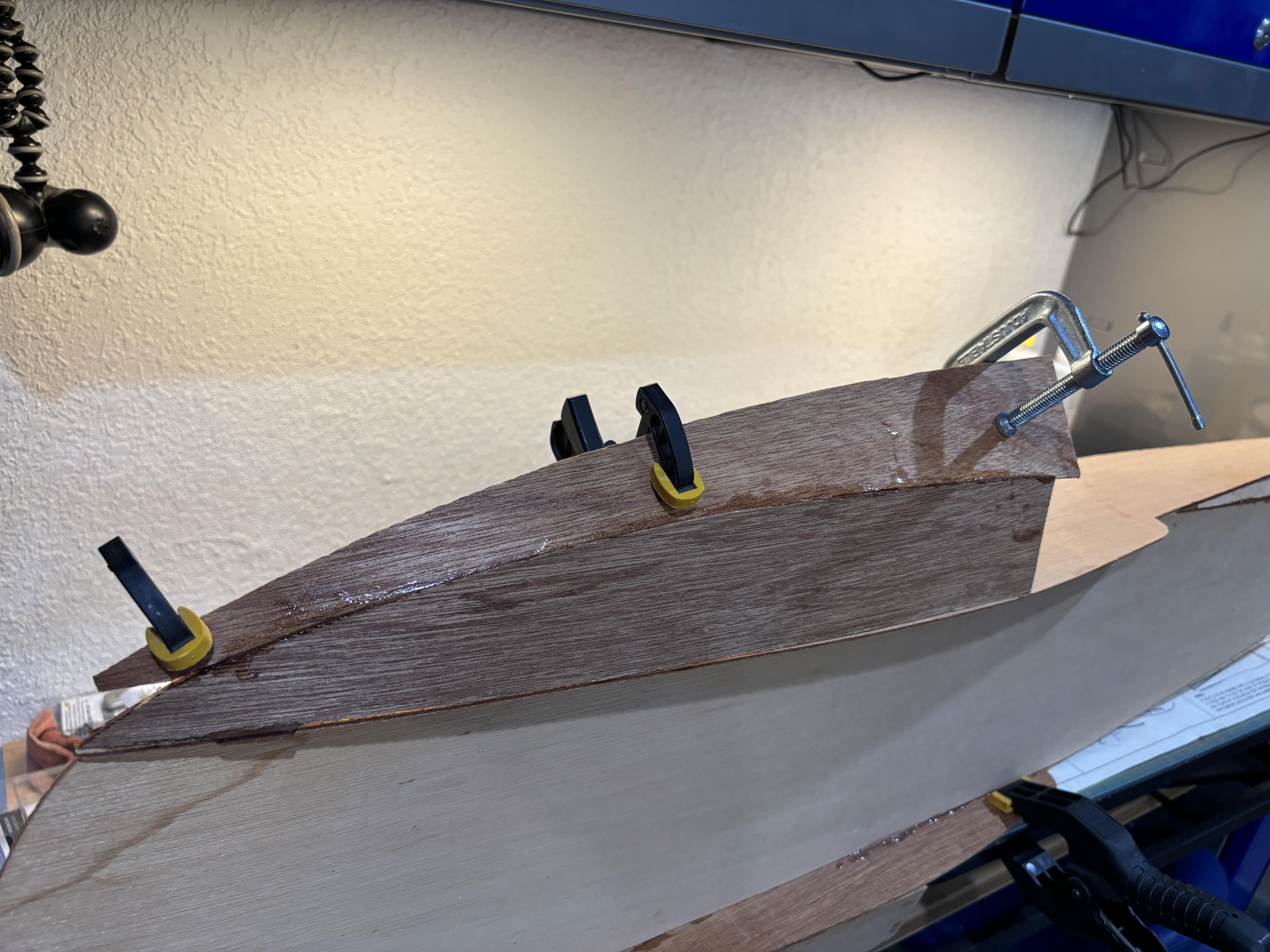

Sonorandog Posted October 14, 2023 Posted October 14, 2023 I am really leaving my comfort zone. I have never posted a WIP and I am making a wooden boat. I have never done a WIP because I don’t think my skill level or technique warrants asking others to watch a mediocre build and wooden boats, this is my first. But, I have had this kit for 30 years, literally 30. I have started it a few times over the years but never have done much. The boat has spent a lot of its life hanging on a wall in the garage and has the stains to prove it. I am doing this because I have made little progress in all these years and I want to finish it. I am hoping that this will guilt me into it. When I bought this kit a friend of mine said I would not finish it in his lifetime. Well that almost came true. He is better now but it motivated me. Funny the things that come to mind in stressful times. I have no idea what I am doing and I am certain to make mistakes. So if anyone checks in on this build hopefully I can provide with some good laughs when you see what I do. Today I added a little wood and a lot of epoxy. That is what the blue tape in the picture is doing, holding wood and glue in place. 1

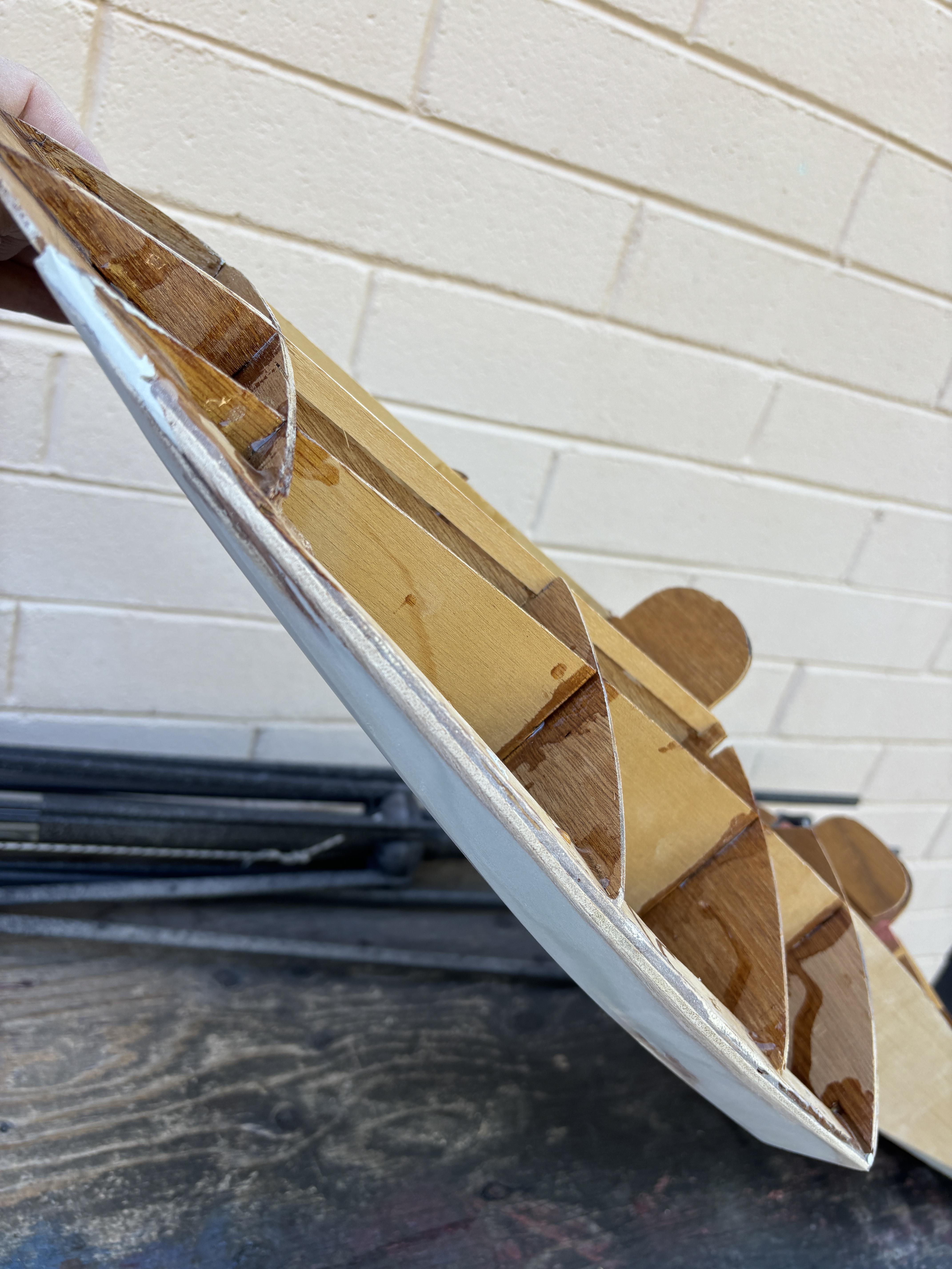

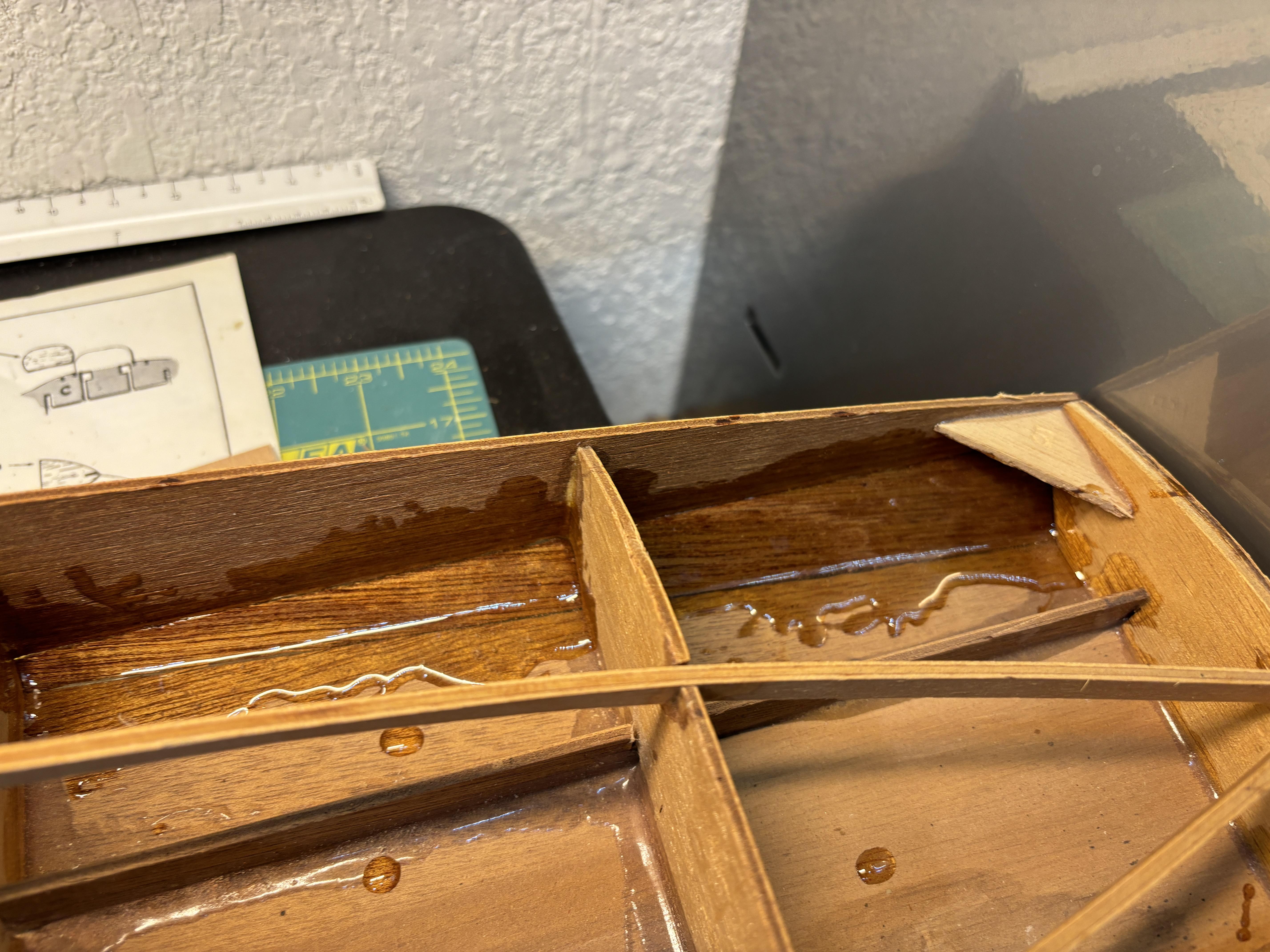

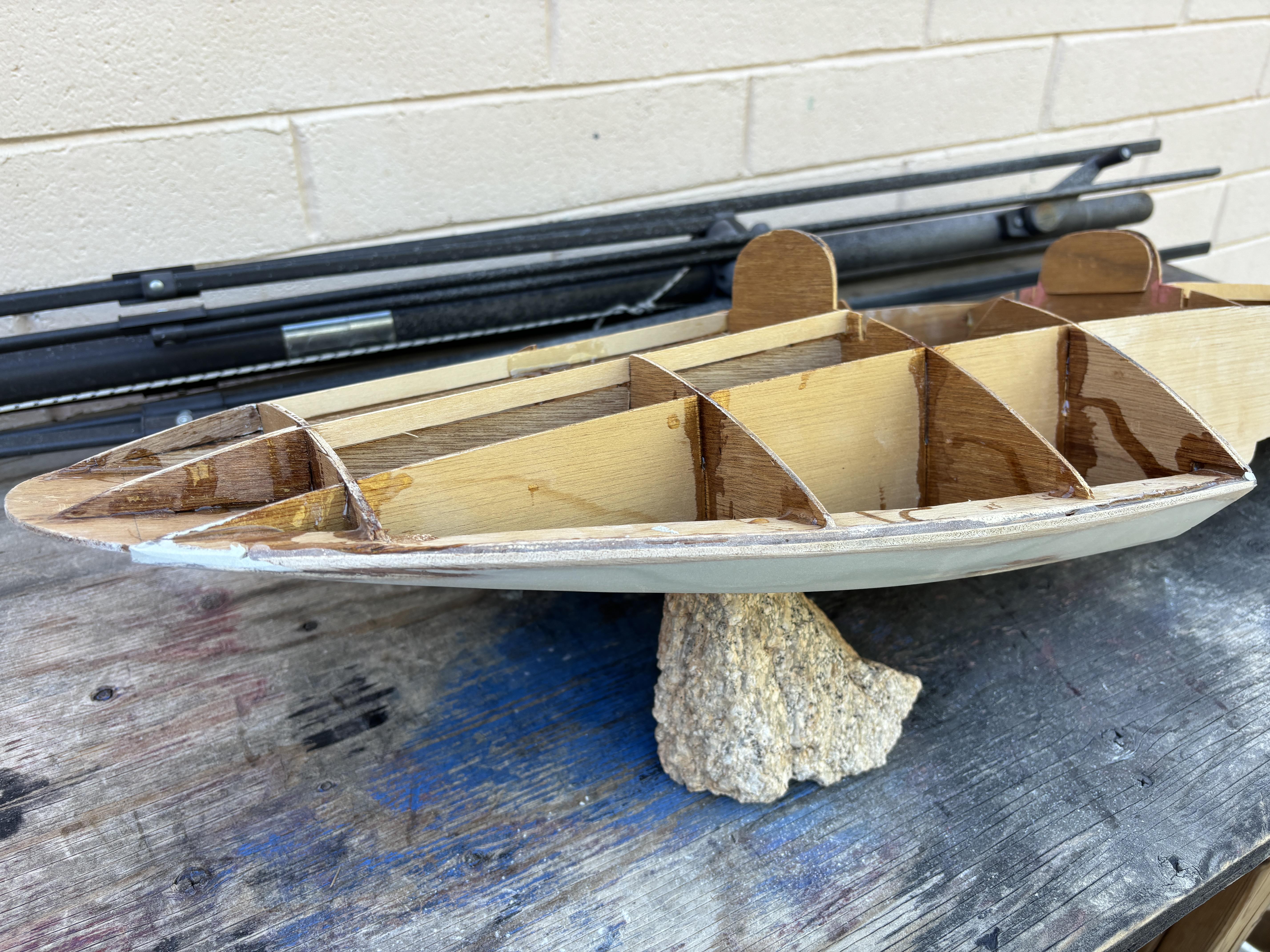

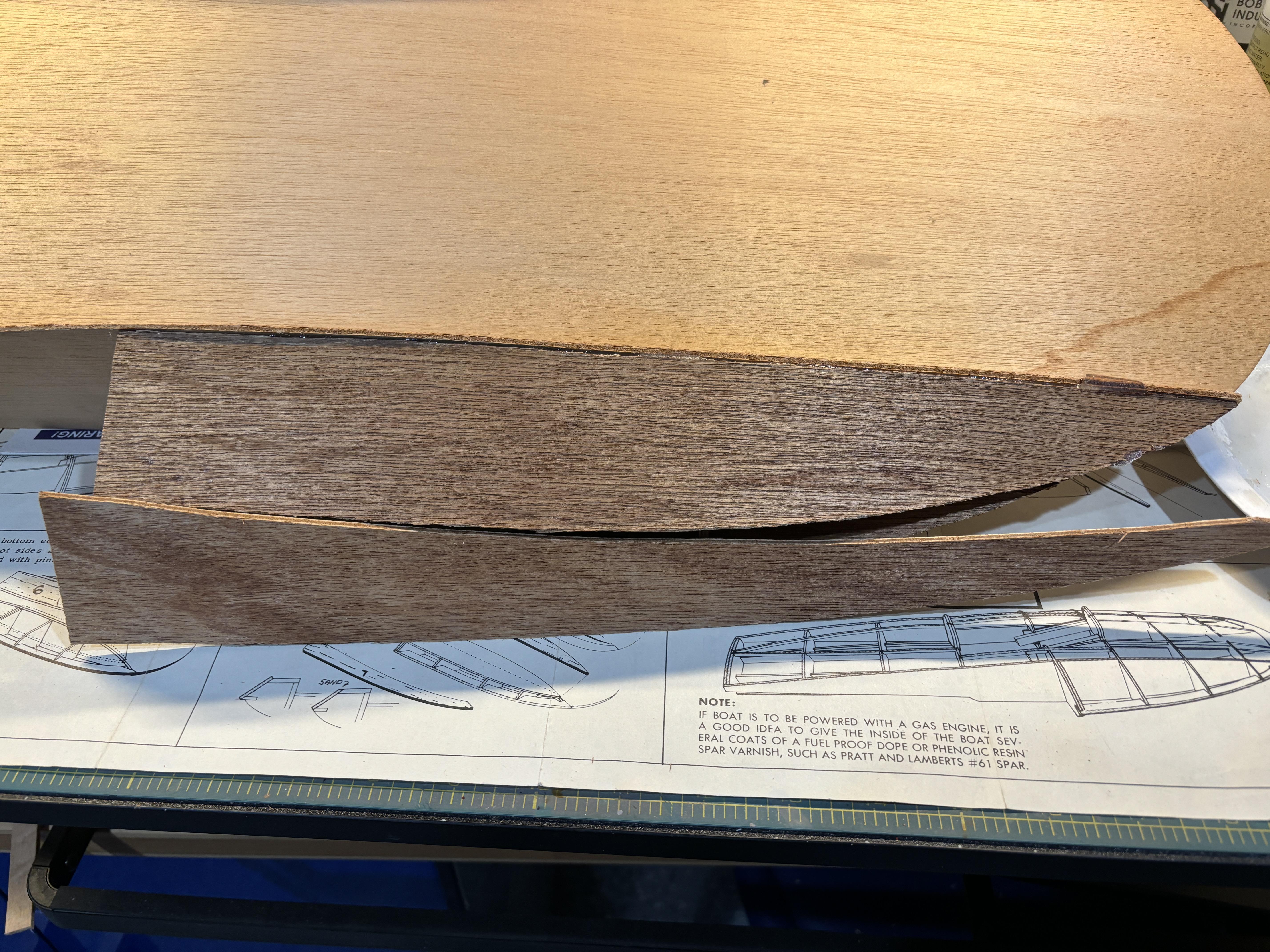

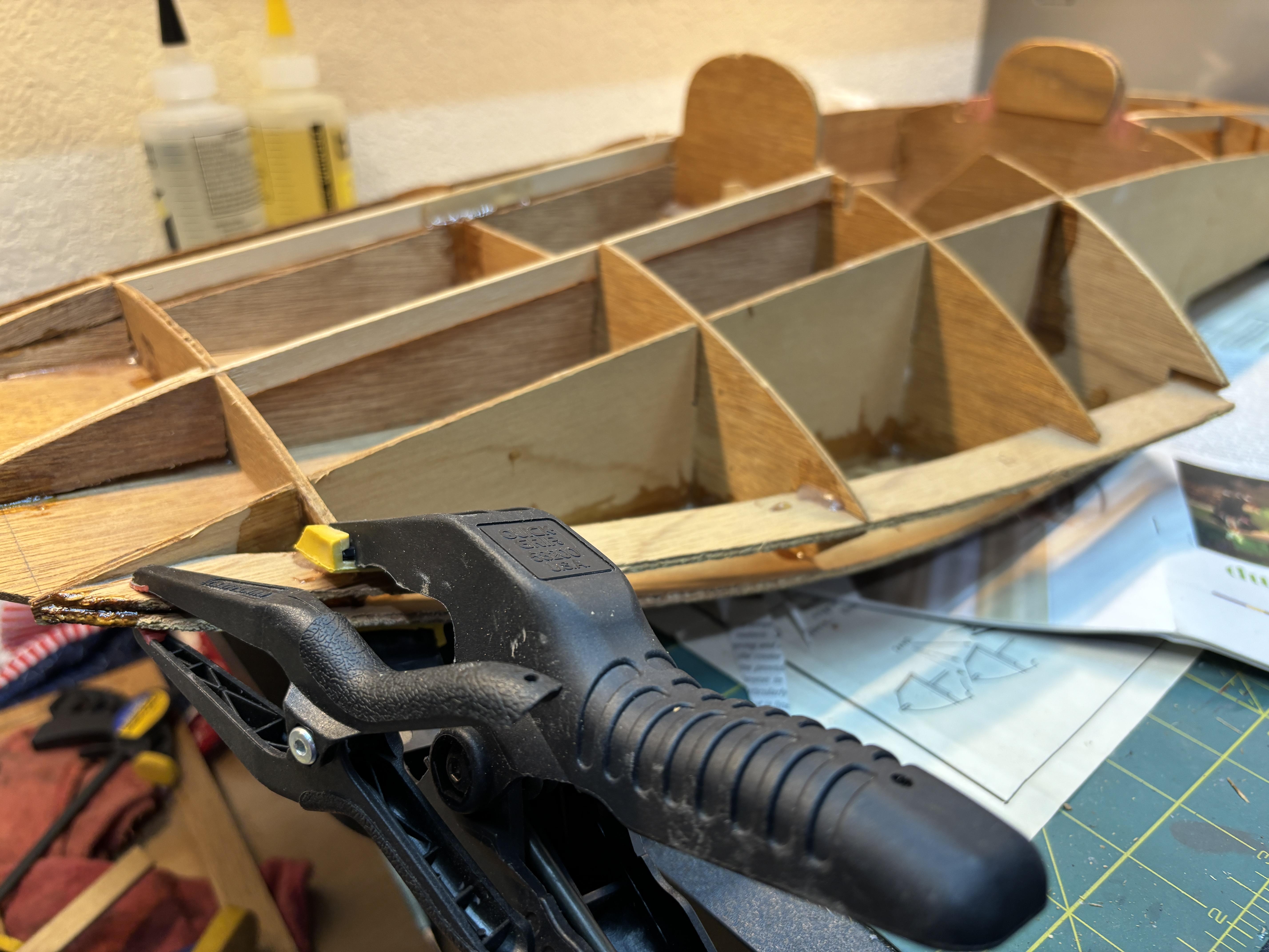

Sonorandog Posted October 17, 2023 Author Posted October 17, 2023 Thanks for the encouragement. I made a little progress. I glued in the lower side panels in back. There were very large gaps between the panels so I OVER epoxied the seams and had blue tape on the exterior holding it all in place. My plan worked. The epoxy flowed through the gaps and filled all the open spaces. I started on the front hull. I had to glue it up in steps due to the curvature. But it all seems to be working. Fortunately my plan of painting all exterior surfaces will allow me to fill and sand what is starting to look like a lot of ugly seams. 2

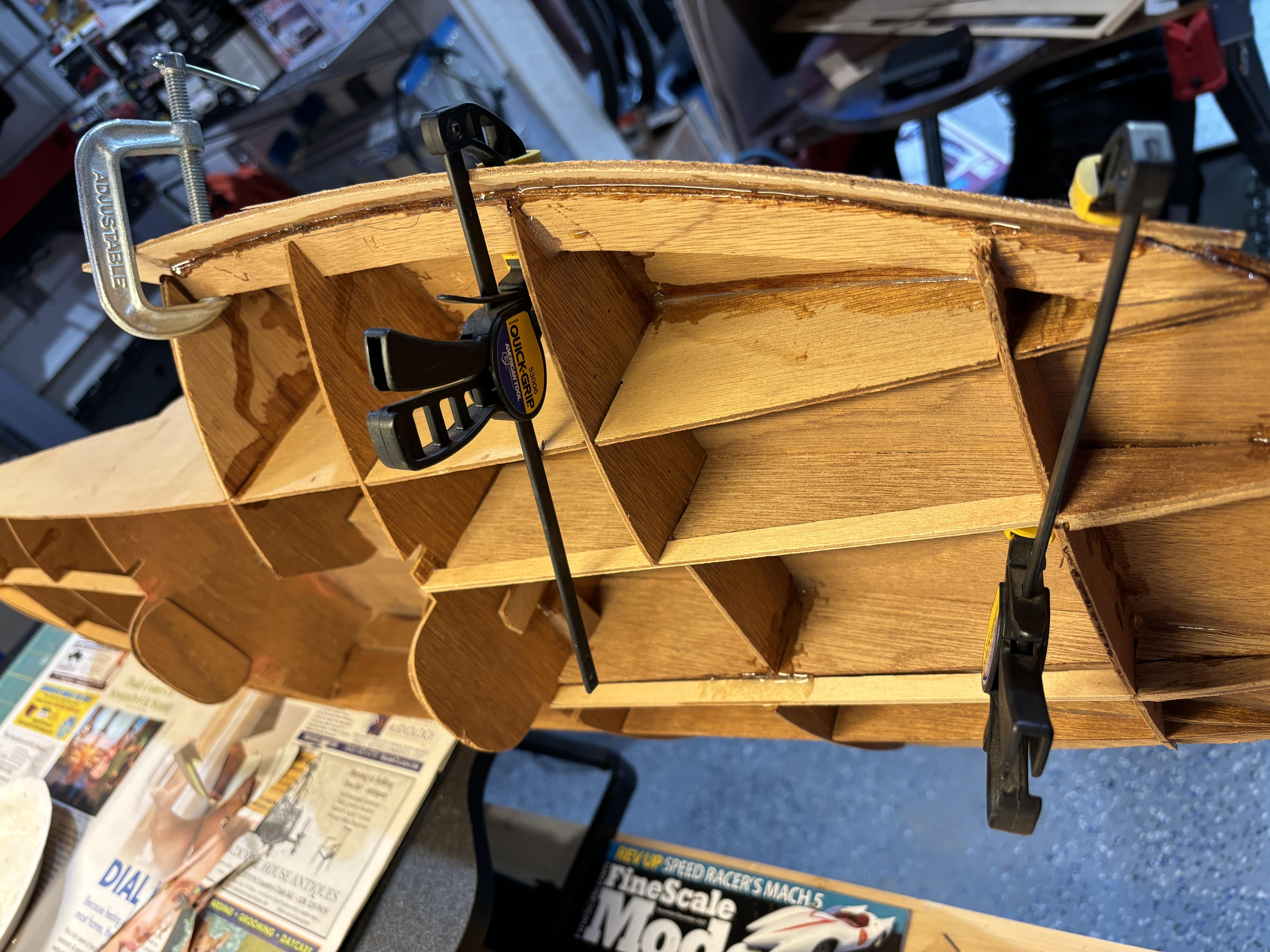

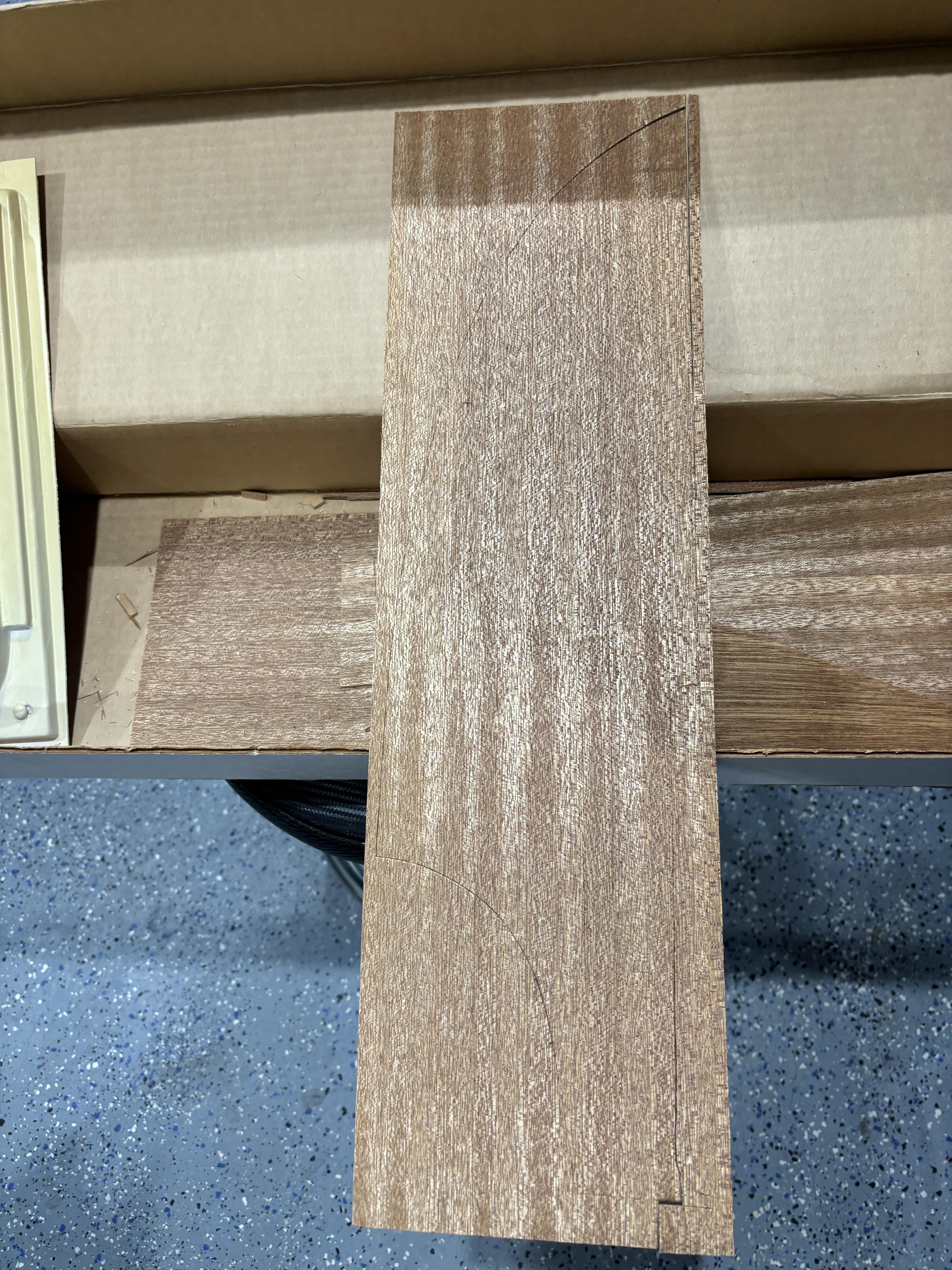

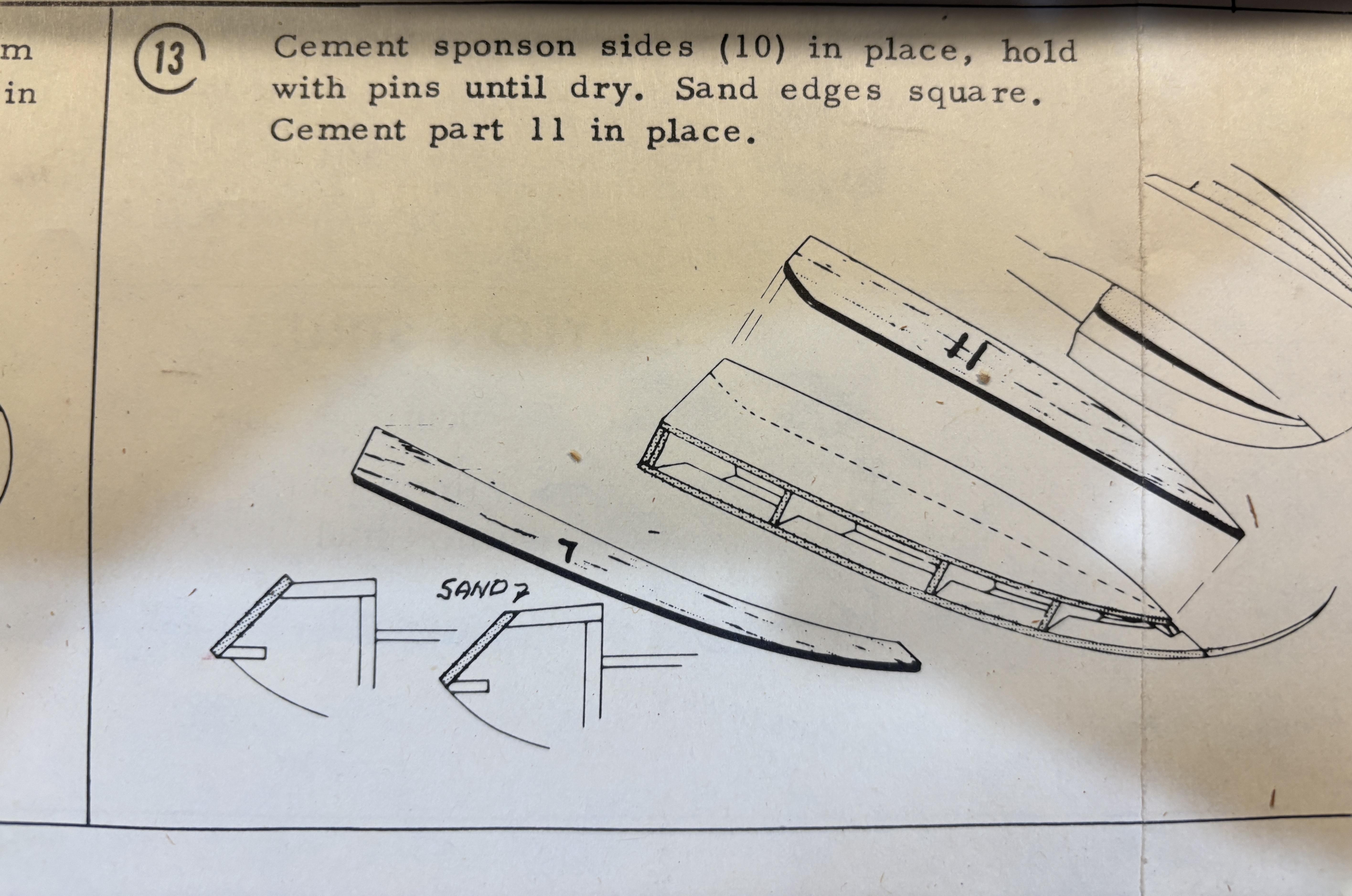

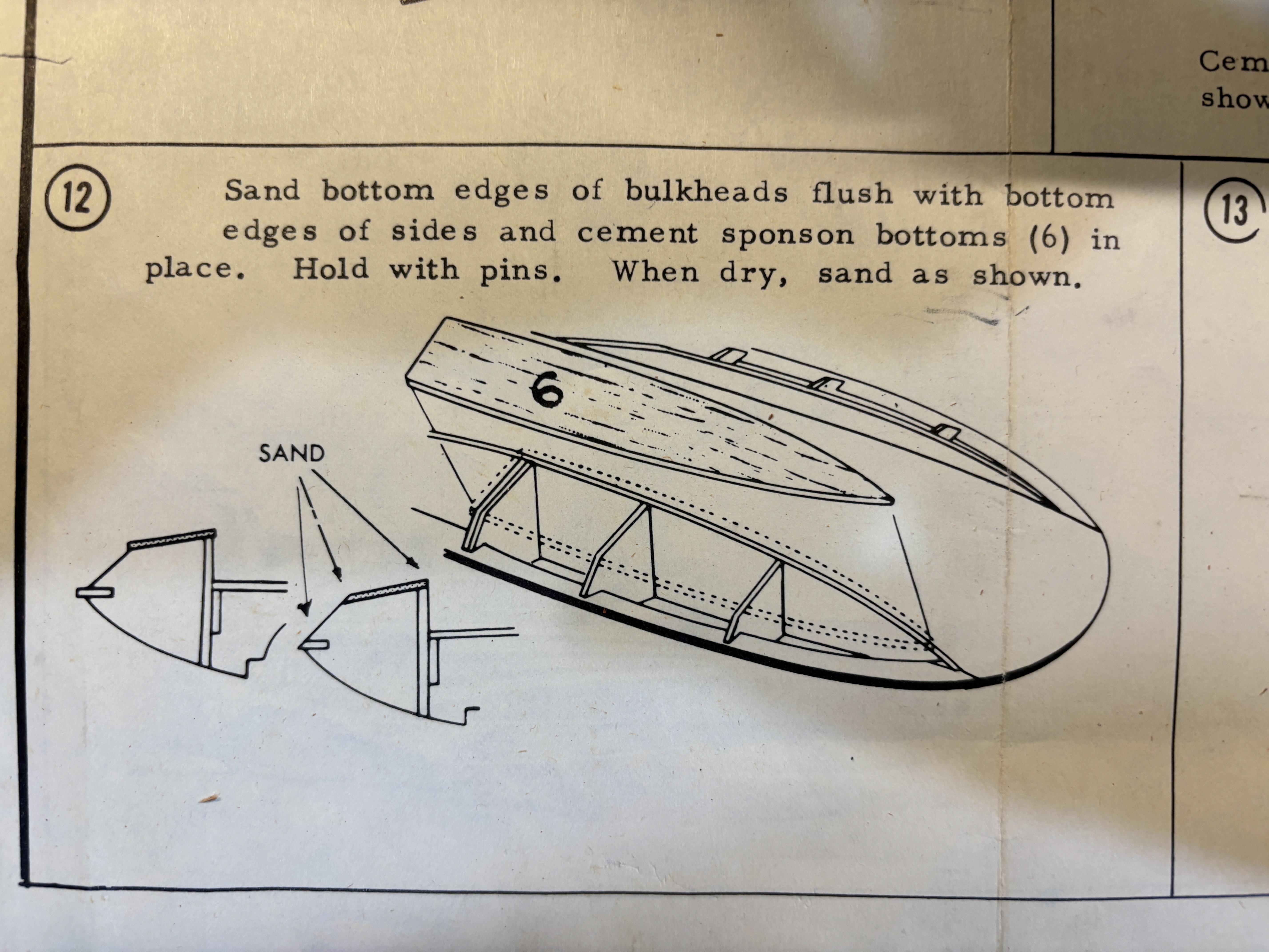

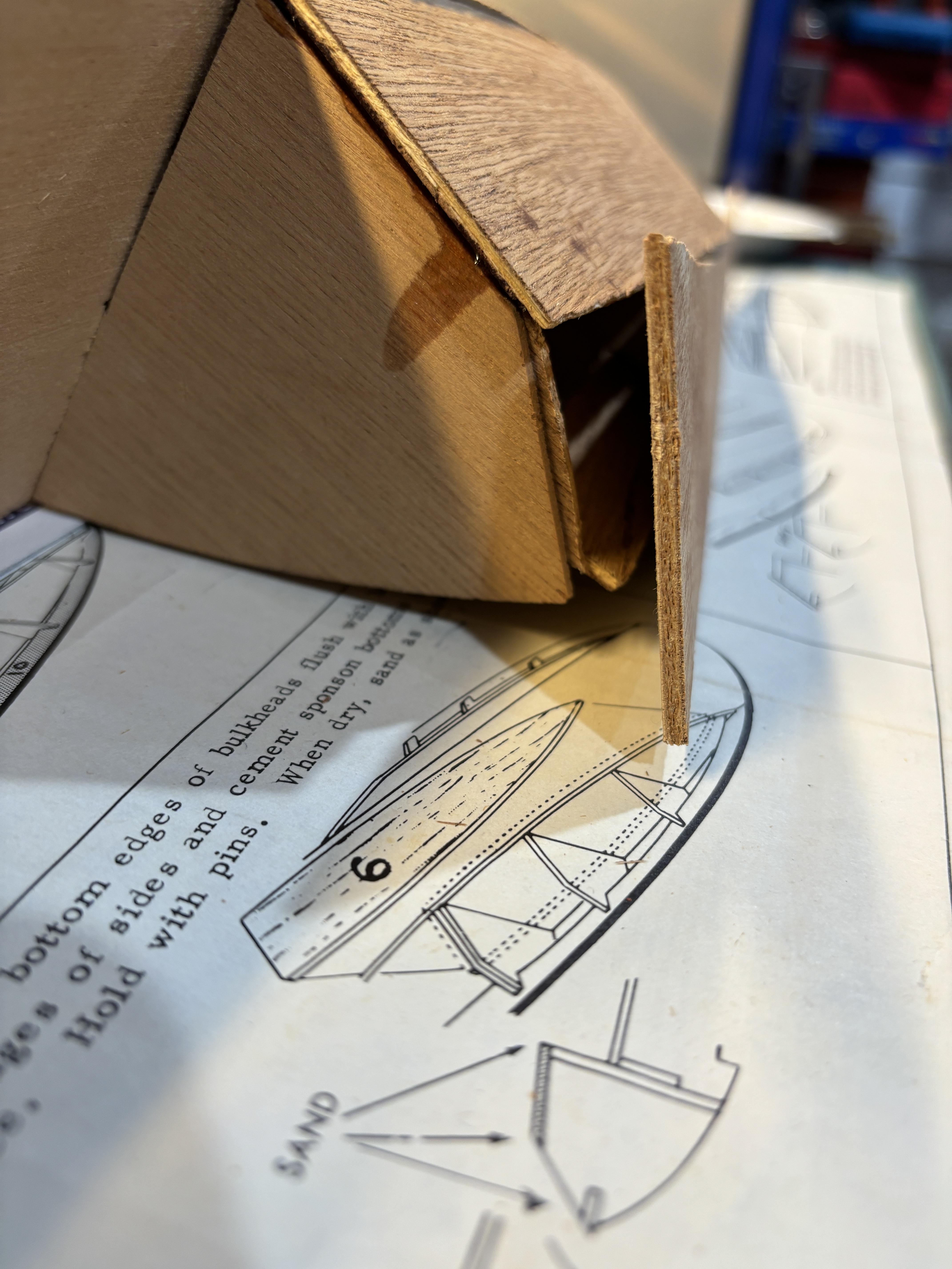

Sonorandog Posted October 20, 2023 Author Posted October 20, 2023 For those that have never had the joy of making one of these. Here is an example of what is required. As you can see, the pieces are going to require a lot of trimming and filling. 1

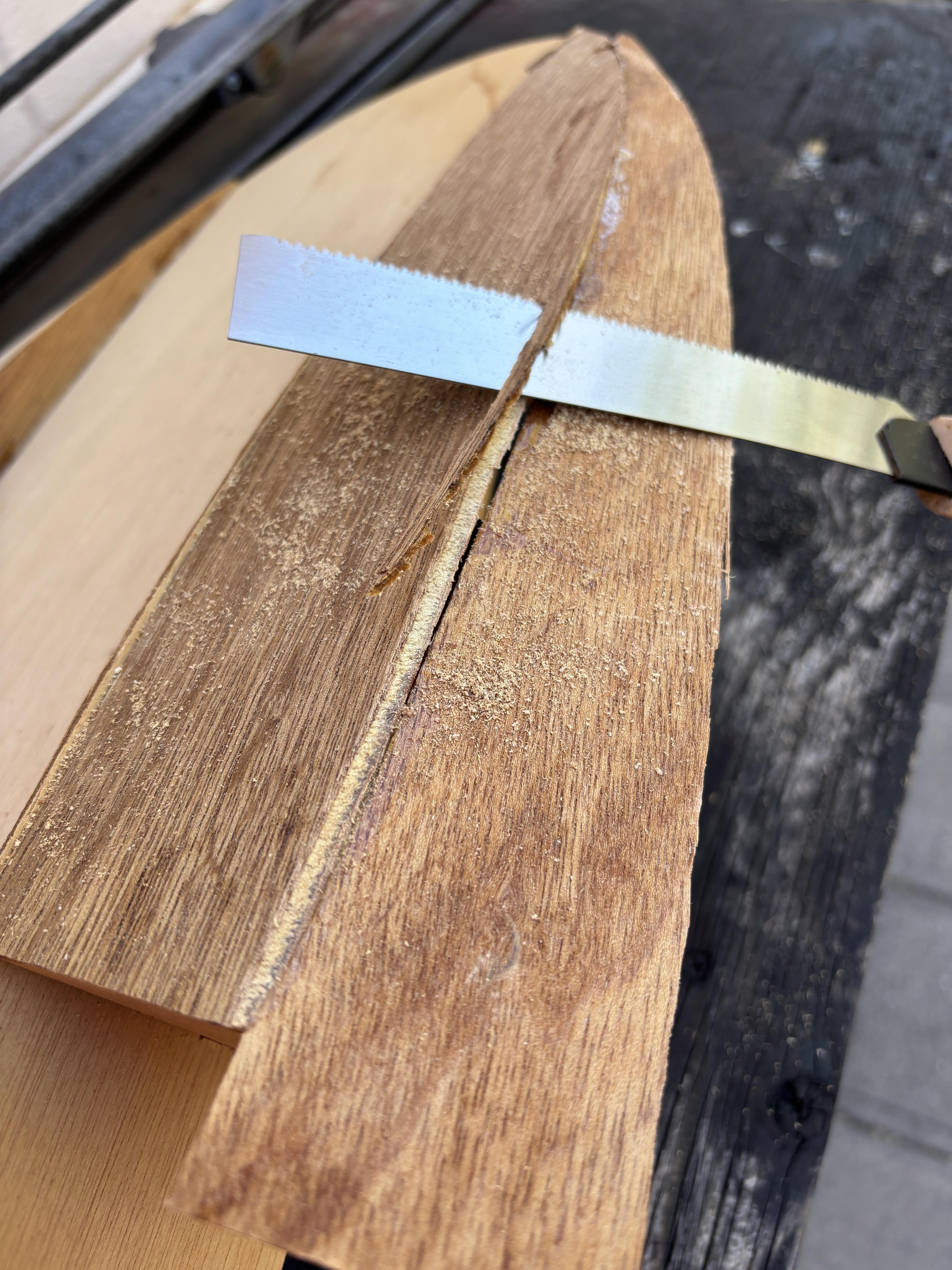

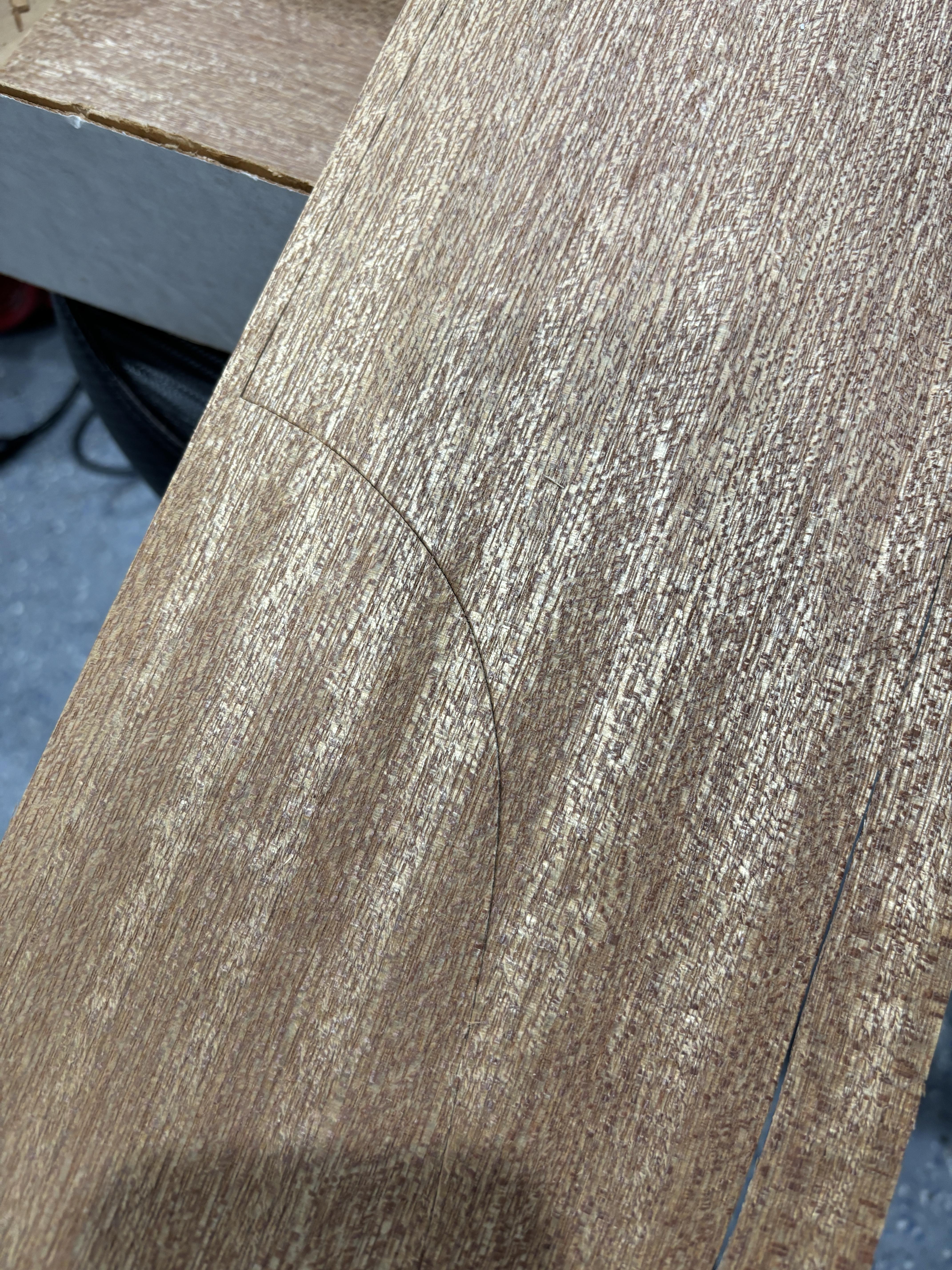

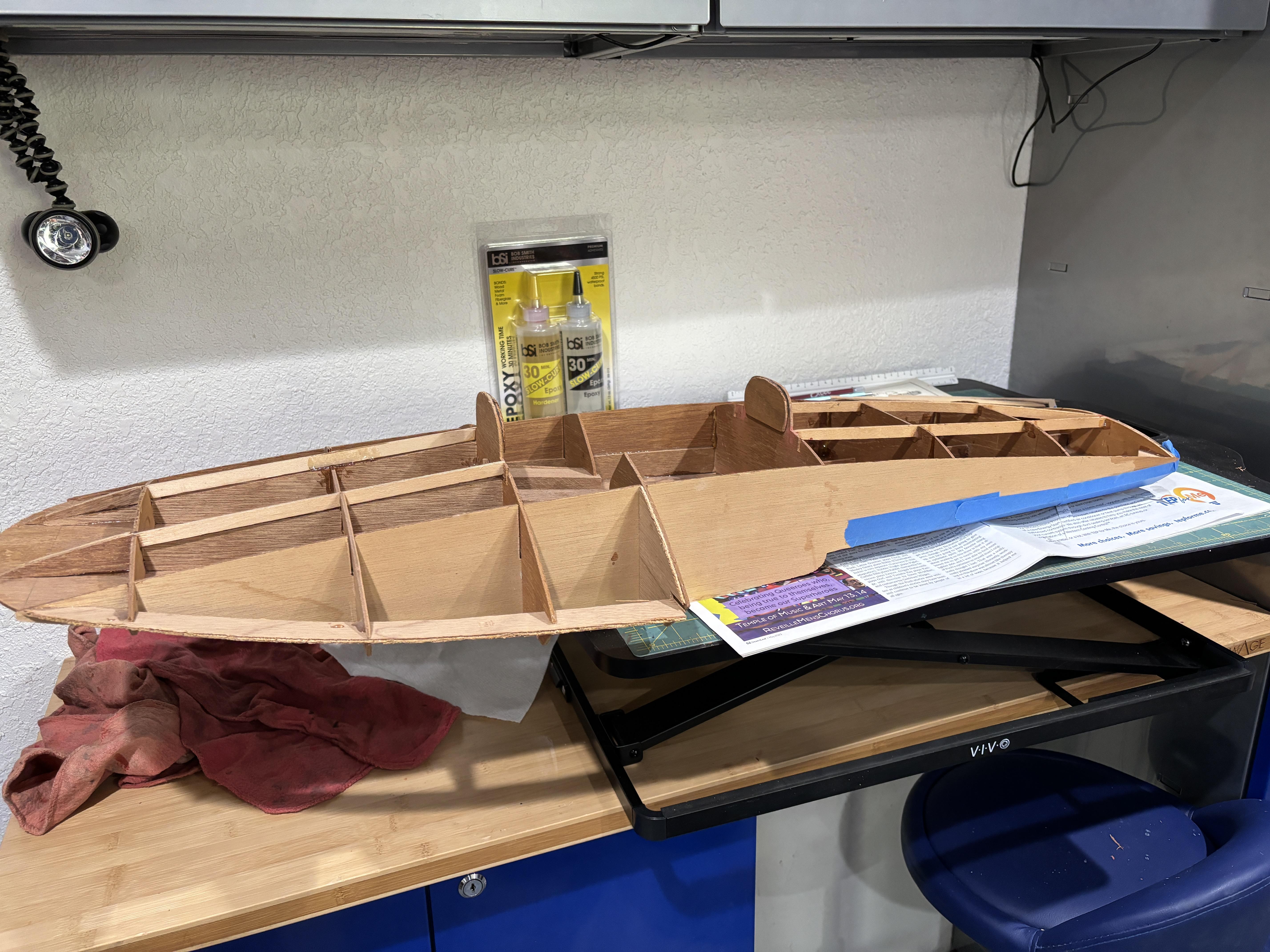

Sonorandog Posted October 21, 2023 Author Posted October 21, 2023 As I said when I started, I don’t know what I am doing with this. My intention is to put it together oversized then cut and trim to finished dimensions. I am doing one side at a time just in case this is the wrong approach.
Oldriginal86 Posted October 21, 2023 Posted October 21, 2023 Key to assembly with any wood kit that is glued together with epoxy is patience. Put on a couple planks and walk away. The squarer or fair the hull is, the less bodywork will be needed later. Mine had a bad twist in the hull and I have a ton of bodywork trying to straighten it. Looks like you are well in to it. Keep up the good work.

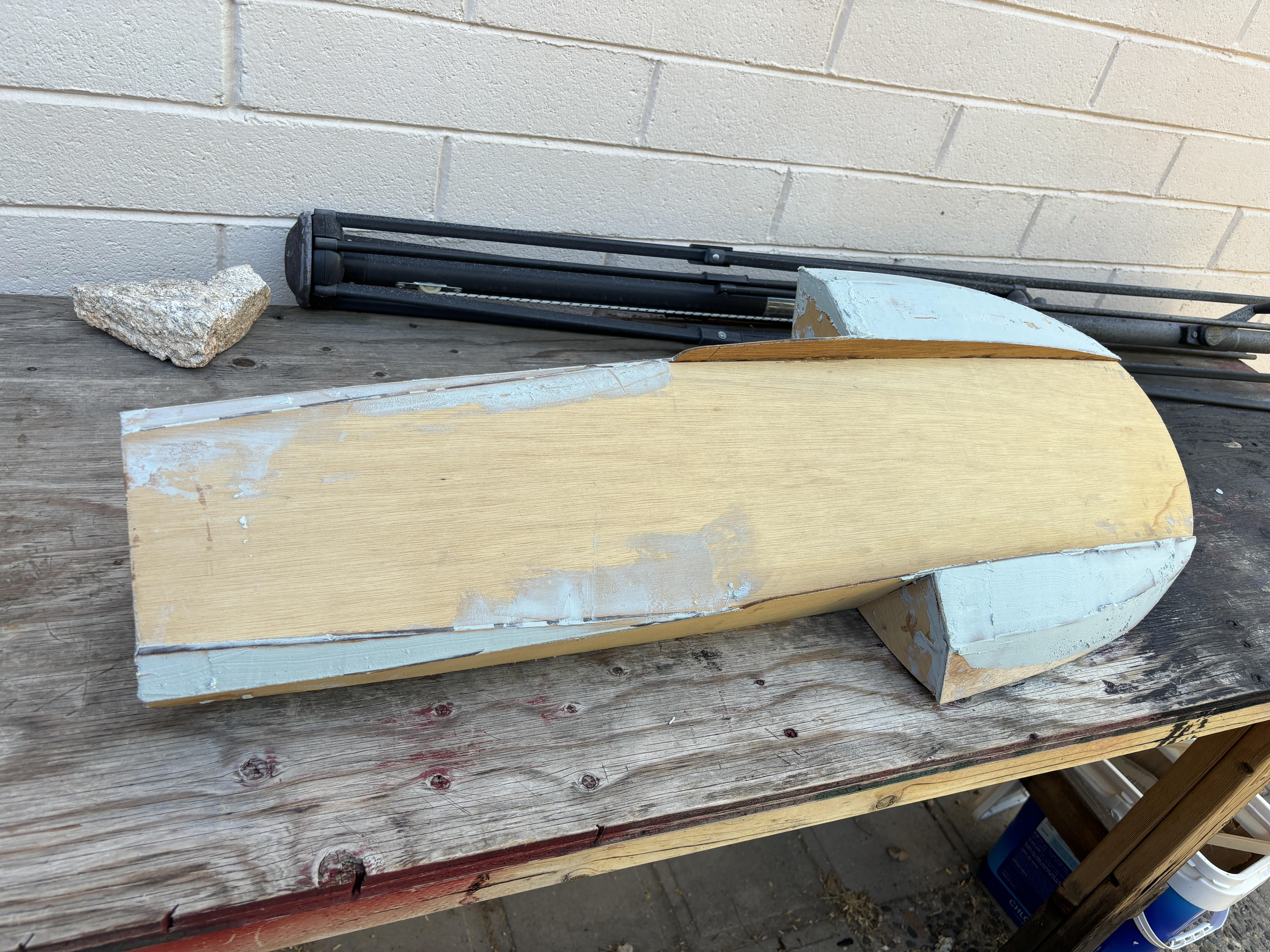

Sonorandog Posted October 22, 2023 Author Posted October 22, 2023 My plan for trimming after the glue up worked well. Until I got a little overzealous. Nothing a little putty can’t fix. Happy with the progress. On to the other side.

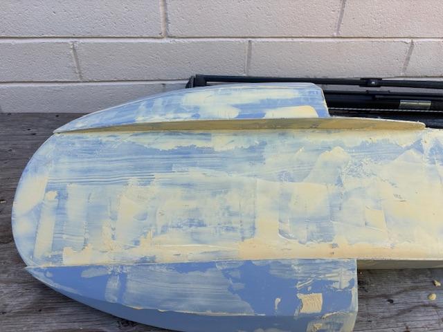

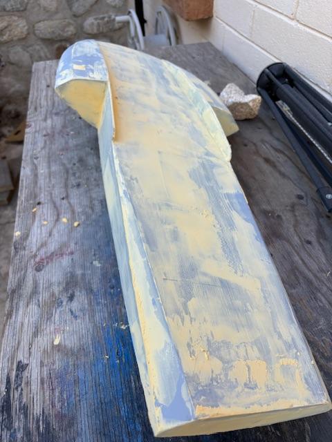

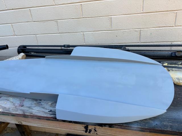

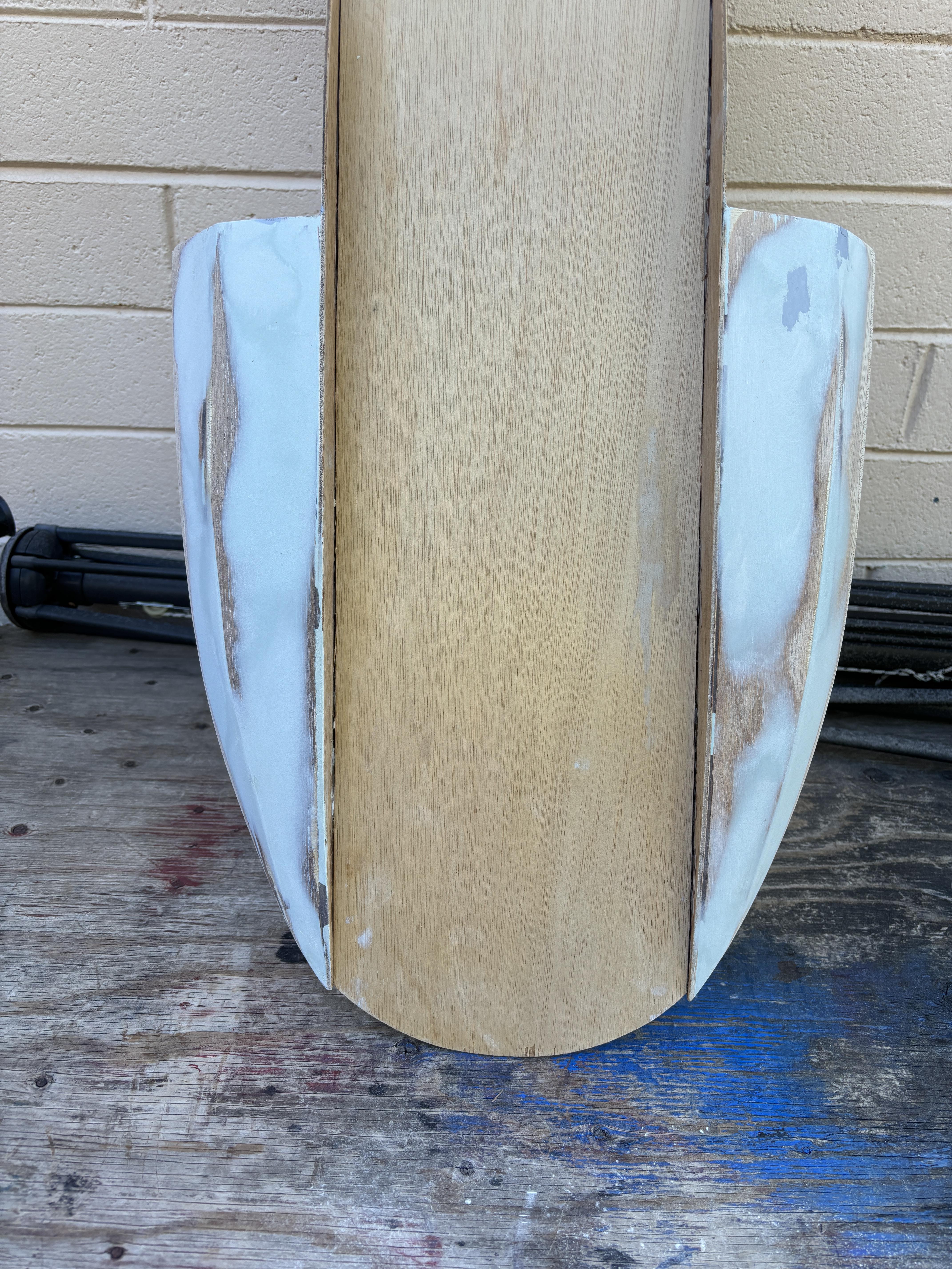

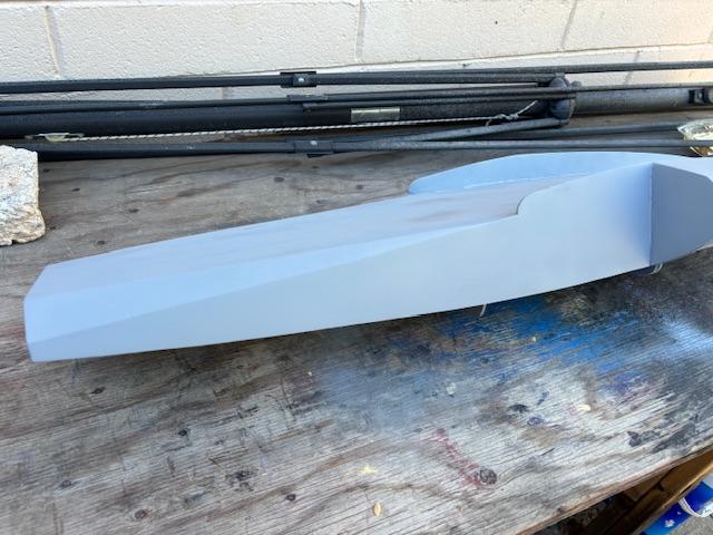

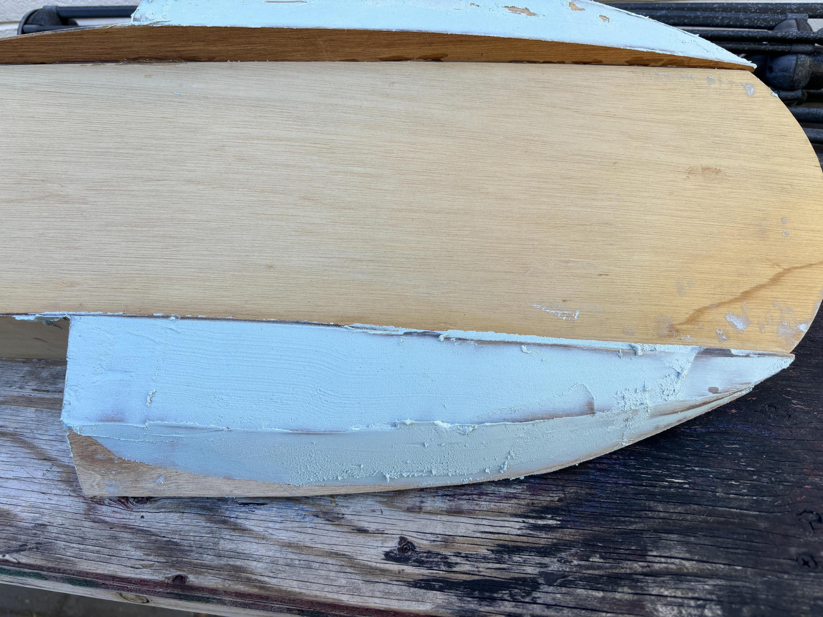

Sonorandog Posted October 28, 2023 Author Posted October 28, 2023 Progress is slow but happening. I used a lot of filler to cover my poor skills. Just a tiny bit more sanding and it will be ready for primer. My plan is to get the lower hull finished and primed before doing the decking. I know there will be a lot more epoxy and filler clean up but it just seems like a good idea to get the lower done first.
Oldriginal86 Posted October 29, 2023 Posted October 29, 2023 Sanding blocks are your friend. Looking good.

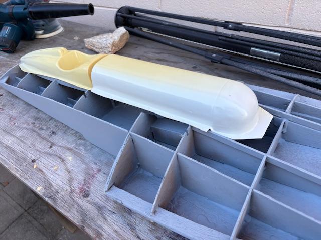

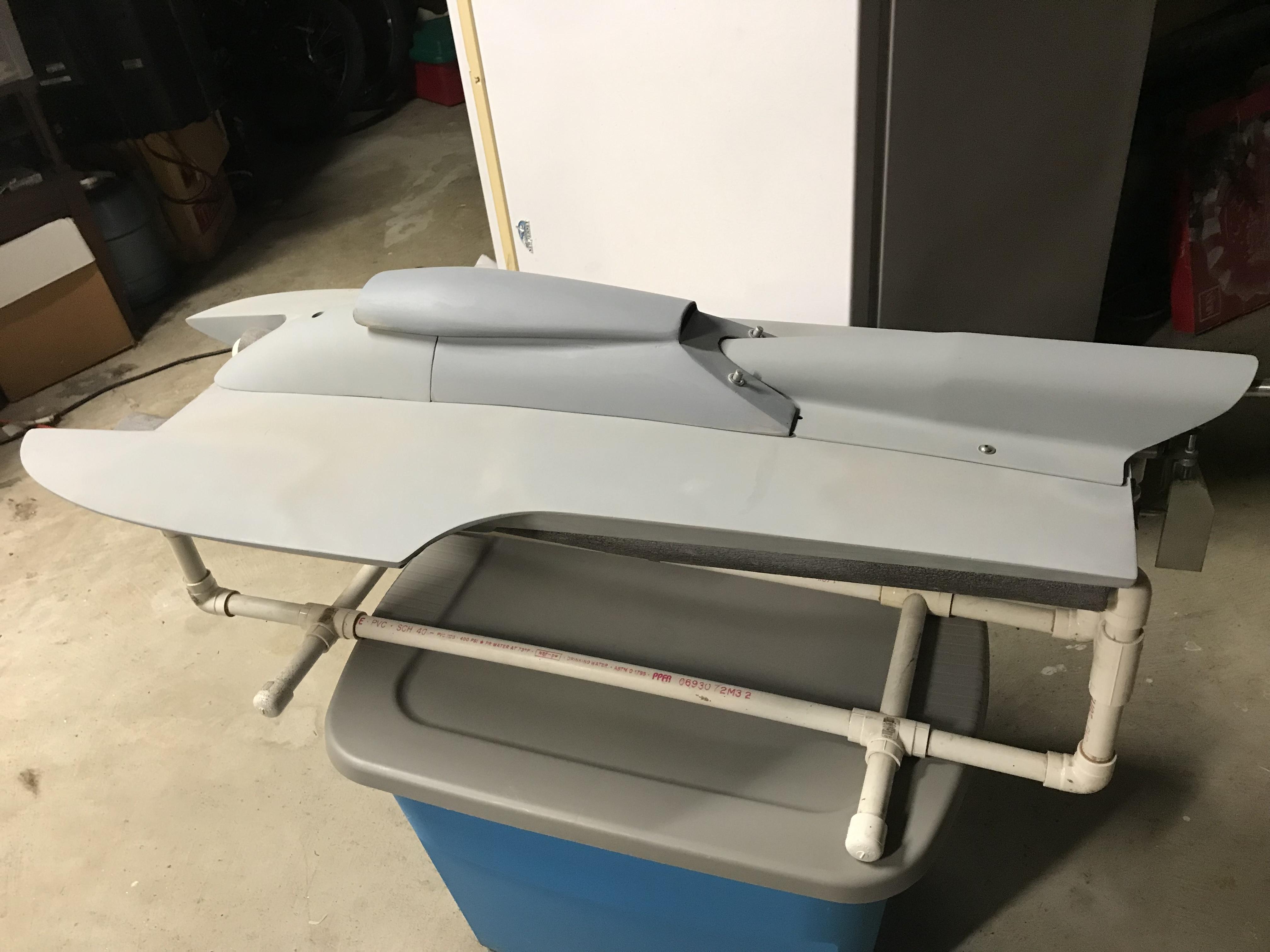

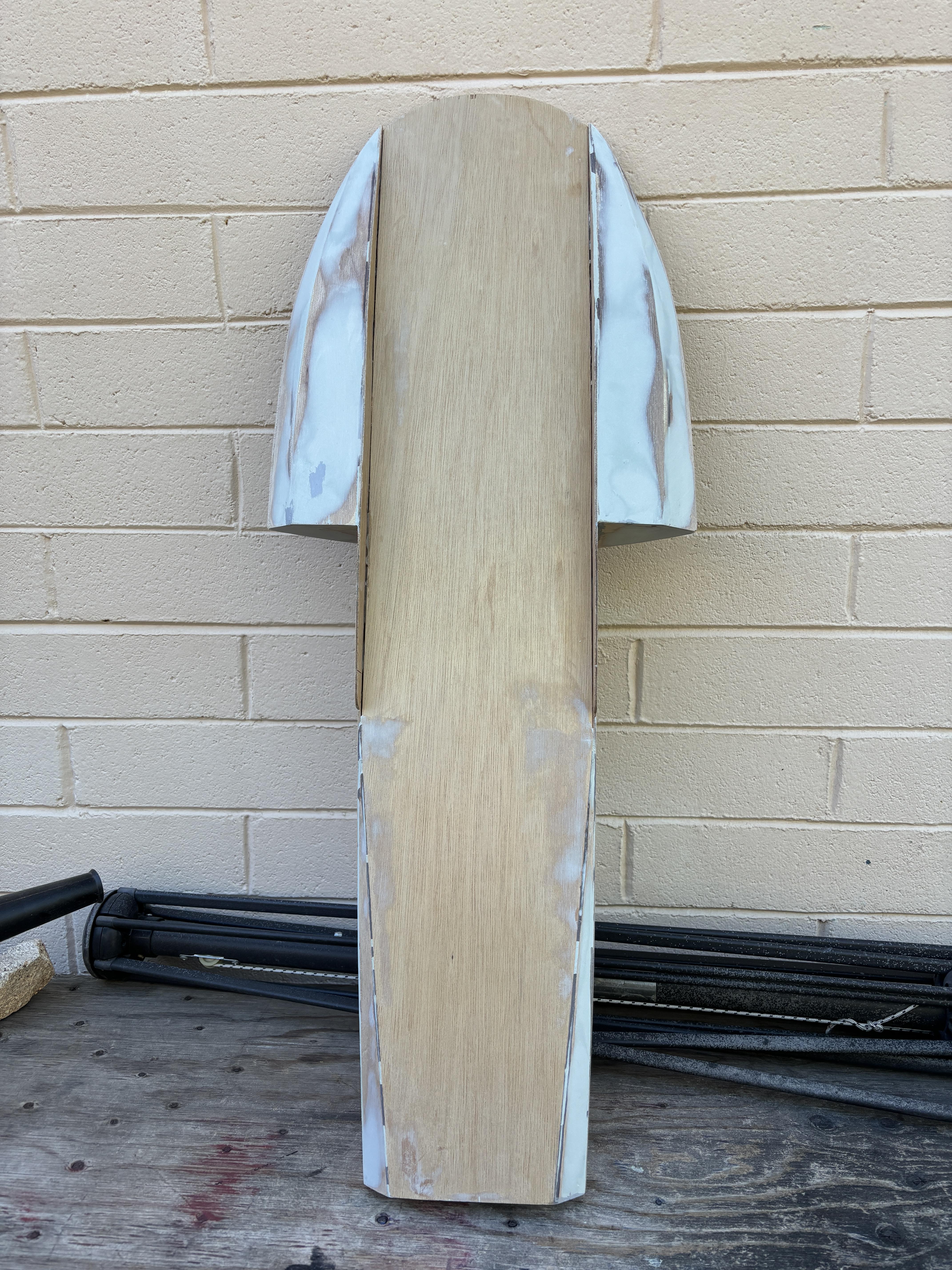

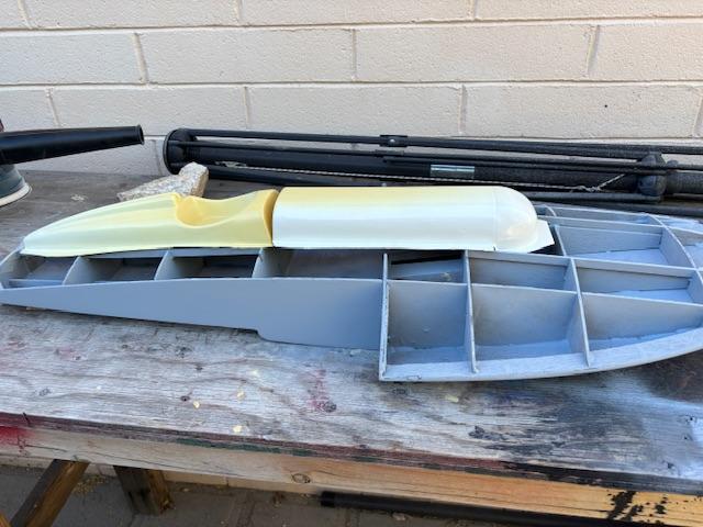

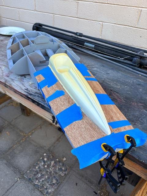

Sonorandog Posted October 29, 2023 Author Posted October 29, 2023 (edited) Thanks! Sanding, sanding and more sanding has been my life the last to days. After sanding down all the putty I put on a coat of primer. Then I filled the grain with a diluted wood putty mixture. I put the primer down first because I used a water based filler and did not want the bare wood to absorb all the water. After more sanding and a little touch up I put down a light coat of primer to see how everything looked. I think it is in a good enough condition to move on to the next step. I could not resist trying out the canopy. Edited October 29, 2023 by Sonorandog 2

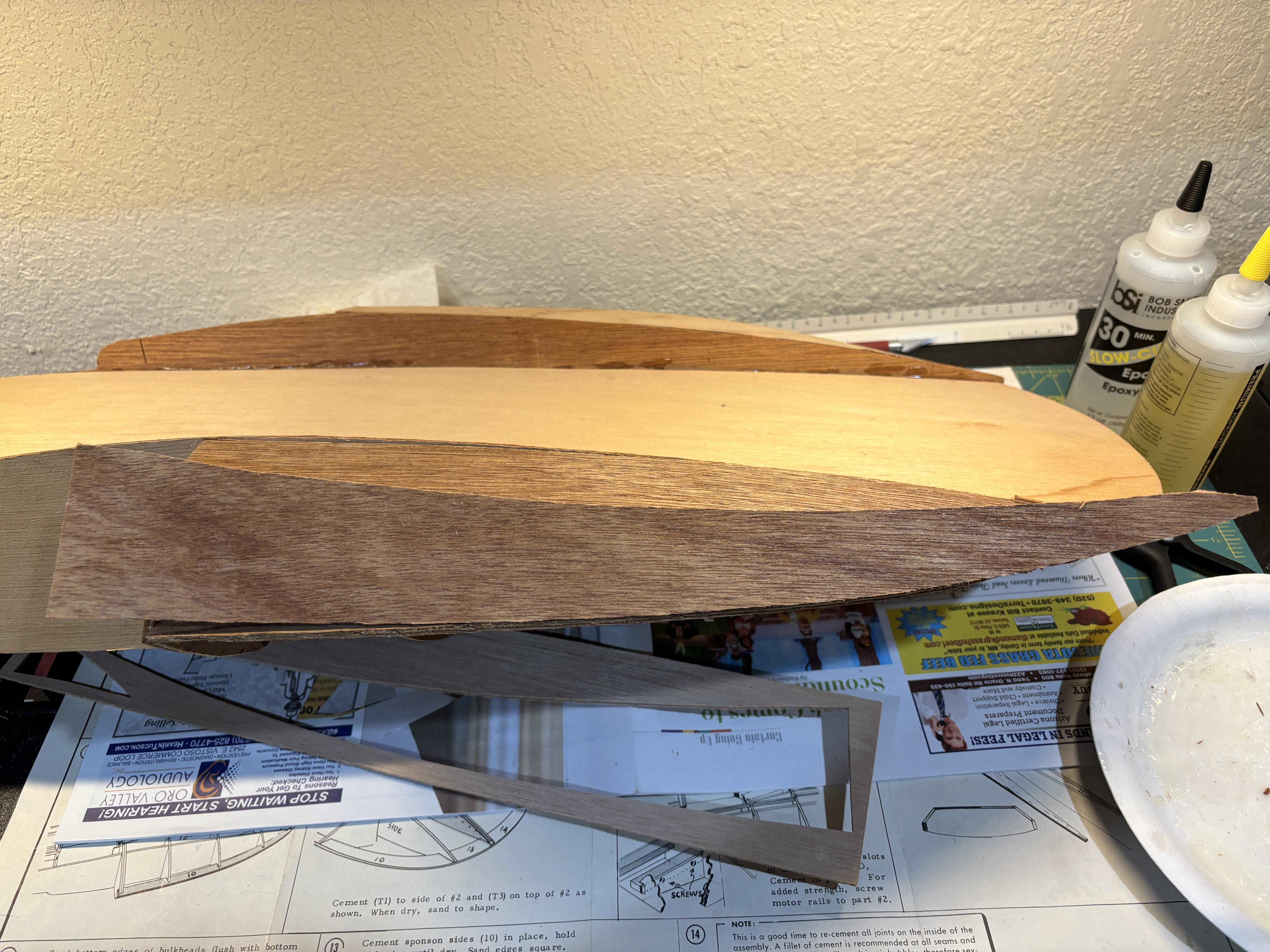

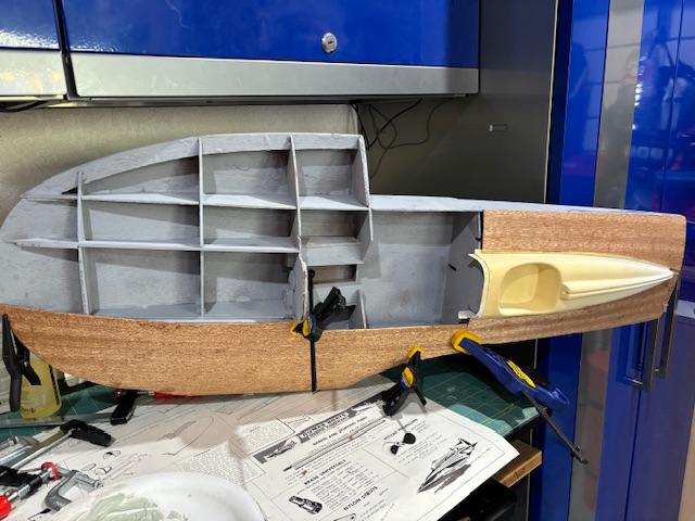

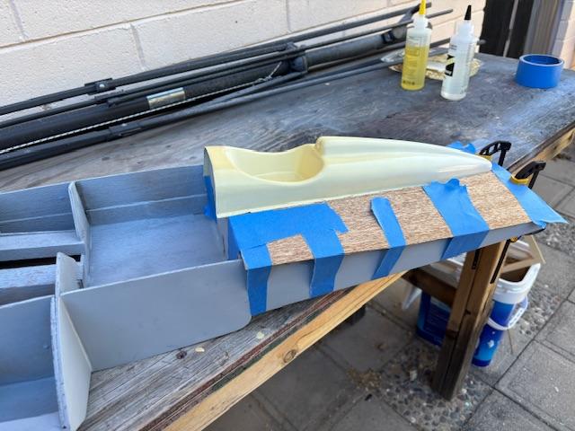

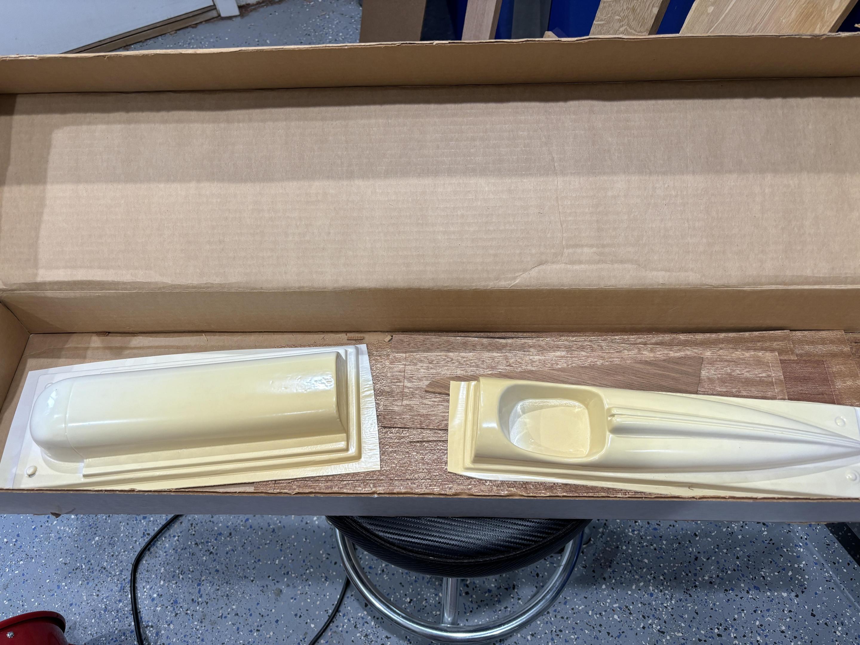

Sonorandog Posted October 31, 2023 Author Posted October 31, 2023 Looks like plenty more filler is going to be needed. There is a lot of space between the precut decking and the cowl.

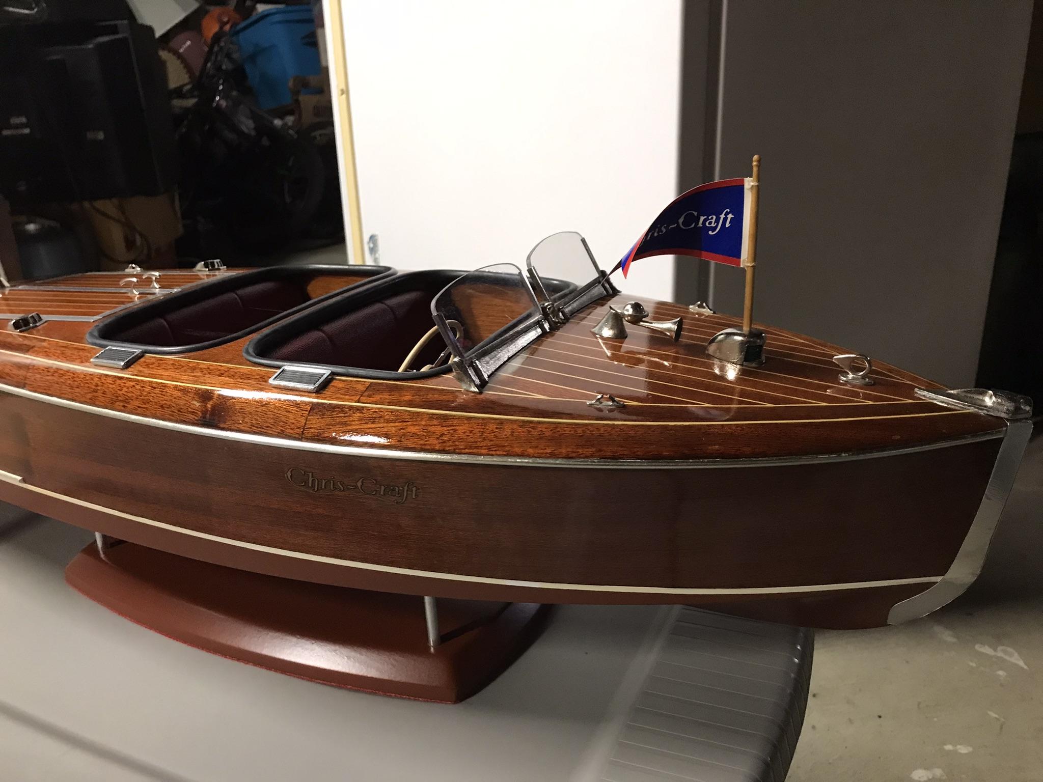

Oldriginal86 Posted November 11, 2023 Posted November 11, 2023 Now your talking! Those runabout projects are fun and rewarding when completed. I could post pics of mine on here if you don’t mind for inspiration.
Oldriginal86 Posted November 12, 2023 Posted November 12, 2023 Put these two on your thread. May post more in their own WIP. 1
