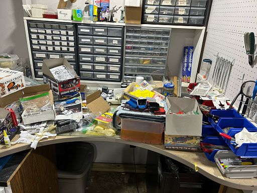

I have been in an extended build slump for the better part of the last 5 years, with little output since then, but especially the last 8 months. I had actual cobwebs all over my bench. The ideas are always churnning away in the brain but the desire and/or time just hasn't been there. I was able to wrap up the last of my outdoor projects for this year so I was able to carve out a little time over the weekend in my hobby room. First order of business was to clean off the bench. Of course, i'm still buying things, so first up was the pile of purchases to sort through and put away. it was like Christmas. All the old projects on my benches were just making me sad, so I needed a clean slate. That meant carefully gathering all the scattered parts for various projects of my one bench and putting them away. Once that was done and a little deep cleaning I was starting to feel better.  Then I needed a project to work on. Something pretty straightforward and satisfying was what I needed. Not kitbashing, scratchbuilding or heavy detailing. The perfect kit in my mind ended up being this kit... Monograms SweeTee.
1698694590383
Pay no attention to the second bench. This is what they both looked like before Operation Clean Slate

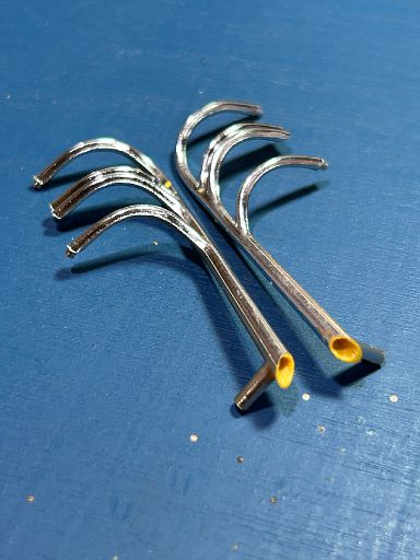

Drilled out the ends of the exhaust headers. Will be touched up with black and Molotow chrome. I also stripped the chrome off a couple parts, and dug up a spare molded in white seat to use instead of the molded in black kit piece. This is to aid the paint process, rather than trying to get yellow to successfully cover black plastic which would probably require several coats to reach full opacity, each coat risking a paint mishap on a rare part.
I also secured a couple Gelly Roll gel pens to attempt the thin whitewall on the slicks, but so far the results are subpar. I used a circle template to get a consistent circle, but the coverage of the white is not great, and the blue and red are too dark to really show up on the black tire. Wish someone made some precut vinyl ones, or that Round2 offered some bigger slicks with the pad printed narrow white wall like the one in their awesome Gasser wheel/tire pack, just with slightly bigger slicks.
Anyway, here's the pic. Next step is to blend up a good paint match for the Monogram plastic.

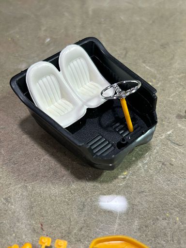

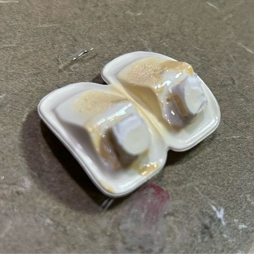

I was kind of in a little bit of a holding pattern for a couple reasons, one of which was overcome last night. I needed to find/mix some paint to match the color of the plastic so I could get the seat painted and also use it to detail paint a few things. Well, I was able to stop by my LHS and grab a bottle of Tamiya orange and yellow and get to mixing. It took a few tries, but I think I nailed it. I checked this morning after I let it fully dry overnight and the final attempt is almost imperceptible against the plastic color. Here is the parts tree with my 3rd, 4th and 5th mixes. In real life the differences between these attempts are more obvious, but I feel attempt 5 just about nails it.
I grabbed a spare seat from a glue bombed Little T that I parted out. Like I explained earlier, this was done so I could more closely match the box art by painting the seat, and trying to paint yellow over black plastic isn't any fun. So, I had to remove the chunks of the interior tub that came with the seats so it would sit in the new tub where it belonged.
1699357429698
I also grabbed a steering wheel from a Monogram 32 Ford because I felt it was more period appropriate to what a builder in 1970 would have put in this rather than the wheel that came in the kit. Got it mounted to the kit supplied column. On the fence about whether to add a turn signal lever or not. In real life that would just be something for the driver to hit their knee on in this tight passenger compartment.

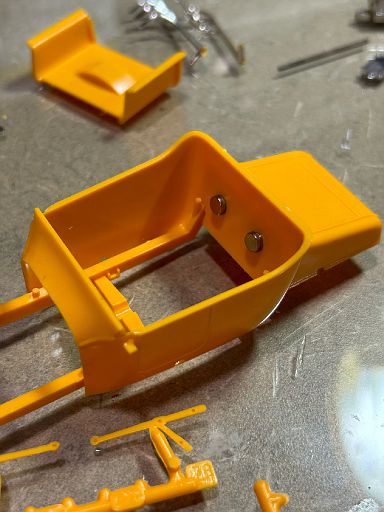

A feature that I have been thinking about for awhile is that the Little T and SweeTee come with a short pickup box, a turtle deck and a big cylindrical fuel tank. I really like the look of the turtle deck and pickup bed, so rather than having to pick which one to use I decided to devise a way to switch them out at will. Thanks to some small rare earth magnets this is a possibility. Got the turtle deck done first.
1699357451544 1699357461344

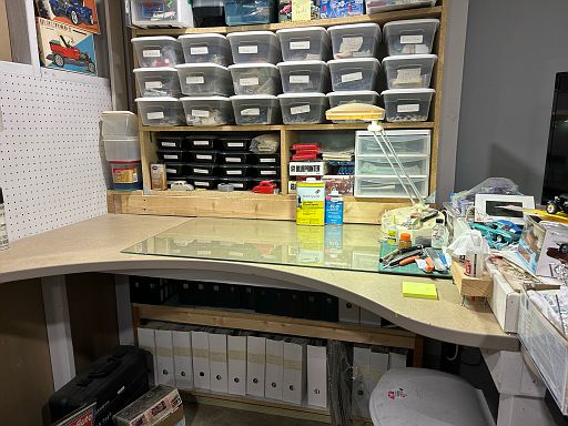

Hey man, nice builds I'll be keeping an eye on these, also I noticed you have glass on you work bench, I was wondering if you could tell me what it's like to work on glass as I'm thinking about going that way, thanks.

I love working on glass. Glue and paint spills can be cleaned up with a razor blade after they dry and it provides and nice flat surface to work on. You can also put reference pictures under there to keep them out of the way. You can also cut on there too, but I prefer my cutting pad for that.

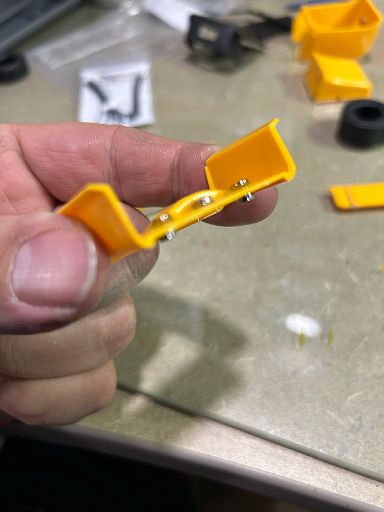

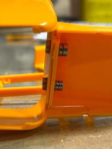

Installed the items in need to secure the pickup bed option to the frame. There may have been better ways to do this, but I'm pretty happy. I drilled holes through the side of the frame near the rear crossmember and inserted and old metal axle from an AMT kit. Should disappear once the suspension is on place. This will give the magnets something to meet up with.
1700218710114
Getting all the magnets placed and secured where I want them was a little tricky, these little suckers are pretty strong. I placed the center magnet and glued it down with super glue. But when I tried to place the outboard magnets they wanted to join the first magnet. So, I held a magnet on the underside of the bed and then put another magnet on top. That actually let me slide the magnet around until it was perfectly positioned. I applied glue, and once that is cured I'll just pull away the magnet on the bottom and should be good to go.

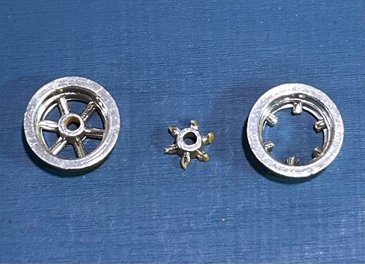

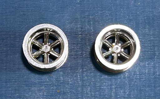

On to modifying the wheels. When Bob Spedding @TooOld built his SweeTee he discovered the wheels looked better with the spokes that are molded on the wheel backs removed. I like the look he achieved, so I'm borrowing his idea. In order to still attach the wheels to the axle I needed to retain the center hub. So I cut that away and glued it to the back of the wheel front.
1700218685021
Then a trimmed away what remained of the spokes from the rim. Original on the left, modified on the right. Subtle, but better.
 1700218690772

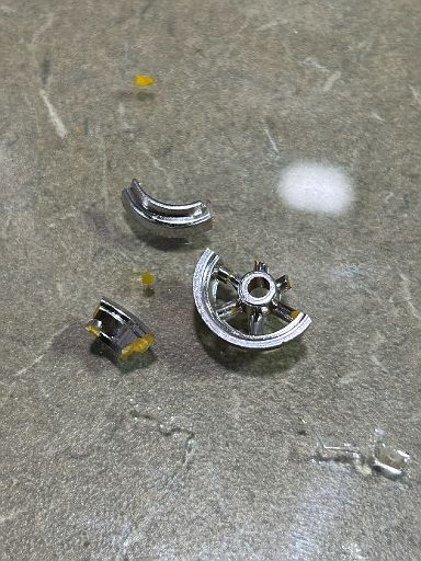

I got the rear wheel sets modified, but when I started working on the front disaster struck. As I was removing the center hub on this very rare wheel, it shattered into 3 pieces. They are clean breaks so I'm hopeful I can get it all glued back together because I'm sure finding a replacement will be very difficult. Fingers crossed.

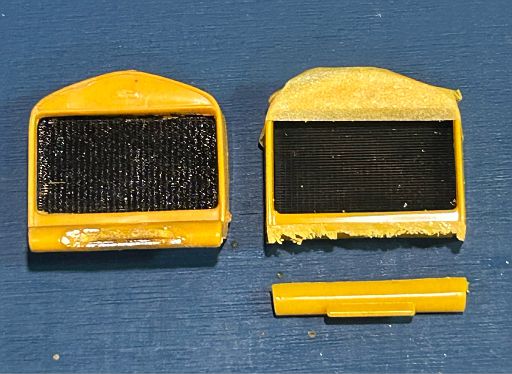

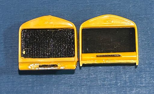

Things are starting to come together. Had to finish up a couple modifications before I started final assembly, and those involve the stance, now that i have finally decided on rolling stock.

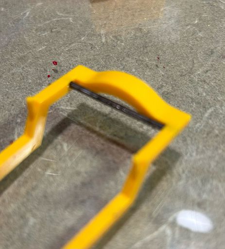

First up is the front. I devised this trick on another Monogram T build I have going. Most people if they aren't familiar with the kit might not realize where the change was made, put it actually gets you about a 2-3 inch scale drop. I removed the flange molded to the bottom of the grill shell that has the tab for mounting the front spring by making a vertical cut, flush with the front surface of the shell. It's a delicate piece, so take your time. I protected the grill shell with tape. here you can see after the cut.
1700571153832
Then I took the flange and sanded the ends until it fit between the uprights of the shell. Then I glued it in it's new home. Compared to the original shell you can see the drop.
1700571162867

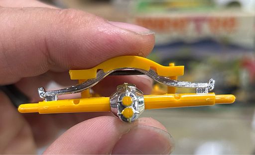

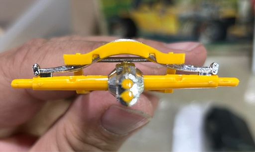

The drop in the rear is more subtle, probably only losing 1-2 inches of height. But it's simple to do and worth it. Here is the unmodified assembly.
1700571165272
First thing is to cut the tabs on the bottom of the spring that attach to the axle. Then I removed material from the underside of the crossmember to allow the spring to slide up inside it, and cut small C notches in the frame rails to allow clearance for the spring to move in real life.
1700571167028
