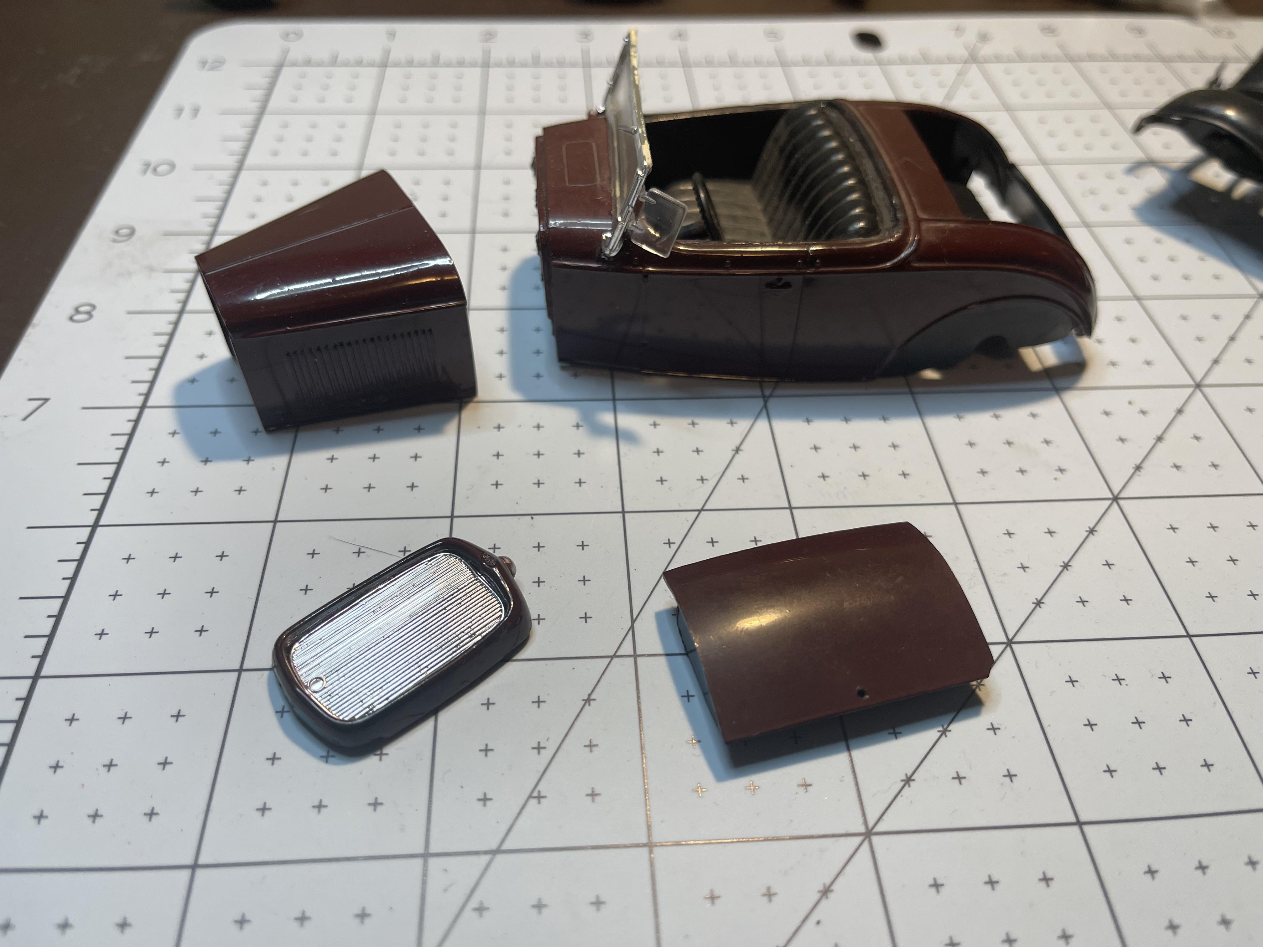

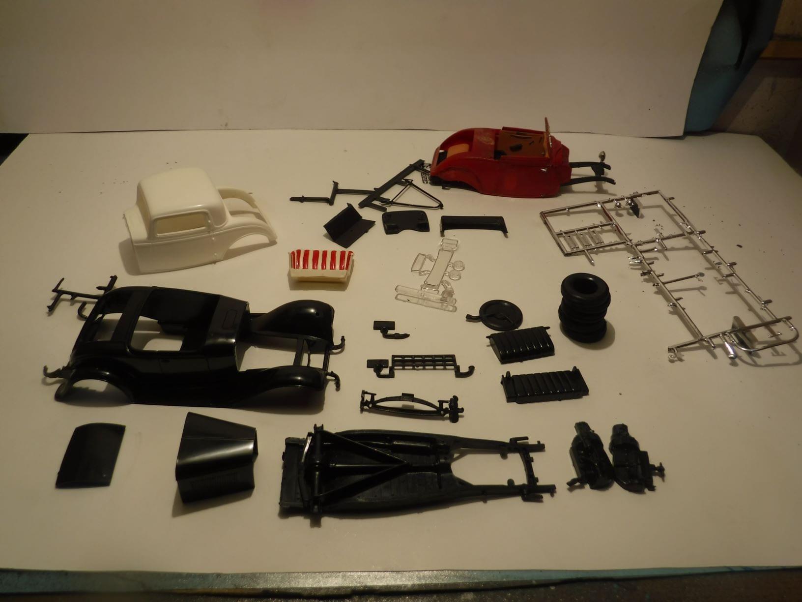

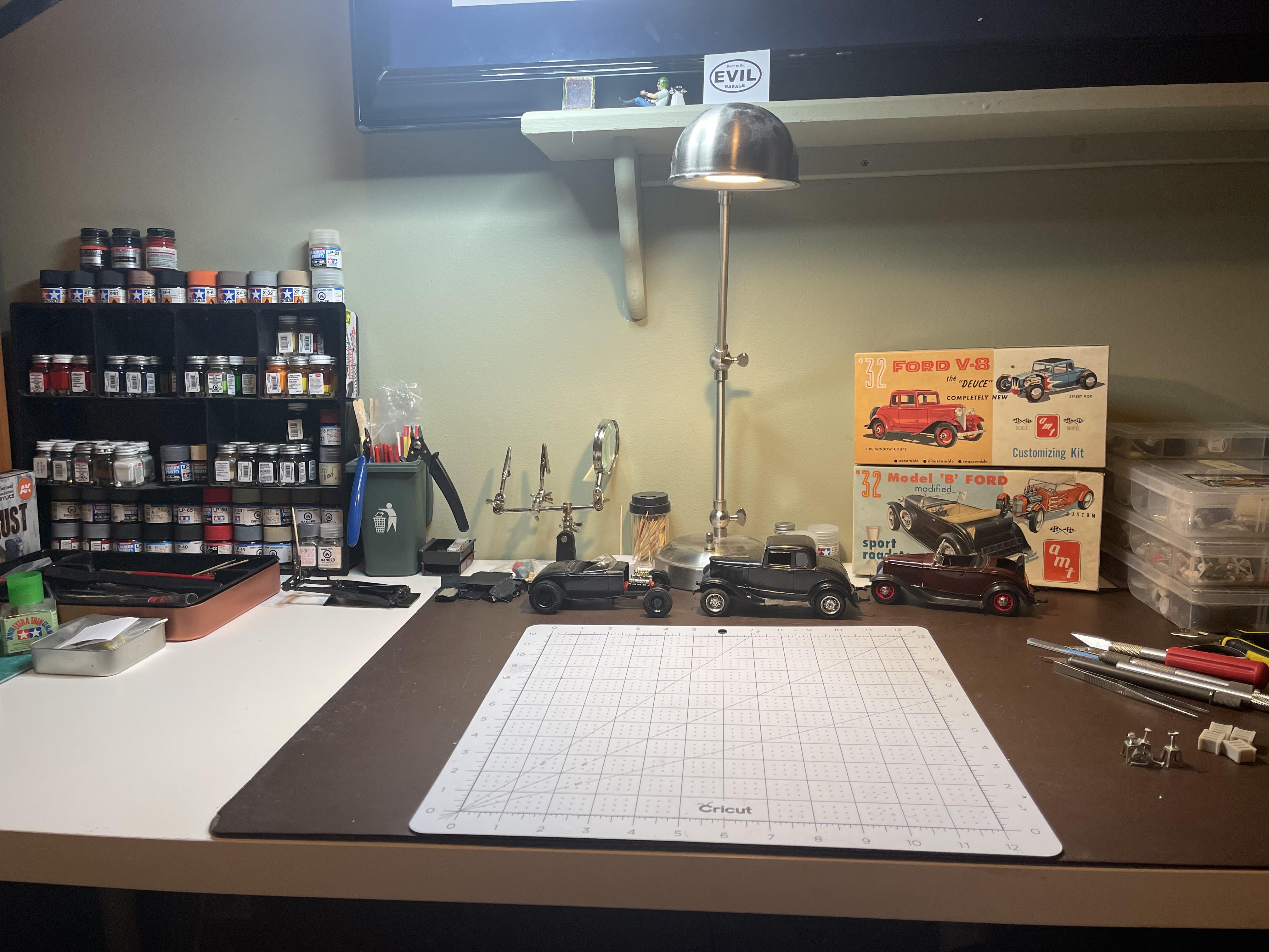

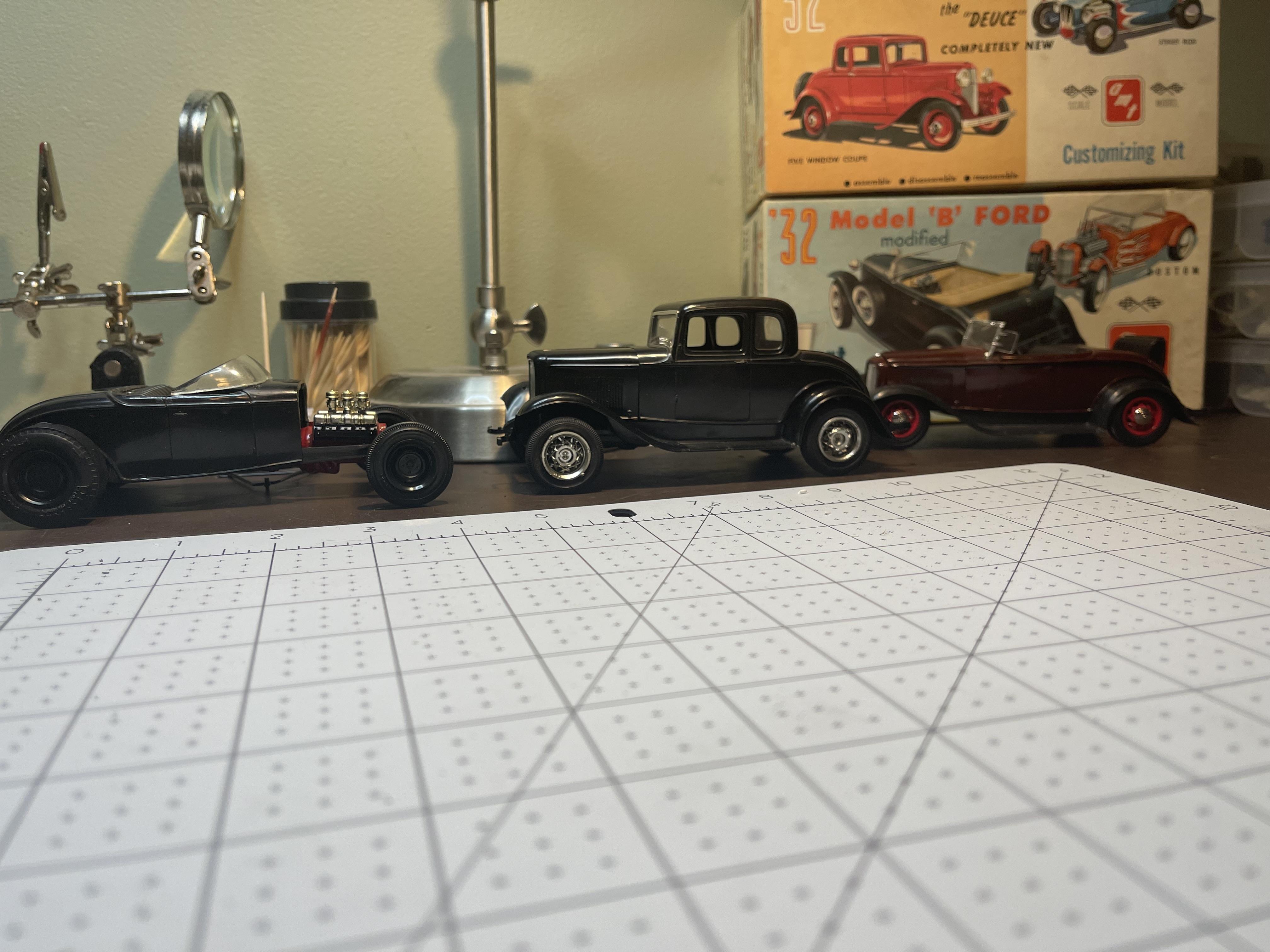

Bullybeef Posted October 31, 2023 Posted October 31, 2023 (edited) Well folks, after a short hiatus from building I’m happy to say I’ve got a bench again. I have tools paint and supplies and the only kits that are not still in storage are these three vintage Amt kits, first release roadster, first release coupe and a second release roadster that will be getting a sympathetic restore. Also snagged a first release built up roadster and a complete first release Vicky. But these are not the reason we are here today. After lurking in the shadows with nothing to show I started scheming… and started an idea to build what in my mind is a combination of some of the best parts that Revell has offered to date. To start with will be the 32 frame from the 29 roadster. While the frame in the new release 32 roadster is just as good, I like the underpinnings of the 29 kit. Engine has yet to be decided. I have purchased 2 new kits to start pilfering parts from, the aforementioned 29 roadster and the new release of the 32 roadster. My goal is to maybe finish at least one model this year. On to the pictures. Edited November 10, 2023 by Bullybeef Spellinq 5

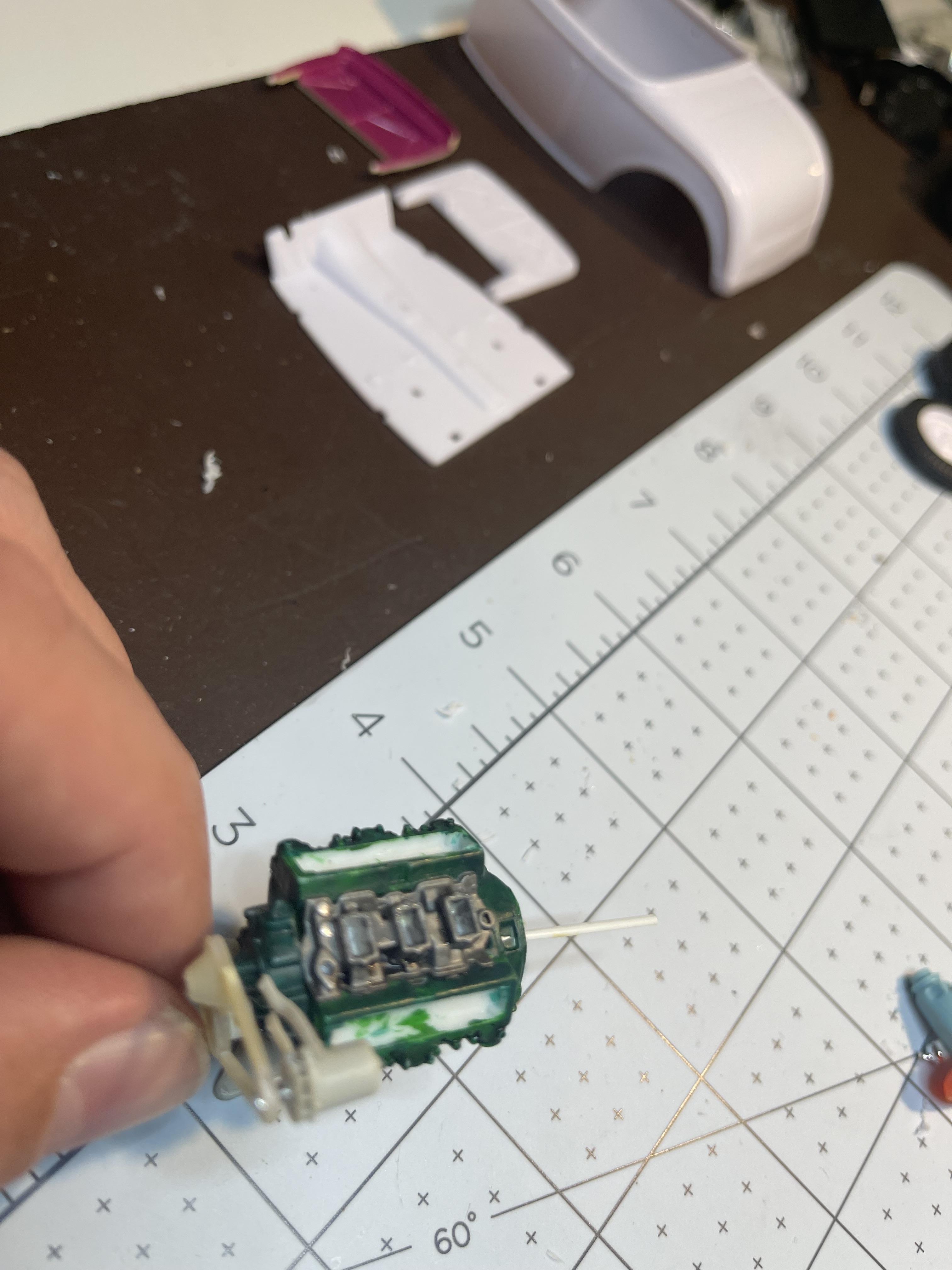

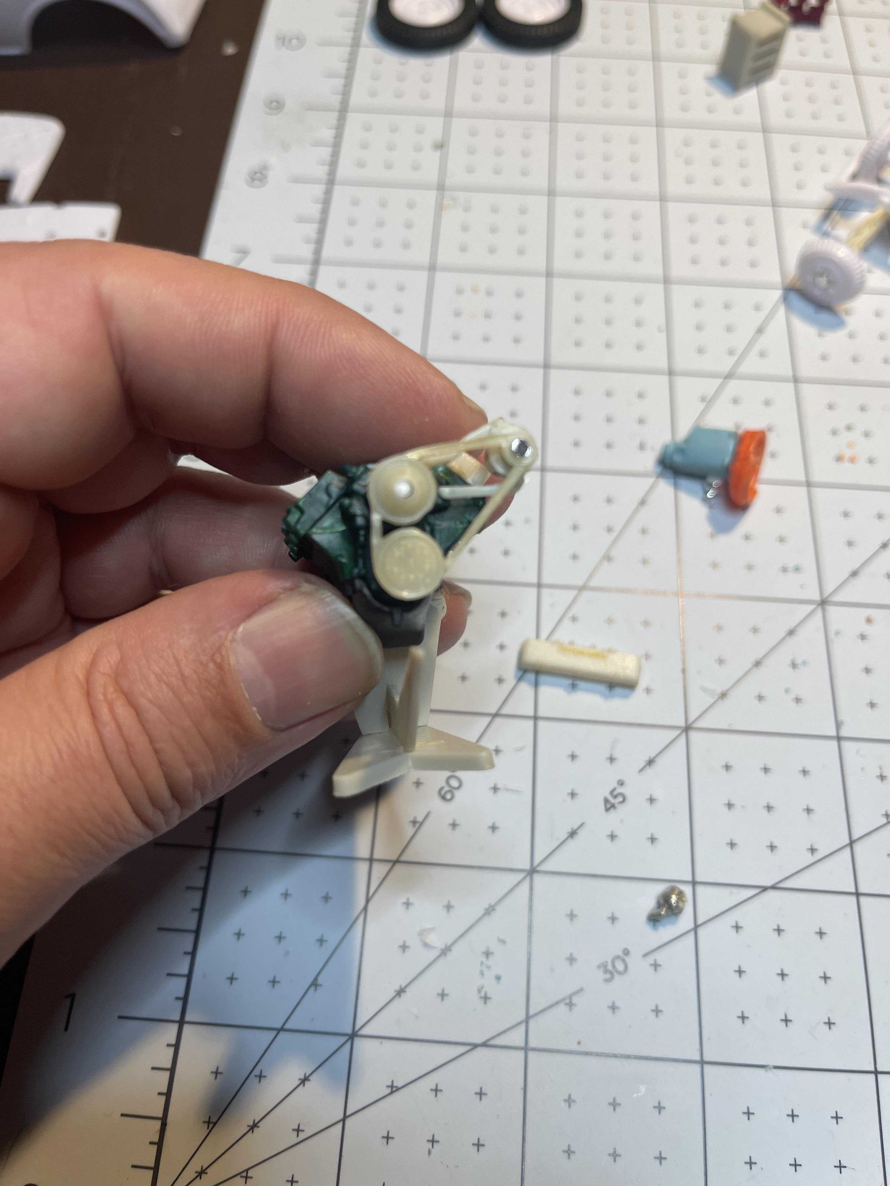

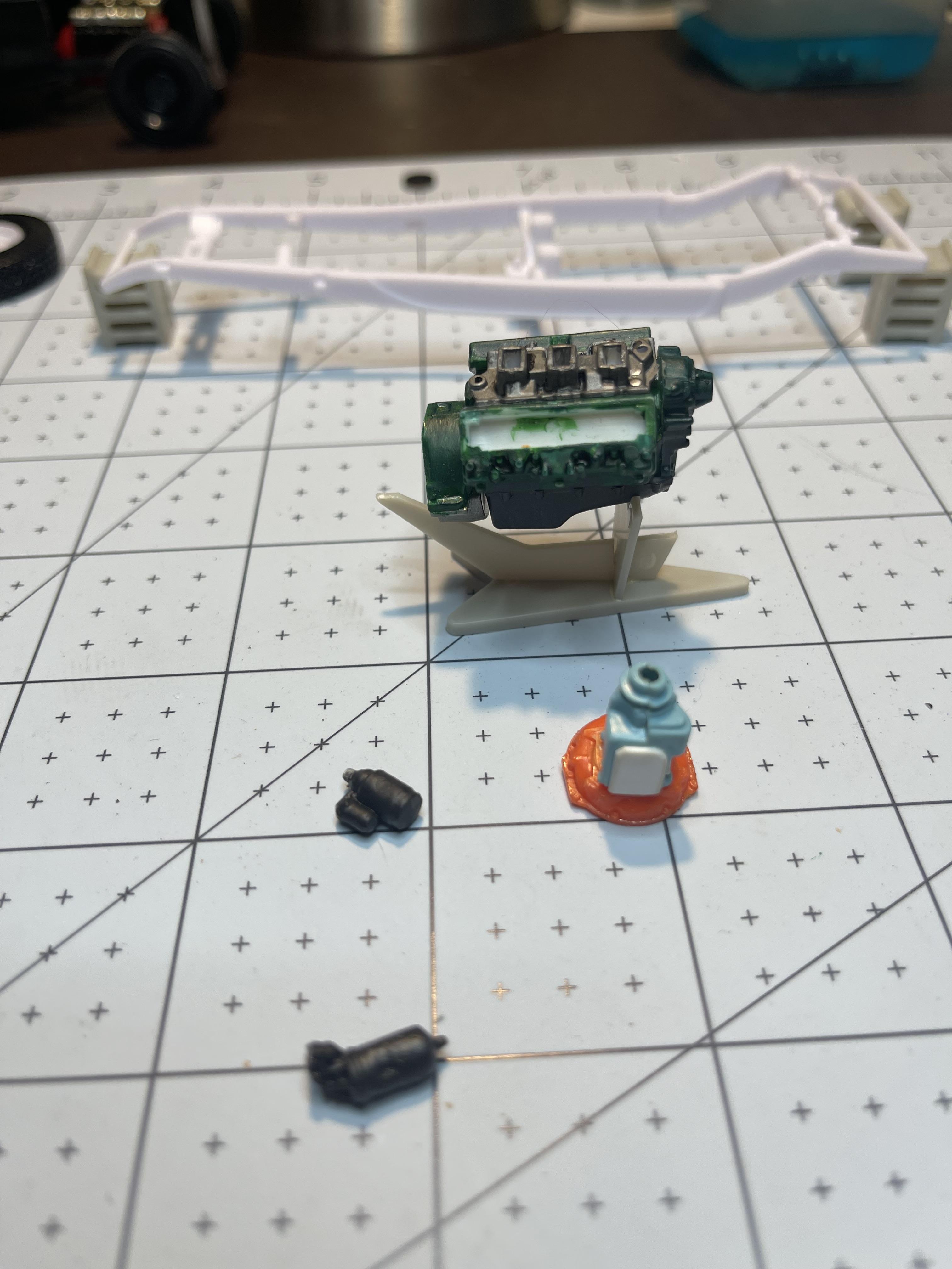

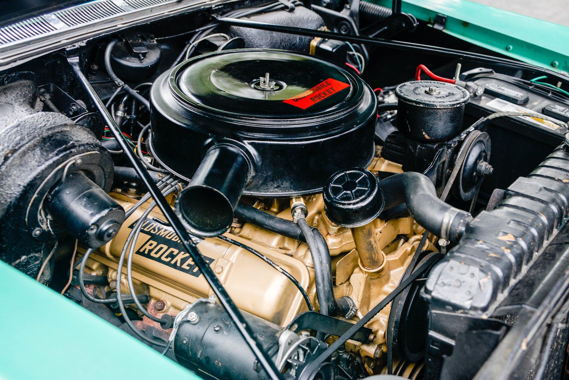

Bullybeef Posted November 1, 2023 Author Posted November 1, 2023 (edited) Olds rocket sourced, and an adapter made for the cad lasalle gearbox, valve covers are soaking in Windex to remove the centuries old chrome. They are a rather special set and I think they will add some wow factor to this engine. Picking through bins of mall parts has consumed some time to find all the right parts for this engine, still searching for a lower pulley and water pump pulley setup that looks right enough. Edited November 1, 2023 by Bullybeef 5

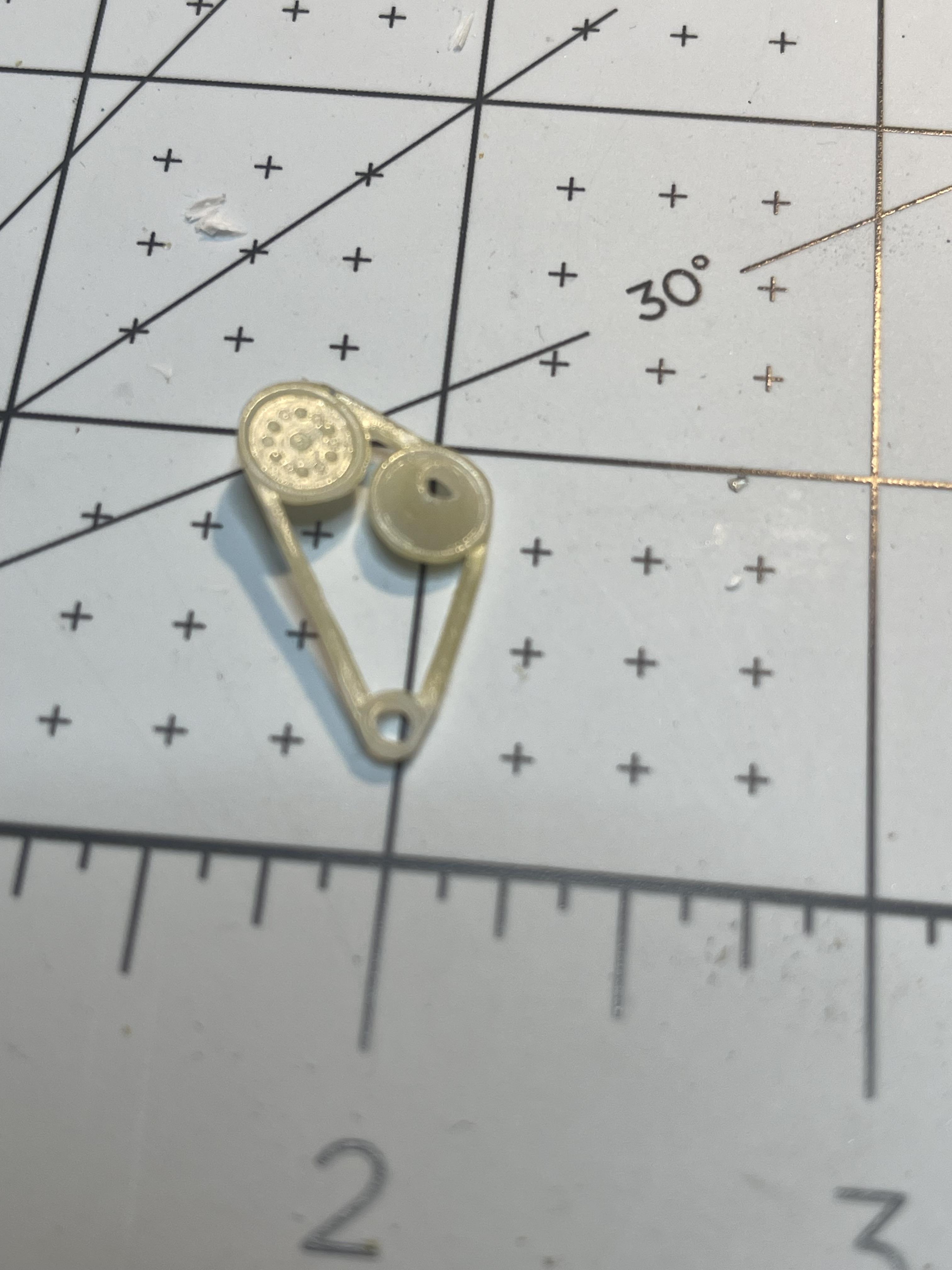

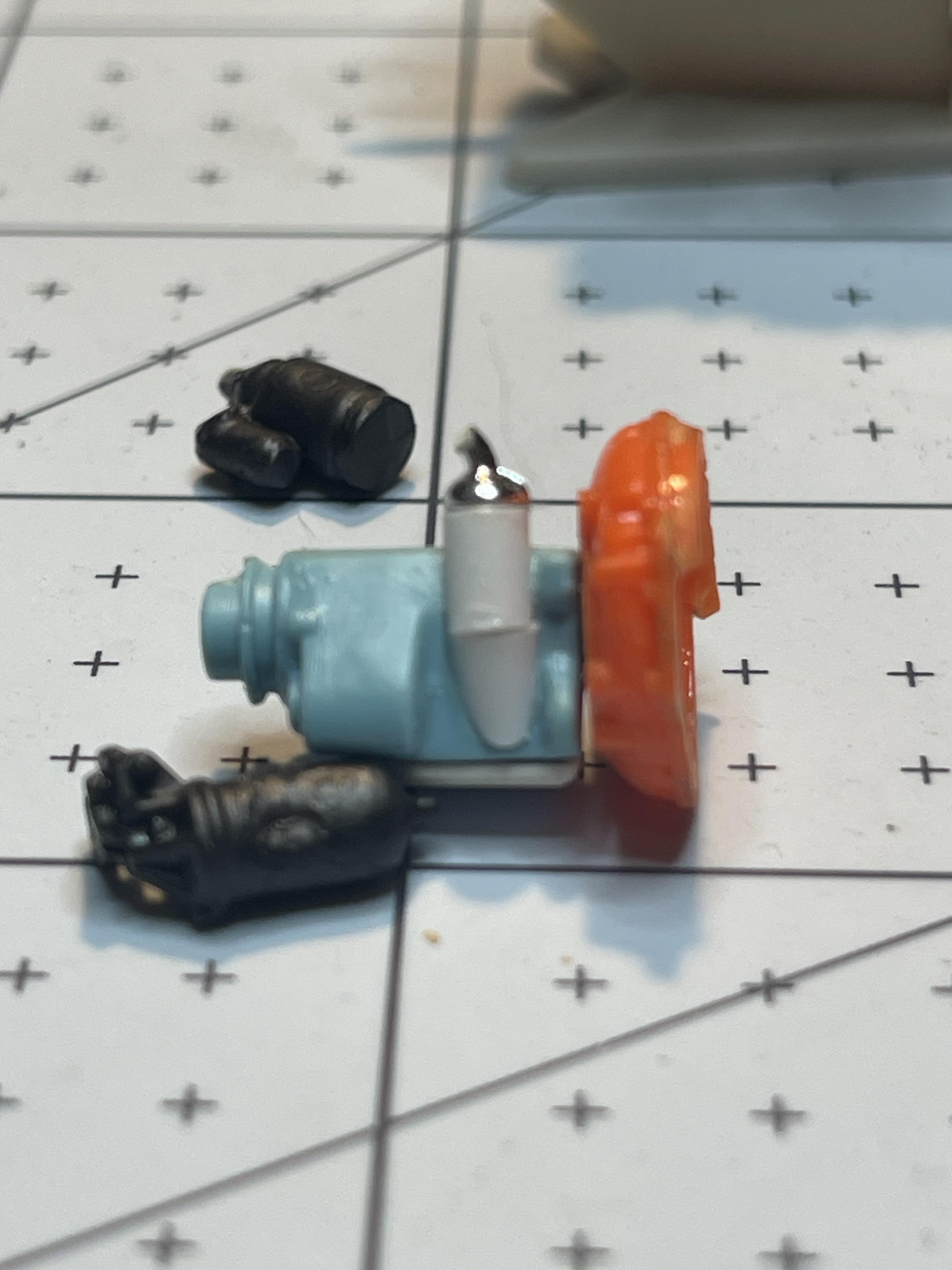

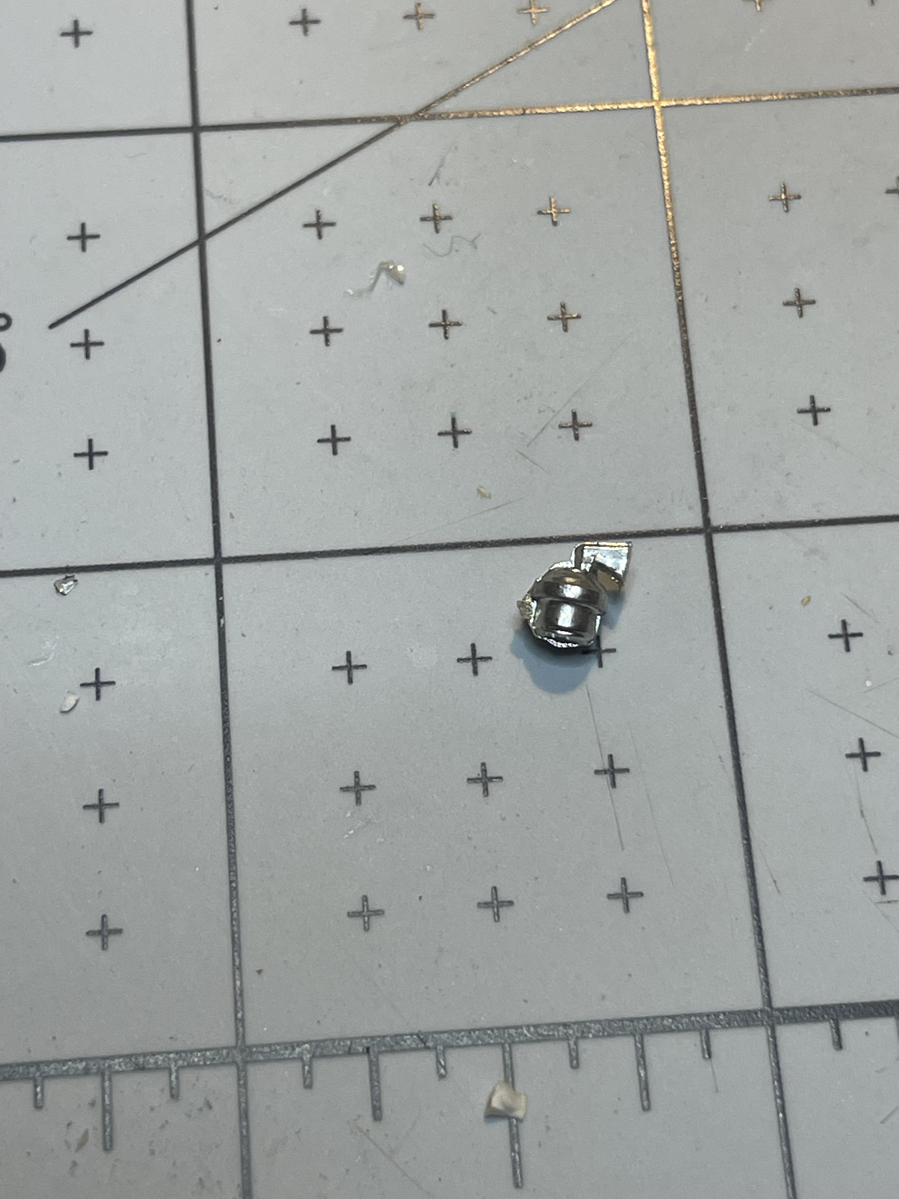

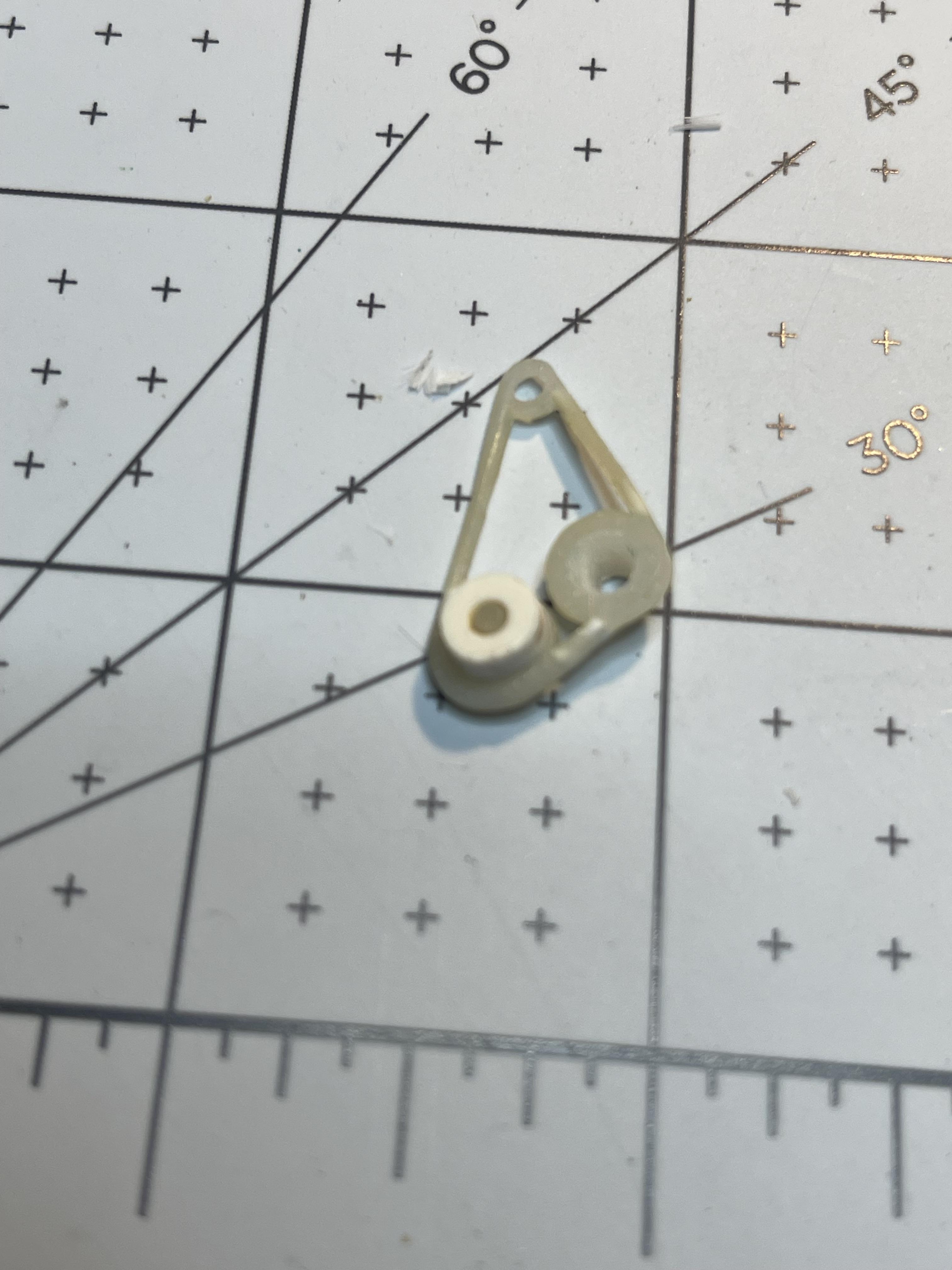

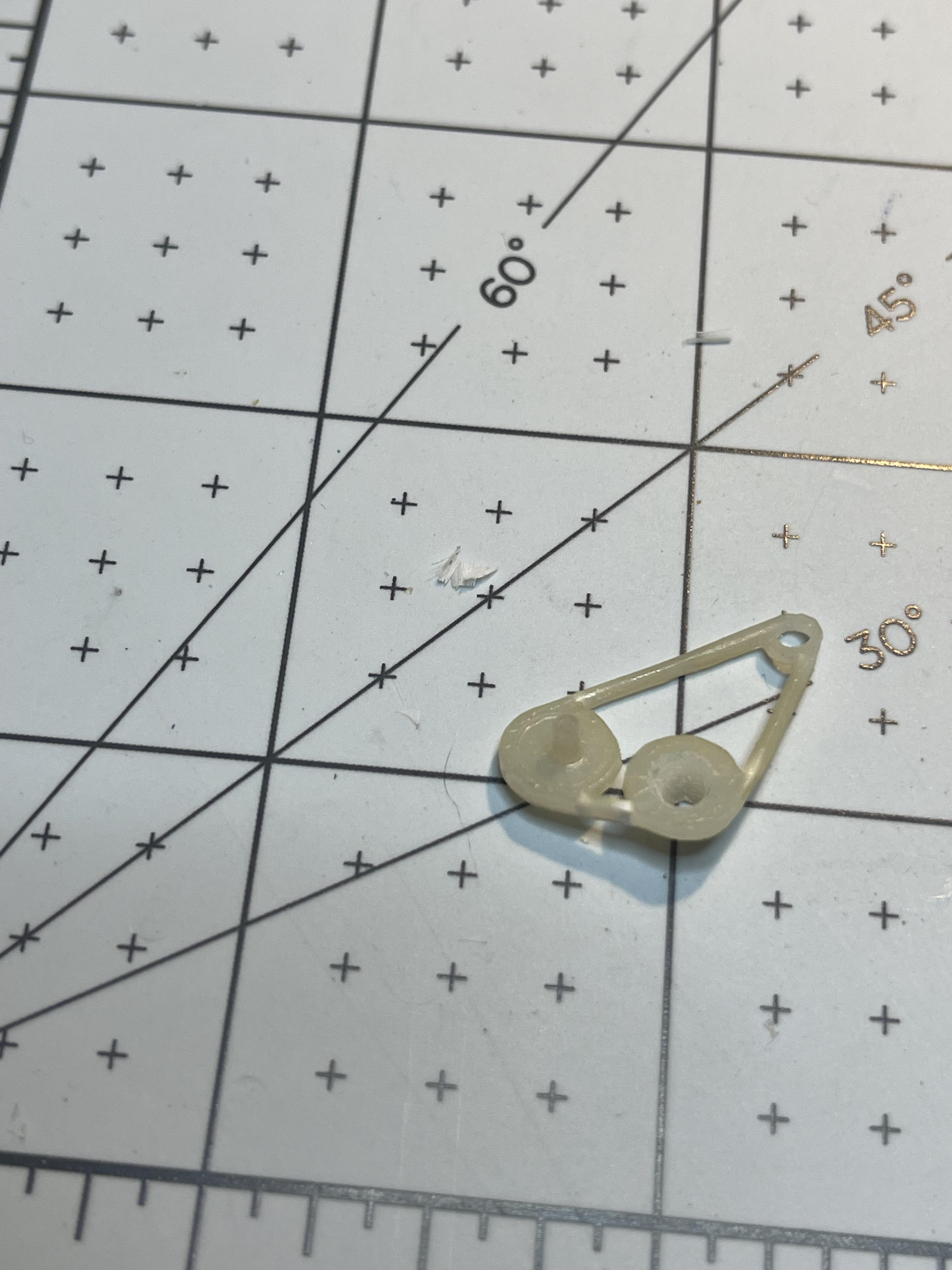

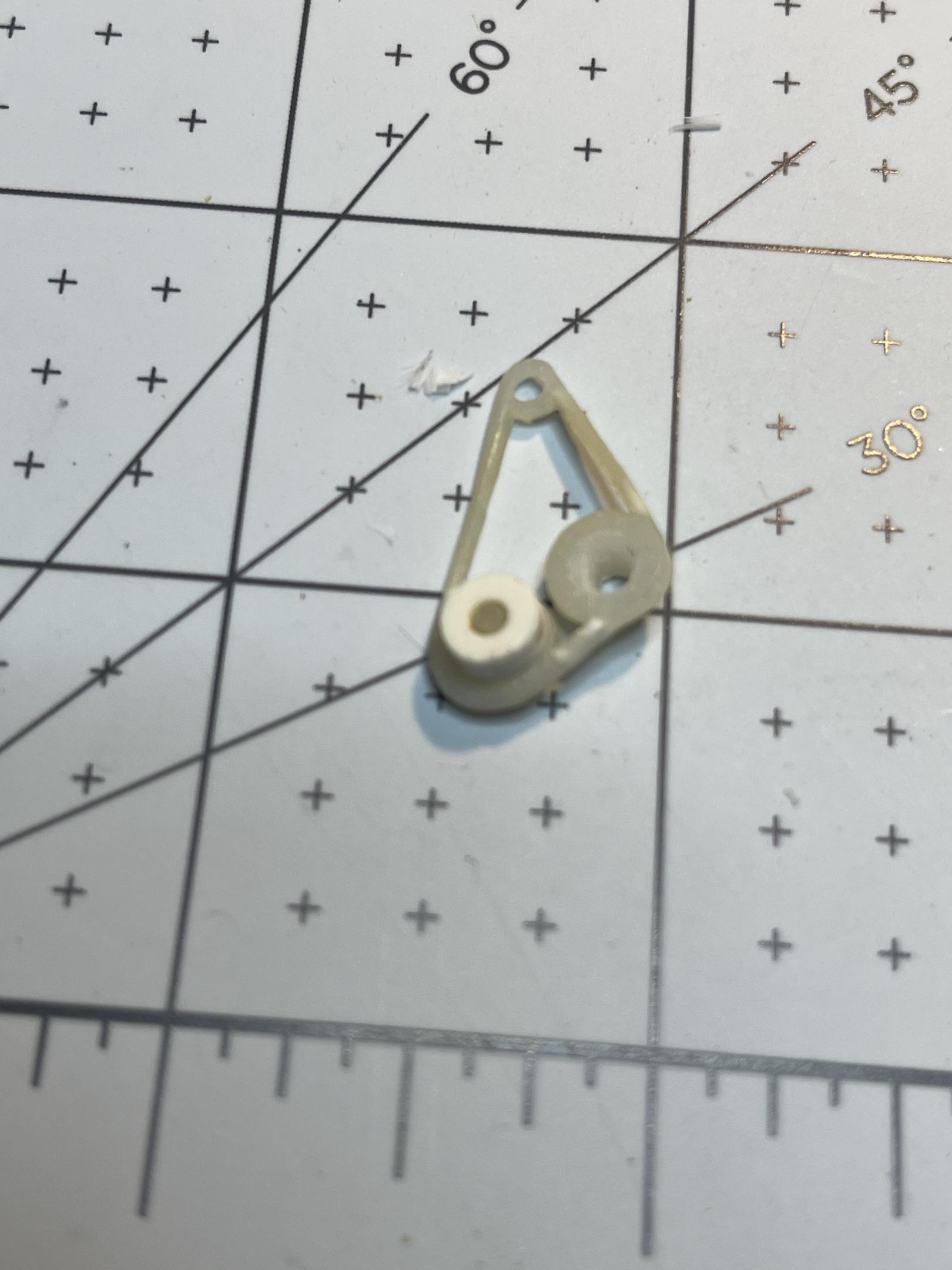

Bullybeef Posted November 2, 2023 Author Posted November 2, 2023 Today I focused my labour on the small things, the small annoying details that never seem to be right. Like the missing fuel pump from the kit engine I found, the missing waterpump and crank pulleys, the generator mount. Breathers for the valve covers( boy those things are sweet) Well after a lot on interwebbing (felt like spiderdude) I found resource pics and then the laborious task of sifting through bins of organized spare parts (I even hate myself for that(dang ocd/adhd))I found useable and serviceable parts. Yay! The only small part I could not find was a decent olds looking distributer( that’s okay we can use a magneto right!(RIGHT?)) Ok enough story time, it’s time for pics 5

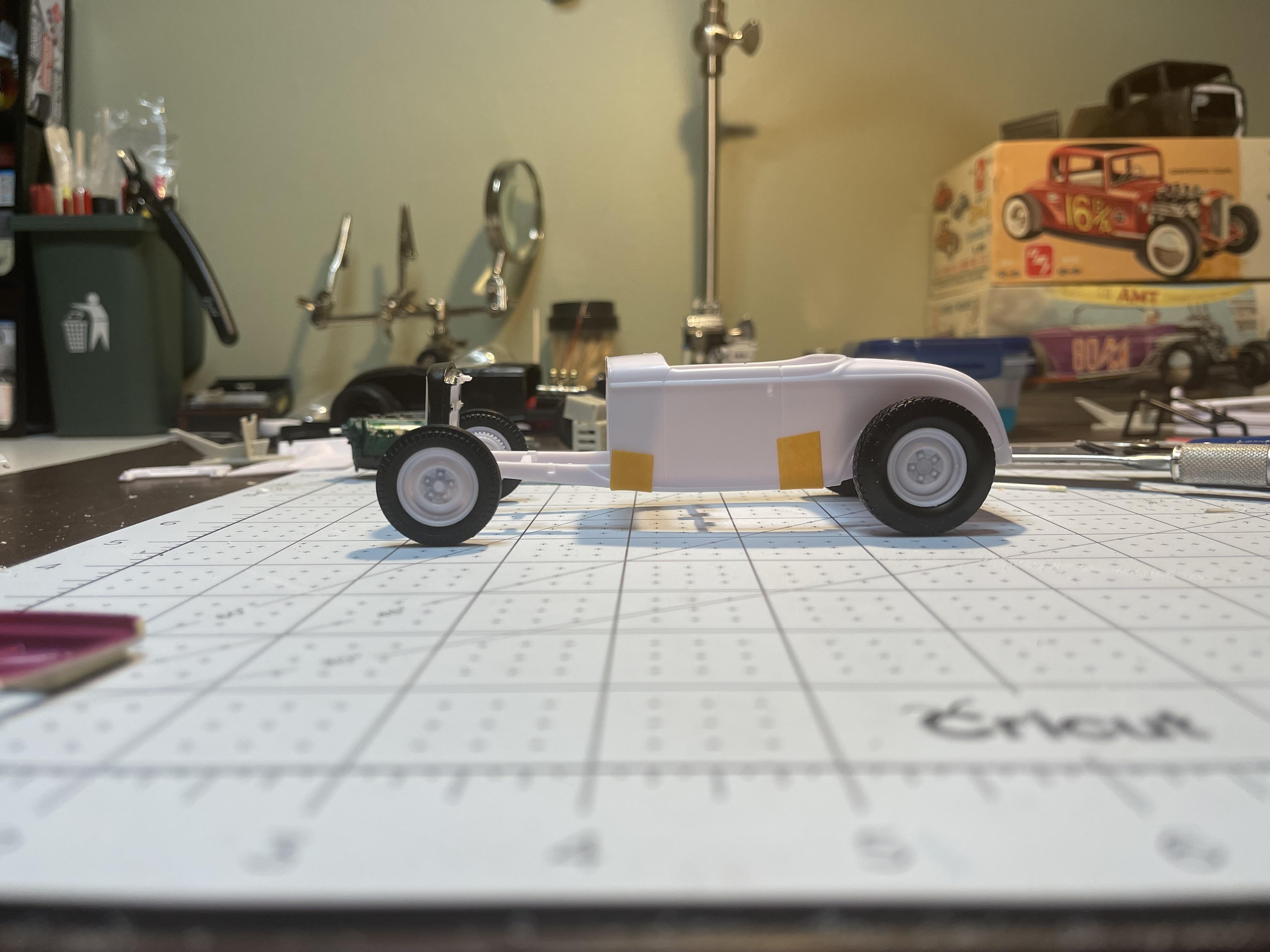

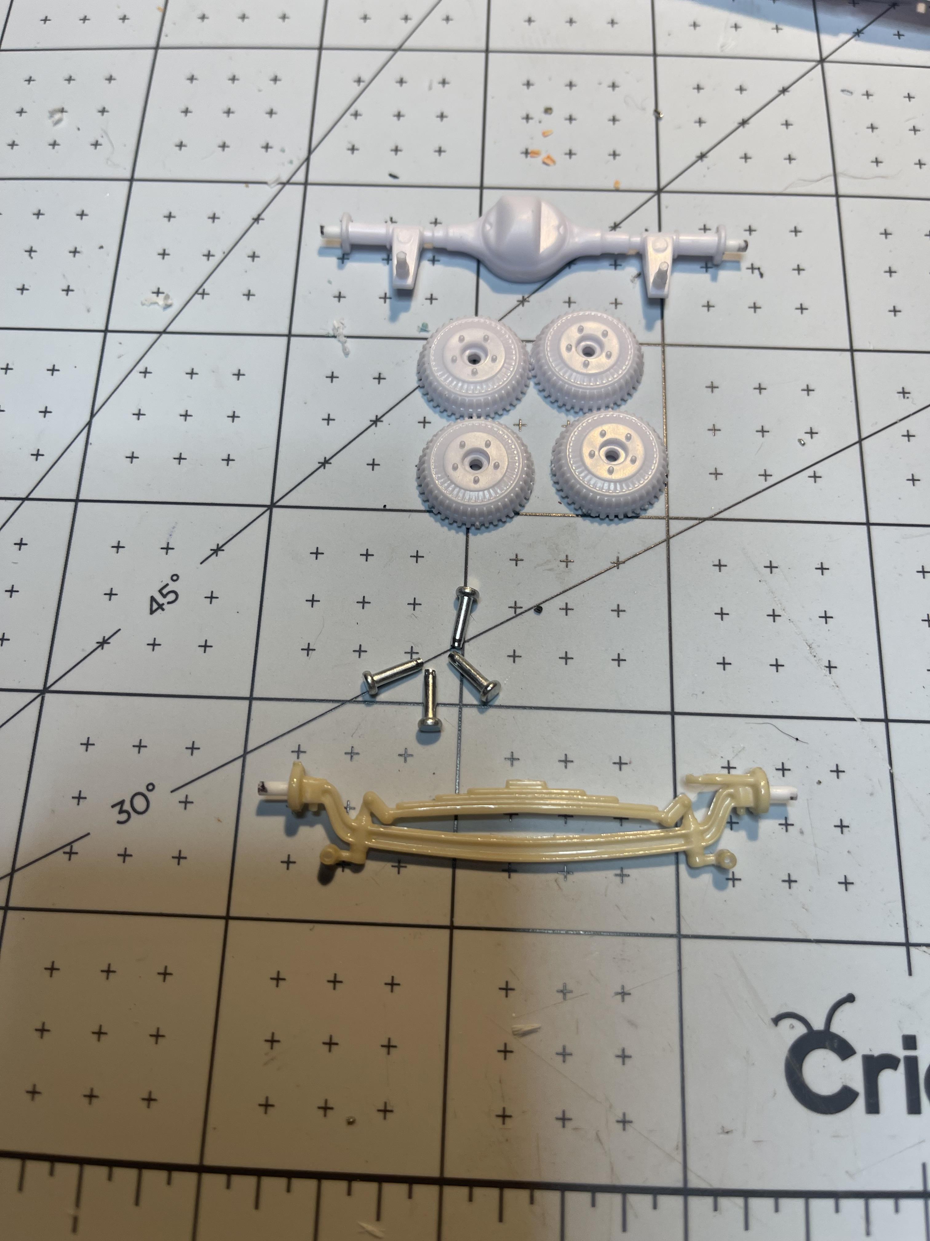

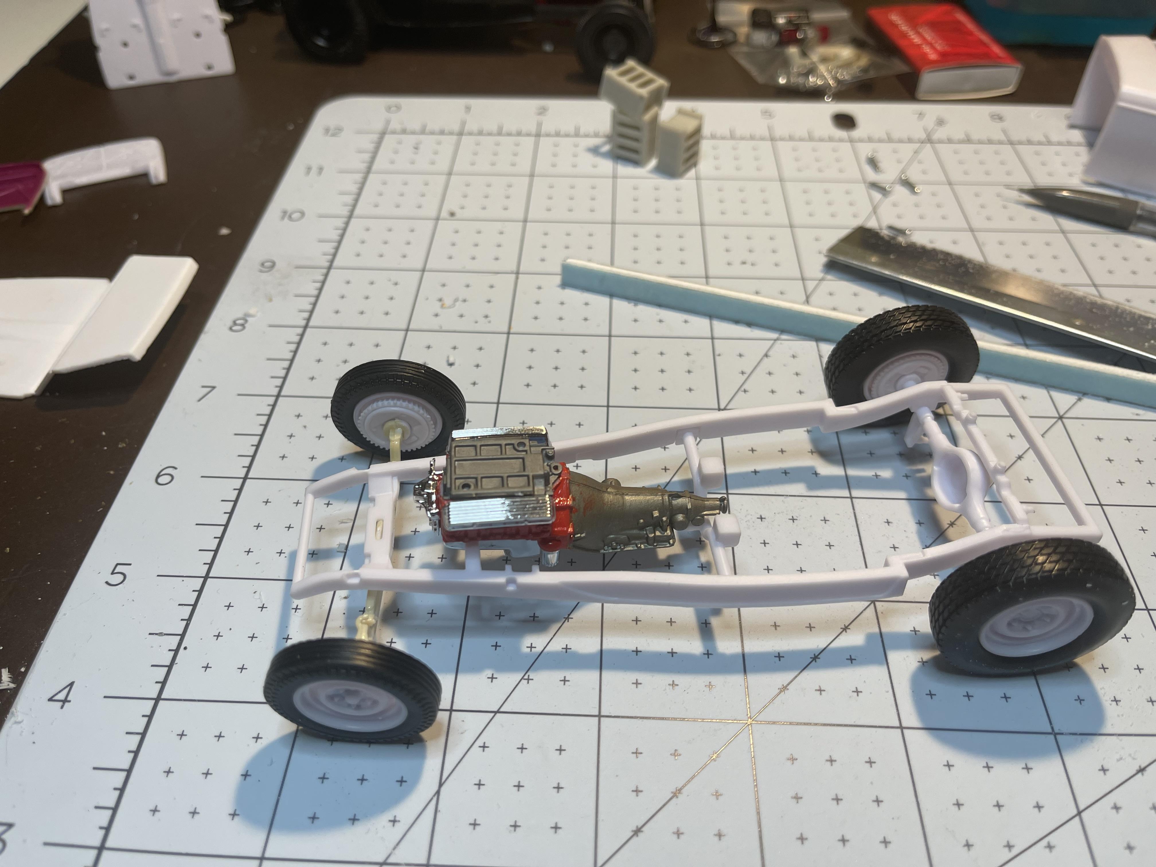

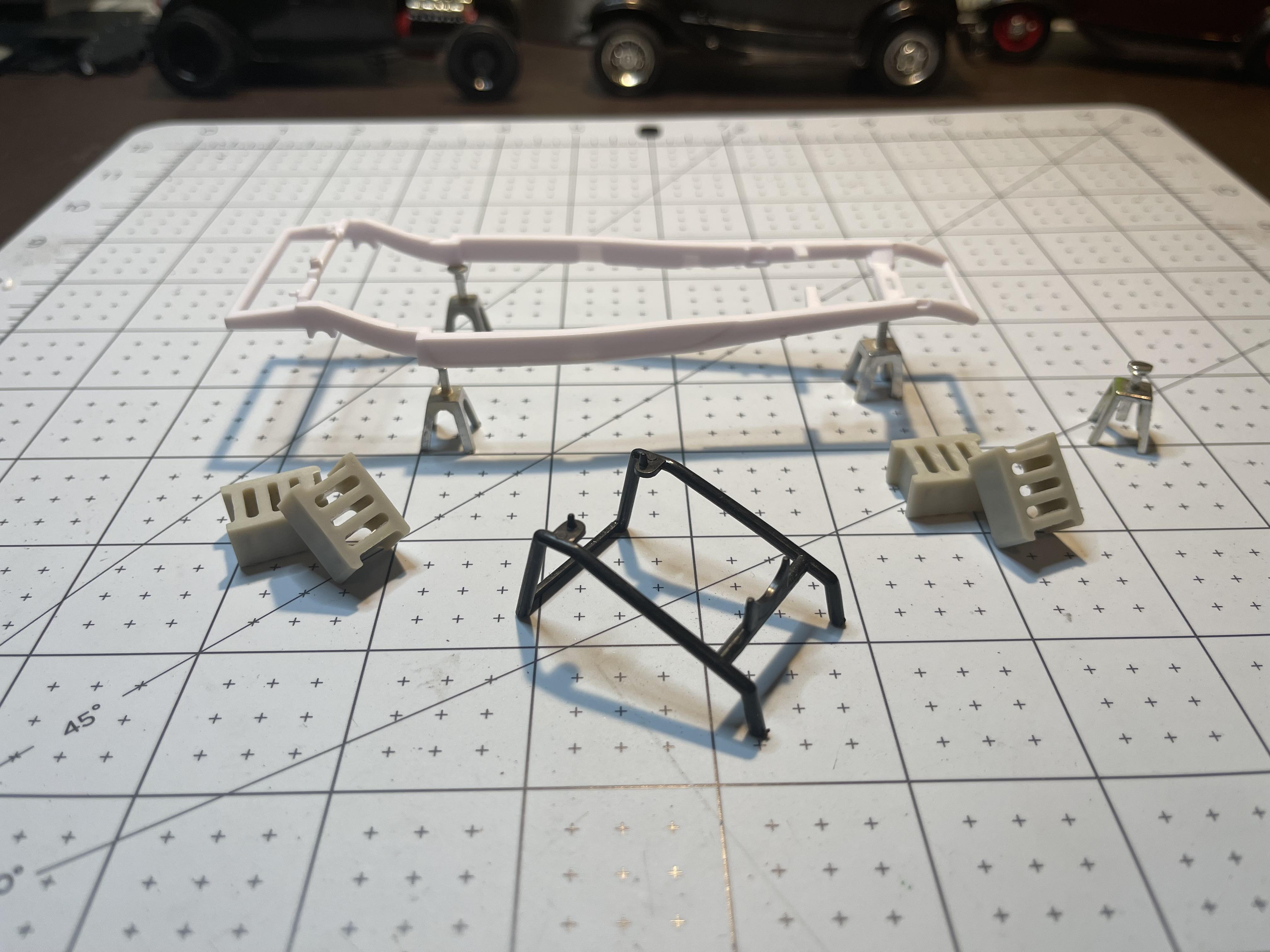

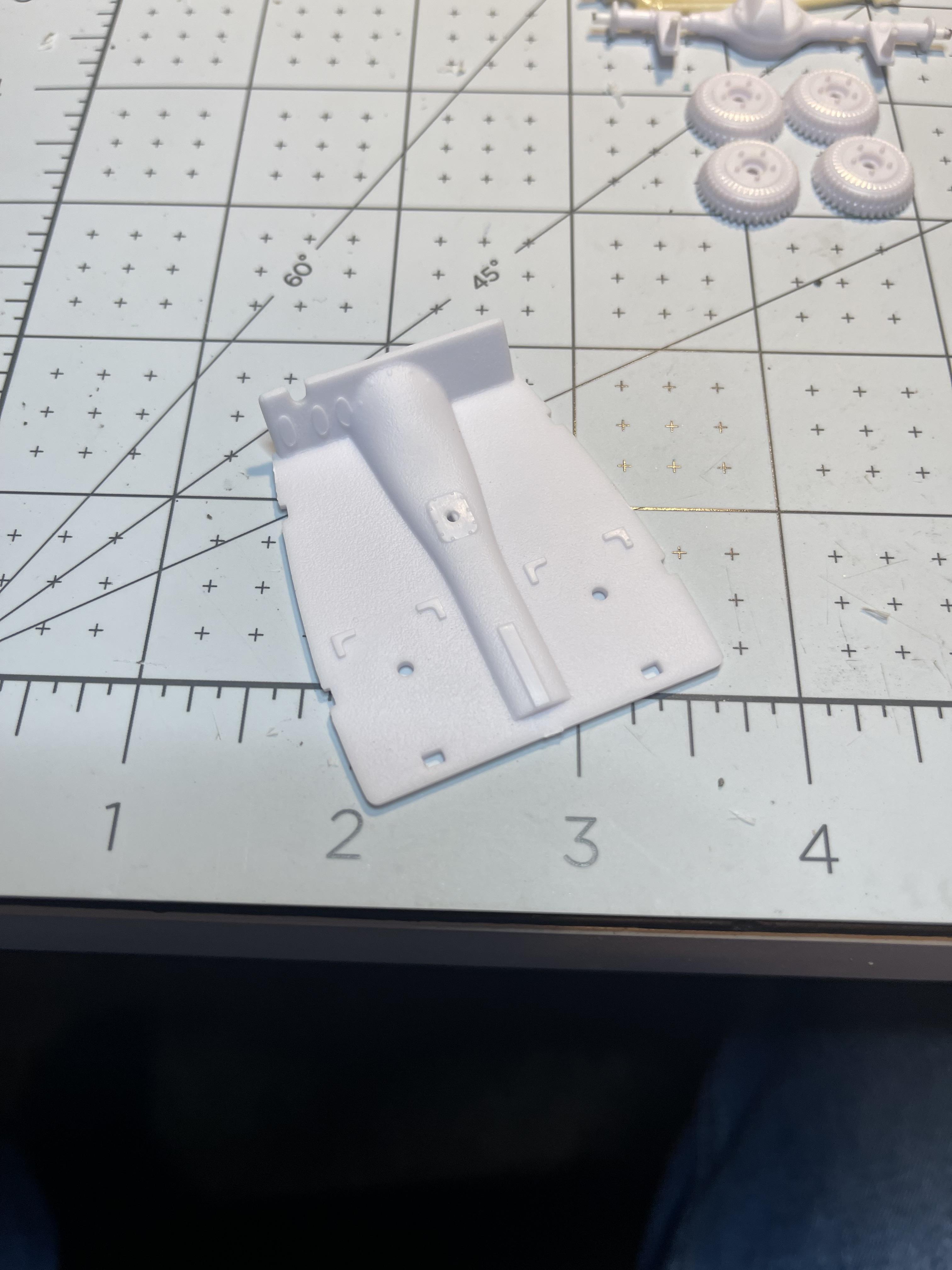

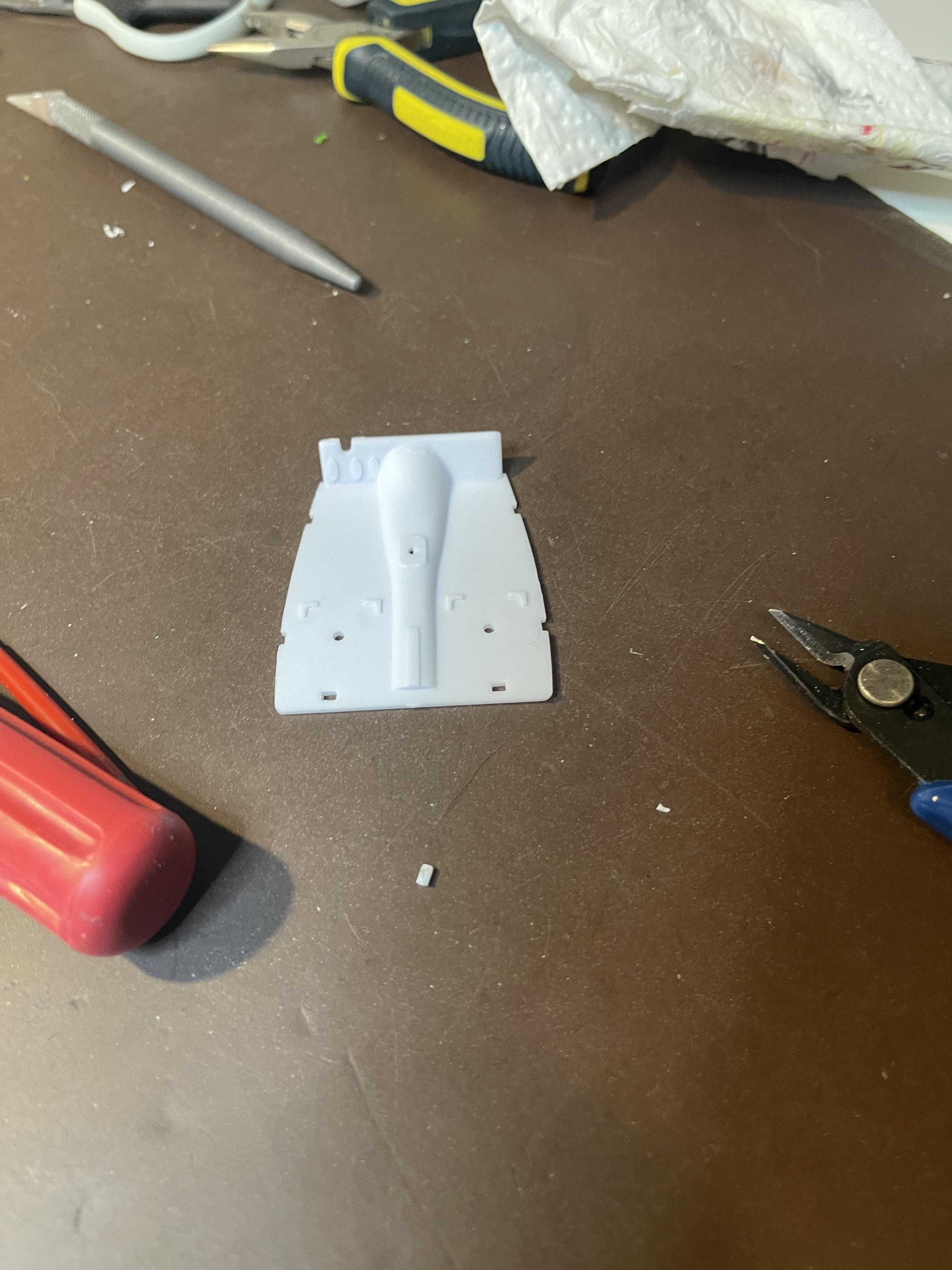

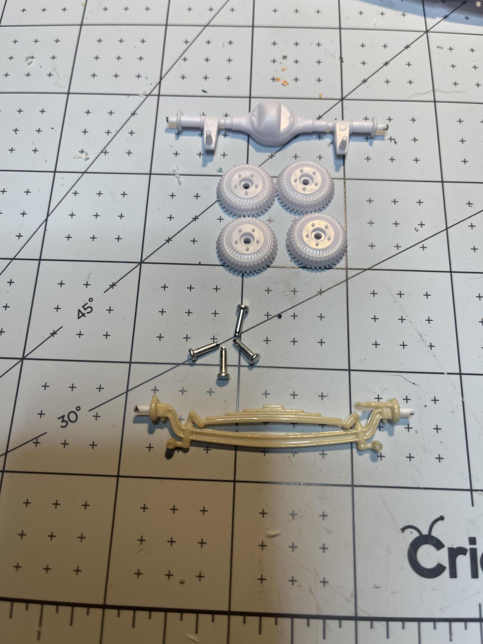

Bullybeef Posted November 3, 2023 Author Posted November 3, 2023 Alrighty then! So I’m going to visit my storage facility tonight, I need more parts so that means I’ll have to canabalize a kit. The floor pan from New roadster has the shifter gate in the floor for a very rear set shifter. It won’t do so we will toss that… well maybe we will save it for something else. So iirc I have multiple 32 ford kits and parts to choose from( hopefully the box is not at the bottom of the pile) so I think the 5 window floor pan is pretty plain so I can plunk my shifter hole down where it’s needed. as for actual work I decided (as should anyone using the 29/30 kit) to toss the metal axle pins in the trash and to use some good old 1/16 rod to affix the wheels. So once I find my low tack fun tack to affix the wheels temporarily I’ll be able to get the frame and suspension up on wheels to check my ride height. I had a thought to make a highboy roadster( it was short lived) I’ll most likely end up doing a nice wedge channel. The last pic is not quite where I want it yet… I just sat down and placed some parts to get a general vibe for the car. Lastly a question: as the external dimensions of the engine are quite similar between the engine sizes should I build the early 50’s rocket in green, the red rocket or the golden rocket? I have it in green atm but that’s only a quick dunk in the purple pond to rectify. lemme know your thoughts . The car is a blank slate I have not even looked at a colour yet. 1

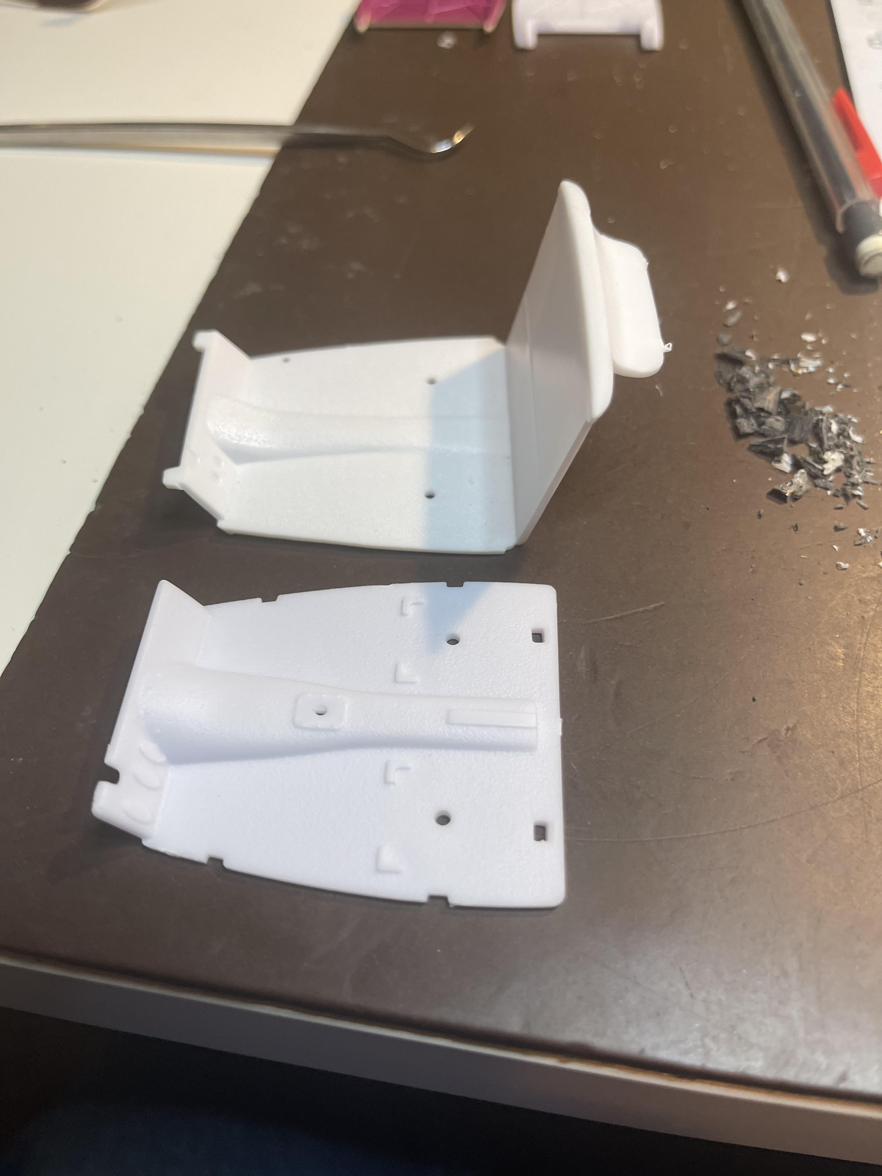

Bullybeef Posted November 4, 2023 Author Posted November 4, 2023 Great success! I found the piece I’m looking for! It will get some trimming and fettling but it was in the top box so I didn’t have to forage too far. 1

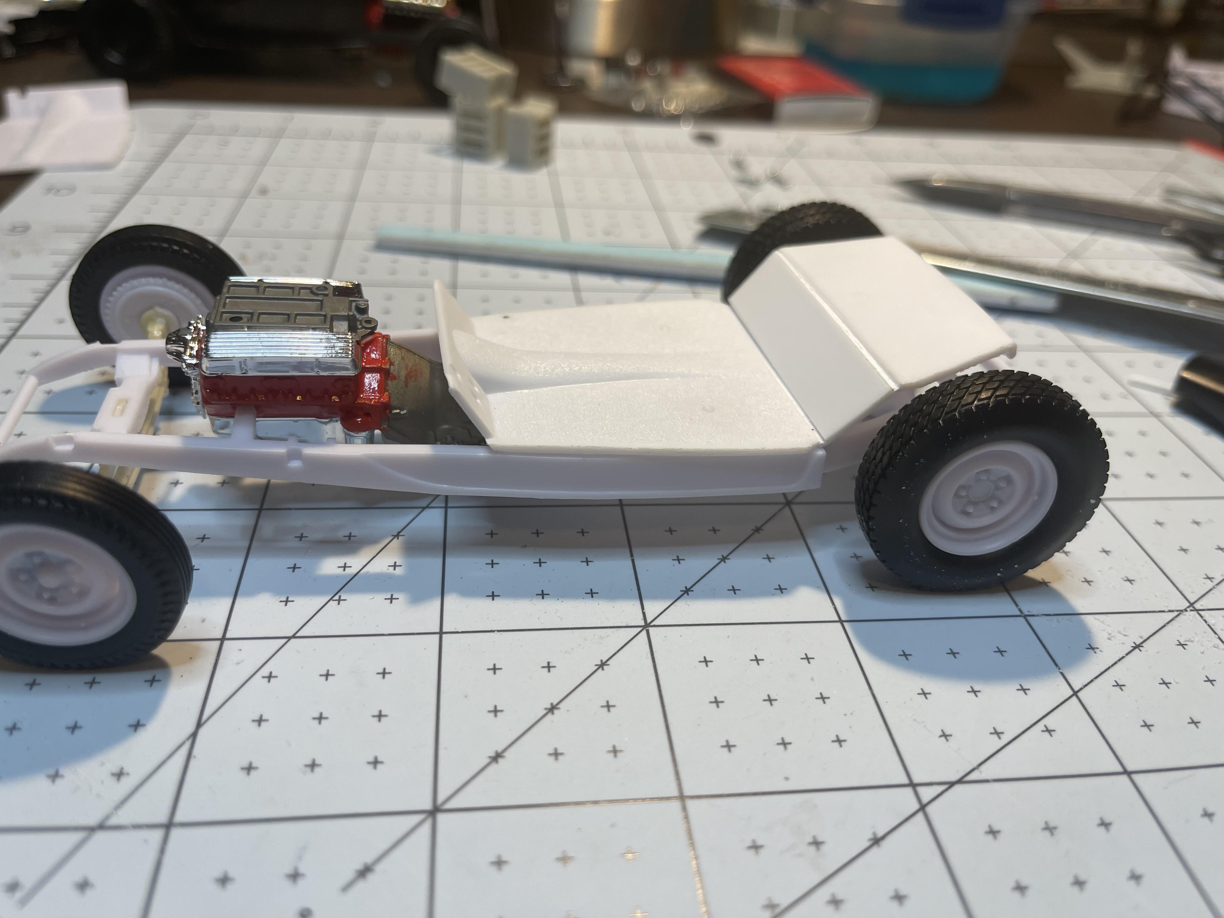

Bullybeef Posted November 4, 2023 Author Posted November 4, 2023 A little nip a little tuck, a bend here and a bend there. And the floor pan is acceptable. I tossed in a half built chebby to make sure I had the right setback of the pan and proper clearance of the trans. I’ll have to temp assemble the rocket and test fit that. And of course the ride height will need attending too. But I have some tricks up my sleeve somewhere… now where did I put that jacket that had sleeves with tricks up them? 2

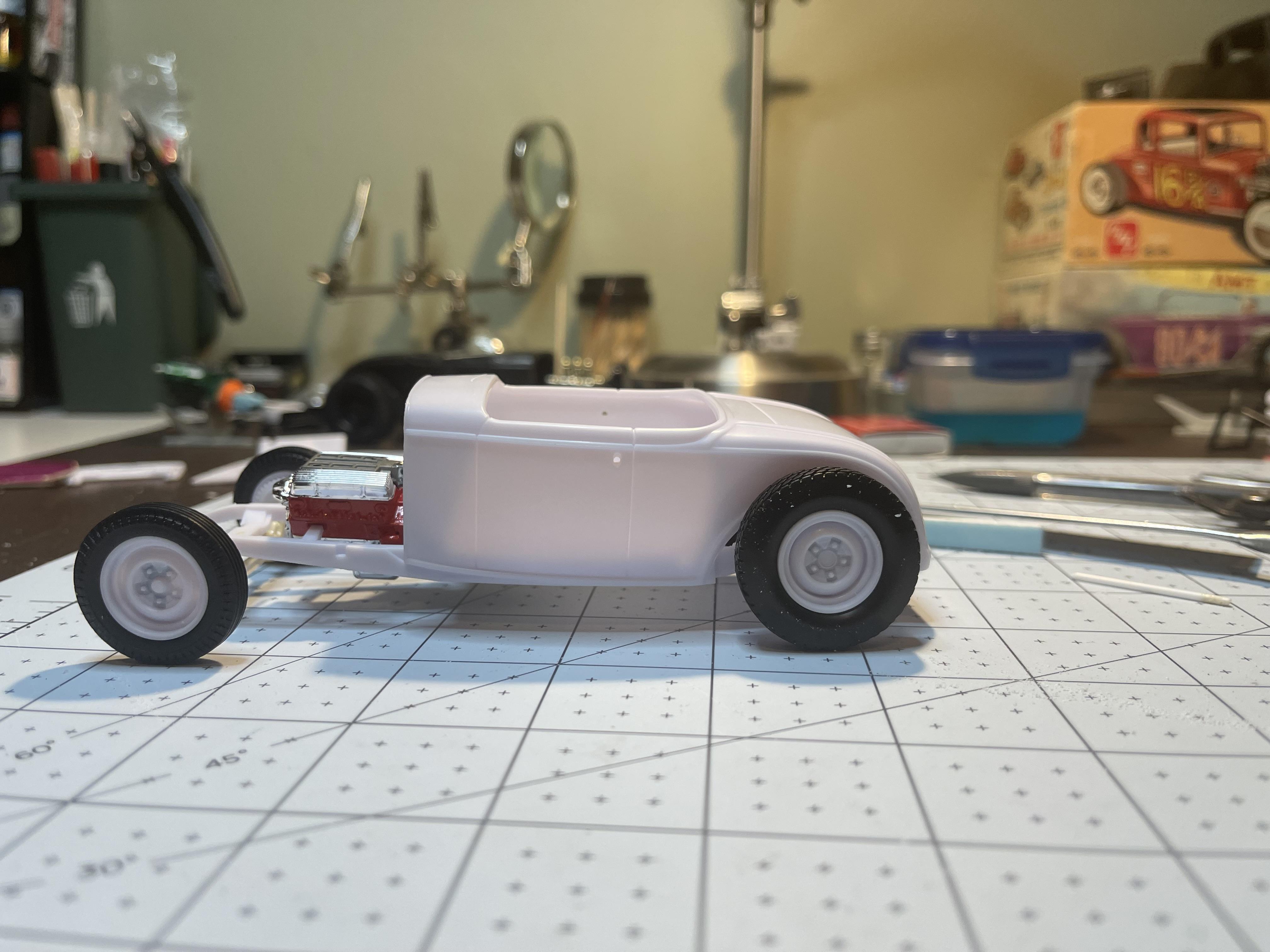

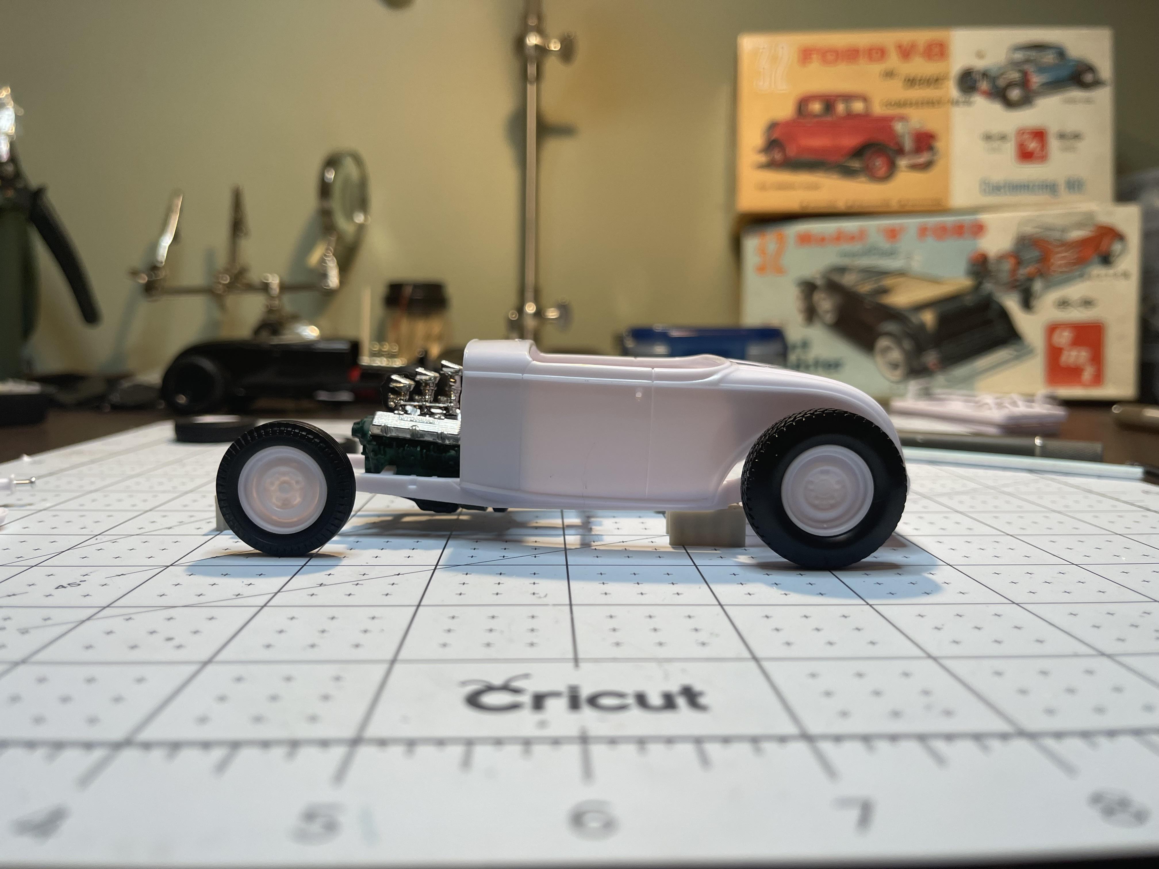

Bullybeef Posted November 4, 2023 Author Posted November 4, 2023 Last one for the night! Channelled just right, bottom of body is dead even with bottom of frame, I’ll lower the front about an inch to have a little nose down rake. Just have to check the oil pan level and make sure I still have good driveshaft geometry. 3
