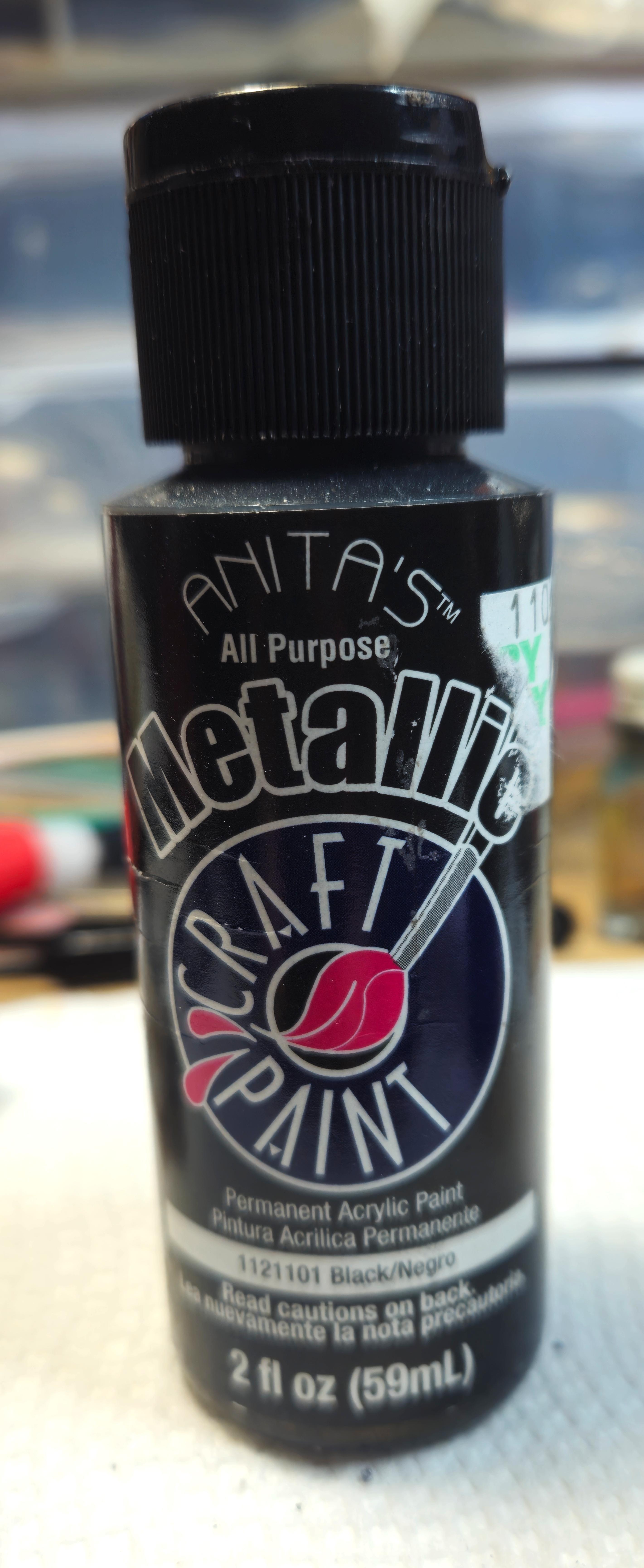

TransAmMike Posted October 31, 2023 Posted October 31, 2023 Have not used the FolkArt but did use this with great result. Gonna do another model with it soon. Sorry for the huge picture.

Dave G. Posted November 2, 2023 Posted November 2, 2023 (edited) On 10/31/2023 at 11:37 PM, bh1701 said: Monty, Here is the recipe one of the members gave me for a homemade thinner for craft paints. Please note that his last sentence mentions that DecoArt paints don't do well with this recipe.: 60% bottled or filtered or distilled water. 40% 91 IPA For every 3 oz of this blend put 4-6 drops of Liquitex retarder. (The Liquitex retarder is their Slow Dry Retarder Fluid, not their retarder medium. The medium is not for airbrushing. I bought this retarder from an online store since neither Michael's or Hobby Lobby carry it.) For every 3oz of that blend put in a trace amount of Dawn dish washing liquid ( Just a trace amount, not even a drop from the bottle. Use the pointy end of a wooden barbecue skewer and just get a film on the end and mix that in), this breaks surface tension in the paint mix. This blend Works in most acrylic paints but DecoArt doesn't like the alcohol. And many craft paints come closer to spraying like solvent paints with this blend. I have not used this formula yet, but plan on trying it with the next kit I use craft paint on. Thanks, Bart Yes that's my formula. Works great with FolkArt, Apple Barrel, Anita's, And real well with Craft Smart. I have another blend for DecoArt. Works well with Createx but better with a small amount of denatured alcohol added, since Createx 4011 reducer is very close to the same formula. Here is a Mustang with basecoat Rose Gold Silver craft paint shot with that formula. This is out of the airbrush untouched. The second photo should be the same body with Tamiya clear blue over the craft paint unpolished. And is a 39 Ford sedan in craft paint with Tamiya clear over it un polished. 49 Ford craft paint base and a combo of Tamiya Clear red mixed with a splash of Clrear Blue, 5 coats of the clear. This is not sanded or polished either. Edited November 2, 2023 by Dave G.
Dave G. Posted November 2, 2023 Posted November 2, 2023 By the way those are louse cell phone photos so there are jaggies and such that aren't there on the model or not magnified like that at least. I've since upgraded the phone.
Dave G. Posted November 2, 2023 Posted November 2, 2023 On 10/31/2023 at 11:45 PM, Pierre_tec said: Interesting, I heard about glycerin but haven’t about dawn! I have try many times, doing te famous spoon test,but never achieved a nice result. I follow a great YouTuber also a fellow member called Stumpy Grumps Scale speed shop that he paint mostly craft paint with amazing results. Glycerin works. Dish soap is quite old school but I like it. The key with any of this stuff as flow aid is don't over do it. Honestly I like the results I get with dish soap better than glycerin. But that's me, someone else might think otherwise. You can also add commercial flow aid, like Liquitex or Vallejo. Again carefully. The biggest key in the formula in terms of additives, I make up is the Liquitex slow dry fluid retarder. That stops the tip dry with craft paints and artist acrylics. Don't mistake Liquitex retarder medium for the fluid, they are two different products. 2
