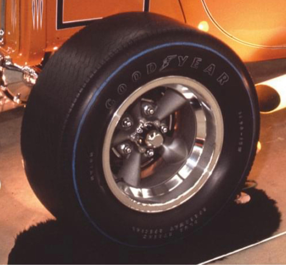

Ace-Garageguy Posted November 9, 2023 Posted November 9, 2023 For doing Goodyear "Blue Streaks", I've had good results from mounting the tire on a tight-fitting wheel, then chucking it up in the lathe and cutting the groove deeper with a specially ground cutter. Then white gel pen in the groove, followed by blue magic marker after the white is fully dry. Sorry...no pix currently available. 2

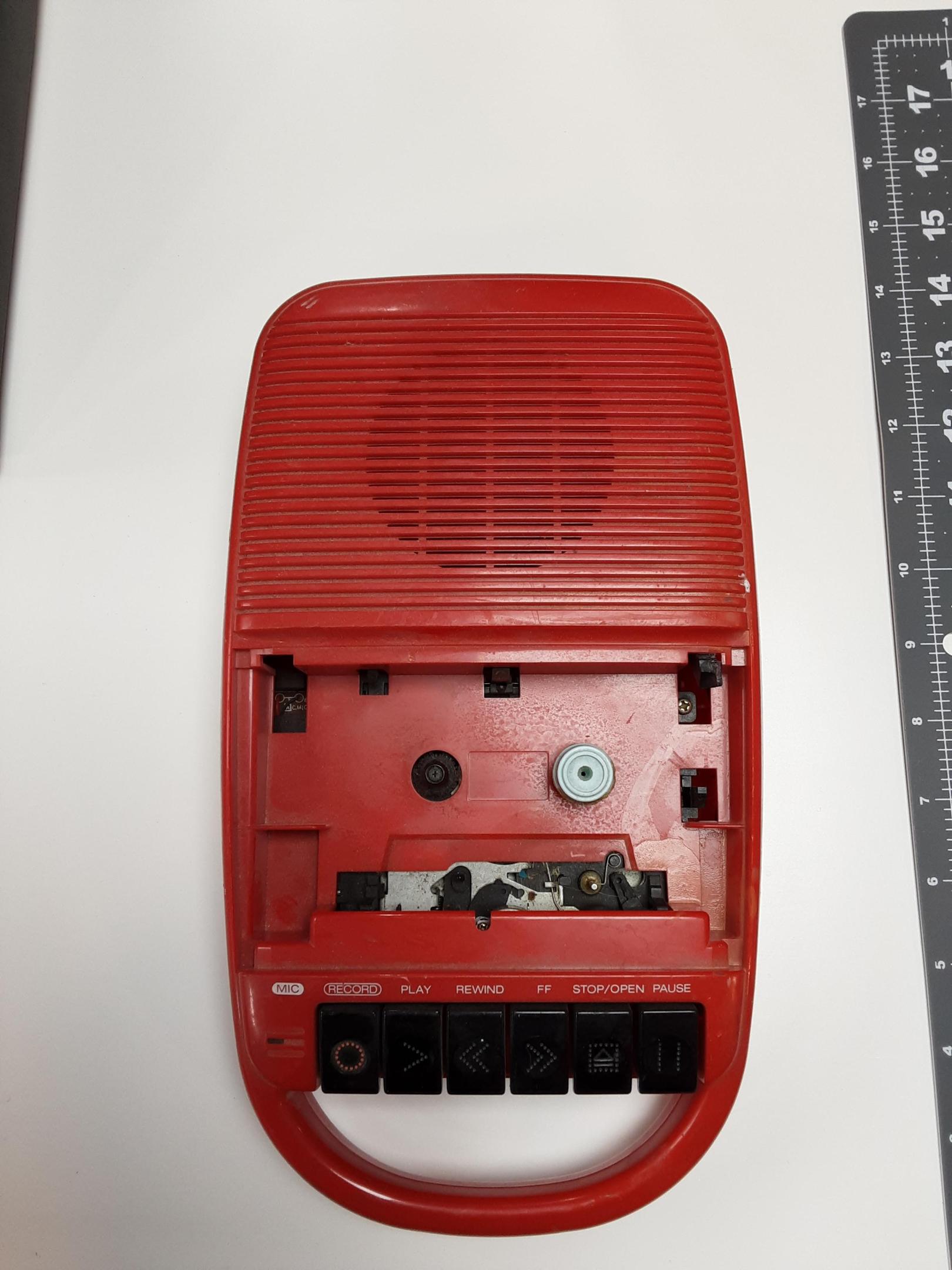

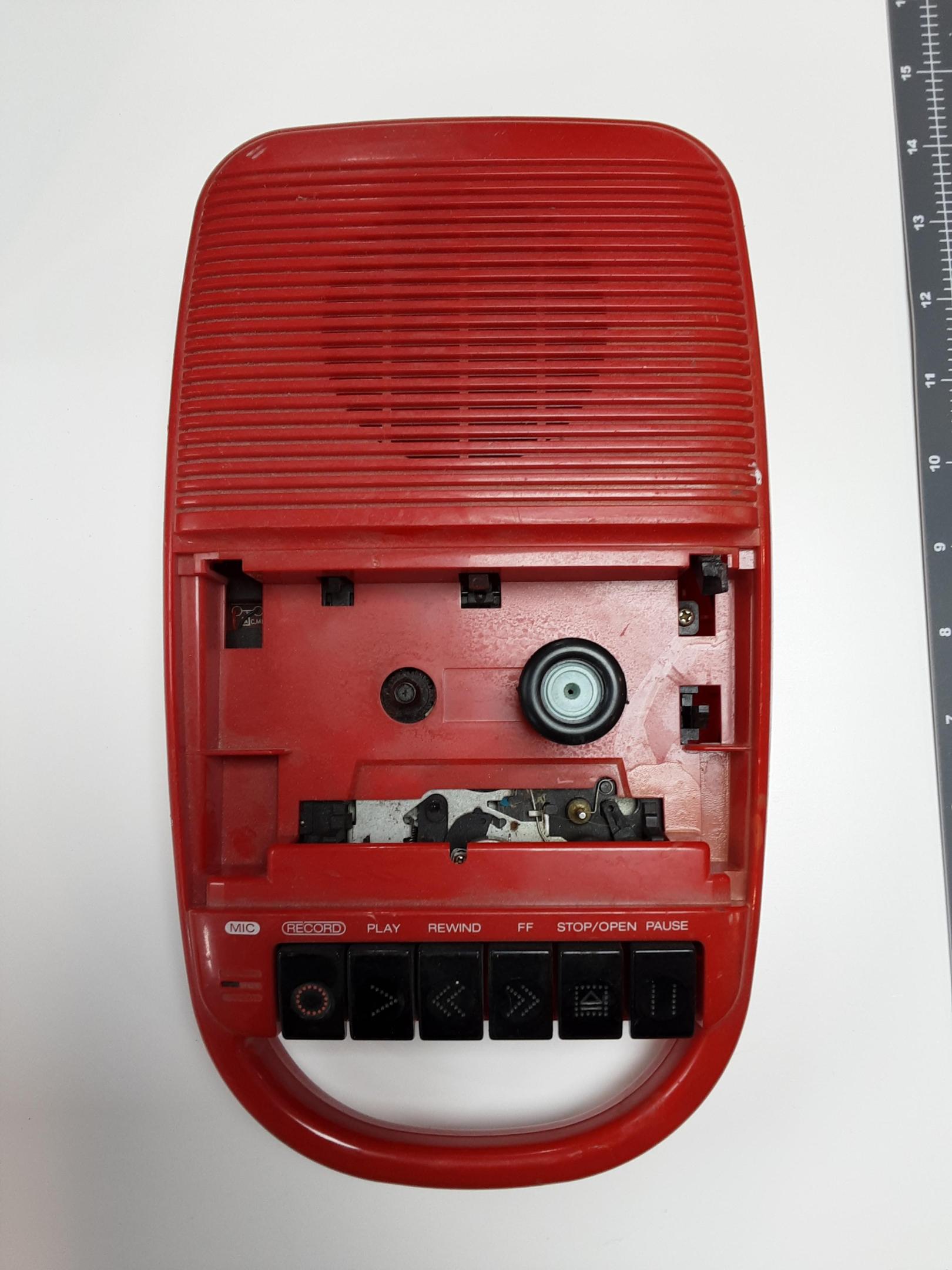

Mothersworry Posted November 11, 2023 Posted November 11, 2023 Here's what I use...an old cassette player with a wheel glued into the capstan. Mount the tire, hit play, apply the brush loaded with acrylic paint. The Talladaga and Dart tires have been done using this technique. 3
Ace-Garageguy Posted November 11, 2023 Posted November 11, 2023 1 hour ago, Mothersworry said: Here's what I use...an old cassette player with a wheel glued into the capstan. Mount the tire, hit play, apply the brush loaded with acrylic paint. Repurposing genius.
Bainford Posted November 11, 2023 Posted November 11, 2023 Yup, very clever, and nice looking results, too.
Pete J. Posted November 11, 2023 Posted November 11, 2023 On 11/9/2023 at 11:58 AM, Ace-Garageguy said: For doing Goodyear "Blue Streaks", I've had good results from mounting the tire on a tight-fitting wheel, then chucking it up in the lathe and cutting the groove deeper with a specially ground cutter. Then white gel pen in the groove, followed by blue magic marker after the white is fully dry. Sorry...no pix currently available. Great idea! I never thought of that. I have a Sherline lathe and cut a jig as a guide. I tried blue and red gel pens over white with no sucess. The markers would have worked much better. By the way, I had several club member ask me to make them a jig. I will pass the magic marker idea on to them. Thanks Bill! 1

Oldriginal86 Posted November 11, 2023 Posted November 11, 2023 I like the spinning tire idea but found most model tires aren’t round and travel an elliptical path causing the stripe to be off-center.
