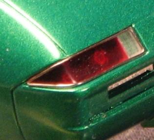

Straightliner59 Posted November 10, 2023 Posted November 10, 2023 On 11/7/2023 at 3:30 PM, espo said: I was going to suggest something like what gman suggested. The textured finish on the foil makes a great reflector for a taillight lenses, the larger and flatter the better. I used it for the taillights and side markers on this Monza. It works beautifully, I'd say! It's not easy to see in photos, but, it looks right.
T-Ray Posted November 10, 2023 Author Posted November 10, 2023 6 hours ago, Straightliner59 said: I used it for the taillights and side markers on this Monza. It works beautifully, I'd say! It's not easy to see in photos, but, it looks right. Wow! Those look great! I'm gonna have to remember that

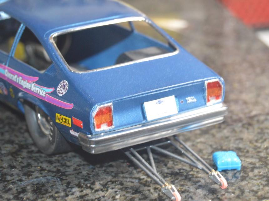

Straightliner59 Posted November 11, 2023 Posted November 11, 2023 17 hours ago, T-Ray said: Wow! Those look great! I'm gonna have to remember that Thank you! After I posted that, I realized that this Vega shows up better. I used clear sheet to make these, and painted the colors with Tamiya clear colors. The pattern might be a little too pronounced, here. But, it's not horrile. 1
Bainford Posted November 11, 2023 Posted November 11, 2023 9 hours ago, Straightliner59 said: Thank you! After I posted that, I realized that this Vega shows up better. I used clear sheet to make these, and painted the colors with Tamiya clear colors. The pattern might be a little too pronounced, here. But, it's not horrile. Brilliant, Daniel. I'll be using that one. 1
