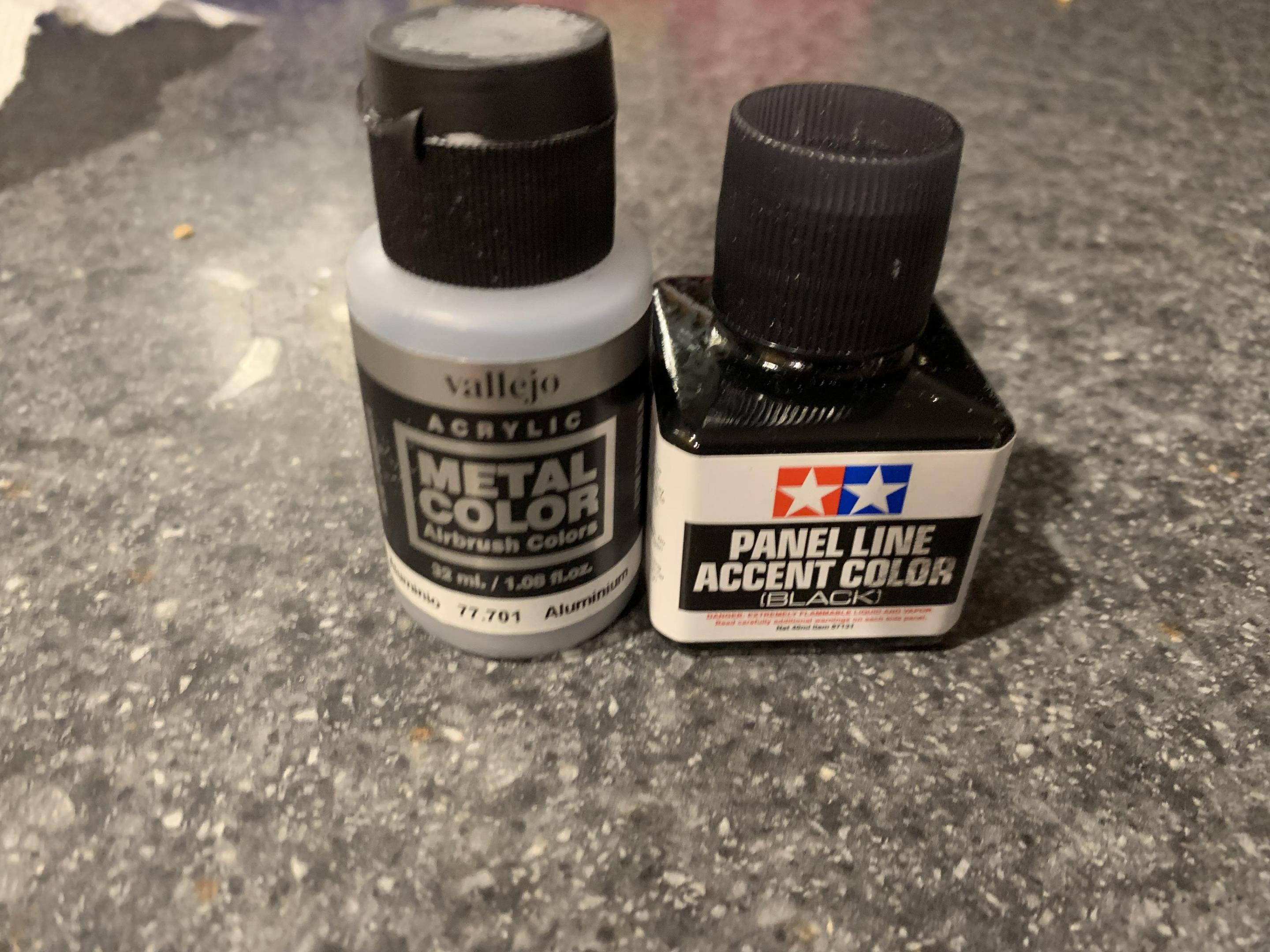

atomicholiday Posted November 9, 2023 Posted November 9, 2023 (edited) I’m a big fan of this stuff. I also really like Vallejo Metal Color acrylic for detail painting. Here’s my problem. Applying the panel line accent over the Vallejo works fine. But frequently, I need to go back over it with a thinner to tone down the effect. I was told to use enamel thinner for this. The enamel thinner can easily remove the Vallejo too though, and that’s a problem. Is there a better way to clean up excess Tamiya panel line accent, without removing the Vallejo acrylic? Or should I coat the acrylic with something before applying the Tamiya? Edited November 9, 2023 by atomicholiday
gotnitro? Posted November 9, 2023 Posted November 9, 2023 I would seal the first coat under a gloss coat then apply your panel line accent. Then clean up excess w thinner, this should protect the other layers 2

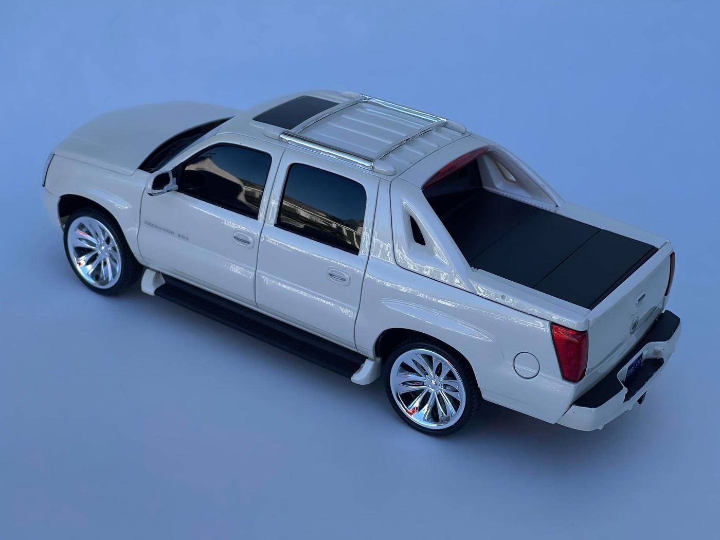

StevenGuthmiller Posted November 11, 2023 Posted November 11, 2023 I'm with Bill and Marcos on the panel line question. It's become evident to me that scribing deeply pretty much eliminates any need for darkening panel lines, and in fact, looks more realistic than using a panel line accent. These panel lines had no accent added whatsoever. Just deeply scribed, and left at that. As far as weathering goes, It's my opinion that there are a great number of other techniques that can be used to better represent weathering. I think what you're accomplishing here Jeremy is not exactly what I would consider "weathering" but more just trying to add a little extra "depth" to the part, rather than "age" or "use". When I think of weathering, I think of adding a little, (or a lot of) extra oil, dirt, road grime, rust, etc. I've discovered that a little playing around with some simple and cheap acrylic craft paints works extremely well for various degrees of "weathering". This Coronet's engine and chassis were weathered very lightly with acrylic craft paint to represent light use. The engine and chassis on this Bonneville were weathered a bit more heavily with the same products to represent a vehicle of a few years of age, and 20,000-30,000 miles of use. Steve 3
Bills72sj Posted November 11, 2023 Posted November 11, 2023 (edited) Steve's results speak for themselves. Panel liner has a mild solvent effect on some surfaces which is OK in many instance. Though as you have discovered, it also takes a solvent to clean it up. If you find/create an equivalent acrylic-based home brew, then water will be your clean up. Alternately, clear acrylic coat your part(s) before weathering to act a sealing agent that is resistant to a solvent based clean up. Edited November 11, 2023 by Bills72sj spelling 1
jaymcminn Posted November 11, 2023 Posted November 11, 2023 (edited) I've used the Tamiya Panel Liner quite a bit, and the solvent is pretty aggressive for acrylic undercoats. A shot of clear lacquer will help to protect the finish. Since you already use Vallejo's excellent Metal Colors, have you thought about trying their washes? The washes are designed to dry slowly which permits them to be manipulated over the drying period for a variety of effects. Even when dry, they can be removed from highlights with water or a mild alcohol solution and a craft swab. The 1/12 Bugatti engine below was done entirely with Vallejo Metal Colors and washes... Edited November 11, 2023 by jaymcminn 3
