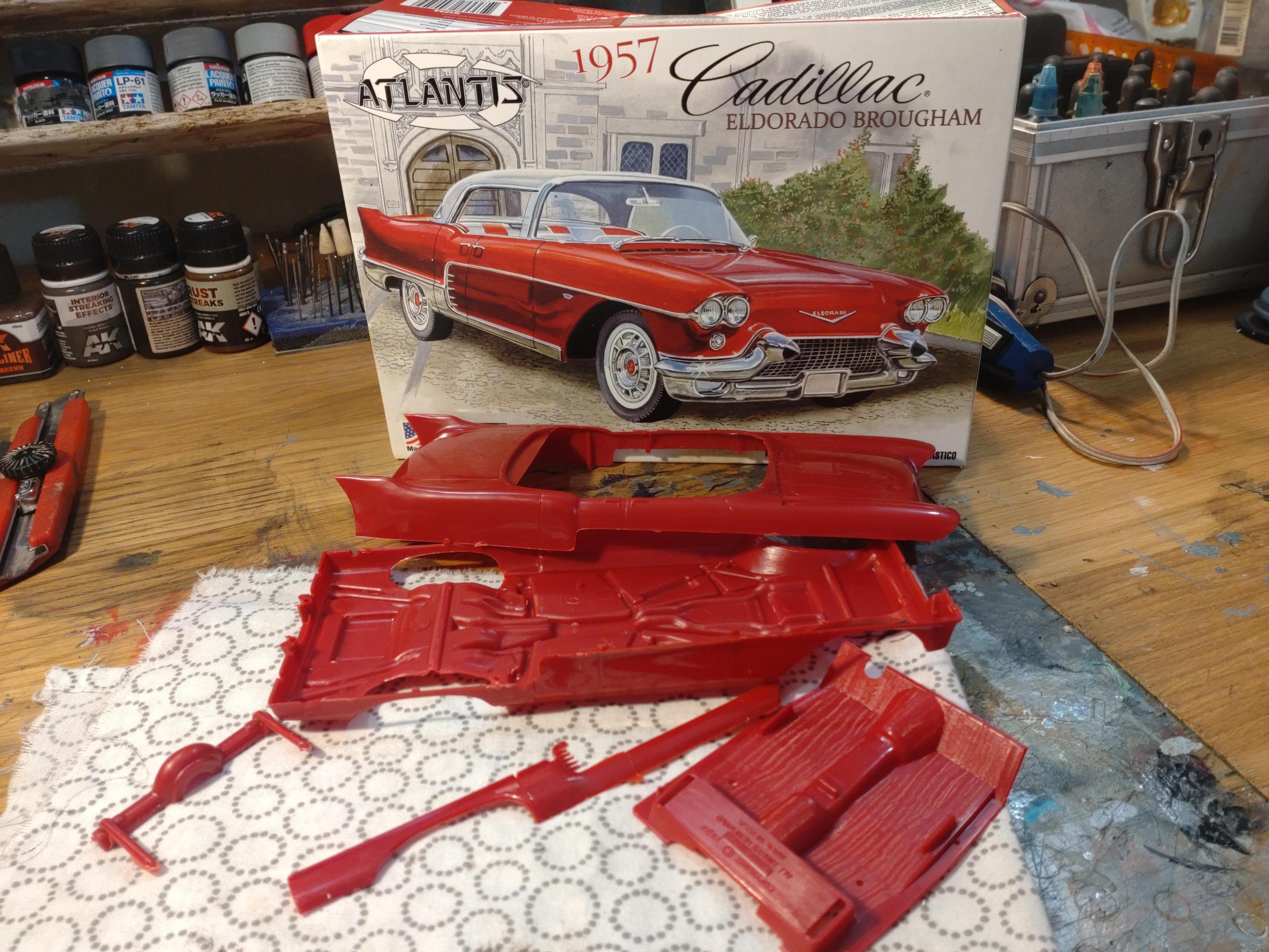

In contrast to my high expectations you can´t imagine my disappointment unboxing this kit. My vendor didn´t mention that the model only fits level 2: It has no engine, less than 60 parts, the "tires" are styrene donuts and the qualitiy level is §$%&? In a sentence, the crappiest kit I have ever laid my hands on. It took 2 days of brooding to make my decision to build or bin.

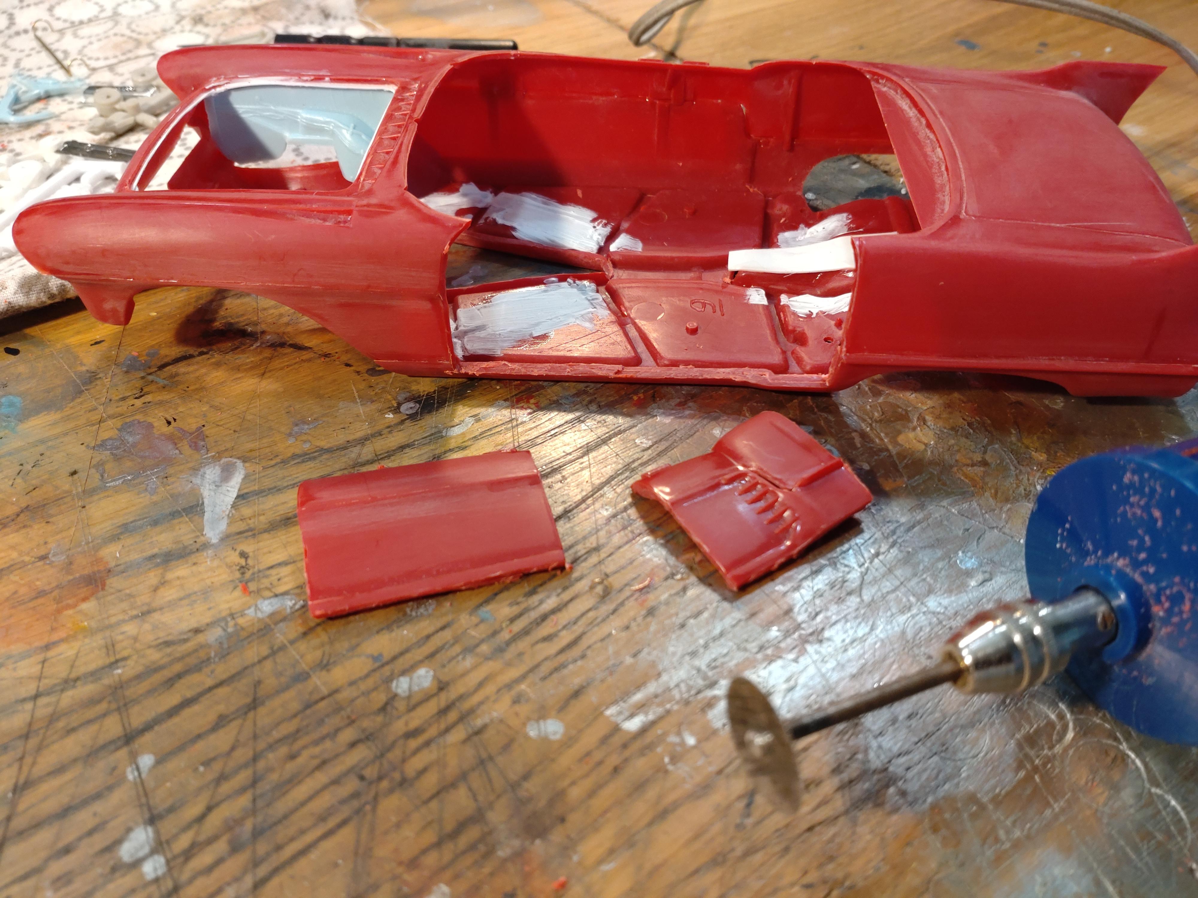

I chose to give it my TLC and add as much details and levels as possible. I have enough spare parts to build a decent engine and turn this kit into a fine show. The body/undercarriage parts connect at the middle, where you would expect a chrome trim.

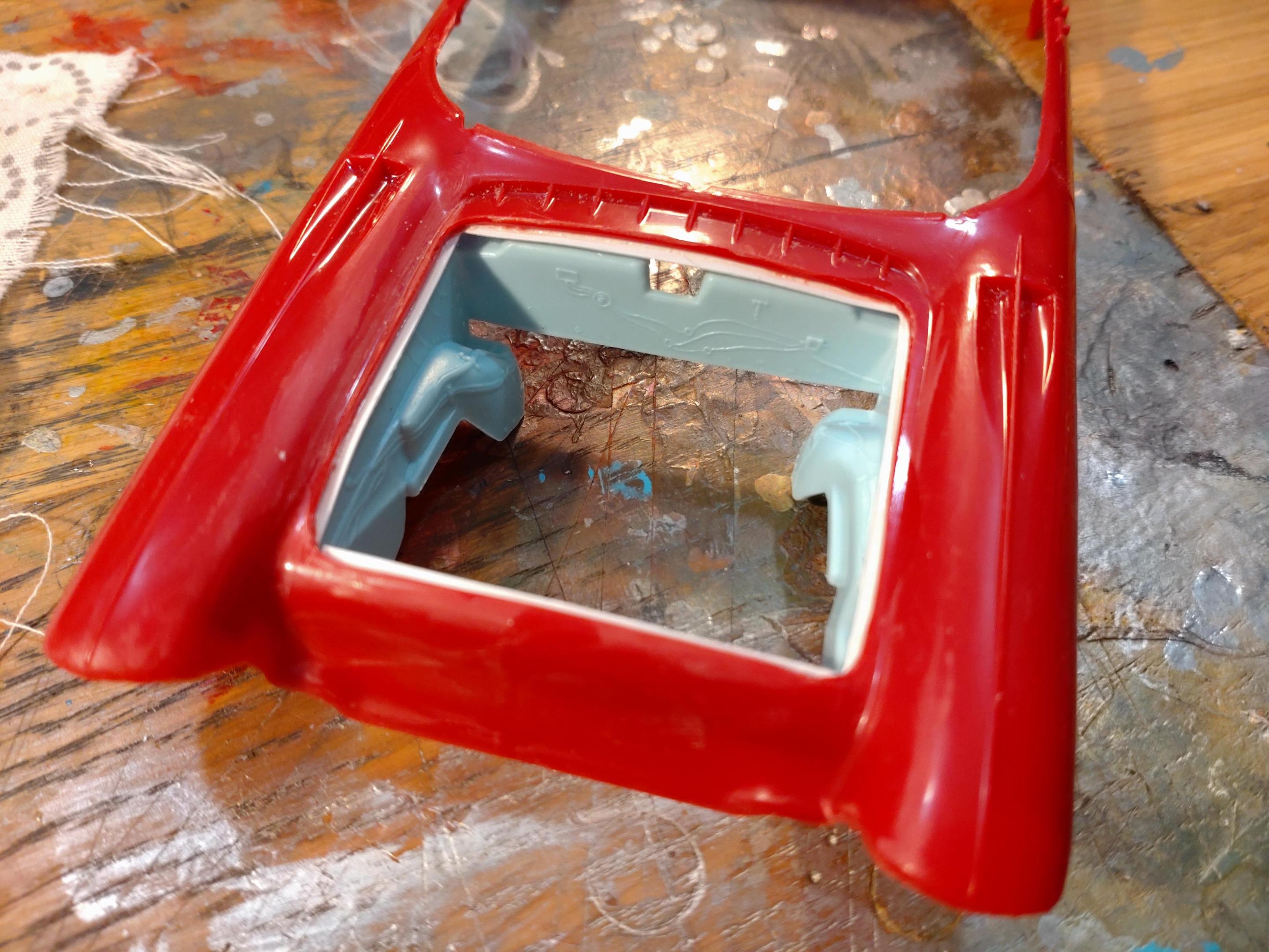

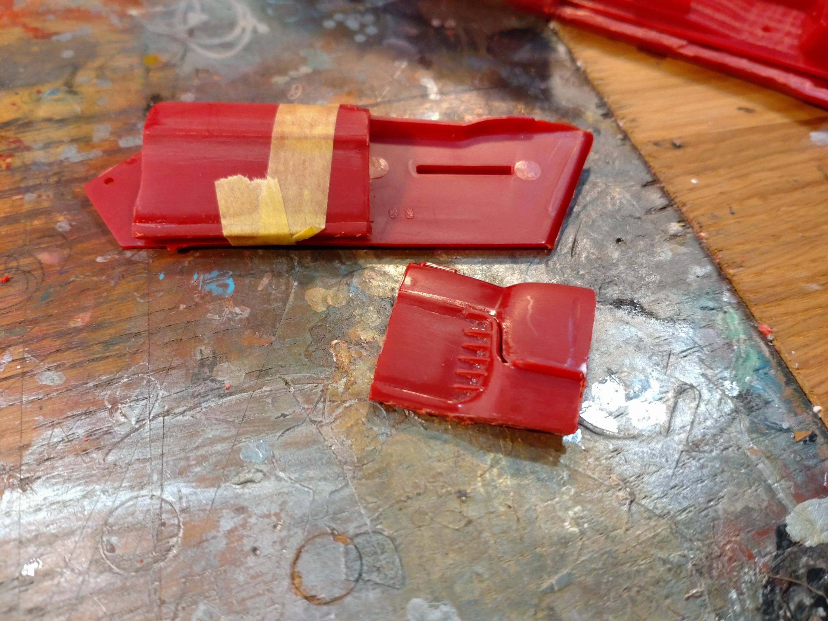

Everything is molded quite crude. The undercarriage has all the details molded on (exhaust system, engine pan etc), so I had to cut and grind out large sections. And I did want an engine to look at. I was able to salvage an engine bay from an extra body (`58 Impala). After cutting the hood open I added lips and glued the bay into place. The hood needed small strips of styrene to fit smug into the opening.
I filled the cavities on the bottom with sheet styrene and smoothed the surface with putty. Because I will add an exhaust system only a minimum of cleaning will be necessary.
My order of work on this kit will be much different than my usual habit. Fortunately the roof is an extra part, so I can work the interior while getting the body finished. Opening the hood wasn´t enough complexity yet, so I decided to get some doors open! Yup, those opposite doors with the suicide back door. Needed some brain work to think it out, I didn´t want to go into a dead end street... The body glued and after first sanding:

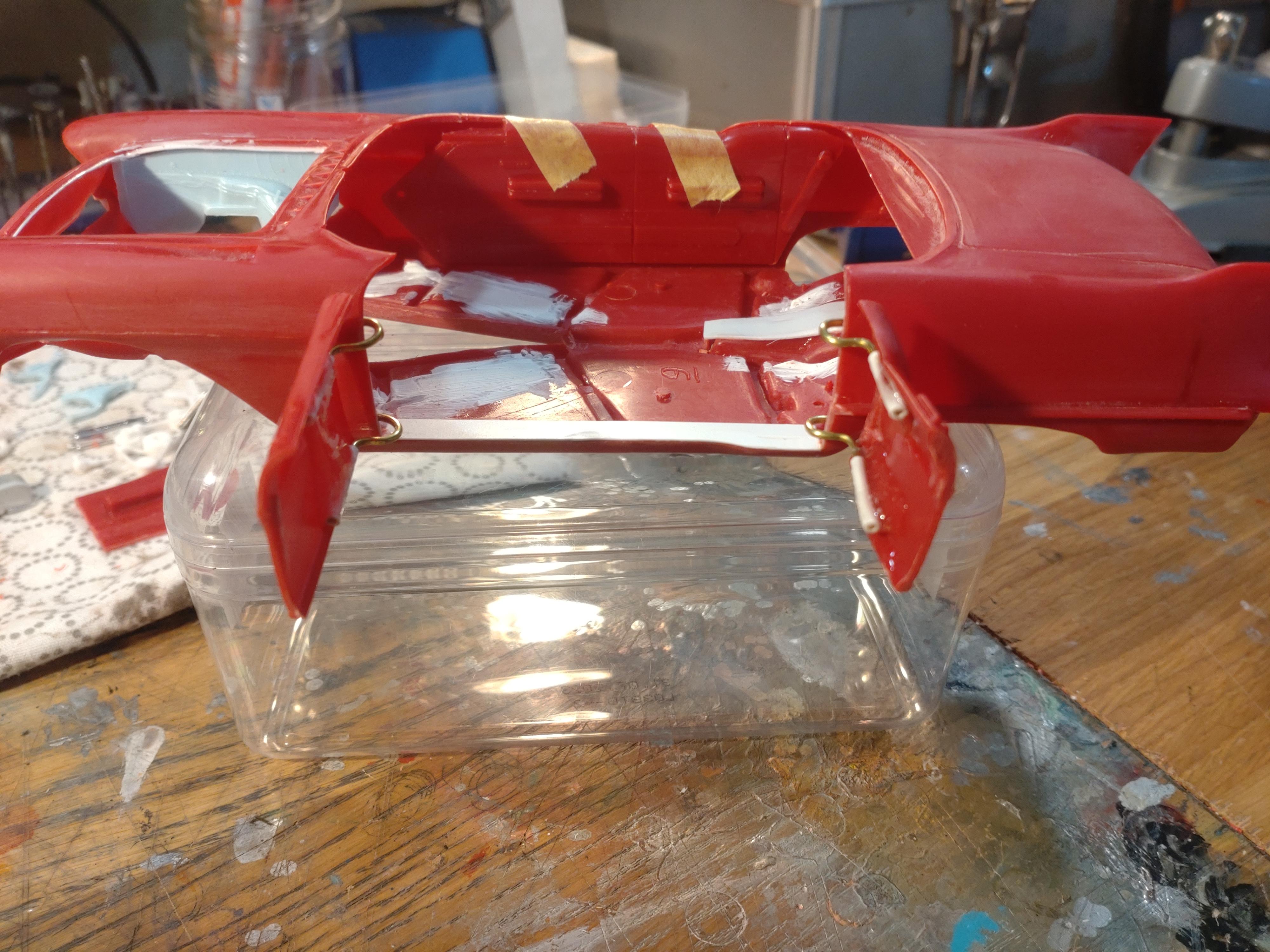

Now without the doors...
The interior panels have to fit too...

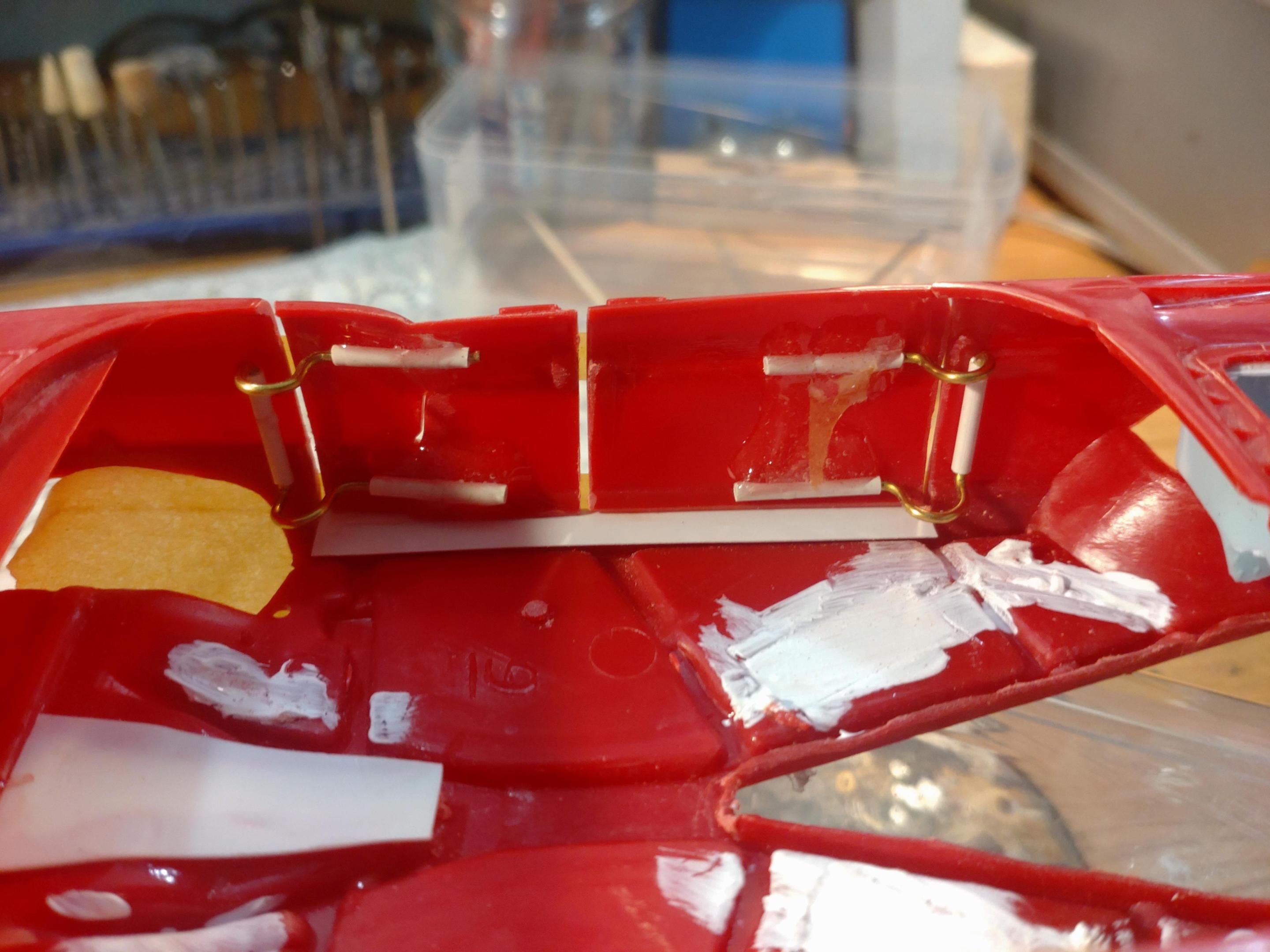

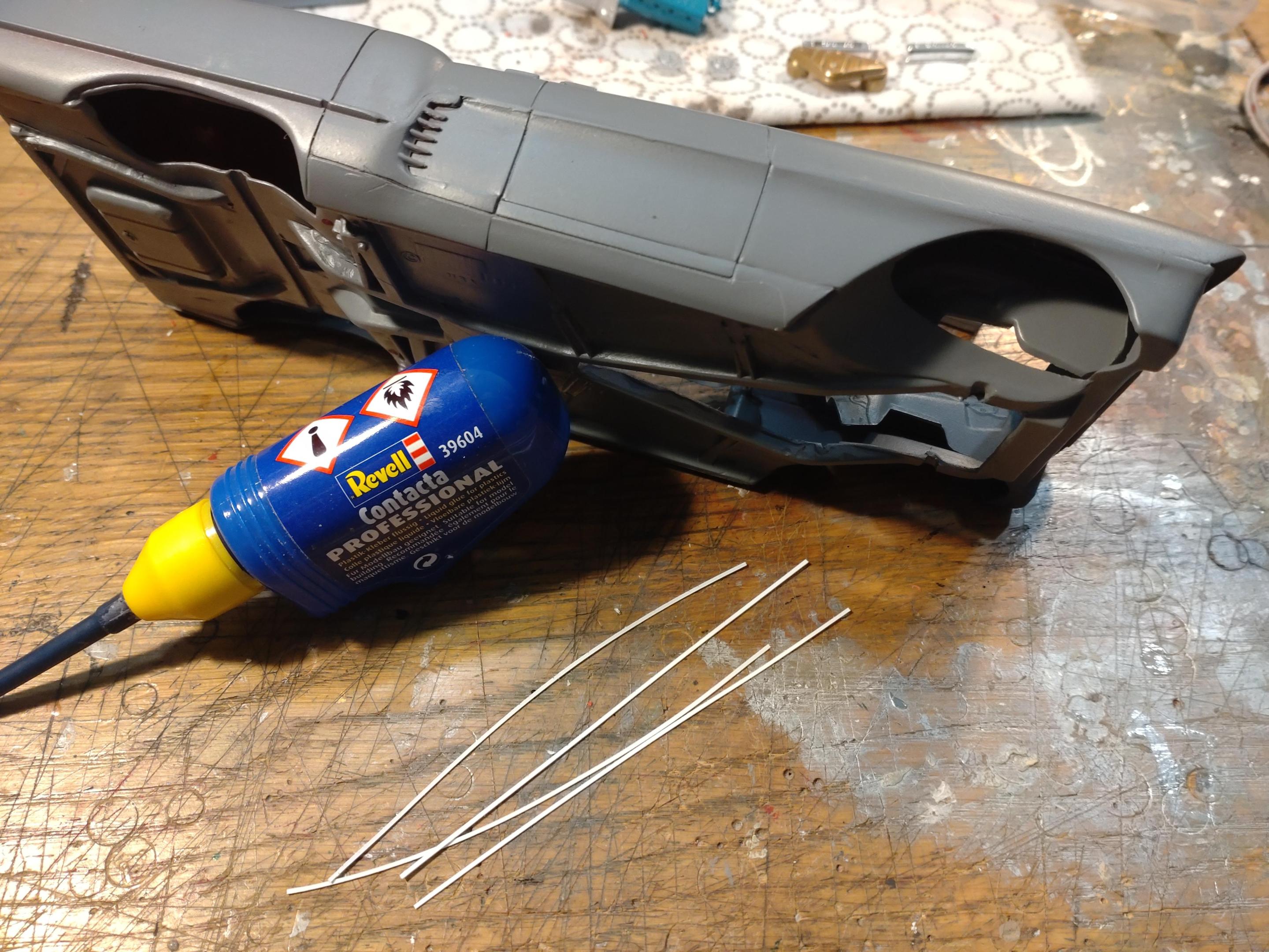

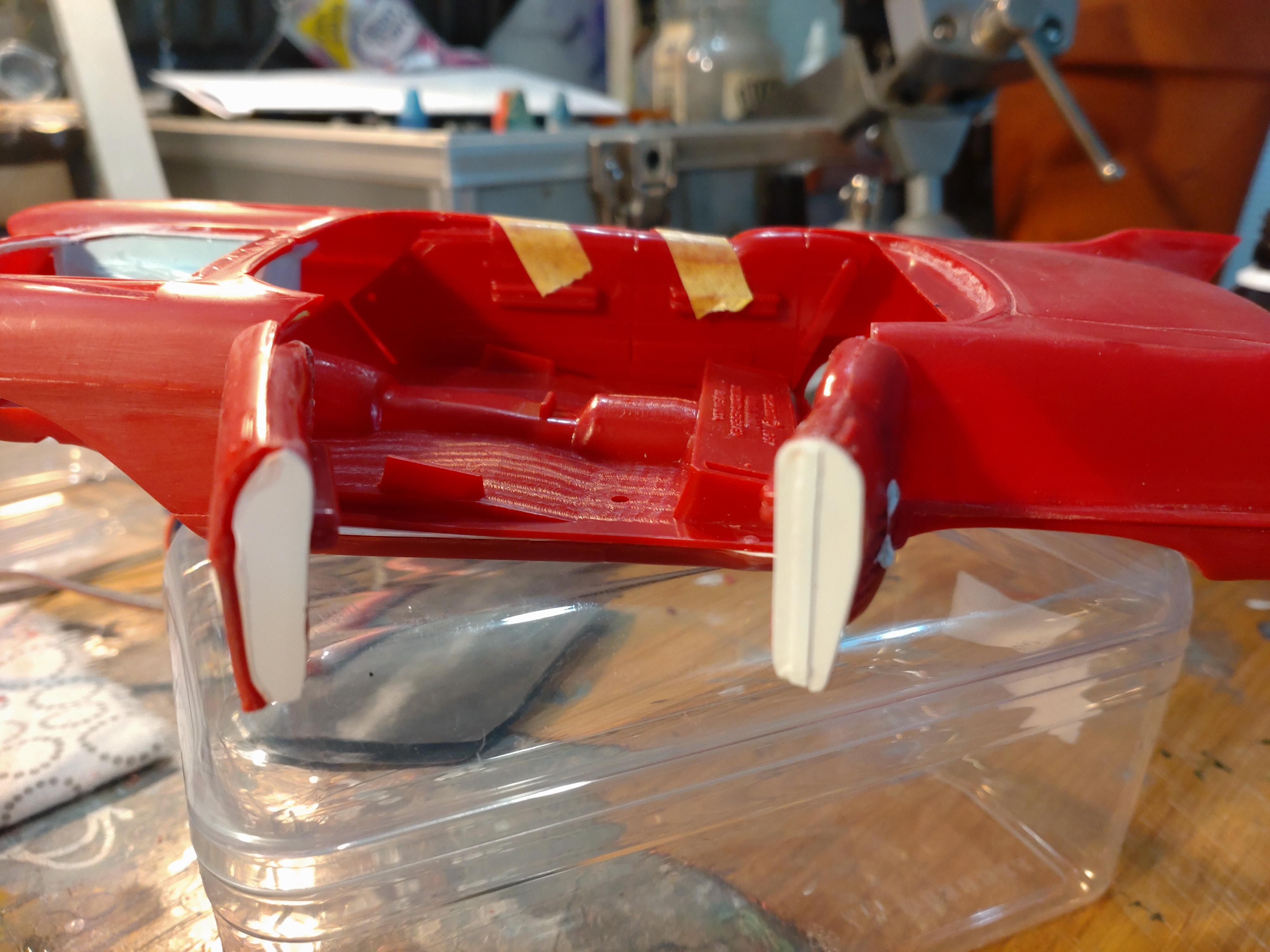

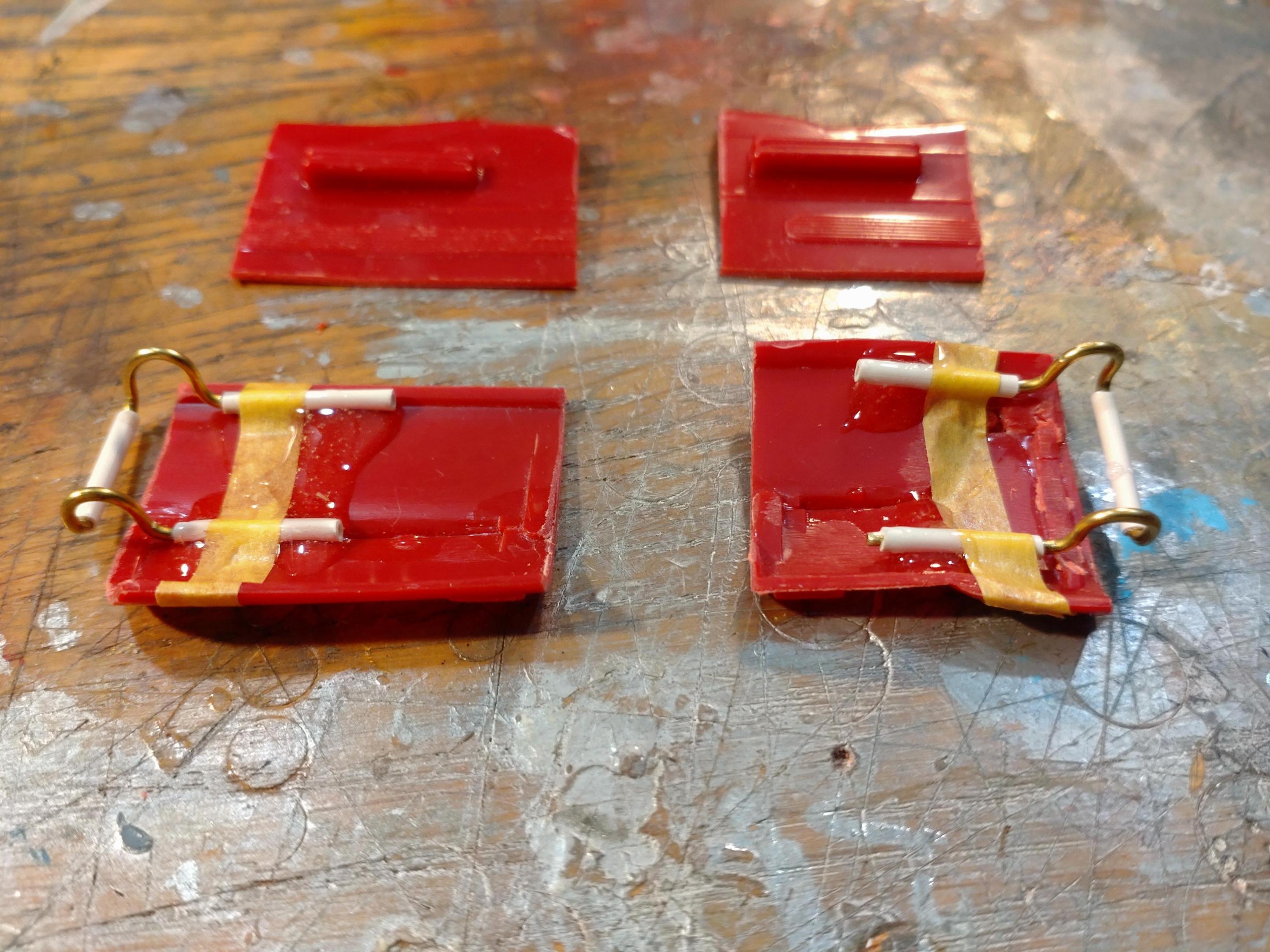

The hinges are the usual method, just that the doors are not flat. After fumbling to find the correct spots, I used 2-component epoxy to glue the styrene tubes. It fills the gapes very well and wont loosen later. The hinges themselves are 1mm brass. And by the way, I will only equip the driver side with doors (this is enough work already?).
The tricky part is getting the doors into the correct place to glue the hinges to the inside of the body. Getting it crooked here is a minor catastrophe. Securing them in the right spot with tape.
A look from the inside before applying the glue. Here too I trusted in epoxy. The door gaps might seem wide at this stage, but I will cover the open ends with sheet styrene and fill the cracks with putty. I hope to get under 1mm gaps in the end.
Behold, the hinges work and the doors swing wide open! Just like the original Brougham.

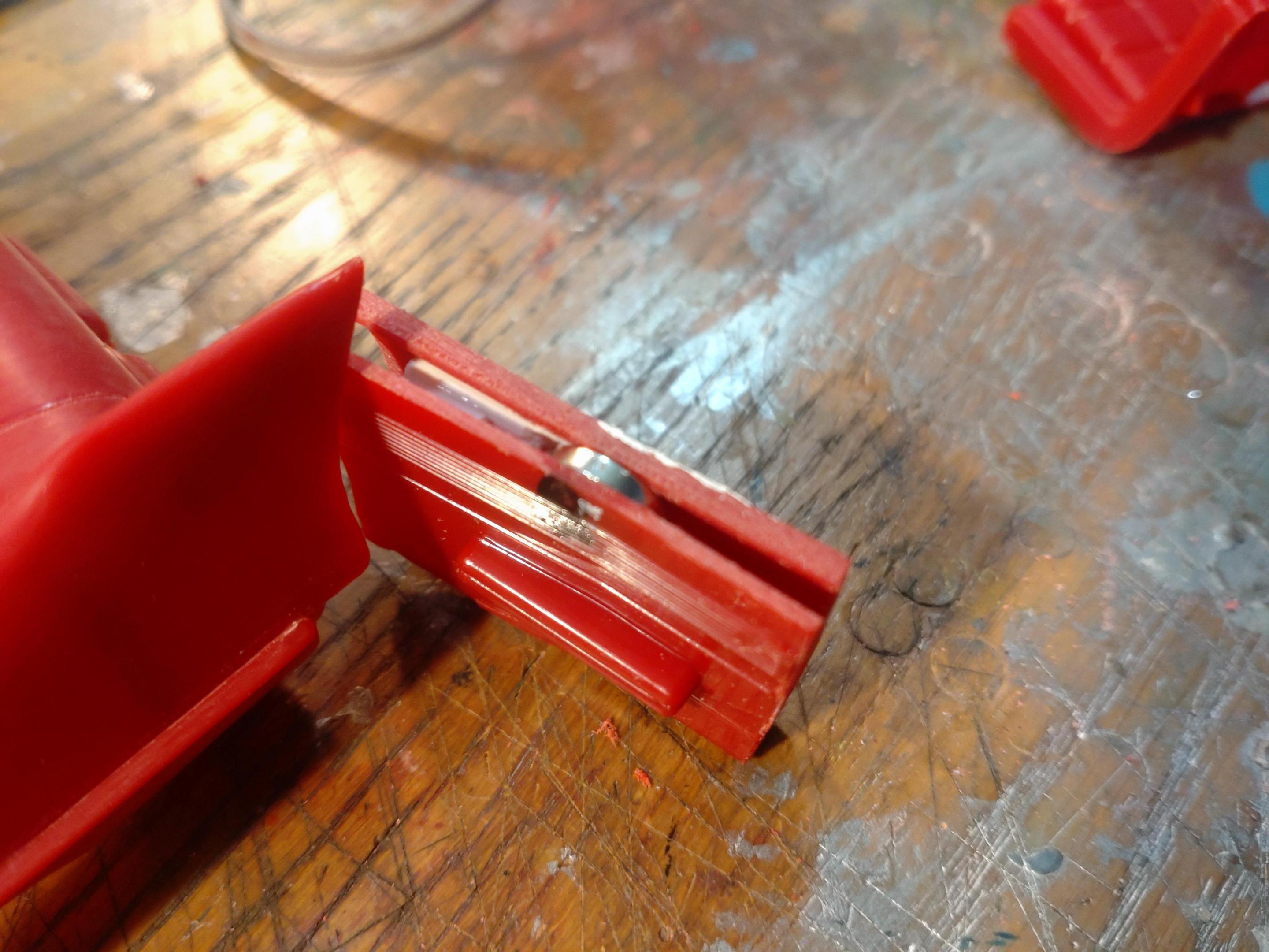

I want to avoid the doors not closing correctly when the build is finished and chose to hide magnets in the right places. The front door will hold the back door closed, so I will only need 2 magnets at the right places. One is under the bottom side of the interior panel. The other will be hidden in the driver seat. The magnets I happen to have at home are quite strong so they can bridge about 1cm and still keep up enough pull to keep the door closed, but not me having to pull too had to open the door. I do hope this works out! Heres the one in the door before I cover the holes.

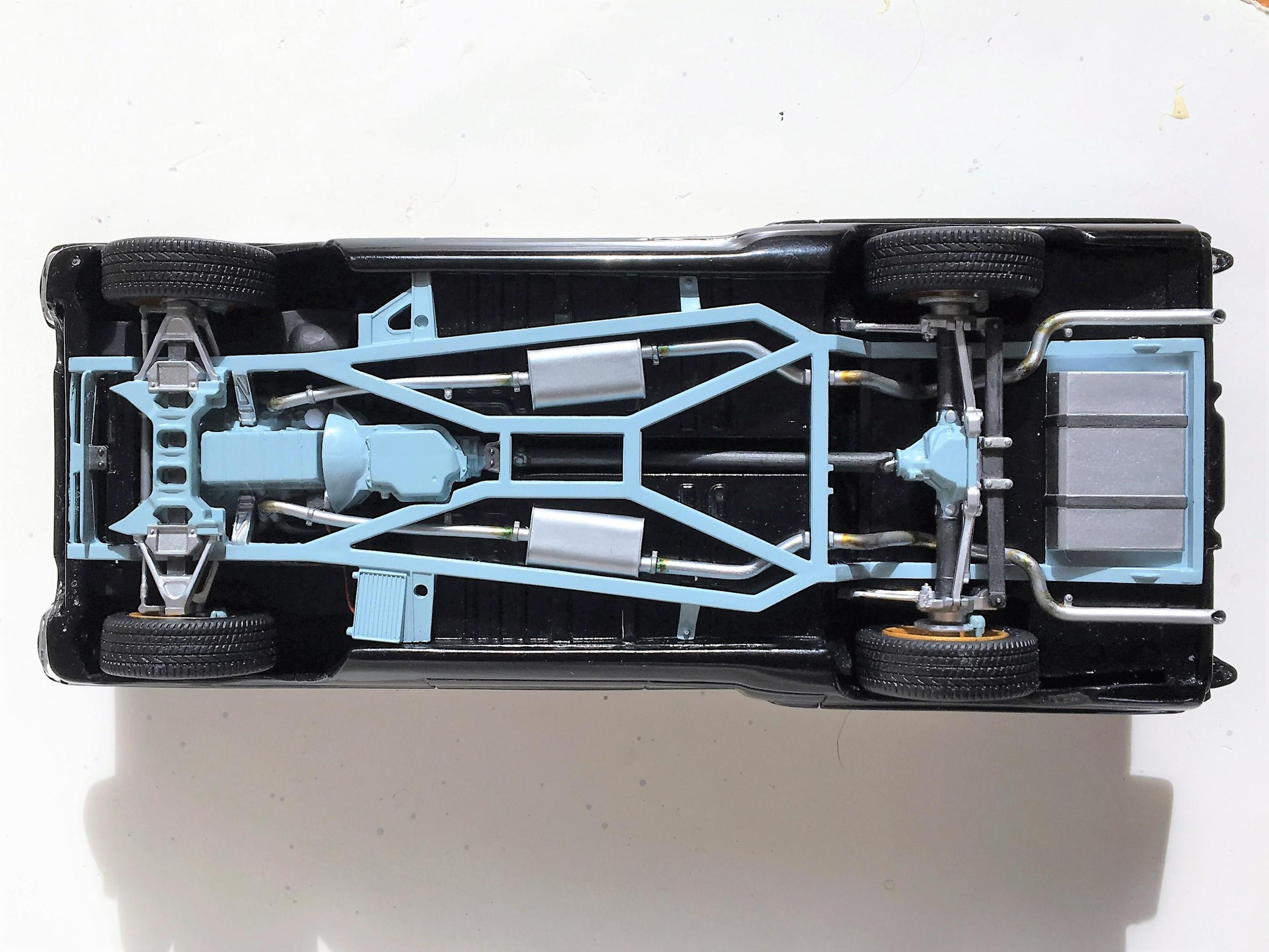

Could this kit be salvaged with a modified '58 Impala chassis? Or, doing a little research, it seems that many of these Caddy's have gotten more conventional frames, a modified '57 Chevy frame or something like that?

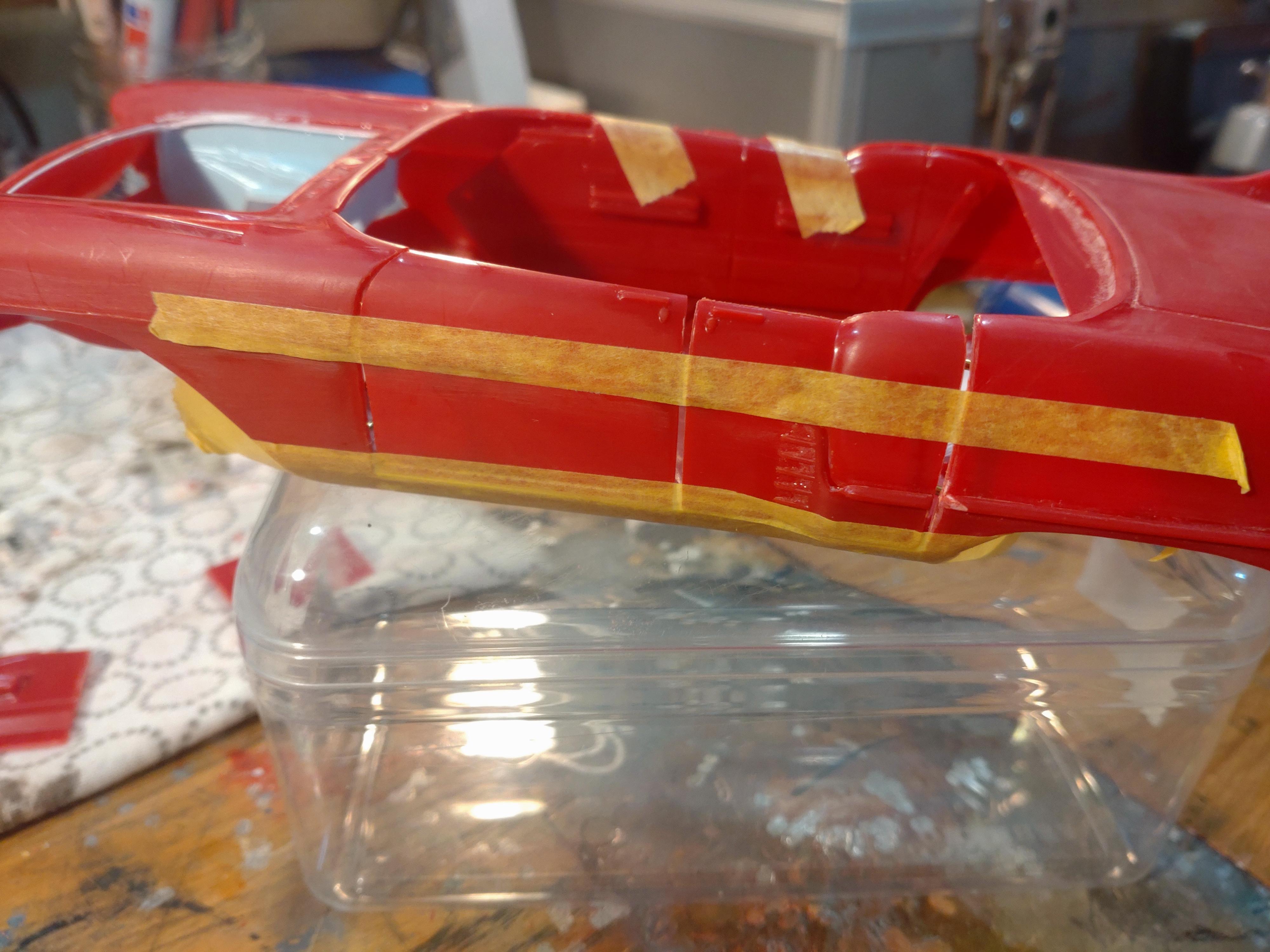

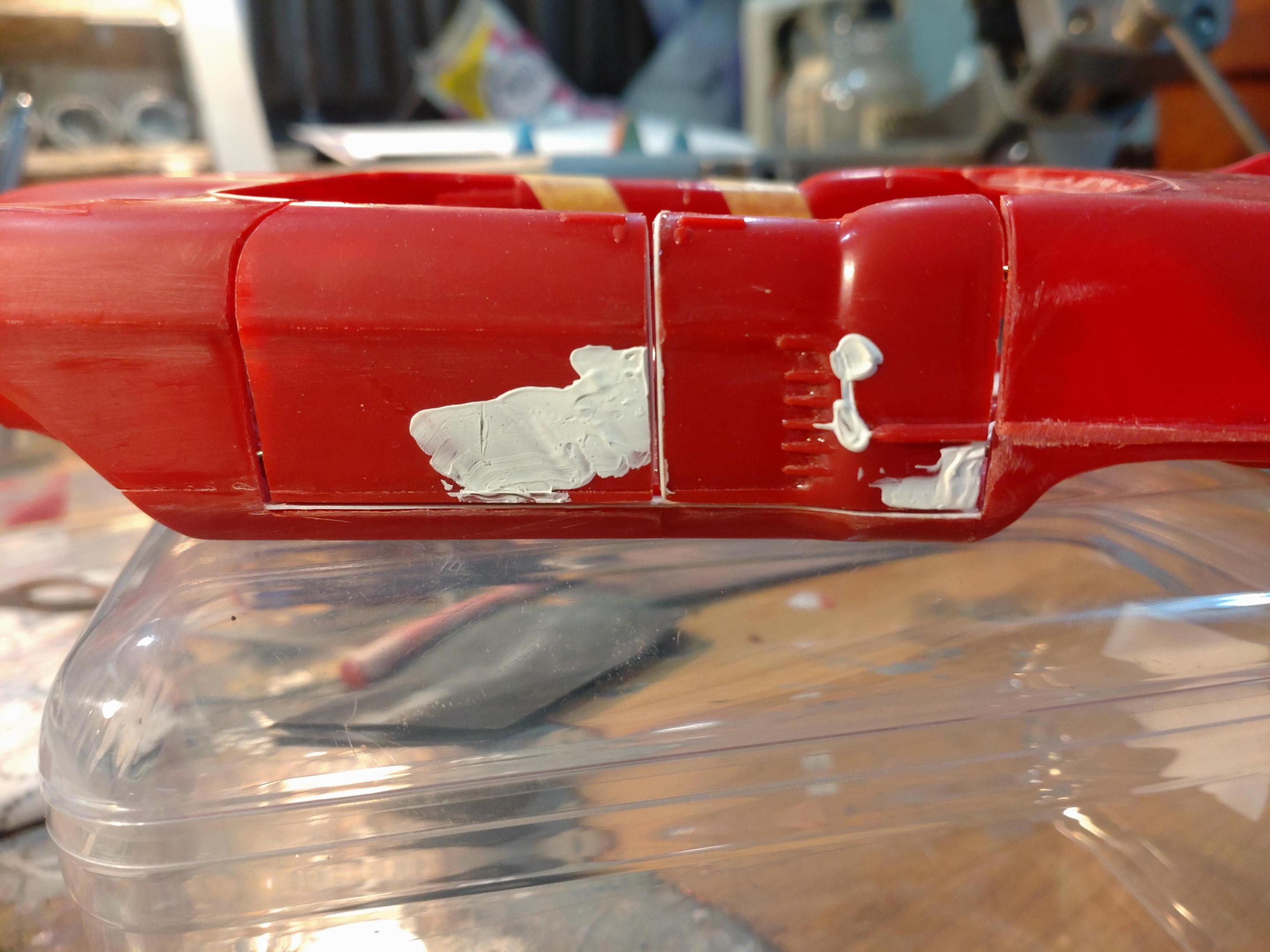

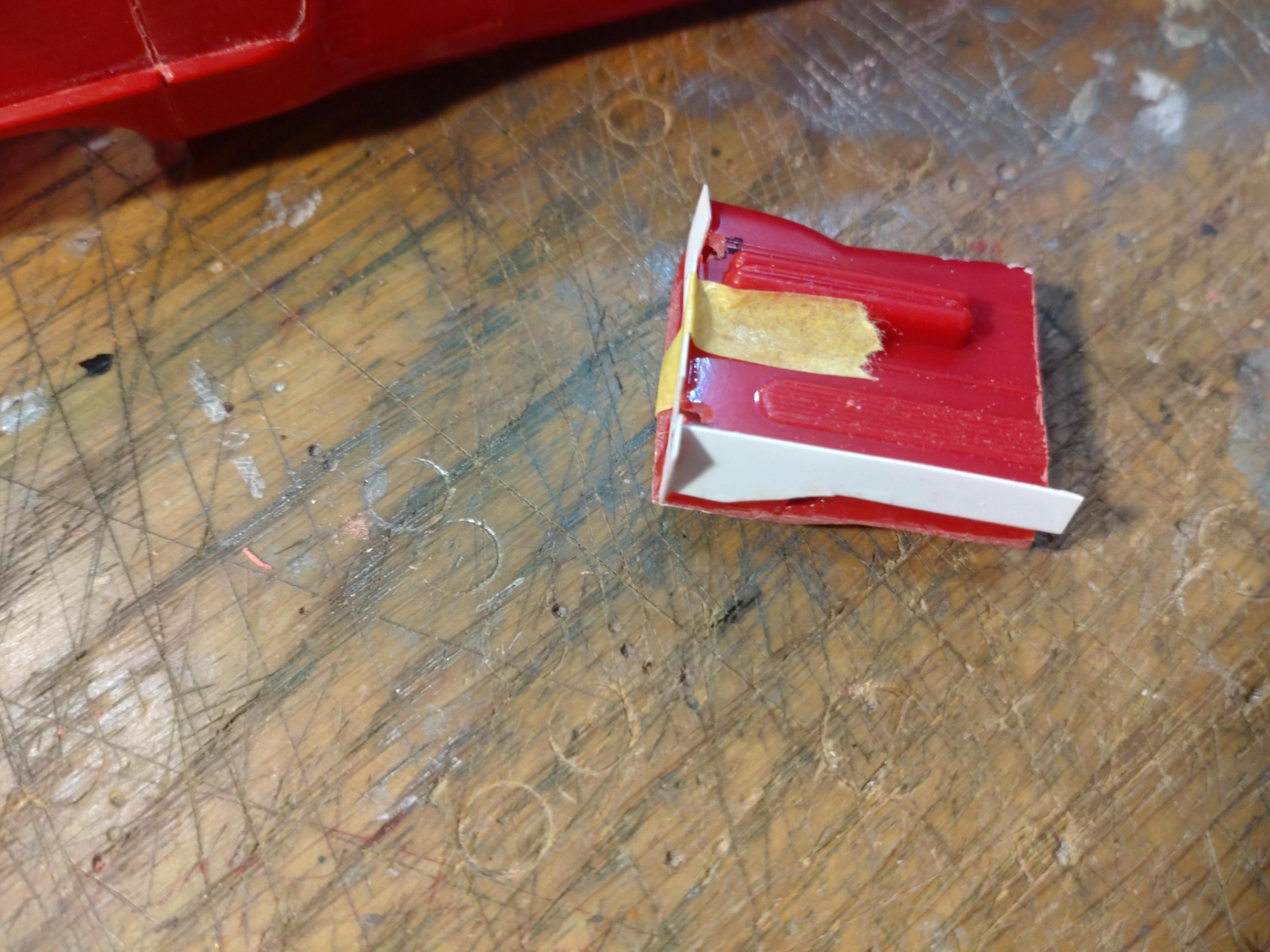

I covered the open areas of the doors with 0.5mm styrene. I usually cut the styrene pieces larger and cut the excess sheet after drying with a scalpel. DSC_1651.thumb.JPG.4e053d08aa9d18d09bec5cf8b9e117b2.JPG
The doors gaps have gotten smaller.
I added a lip the the back door to further close the gap. I necessary I can add another thin layer later.

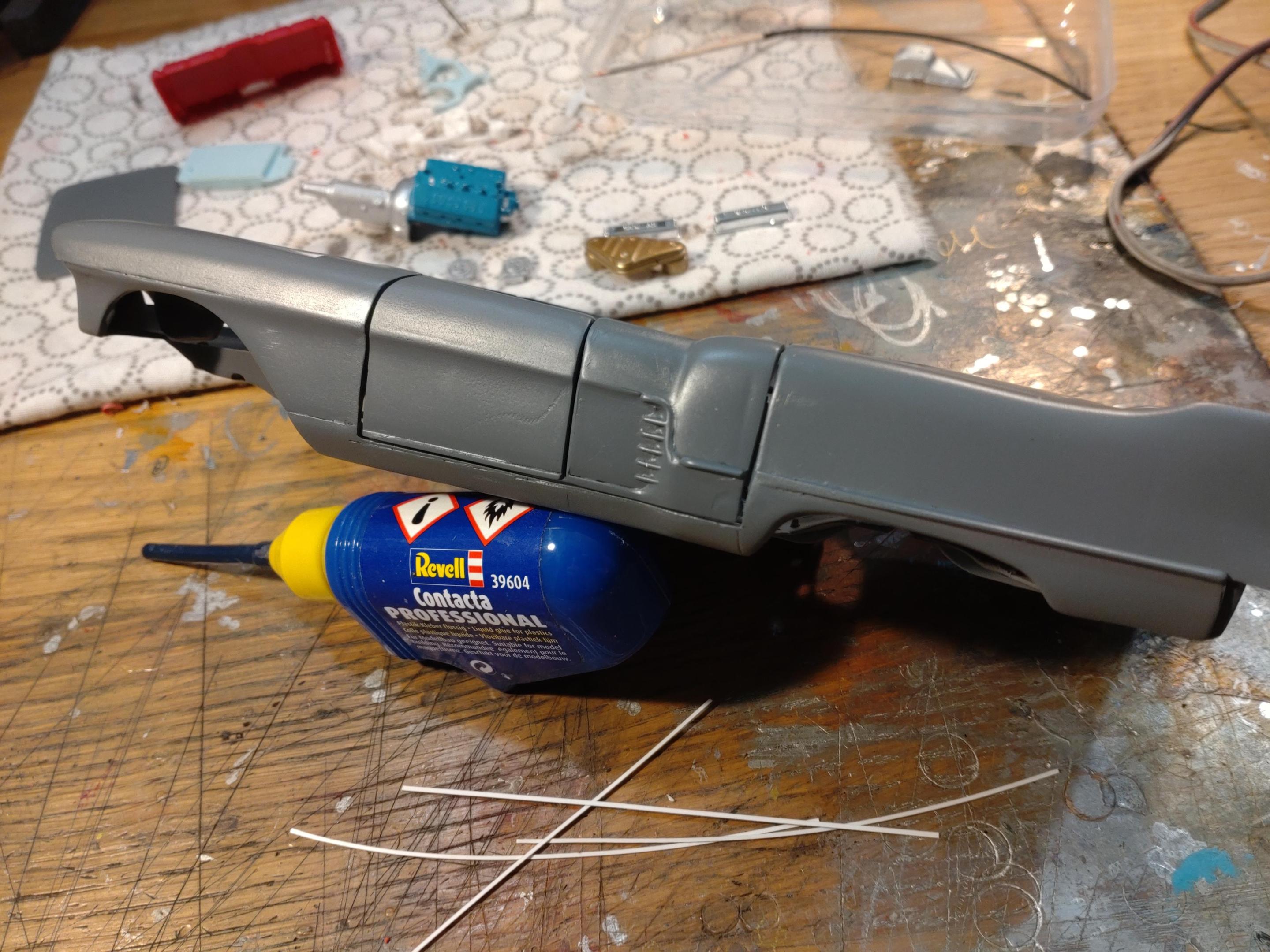

The first base paint did reveal several murky areas. Now comes the boring part of building to me: Putty, sanding, putty, sanding, spraying, putty.....???

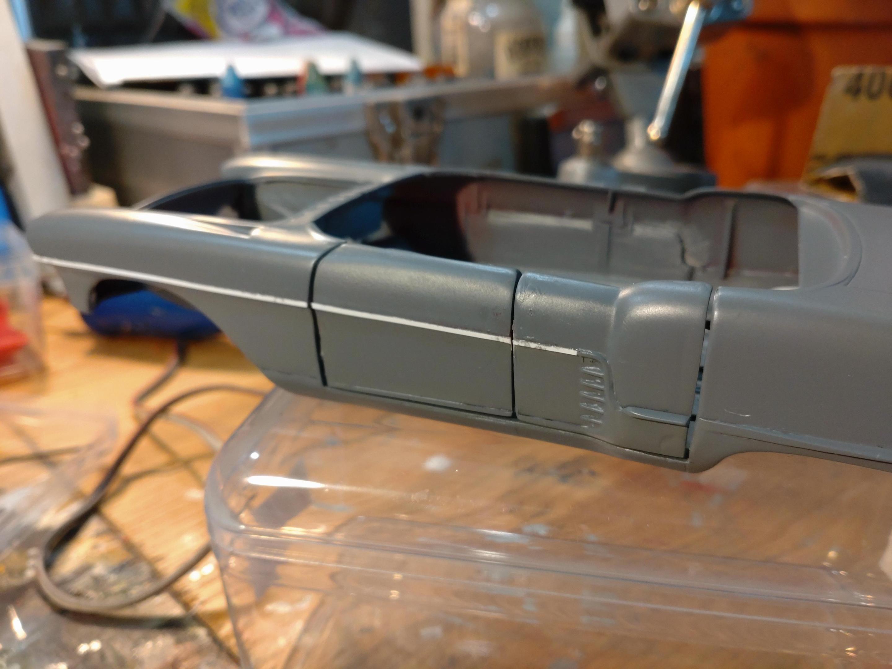

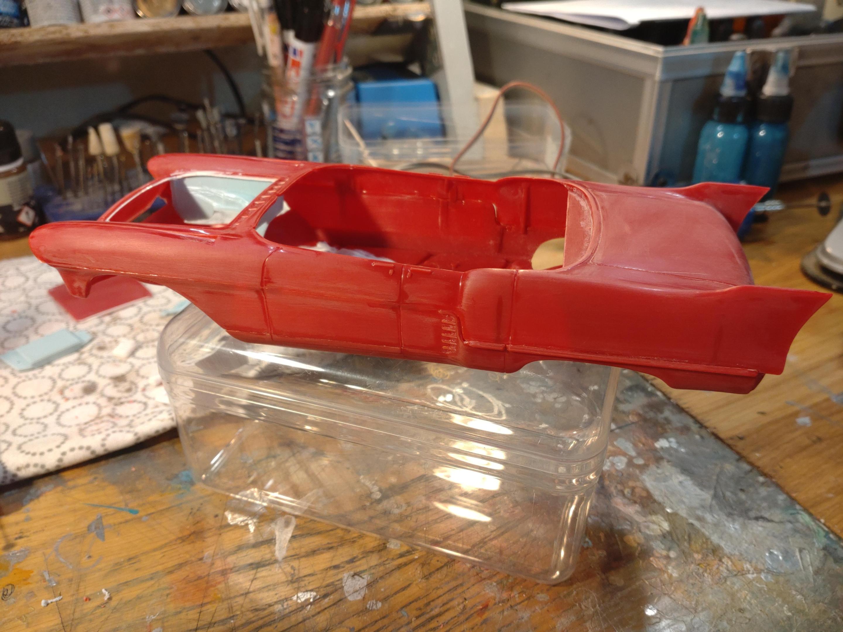

I cut thin strips of 0.5mm styrene to add the trim running the middle line. This will help cover up the poor fit of the body parts.
Finished with extensive wet sanding. I´m letting the body dry a bit and after the next base coat will see how much putty work is left to do. As you can see I shaved off the door handles. Nicer ones are on their way now from Scale Production.

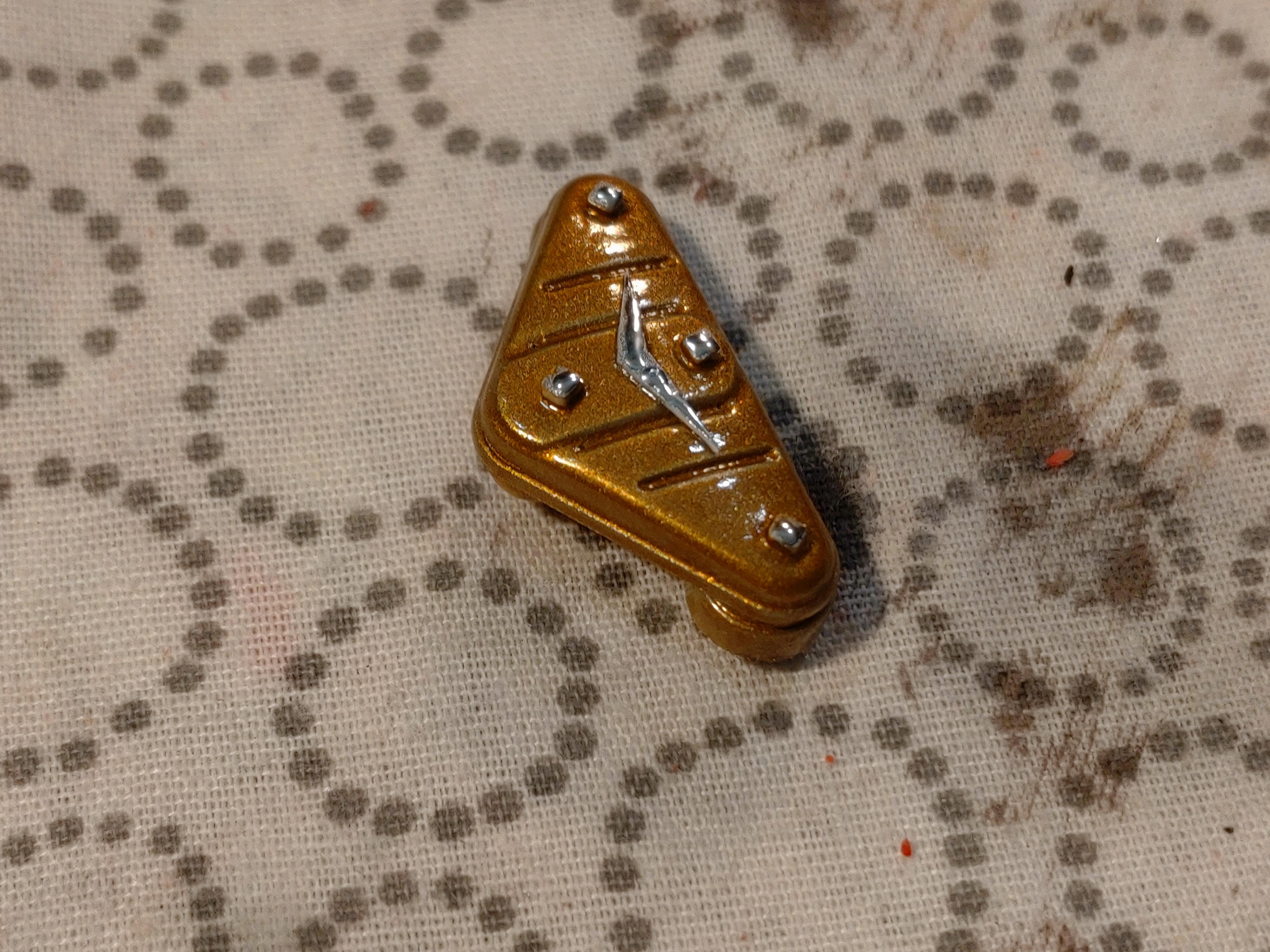

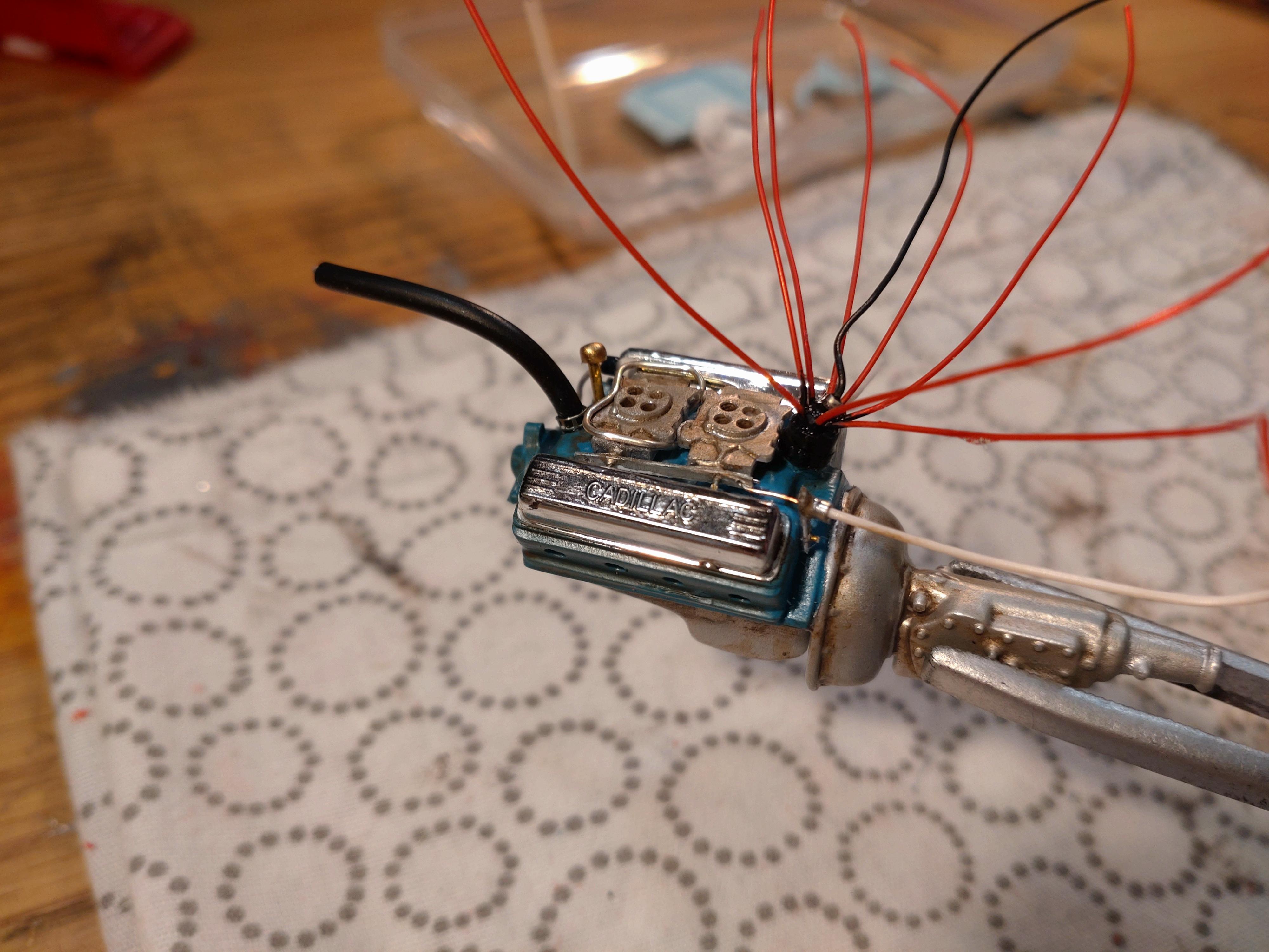

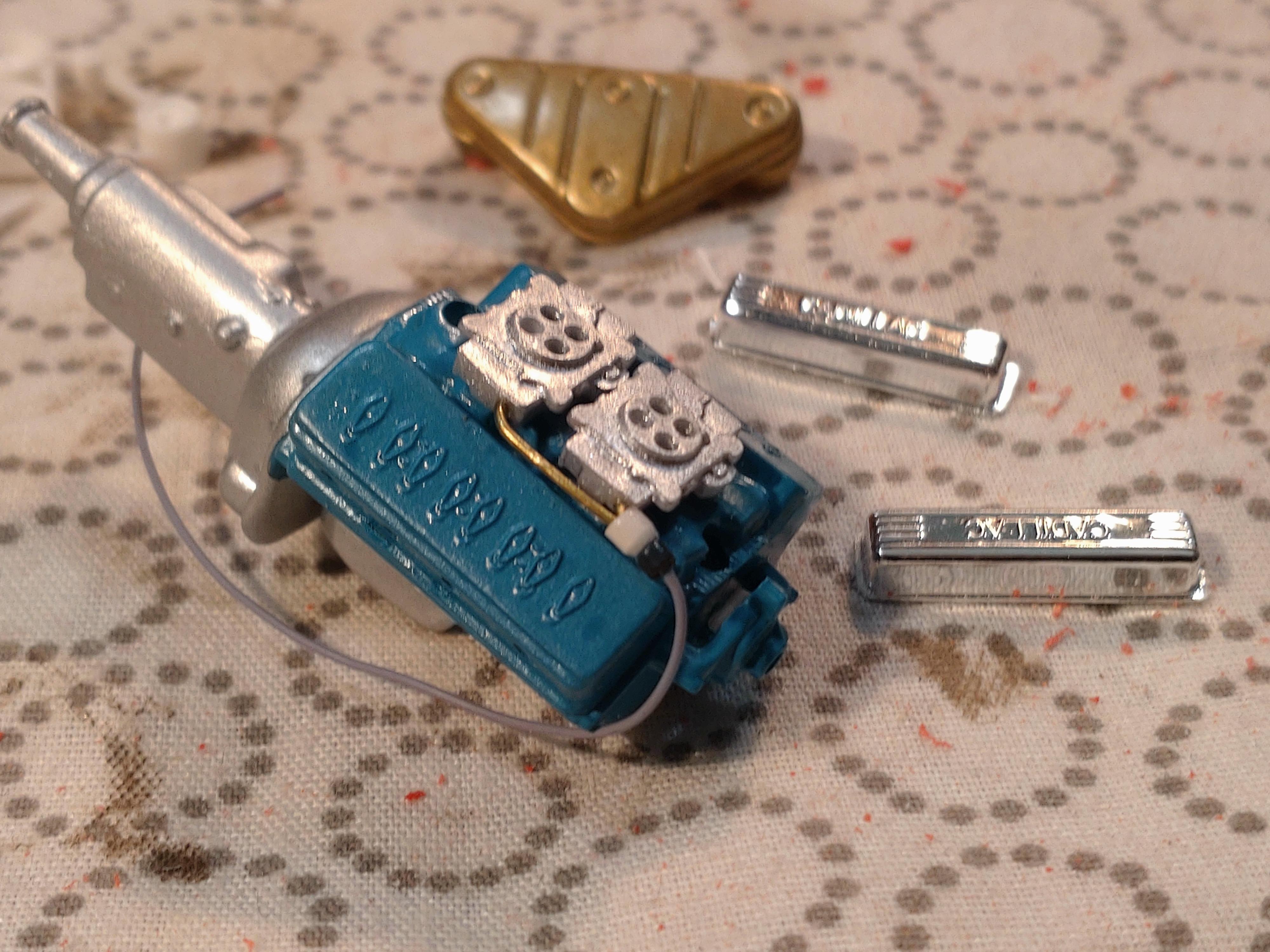

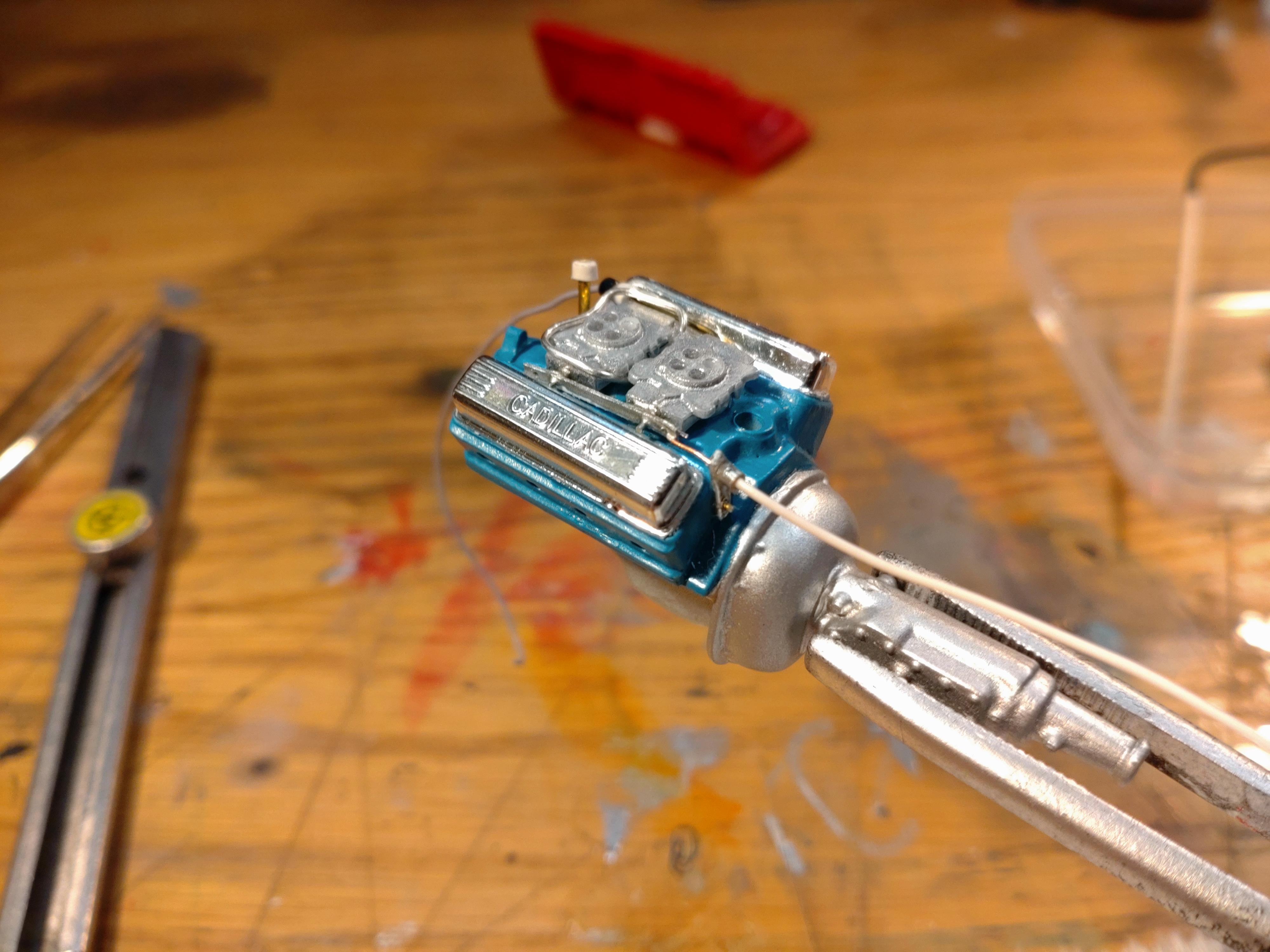

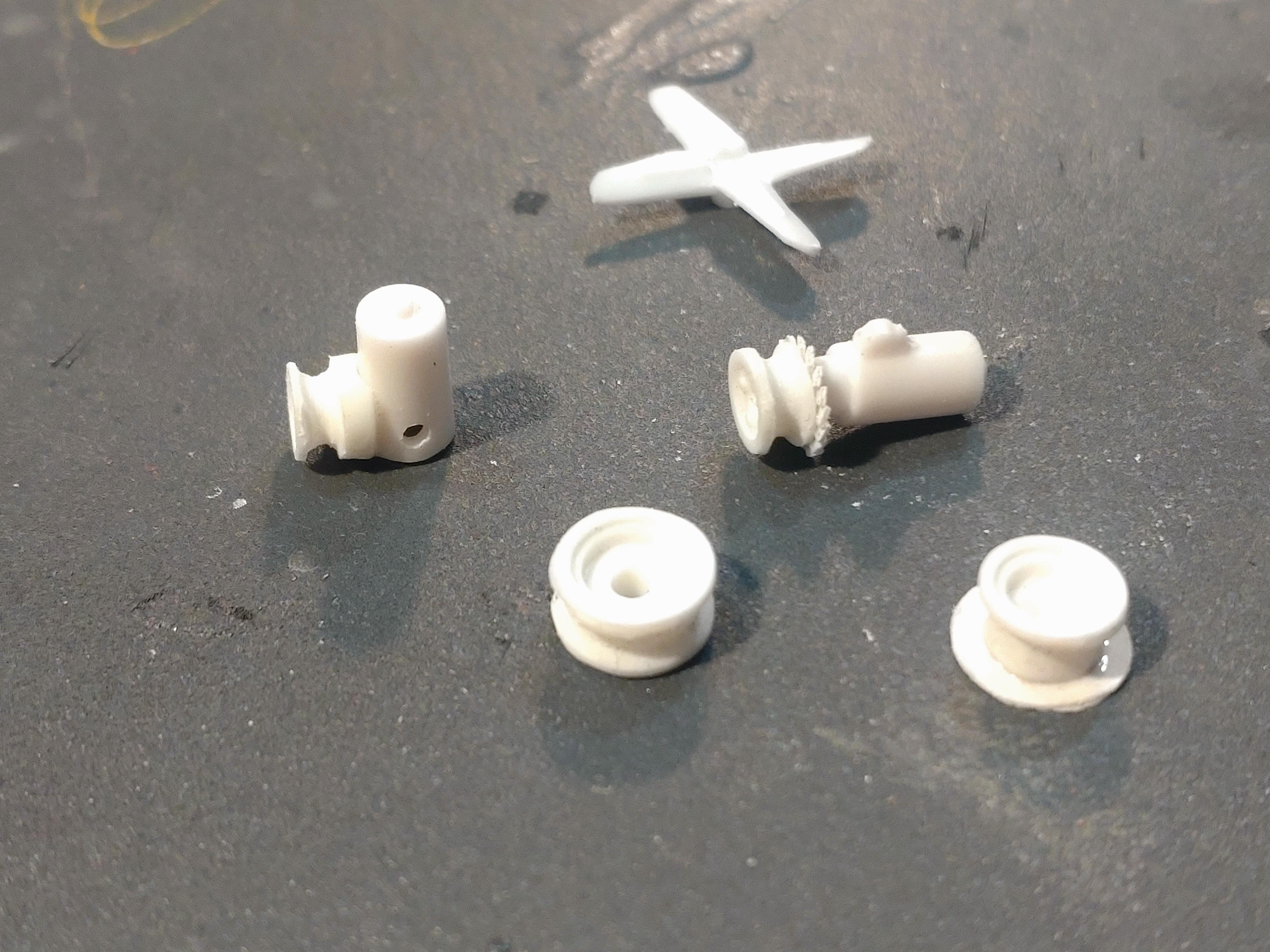

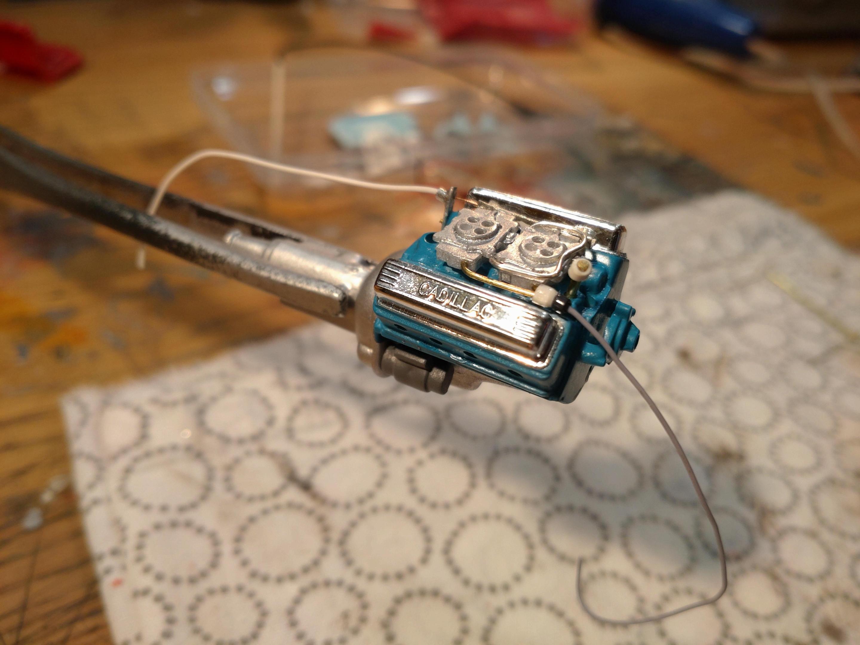

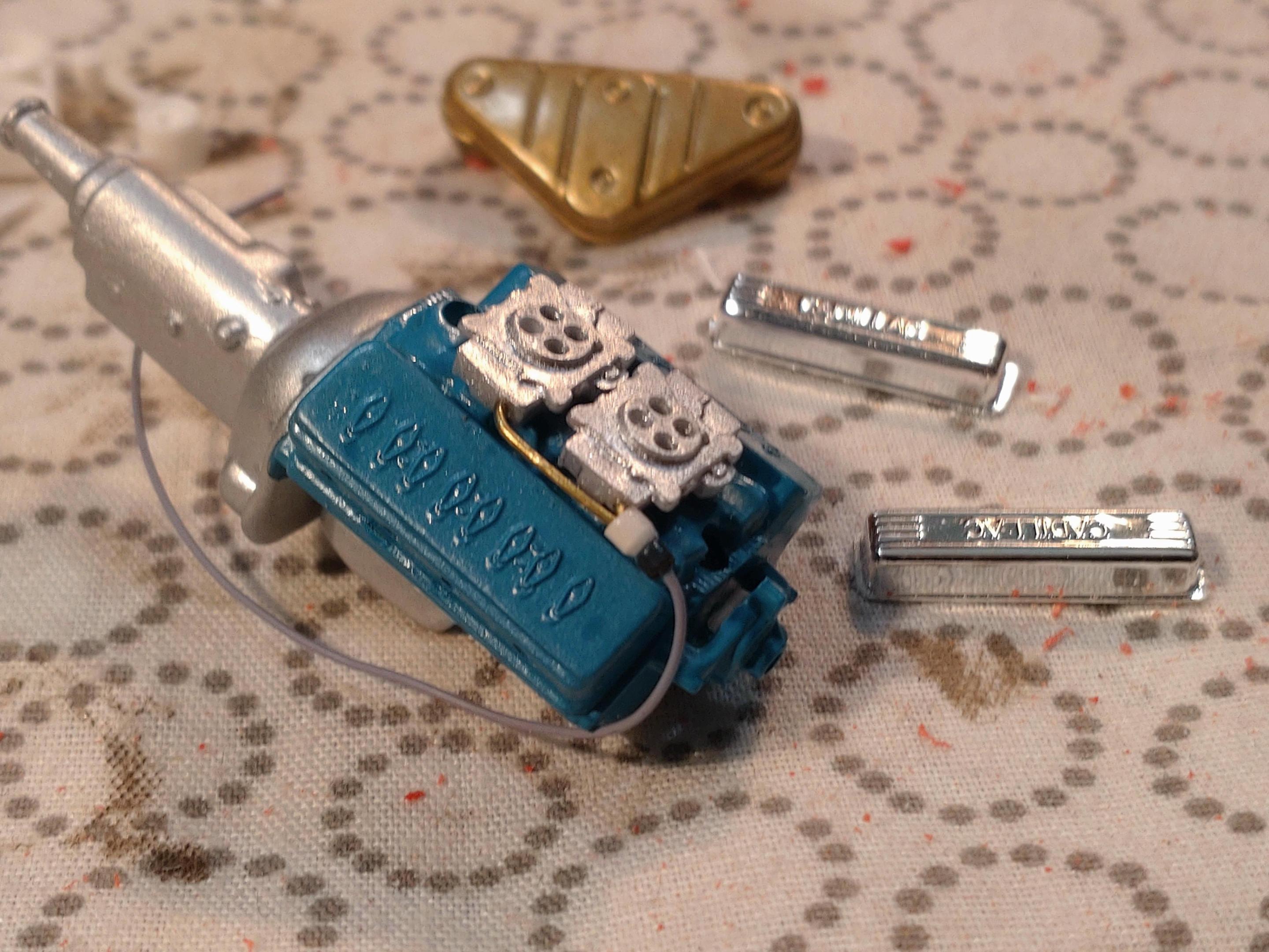

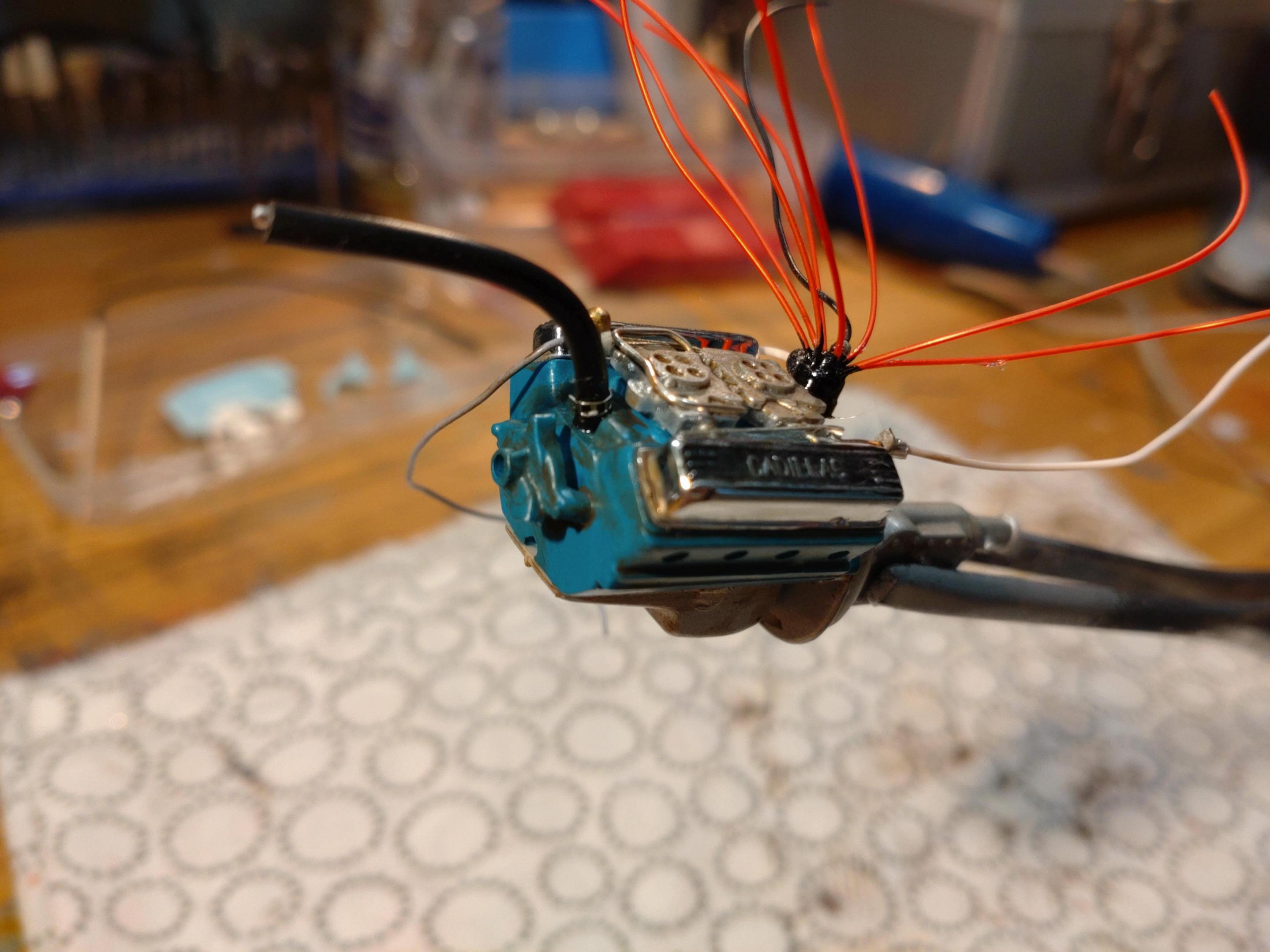

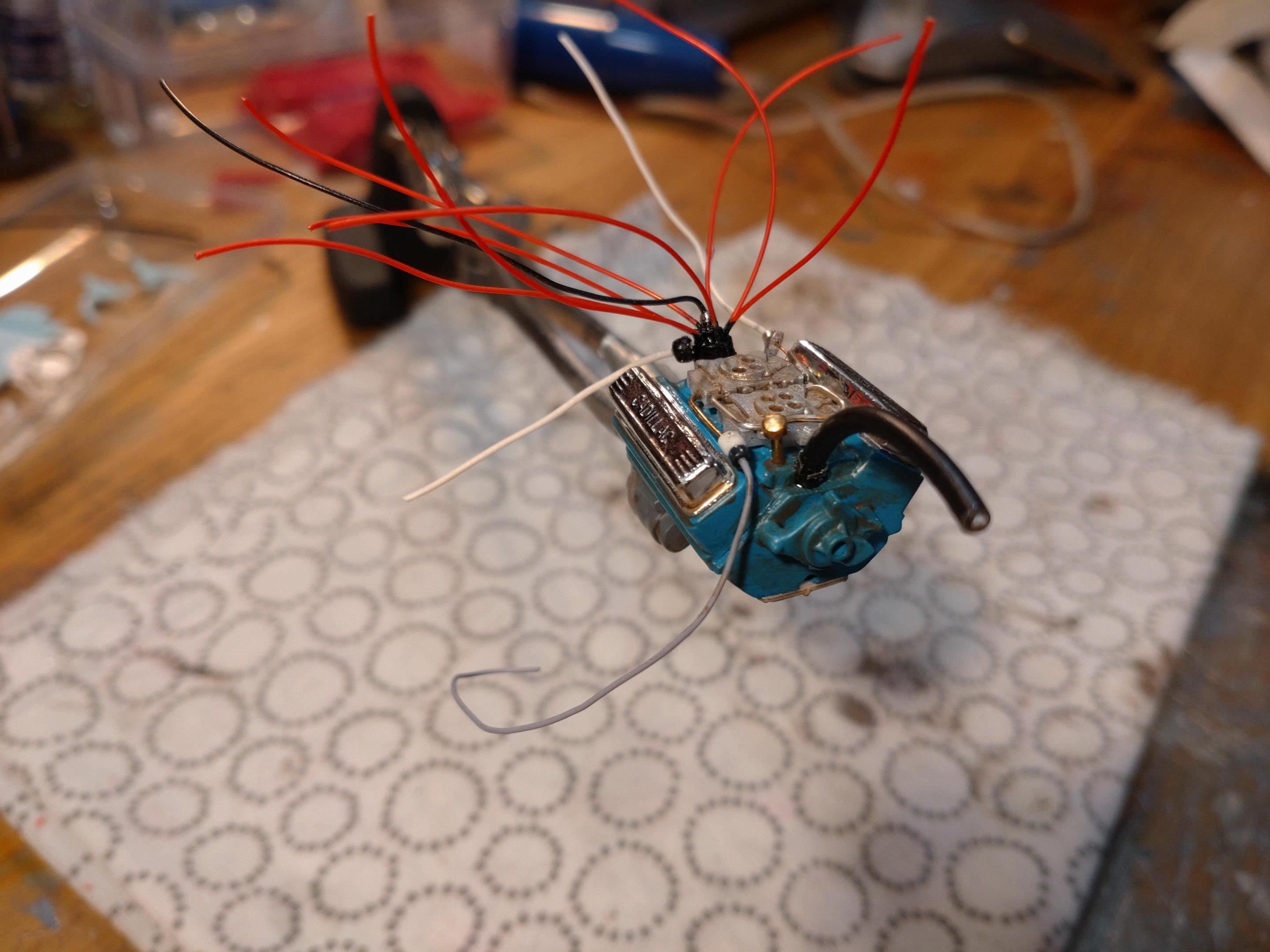

While the body is drying after sanding or the paint and putty have to harden I have started building the engine. Um, what engine? OK, I scavenged my boxes for parts that come as close as possible to the original. I even had that big triangular air filter left over. The engine will include parts from about 4 different kits. I´m adding some extra details for realness. The valve covers are not close to the simple painted original ones, but I had a pair with the Cadillac emblem. So it has a custom touch.
Next step was giving the engine a mild used look. It´s from ´57....
The air filter received some enhancement with chrome knobs and that flying V. There are two 1mm pegs underneath that fit into the holes of the double Holleys.
I couldn´t get any really good images of the belt and pulley setup. There seems to have been different variants. I will concentrate on the alternator and the power steering pump. Since I like working with "real" rubber belts, the pulley wheels needed some working. In this case I didn´t have to fabricate new wheels, but could use a kit part. I deconstructed the piece and cut off the wheels. After sanding the wheels round I used a triangular file for the first V-cut. Then I widened the V with a diamond file flat and smooth. These parts will be attached to the block with brass pins. That way they can take the slight pull of the rubber belts without breaking off.
