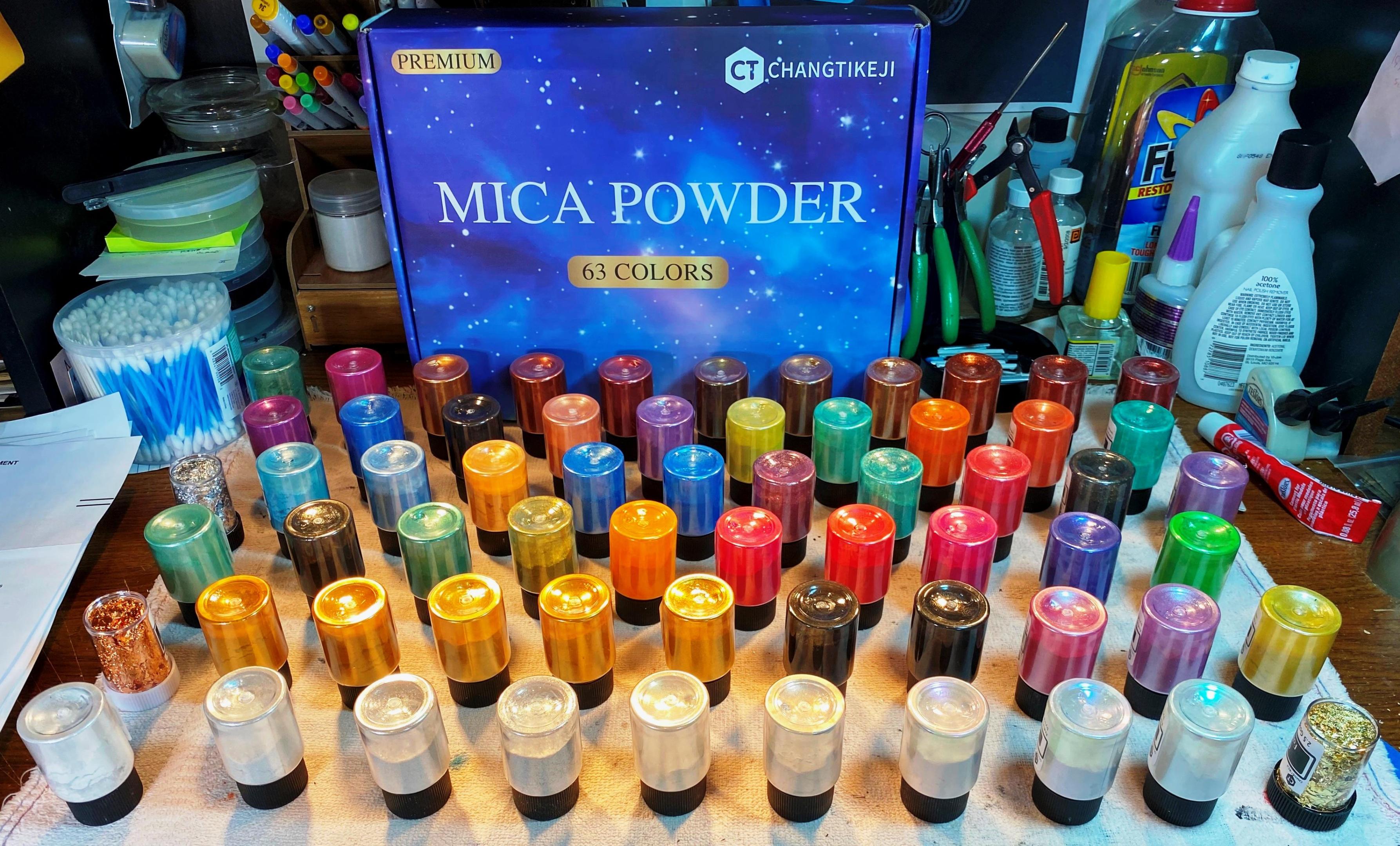

Bills72sj Posted November 16, 2023 Posted November 16, 2023 Now you have me curious. I have some pink mica powders. Though, I cannot imagine painting any of my projects pink.
