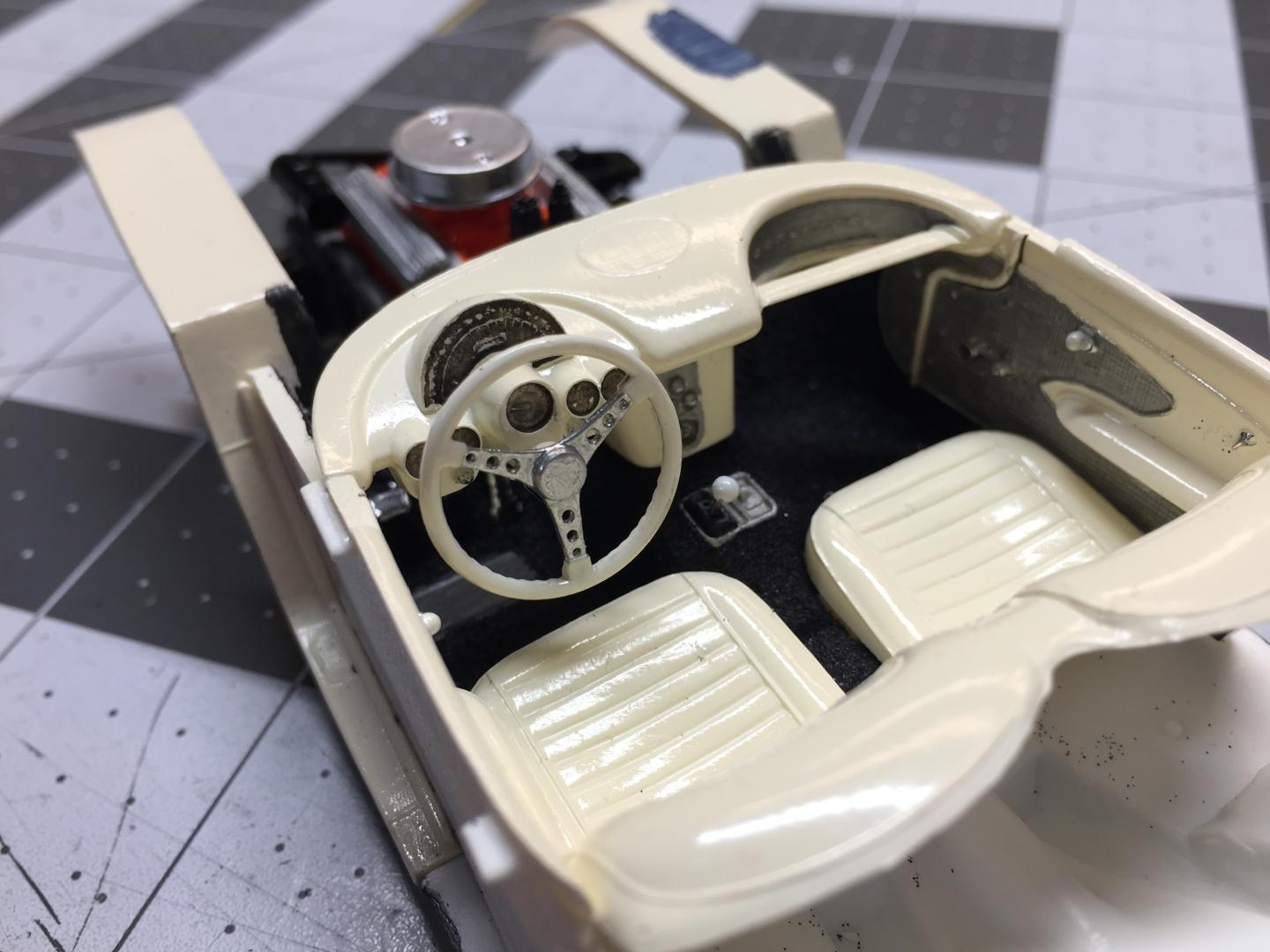

NOBLNG Posted November 20, 2023 Posted November 20, 2023 (edited) I believe I used Tamiya racing white for this interior. I should have given it a coat of flat clear?? Edited November 20, 2023 by NOBLNG 1
Milo Posted November 20, 2023 Author Posted November 20, 2023 40 minutes ago, NOBLNG said: I believe I used Tamiya racing white for this interior. I should have given it a coat of flat clear?? What did you do for the aluminum areas on the doors?

NOBLNG Posted November 20, 2023 Posted November 20, 2023 1 hour ago, Milo said: What did you do for the aluminum areas on the doors? I can’t recall for sure, but I think it would be Tamiya gunmetal or light gunmetal.
