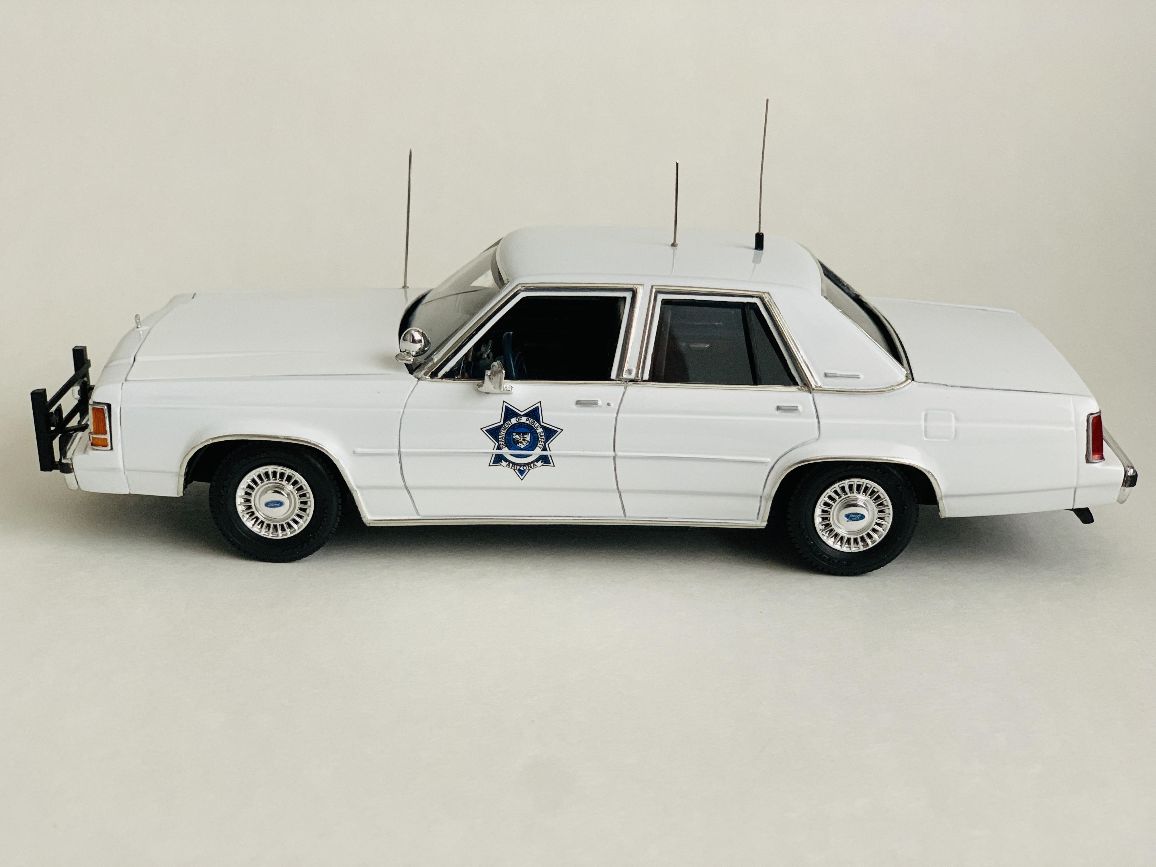

av405 Posted November 27, 2023 Posted November 27, 2023 8 hours ago, JollySipper said: Do you push, or pull the blade? I've heard you can do either with the surgical style blades..... I want to get some to try on my next foiling job. I pull the blade. I know someone else mentioned that they put the surgical blade on the xacto knife handle, but I actually like the surgical handle more for this particular task. Like anything else, try every option out and do what's best for you. 2 hours ago, Miatatom said: Got a part number from Amazon? https://www.amazon.com/gp/product/B08Z39CL8B/ref=ppx_yo_dt_b_search_asin_title?ie=UTF8&th=1 https://www.amazon.com/gp/product/B089XW2JQ4/ref=ppx_yo_dt_b_search_asin_title?ie=UTF8&th=1 Here's my last build just as reference. All of the window trim and bottom rocker panel is BMF. I'll never claim to be the best at this, but I figured I should back up my claims with something.

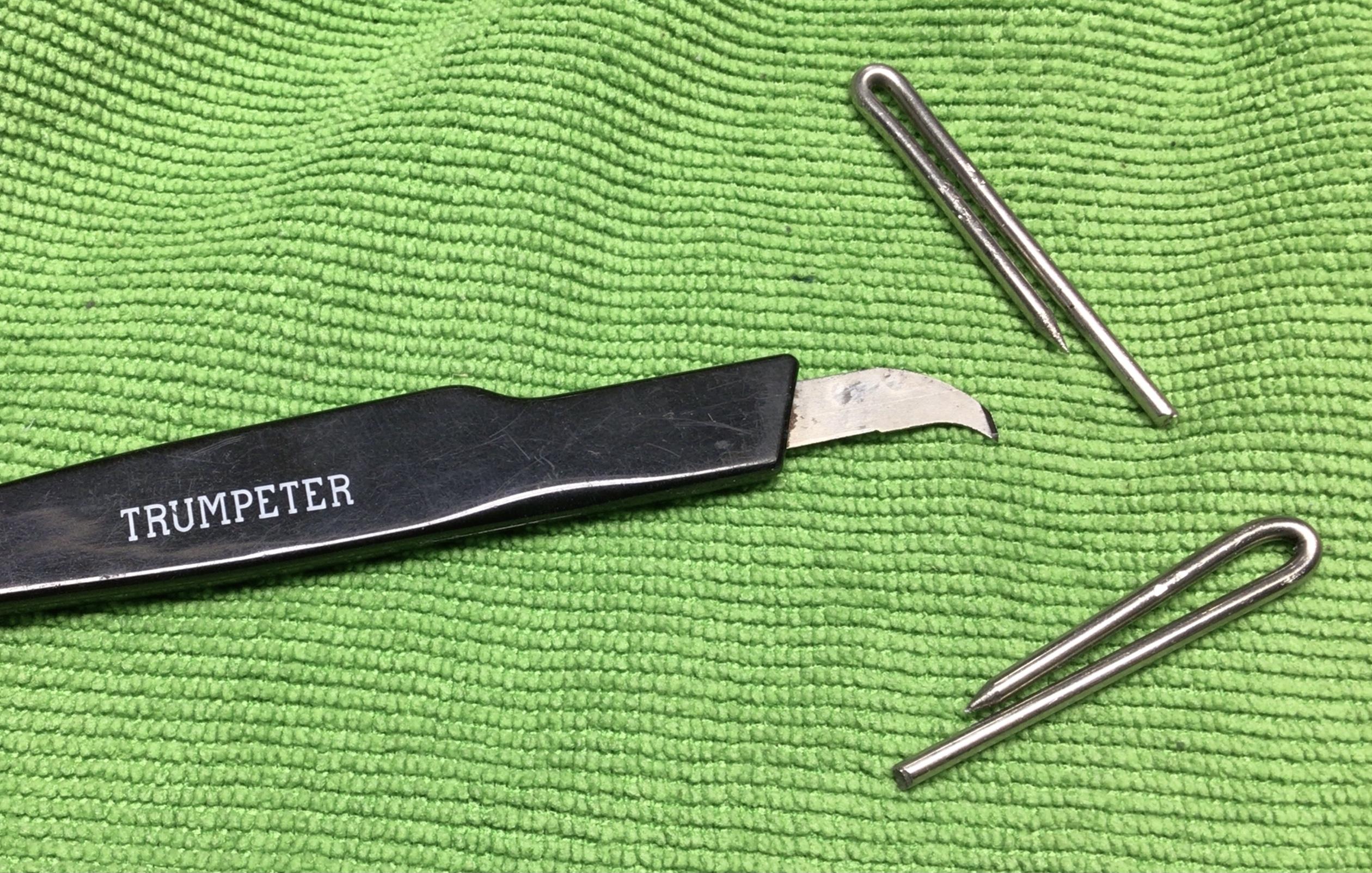

NOBLNG Posted November 27, 2023 Posted November 27, 2023 Another thing I’ve been doing lately, is carefully, lightly scribing the outline of moldings before priming, just to provide a slight guide for the hobby knife later. 5
espo Posted November 27, 2023 Posted November 27, 2023 A lot of good suggestions by others, and what I was sort of suggesting going in. I would like to add something that I and I'm sure many others do in preparation to adding chrome foil. During the very initial phase of body prep when you're getting panel lines and door openings scribed, include outlining body trim that you will be using chrome foil on in the finishing stages. The reason for this is that the edge of the trim will be easier to find and give the blade a line or grove to follow.
NOBLNG Posted November 27, 2023 Posted November 27, 2023 (edited) 34 minutes ago, espo said: A lot of good suggestions by others, and what I was sort of suggesting going in. I would like to add something that I and I'm sure many others do in preparation to adding chrome foil. During the very initial phase of body prep when you're getting panel lines and door openings scribed, include outlining body trim that you will be using chrome foil on in the finishing stages. The reason for this is that the edge of the trim will be easier to find and give the blade a line or grove to follow. On that note…here is my favourite tool for pre-scribing the side trim, and a couple that I made for doing window and door trim. They make it pretty much impossible to go off track and have to do a repair . Edited November 27, 2023 by NOBLNG 1
Fat Brian Posted November 27, 2023 Posted November 27, 2023 2 hours ago, StevenGuthmiller said: OOF! You're definitely better at it than I am! It usually takes me several days to foil a project! Of course that's only an hour here, two hours there, etc, but it still takes me some time. Steve I'm certainly not better at it but this is the second time I've built that particular kit so I knew where the problem areas where and had had some time to think of solutions. I'd day four hours is a bit more realistic of how long it took but still less time than I expected.
espo Posted November 27, 2023 Posted November 27, 2023 1 hour ago, NOBLNG said: On that note…here is my favourite tool for pre-scribing the side trim, and a couple that I made for doing window and door trim. They make it pretty much impossible to go off track and have to do a repair . Your post was coming in as I was writing mine. They asked for my approval to add your first and I agreed of course. There is a range of scribing tools out there and I have tried a few. I have picked up some that look like dental tools that work OK for me in some instances. I had been using a tool from Excel that seemed good until I bought the Tamiya Plastic Scriber II. That is now my go-to tool. I enjoy seeing what others are using as it will give me additional ideas, but in the end we all have something that works best for how we do our builds.
