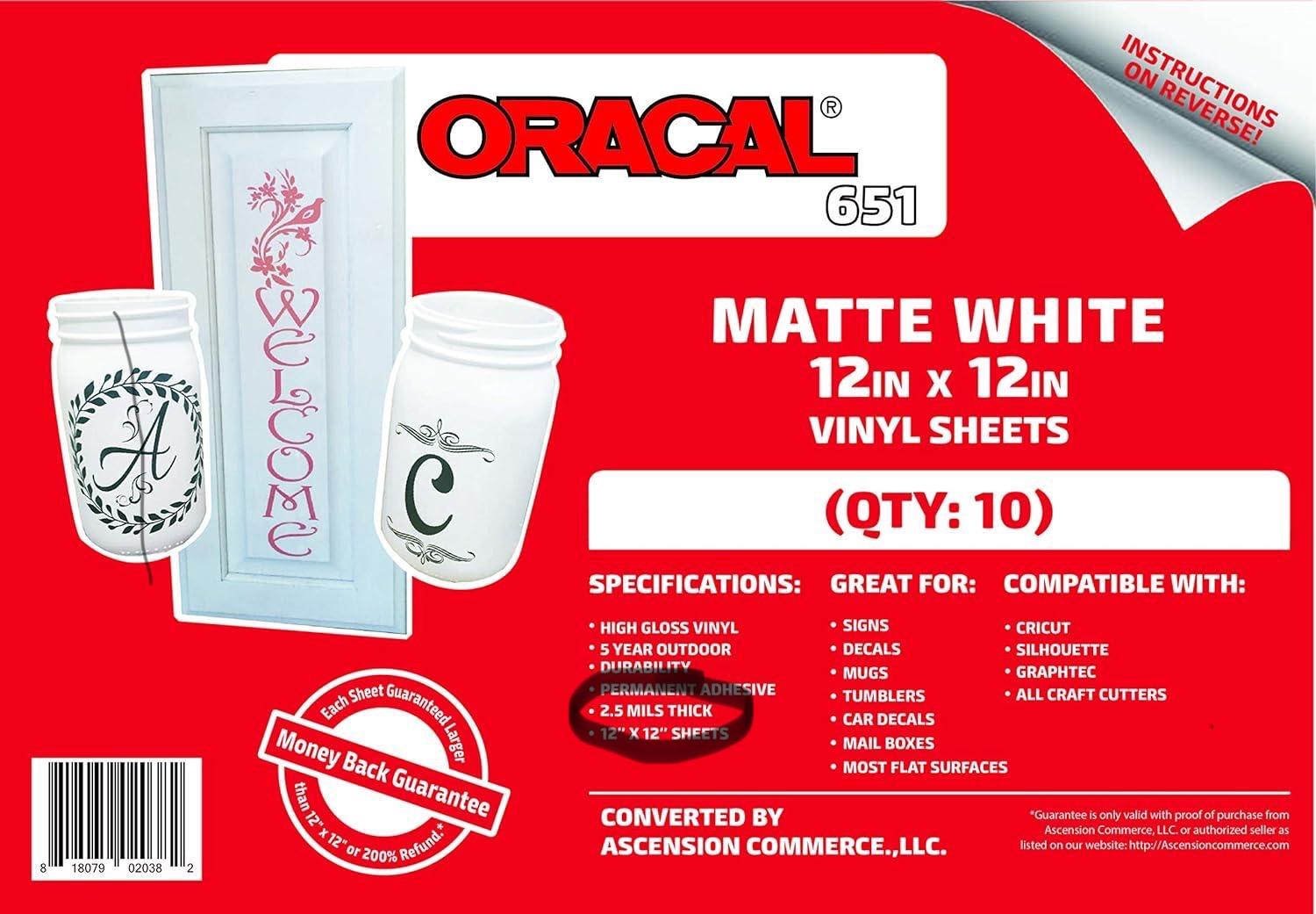

StevenGuthmiller Posted November 29, 2023 Author Posted November 29, 2023 Thanks for the suggestions everyone! On 11/27/2023 at 6:20 AM, camaro69 said: Hi Steve, I think Orafol cutted into the width you need could be a possible option. It´s mainly used by advertising companies and even on 1:1 cars for foiling so it should stick well. With a little warming you can lay it smooth on the areas you want to have it and with some water underneath it you even have time to bring it into the right position. I already used this to create the seams for vinyl tops and it worked very well. Rico P. S.: I can send you some leftover pieces if you want. If so feel free to send me a PM. I'm investigating this option, but I was wondering if you, or anyone else knows of the thickness of this product. I can get a package of this on Amazon for about $10.00. Steve 1
camaro69 Posted November 29, 2023 Posted November 29, 2023 (edited) Hi Steve, after a little research I can tell you that its thickness is about 0.06mm. If you can find some of the Oracal 631 it´s a little bit thicker round about 0.075mm. My offer for sending you some leftover pieces for at least much more then one model still stands. Here 2 samples... On the Cuda i did the Hockey stripes with this nearly 20 years ago now and clearcoated right out of a rattlecan... and on the NSX the white stripes over the body. Cheers, Rico Edited November 29, 2023 by camaro69 added some pictures

NOBLNG Posted November 29, 2023 Posted November 29, 2023 (edited) 8 hours ago, StevenGuthmiller said: Thanks for the suggestions everyone! I'm investigating this option, but I was wondering if you, or anyone else knows of the thickness of this product? It says 2.5mils which would be 0.0025”. Which would be 1/16” in 1:1 scale. What about just doing a couple coats of a filler primer? Edited November 29, 2023 by NOBLNG

StevenGuthmiller Posted November 29, 2023 Author Posted November 29, 2023 4 hours ago, NOBLNG said: It says 2.5mils which would be 0.0025”. Which would be 1/16” in 1:1 scale. What about just doing a couple coats of a filler primer? Thanks Greg! I missed the thickness on the package. Thanks for pointing it out. Filler primer? Jees!! Why didn't I think of that?!! Once the rest of the modification work is finished, I could just mask the sides of the roof and spray however many coats of filler needed to create the thickness I want down the center! GENIUS! Thanks Greg!! I think we may have a winner! Steve 2
