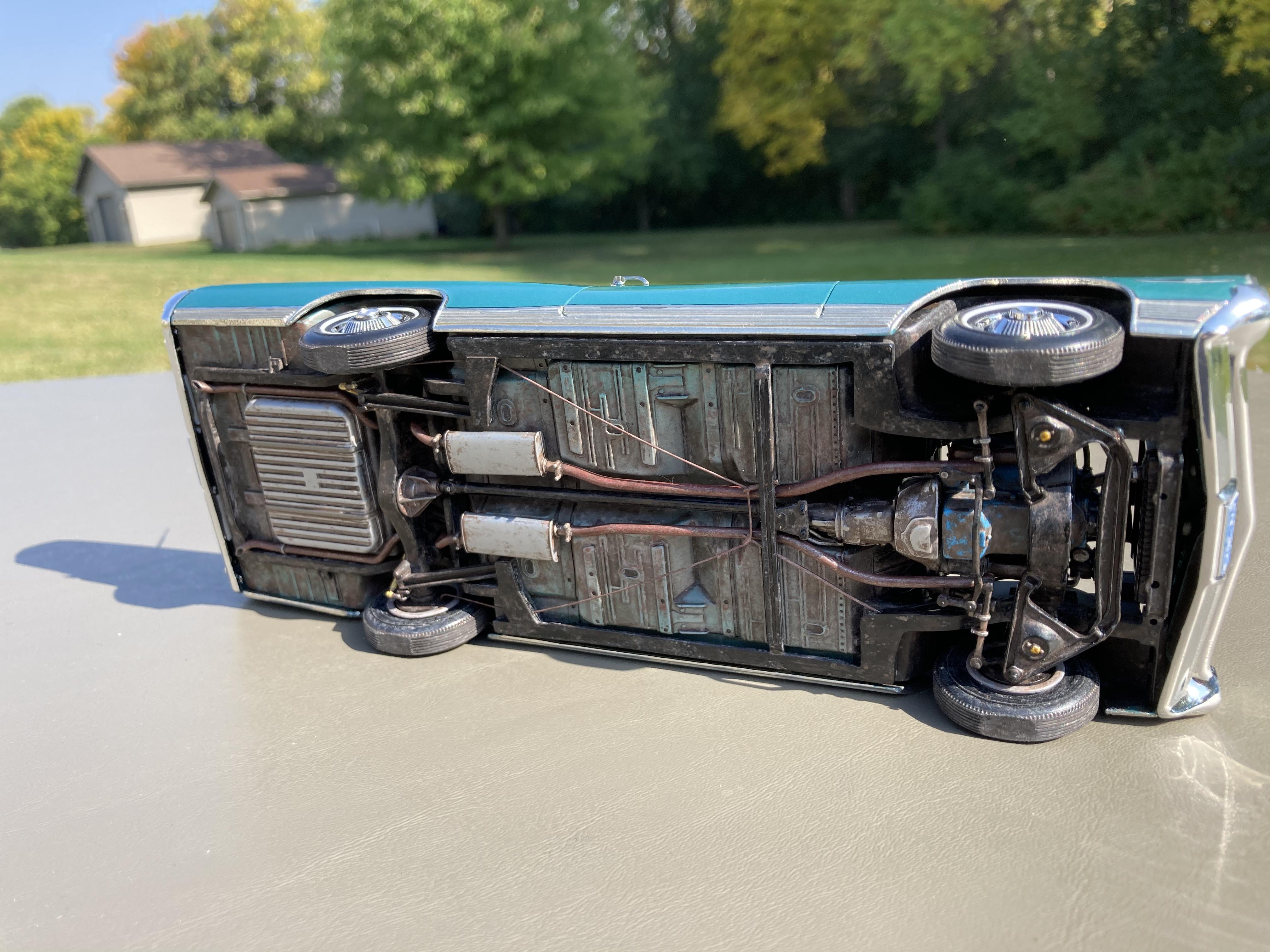

StevenGuthmiller Posted November 28, 2023 Posted November 28, 2023 Well, I guess my first question would be, what’s “accurate”? There are many different metals and finishes for exhaust parts, and there are numerous directions that you can go for weathering as well. Just the soil color alone in a particular region can make a big difference. But that’s probably a little further into the weeds than you would prefer to go. My process is to of course remove all mold lines, replace or modify whatever requires it, then prime and finally paint with Alclad paints. As a rule, I’ll use an aluminum shade for the mufflers, and a darker steel shade for the remainder of the exhaust pipes. Then my general practice is to decide on how much rust I want to portray. My simple rust technique consists of spraying a very light mist of red oxide primer from a couple of feet away until the desired affect is reached. I at some point will usually add a single light coat of clear to protect the Alclad from rubbing off in spots from too much handling, either before or after rust. Finally, I just use a combination of washes and dry brushing of acrylic craft paint to achieve the desired weathering. Here’s a couple of shots. One very lightly weathered, and the other more heavily. Steve 5
Vintage chromoly Posted November 28, 2023 Author Posted November 28, 2023 Thank you, Steve. I appreciate the reply. I suppose “Accurate” would be what you showed in the 68 Coronet pic. I build 60’s musclecar models and like to build them to replicate a nice, clean, driven car. As of now, I’ve been using old Testors enamel “aluminum” on the mufflers and Testors enamel “steel” on my pipes. I have Alclad “chrome”, on hand. This is probably a dumb question, but does Alclad come in a variety of shades? thanks for the help, Rob

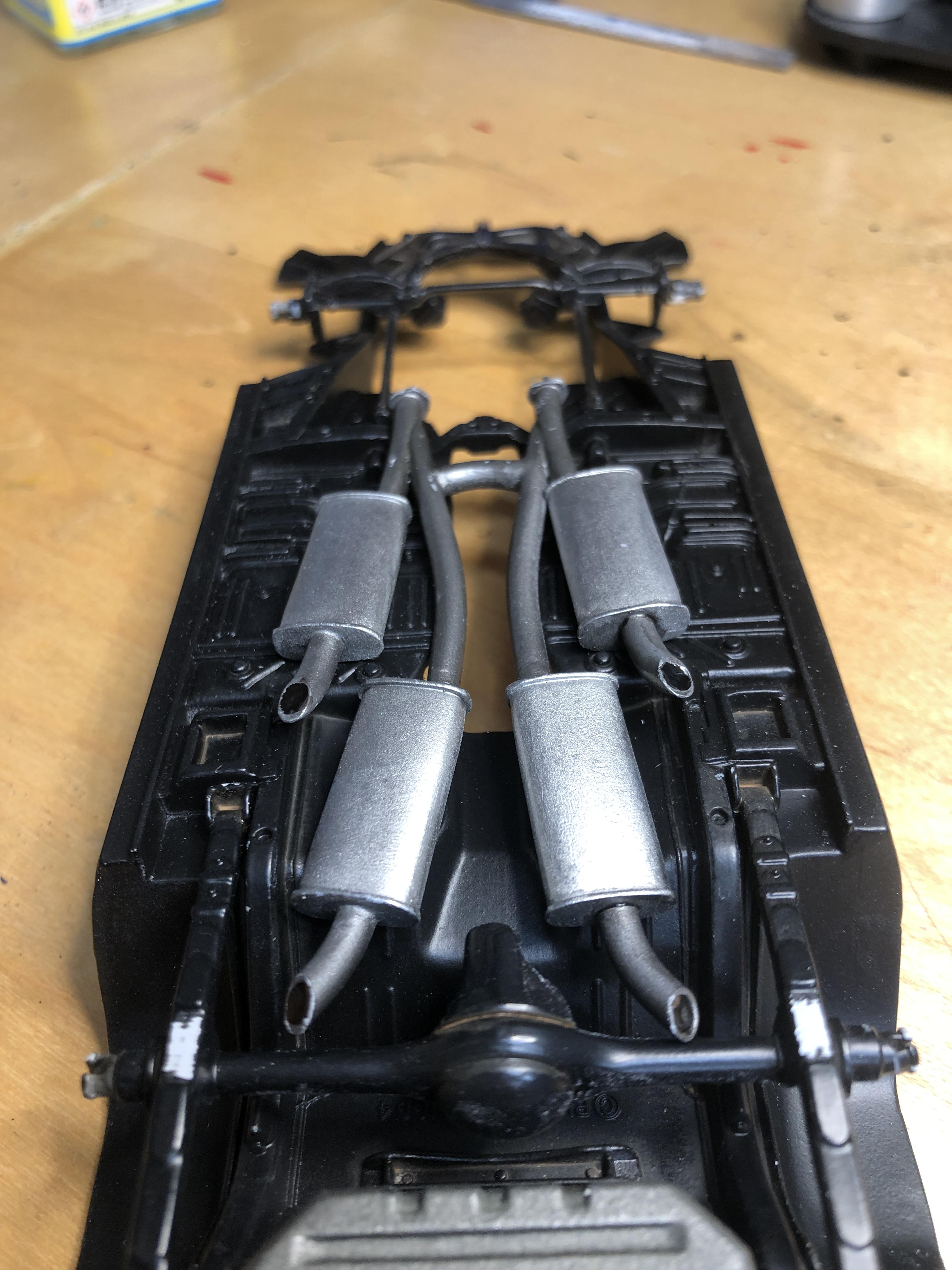

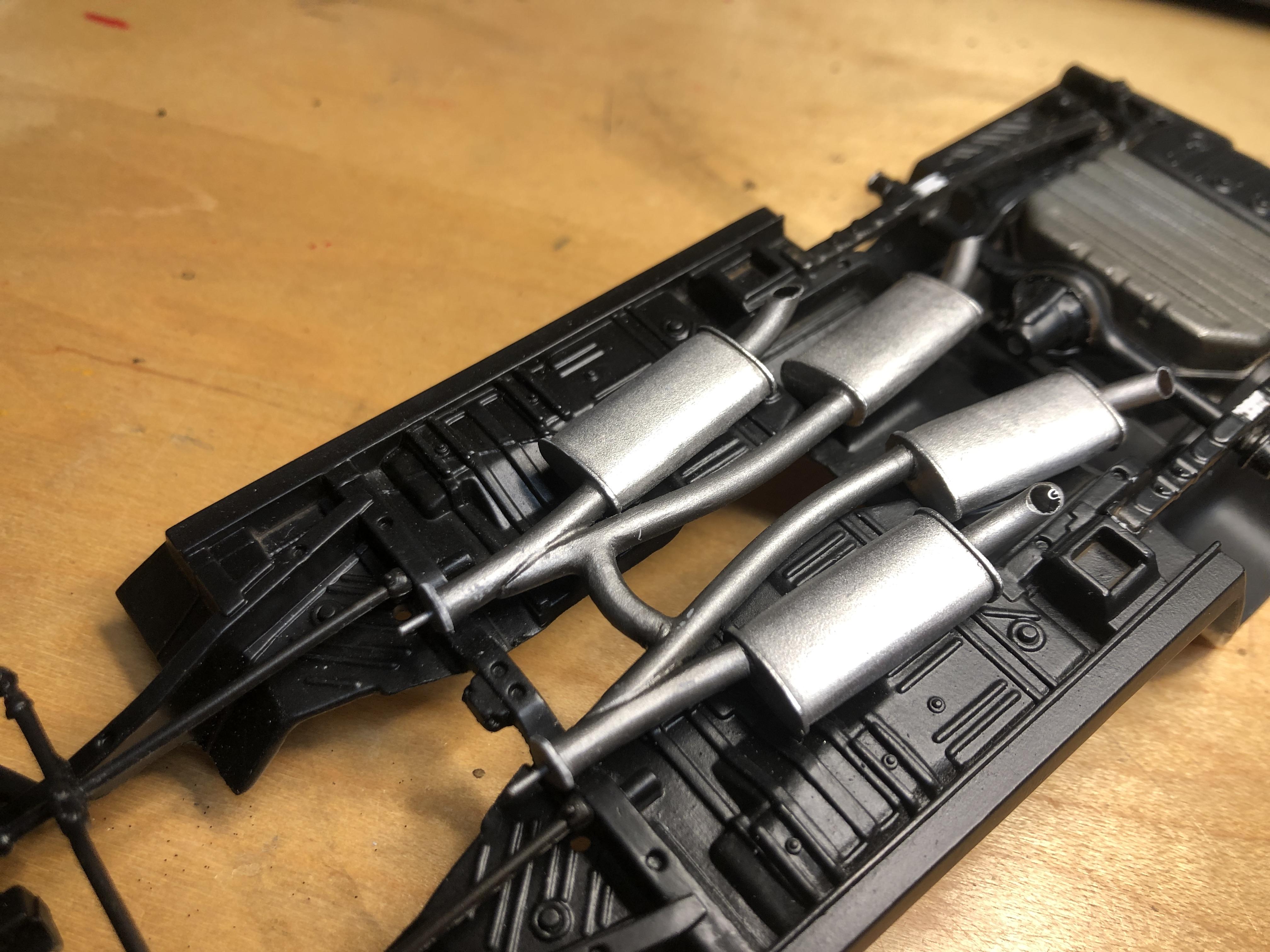

Vintage chromoly Posted December 8, 2023 Author Posted December 8, 2023 I Shot some Alclad this evening. this is an exhaust I made for my Silver Bullet GTX folly. the pipes are “magnesium” and the mufflers are “aluminum”. I washed it with a little black panel line . I’m fairly happy with it, but I’m sure I’ll get better results as I work with the product more.
