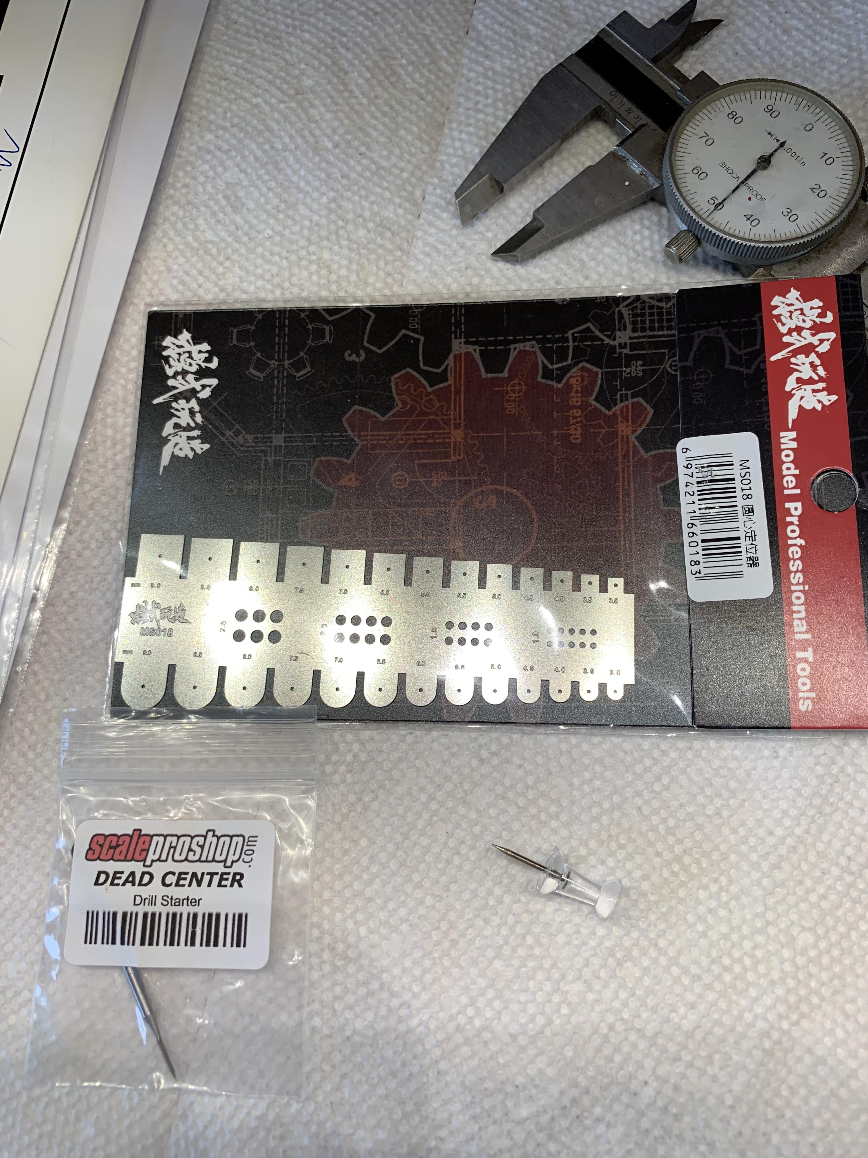

R. Thorne Posted November 30, 2023 Posted November 30, 2023 If the center hub is not bigger than .350”, this works good in conjunction with a pin or other device or tiny drill for the centering hole. 1
