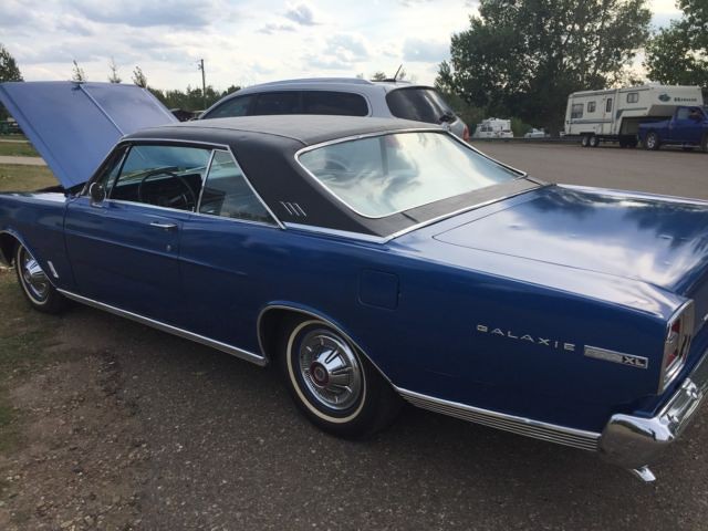

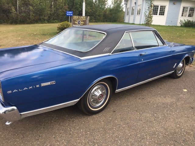

StevenGuthmiller Posted November 30, 2023 Posted November 30, 2023 Looking good so far John, but if I may make a suggestion for future projects? Whether using tape for the top or some other method, you might want to more closely investigate the placement of the top seams. As a general rule, the seams should be placed much further "outboard" than what you have done here. In most cases, the seams are placed within a few inches of the corners of the glass, front and rear. Not meaning to be critical, but I find it very useful throughout the course of my builds to receive a bit of constructive criticism or suggestions. I don't know everything, (far from it) so I am always open to any help that others can offer for my projects. I hope I haven't stepped on any toes here. If so, forgive me. I wasn't able to find any clear photos of the seams on the '65, but these from a '66 would have been placed in roughly the same vicinity. Steve 2

ModelcarJR Posted November 30, 2023 Author Posted November 30, 2023 Thanks, Steve and Matt! I appreciate your comments! Steve, your comment is very well received. I, too, am always open to constructive criticism. My method is always the product of math when it comes to the vinyl top. The top is 2 1/4" wide so I first went with 3/4" wide across the top. That didn't look right so I then measured 5/8", 1 inch, 5/8" which made the center actually 1 1/8" so that I could have 1/16" overlap for the seam on each side. That's a lot of math at 7 AM while I am still drinking coffee trying to wake up. I now see I should have gone with 3/8", 1 1/2" (1 5/8"), and 3/8". That would have looked better, the 2" tape would still work widthwise, and it would have probably worked better with the square corners (less stretching). So in the future, I'll keep that in mind. Thanks for the comment, Steve!
