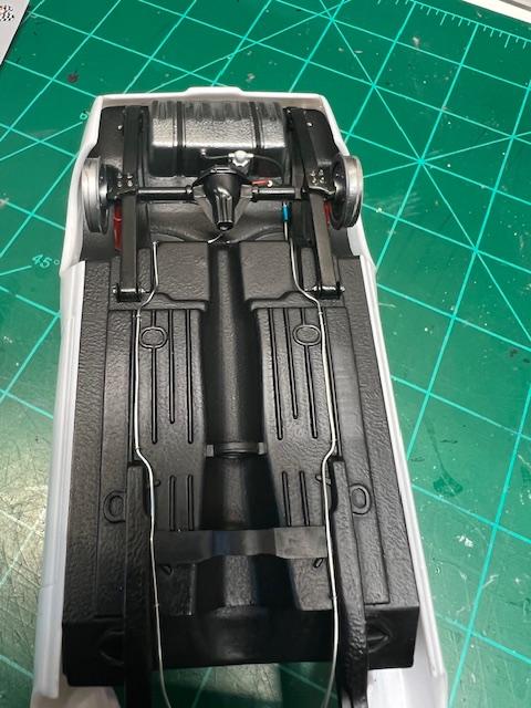

Quick update.  Complete re-do of the rear suspension.  Actually had to use a new chassis from a second kit (guess that's why I have two of a lot of models, LOL).  For some reason the paint was lifting off of the original and requiring a purple bath.  I'll clean that up and build the second kit stock someday.  Anyway, got the shackles and shocks sorted out and redone.  Added an electric fuel pump and brake/fuel lines.  Will also be adding some old school Lakewood traction bars.
BRCamarorearchassis3.jpg.752a9418433eb52b468a8a718c81083d.jpg               BRCamarorearchassis2.jpg.a4e562a8033ca4523773ef246082e766.jpg
Now on to the front suspension.  Below is what comes in the kit.  Plan is to make some springs/shocks.  Not going overboard on it, but just couldn't leave these.
With Christmas this week and all I've got to do around the house for family coming over, I will probably not be getting much modeling done the rest of the week.
Merry Christmas everyone!  Hopefully Santa brings you some new kits or supplies.
I know I'm late to the game, but your brake/fuel lines are killer! They look amazing!
