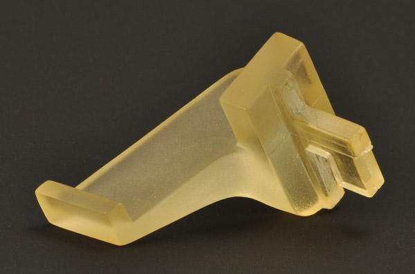

robdebie Posted December 4, 2023 Posted December 4, 2023 11 hours ago, customsrus said: Which is better to cast small parts. Casting resin or epoxy resin. I've used both, and I was always impressed how much harder, stiffer and stronger epoxy is. But epoxy 'eats' the molds much quicker, and casting time is generally much longer. Therefore it remains the less practical option. I used epoxy mostly for parts that required the extra strength (like the bracket below) or transparancy. For the latter I bought a special epoxy, with a pot life of 10 hours, and a cure time of 4 days. Talk about impractical! But the parts came out very nice. The second photo shows the original kit part plus the epoxy casting. Rob 2
