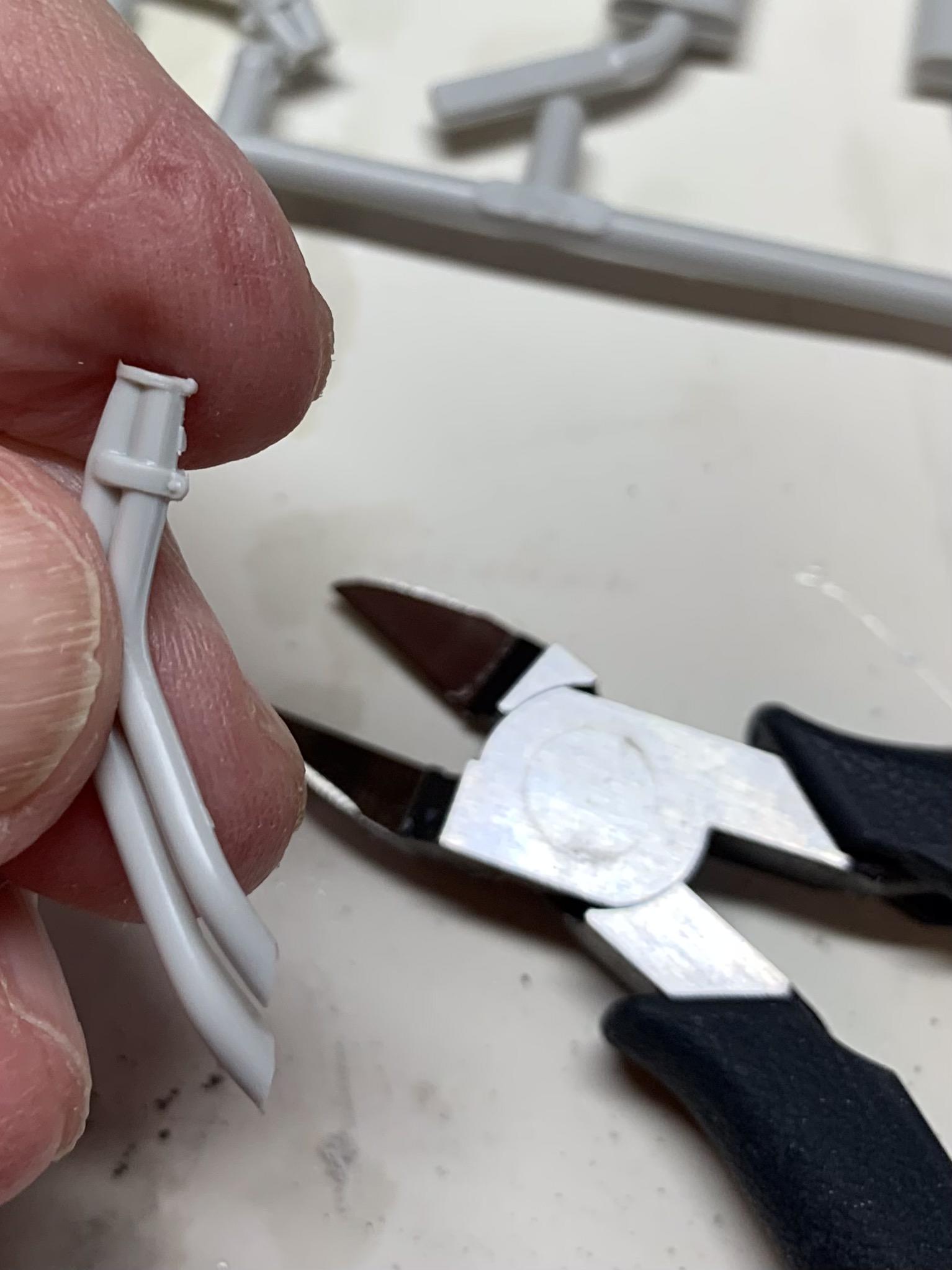

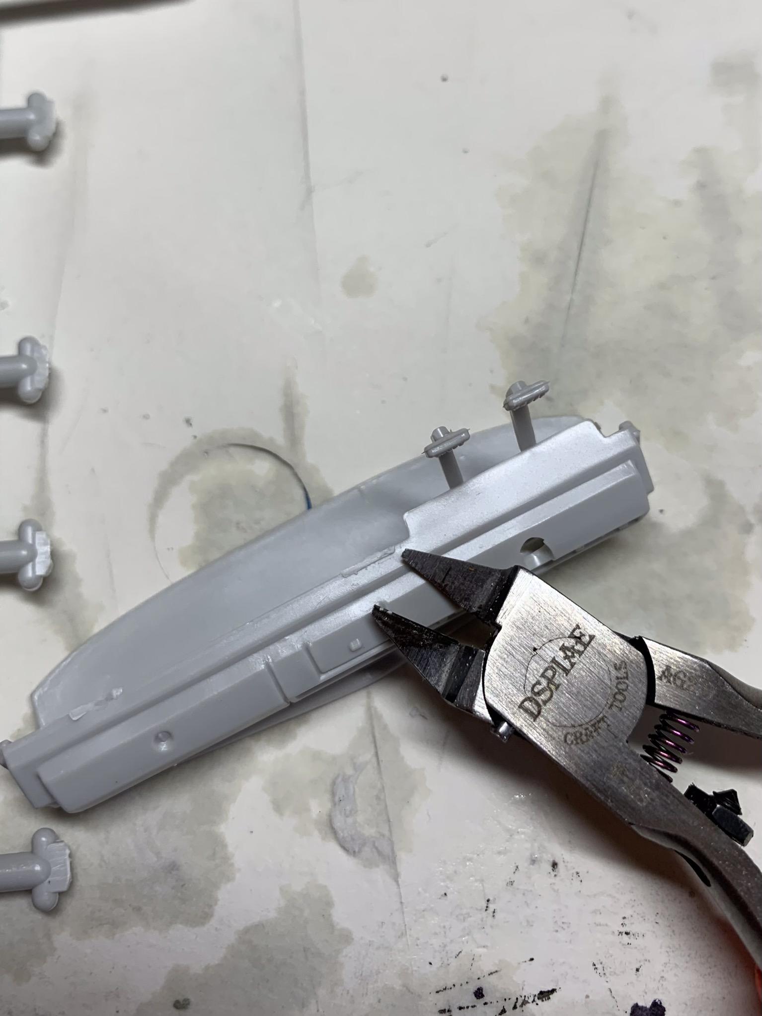

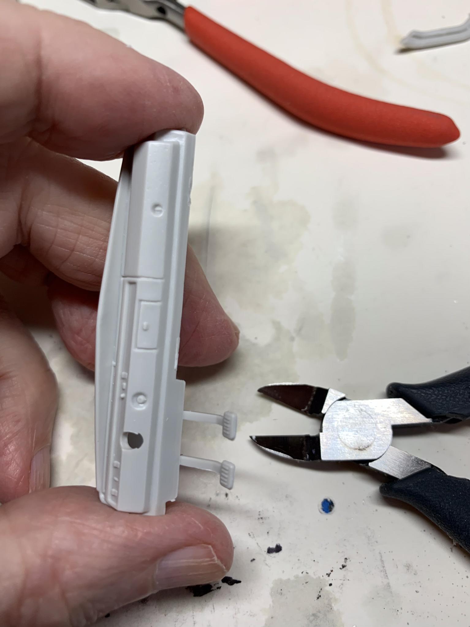

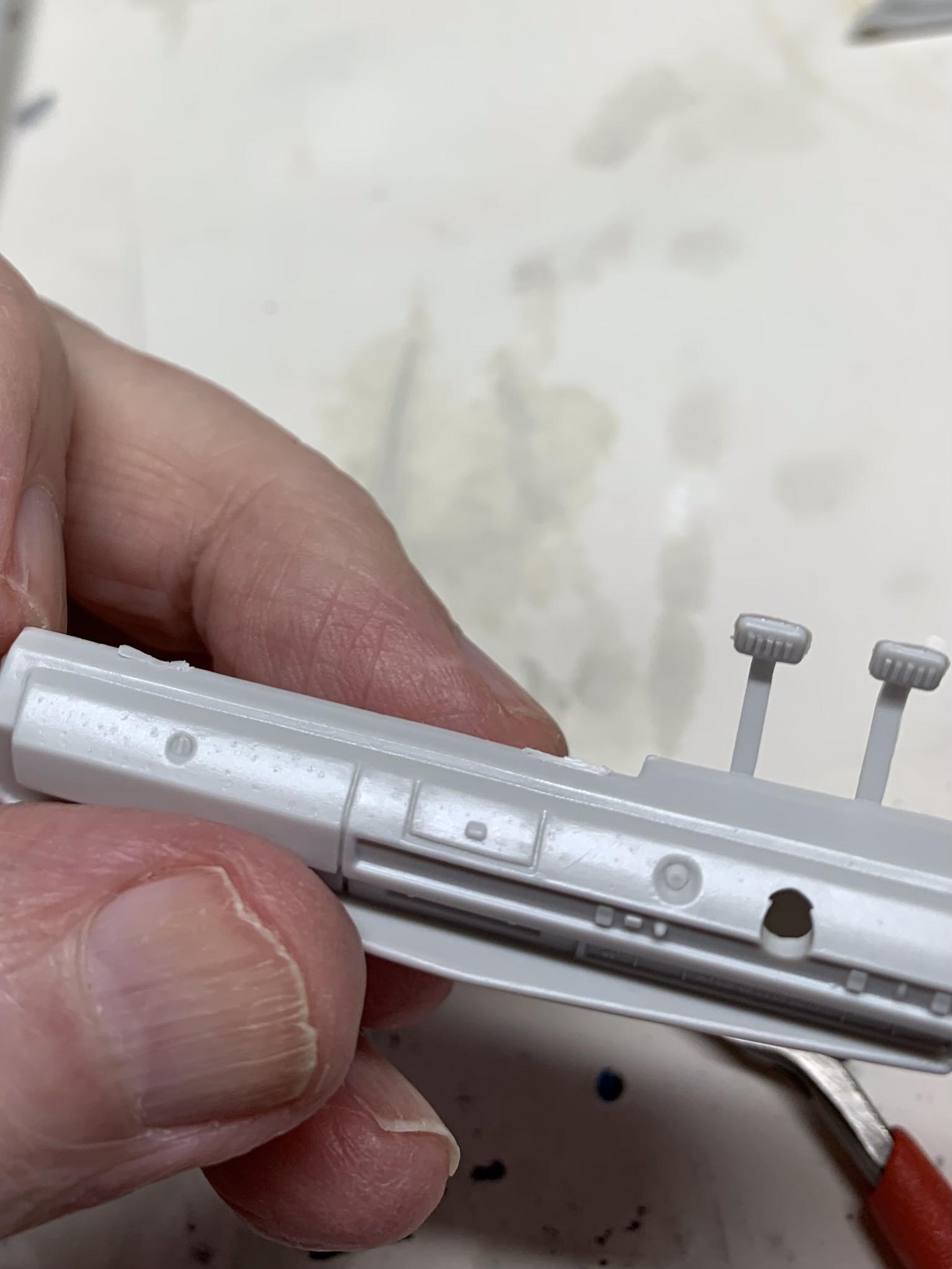

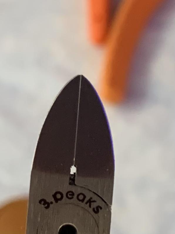

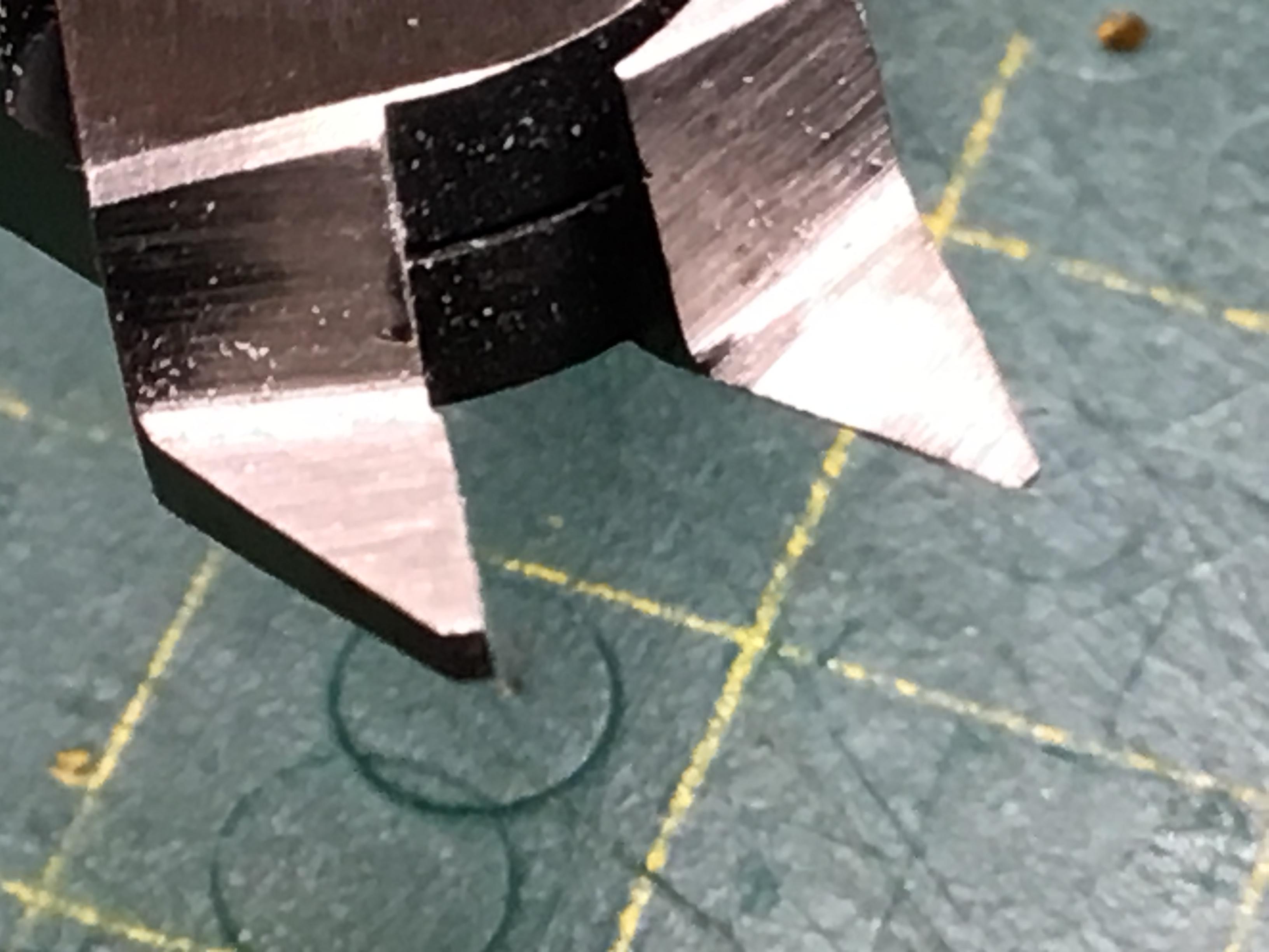

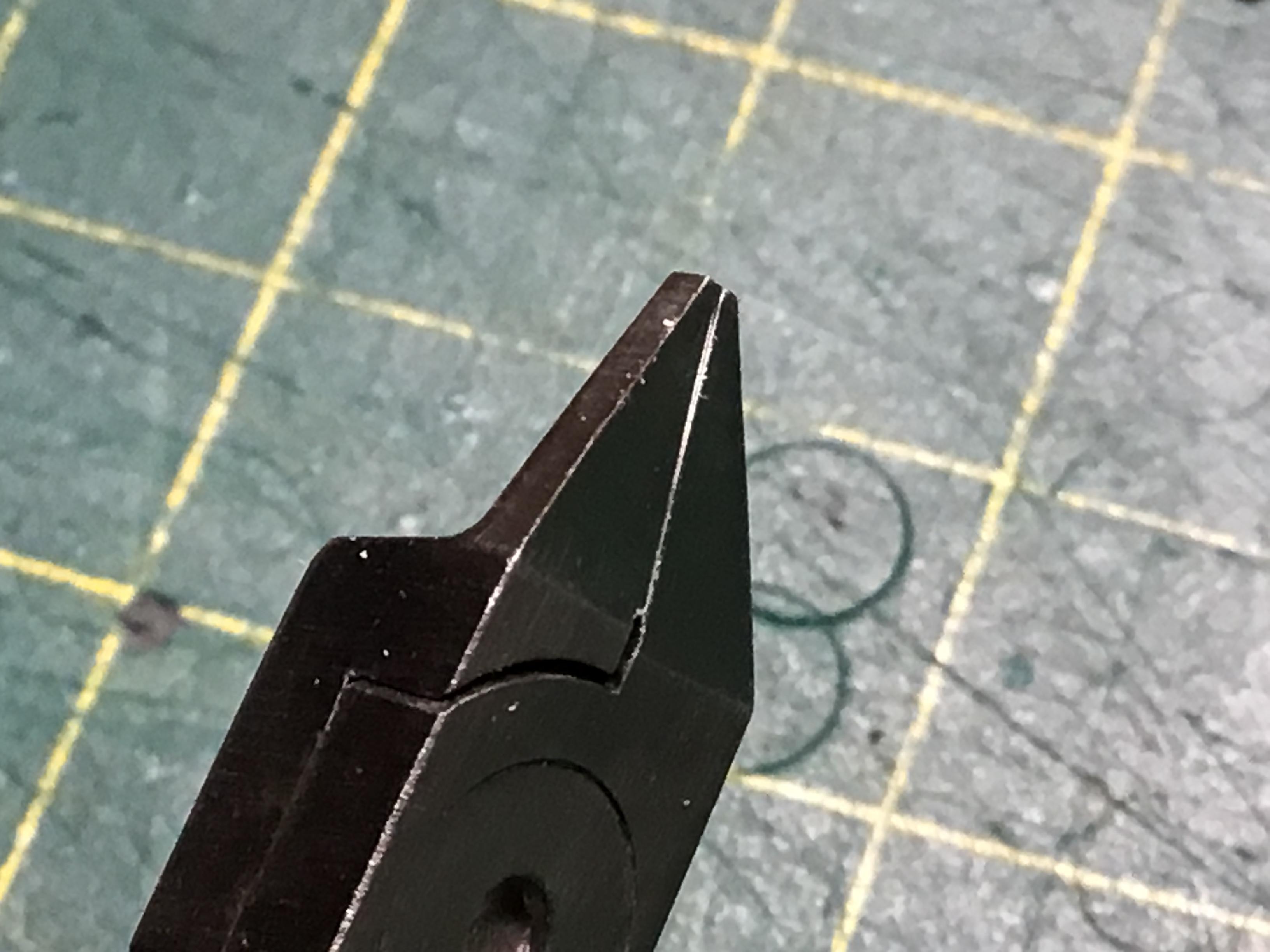

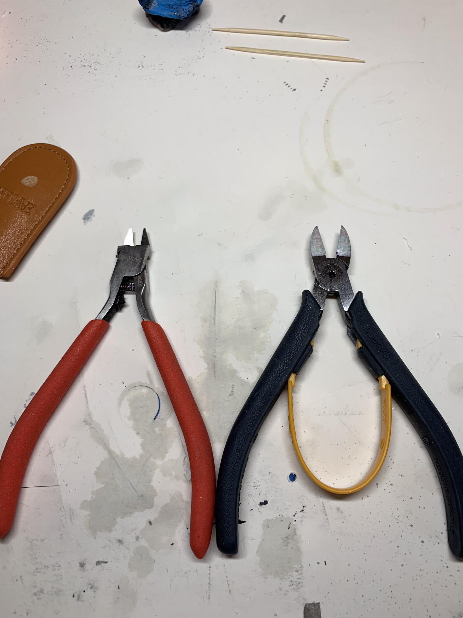

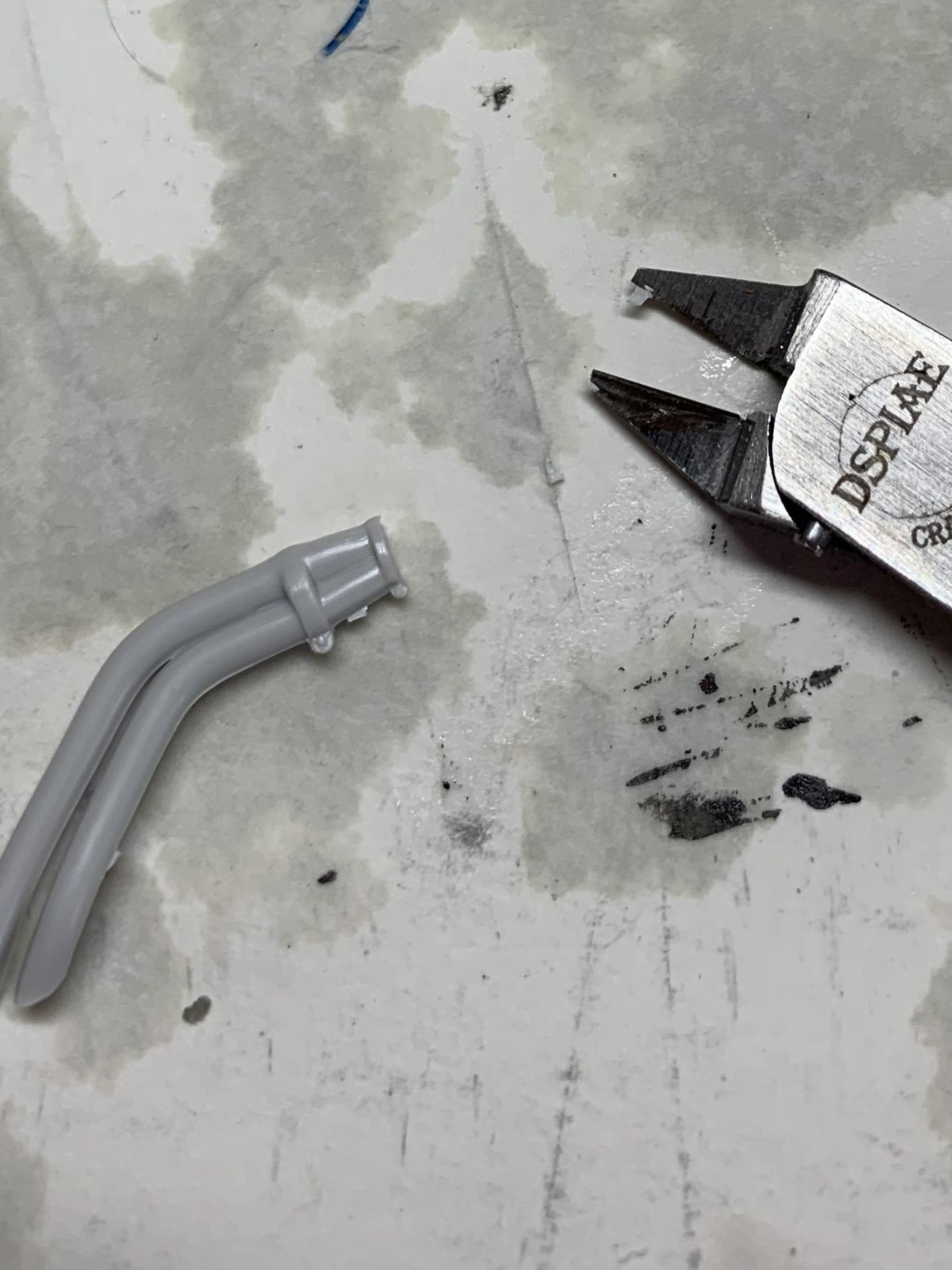

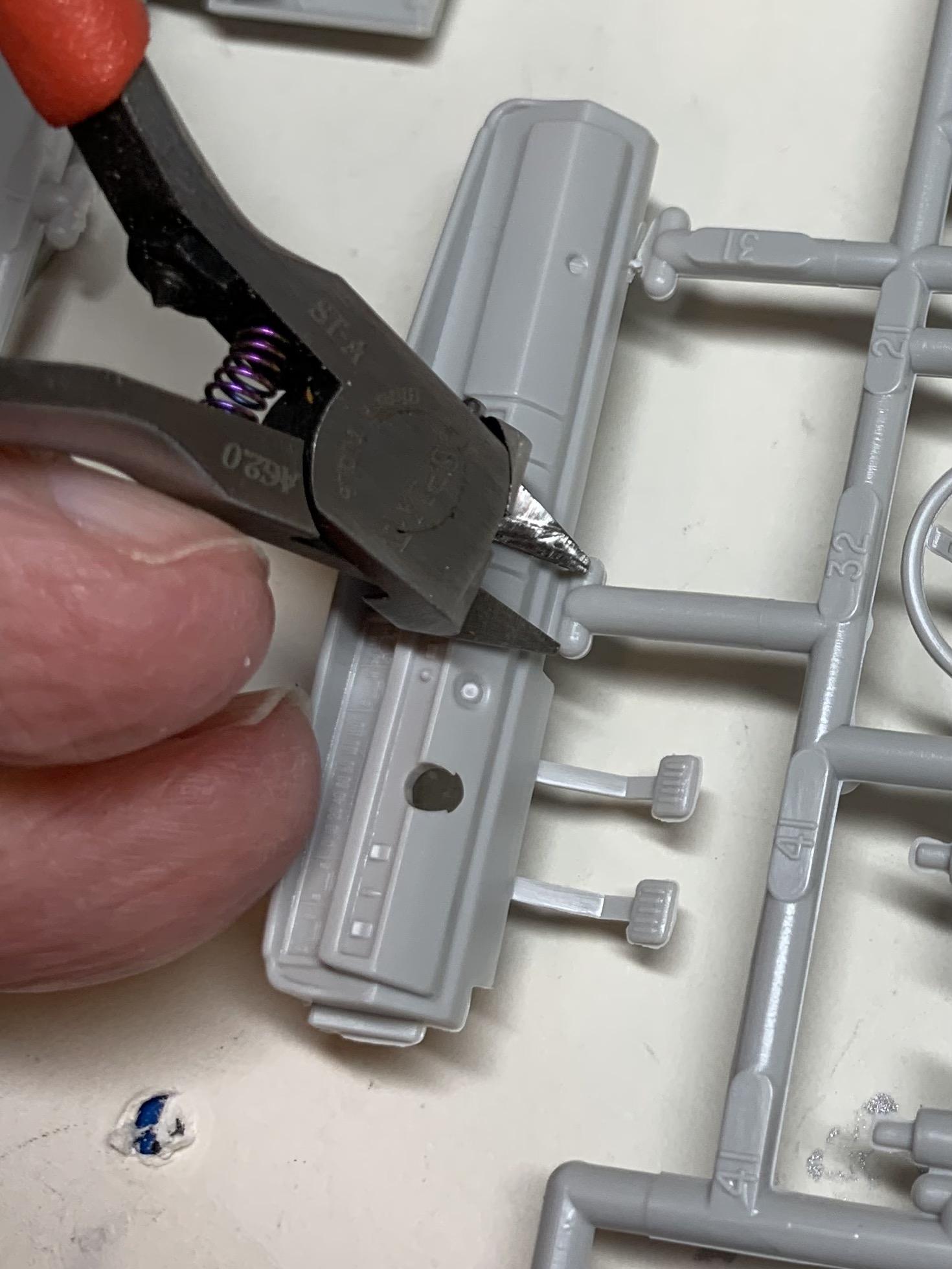

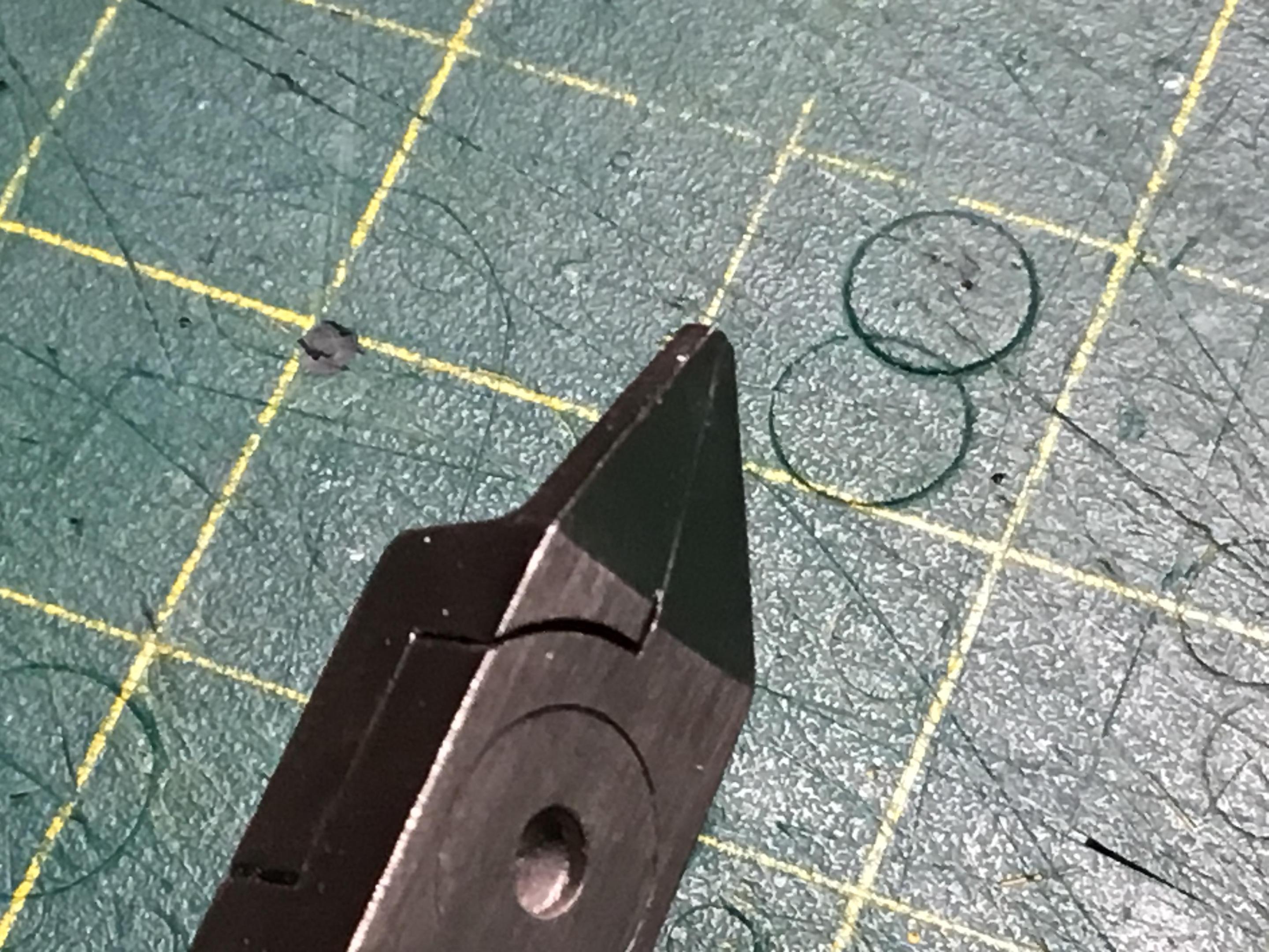

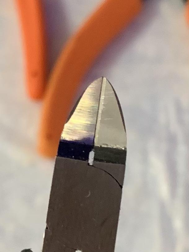

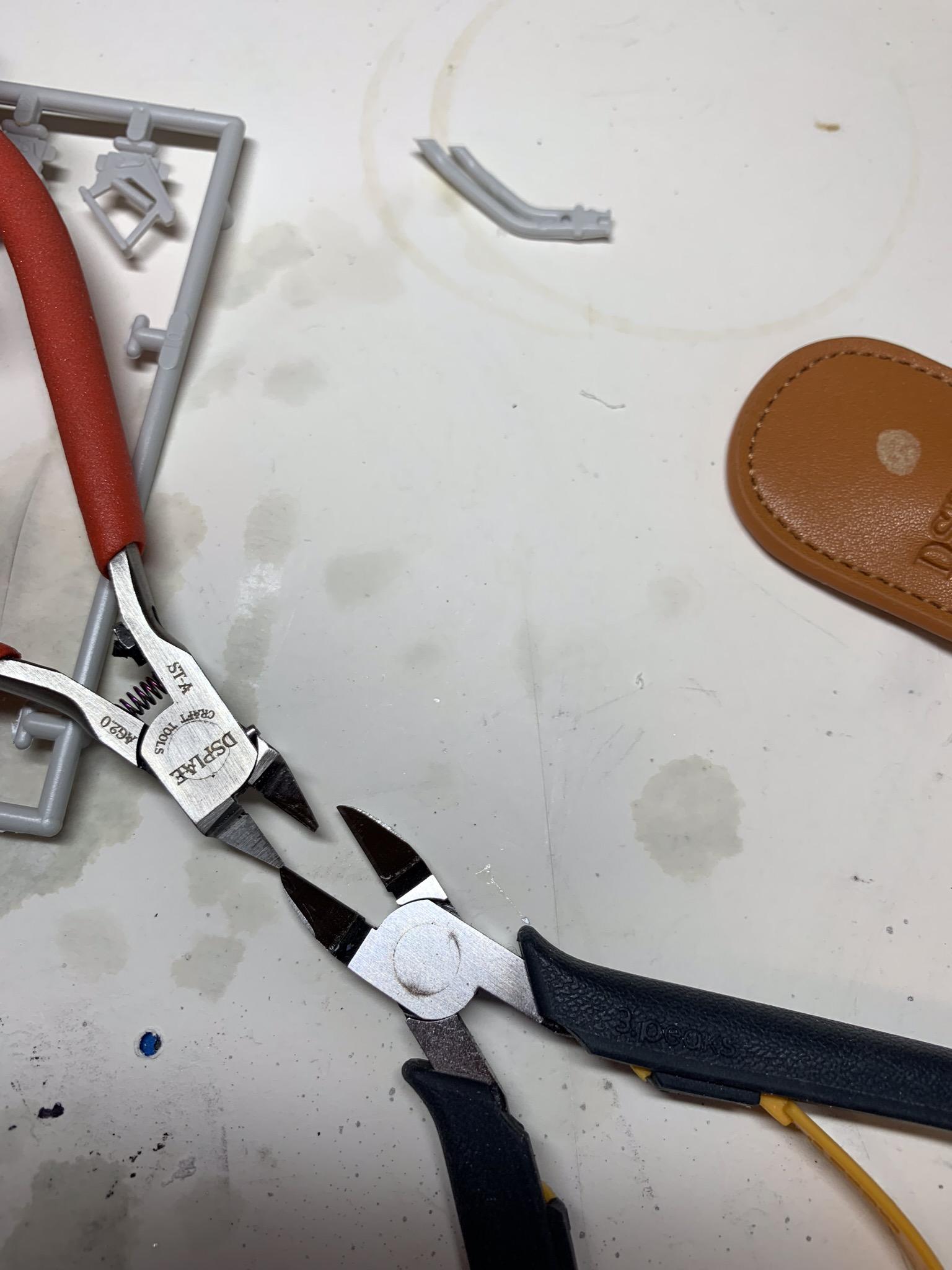

R. Thorne Posted December 22, 2023 Posted December 22, 2023 While waiting for parts, I decided to work on one of those (should be fun, but minimal efforts at detailing) models. In the process, I decided to save my “good” sprue cutters and use my Dspiae ones. I have used the 3.peaks nippers for the past 3 years, try others, but always come back to the “good” nippers. Anyway, just thought I would show the difference between removing as much of the nub with each pair of nippers. Also, the difference in jaw opening is readily apparent. Obviously, I gave up using the Dspiae ones as it just caused a lot more sanding (not my favorite pastime). p.s. I just ordered another pair of 3.peaks for $22.00 on sale as a backup to the backup pair I have had for a year. The first pair is still going strong. 1

Dpate Posted December 24, 2023 Posted December 24, 2023 Nothing beats the GODHAND nippers. But what you should of done when cutting the dashboard off was use the blue pair to cut the gate, and than use the dspiae's from the side to cleanly cut the nub off. There not meant to cut thick sprue (such as gates), and you can easily damage the thin blades. 3
Matt Bacon Posted December 24, 2023 Posted December 24, 2023 Those wide gates you’re better off not cutting at all… just bend the dash up and down a few times and it’ll snap right off. You can use the DSPAIE nippers on what’s left, or just smooth it with a file or sanding stick… You’re not tearing the plastic like you would breaking off a part with a single point gate, so it won’t start taking chunks out of the dash (or body shell). best, M.

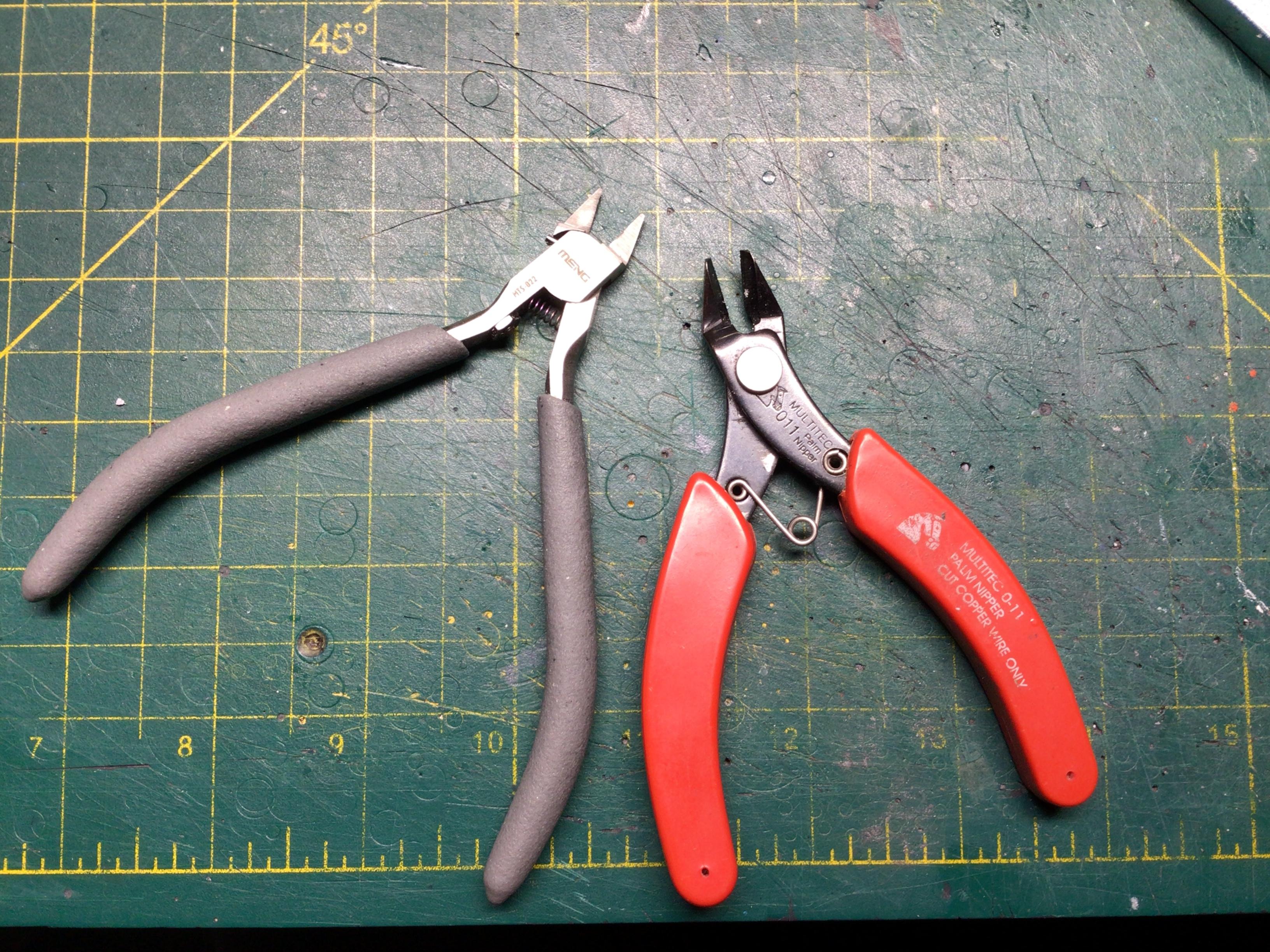

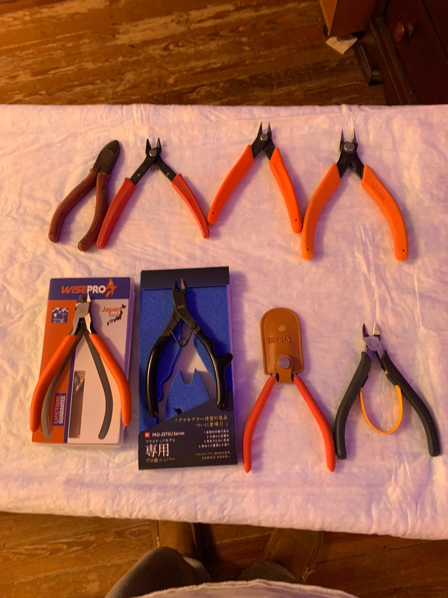

R. Thorne Posted December 25, 2023 Author Posted December 25, 2023 Just giving my personal experiences with cutters/nippers. These are the ones I have used over the years. While I never tried the Godhands, everything I have seen and heard suggests they are similar in design and results to Dspiae, but perhaps slightly thinner and more delicate to use. All of the more expensive nippers do not recommend cutting sprues (possibly why the jaws don’t open as wide). I keep my old xuron cutters for “heavy” cutting (making sprue glue, etc.,)but I don’t baby the 3.peaks and have cut sprues with them, if necessary. Put simply, they cut closer with less cleanup than any of the others. I believe the closeup pics of my old cutters speaks for itself. Merry Christmas to all. 1
Dpate Posted December 25, 2023 Posted December 25, 2023 8 hours ago, R. Thorne said: Just giving my personal experiences with cutters/nippers. These are the ones I have used over the years. While I never tried the Godhands, everything I have seen and heard suggests they are similar in design and results to Dspiae, but perhaps slightly thinner and more delicate to use. All of the more expensive nippers do not recommend cutting sprues (possibly why the jaws don’t open as wide). I keep my old xuron cutters for “heavy” cutting (making sprue glue, etc.,)but I don’t baby the 3.peaks and have cut sprues with them, if necessary. Put simply, they cut closer with less cleanup than any of the others. I believe the closeup pics of my old cutters speaks for itself. Merry Christmas to all. Those are nice. The dspiae’s might look similar to godhands(red handle), but there not the same at all. Now the blue handle godhands are even thinner. Basically red pair is for cutting the nub, and blue pair is for clean up. The main use for that method was towards gunpla, but lots of methods from other similar hobbies have made there way to model cars. All these single blade nippers do a great job cutting the nub, with a clean cut (no stress mark) leaving minimum clean up if any at all if used properly. A little sanding afterwards can save from having a $120+ in two pair of nippers though.
