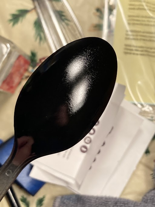

Milo Posted December 24, 2023 Posted December 24, 2023 I'm currently spraying Mr. Super Clear gloss coat over 2x cover Rust-Oleum black primer. I'm practicing on spoons right now. My primer coat is smooth, but I sand it anyway, and the result it very nice. The gloss coat when applied in thin dust coats never ends up glossing. Every time I do a heavy wet coat, it covers really glossy and super smooth, but as it dries, dots begin to appear and then when it's fully dried, the gloss is almost all gone and the texture is all there. So who knows why this texture is coming out this way, and how can I stop it. I want to get a nice smooth glossy finish, but I can never achieve that.
Funkychiken Posted December 24, 2023 Posted December 24, 2023 could be many things like incompatible paint, base coat not gassed out completely, clear coat too hot, clear coat not diluted with thinners, humidity. test with another base cose manufacturer, or test with leaving the base coat longer keeping everything else the same (like an OFAT experiment)
robdebie Posted December 24, 2023 Posted December 24, 2023 (edited) 6 hours ago, Milo said: I'm currently spraying Mr. Super Clear gloss coat over 2x cover Rust-Oleum black primer. I'm practicing on spoons right now. My primer coat is smooth, but I sand it anyway, and the result it very nice. The gloss coat when applied in thin dust coats never ends up glossing. Every time I do a heavy wet coat, it covers really glossy and super smooth, but as it dries, dots begin to appear and then when it's fully dried, the gloss is almost all gone and the texture is all there. A loigical experiment would be to skip the thin dust coats, and do a wet coat straight away. Or as a variation, do one dust coat and a wet coat immediately afterwards. Rob Edited December 24, 2023 by robdebie
Dave G. Posted December 24, 2023 Posted December 24, 2023 Rustoleum primer is basically enamel primer, various solvents to speed initial dry but still enamel. Enamels have a long cure process. I deemed it unusable for basing models. I tried a can, gave it one shot on a scrap piece and by smell alone I knew it was not lacquer. It smelled the same as every other enamel based primer I ever used and so returned it, since I told the hardware store guy ahead of time ( they have a return policy). You have to be careful what you spray over enamels, not to mention when you do it. Hotter Lacquer in particular wrinkles the stuff all up. I never use enamel primers. 2
Ace-Garageguy Posted December 24, 2023 Posted December 24, 2023 (edited) Rustoleum issues seem to be boundless. Saving a few bucks on material doesn't really make sense when it ruins almost any model you paint, now does it? Rustoleum products really are primarily aimed at the DIY market who are satisfied with dirt and runs and bubbles on their mailboxes and old outdoor furniture...not modelers who are trying to turn out high-quality work. Many of us used quality automotive-grade lacquer primers in the past with excellent results, but for a variety of reasons, that is not always an option today. Use a primer specifically designed for plastic models, and be sure it's fully compatible with your topcoats. Edited December 24, 2023 by Ace-Garageguy CLARITY and ACCURACY 4 1

Milo Posted December 24, 2023 Author Posted December 24, 2023 3 hours ago, robdebie said: A loigical experiment would be to skip the thin dust coats, and do a wet coat straight away. Or as a variation, do one dust coat and a wet coat immediately afterwards. Rob same results

jaymcminn Posted December 24, 2023 Posted December 24, 2023 3 hours ago, Milo said: How come I have seen SO MANY spectacular results purely from rust-oluem paints? I guarantee you will see many more spectacular results from practically any other paint manufacturer. The 2x stuff you're using is, as pointed out above, basically an enamel. It doesn't like to be coated with lacquer, even if it's had weeks or months to cure. Enamels, even "big box store" ones, can produce decent finishes... when properly cured they are rock-hard and non-metallic gloss colors can take polishing well. Most modelers have moved on to synthetic lacquers like Tamiya and Mr. Color for ease of use and not having to wait a month while the paint on a body dries. I have to ask, why are you trying all these weird combinations of paint and primer when pretty much everybody who responds to your threads is trying to steer you in a direction that works? If you don't have a decent hobby shop nearby you can order Mr Color and Tamiya online as well as any number of companies like Splash Paints, who do a fantastic range of airbrush-ready lacquers. 7

oldcarfan Posted December 26, 2023 Posted December 26, 2023 I hate to dogpile on Rustoleum, but I'm guessing the primer wasn't completely dry or reacted badly, or maybe was just a bad batch. Their quality control is not the best. For my Binford tool box redo, I bought four cans of Brilliant Blue, and two worked fine and the of the other two, one seemed to not have any propellant, and the other came out like silly string. The only differences were the batch numbers were the same on the good cans and the others were different. Anyway, most of my problems seem to come after using one of their products. For primer I switched to Duplicolor or Plastikote sandable primers a long time ago and they seem to eliminate a lot of issues. From the smell, they are a lacquer base and are compatible with every type of paint I've used and dry fast. I like them because I can sand them using ultra fine sandpapers and they give a great base. Rustoleum paints seem to work best under low humidity moderate temperatures to me, and even then they can still feel tacky.
