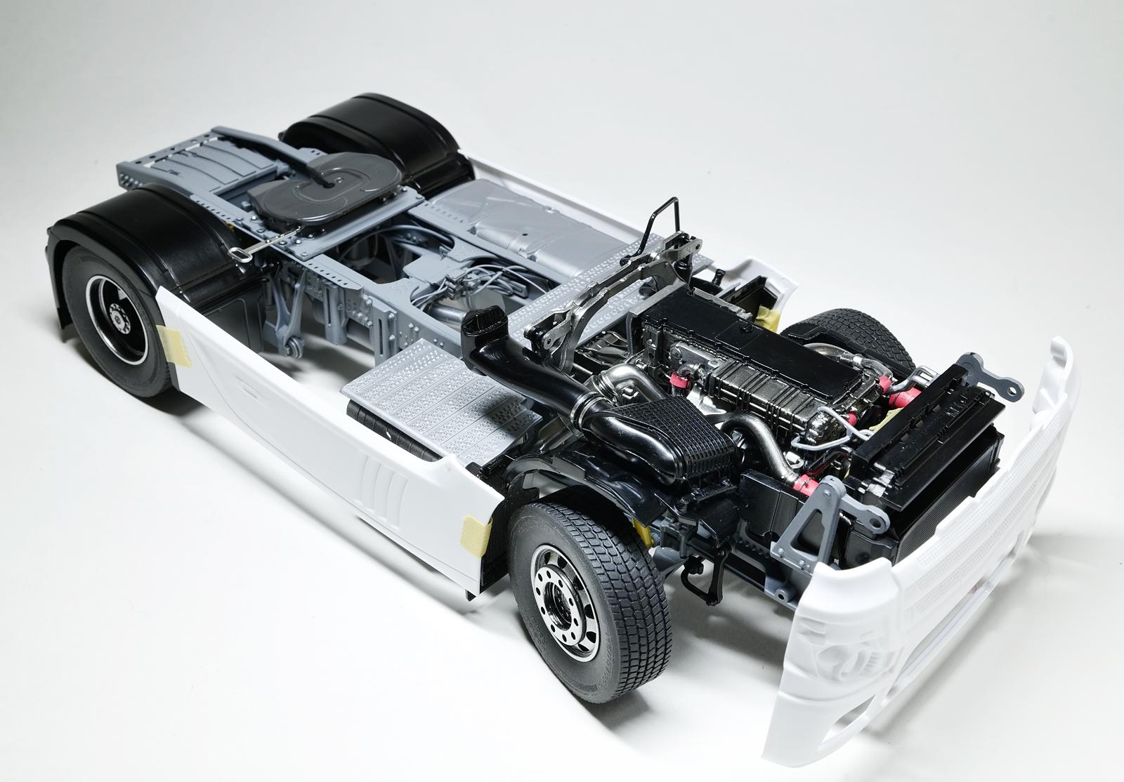

I am slowly attaching each component one by one, and the truck is taking its shape nicely.
Except a couple of "what to look out for" areas in this build diary, so far my build experience was quite pleasant.
Yes, the rectangle looking silver box is the exhaust!  :)
I decided not to further detail the brakes.
Once the wheels are mounted, no disc rotors/calibers will show up.  After all, I am building this to finish quickly. :)
I checked the fitment of various components including the air intake system.
The lower body panels position well also and I verified their attachment locations.

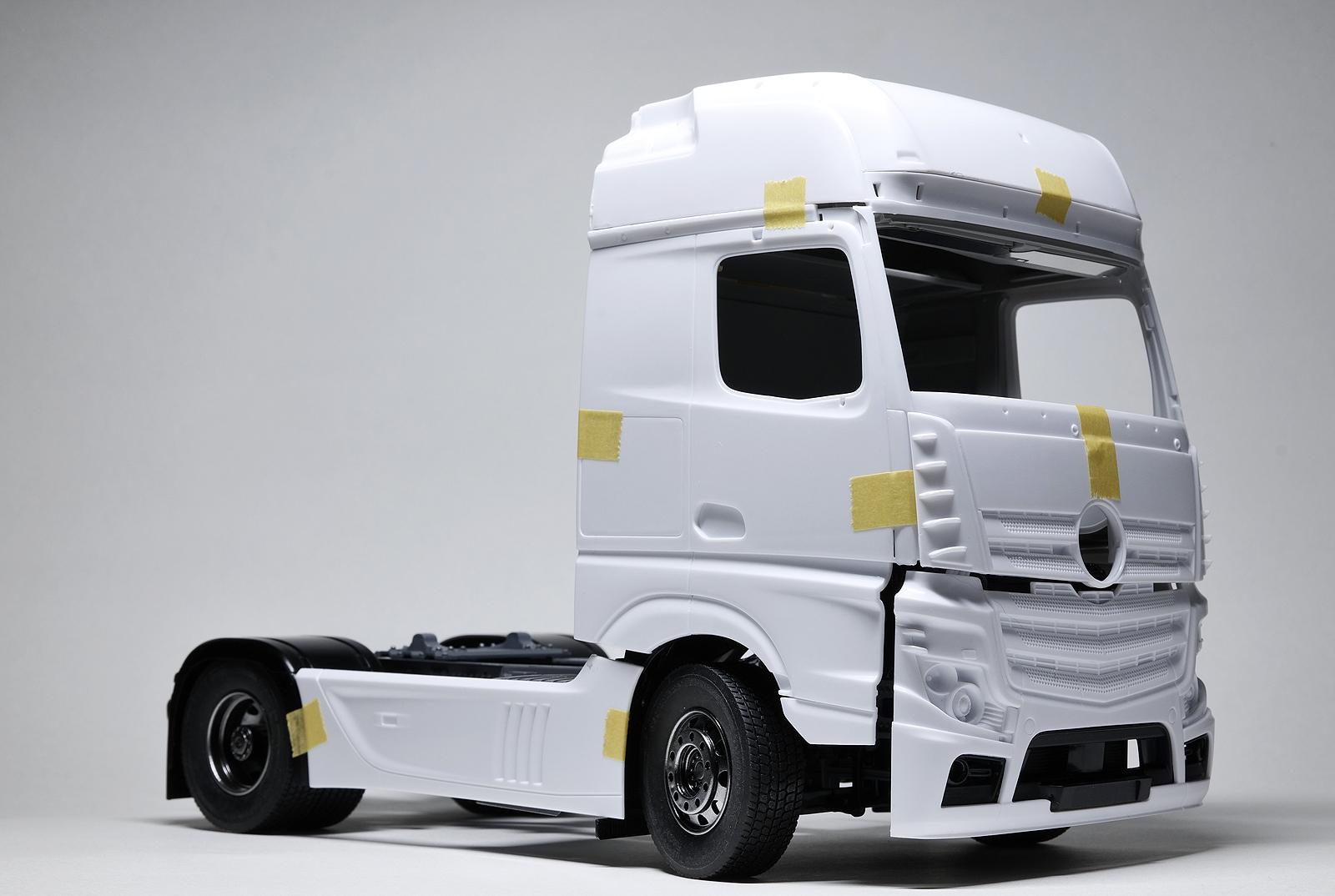

No unexpected finding so far and I started to "mock" build the cab.
Using some masking tape to hold parts, I was able to complete this mock build.
I examined things as to how I would need to build and paint the cab.
I was basically planning my next move.
I really like the look of this truck.  Mercedes Benz did a fantastic job styling and designing this truck.  I cannot believe this design is already 10+ years old though.
Still the truck looks fresh and very modern to my eyes.
By the way, this is when I also realized that I need to build this truck in one of the following configurations:
  • Open hood configuration (means the cab in tilted position)
  • Closed hood configuration (means the cab in driving position)
The truck does not allow you to open and close the hood (cabin) once you make your choice and build that configuration.
Strangely, the kit does have a functioning mechanism so you can tilt the cab!  See below (red arrows):
BUT the front bumper piece blocks the operation!
I confirmed it with the instructions also, if you are building the truck in opened hood configuration, this is how the truck would look:
I can't believe that my only option of displaying/revealing the engine is to make the truck in "Opened Hood Configuration".

For the problem, maybe I wasn't clear when explaining the issue.  I wish it is the top grille that interferes, but unfortunately it isn't.
The problem is with these two pieces (two red boxes) having no clearance and preventing the cab movement:
To be exact, these four corners (red arrows) get locked in.  Tightly!
After studying the mechanism from my mock build, in order to display the truck in tilted forward position so engine bay is revealed, you must tilt the cab and assemble first, then attach this bottom piece.
The cab will rest on the top of this bottom piece and it keeps the cab in tilt position.  Wow.
I am going to modify the hinge (green arrows) so the cab can be pulled upward when tilting is required.  That can provide some extra clearance to tilting and it shouldn't increase the existing height of the cab.  Hopefully, it is a quick fix.

The interior work is started and for simplicity, I decided to use two tone interior with no other additional details.
I am going to paint the exterior cab as one piece.
As I mentioned from previous post, Italeri doesn't want you to do that.  But I will make some small modification to the kit to allow it!
Italeri steps:
  1. build/paint interior cabin
  2. paint each exterior panel
  3. attach exterior panels around the interior cabin
My steps:
  2. modify the interior cabin so it can be detached from the exterior
  3. attach unpainted exterior panels around the interior cabin (except the back panel)
  4. fill/putty joint seams
  5. take out the interior cabin
  6. paint the cab as one piece
  7. reassemble the interior by inserting back to the cab
I didn't mean to complicate things, but looks like I just did!

This is how I was able to insert/remove the interior cabin.
I cut away the cabin floor from each side(about 0.25 inches).
Then carefully glued all of the exterior panels except the back panel.
This setup allows me to insert the cabin interior from the back and push up.  To remove the interior cabin, I can pull it down and back.
I can simply glue the back when everything is done.  The joint seam is actually hidden for the back panel so I am hoping everything will work out.
Lastly, the bottom will be covered with a thin styrene sheet so no one will know what I did...
