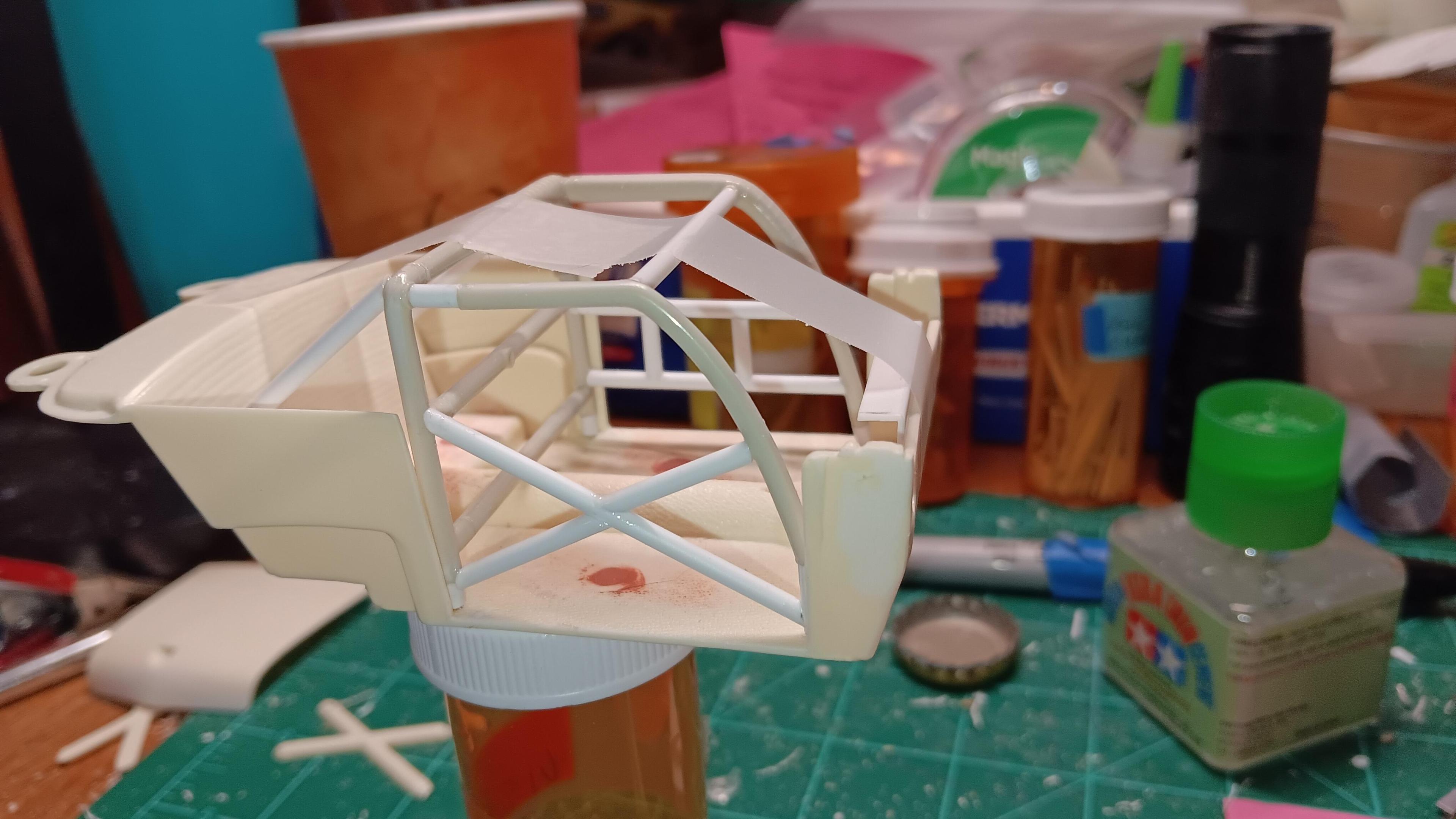

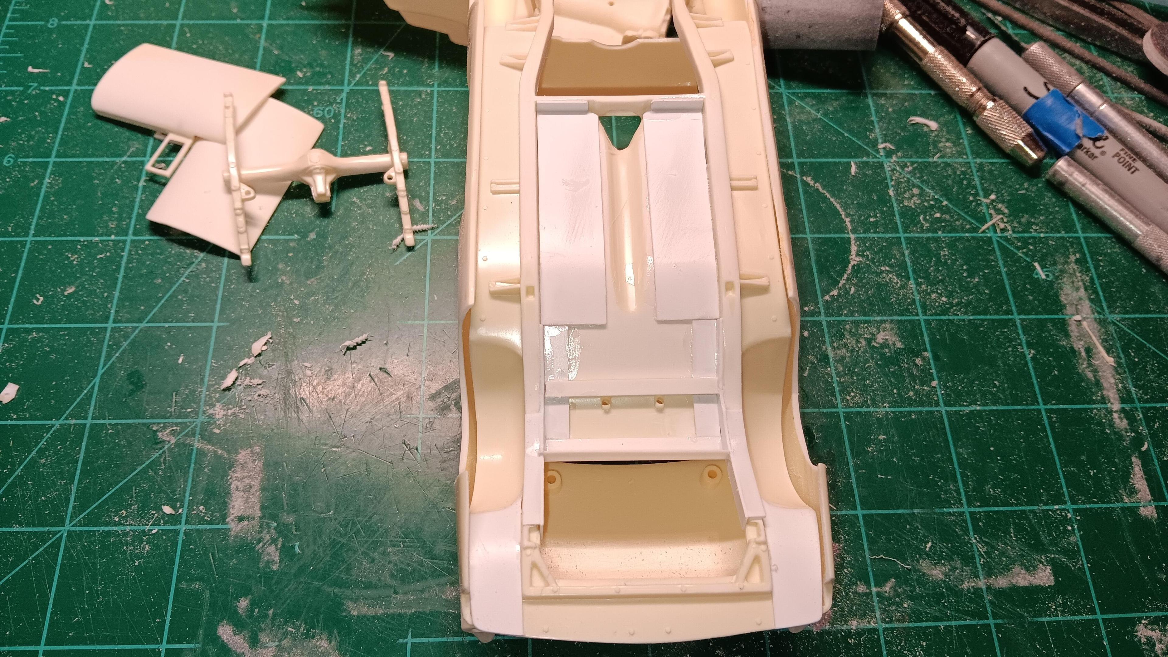

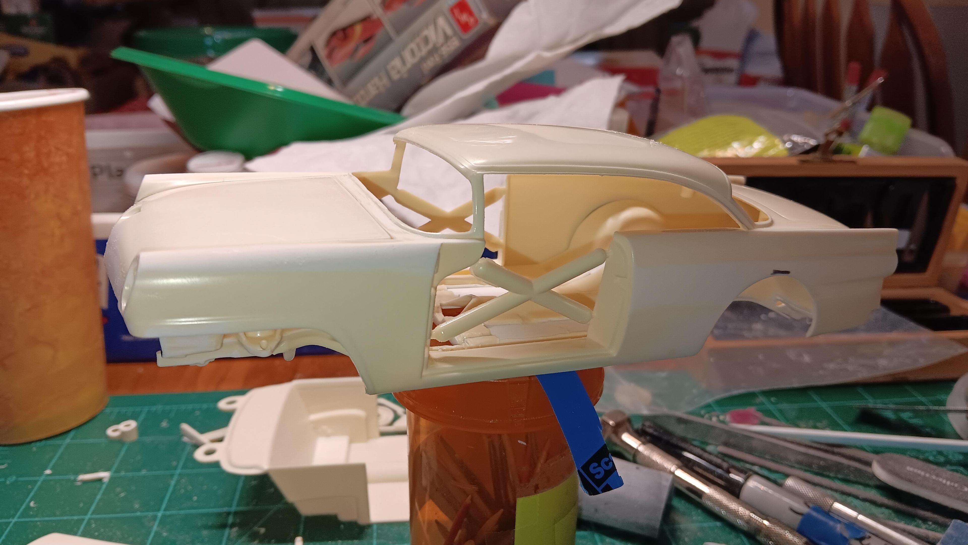

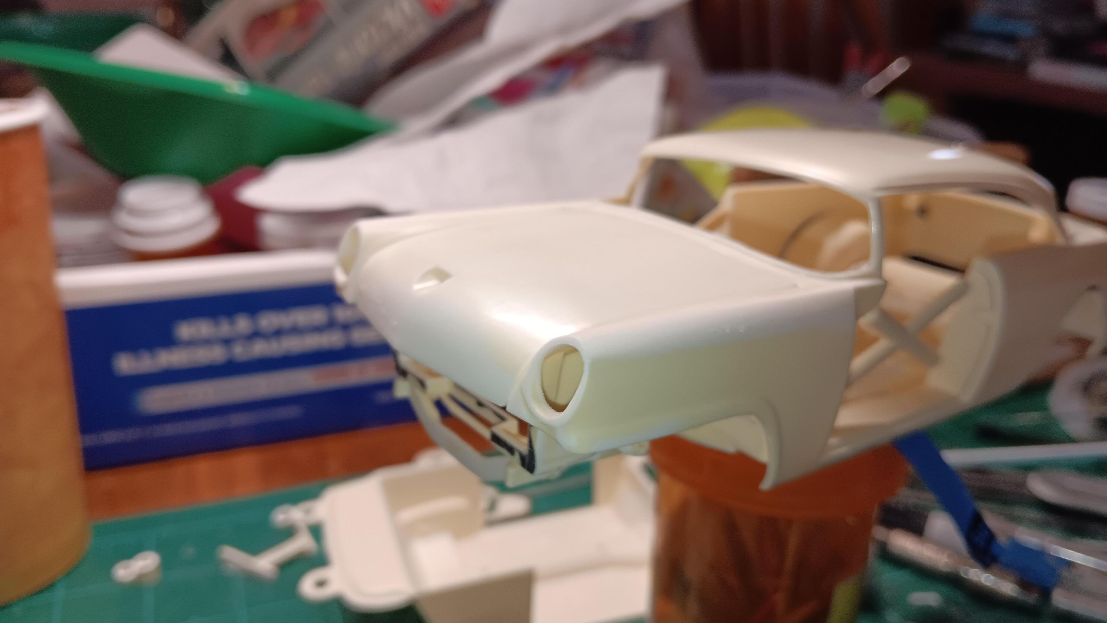

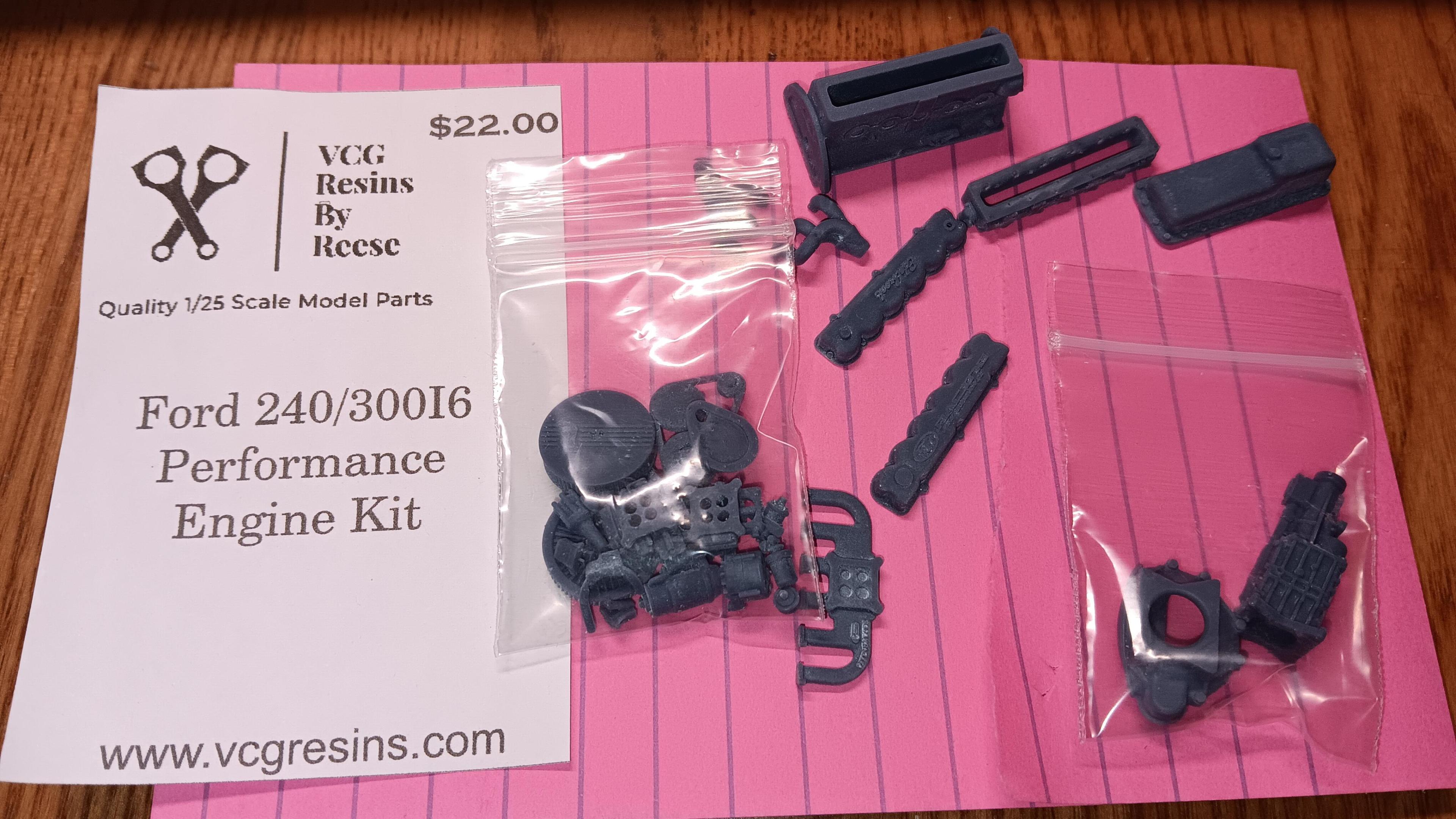

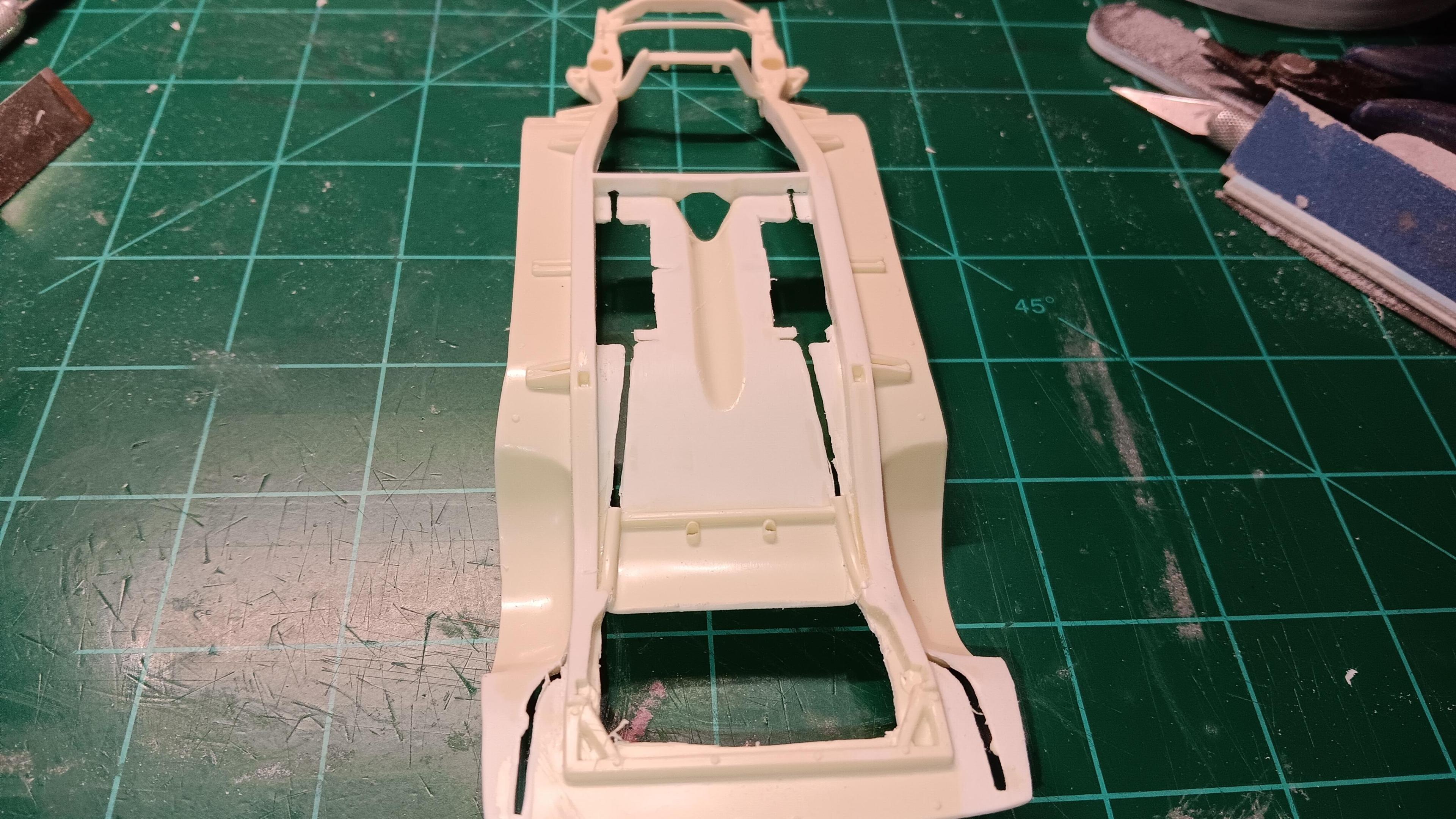

bobss396 Posted December 27, 2023 Posted December 27, 2023 I'm roughing this out for now. Dug an old parts kit out that has 2 busted roof pillars. They will ge fixed once I have the major body work completed. Engine will be the VCG Resins 240/300 straight 6. I removed the front crossmember to make room for it. Based on what I did on the '51 Chevy. I will be using the vent windows, I need more strength for the broken A pillar. Some cars had them, some didn't. I will run a RF safety hub, this depicts a slightly newer F8 build. 1

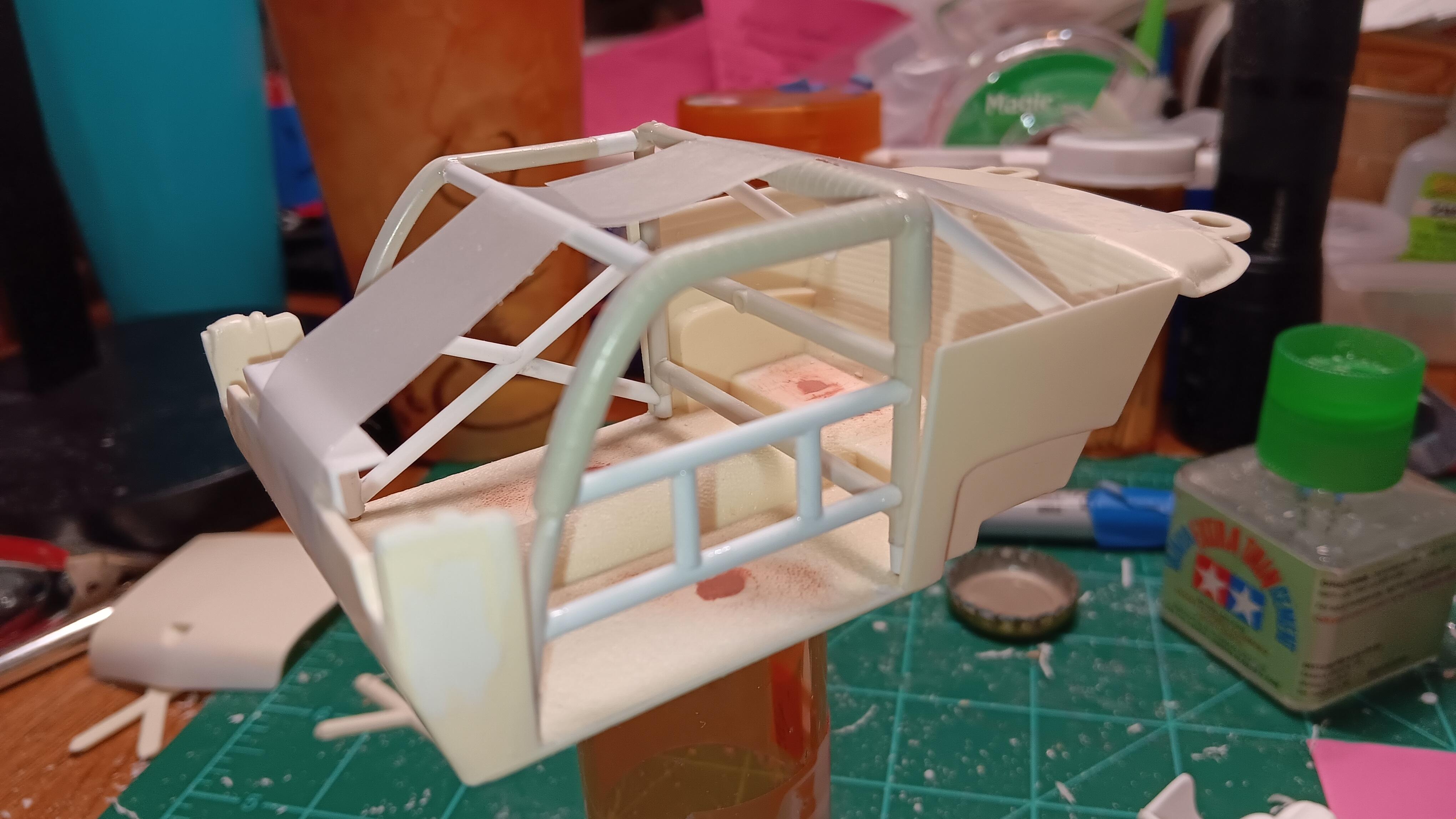

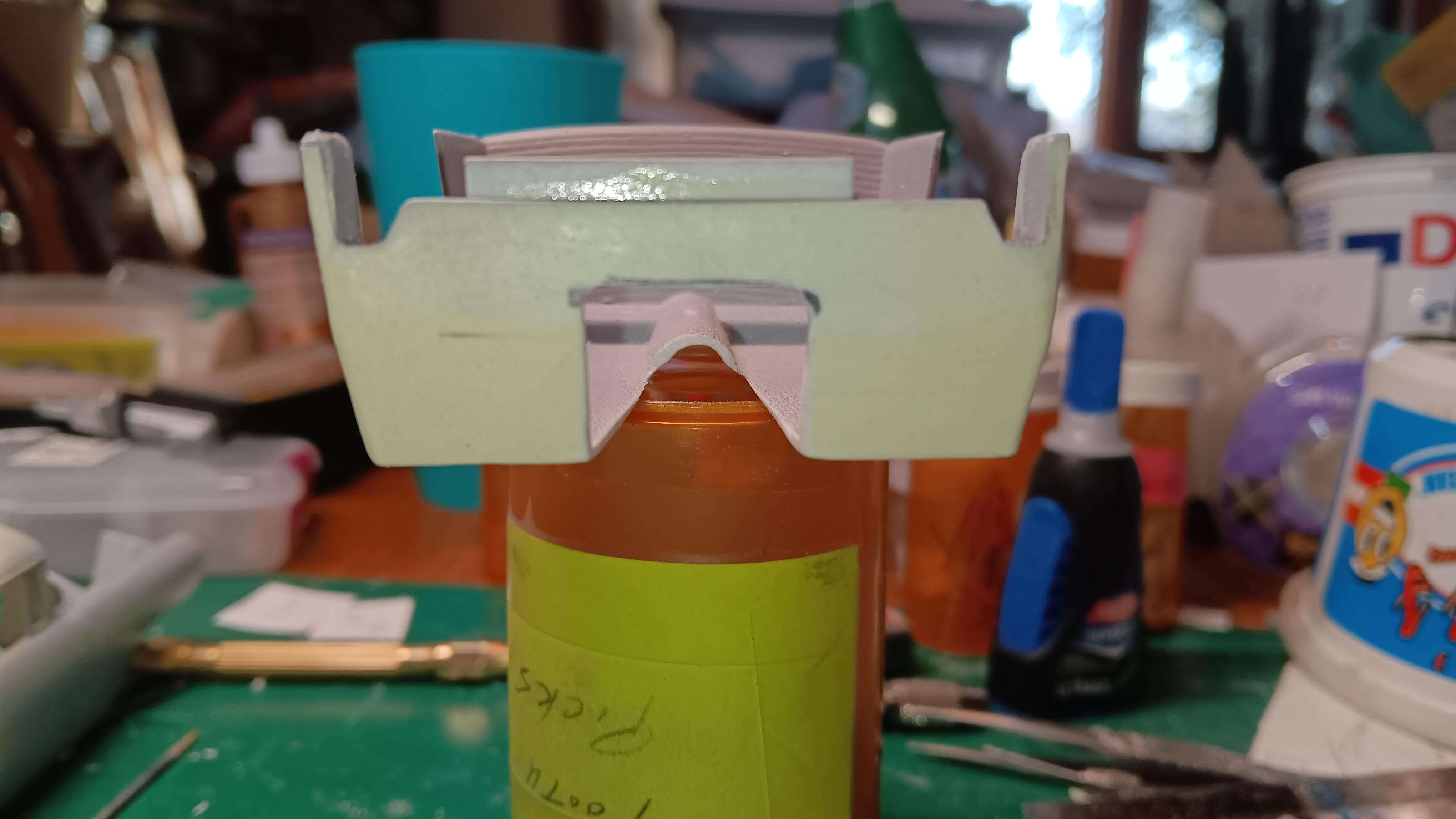

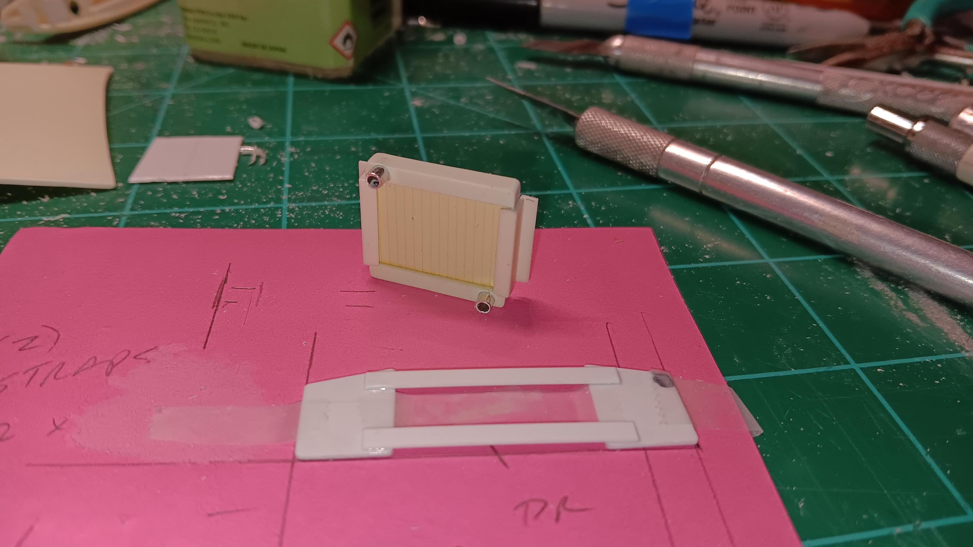

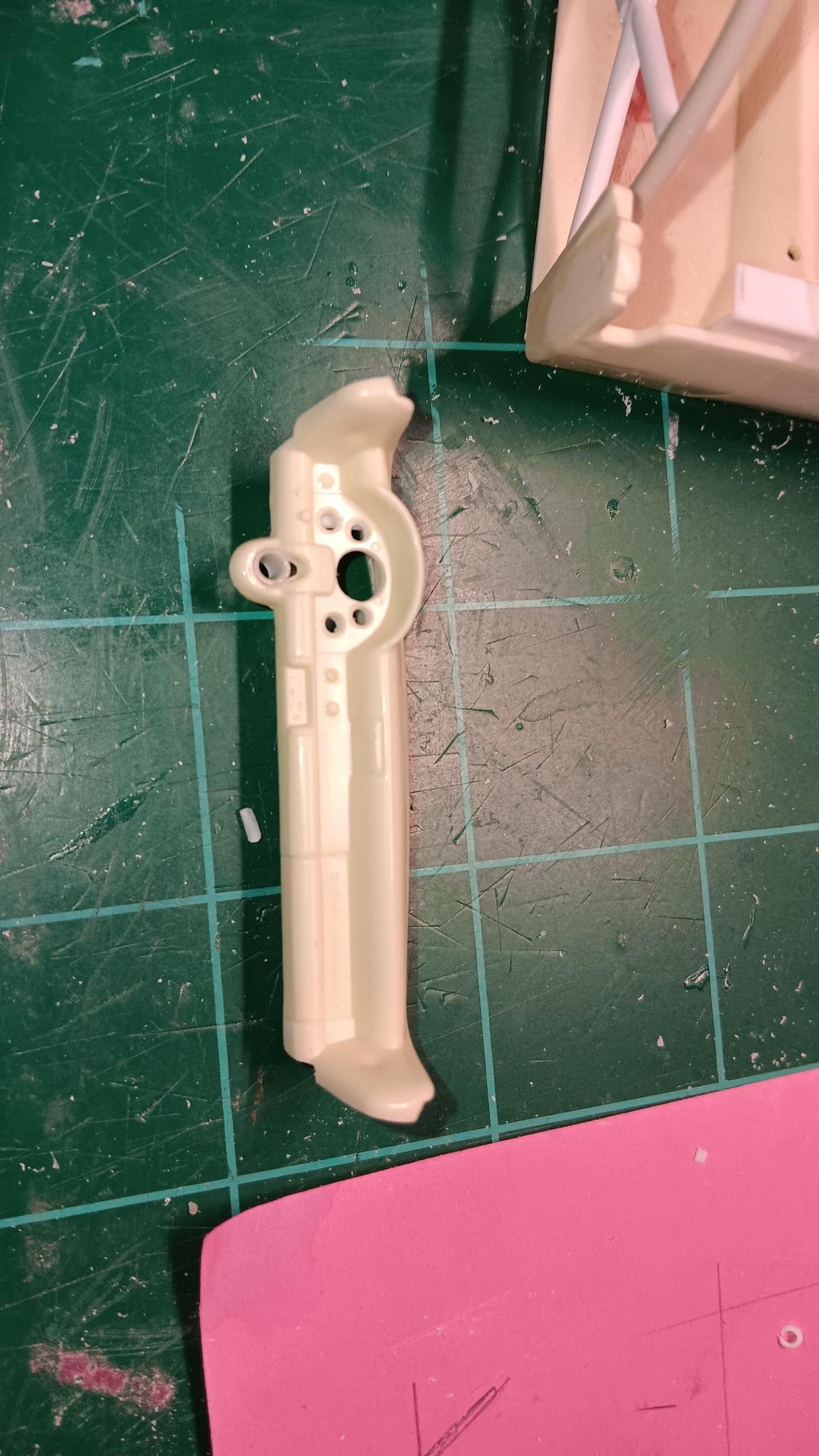

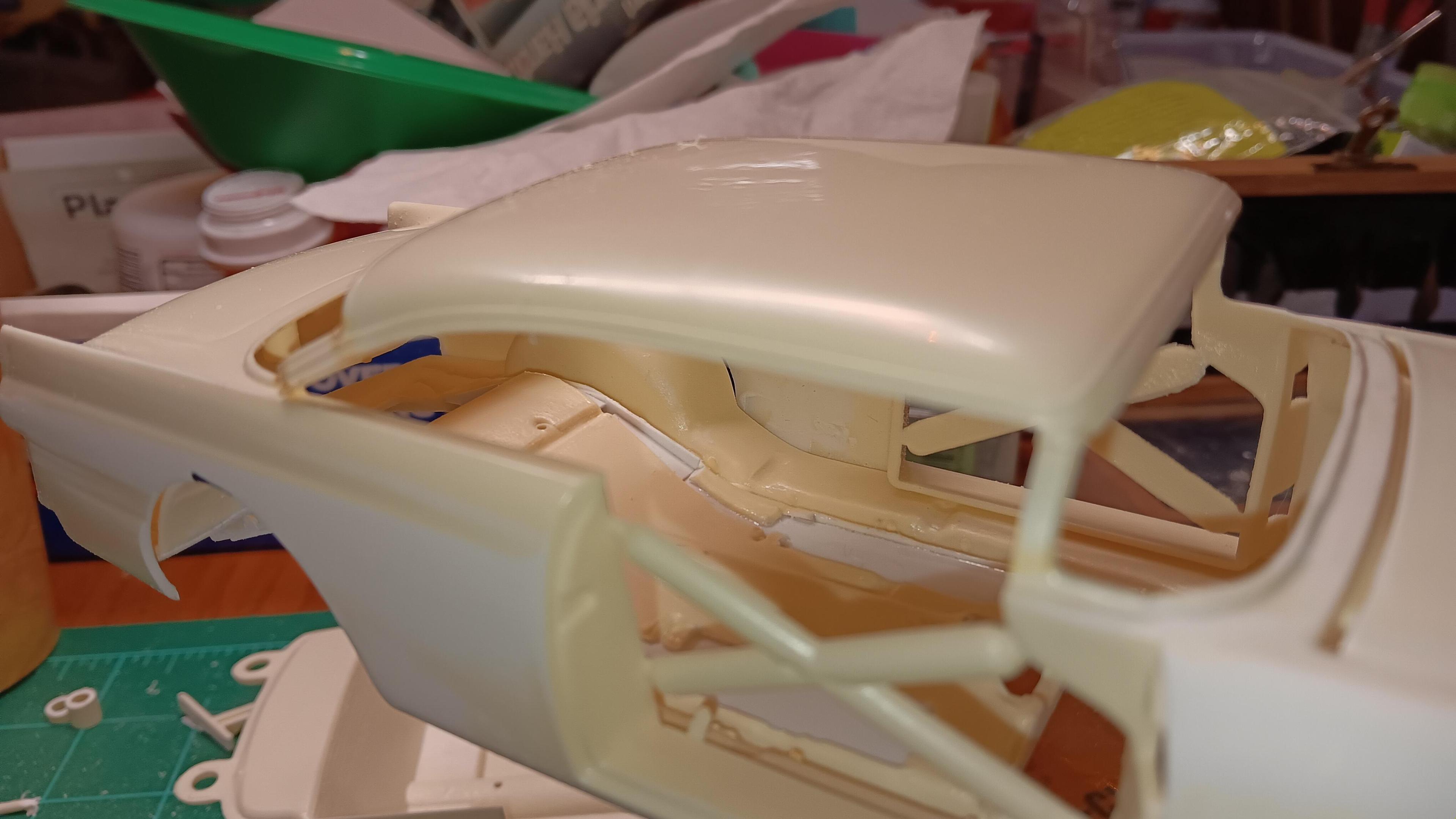

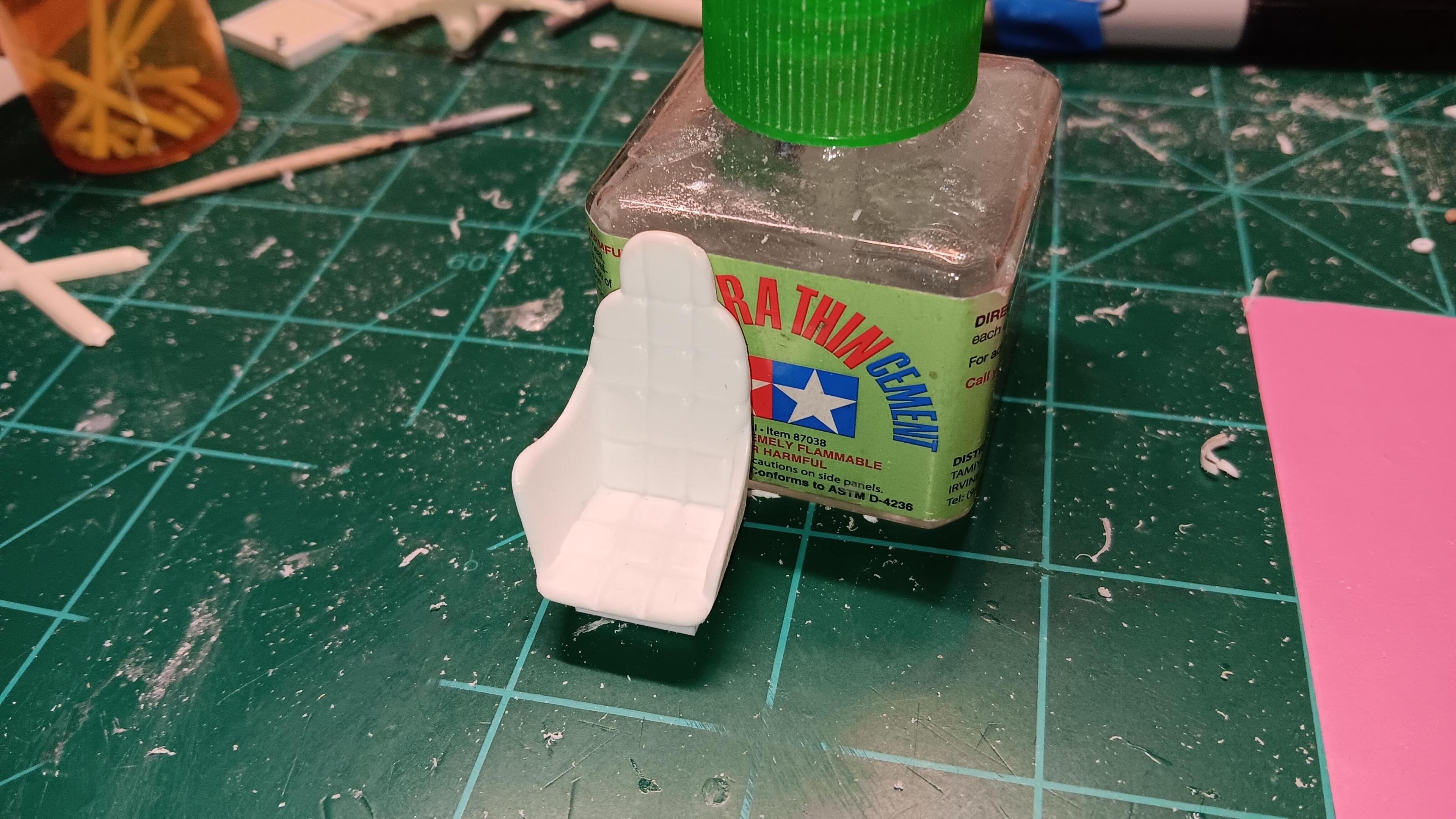

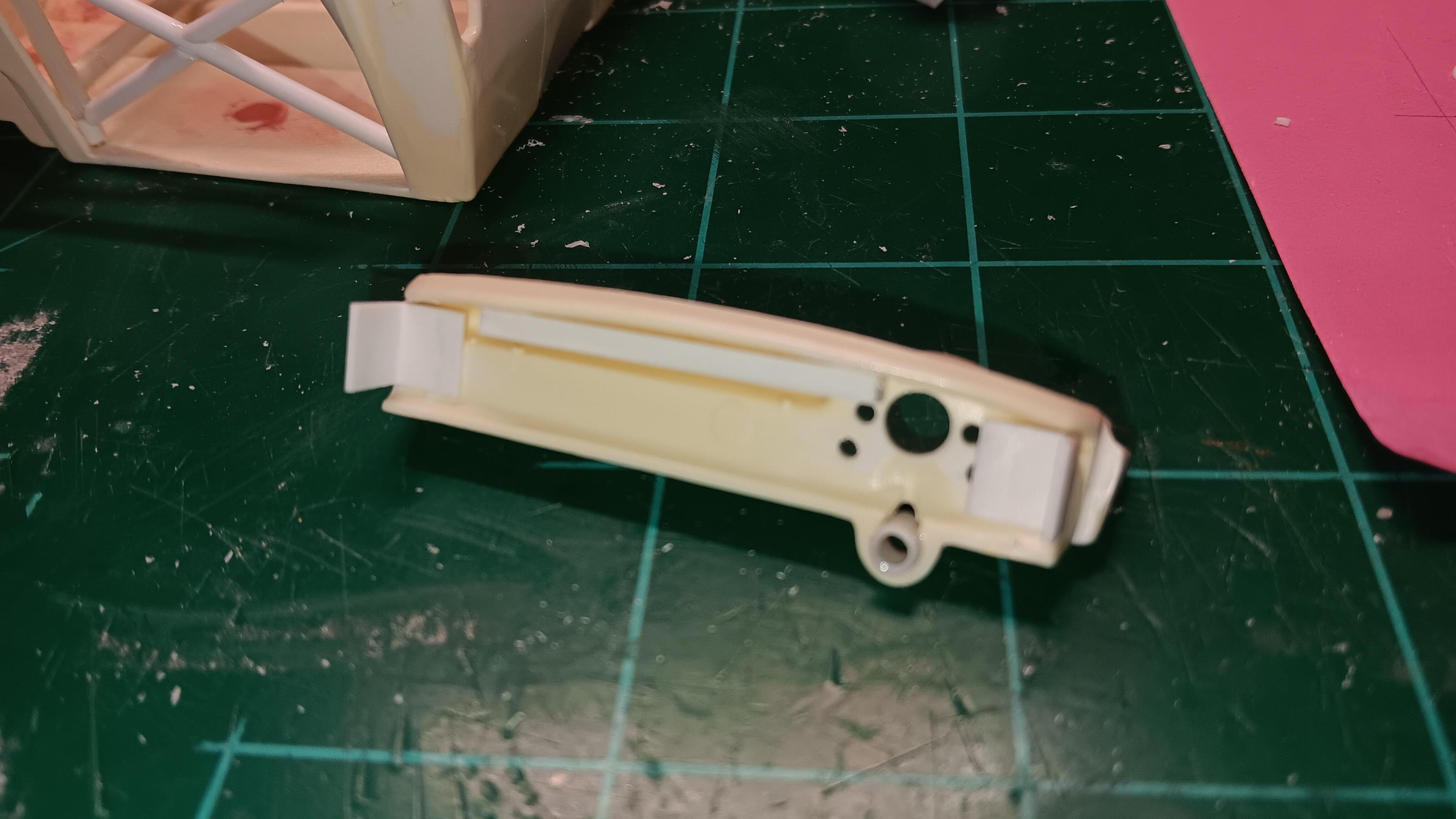

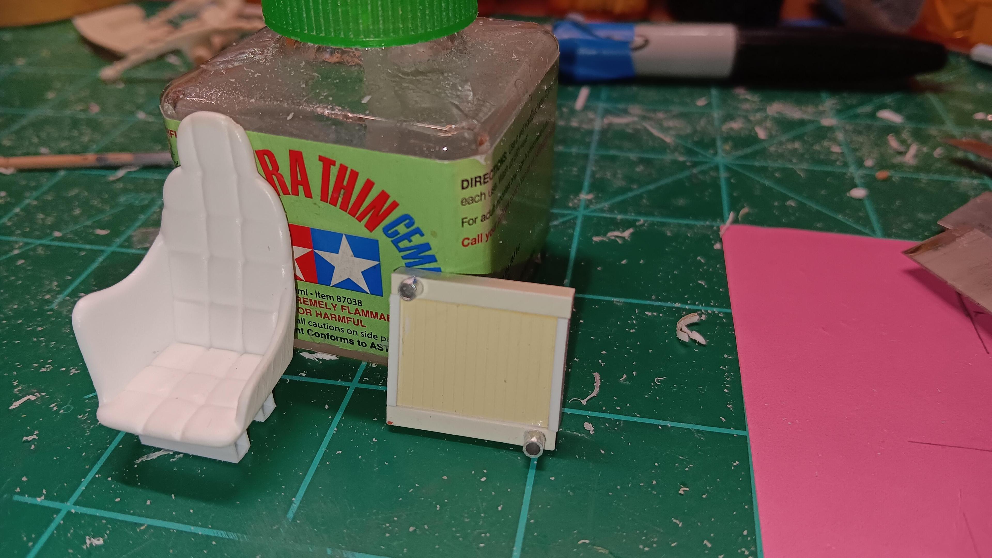

bobss396 Posted December 30, 2023 Author Posted December 30, 2023 More progress on the '56. Scratch built the radiator and support. The dash needed location help too. The cage is a parts box donation with added bars. Seat is from Ron Coon Resins. 1

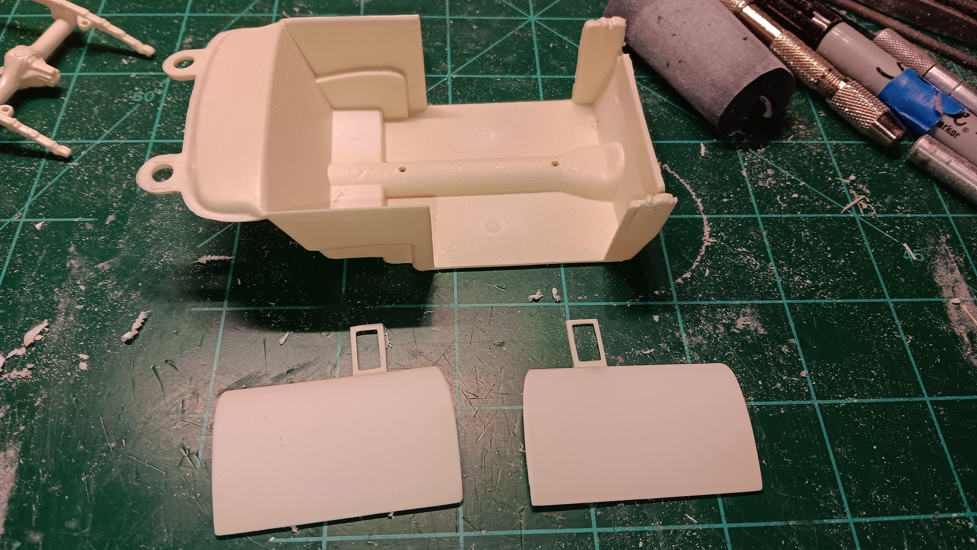

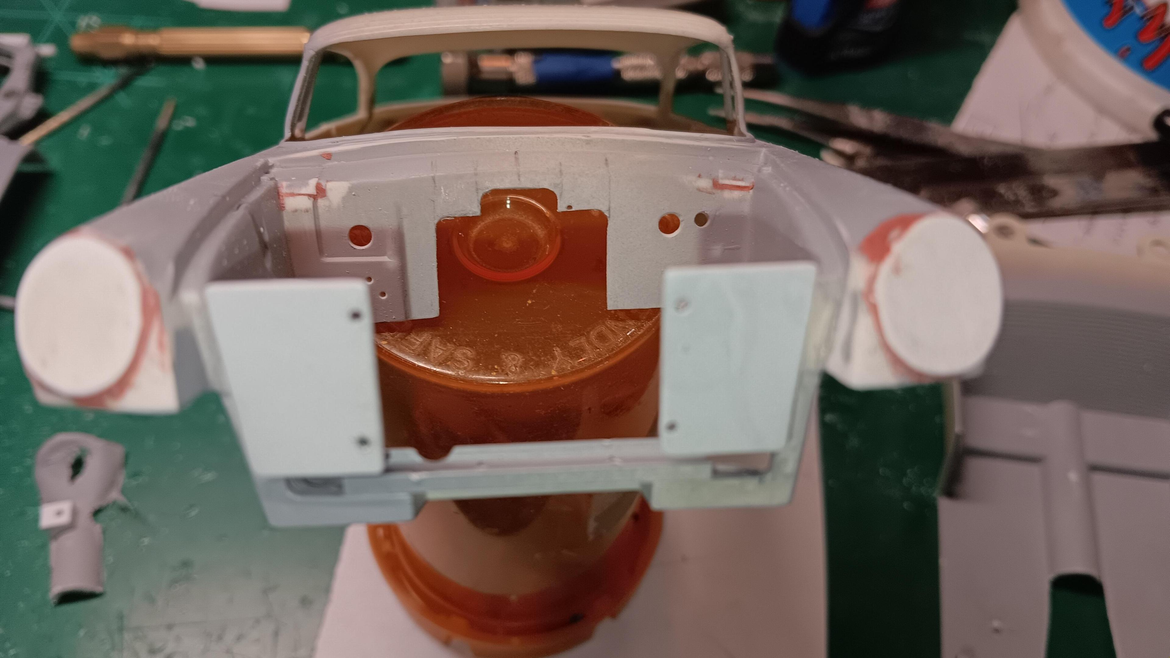

bobss396 Posted January 11, 2024 Author Posted January 11, 2024 (edited) Thanks, still doing some work here and there on it. I have too many things going at once... the story of my life. I have most of the suspension parts painted.I opened up the inner wheel wells somewhat so I can tip the top of the front wheels in to get the negative camber these cars had. This is the approximate look I am after. This is what we call an "opening day" shot. No body damage. And as the season progressed, more tire clearance would be added. Maybe some door bars or "cow catcher" bumper upgrades too. Edited January 11, 2024 by bobss396

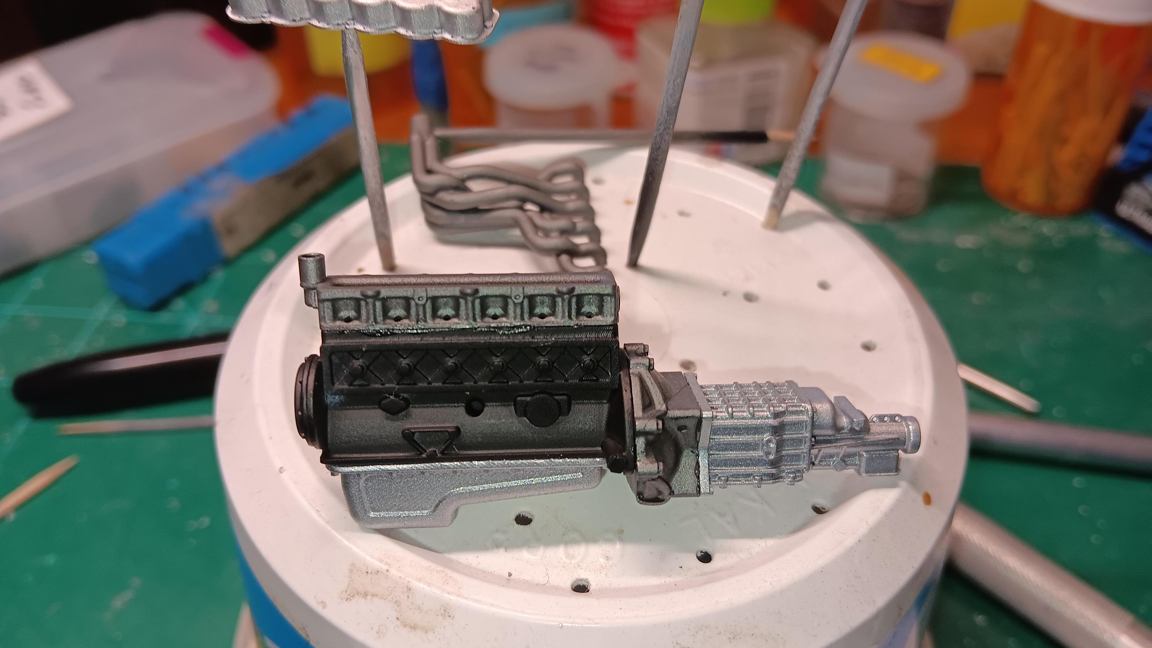

bobss396 Posted January 7 Author Posted January 7 The '56 is back in work. Painted up most of the VCG Resins 6-cylinder that will the engine fit. Body is essentially done, the chassis too. Made up weight jackers for the front springs. Small parts box is starting to fill up. Next is some dash gauges. Rub rails are done, not pictured

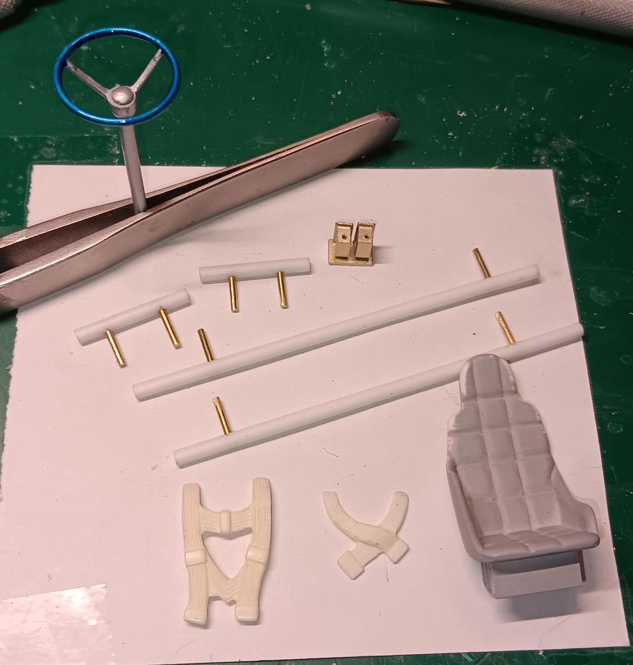

bobss396 Posted January 7 Author Posted January 7 Added some shots of the rub rails, seat and belts. Rails are .093" tubing and pinned with .047" brass rod. Much stronger over using all plastic. Steering wheel was done, using the kit piece, with Tamiya TS 30 silver with Tamiya clear blue over it. Just about any parts store had metal flake steering wheels that were widely used. Bumpers are done, everything is pinned to help final assembly. I can start engine mounts shortly now that the engine basics are assembled. 1

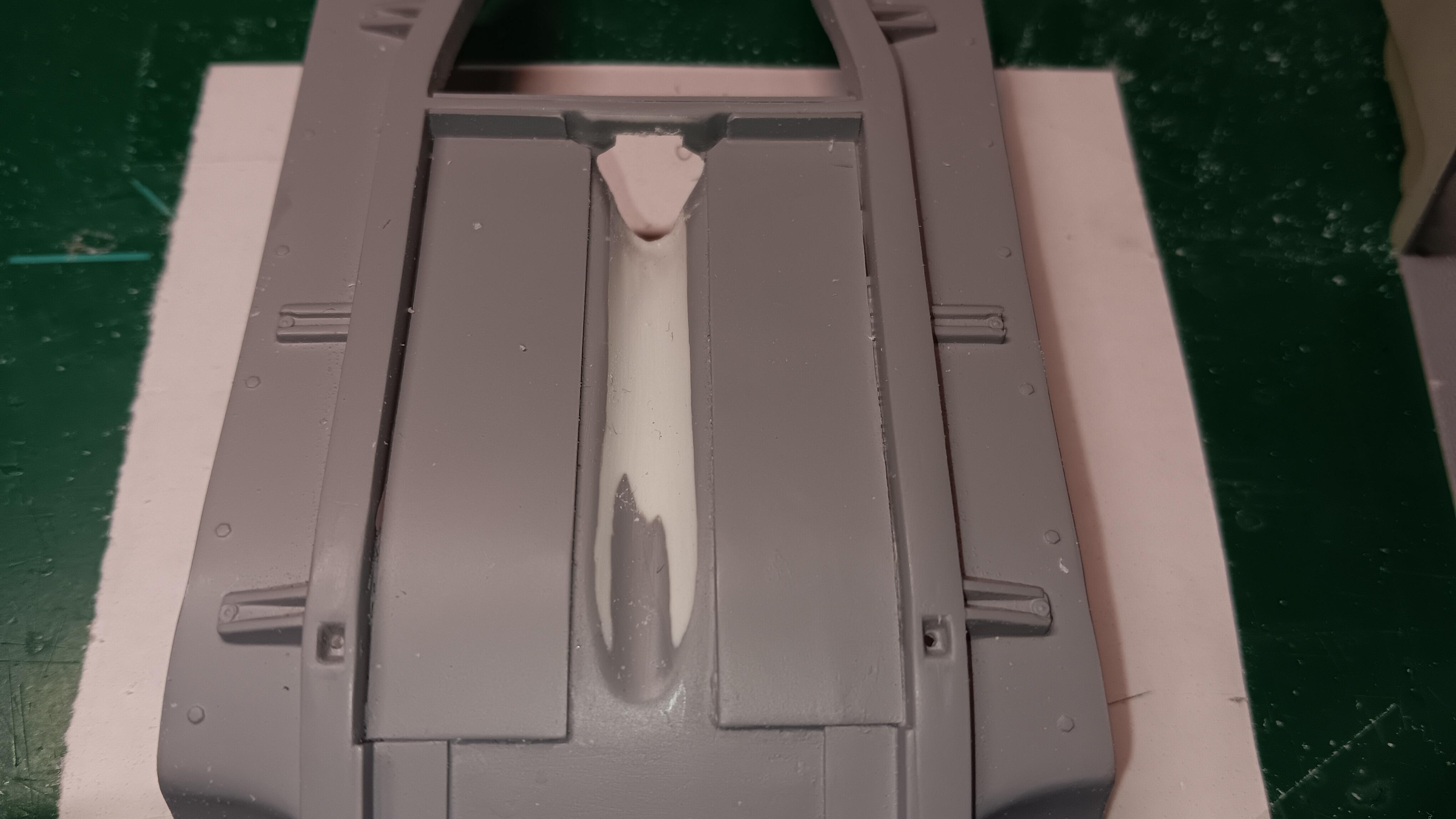

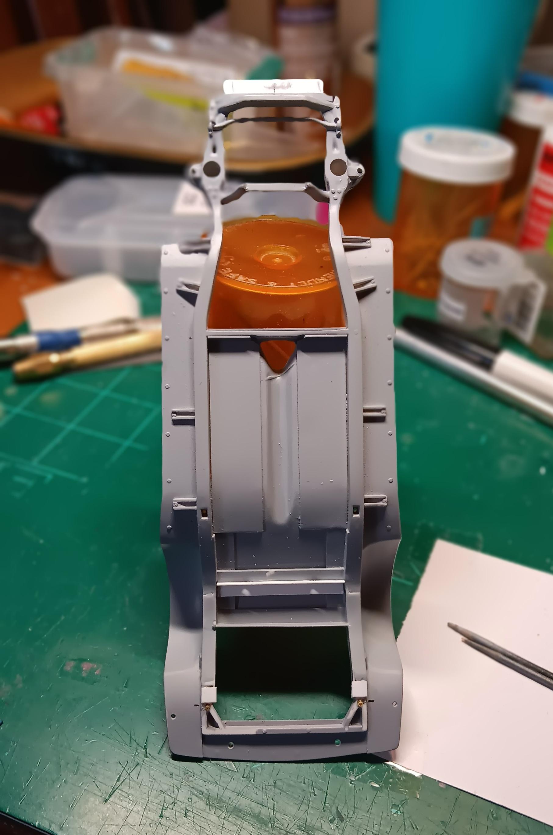

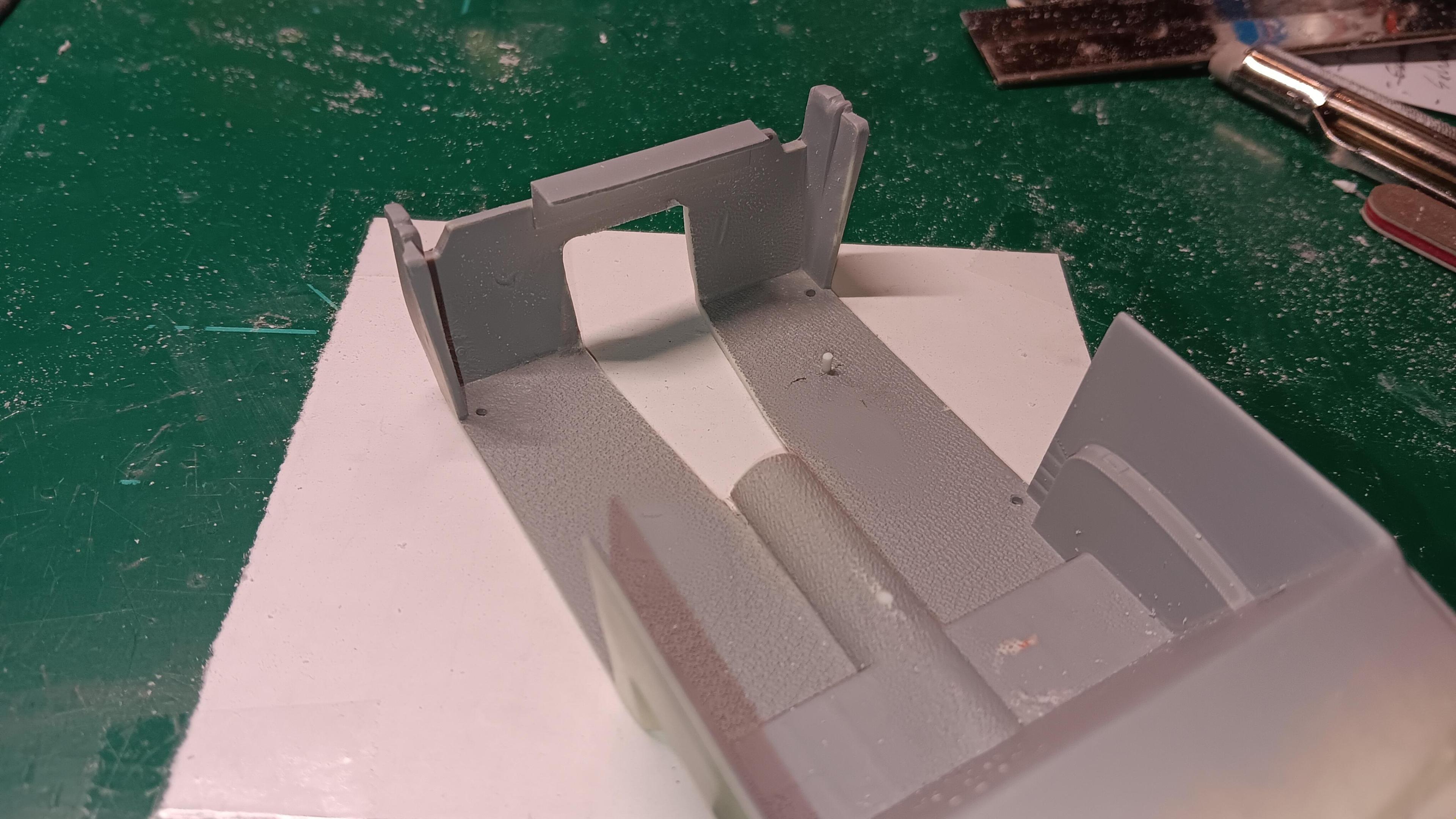

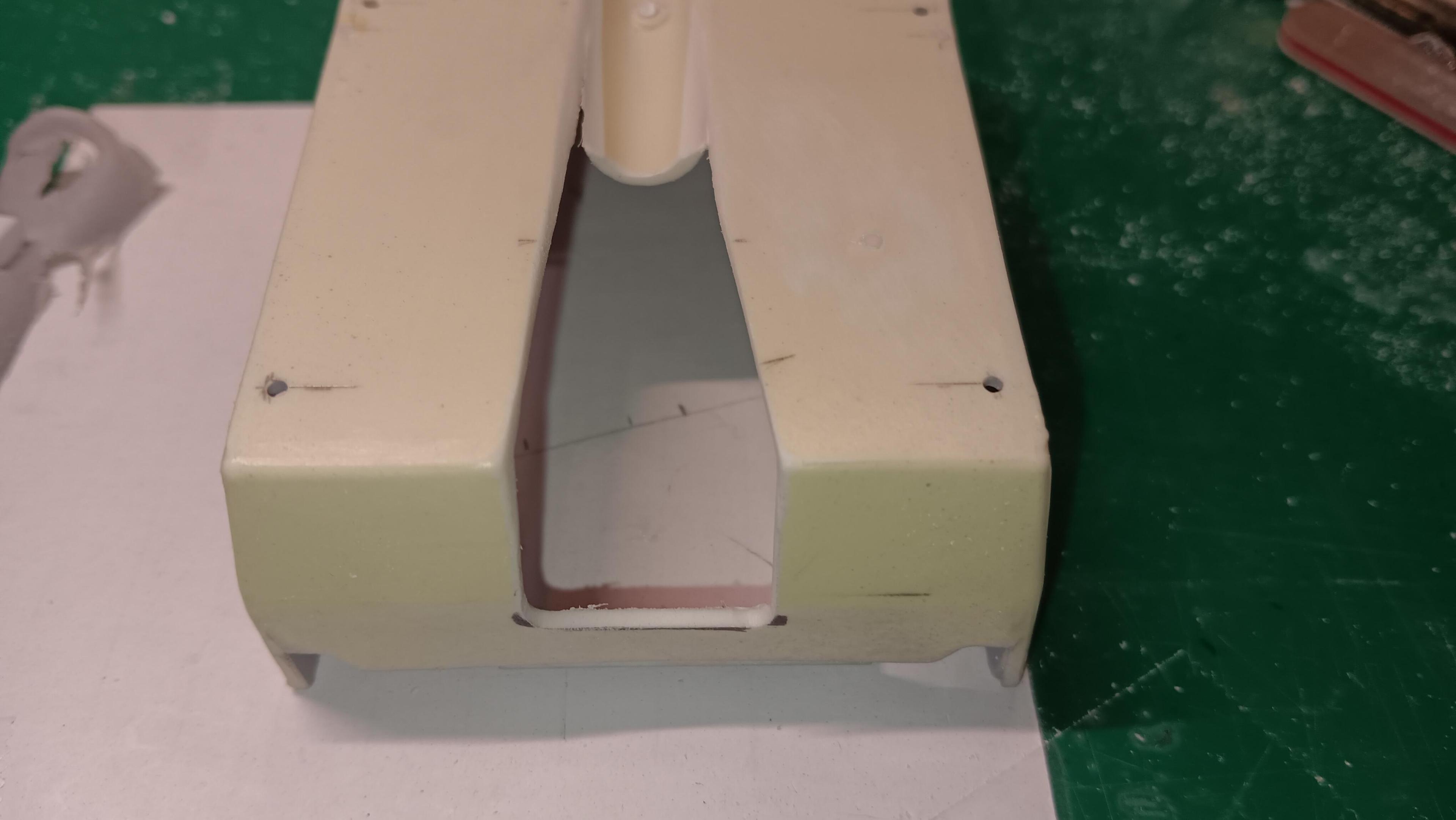

bobss396 Posted January 7 Author Posted January 7 So, put a 300 cubic inch 6 cylinder into an old AMT kit.. it will be fun they said. The 3D printed transmission plus the set back I had to go with made a ton of work for me. I have to build a transmission tunnel, trim out the firewall after I get the mounts made up
