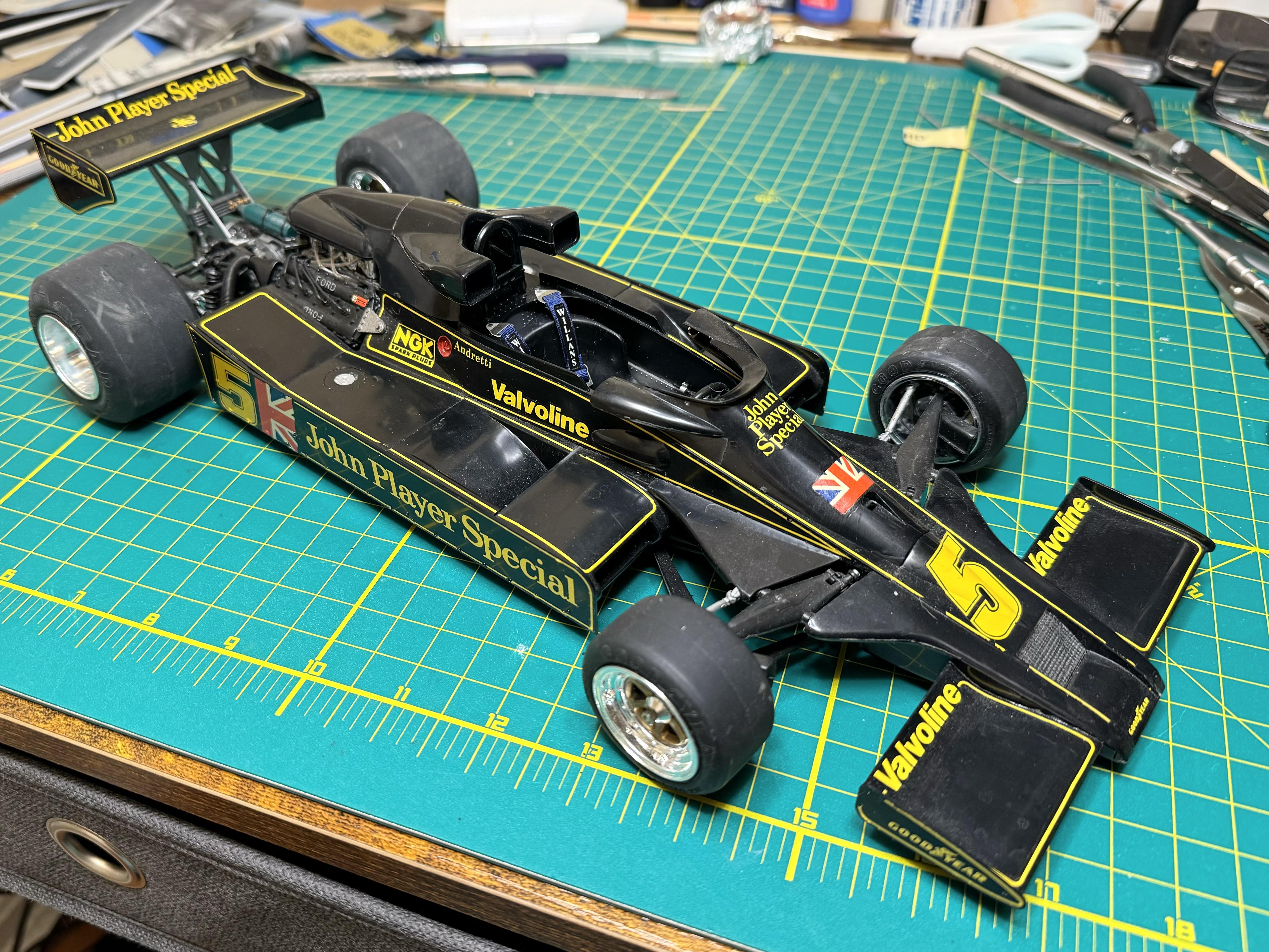

On 12/27/2023 at 7:54 PM, redscampi said:
I'd love to see the one you built, black plastic and all.
Here you go. It's a shot after I installed the seatbelts, crooked steering wheel and all its various warts. It's amazing to see that the decals aren't all over the place (like the floor and just plain missing) and there aren't pieces falling off.

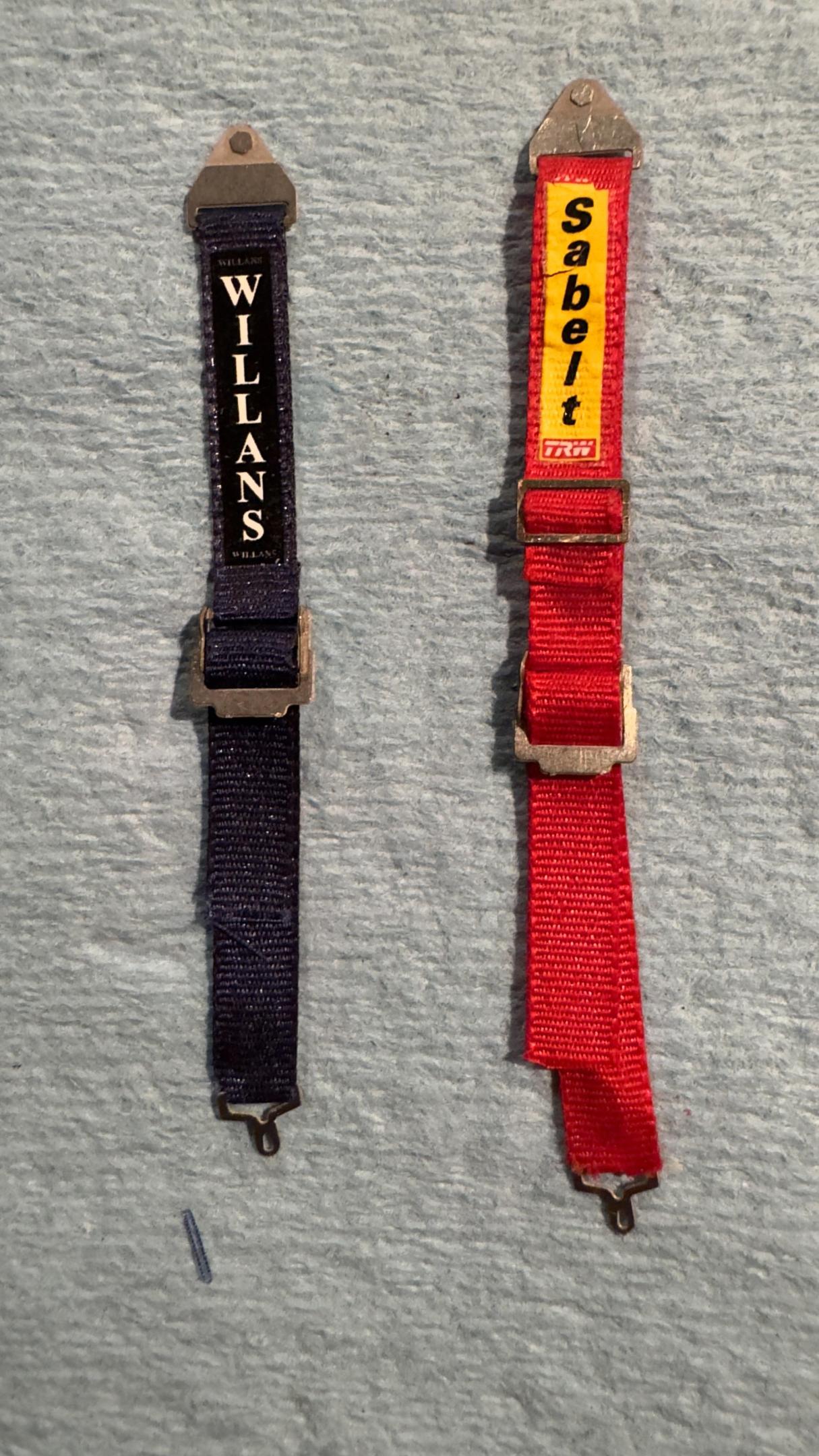

My very first experience with PE was the "Sabelt" in the next pic. For a multitude of reasons, it took over (I cringe to say it) five hours to complete. The Willans is in the model now. That one belt took about 30 minutes, and the set, plus installation, took under two for sure. Doing the Sabelt, I was Edward Scissorshands with the forcepts, tweezer, artery clamps, and more. The Willans was half or more done by hand.*
I'm amazed by PE and especially the designers. I cleaned up that which came with my 1/12 Porsche 934 RSR aftermarket detail kit. It felt like it weighed a veritable ton. So I actually weighed it: 137 grams... almost 5 oz of the stuff. The kit has a lot of parts, the PE easily has twice as many. LOL. But something tells me I missed the craze that seems to have happened on either side of 2010. Even the 934 detail kit is from that era. I read about it over the years, and I understood the concept from my work, but I'd never touched it, done anything with it. Now I have about 1 kg of the stuff waiting for four models to be built after this one, LOL. (The PE available for the B192 was overpriced.)
Putting together the Sabelt that I struggled with for hours, the stupid thing is, after all the times I've strapped myself into a seat with a six-point harness (but not since 2018) I let the directions throw me off instead of relying on my experience. Also, In the process I used about 1/3 the available red fabric on just that one belt. I had to learn to economize. That's somewhat of a theme here. Running out of paint is a drag.
The seatbelts are from Reji, which I think is affiliated with Eduard. They do some really cool stuff! Some of those 3D airplane cockpits, amazing...

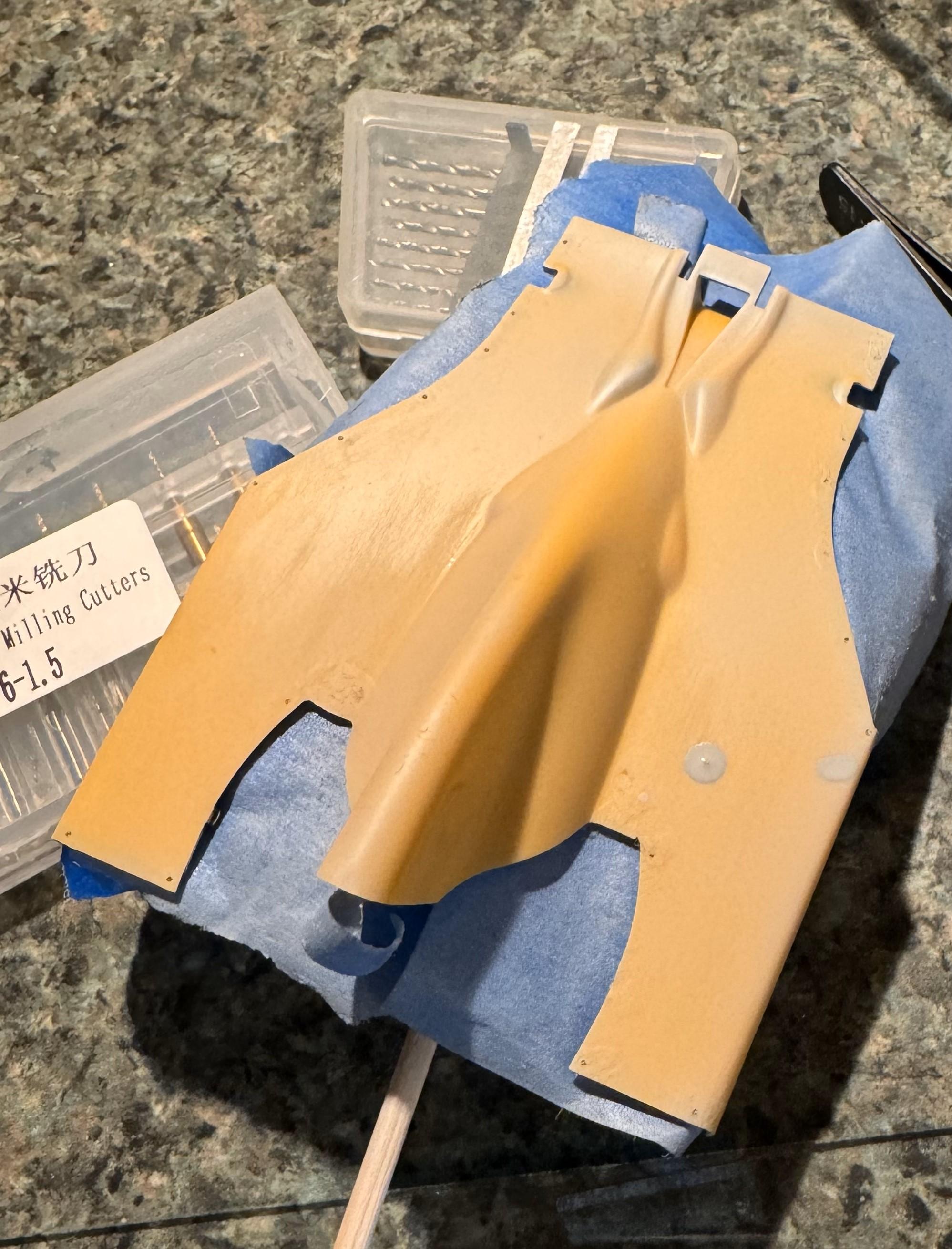

When I shot the body with primer, first I was amazed by the atomization from the rattle can of Tamiya gray fine primer. I didn't have a spray booth yet, and didn't plan on getting one until I saw all that fine primer mist floating in the air.
And, not surprisingly, as my first attempt doing this, it didn't come out well. I didn't expect to know what I was doing right from the start and get stellar results (I sorta was), but making a mistake this big was puzzling. Later on, like recently, I was using a $40 Chinese dual-action airbrush and the thing back flowed on me one afternoon upon my first test shot with my dwindling yellow paint. The loosely secured cap (because it wouldn't secure tightly) popped off and paint went up in the air was wasted making yellow polka dots on the bottom of my spray booth. l'd only had the airbrush for about 10 days and had cleaned it thoroughly the night before, disassembling it sitting at my table. I got rid of it the next day.
This is what it looked like when I got back upstairs.

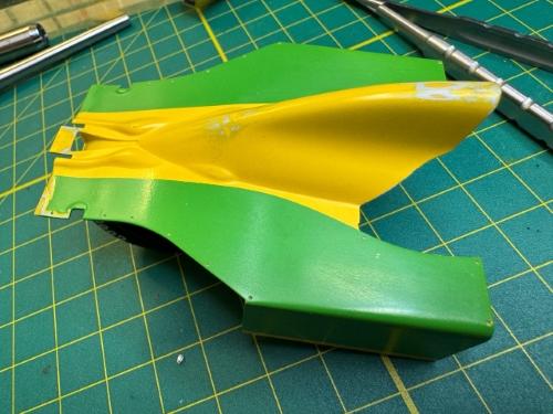

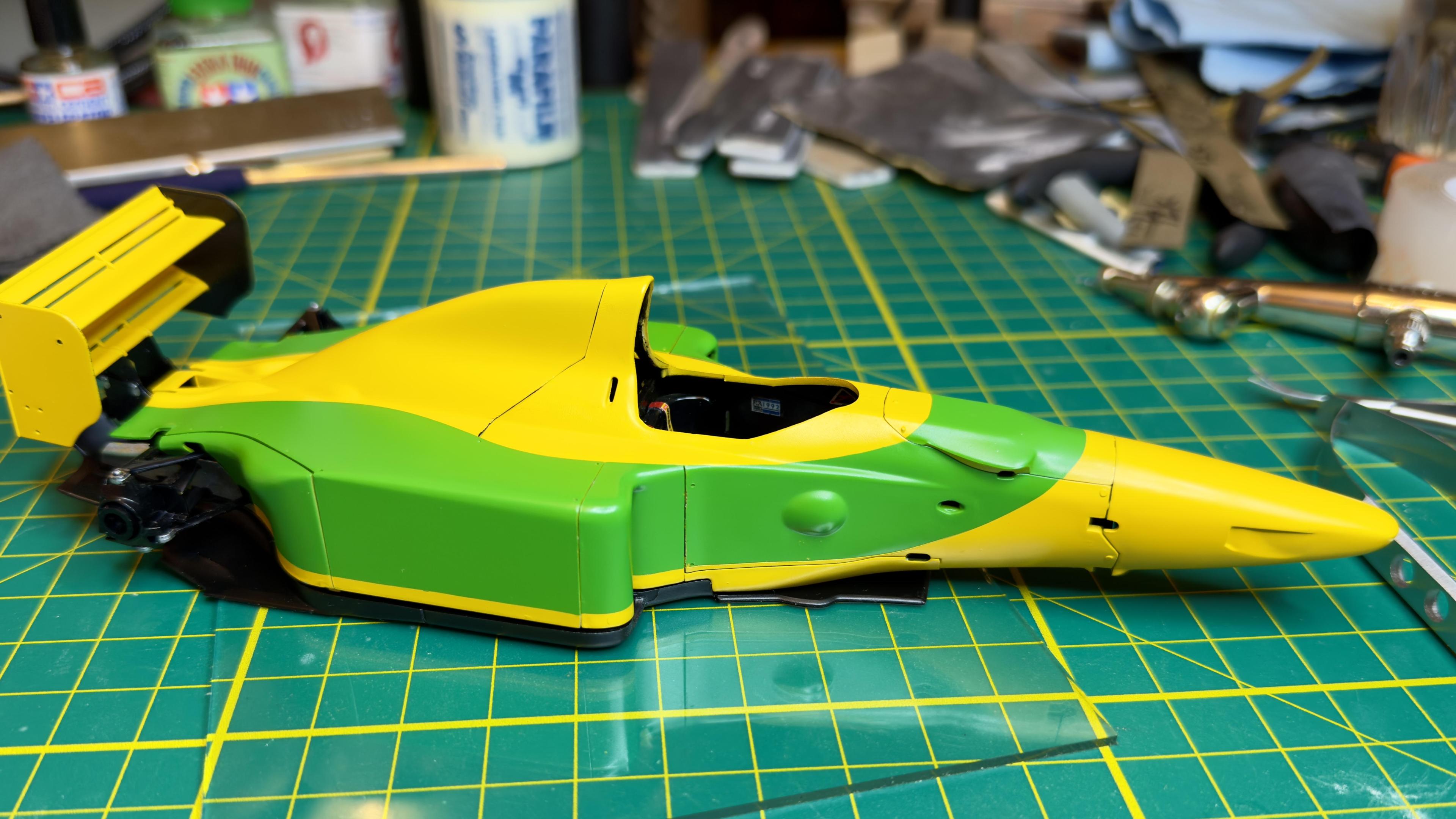

IMG_2858Largecropped.jpeg.a9987d2755a7890e5b4c0ec7a6402f19.jpegThe two-tone paint repaint. O. M. G.!!
I got the new bottle of Zero Paints "Camel Yellow" that I need to deepen some areas and, wickedly, to repaint most of the line that separates the green and yellow colors. The yellow border at the bottom of the body is too wide. If I'd dry fitted the model even once before painting the green over the yellow base coat, I would have noticed the problems (with an 's').

Which got me to here, which presented some obvious decisions that needed making:
My options were 1. to align the yellow stripe at the bottom of the cockpit only, instead of 2. doing the rest of the body to match the cockpit line. Mind you, except for a slight deviation in the line, the green on the monocoque area was correct, running right to the mating of the cockpit bottom. Instead of just fixing that small error, I go for option 1, moving the line (double entendre absolutely intended!):
IMG_2824Large(1)(1).png.d86919e48339c667e1a8f5935e6a79af.png  IMG_2822Large(1)(1).png.35dcfe0aae47571c8a870e8dcf747796.png
And this is what I get for not paying attention, and again, for not pre fitting days ago when I first masked for the green top coat. The obvious problem here is that I should have opted to extend the green top coat down instead of applying my precariously depleted yellow to go up. No, not to save the yellow! Cripes, that would have been a side benefit, and a big one at that. Instead:
The reason I should have gone down and not up is:
  1. That would  have placed the color switchover line where it was supposed to be in the first place, and
  2. I would not have been building up a huge ridge by having primer + lots of yellow + green + more yellow. I could have just added green... end of story.
The obvious misguided driver in my decision making was (besides lack of experience), that I'd have had to do all the panels with option 2. Now, I get to do even more to correct this and some other problems... if I want to go that route, and I think I do.

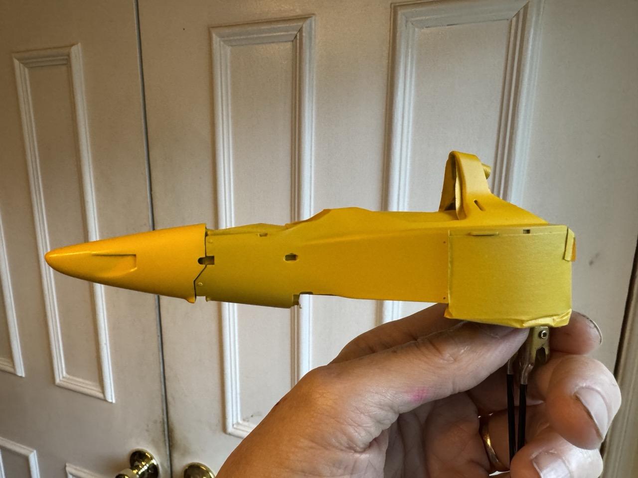

I have, of course, decided to go for a grand prix, win or go home, type fix. But how to do it is still open, although I have a plan. I just don't know if it's the best plan. This is where I'm at now:
Some of the detail of how I got to this place. I had noticed there was a problem with the fit of the air intake. I finally — and I mean I have no idea why it took so long — took a closer look and noticed that the rear cowl had a flat spot on the top of its portion of the intake. I fixed it with, first, some CA hardened with baking soda, and then with some UV activated resin (UVR) on top of that, followed by one of the longest sanding sessions ever... maybe 90 minutes or more. When I realized I needed more material on top of the CA, I went with what I'm comfortable with.
I held the intake against a steel block covered with aluminum foil and dripped on some UVR such that the steel block formed a straight edge (picture was taken in haste and through my magnifying lamp... sorry). You can just make out how the UVR spread into a thin layer I snipped off. The flat edge is what I was worried about and wasn't sure the CA wouldn't stick, at least in part, to the foil. On the other hand, I knew the UVR wouldn't.
-IMG_3105Large(1).jpeg.a279ecfbaaeec55e0f40dc96b3bb0603.jpeg  -IMG_3140Large(1).jpeg.110273713325973068abeab6aab2f77c.jpeg  -IMG_3142Large(1).jpeg.f60b35c51350bce27246aab1658df78c.jpeg
Then I notice the bulge on the left side of the intake and decided to take care of that:
-IMG_3154Large(1).jpeg.07abbccb6ba61ec4b3bd49b9632e2654.jpeg    -IMG_3153Large(1).jpeg.49d92a86f4c8bdf1cd621cbd6b81948c.jpeg
I ended up with this as the current state of the intake. Note that the little flap at the rear got bent during the process — I have no idea how it lasted this long! — and I have yet to sand the putty:
When I say I'm not sure of how to do the repainting, I mean I don't know whether to strip all the parts and start over, or piecemeal shoot the yellow and then the green, and in some cases vice versa. It's all on the table. I hate to go forward without input from hobbyists with experience, but I'm afraid that's how it's gonna go, given that's how it's gone. I'll probably start painting late afternoon / early evening today. If you have anything to say, and I mean anything, even if you're not sure it would be helpful, please do. Remember that at the top of this post are larger pics to help get an idea of what I'm working with.

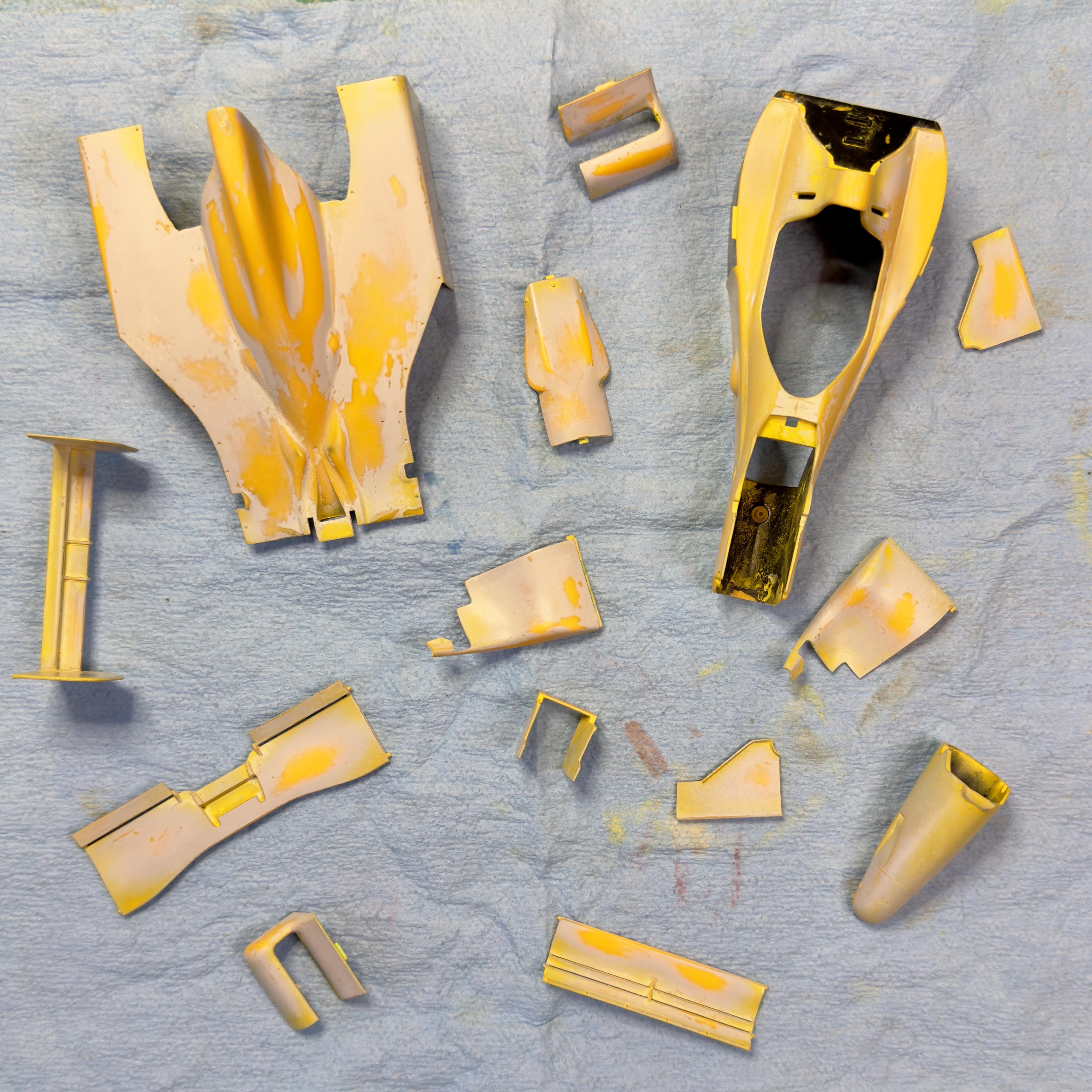

Only my opinion, but I would strip it down to bare with your stripper of choice,  apply a couple thin coats of primer and then finish the body work to your satisfaction.  Then proceed with the color, lightest first.  You picked a tough one to come back but I really like the choice!
+1 to this, rather strip it down.
An IPA bath it is!
Thank you, both... sort of. JK. I am grateful to you. I feared that would be the best course., but I wasn't going to start there. What convinces me (aside from your experience), and what I had only in passing thought about, is the next step — shooting it with primer to validate the fixes I've done so far. It definitely needs that.
Primer is amazing stuff. I was surprised after only the first coat what all it revealed. My only hesiancy is the monocoque. I spent a lot of time while masking the first time to maintain the monocoque interior because of the decals inside it. I hand painted and decaled it circa 1994. I have replacement decals, though, so it's on with a bath of 99% IPA. Ugh.
Can't thank you both enough.

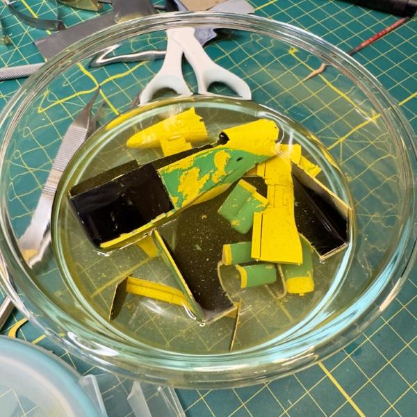

Is there something I need to be aware of to do differently when repainting?

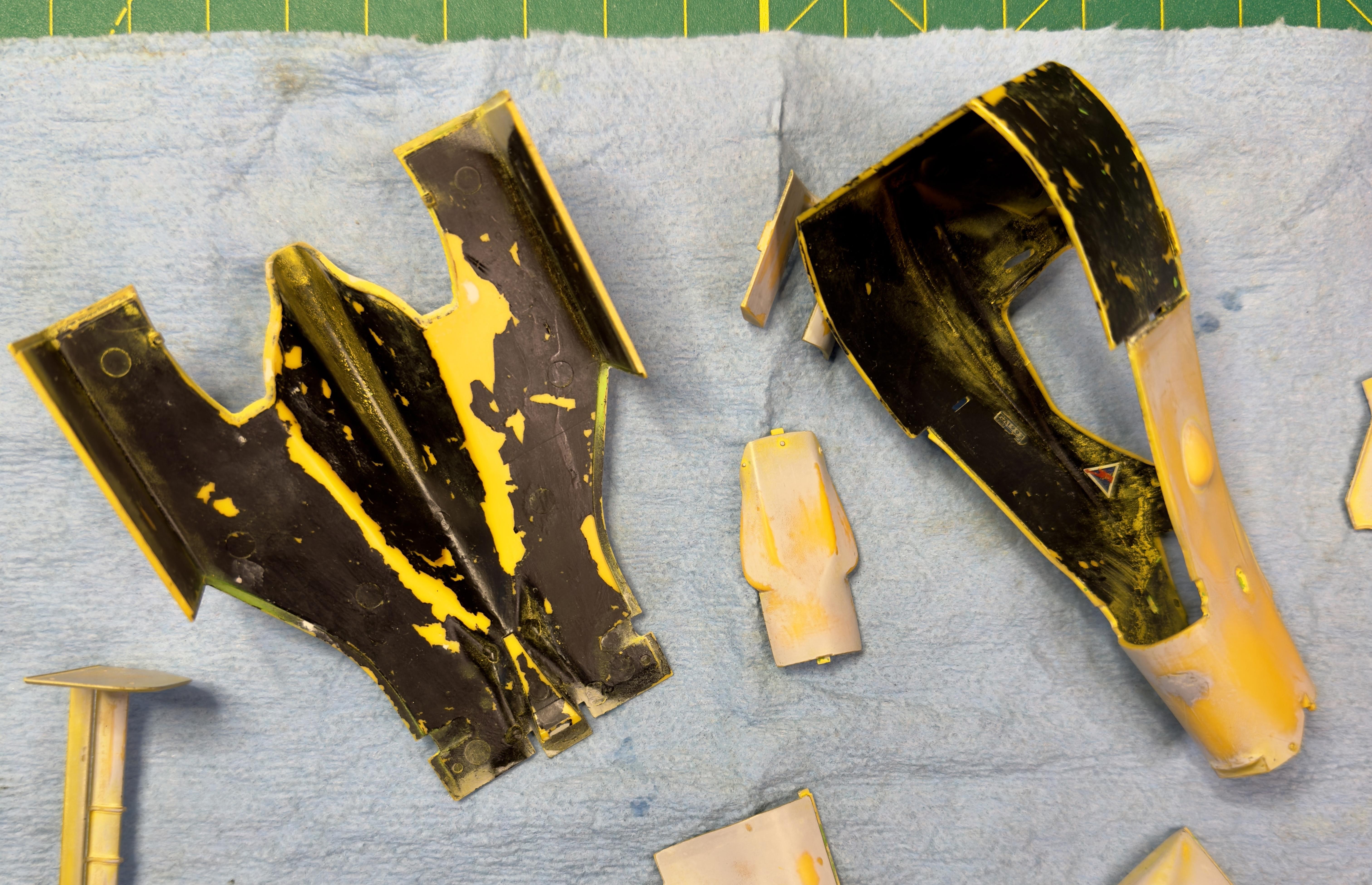

I just went to start in with the toothbrush, and I didn't expect what I found:
It's been, what, 4 or 5 hours that it's been stewing. That the green flaked off while the yellow stayed attached to the primer doesn't right away concern me. However, I am curious about what it means.
Can I get your opinions about whether it's indicative of a problem, or even just a concern, about which I need to take into account when I start repainting?
If it all looks good to you so far, please, please let me know. Or, if I did or didn't do something between coats that I need to correct in my technique, please help me with that:

Re: the paint stripping: until you've stripped a model you spent 20 hours painting and repainting — I kid you not — you just have no idea that it's a rational decision to undo all of that instead of try to work with it. Much of what is going to change is that it won't take me 20 hrs to get to the point I was at before throwing it in reverse. Or at least, it better change!
Again, thanks. Stop in every now and then, would you. I'm starving for input.
I know I need to strip the black enamel from the interior. I've ordered some Testors enamel thinner (should have just gotten some mineral sprits, I suppose) because the IPA isn't cutting it. In any case, I used all the 99% I had in the first dipping and the gallon I ordered won't get to me until Wed.
My question at this point is, am I deluding myself by thinking that the parts aside from the black are good to go? The stripping with a towel, and using an electric toothbrush for the tight spots, took a while. Add the time I spent sanding those parts, and it's been a pretty solid eight hours of work. That Tamiya gray primer is stubborn stuff! Wow, it's nice to know that, when you don't have to strip a project, your paint has the support of that primer underneath it. Trust me, the surfaces are smooth as a baby's bottom. However, I have no idea if the new coat of primer will blend with the old or just highlight that I left some behind. lol.
There's a part of me that doesn't care about the insides, that all I need to do is sand with some 80 grit paper (kidding), apply some black over that, and call it done. Agree?
I left the pictures large so you can zoom in on them (it's amazing those decals in the cockpit are still there... I may try to preserve them just becasue):
The alcohol isn't much good for enamel. I've always used Easy Off with no problems.
I don't think I'd use the Testors thinner or mineral spirits for stripping, might melt the plastic.

As you have found, IPA wont strip enamels. Don't use paint thinner to strip paint, it can seriously damage the plastic. There are several common items used to strip paint, some work better then others depending on type of paint (lacquer, enamel, acrylic), specific manufacturer's formulation, type of primer, how old the paint is, and curiously, the colour (some don't strip well, such as flat black or silver). Here is a link to a thread with much good information. It's 27 pages, so probably way too much information, and some mis-information (if it doesn't sound right, question it). Everyone has their personal favourite paint strippers for removing different paints. A quick breakdown of the common players;
- Castrol Super Clean degreaser, colloquially referred to as the purple pond (great for enamels, sometimes works on lacquer and acrylics). Pour it into a suitable container and dunk the whole body in it. Can take from hours to days to work, depending on the paint. It's re-usable. There is a knock-off product called Purple Power, but it's not nearly effective.
- Easy-Off HD oven cleaner (NOT the fresh scent or lemon scent stuff). Like Castrol Super Clean, it employs lye as an effective ingredient. Put the parts in a zip-lock bag, hose the parts with the Easy-Off, and seal the bag.
- Isopropyl Alcohol (IPA). Use at least 91% IPA. Works great on most lacquers and some acrylics.
- Brake Fluid. Can be a bit messy, but can also strip stubborn to remove paint. I use it when the others don't work. It's re-usable.
- There are also a couple a bespoke products that work very well, though I've not tried any of them. One is ELO (Easy Lift Off), a Testors product, I think (could be wrong, but the linked thread will have the vital info). You don't soak parts in this stuff, but apply it with a brush/rag to soften the paint, then remove the paint.
- ...and a couple tips; All strippers work best when warmed slightly. Also, paint will strip easier, especially stubborn or old paint, if the surface of the paint is abraded with sandpaper, allowing the stripper to get in under the outer cured layer of paint. Also, it's best to use latex gloves or similar when handling any of the strippers.
I appreciate the reticence to strip a paint job that took many hours of work to prepare and apply. The impetus is to try to save as much of the work as possible. However, in the end, you will find that if you are not happy with flaws in the paint, you often will not be happy with attempts to fix it. Some flaws and issues can be skillfully repaired with an airbrush, so it's not always a loss, but we have all put more hours of effort into trying to save a hard won paint job, reluctant to strip it all off. Often you come to the conclusion that putting 200 hours into a build with a compromised paint job is not nearly as satisfying as putting in 220 hours into a build with a great paint job. Though a pain in the butt at the time, the end result is a model you are even more proud of, knowing you went the extra mile to get it right. You soon get used to removing a paint job that did not go down well as soon as you realise it's not good, thereby saving all the hours and effort you would have put into a doomed attempt to save it. The real nuisance is when the model has a lot of repairs, corrections, or custom work involving putty. Most paint strippers damage most putties, requiring all that work to be redone. In some of these cases, sanding off the damaged paint may be the best way forward. It depends a lot on the type of body and its details that can be damaged by sanding. All very subjective.
It looks like your body panels are ready for primer again (it's usually not necessary to remove all traces of the previous primer job). Give the parts a quick wash and scrub with mild soap (absolutely must be silicon free) and warm, running water. Rince well using a fine nail brush to get into all the crevices, dry with a lint-free cloth, and let air-dry thoroughly. Give it a quick wipe with IPA on a lint-free cloth. Then apply your primer. Once the primer is on, you can assess the quality of the surface finish, and do some fine follow-up sanding if needed. Re-prime if necessary. A final light rub with 1000 or 1500 grit sand paper, used wet. A final thorough rinse and dry, final wipe with IPA, and you're ready for paint.
Edited by Bainford
Bats in the belfy
I am not familiar with the paint strippers mentioned above, a local hobby shop here in South Africa sells an unbranded bottle containing oxytol.
I kid you not, I have stripped a body which I had primered with Tamiya grey primer, red Tamiya LP paint as well as automotive 2k gloss coat in less than 10 minutes.
There is no need to sand afterwards, the paint is gone completely, I just agitate it a lit with a brush, and that's all.
I too have painfully made the decision to strip knowing how much effort went into what I am throwing away, but from this you get experience, confidence, etc. After the hard times easier times will come, as each step in this process becomes a new skill.
