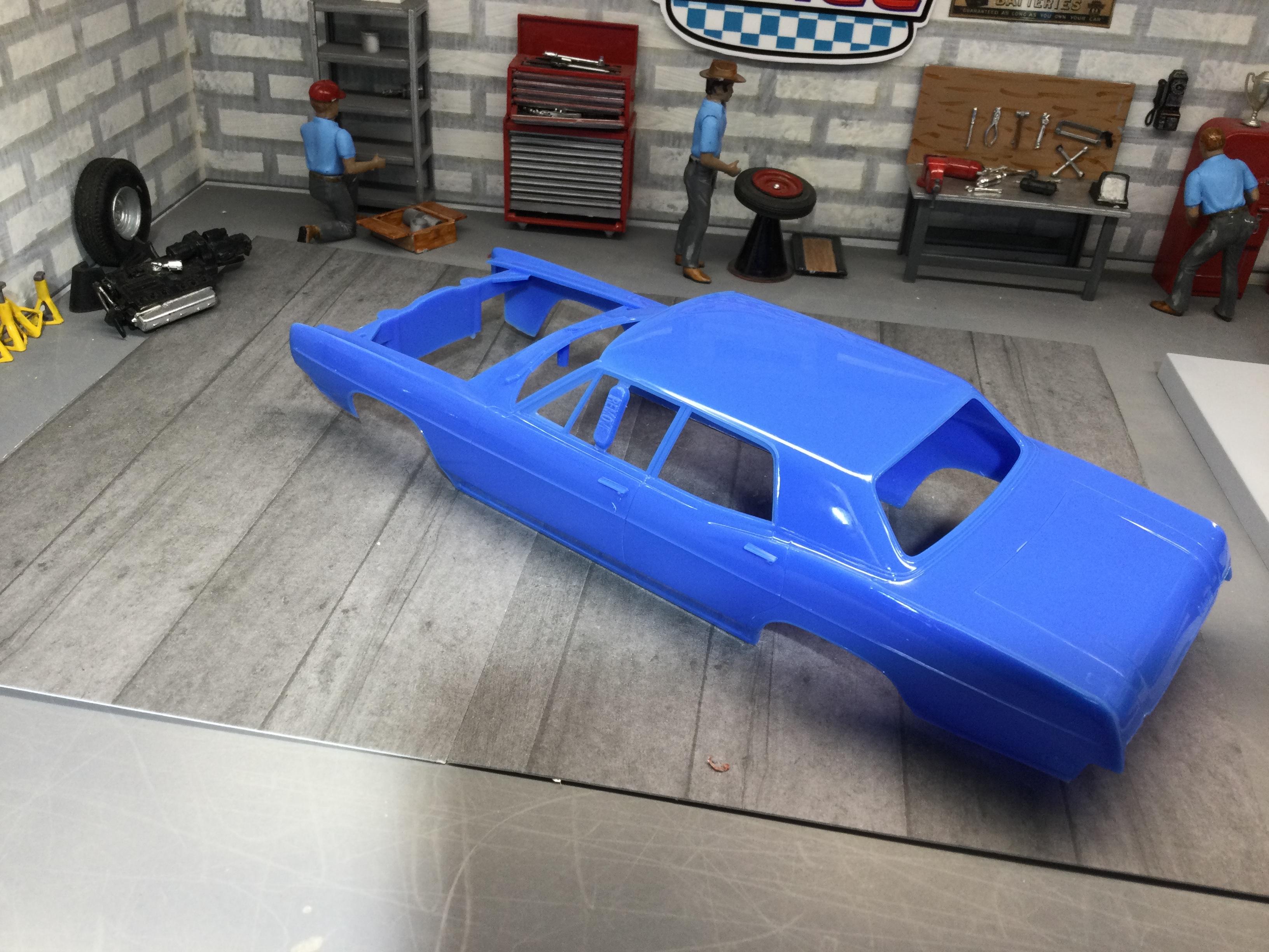

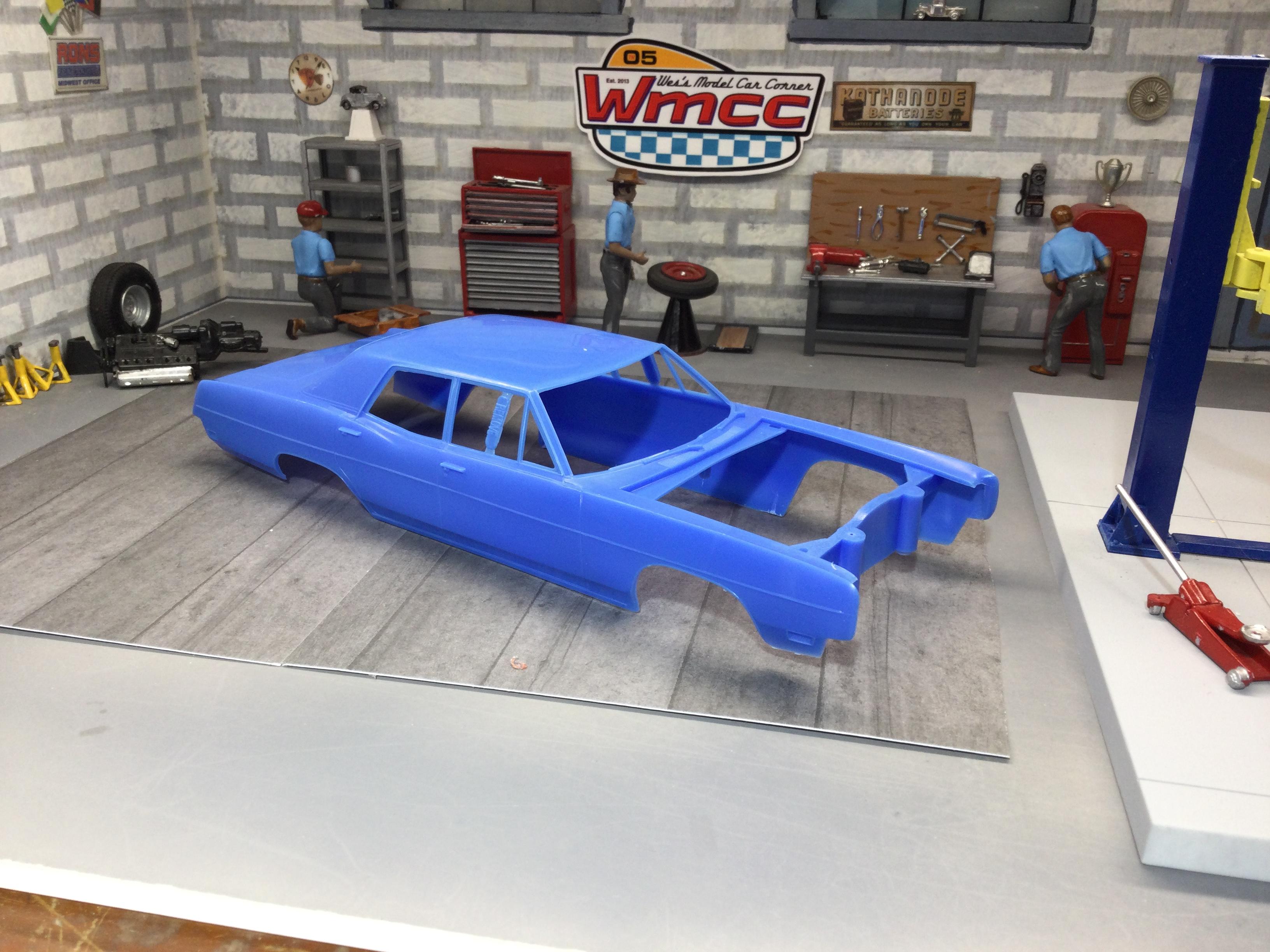

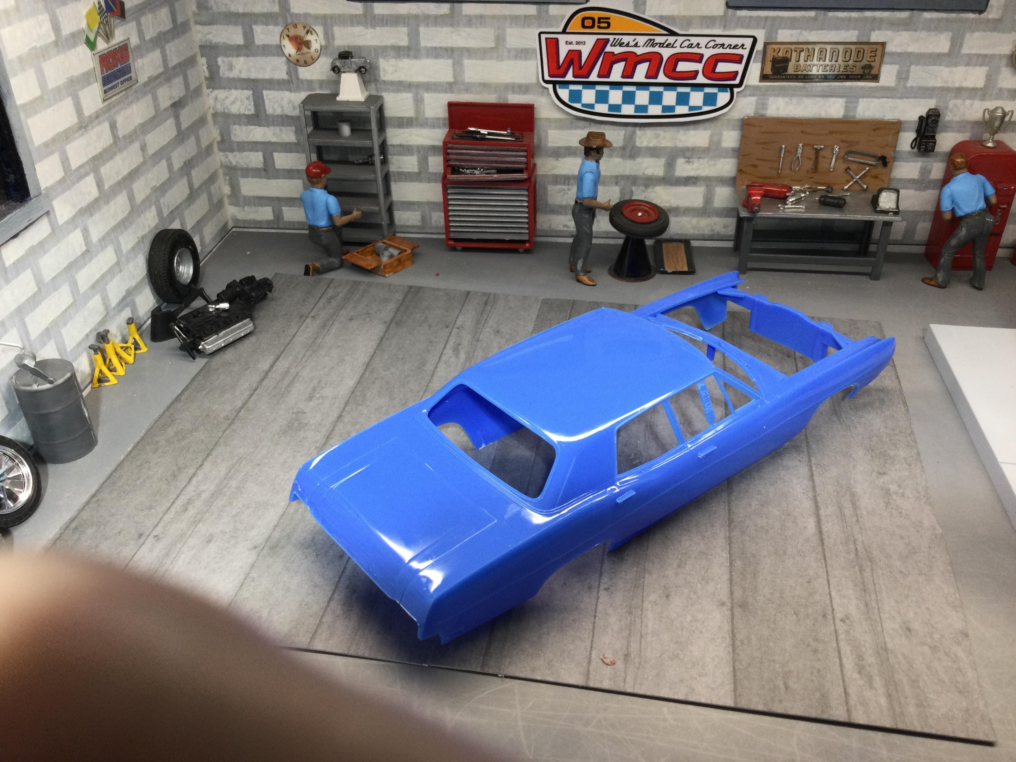

So I know there is this thing about Pledge Revive It. So here’s an example of a colored plastic before and after a coat. I just threw it on there. It’s the 007 blue police car. My Ollie’s just got these in so I bought one out of curiosity seeing I just received the earlier white plastic version of this kit. First 2 photos are before a coat. The other 2 are after. If you have this kit you know how awful the blue plastic is in the kit. This doesn’t work well with enamel paint. But some builds I’ve done that were colored plastic has come out well.

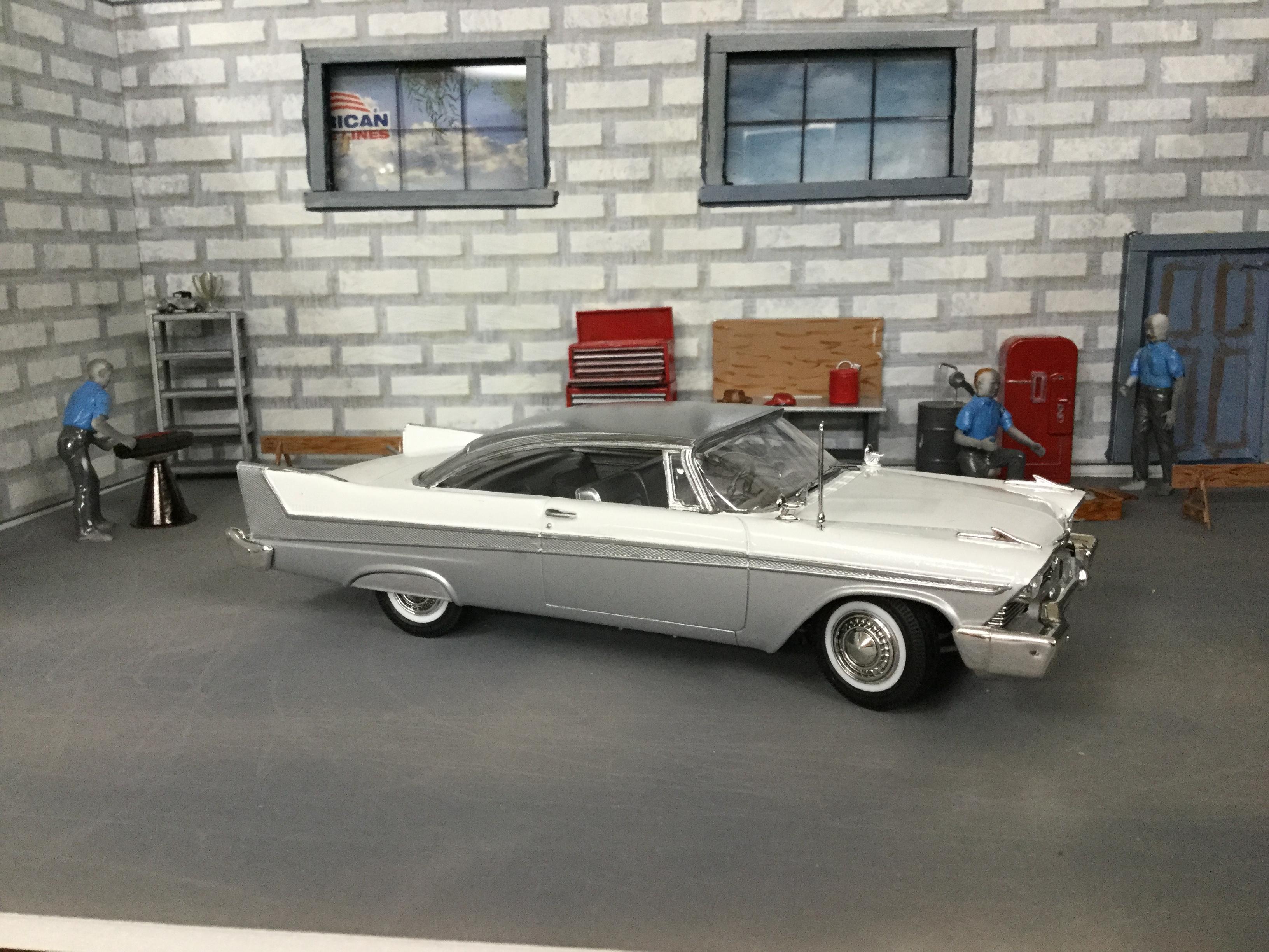

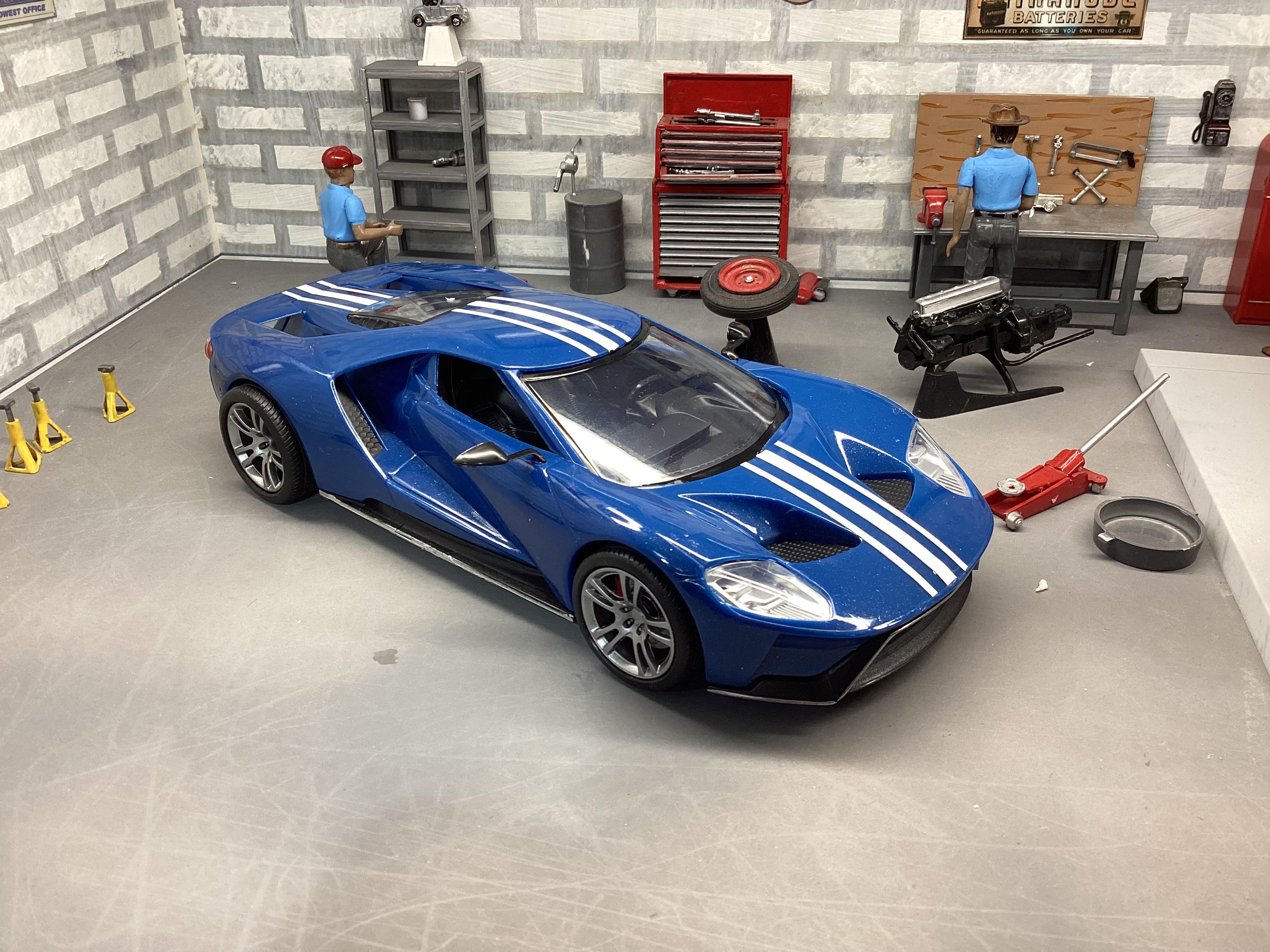

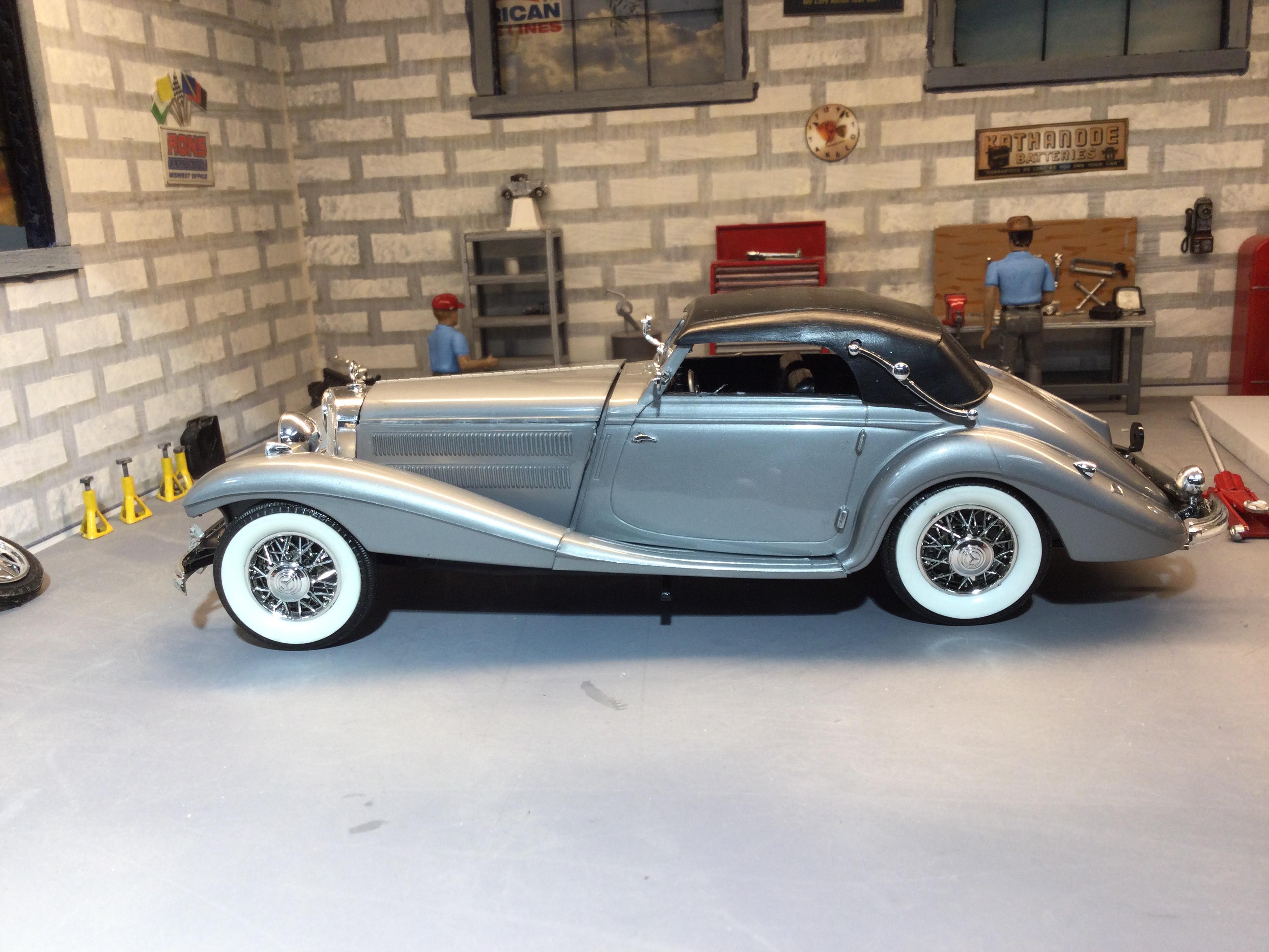

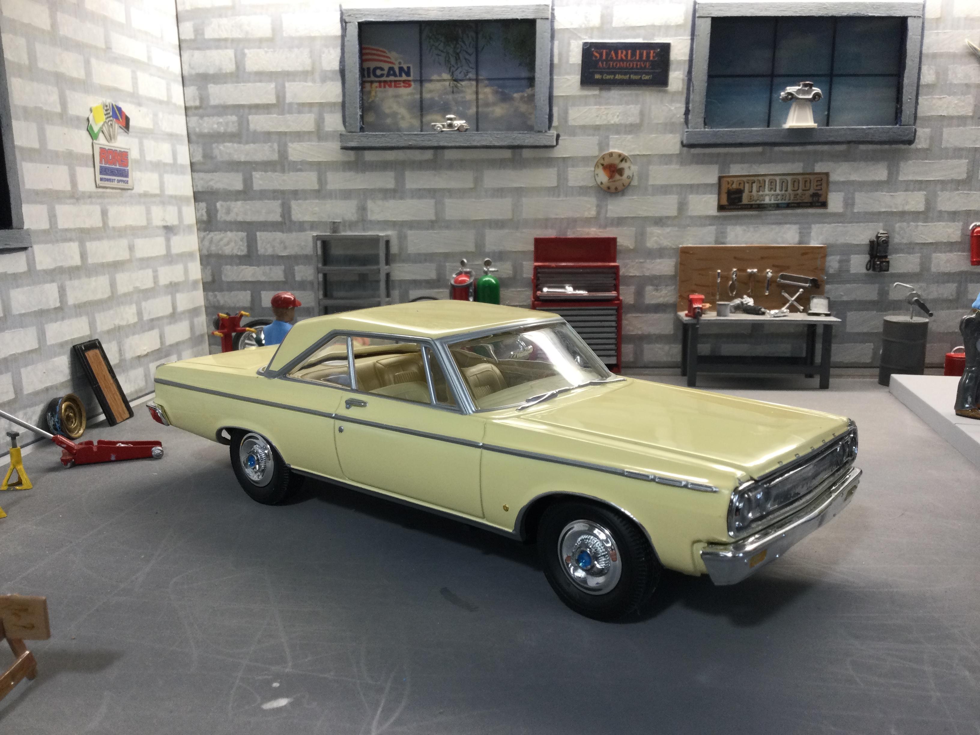

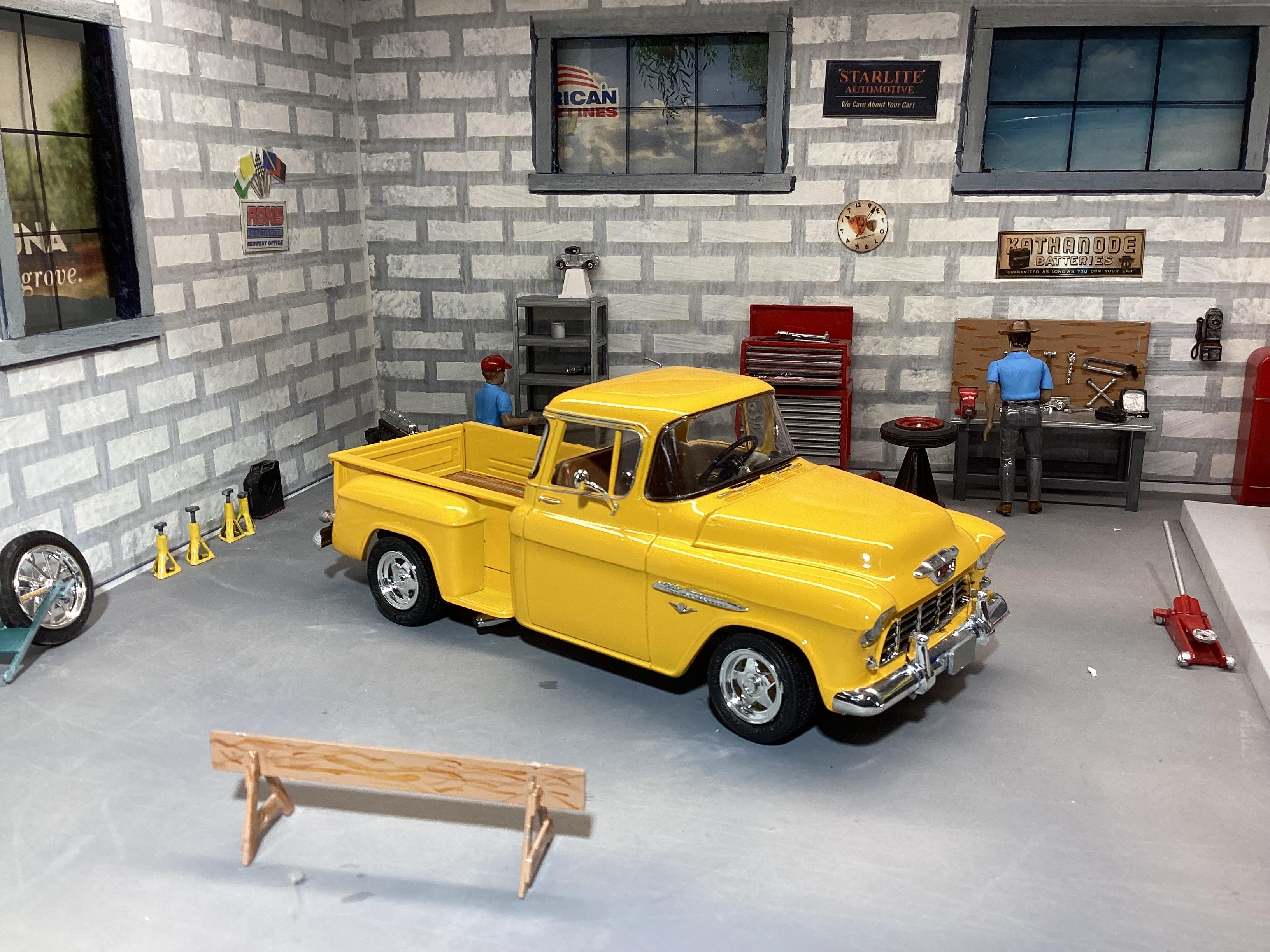

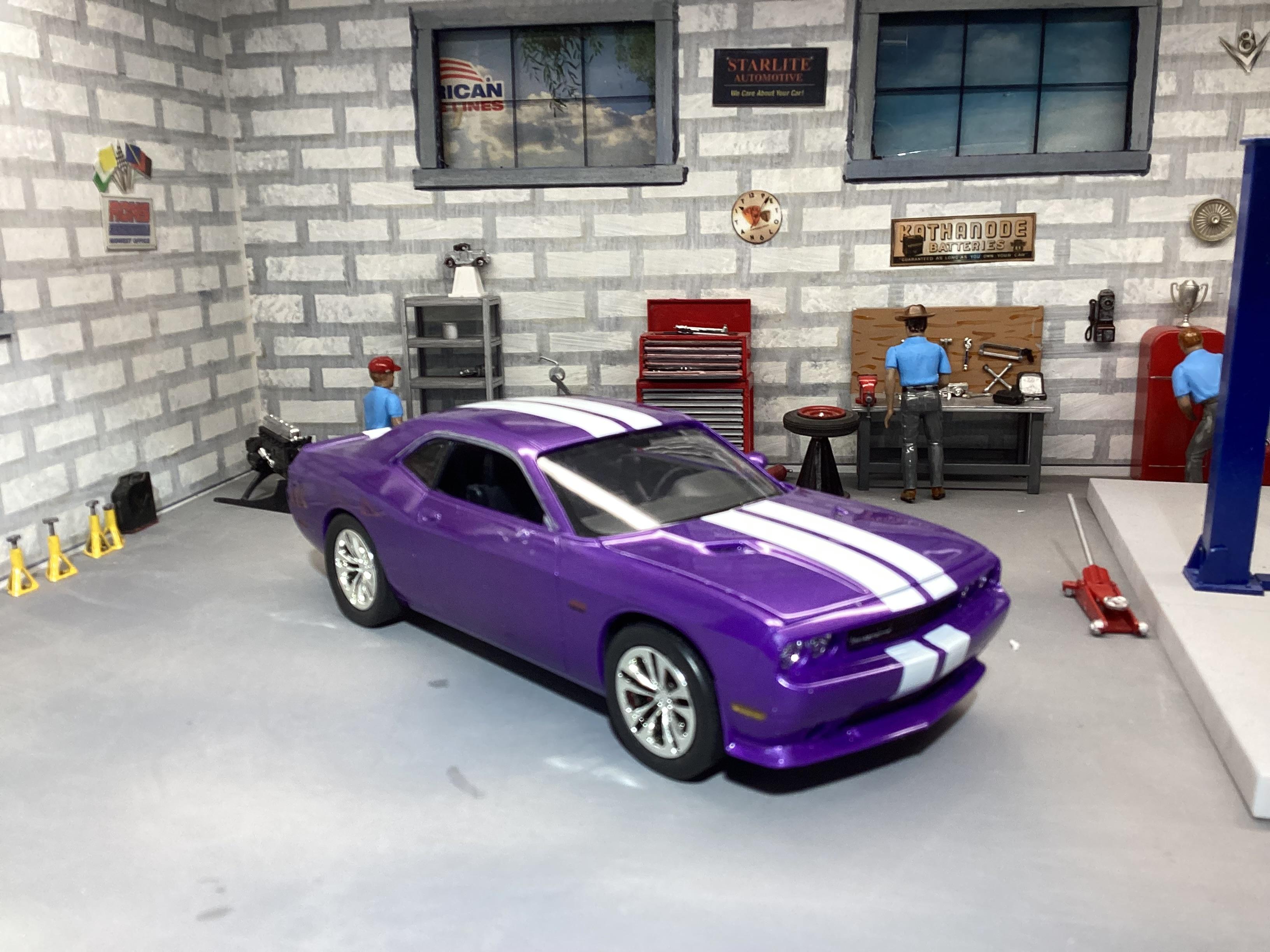

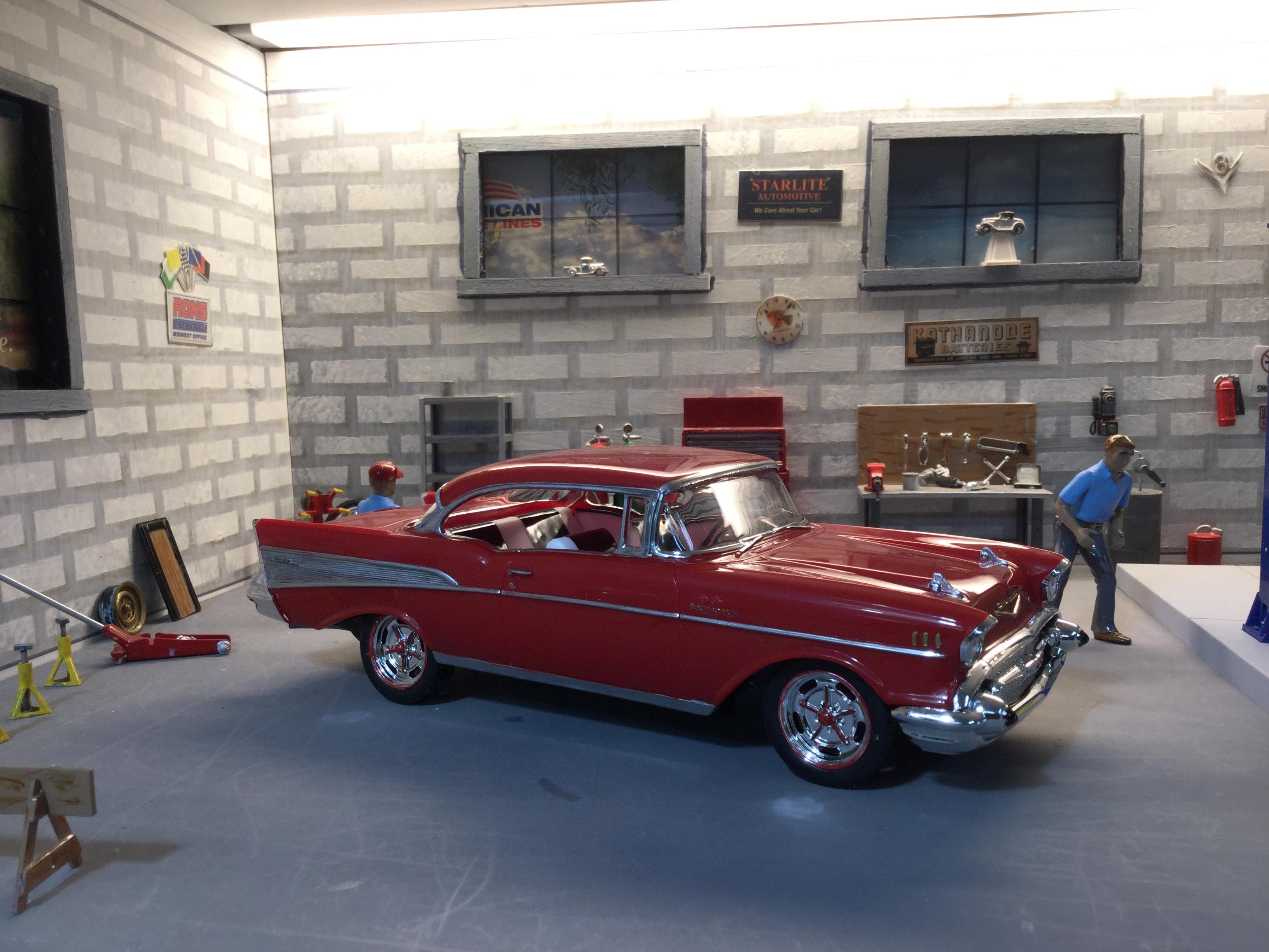

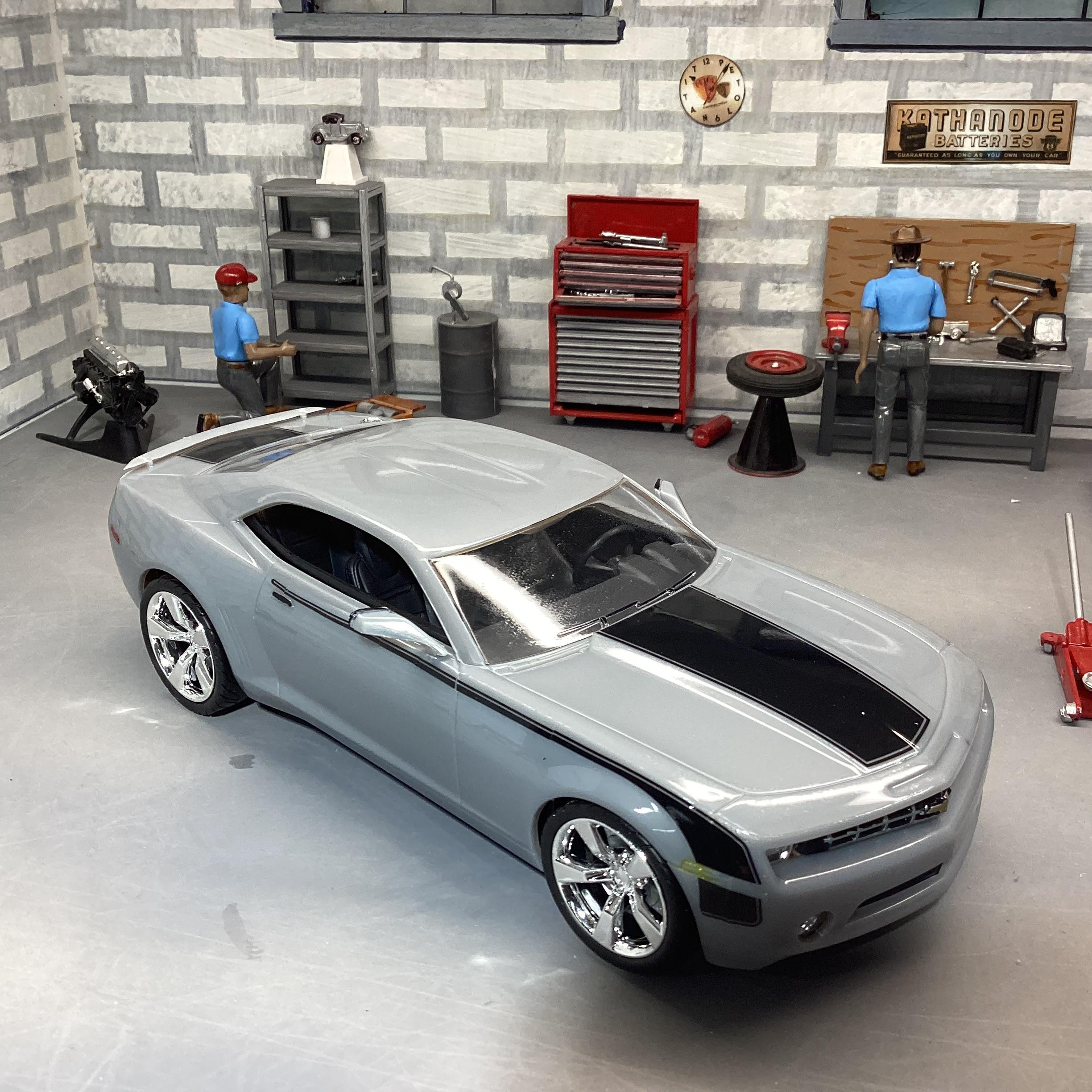

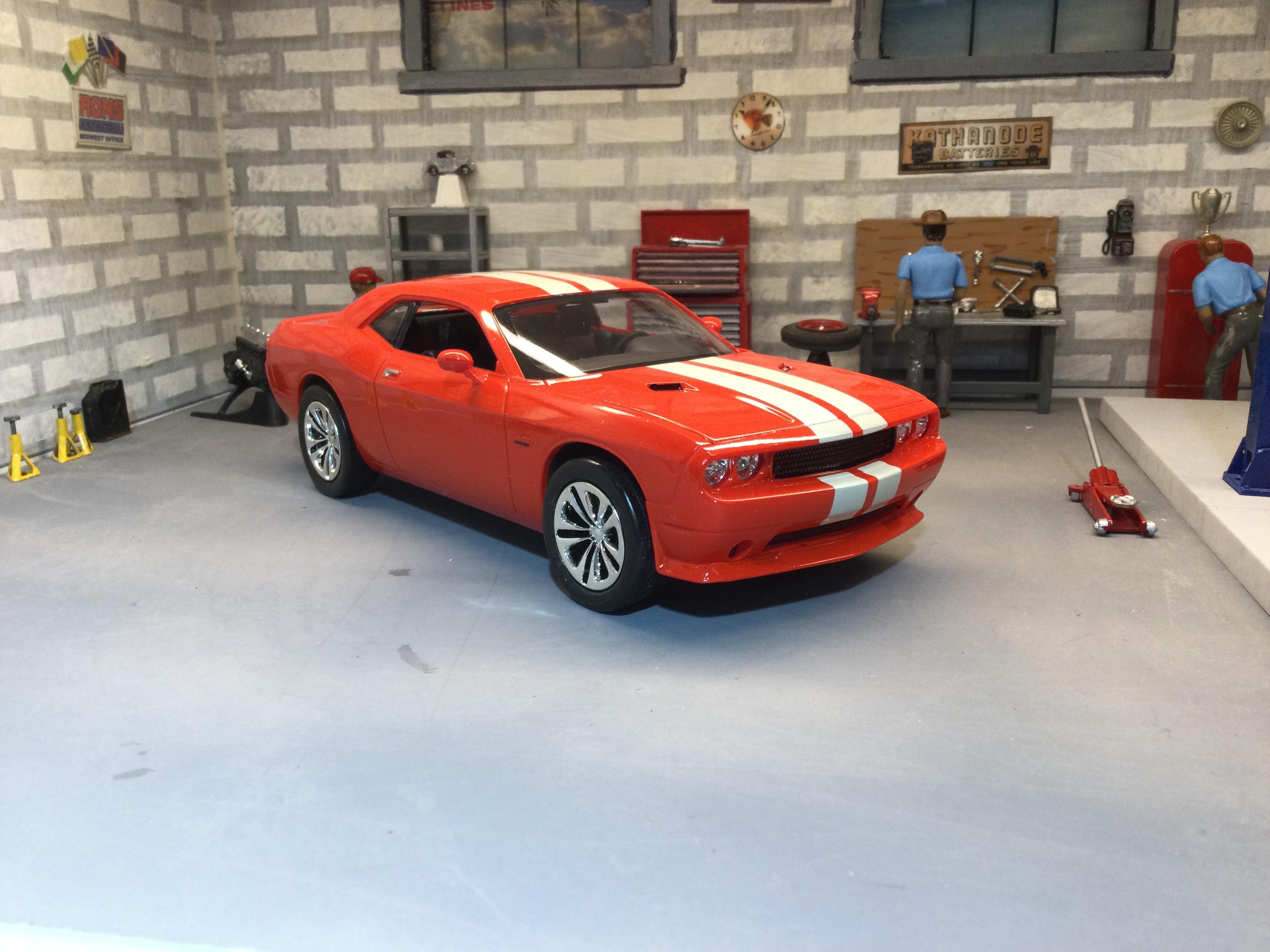

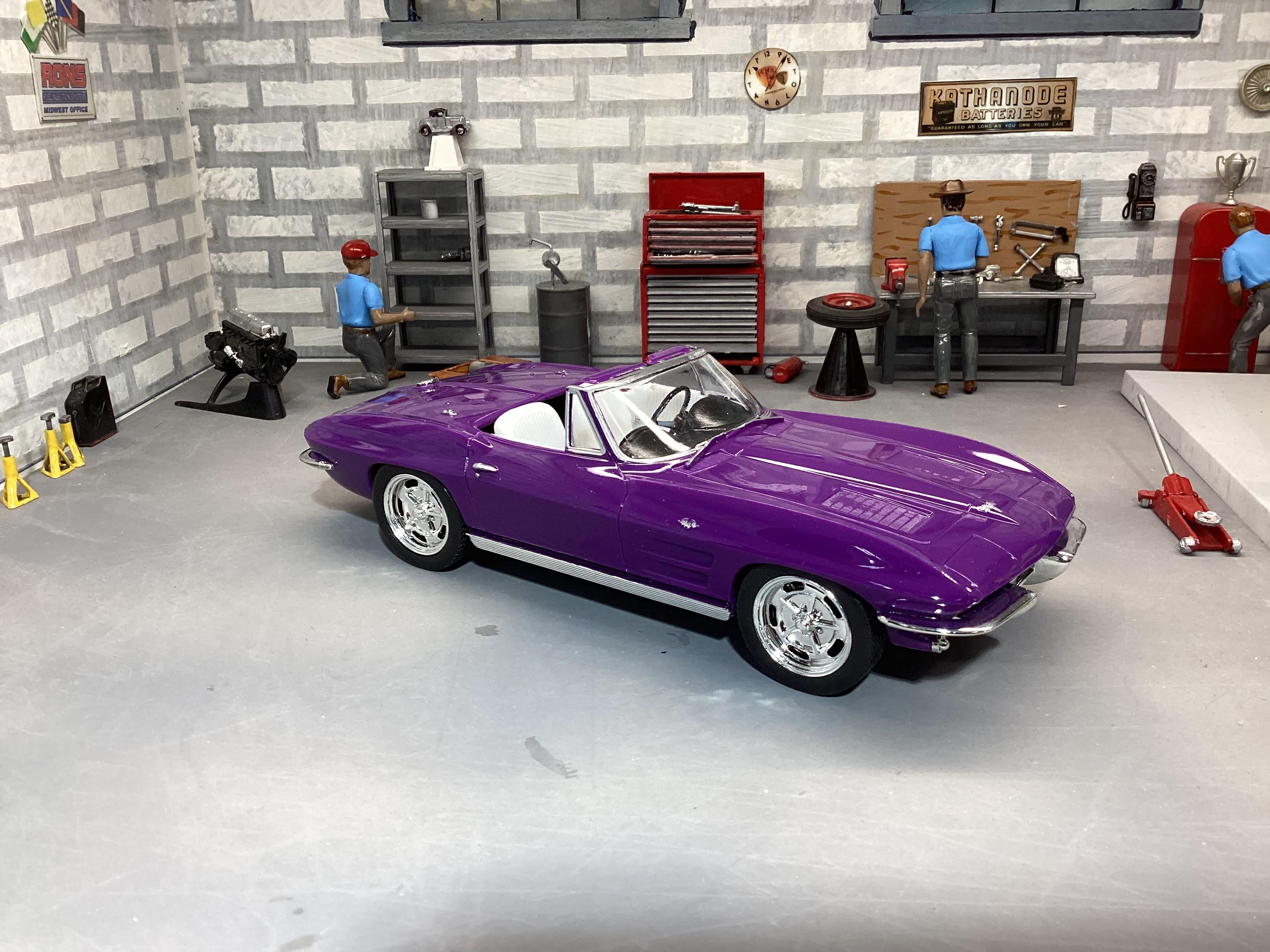

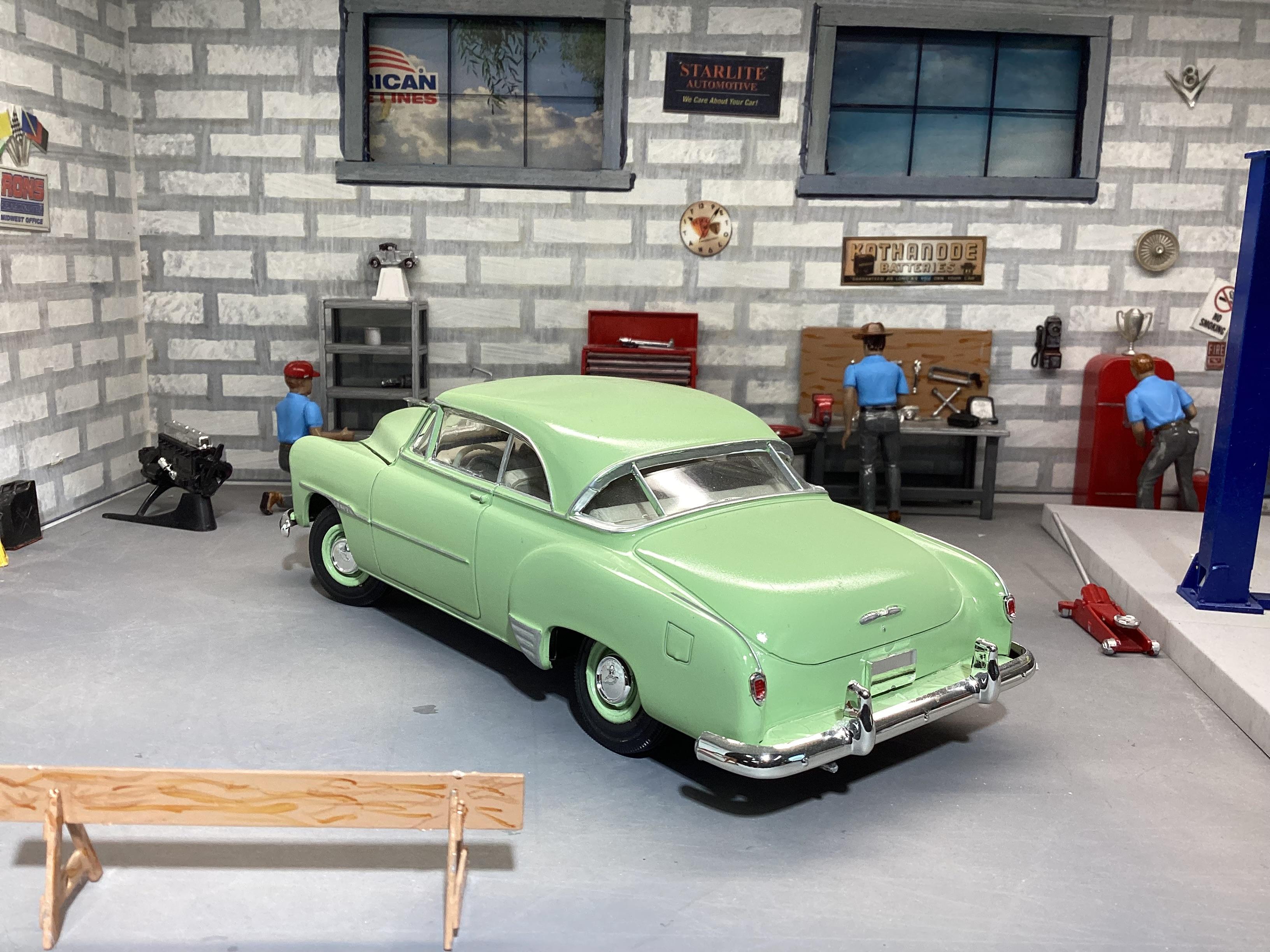

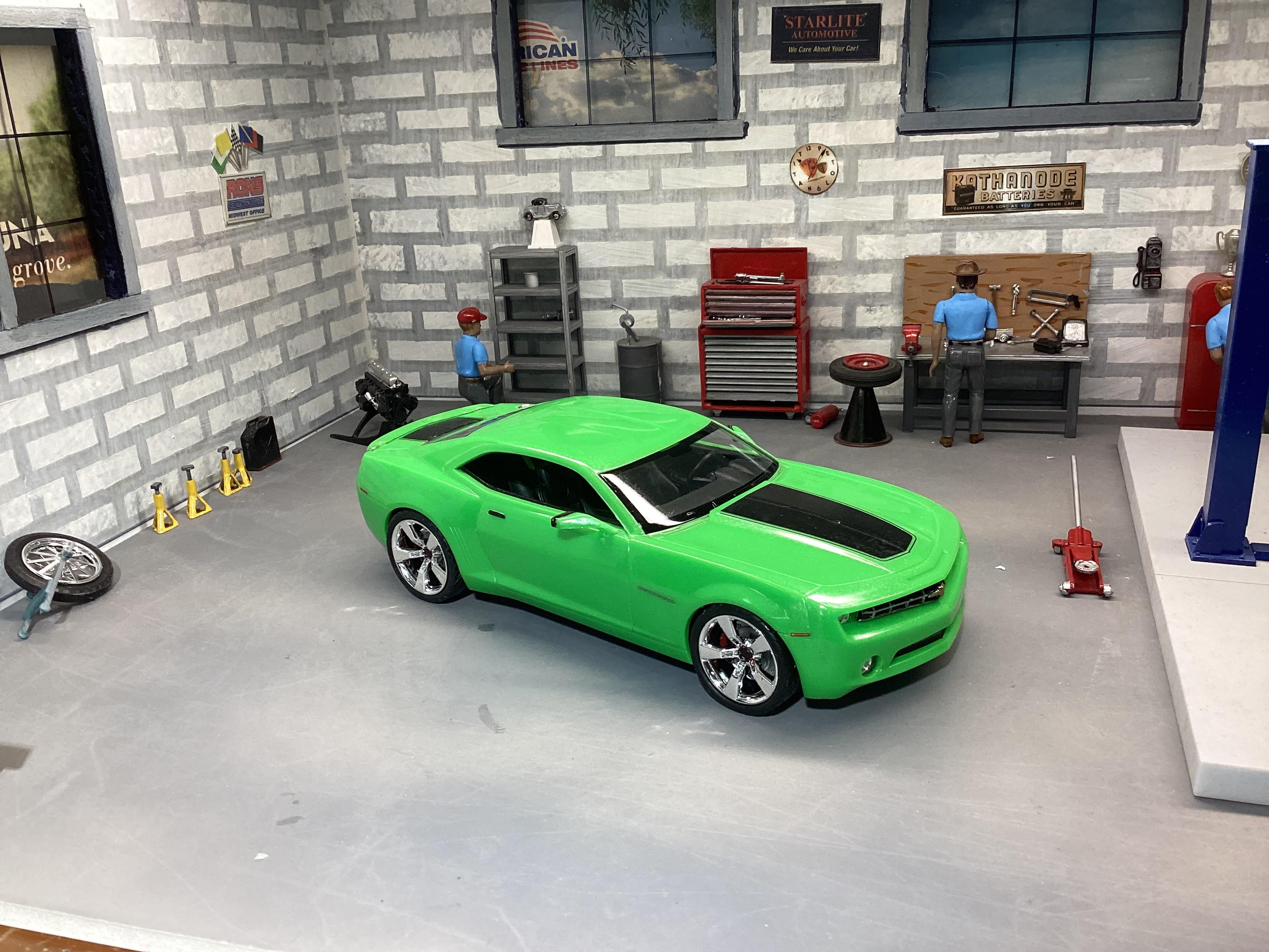

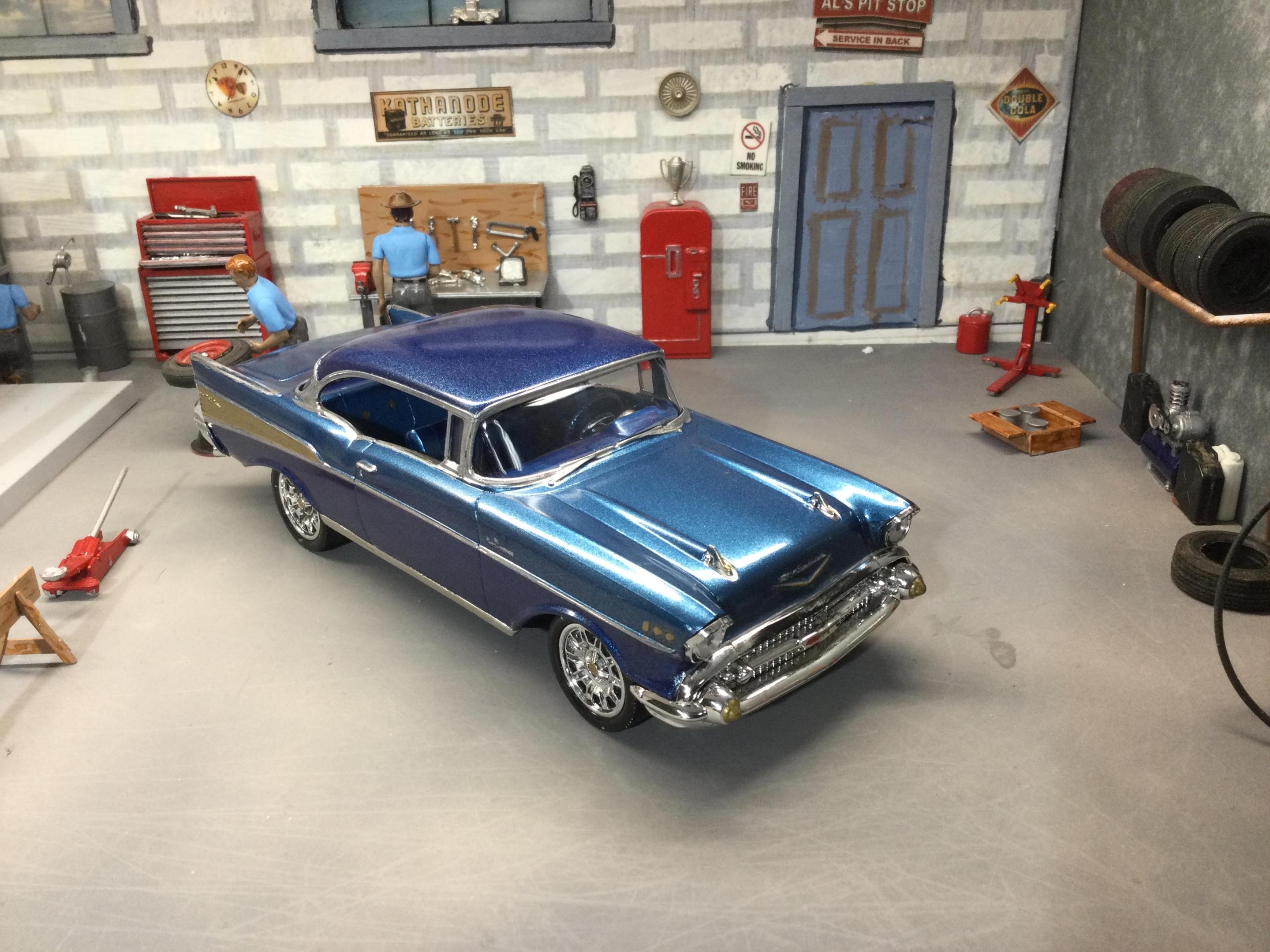

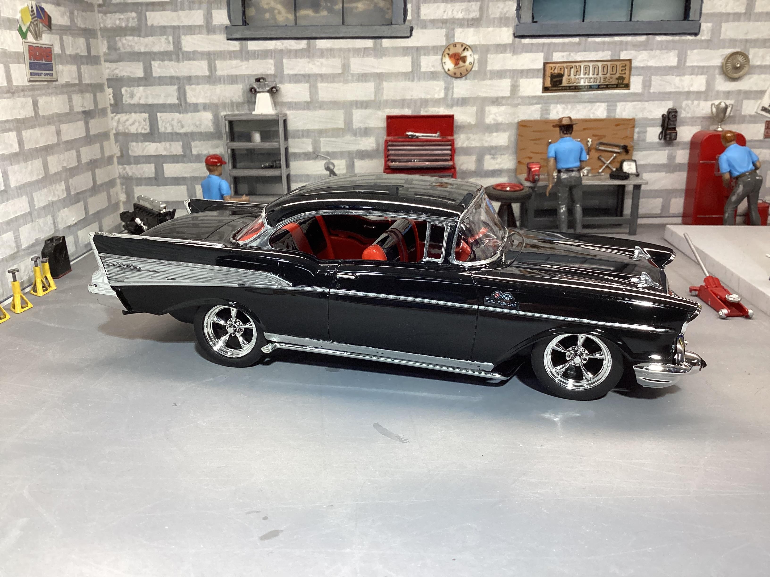

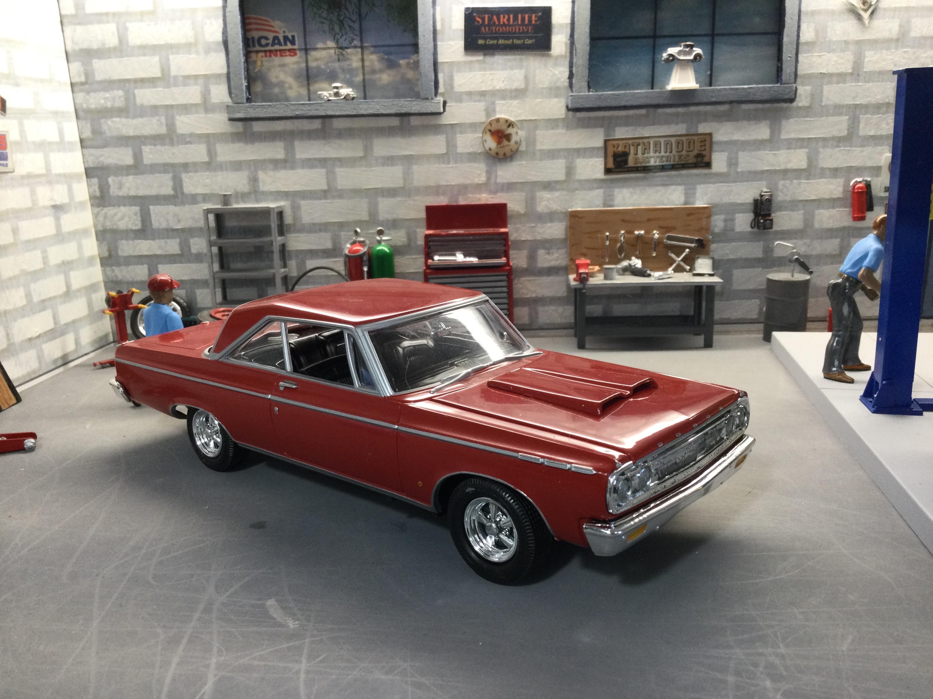

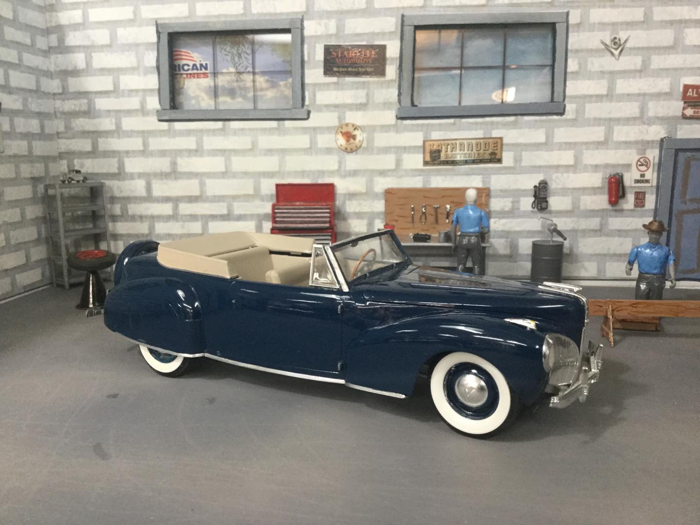

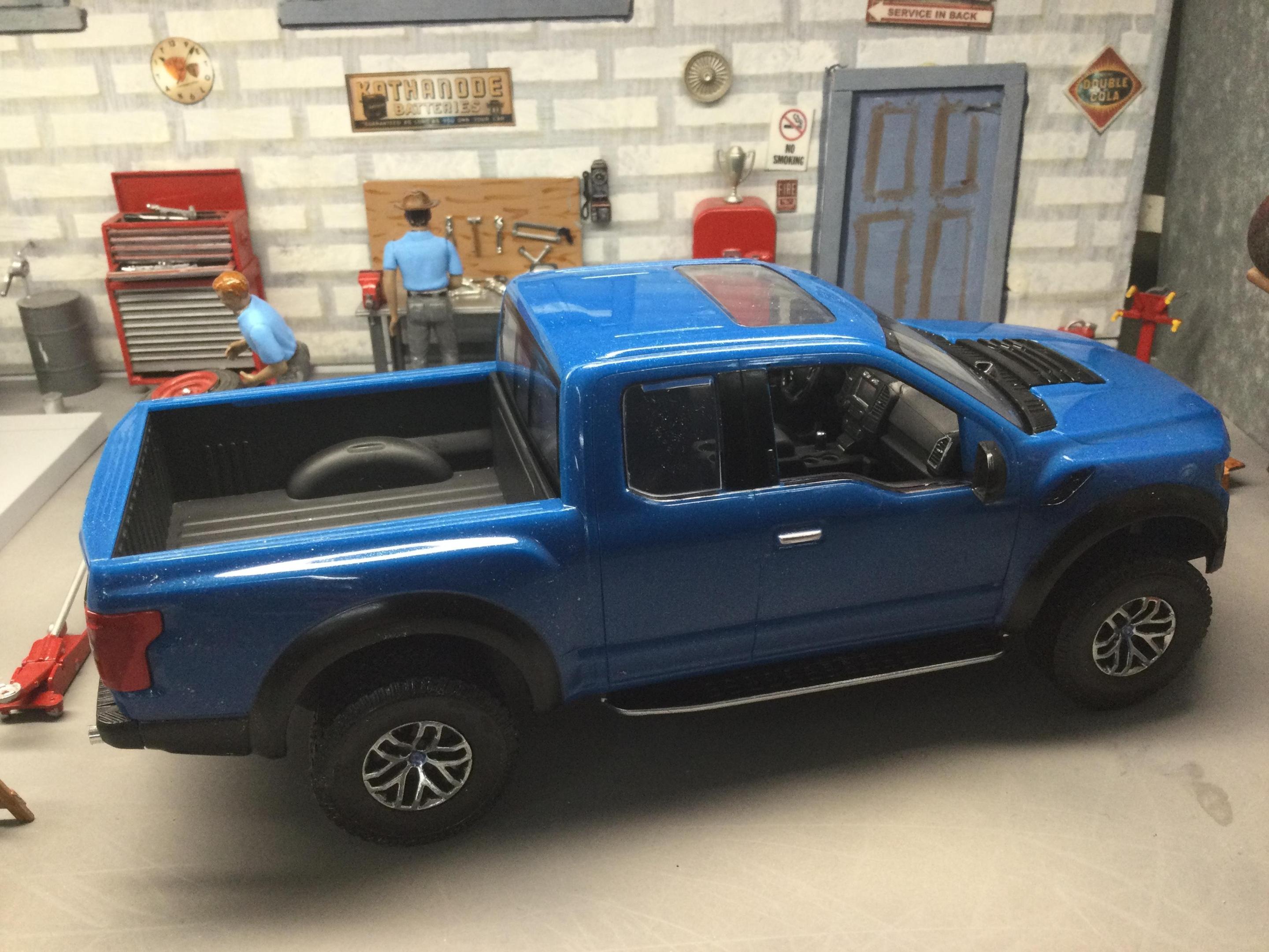

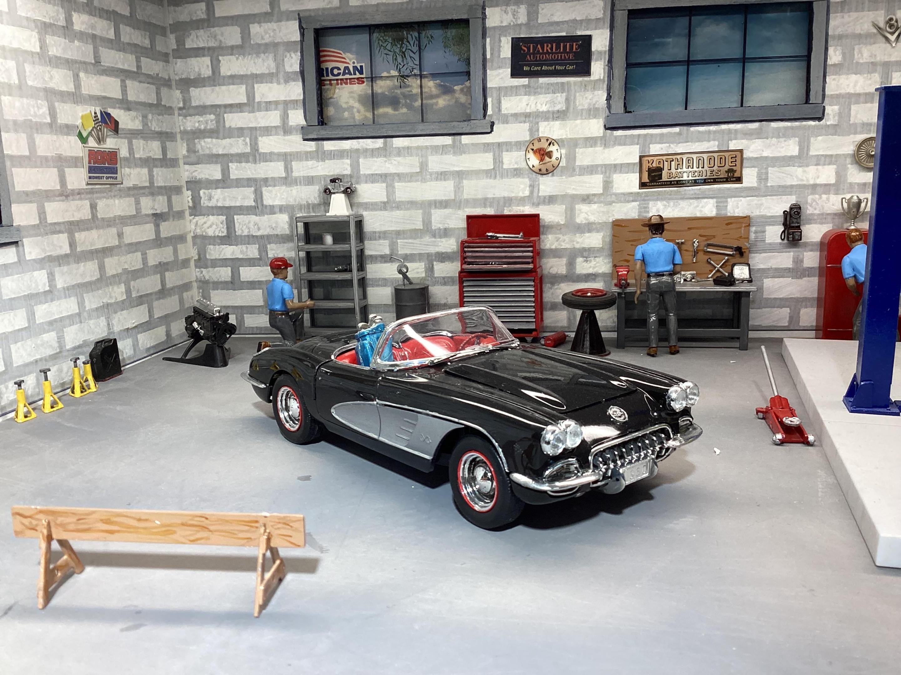

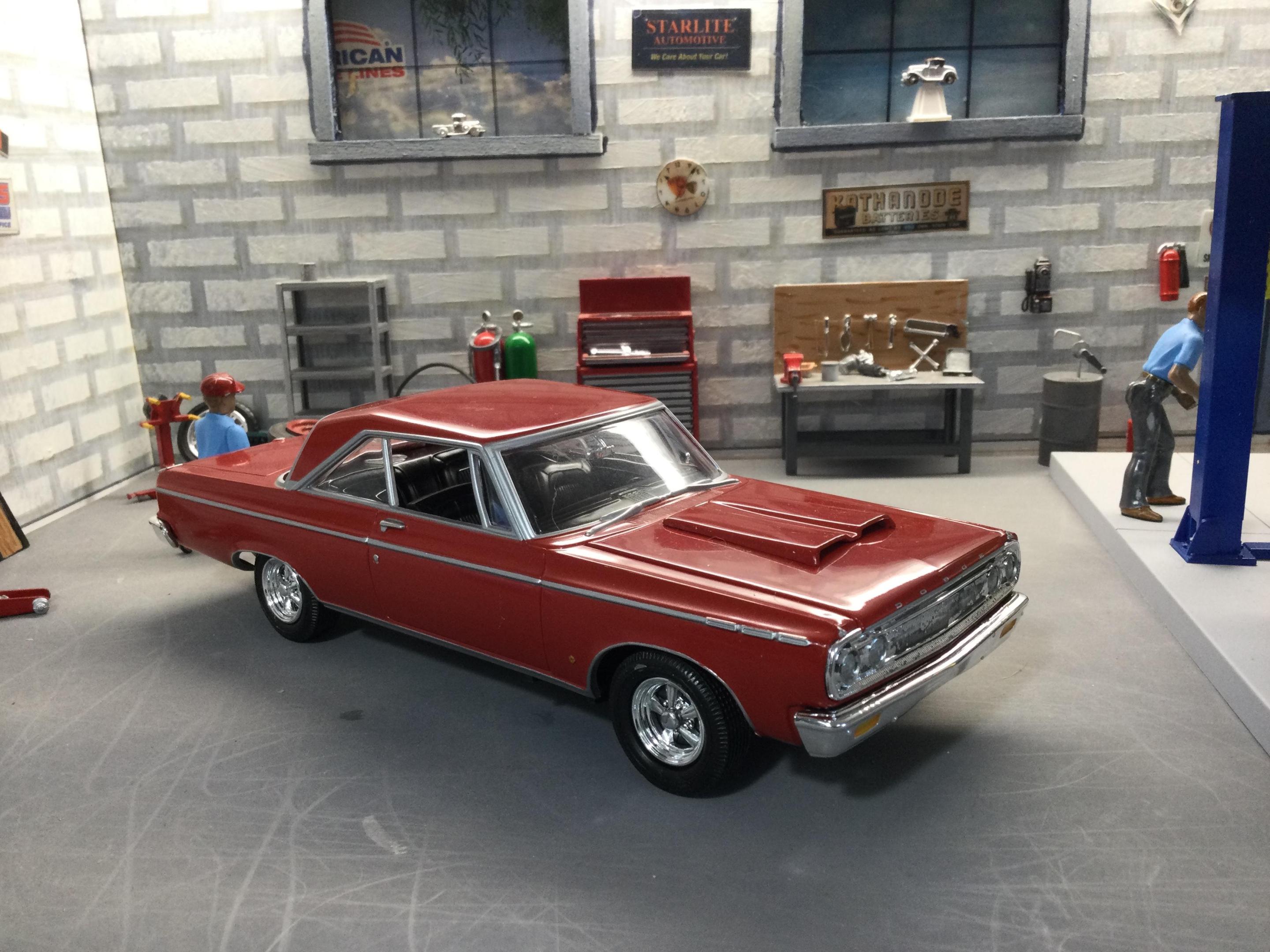

It says non yellowing on the label. And at 69. I'll never see them yellow lol. All done in the last 15 years.
1958 Plymouth Fury - Silver:white2.jpg
Edited by ewetwo
  • Like 3

I've mainly used it on colored plastics that have a nice finish but this makes them pop. And the 007 Cop Car was just a demo as that blue plastic is pretty bad. But it was the best candidate to show the before and after aspects. And my cars are in displays. It washes off if you need to. It doesn't work well on enamels as I've done that. Enamels air out for years as far as I see. I agree with you on the clear glass.
