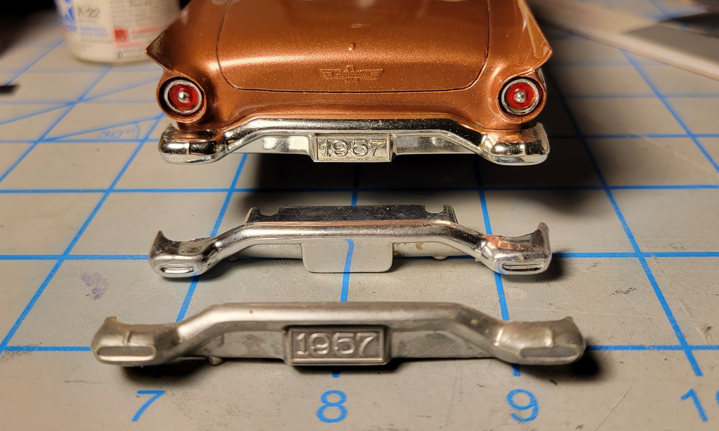

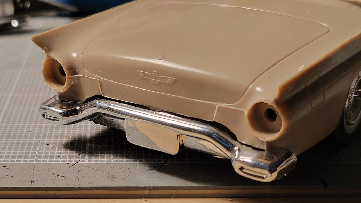

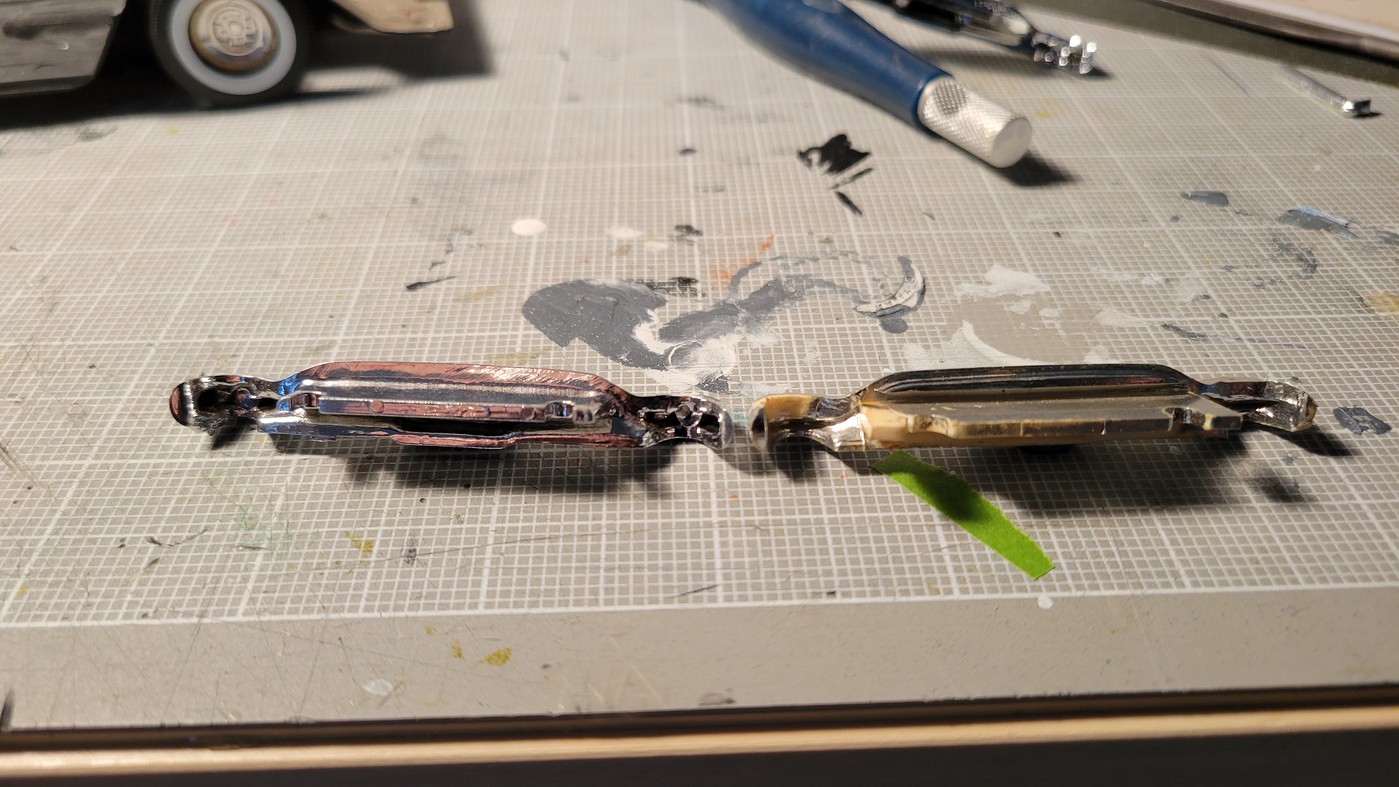

Dave Darby Posted December 31, 2023 Posted December 31, 2023 (edited) Looking good! All of the Ertl reissues (1989-up) have newly tooled clear parts. Another larger issue with the newer (1979 Vega$ and up) reissues is the relocated bumper mounting tabs to accommodate the Continental kit bumper extension. It sits the bumper around 3/32" too low on the body. One workaround around is to shorten the mounting posts on the body, then put spacers between the bumper mounts and the chassis to keep the body height correct. Unmodified below. Note gap. Post 1979 bumper on left. Older bumper on the right. Original issue bumper on car, current issue center, Craftsman version in foreground. You can see the fit is much better. Current bumper with modifications to fit. Your Bird is pretty cool. The mods are very tasteful. Stance is great. If that gap bothers you, the fix is easy. Edited December 31, 2023 by Dave Darby 2
