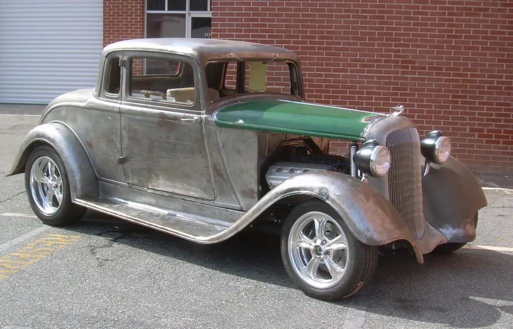

Ace-Garageguy Posted January 5, 2024 Posted January 5, 2024 (edited) 34 minutes ago, av405 said: Sorry, your tone is confusing me. Did I say something wrong? The whole point of my question is to learn. What's confusing? The "oh geez" is for the experts who say "paint the hood off". I think my answer is pretty easily comprehensible as to why you don't want to do that with pearls or metallics...as several other guys who understand have echoed. Those of us who paint real cars and have a clue would never dream of painting parts separately, unless the paint is a solid color. And even then, if the color is a base-clear, you can get a slight panel-to-panel mismatch. But then again, some people just don't even see it. EDIT: Some years back, the idiot know-it-all painter who shot a real-steel 354 Hemi-powered '33 Plymouth I built for a nationally known shop shot the HOK sunset orange with the fenders, hood, and doors separate..."but at the same time with the same batch." When it came back to me to build up, you could see across the parking lot that the panels were at least 3 different colors. This was a $250,000 build, and to say the owner was a little upset would be the understatement of the decade. It ended up costing the poor SOB who owned the car another 30 grand to get the paint right...as the clown who did it wrong wouldn't make it right himself, making up excuse after excuse after excuse. The car owner sued the bozo who made the mess, and collected absolutely nothing. Below is the car just before I'd completed the metalwork. The frame and engine in HOK sunset orange... Edited January 5, 2024 by Ace-Garageguy 2
av405 Posted January 5, 2024 Author Posted January 5, 2024 19 minutes ago, Ace-Garageguy said: What's confusing? The "oh geez" is for the experts who say "paint the hood off". I think my answer is pretty easily comprehensible as to why you don't want to do that with pearls or metallics...as several other guys who understand have echoed. Those of us who paint real cars and have a clue would never dream of painting parts separately, unless the paint is a solid color. And even then, if the color is a base-clear, you can get a slight panel-to-panel mismatch. But then again, some people just don't even see it. EDIT: Some years back, the idiot know-it-all painter who shot a real-steel 354 Hemi-powered '33 Plymouth I built for a nationally known shop shot the HOK sunset orange with the fenders, hood, and doors separate..."but at the same time with the same batch." When it came back to me to build up, you could see across the parking lot that the panels were at least 3 different colors. This was a $250,000 build, and to say the owner was a little upset would be the understatement of the decade. It ended up costing the poor SOB who owned the car another 30 grand to get the paint right...as the clown who did it wrong wouldn't make it right himself, making up excuse after excuse after excuse. The car owner sued the bozo who made the mess, and collected absolutely nothing. It wasn't clear if your "oh geez" and "but folks just never learn" was directed at me, at others, or who. Yes, that was confusing for me as the OP. Anyhow, thanks for clarifying and thank you for your information. 3
Bills72sj Posted January 6, 2024 Posted January 6, 2024 3 hours ago, Ace-Garageguy said: EDIT: Some years back, the idiot know-it-all painter who shot a real-steel 354 Hemi-powered '33 Plymouth I built for a nationally known shop shot the HOK sunset orange with the fenders, hood, and doors separate..."but at the same time with the same batch." When it came back to me to build up, you could see across the parking lot that the panels were at least 3 different colors. This was a $250,000 build, and to say the owner was a little upset would be the understatement of the decade. It ended up costing the poor SOB who owned the car another 30 grand to get the paint right...as the clown who did it wrong wouldn't make it right himself, making up excuse after excuse after excuse. The car owner sued the bozo who made the mess, and collected absolutely nothing. Below is the car just before I'd completed the metalwork. Thanks for sharing. My Dad used to drag race a 33 Plymouth Coupe with a 331 Hemi in the mid 60's. At one point he had 8! 2BBLs on it. If he saw that there was no one in a certain, Blown, class, he would run a flex hose from the heater blower into one of the carbs just to win a trophy. 1
