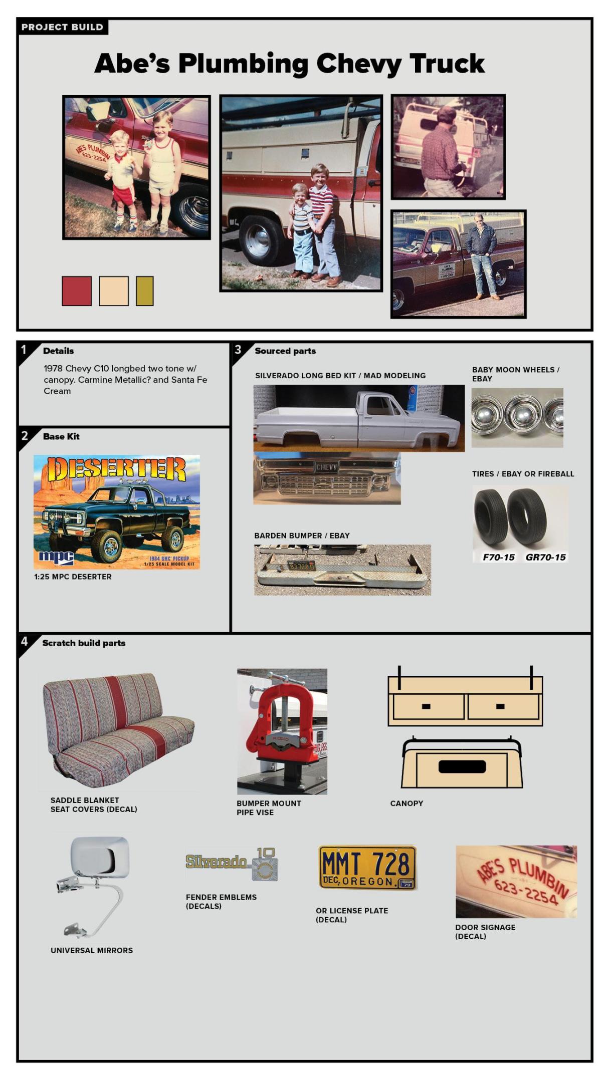

Vince311 Posted January 14, 2024 Posted January 14, 2024 (edited) Not sure starting another project, with four stalled projects on the bench, is a good idea. But... planning them is my favorite part. This build is a tribute to my dad's Plumbing truck, from the early 80s. I hope to get this started this year. It's got a few unique elements to it that should be a challenge. Here is my build sheet thus far. EDIT: updated build sheet with new plan of attack. 1/23/24 Edited January 24, 2024 by Vince311 revised build plan 6
mikemodeler Posted January 14, 2024 Posted January 14, 2024 Nice tribute and looks like you are on your way to getting it done. Just a note on that donor kit- it is 4wd and has the different front end (81-87 model years). Check with Kris Morgan at Morgan Auto Detail, he has resin 78 Chevy longbed kit that also includes the bench seat. Has the side trim molded in and the grille. You will need a donor chassis and the Deserter kit can be elongated or you can buy a long bed frame from Texas 3D Customs. You will still need to fabricate a front suspension and depending on how accurate you want it to be, there might be some 3D printed options. 1
Can-Con Posted January 14, 2024 Posted January 14, 2024 Yea, what Mike said. , ,PLUS , , That e-bay grille is from a 1'24 Monogram kit. It won't fit the MPC pickup. Wrong scale and wrong front fenders and hood for it. It's be easier to just get the Revell/Monogram 1/24 scale kit to start with.
Vince311 Posted January 14, 2024 Author Posted January 14, 2024 (edited) 2 hours ago, mikemodeler said: Nice tribute and looks like you are on your way to getting it done. Just a note on that donor kit- it is 4wd and has the different front end (81-87 model years). Check with Kris Morgan at Morgan Auto Detail, he has resin 78 Chevy longbed kit that also includes the bench seat. Has the side trim molded in and the grille. You will need a donor chassis and the Deserter kit can be elongated or you can buy a long bed frame from Texas 3D Customs. You will still need to fabricate a front suspension and depending on how accurate you want it to be, there might be some 3D printed options. @mikemodeler @Can-Con thanks for the review! Yes, aware of the conversion from 4wd to 2wd. I've seen at least one 3D kit that facilitates this. Somewhere I read about a guy using a NASCAR chassis as well. ?? The long bed conversion seems to be the real challenge. The Mad Modeling (Morgan Auto Detail) bed is designed for a 1:25 kit. Thus the Deserter kit. I originally wanted to use the GMC snow plow or Big Game truck, as those have the proper front clip. But alas, both are 1:24...and won't work with the MAD bed. hmmm. Then there is this route. Edited January 14, 2024 by Vince311
leafsprings Posted January 14, 2024 Posted January 14, 2024 1 hour ago, Vince311 said: Then there is this route. Bingo! IMO, that is the best way to go, much less headaches than the alternatives. 1
mikemodeler Posted January 14, 2024 Posted January 14, 2024 I would contact Kris at MAD, here are pictures of his 78 Chevy Pickup resin kit, mastered by Tom Ellifritt. You get the side trim, bench seat, correct grille and bumper, filler panel below the grille and a cab and bed that look like kit pieces, not clunky resin casting. I bought one from him and IIRC it was $70 plus shipping. It might be more but the Deserter kit will get you the tail lights, rear bumper, glass, drive train. You will either have to extend the kit frame or find one and of course the front 2wd suspension. This kit is NOT on his website, so email him or contact him here on the forum. 1
Vince311 Posted January 14, 2024 Author Posted January 14, 2024 9 minutes ago, mikemodeler said: I would contact Kris at MAD, here are pictures of his 78 Chevy Pickup resin kit, mastered by Tom Ellifritt. You get the side trim, bench seat, correct grille and bumper, filler panel below the grille and a cab and bed that look like kit pieces, not clunky resin casting. I bought one from him and IIRC it was $70 plus shipping. It might be more but the Deserter kit will get you the tail lights, rear bumper, glass, drive train. You will either have to extend the kit frame or find one and of course the front 2wd suspension. This kit is NOT on his website, so email him or contact him here on the forum. whoa buddy! indeed...that is sweet! I'll reach out to him. cheers! 2

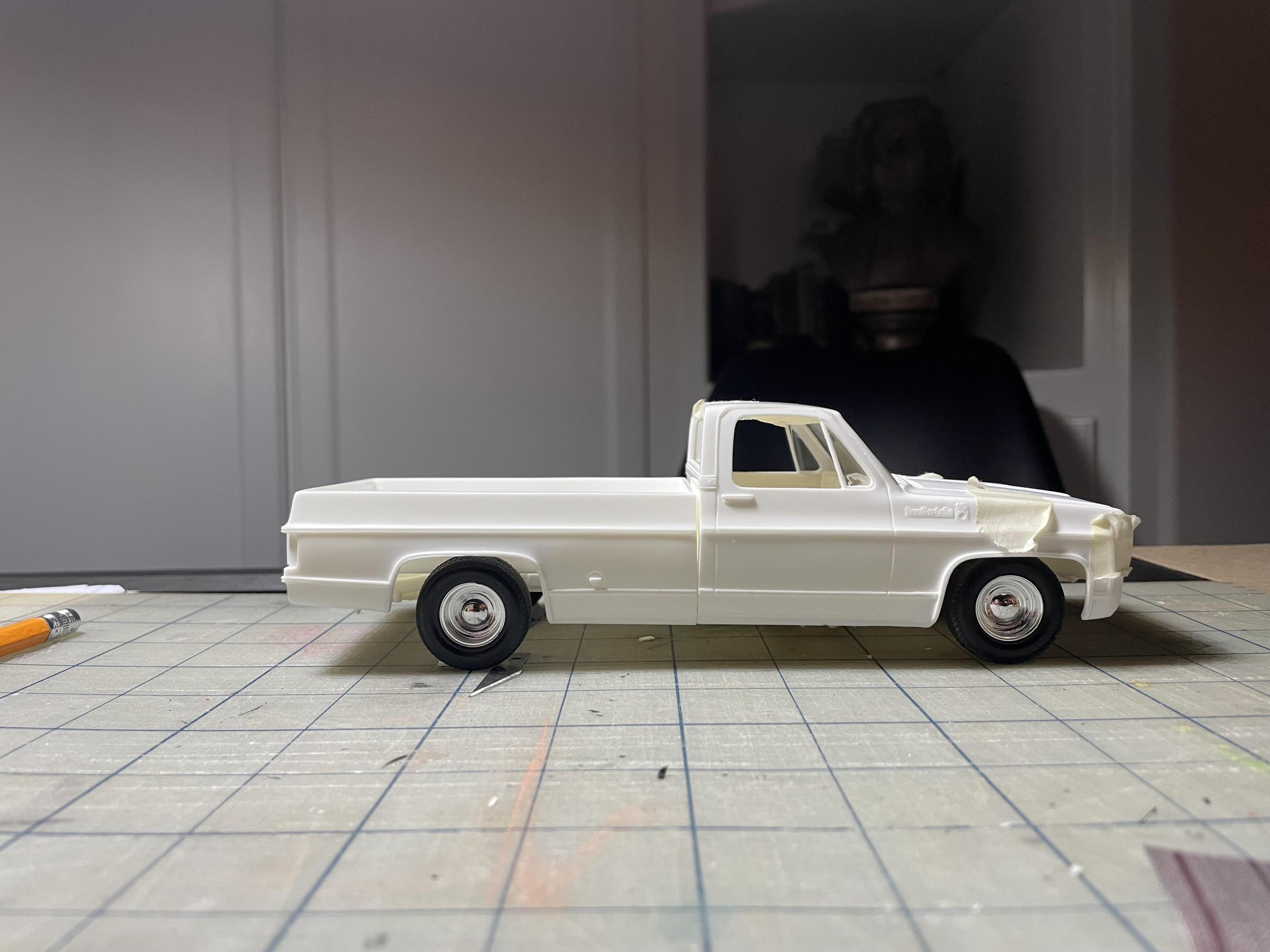

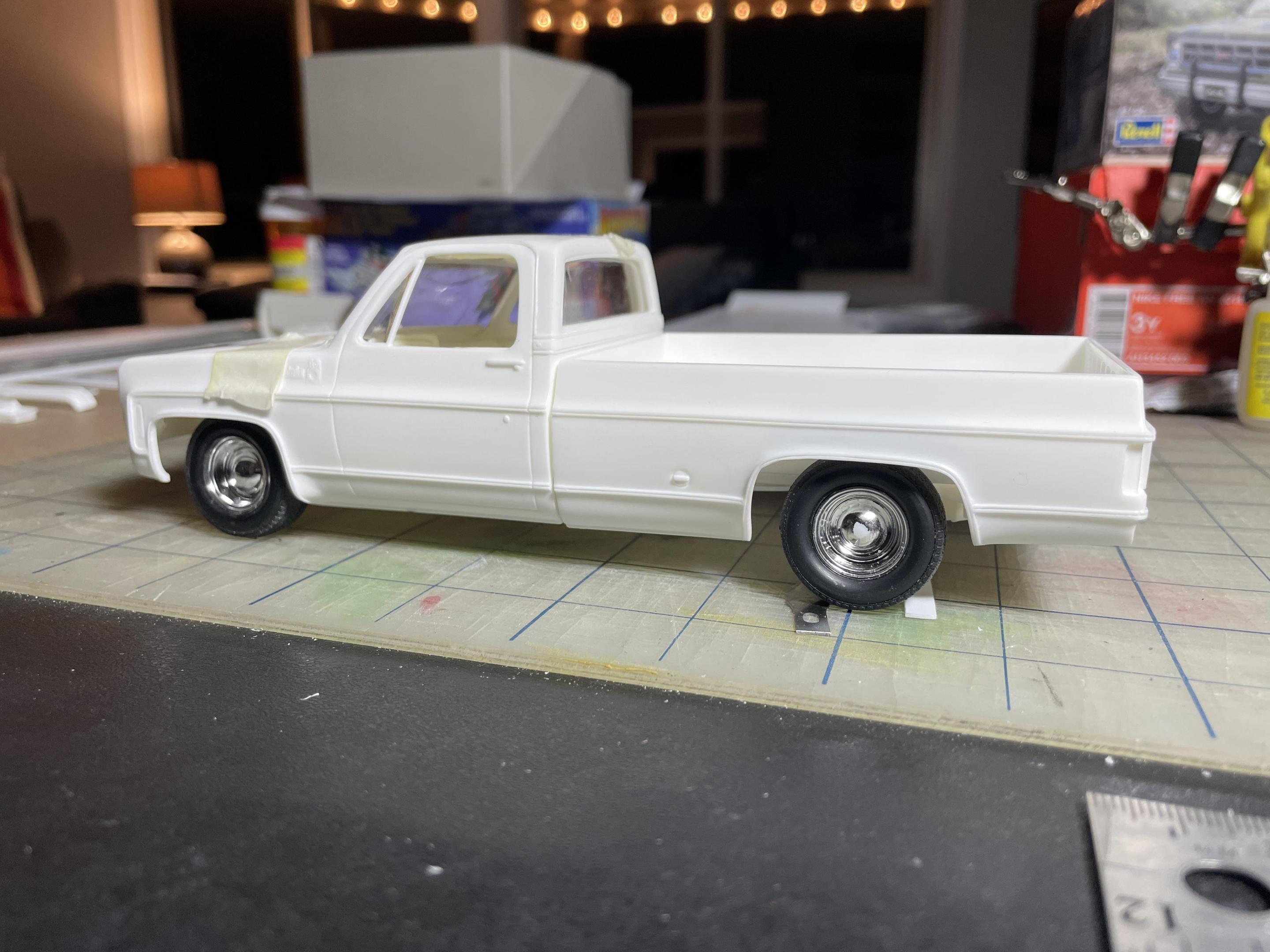

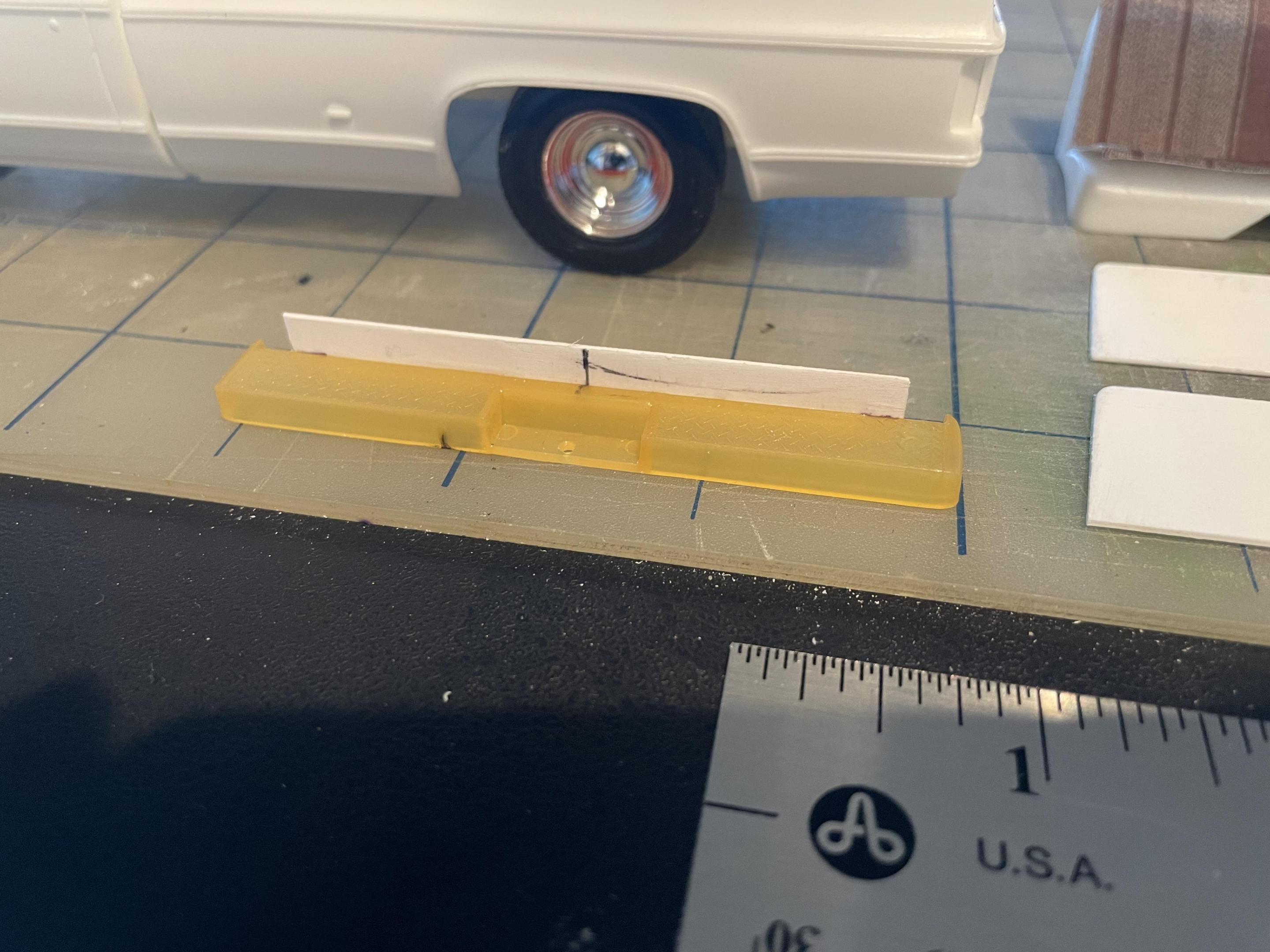

Vince311 Posted January 23 Author Posted January 23 Had a chance to get this bad boy rolling again. Extended the frame to accommodate the long bed. It’s not pretty, but should work. Fussing with ride height. door signage, license plates and seat decals designed. Got a friend doing a 3D print on the bumper mounted pipe clamp. Started getting the canopy laid out with various styrene panels. Bumper is being modded to resemble 1:1. ISO: needing to source the trailer/hauling mirrors. 92 f150 kit appears to have the closest. 5
bandit1 Posted January 27 Posted January 27 This is cool, Im wondering what are you using for the suspension on it? (Obviously the 2wd suspension is HOLY GRAIL status) 1
Vince311 Posted January 27 Author Posted January 27 44 minutes ago, bandit1 said: This is cool, Im wondering what are you using for the suspension on it? (Obviously the 2wd suspension is HOLY GRAIL status) Thanks! In all honesty, I wasn’t quite sure how this was gonna work out with the 2wd conversion. I understand that there are aftermarket drop kits available.I’m also not super concerned with accuracy as far as the suspension goes. I’m using a 60s Chevy pickup front suspension, with a bit of blocking to get ride height. For the rear, I have the axle sitting on the frame, which has been shimmed for ride height. I’ll try to get some pics up soon.

Vince311 Posted February 4 Author Posted February 4 Working on the scratch built canopy. Wondering if anyone might have an extra utility bed from the Mobius Ford utility kits? The box latches are perfect.
Vince311 Posted February 4 Author Posted February 4 51 minutes ago, GLMFAA1 said: here is easier slam lock solution: greg whoa! and there they are. much easier. thank you!
Mattilacken Posted February 5 Posted February 5 There is also this 3d file for 1:1, easy to make it thicker and print it. Locking paddle handle slam latch | 3D CAD Model Library | GrabCAD 1
