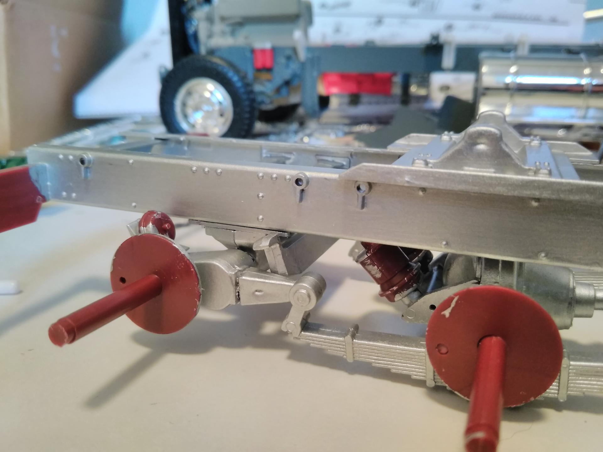

If you get a Scania 3 axle kit with spring suspension where the rearmost one is a tag axle wich you can lift hydraulically I can tell you right now that the Italeri instructions for that suspension is wrong.
Scania with spring suspension with a drive axle and a tag axle uses a balance beam suspension with a fixed pivot point between the 2 axles (and Volvo too with a slightly different construction) this suspension is like a teeter-totter, push one side down the other goes up.
This is how Italeri wants us to do it wich is wrong, the arrow points at the axle lift beam and the hooks are under the spring hangers/tag axle carriers like it's drawn in the instructions.
This will in fact do nothing other than restrict the suspension travel so it can't move freely like it can with the tag axle down and the lift beam in the correct position, and if the hydraulic cylinder piston aft of the tag axle goes out the lift beam will do absolutely nothing as it's going down because the pivot point of the tag axle lift is at the same place as the tag axle carriers...so it's drawn backwards.
The correct way is like this with the hooks above the spring hangers/tag axle carriers, the axle lift beam is up against the frame when it's not in use so the suspension can travel freely, and when you lift the tag axle the beam pushes against the spring hangers/tag axle carriers and pushes the drive axle down and the tag axle goes up...like a teeter-totter.

Haha, I see what you mean here on incorrect build instructions.

First time that i know of that some pic's of one of my models is used to help someone. I feel kind of honoured for that. These 2 pic's are from my T142 i built some years ago.

It was the only one I found to illustrate the issue clearly, I didn't know it was yours.
