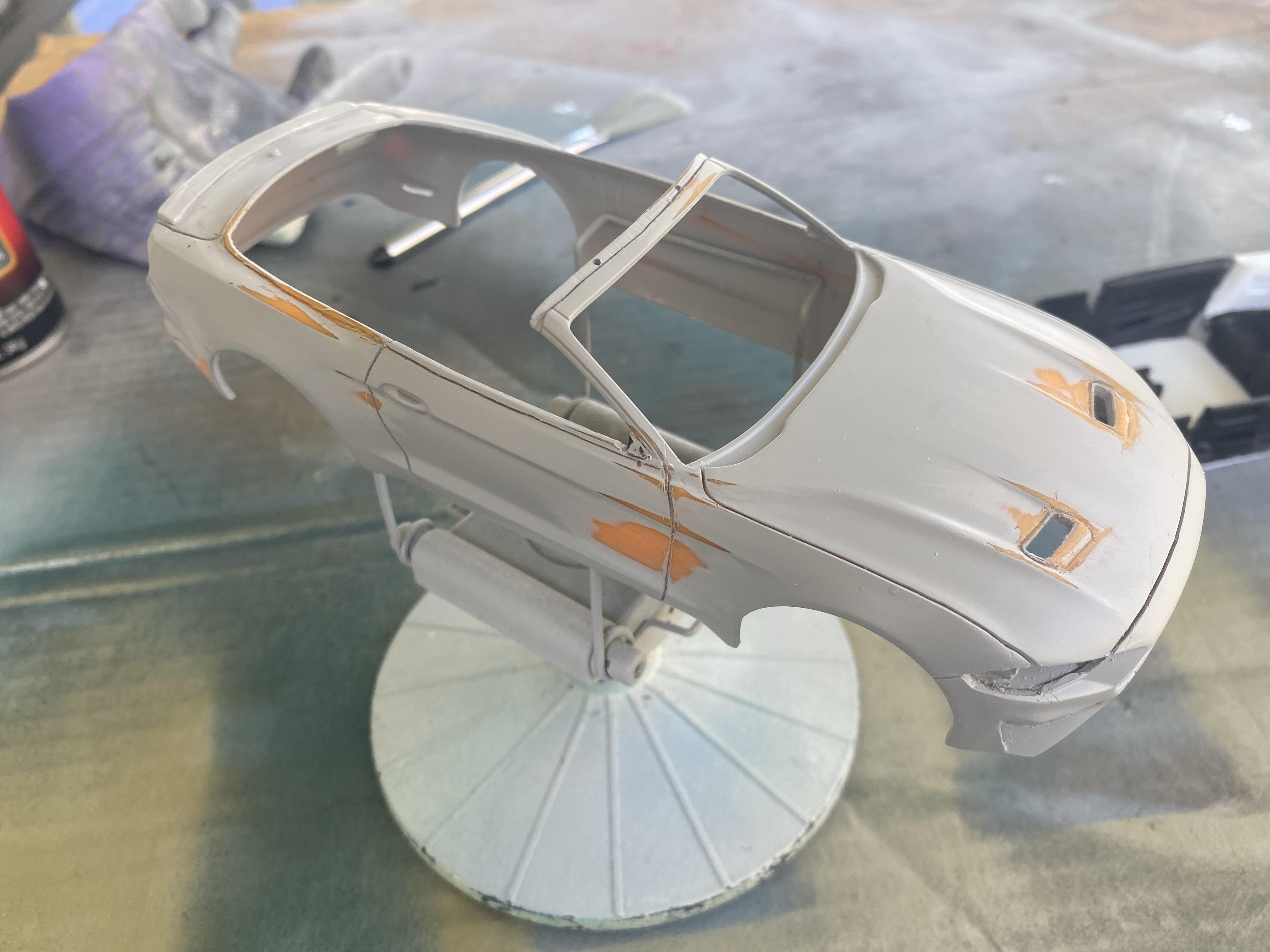

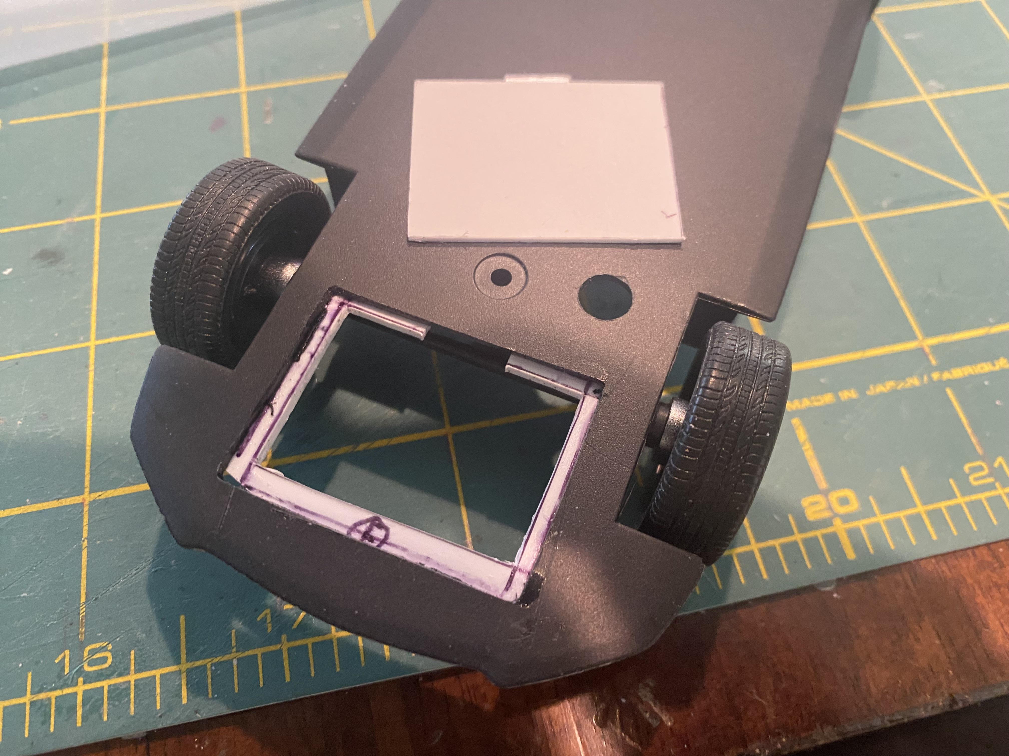

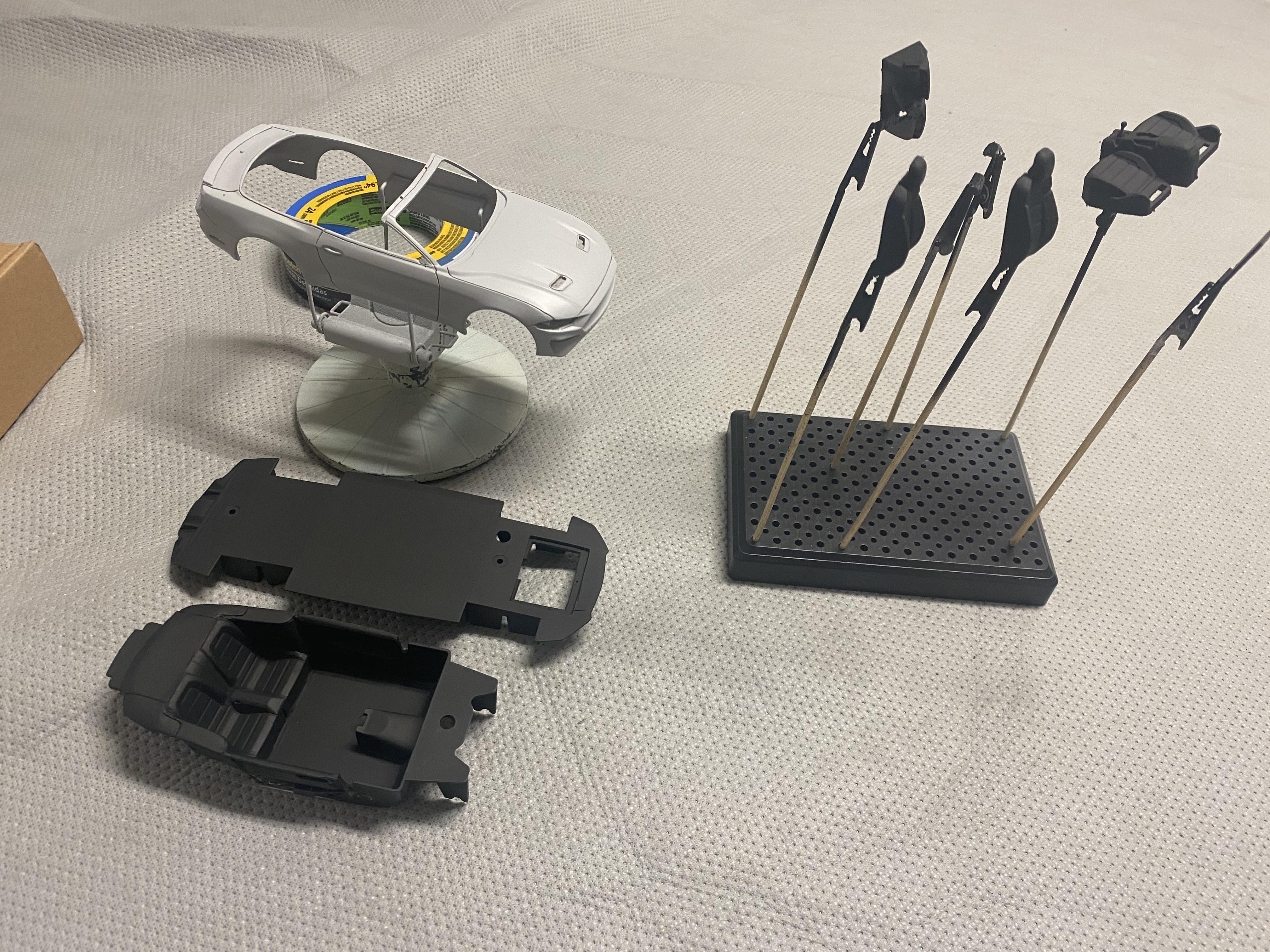

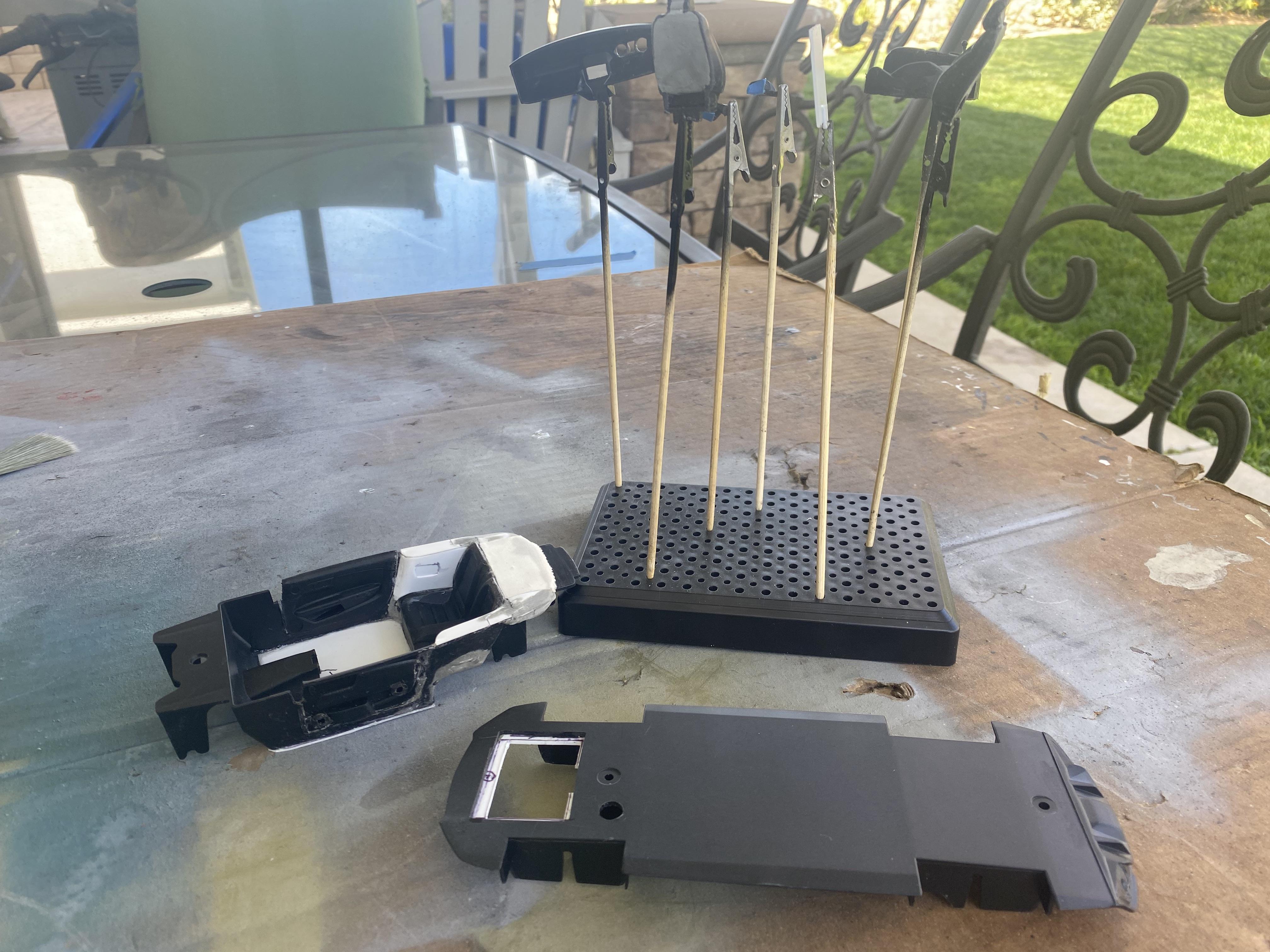

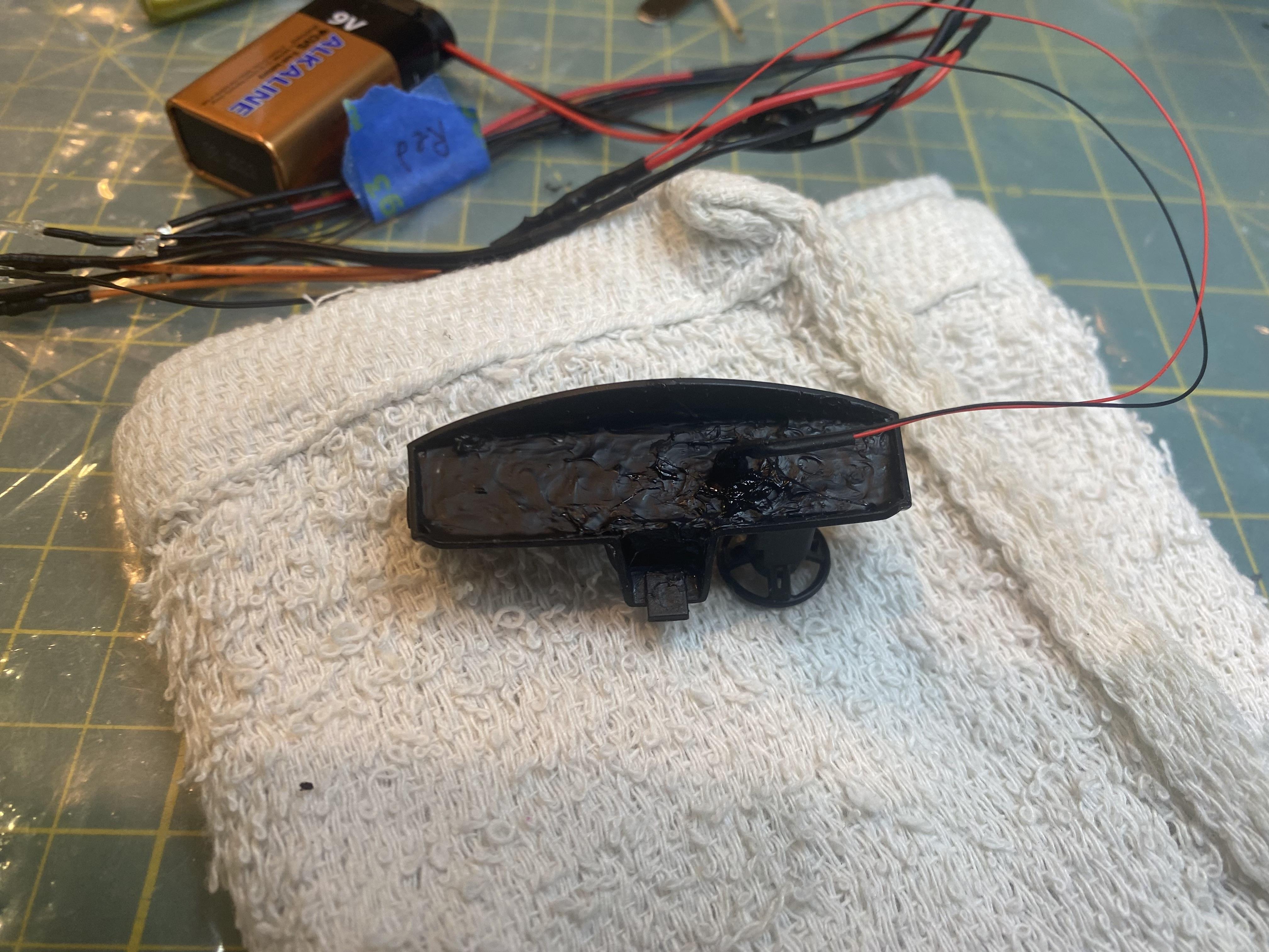

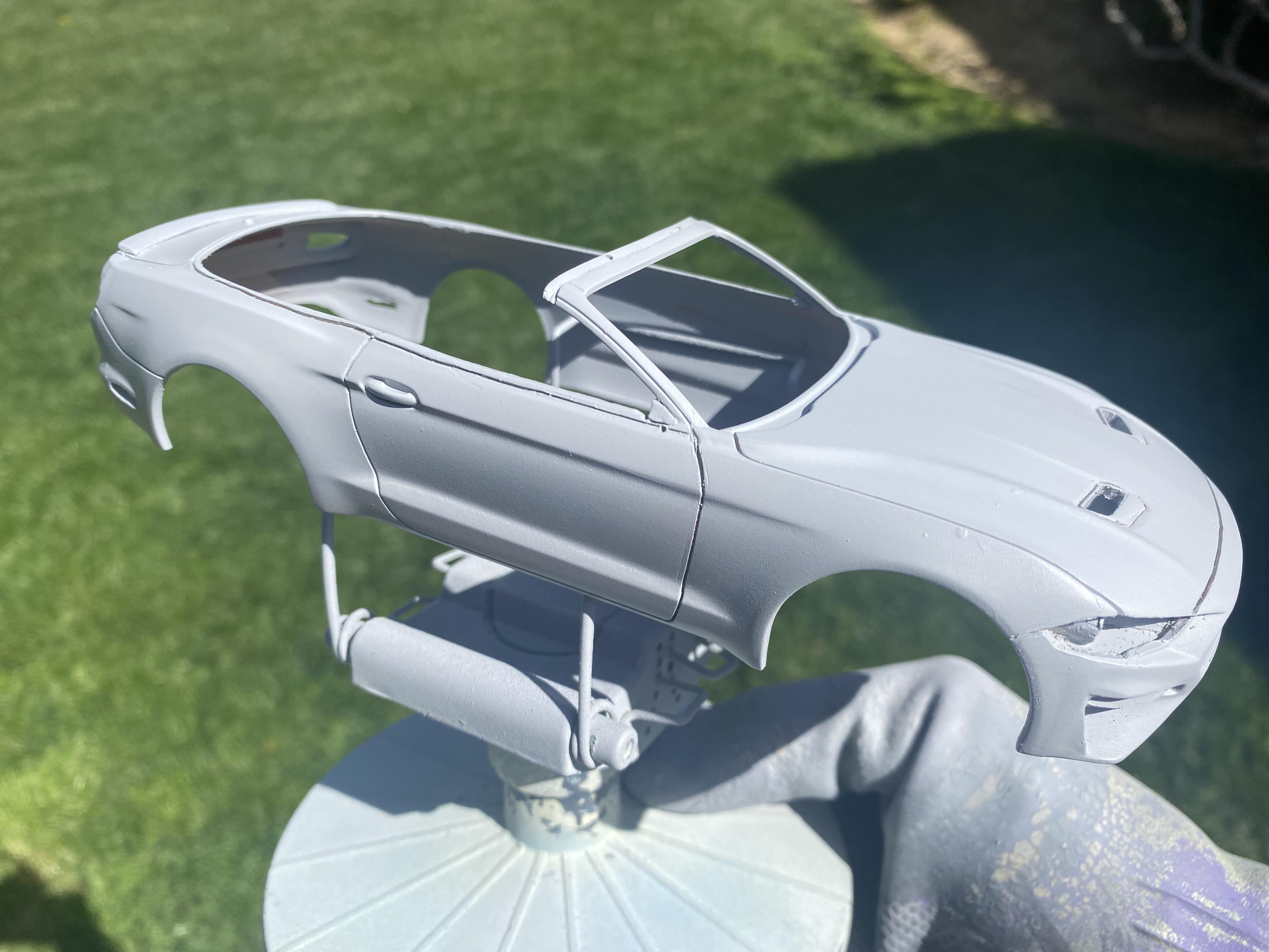

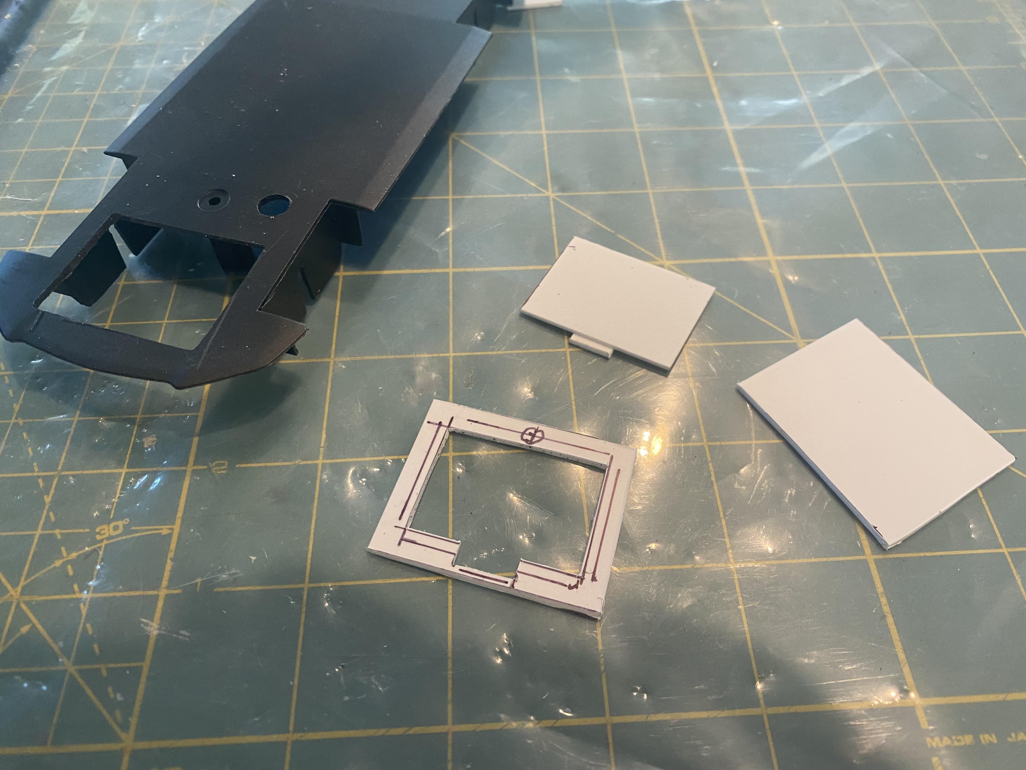

I am still getting over Covid but got a little done today. I created the Battery box for the LEDs and got many of the components in primer. Since they will be black most are in black primer. Second priming on the body after fixing many blemishes but I am still not quite happy with the body yet.

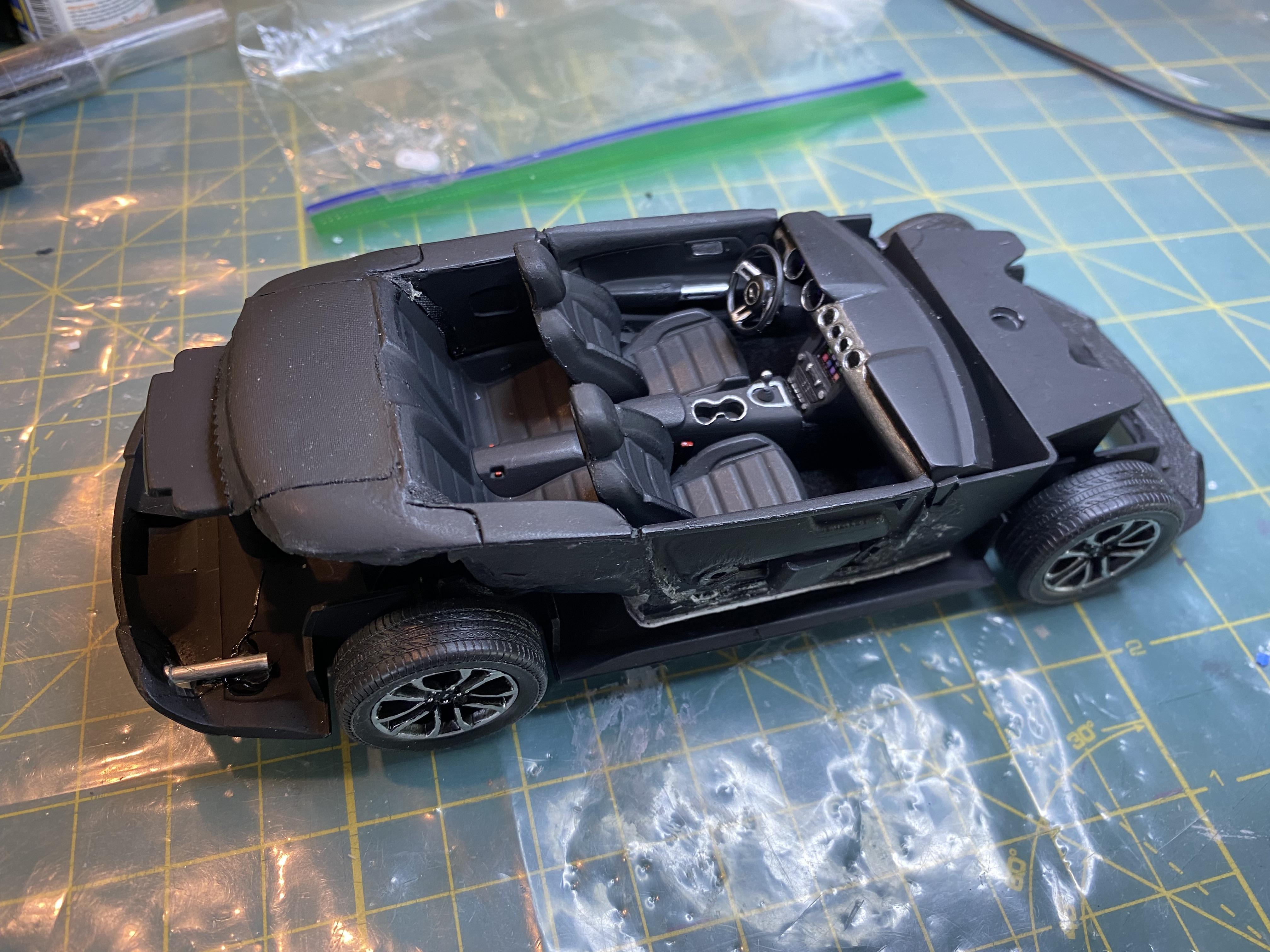

Created the LED wiring harness. That pretty much finishes up the fabrication phase, next on to paint.

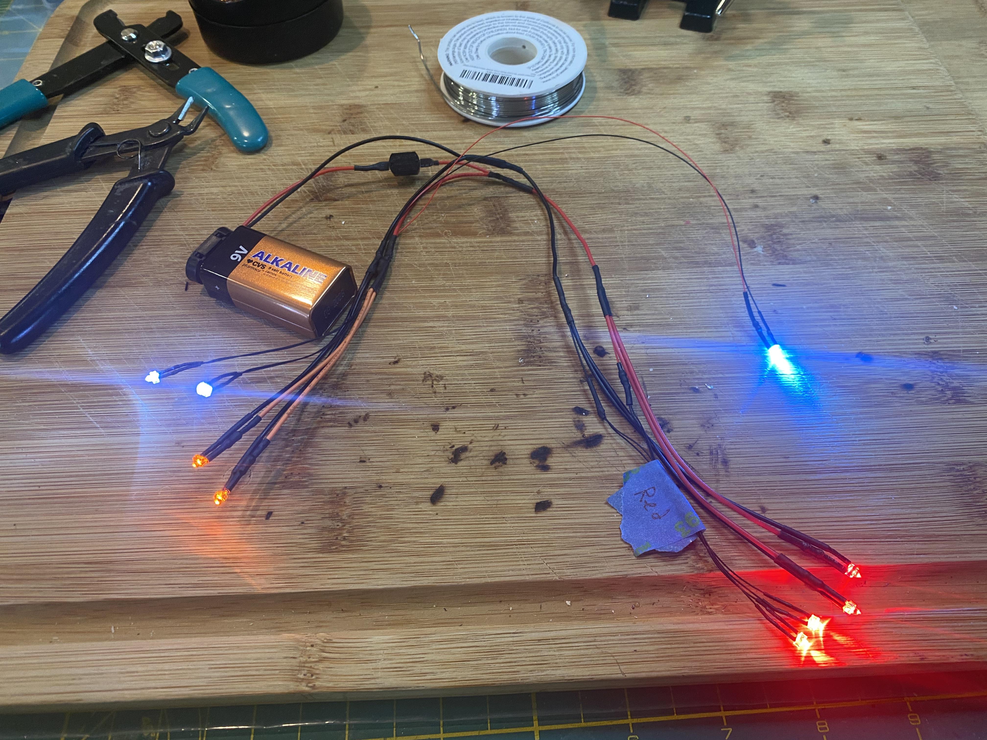

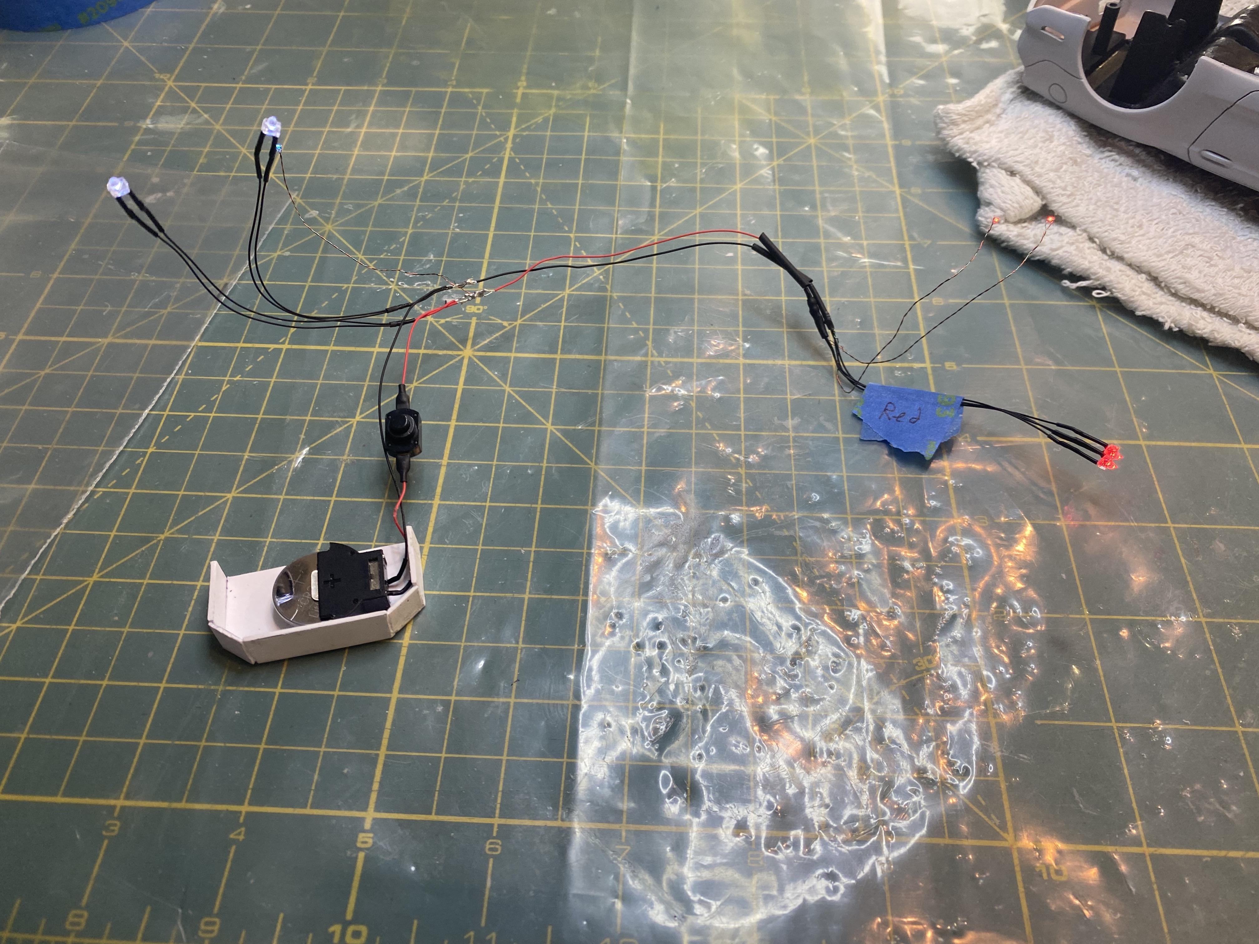

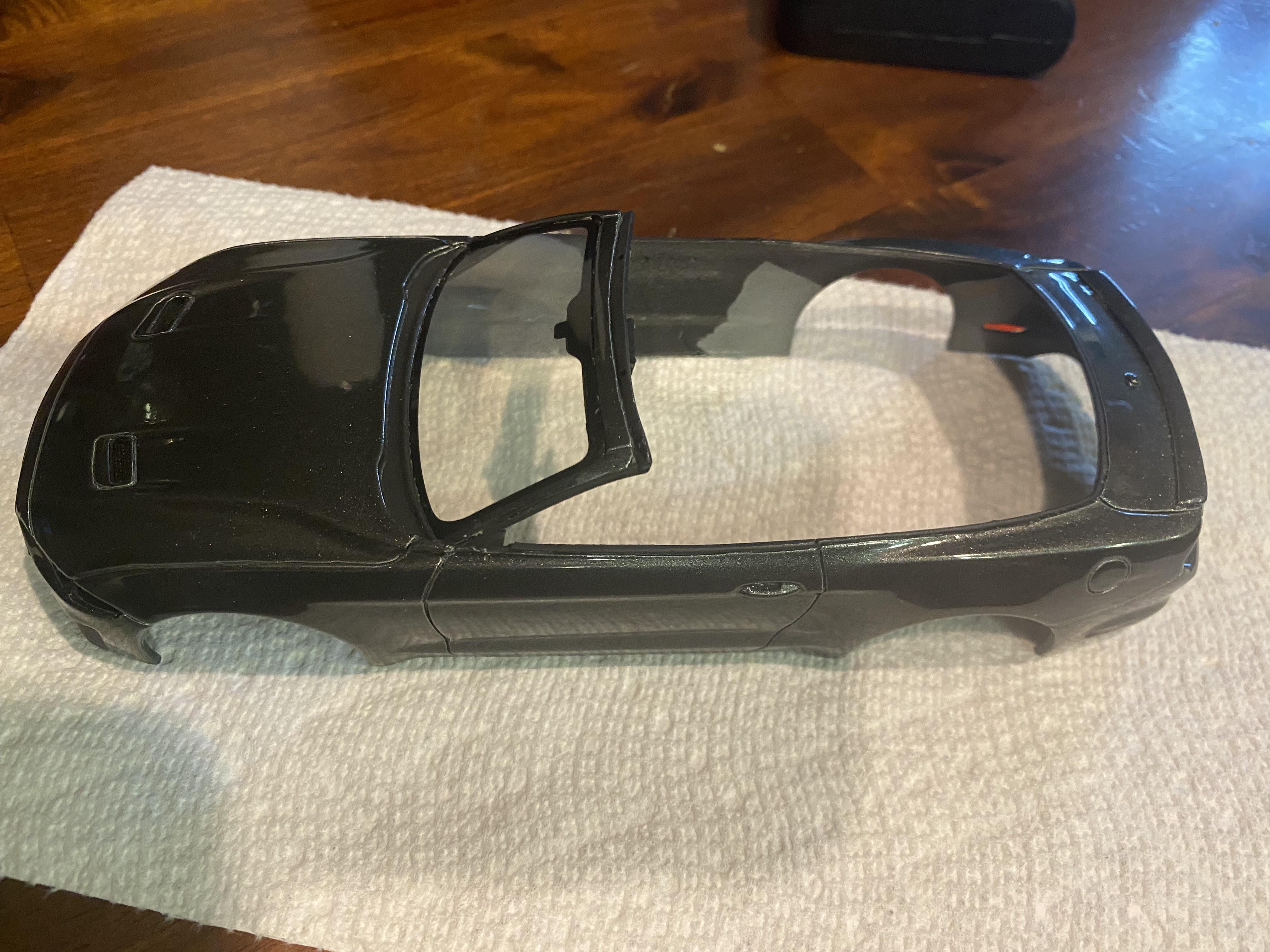

Still getting over Covid but got a little work done this weekend.

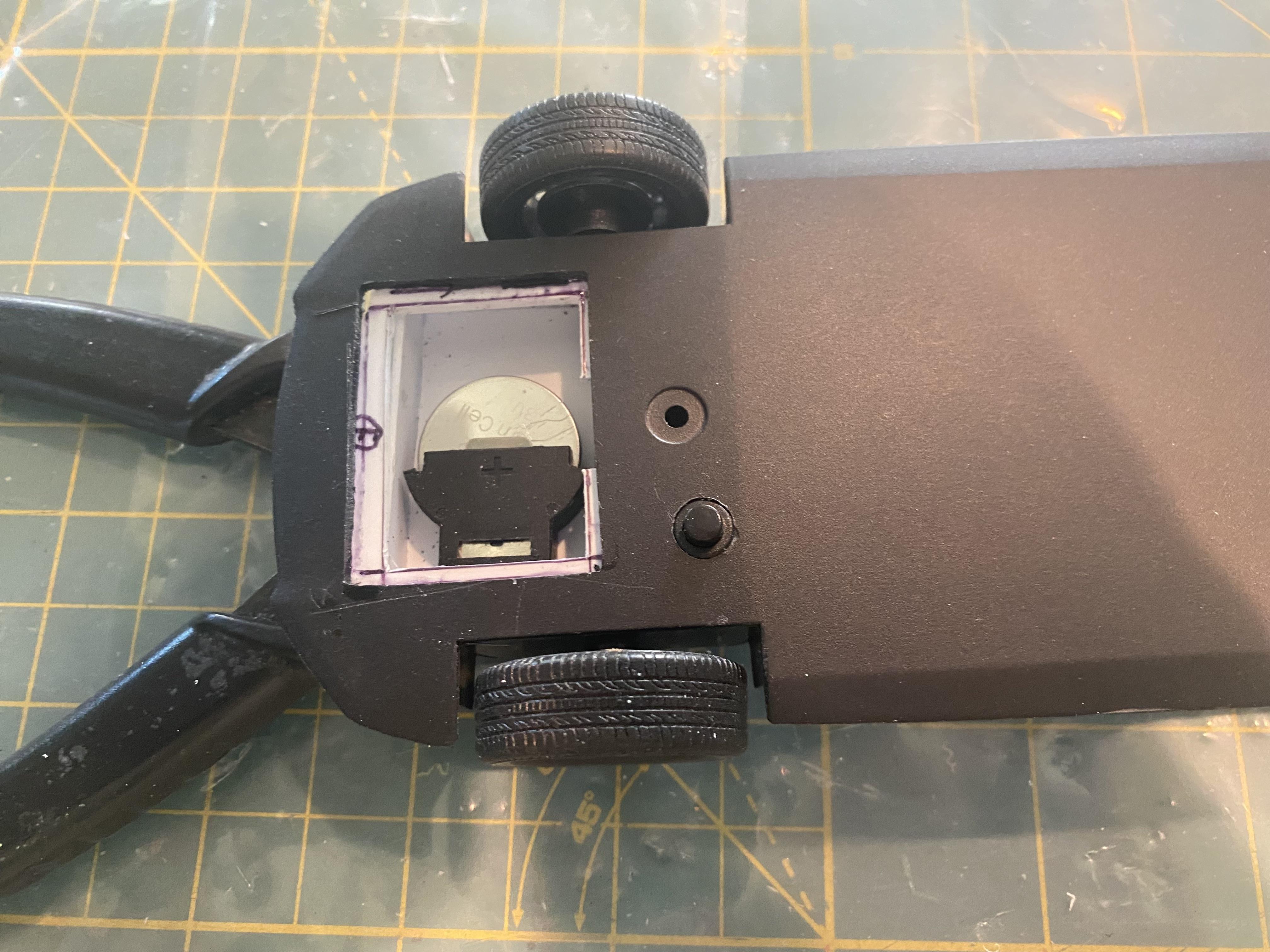

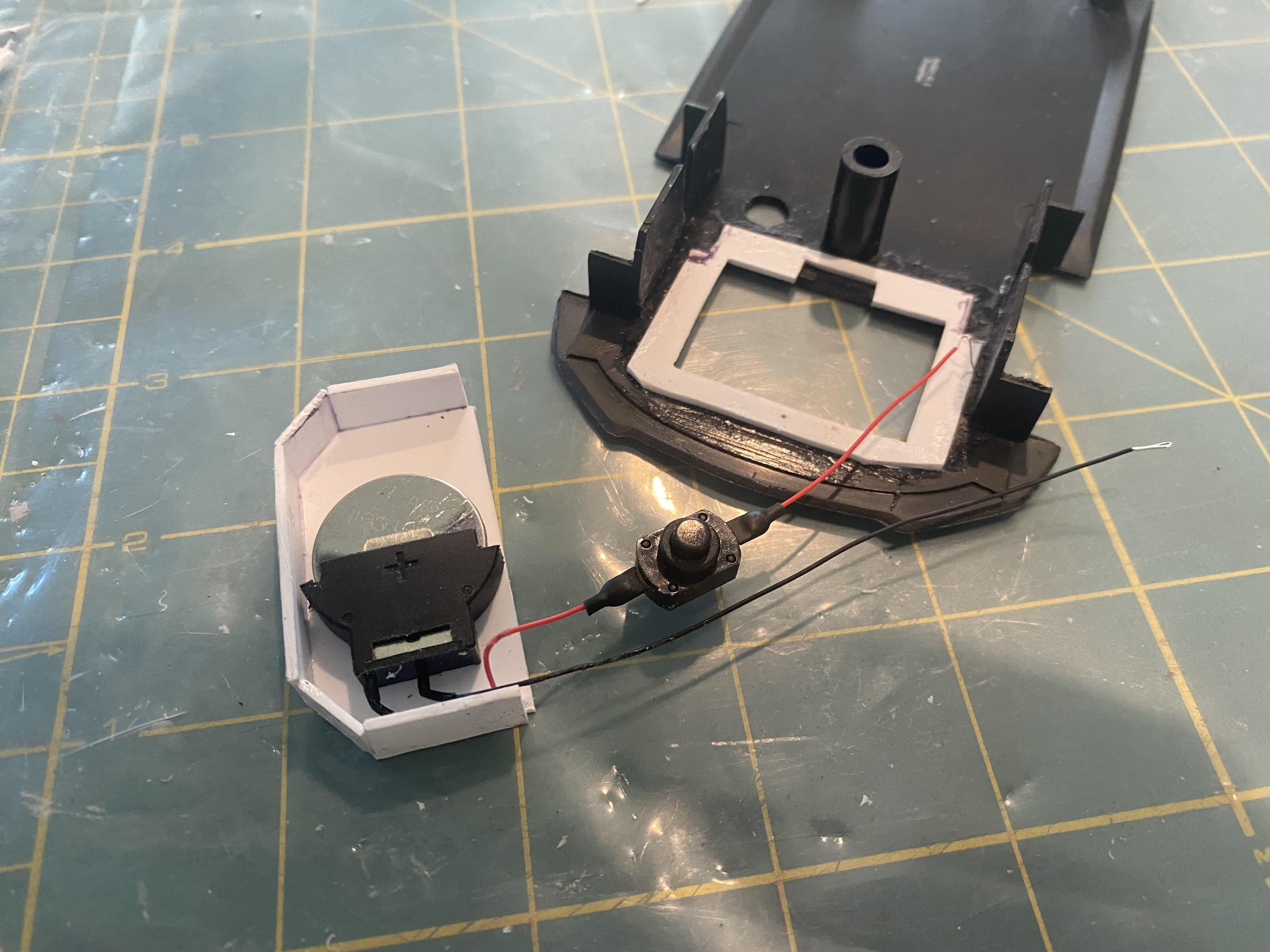

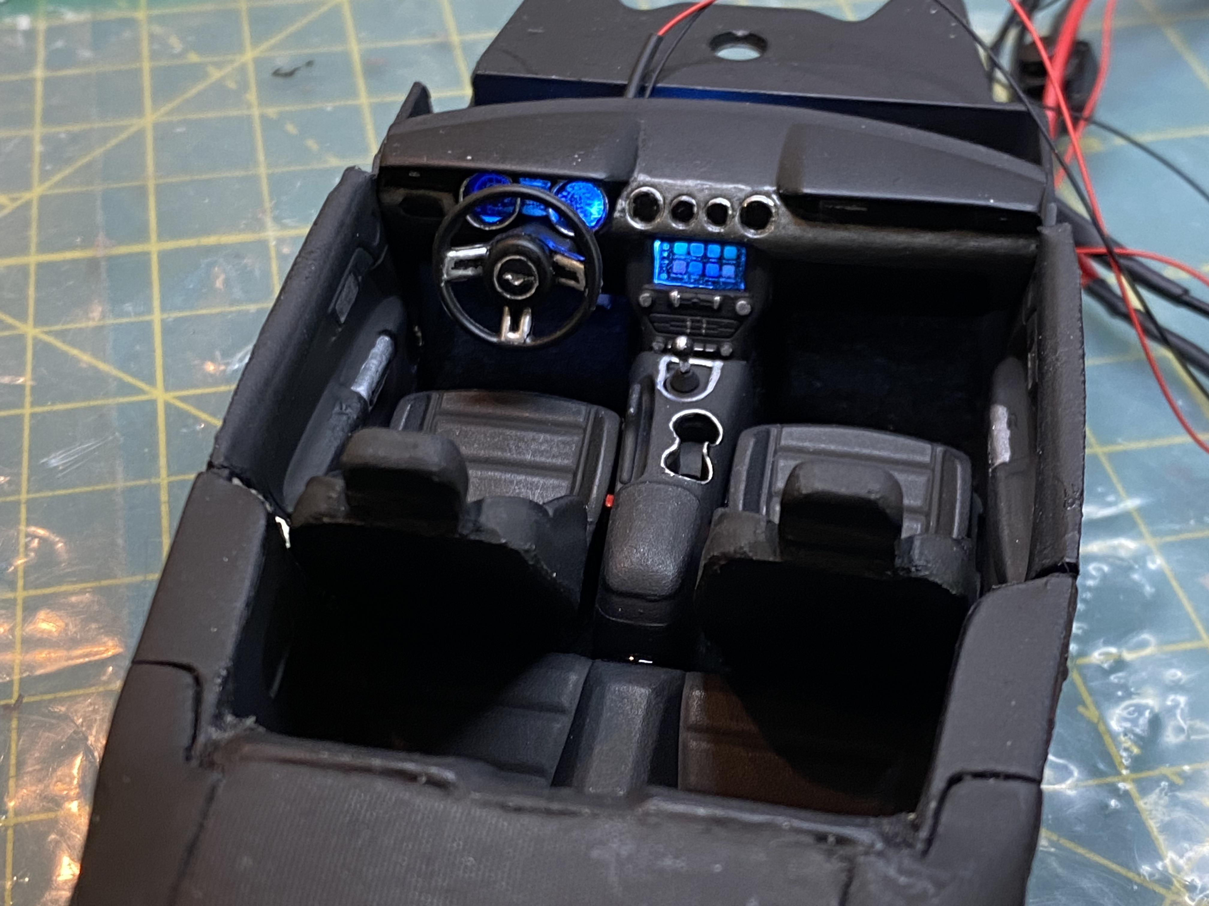

The 3v coin battery was just not enough power to run all the lights I need for this build so I am going with 9v power. Being a curbside I have room to put the battery where the engine would go. The pico lights were also not enough light so I completely redid the LED wiring harness with all 1.8mm bulbs.

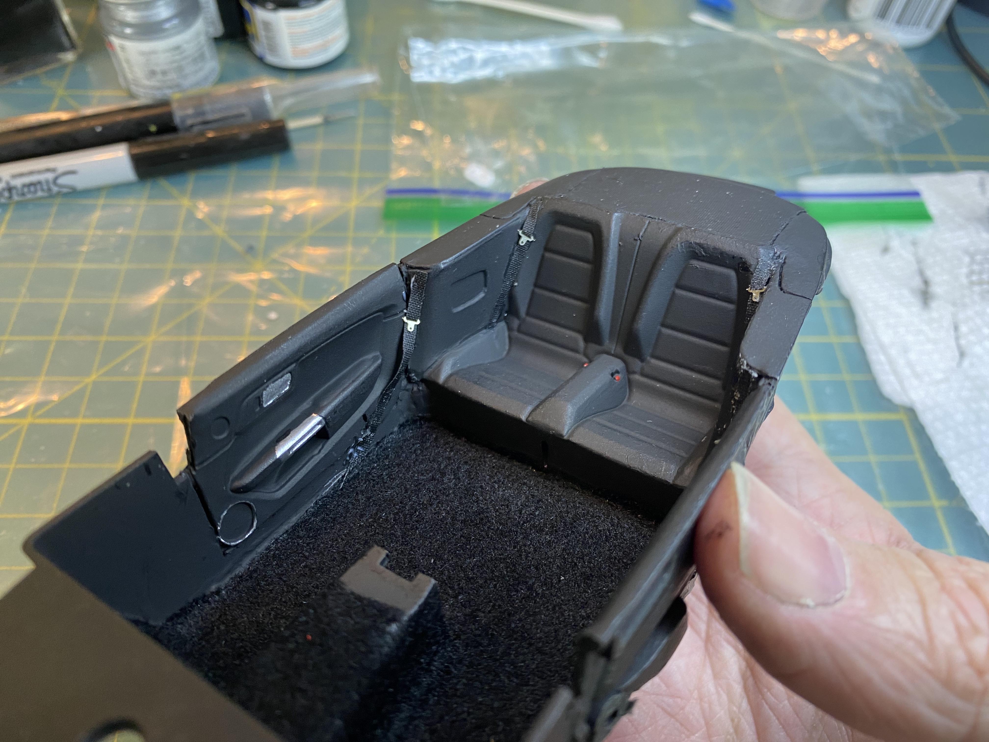

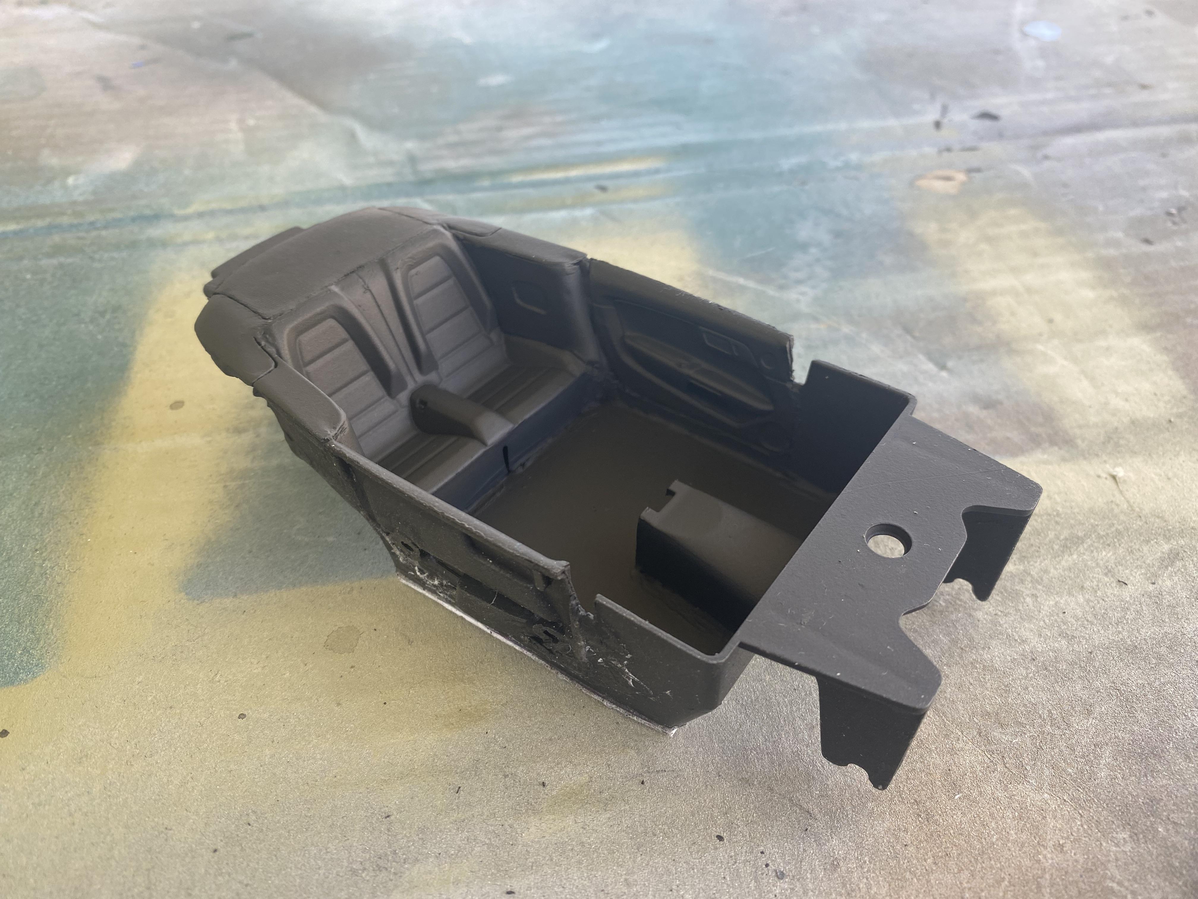

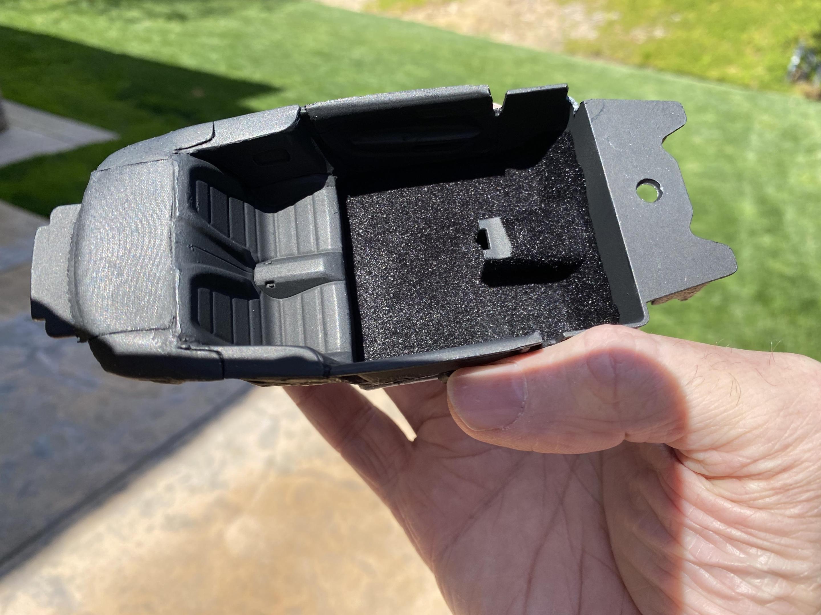

I also did the interior carpet flocking.

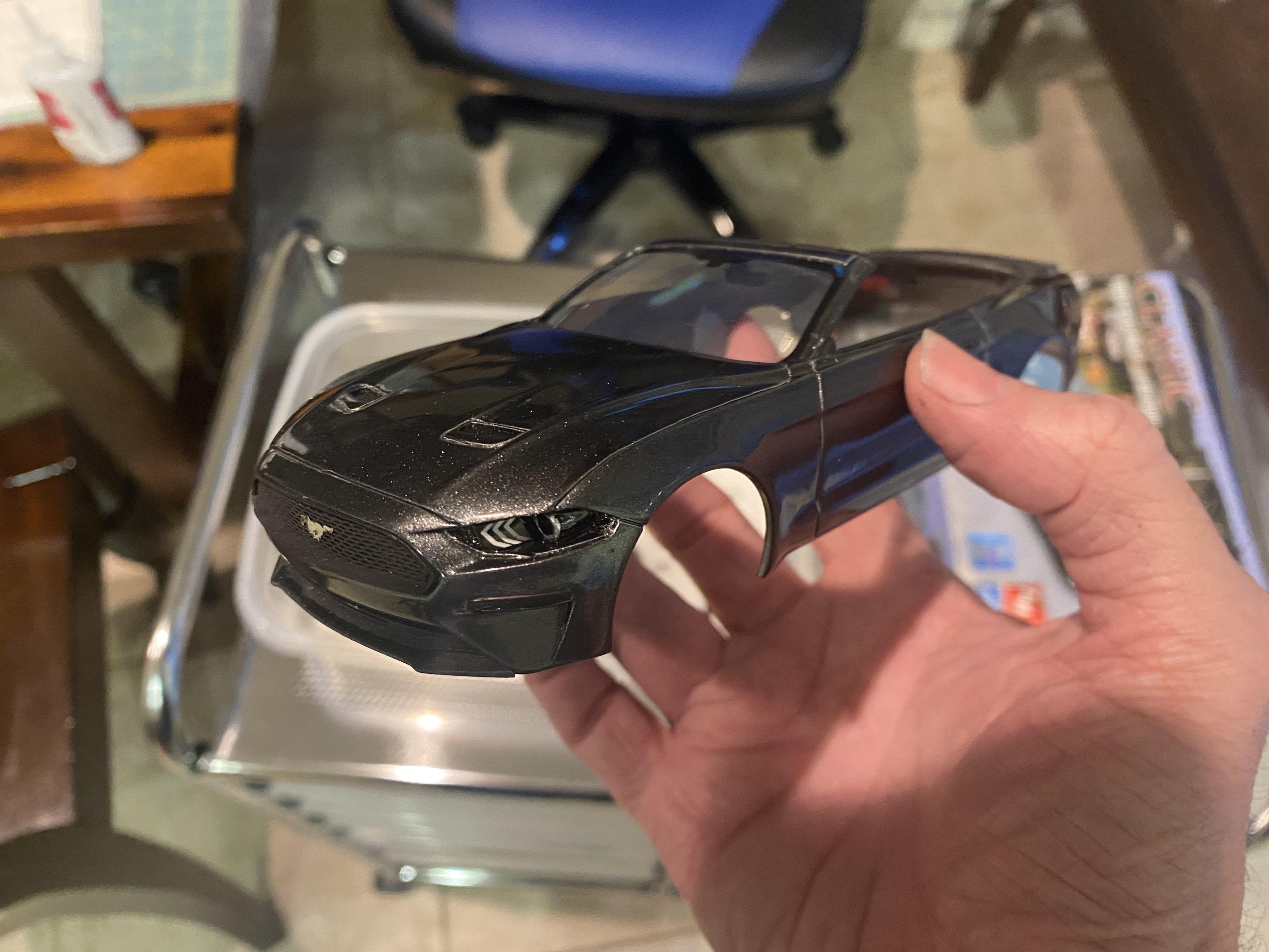

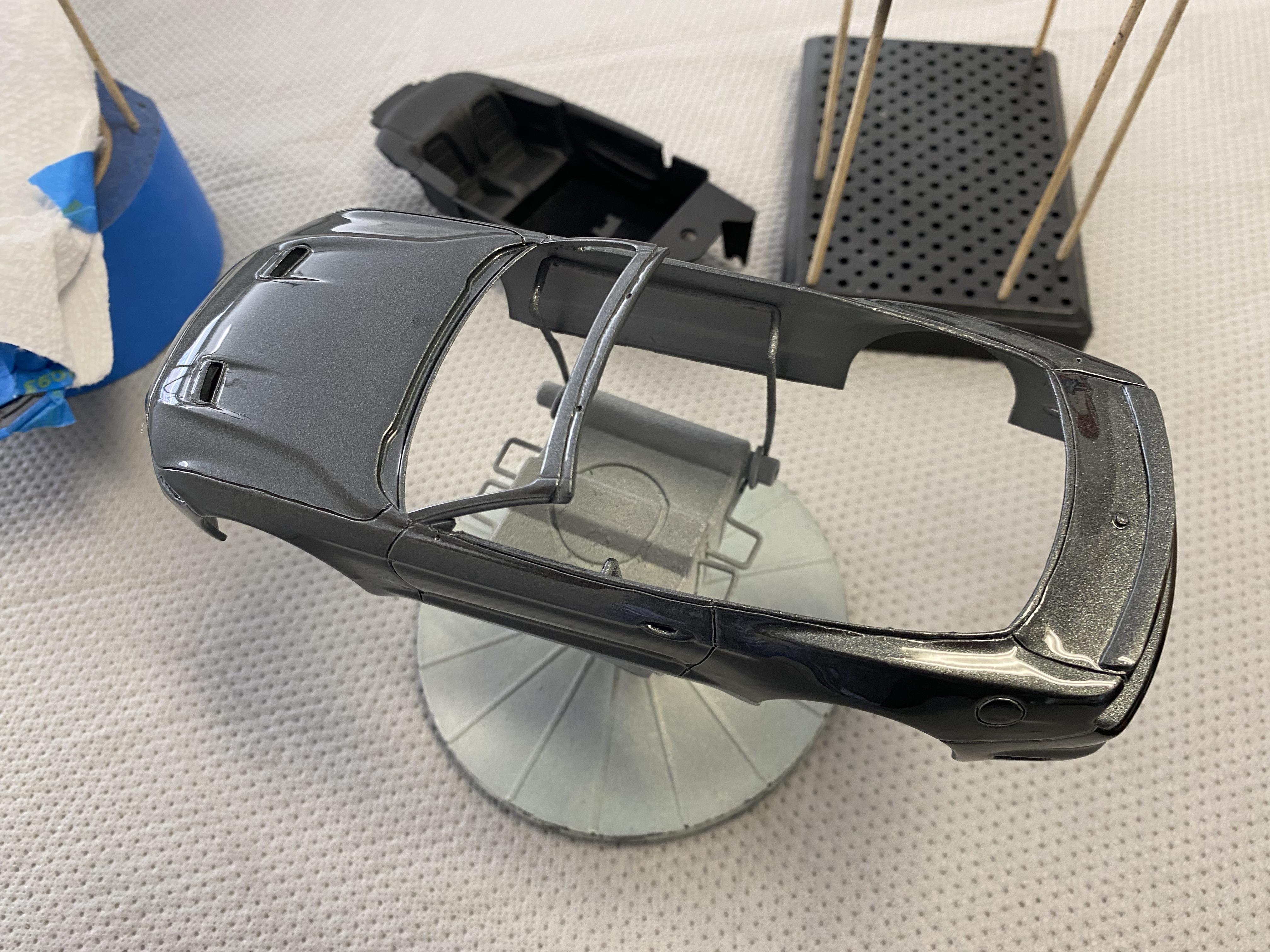

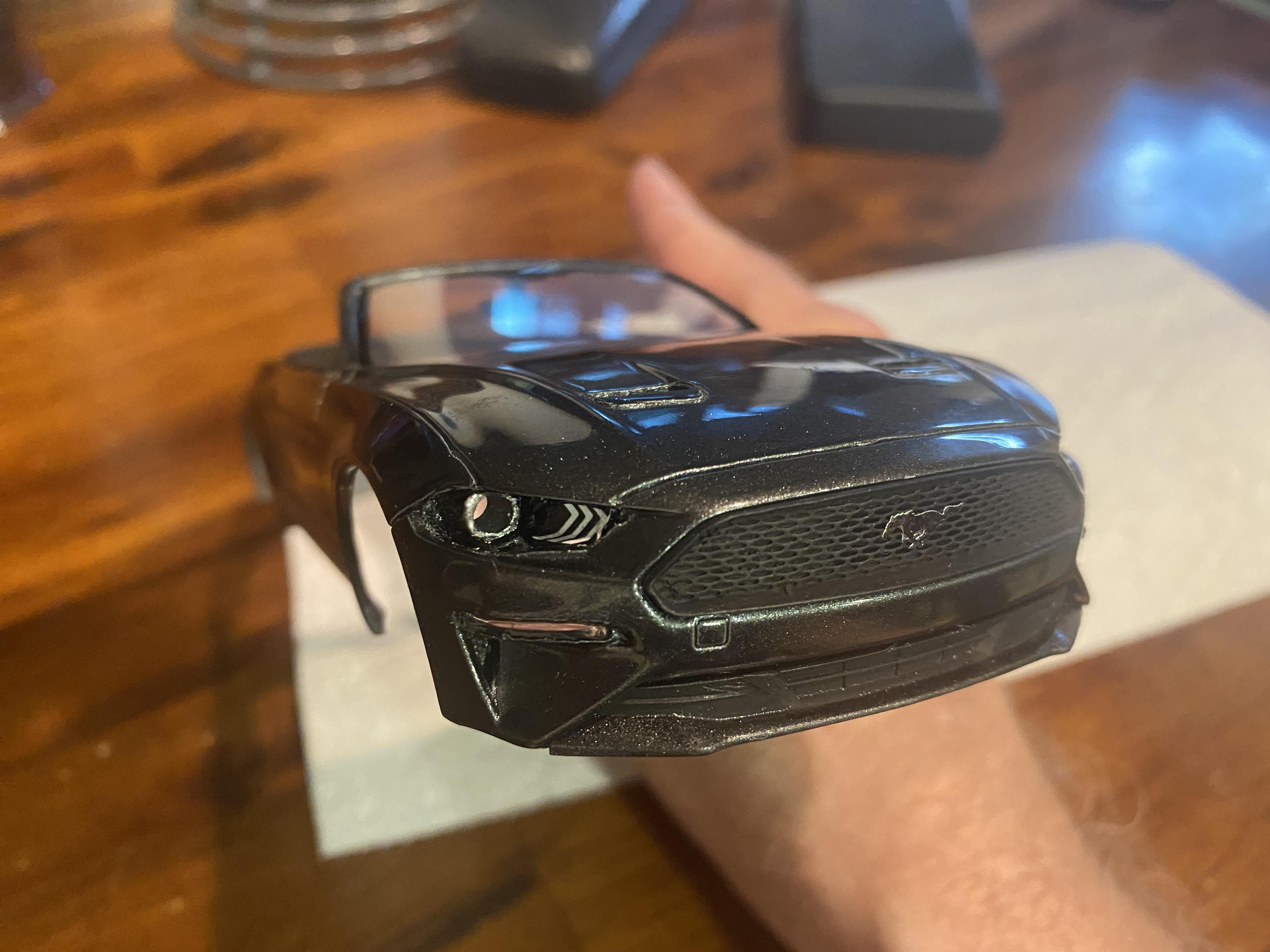

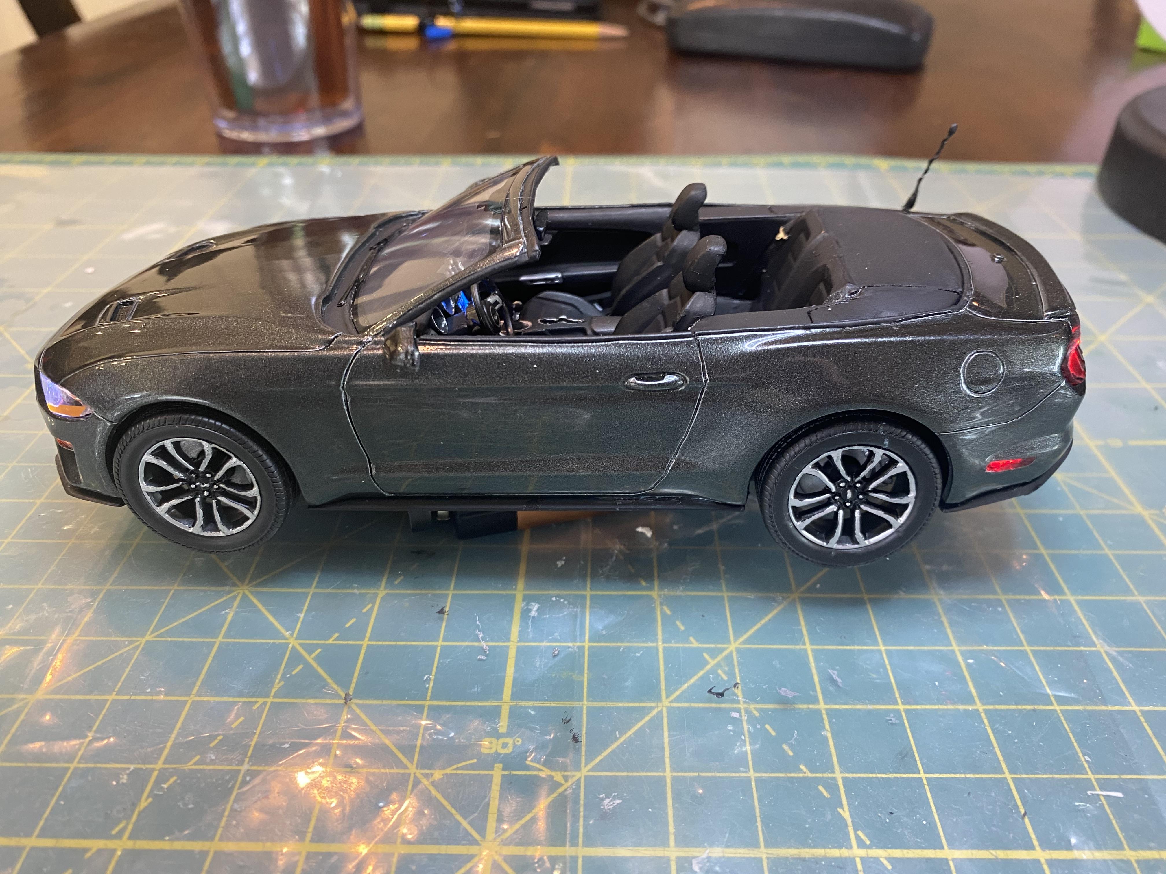

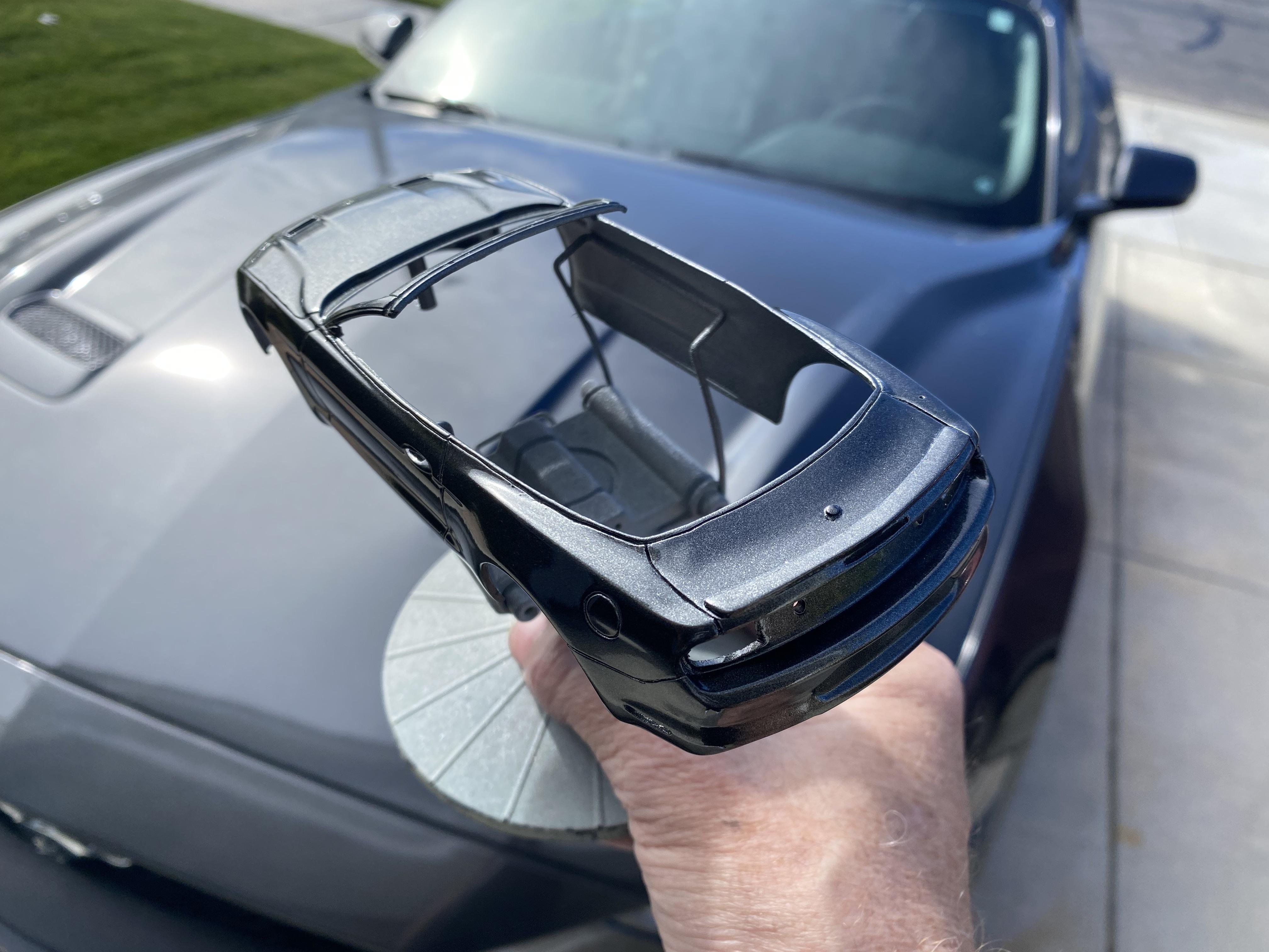

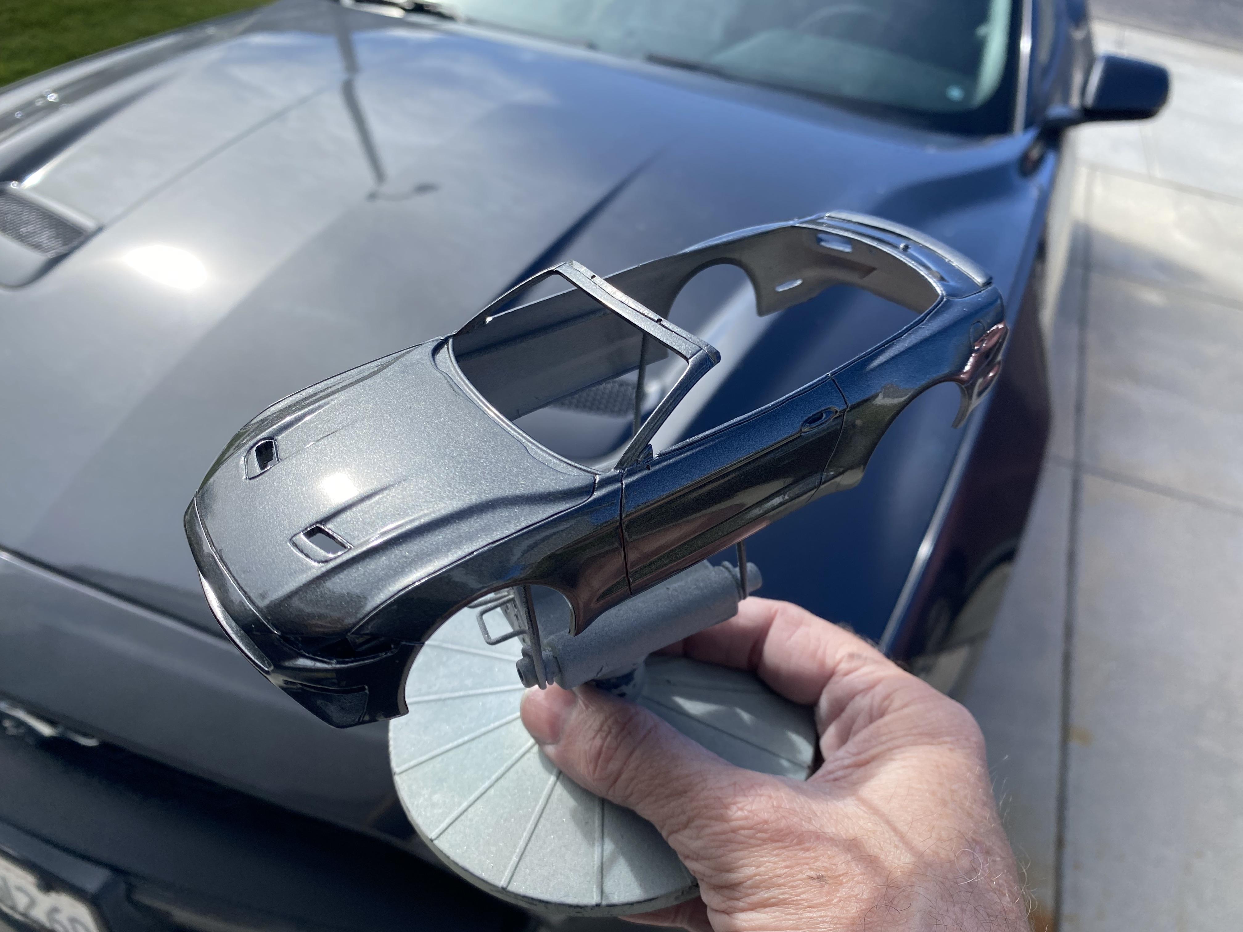

And got a base coat of J7 2018 Ford Magnetic metallic paint on the body and rear view mirrors. Using actual ford touch up paint, thinnedand airbrushed, the metallic particles are going to be a bit large for 1/25 scale but it’s the best match I can think of. Still need to 2K clear and polish but I think it is looking pretty good so far.
IMG_3889.thumb.jpeg.e30f39f6dbb42c0c9e5339063db7576a.jpegIMG_3890.thumb.jpeg.57ebd3d0fd440594ea1092e5fa8b18d7.jpeg
  • Like 2

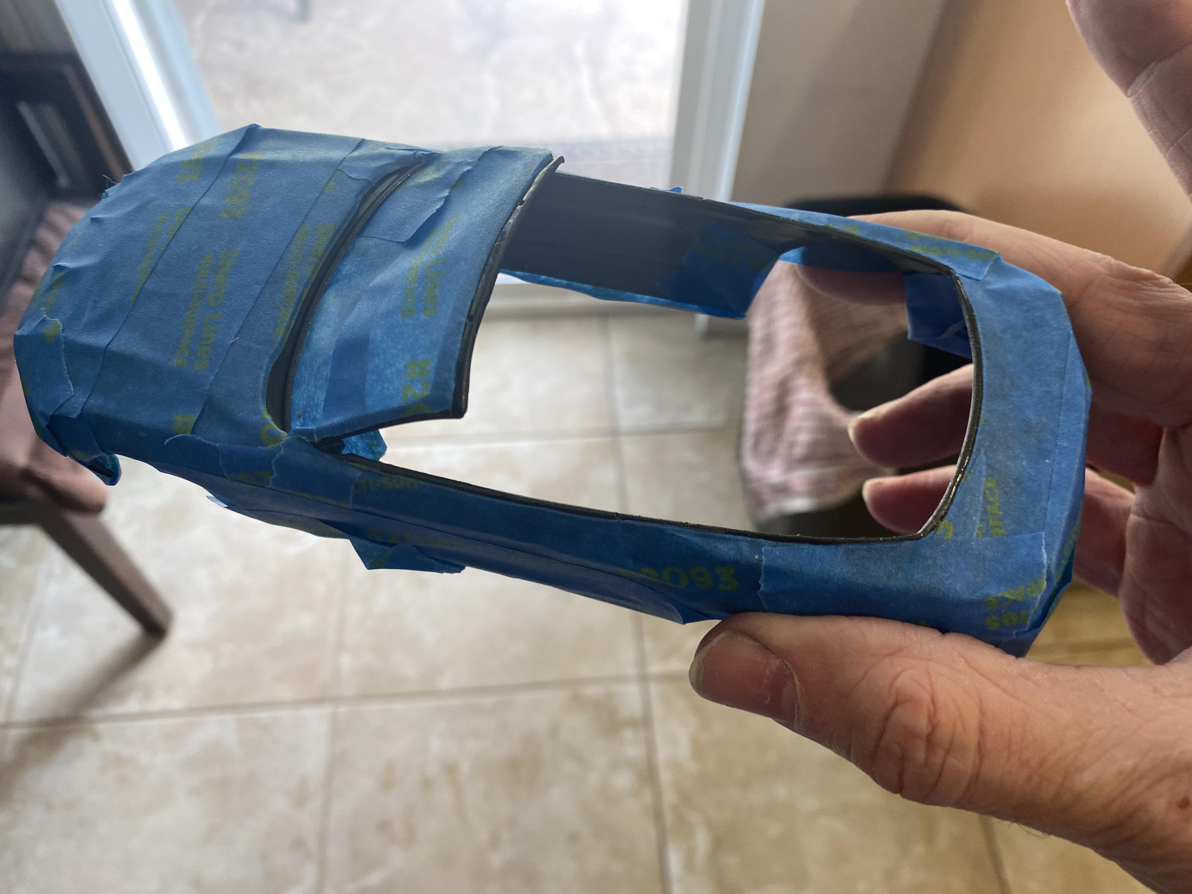

Got the body in 2K clear today. Now to wait a few days before wet sanding and polishing. No runs and only a couple specs in the hood that should sand out nicely.

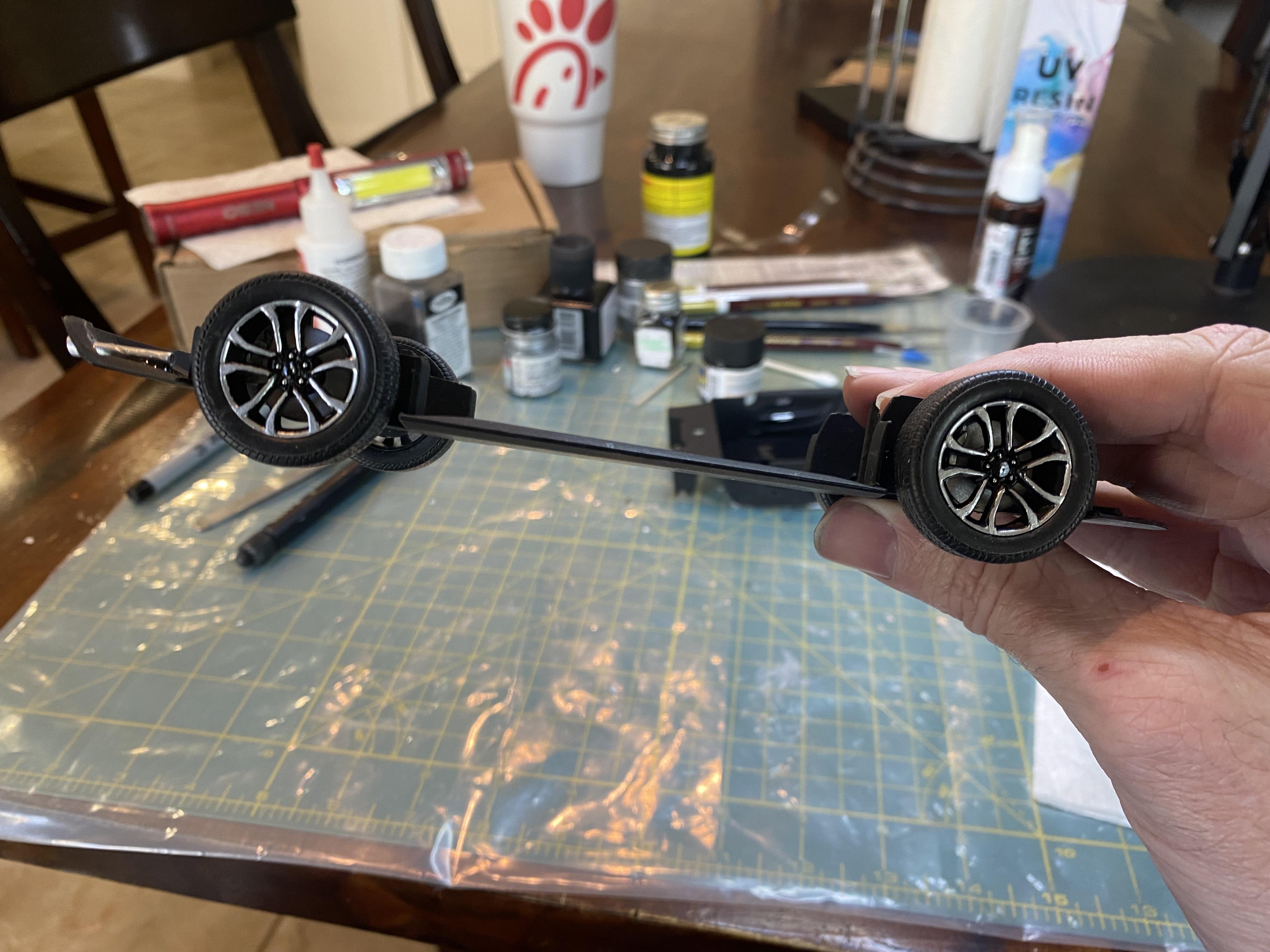

Finished up what there is of a chassis and the interior today. Added seat belts and created the gauge lenses for LEDs. Next it’s time to wet sand and polish the body.

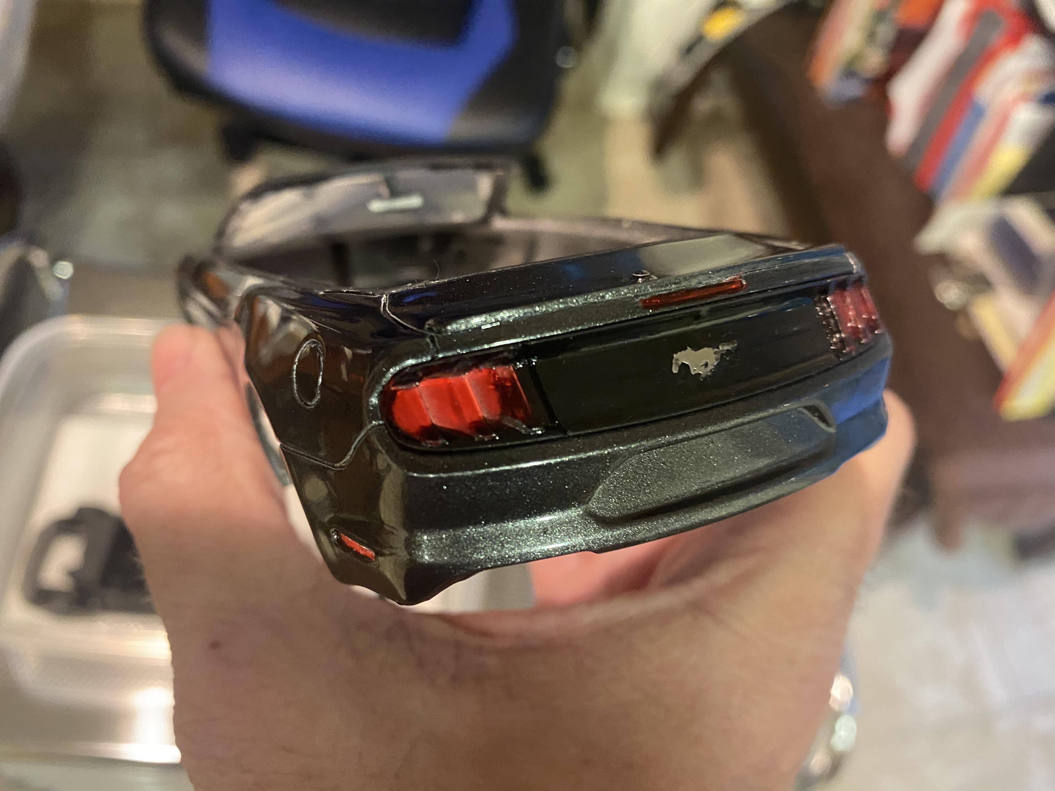

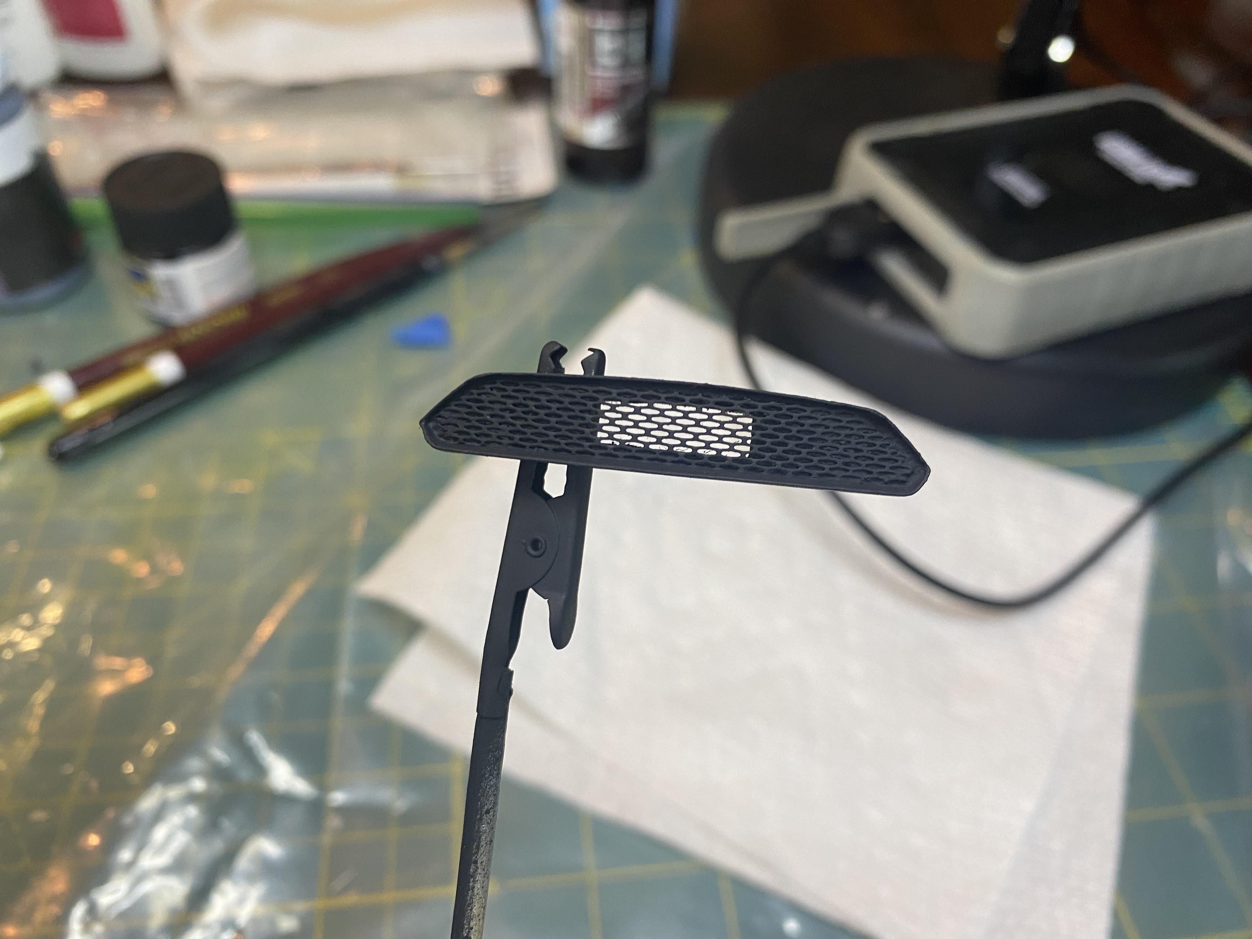

I got some work done on the body today. Time for assembly.

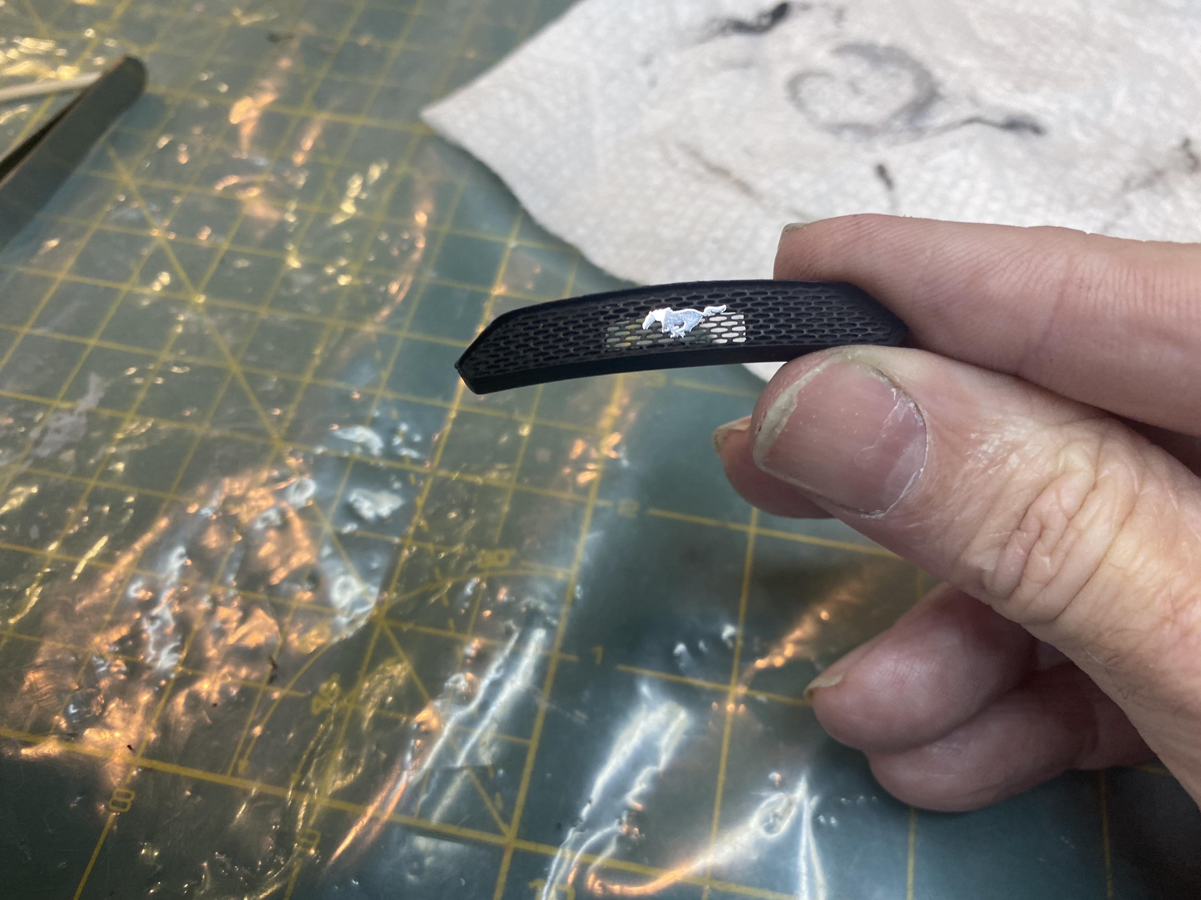

photo-etch grill, chrome decal horse
painted trim flat black, painted & detailed inner headlight. Chrome decal horse on back panel.

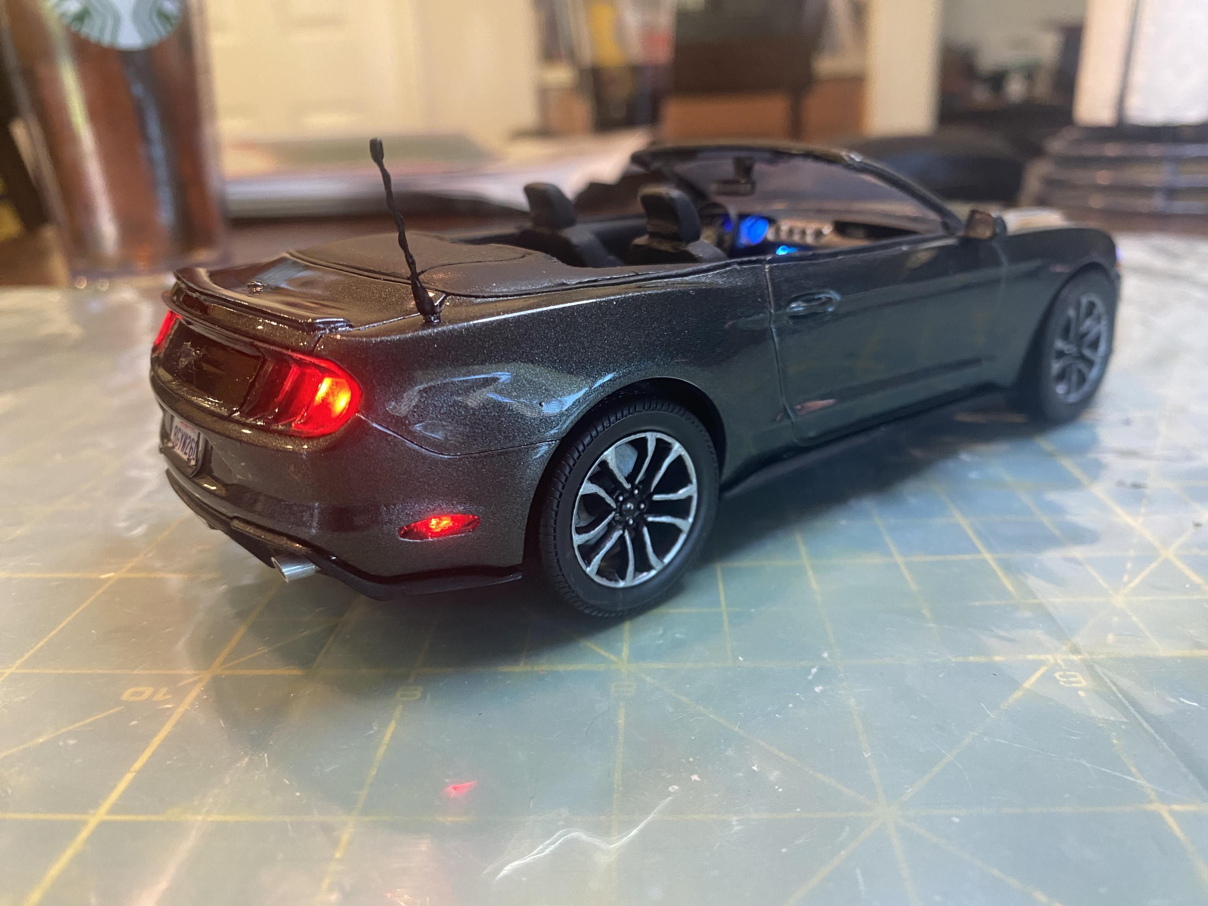

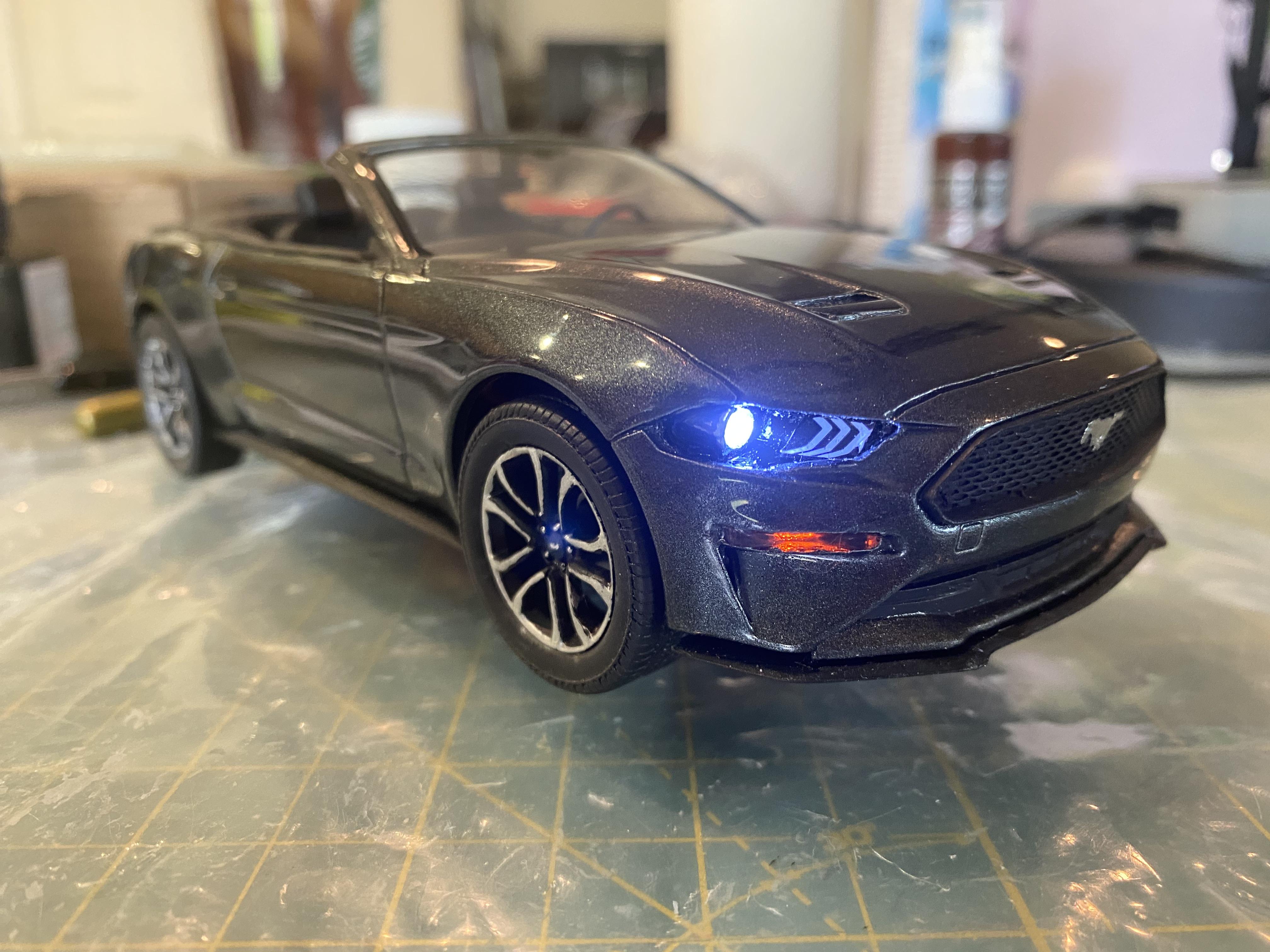

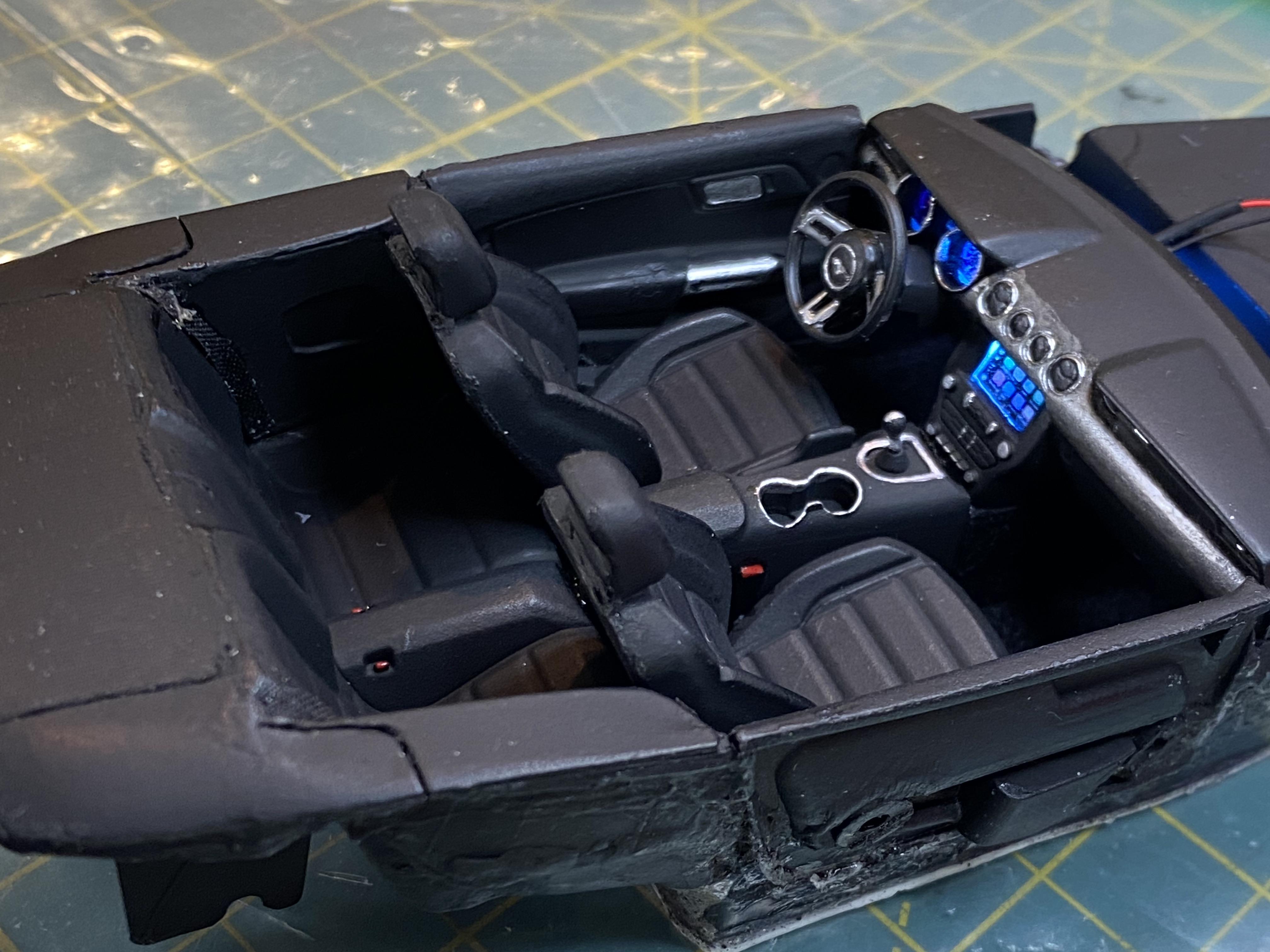

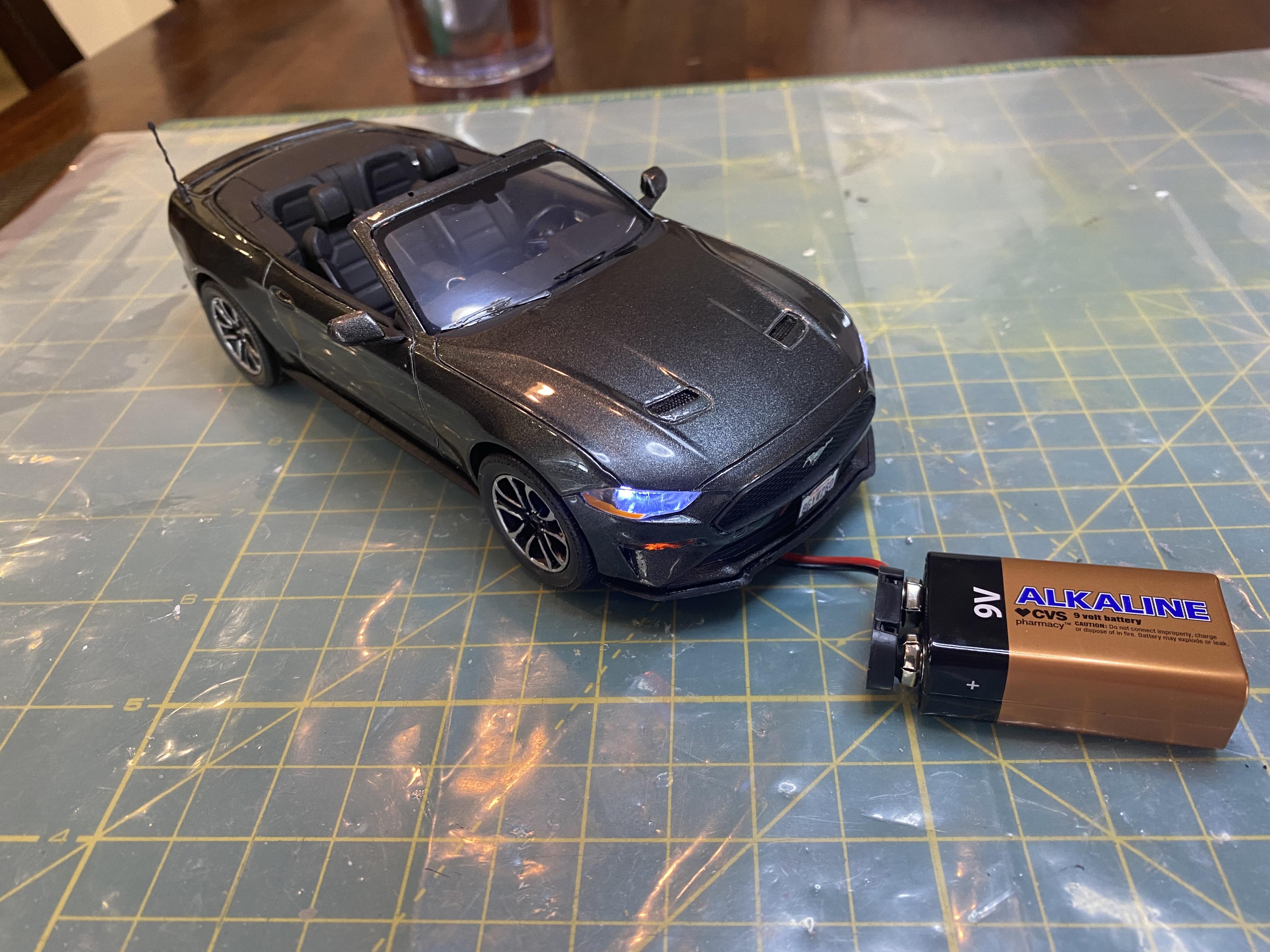

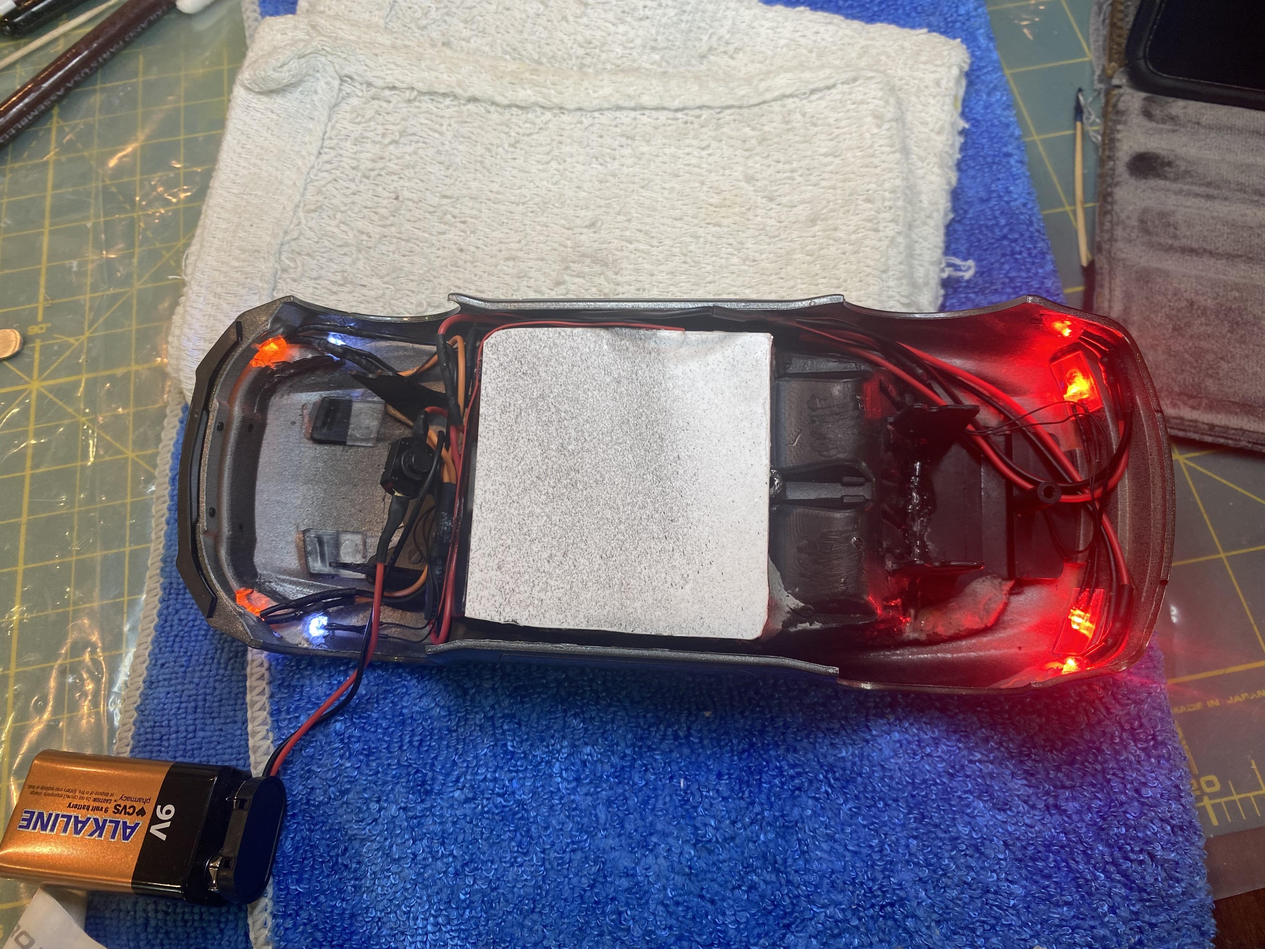

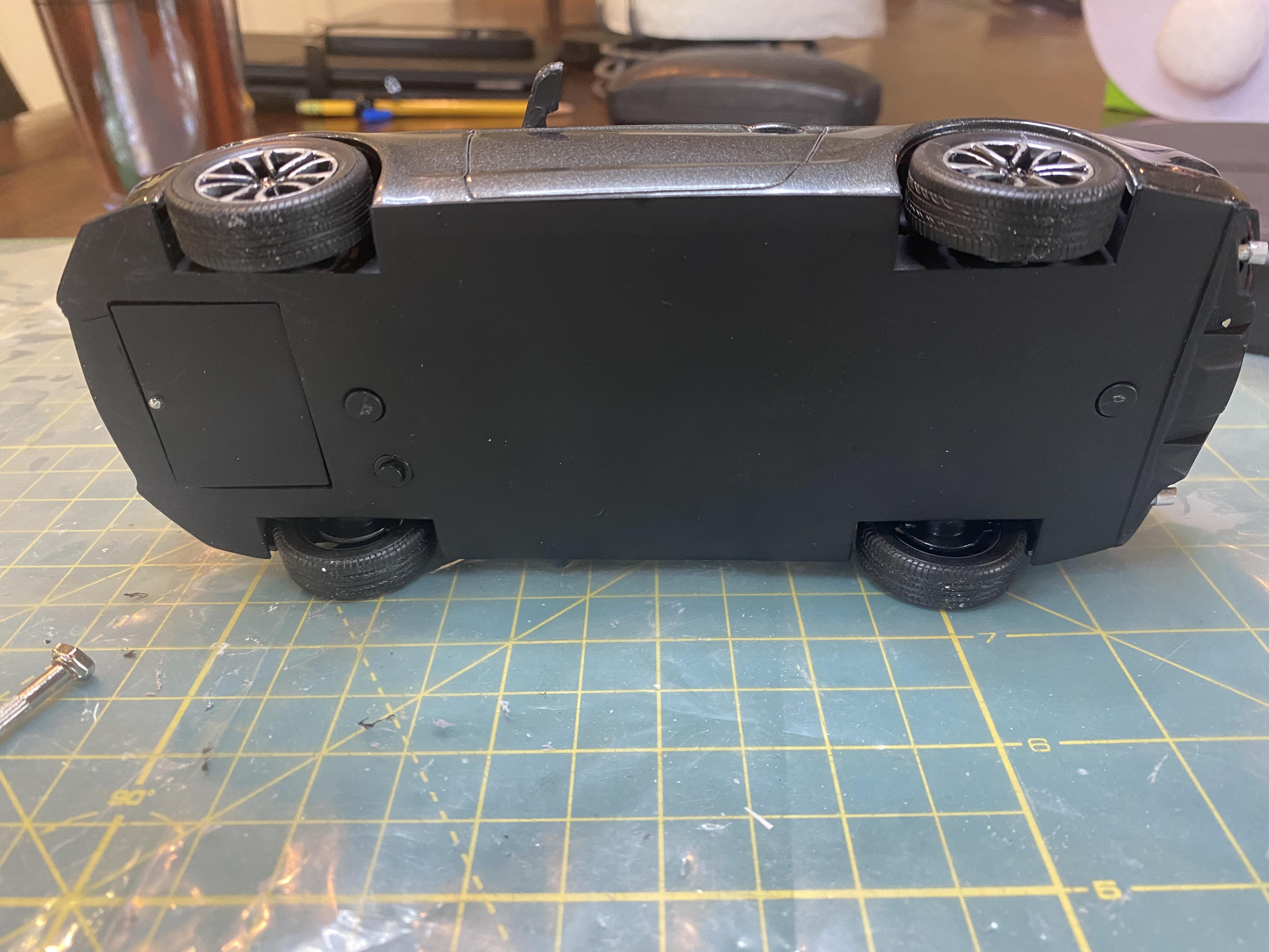

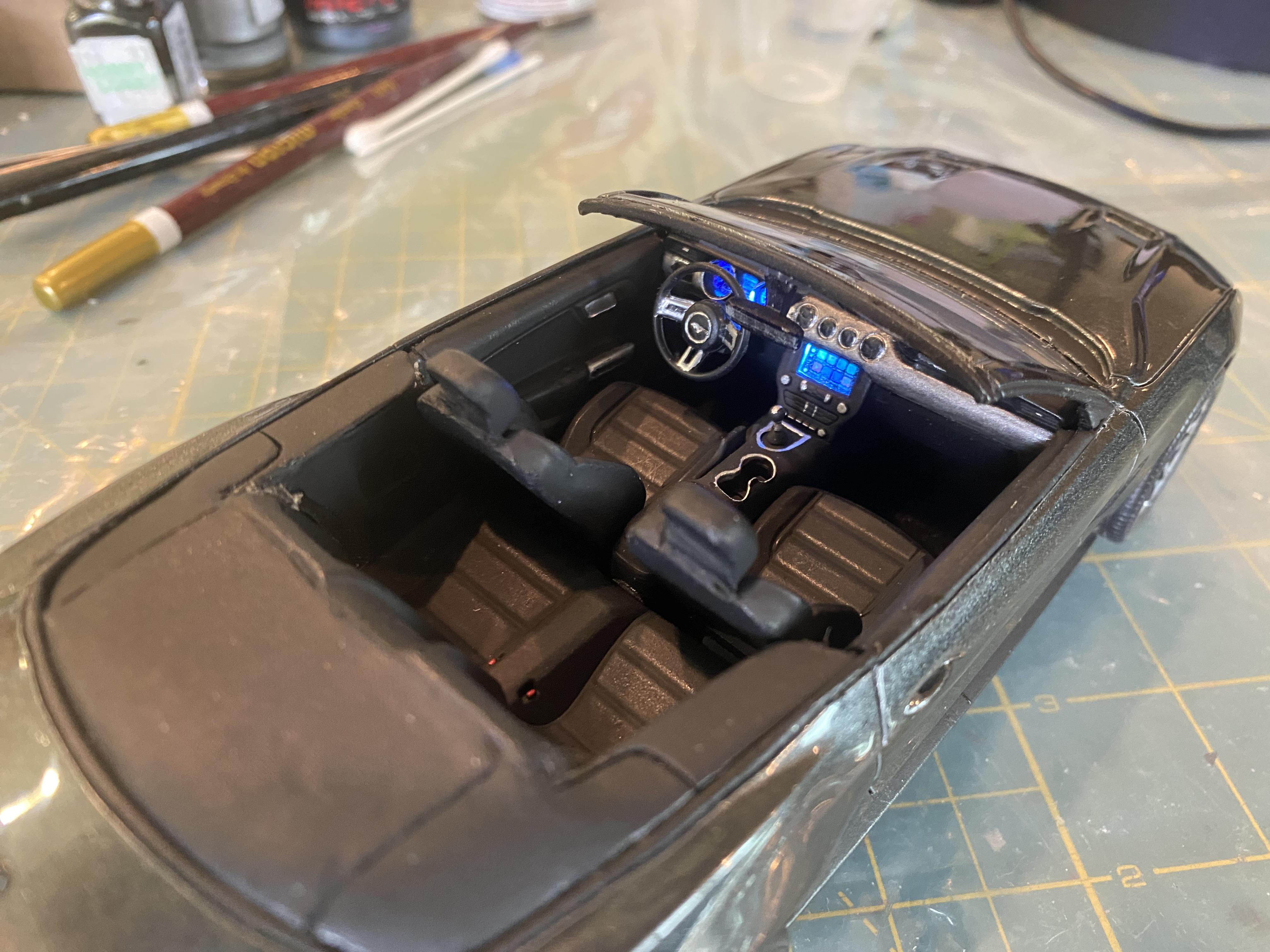

As luck would have it there so no way to get the 9v battery to fit in the car so now I am looking into alternatives. I think an A23 battery might fit so I have some on order with holders. I have the car assembled otherwise.

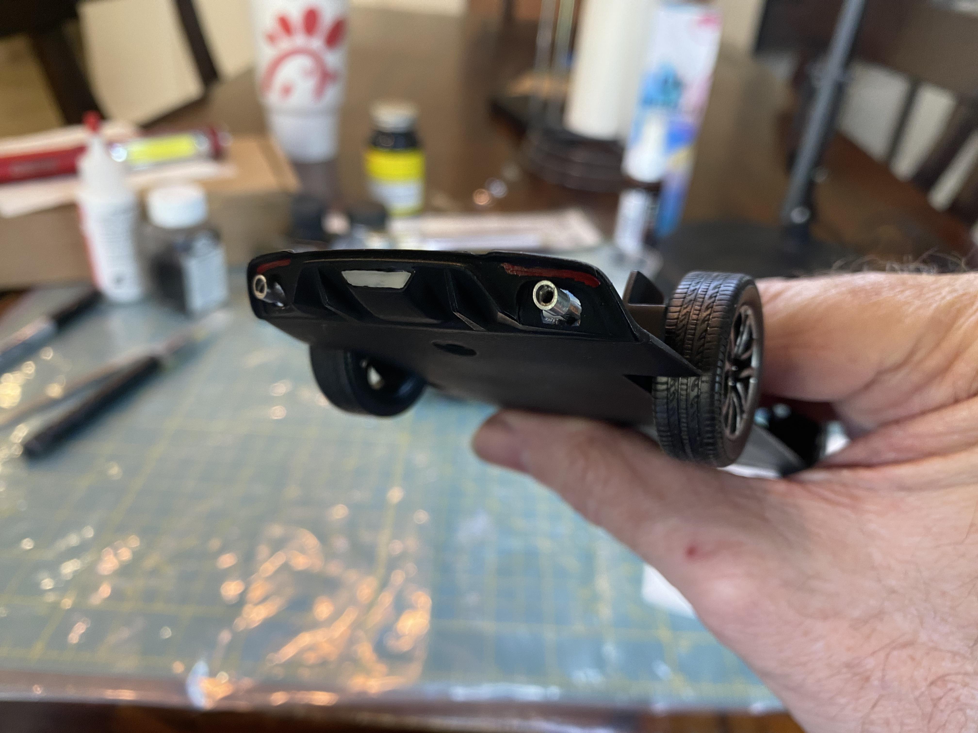

Installed the LED wiring harness
IMG_3925.thumb.jpeg.6248bfcccc8581ca2f94e1f5d842f917.jpegIMG_3926.thumb.jpeg.c75b1a1c8050c3bb4d8e69b3b6fe75ce.jpegIMG_3928.thumb.jpeg.6f87643458318b20fa1bf457aff767b3.jpegIMG_3929.thumb.jpeg.aefc3da486295af08613d7d166554991.jpeg
and finished assembly, but still need to solve the battery situation.
IMG_3934.thumb.jpeg.686c91e3e042c68514b7e89c23313d1d.jpegIMG_3935.thumb.jpeg.a00a2f91ce0a3bcceea6f4c4089bca5b.jpegIMG_3936.thumb.jpeg.53c57c68a551c58d1fad04c0a4c17366.jpegIMG_3937.thumb.jpeg.0ff6416997710b0aa219eeb37cc71909.jpegIMG_3938.thumb.jpeg.f50eb015a6bb83f6b28d6fe5daebceff.jpeg
The lighting looks good in my option, just hope I can hide a battery in a compartment.
IMG_3939.thumb.jpeg.311986c9b1bdb44c99ad4abc68b1e08b.jpegIMG_3940.thumb.jpeg.fedc8bfd5f34a9de550d3a111fd0acfe.jpegIMG_3941.thumb.jpeg.cd68dd32fd6e38aa42618383df9cb29f.jpegIMG_3942.thumb.jpeg.4df0225c39b80acfb5db39f5c04c46da.jpegIMG_3943.thumb.jpeg.d05dfd4ac8a906b5f05ac5e1d6201482.jpeg

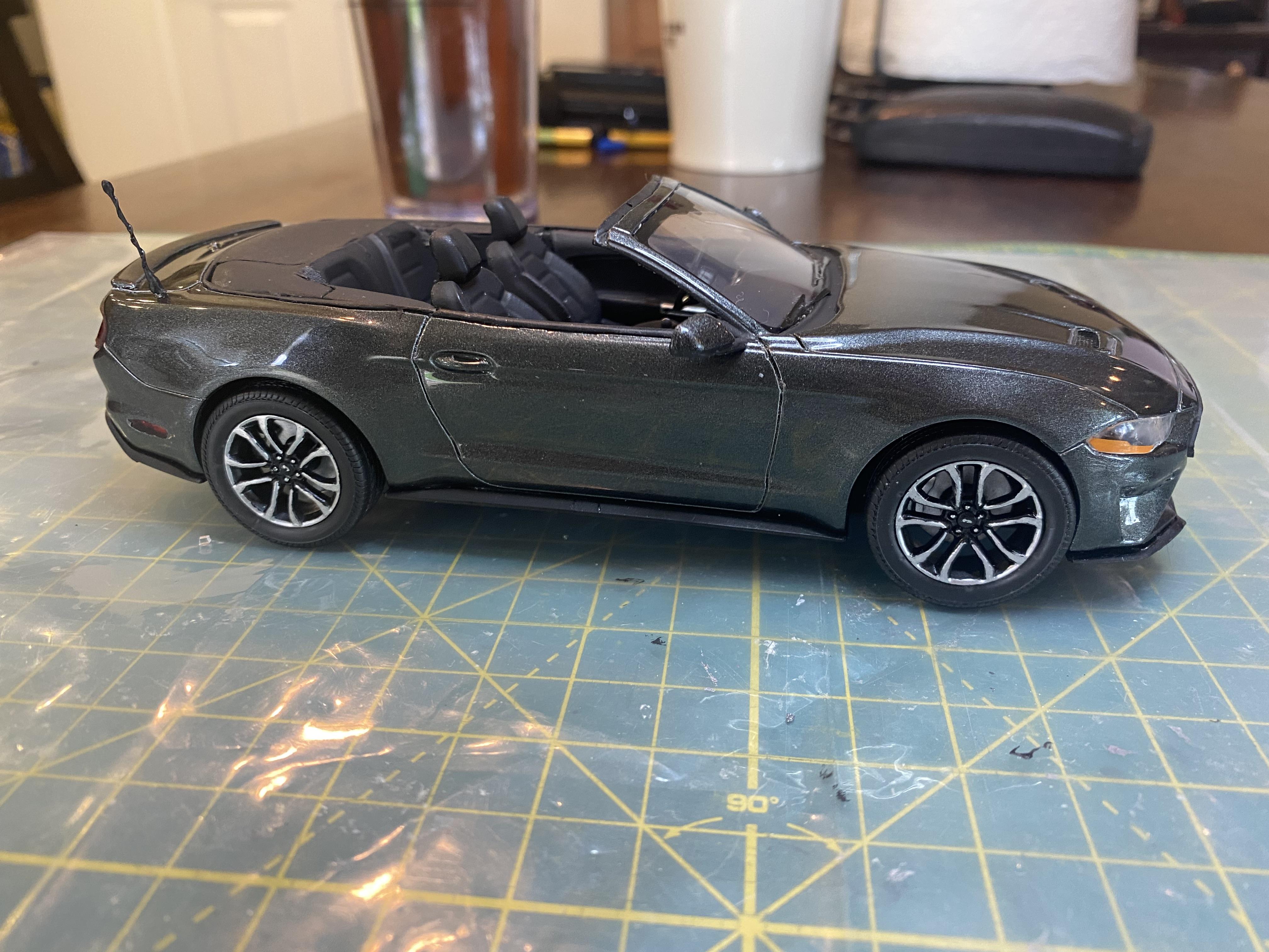

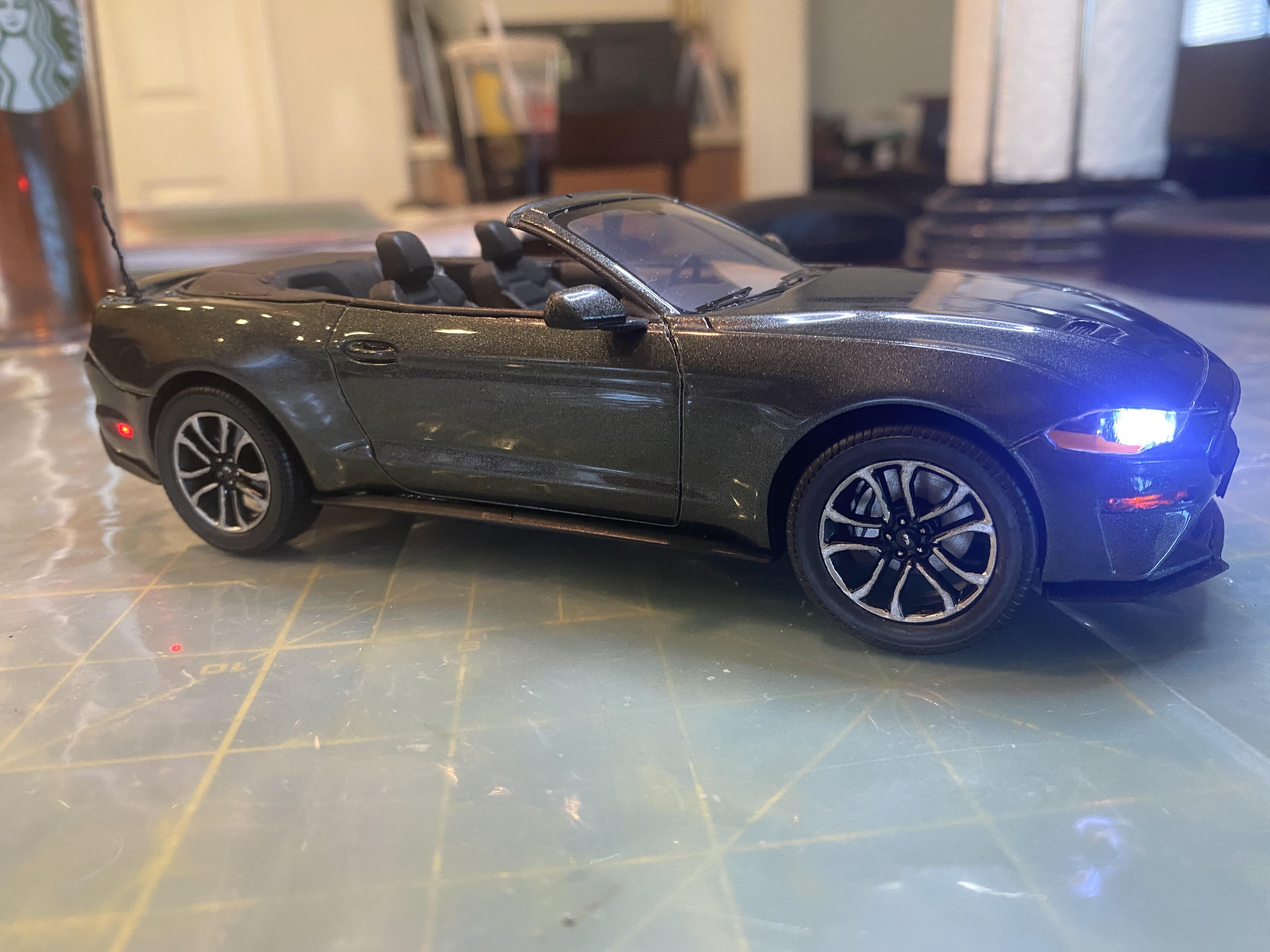

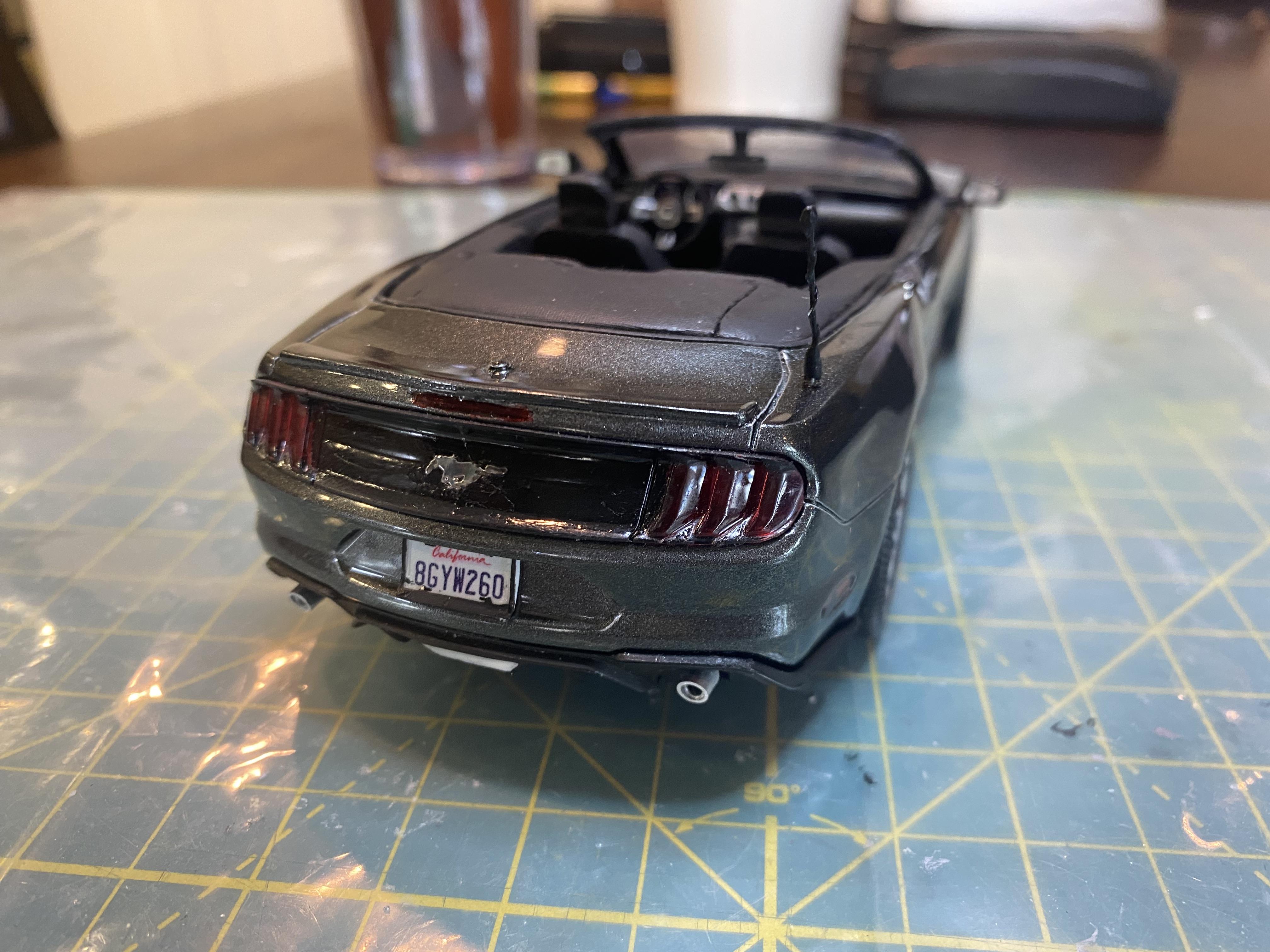

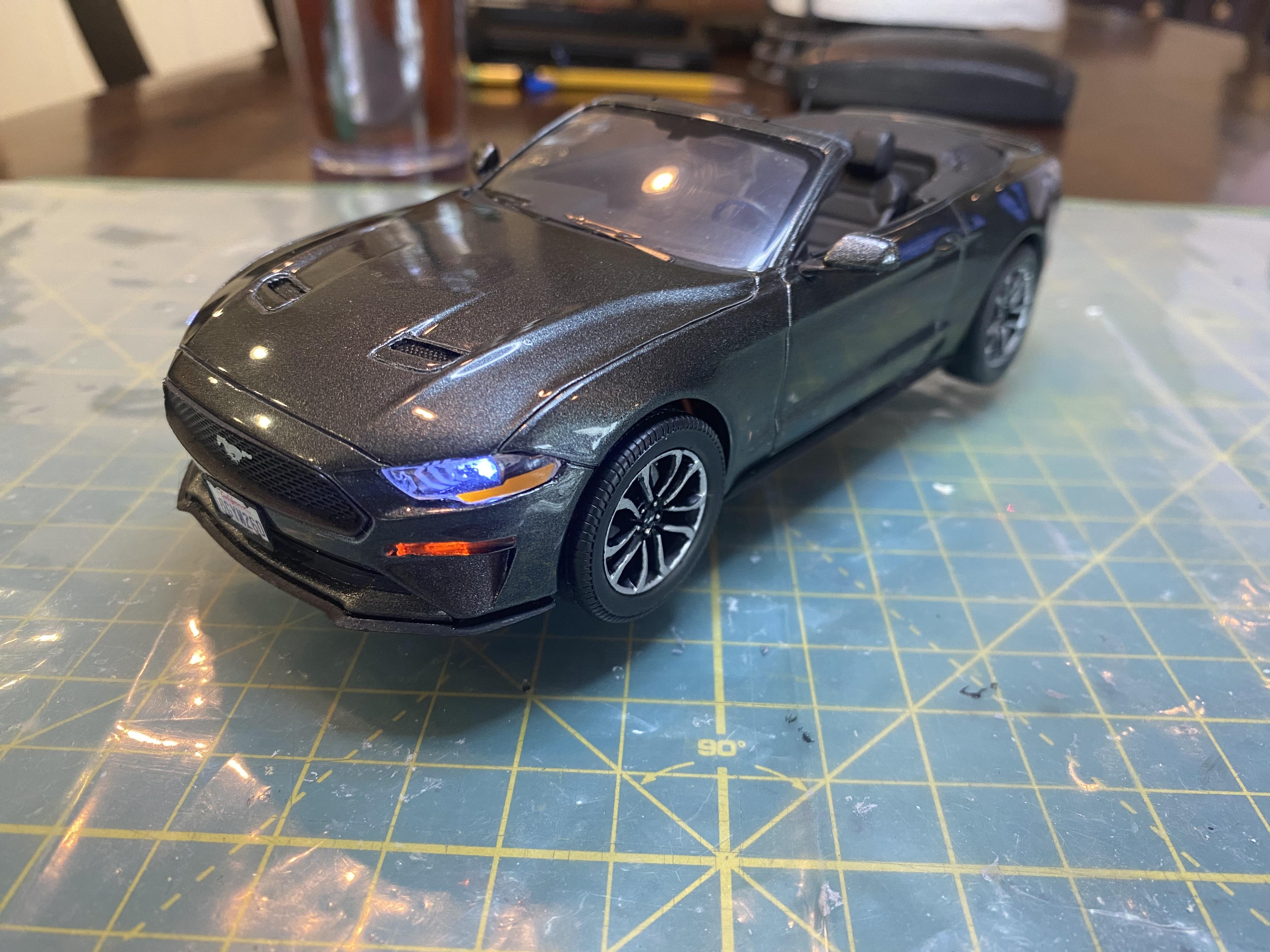

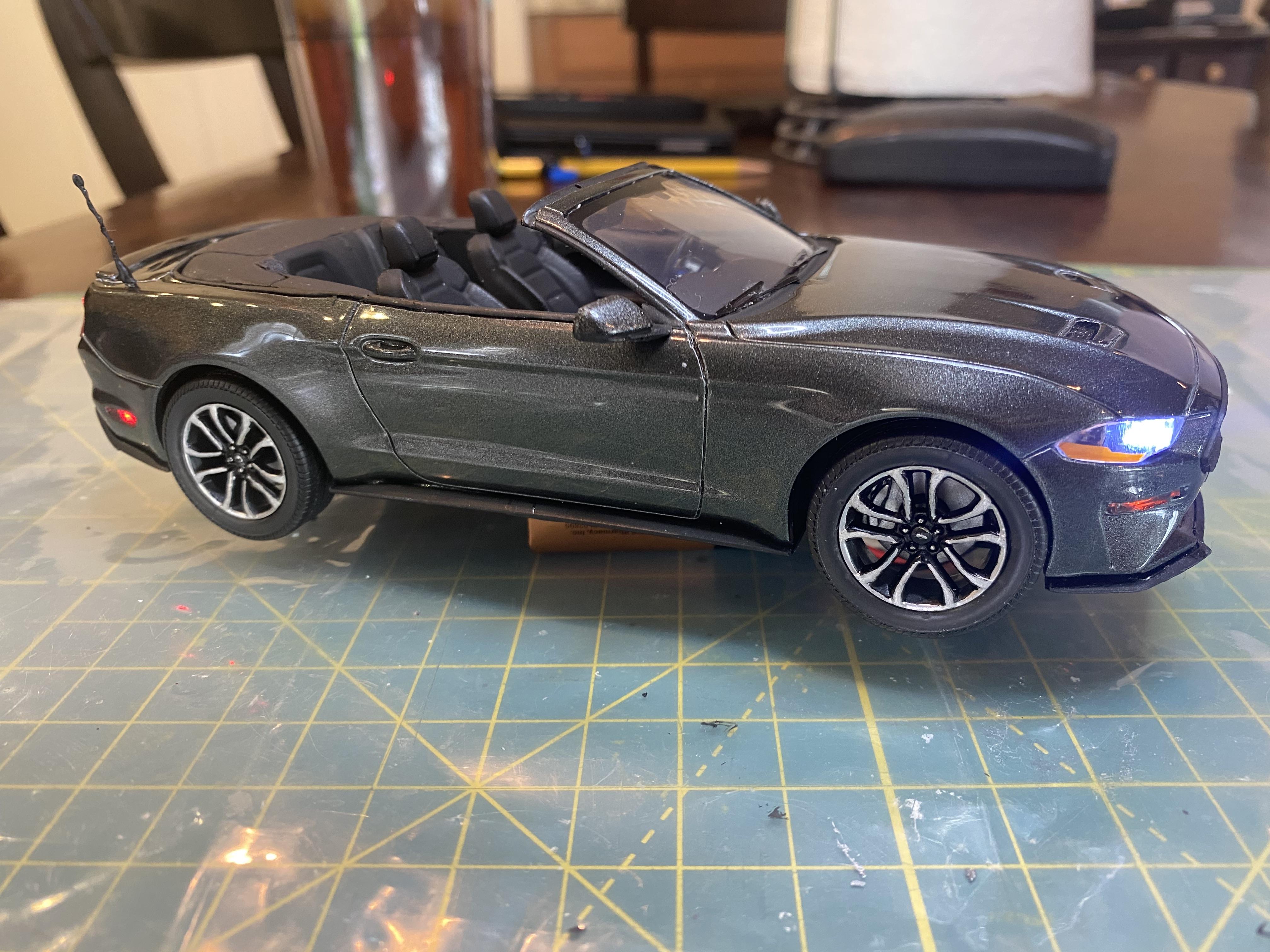

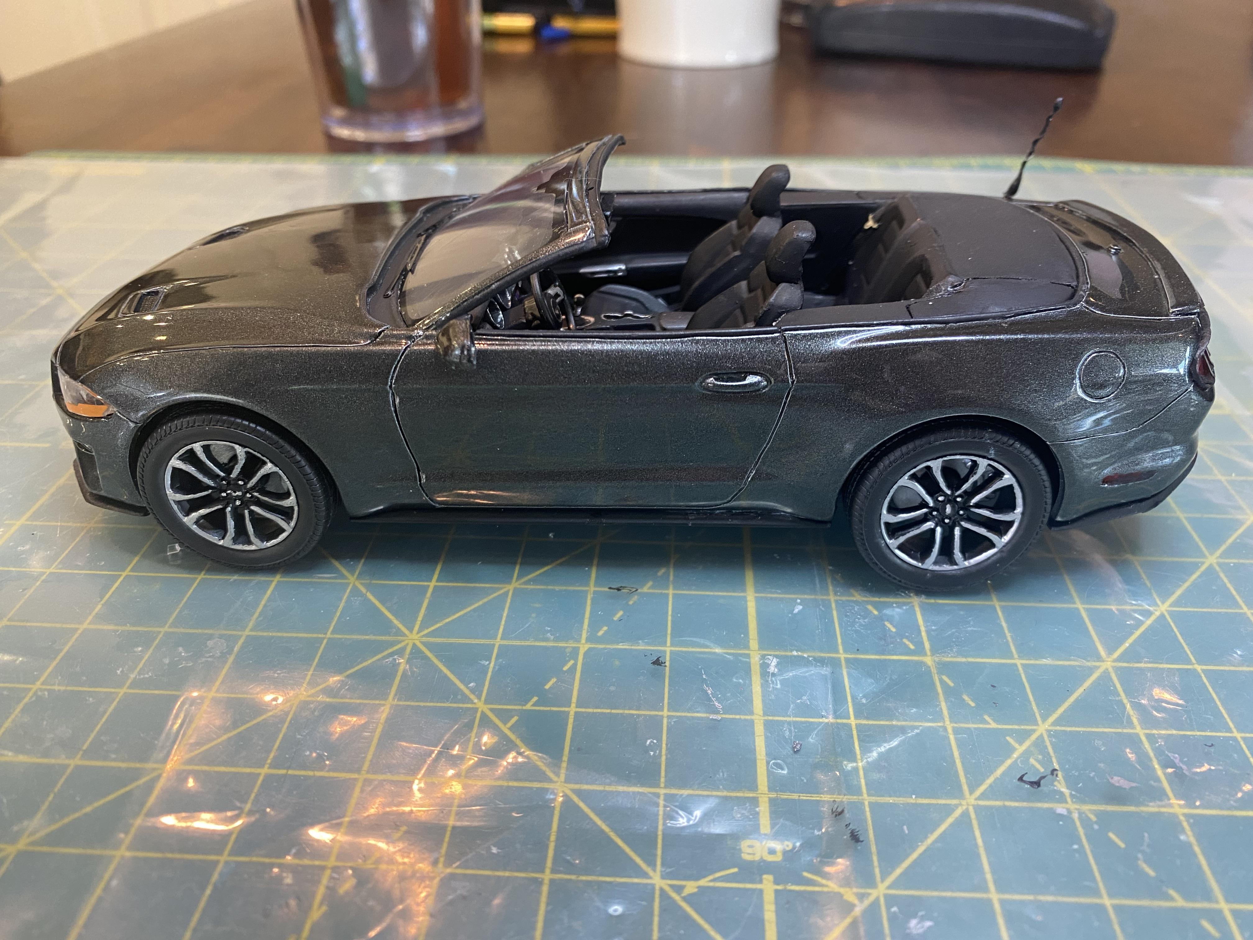

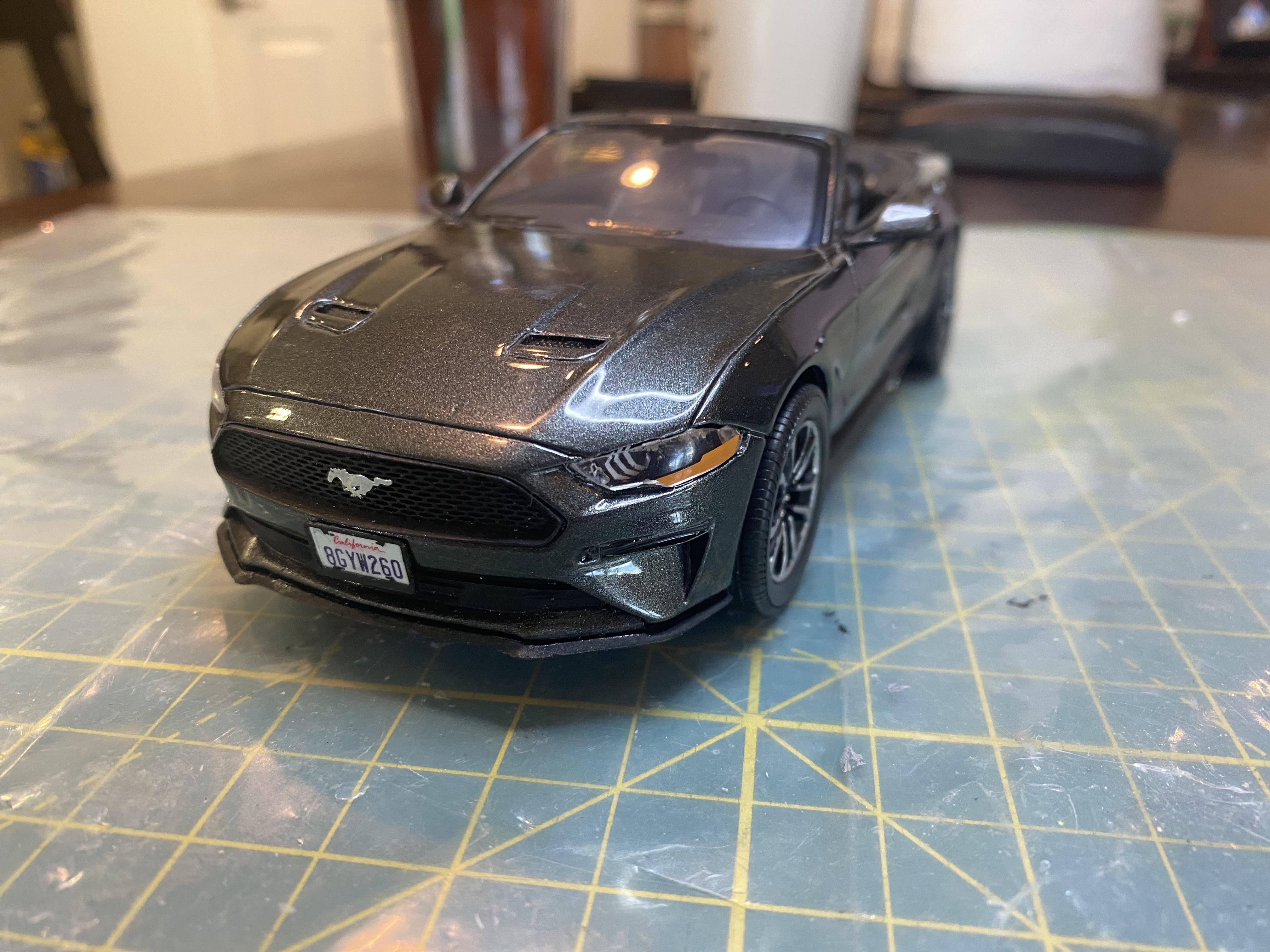

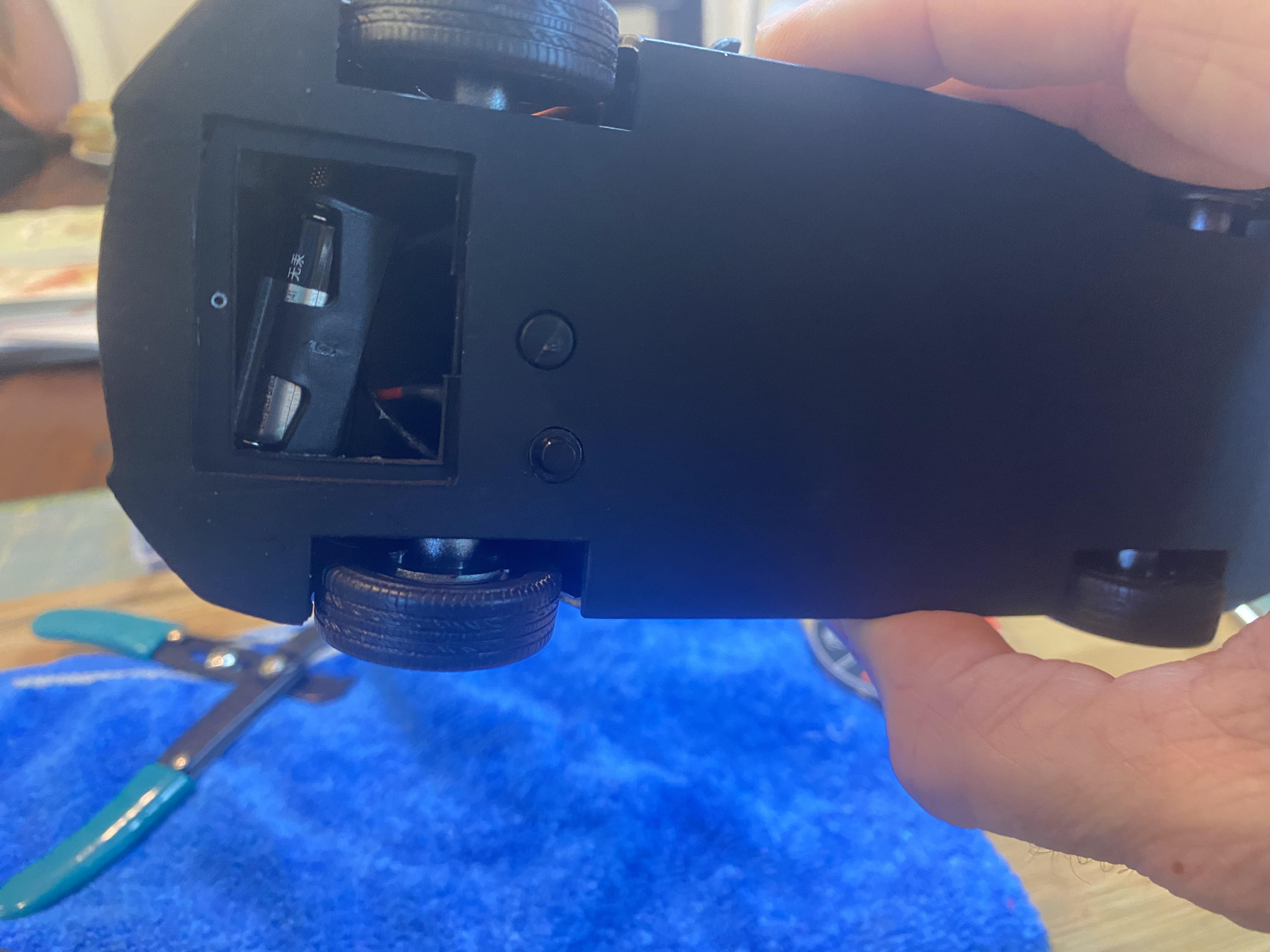

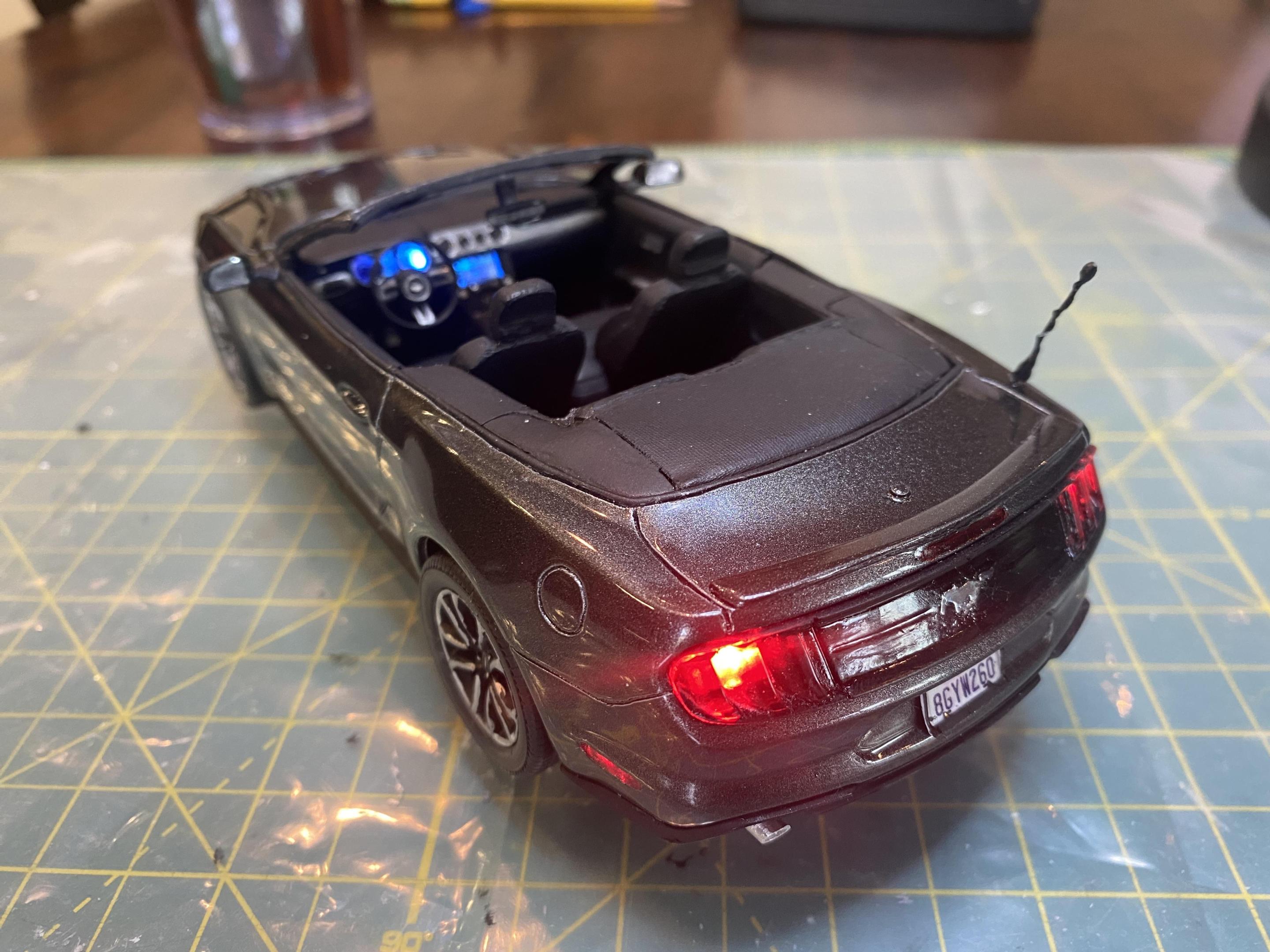

I was able to get an A23 12V battery and holder to fit in the battery compartment I created. This is the final post for WIP. You can see the Model Showcase thread here with much better pictures.
This is the A23 in place
IMG_3954.thumb.jpeg.0999c45b058fd818a6aa91568a24c6ab.jpegIMG_3956.thumb.jpeg.0431a9bb242bb8da9c4b1f6523fd97a9.jpegIMG_3957.thumb.jpeg.323e6d3e7bf864d46d9192e6bb4598f4.jpeg

Excellent. Love the lighting. Color is awesome.
Thanks, The lighting on this one was a bit more difficult. I had to move from a 3V coin battery to a 12V A23. The addition of the 4 additional side markers was just too much for the coin battery.
