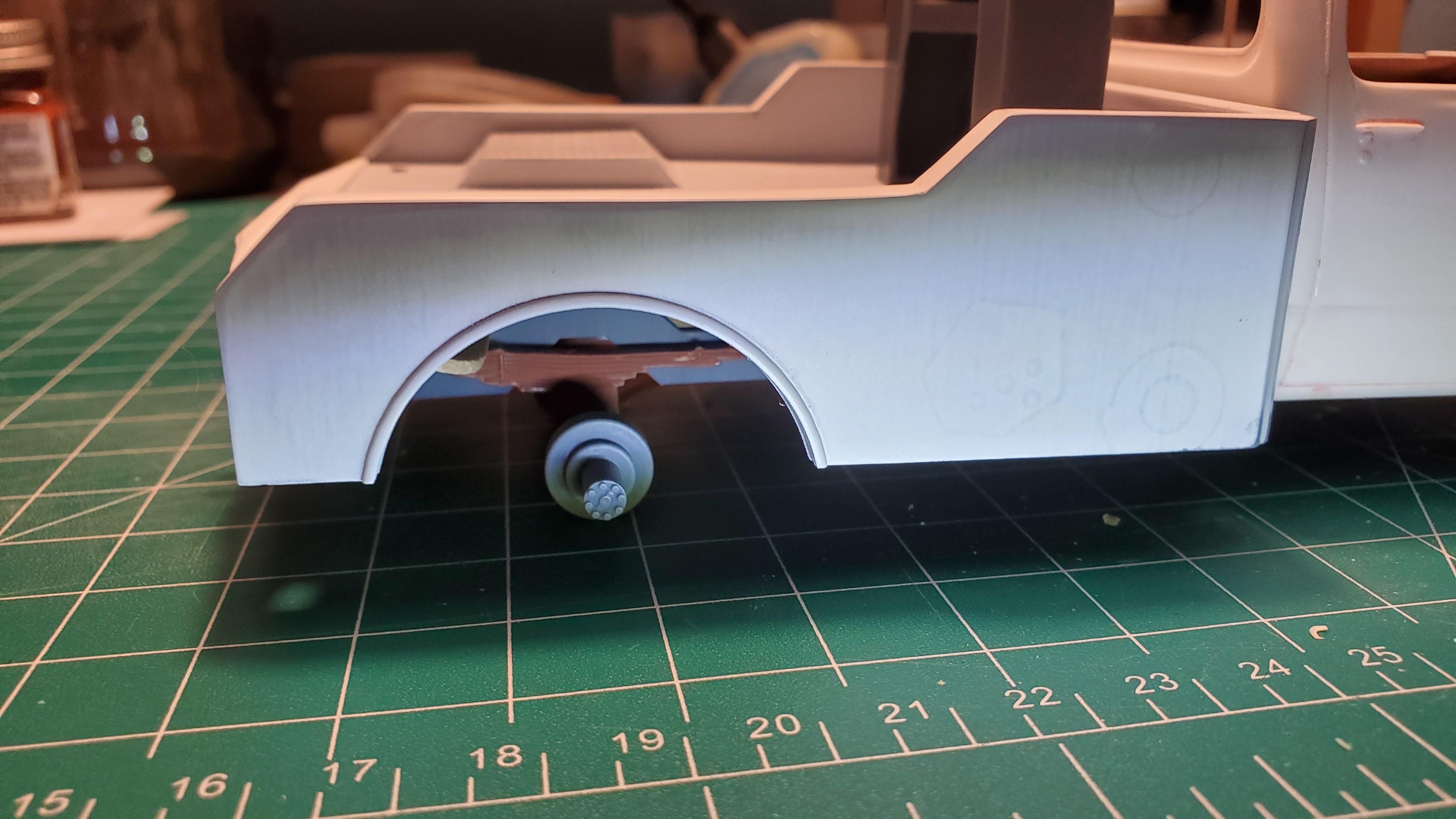

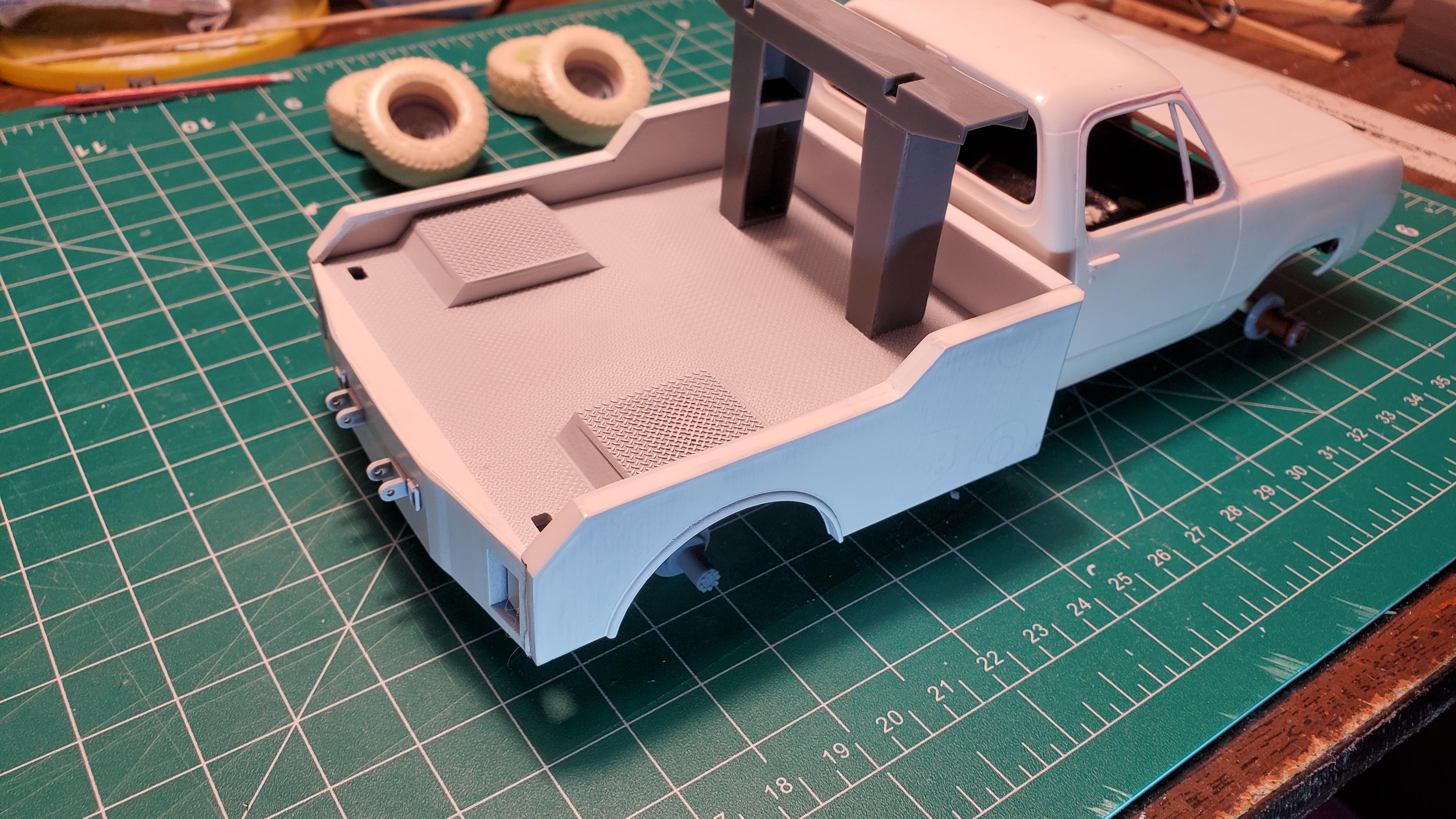

Steamboat Posted February 12, 2024 Author Posted February 12, 2024 Some progress on the wrecker bed. 95% of it is 3d printed from my own CAD files, including the bed floor, bed sides, kingpost, winch and towing hardware. I did use some styrene tubing and angle stock for the boom, and some styrene sheet for the bed rails. 3

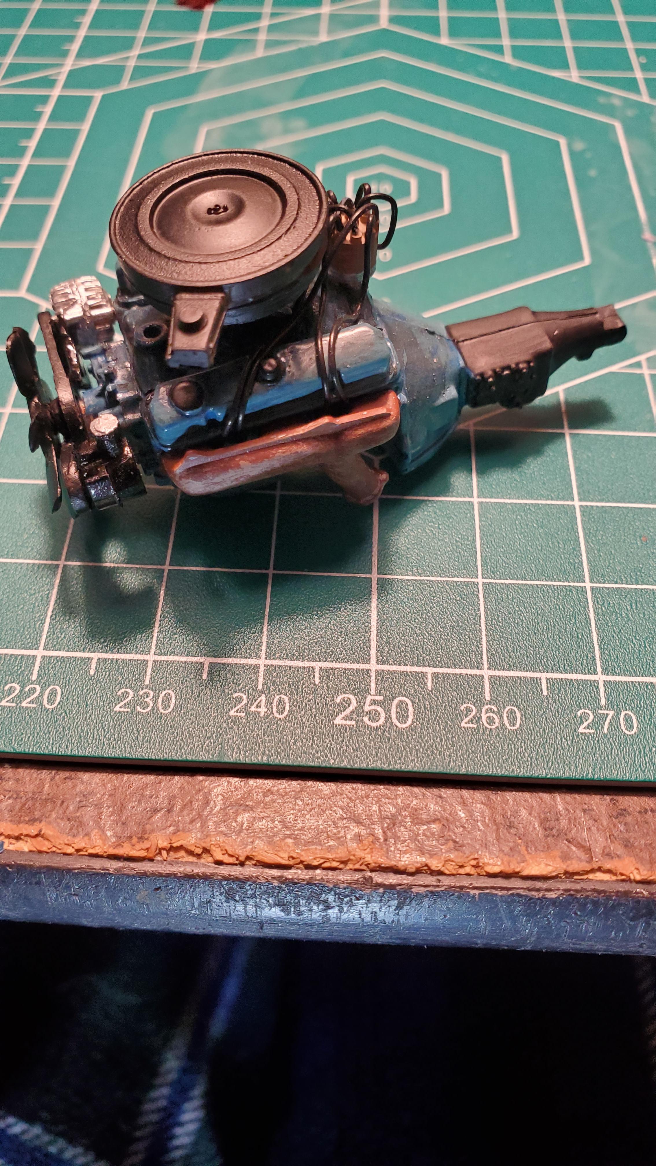

Steamboat Posted February 21, 2024 Author Posted February 21, 2024 I got some painting done on the dash and steering wheel. Also the engine is detailed and ready to go in. I used the air cleaner from the '71 Charger with one snorkel removed. Fan and belts are original to the truck. The alternator is from the Revell '69 Dart.
Aaronw Posted February 21, 2024 Posted February 21, 2024 On 2/12/2024 at 3:29 PM, Steamboat said: Some progress on the wrecker bed. 95% of it is 3d printed from my own CAD files, including the bed floor, bed sides, kingpost, winch and towing hardware. I did use some styrene tubing and angle stock for the boom, and some styrene sheet for the bed rails. Nice to see you made all this. I initially expected it to be the wrecker bed from the Midnite cowboy kit with the weird mini "Peterbilt" cab.
Steamboat Posted February 21, 2024 Author Posted February 21, 2024 6 minutes ago, Aaronw said: Nice to see you made all this. I initially expected it to be the wrecker bed from the Midnite cowboy kit with the weird mini "Peterbilt" cab. A friend gave me the Midnight Cowboy kit when I started this project. Not much there that is the same. I decided that I wanted to make it as close to possible to the 1:1, so I ended up making a lot of my own parts.

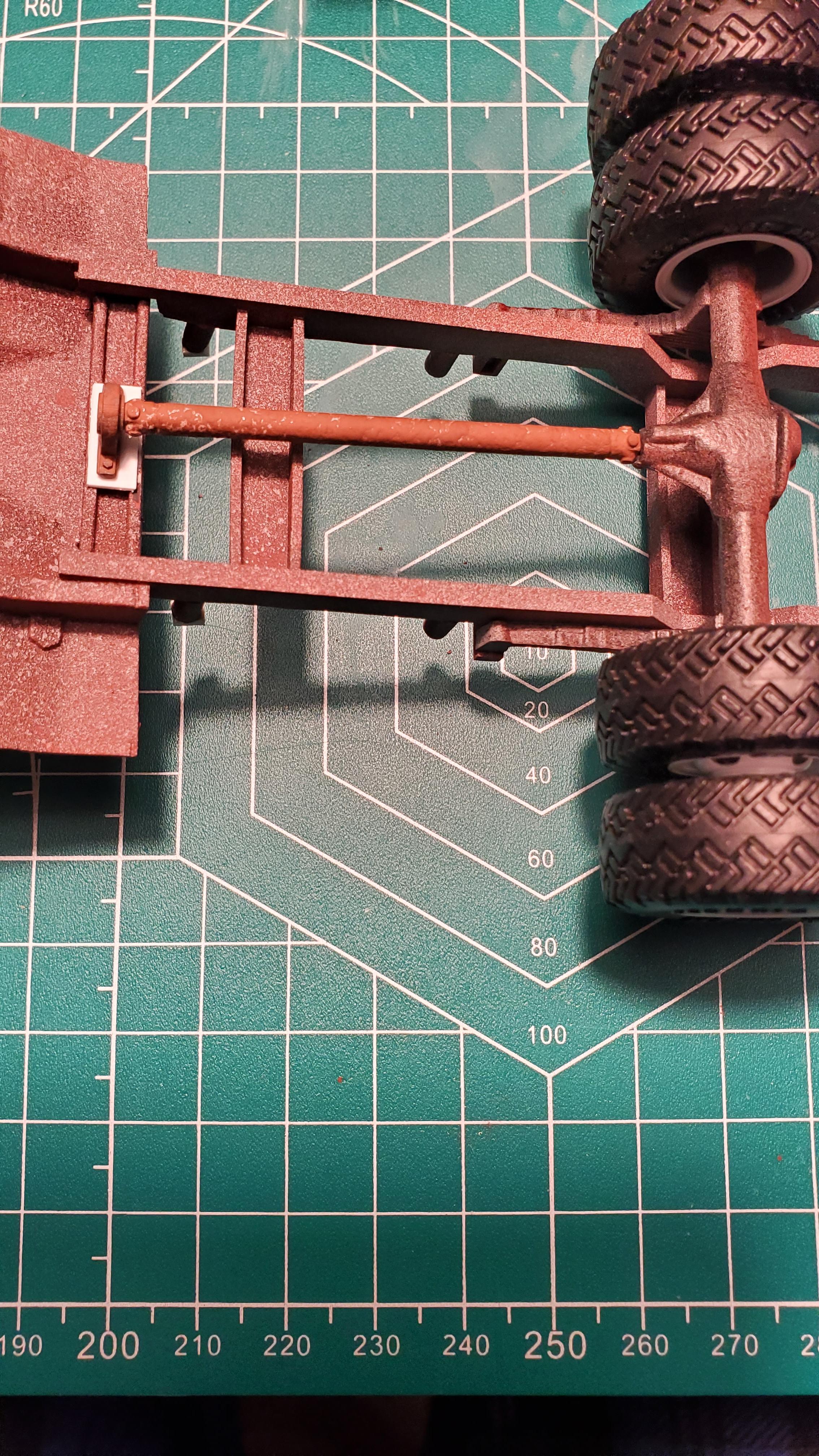

Steamboat Posted February 23, 2024 Author Posted February 23, 2024 I added a carrier bearing for the driveshafts. It looked like it needed one.
