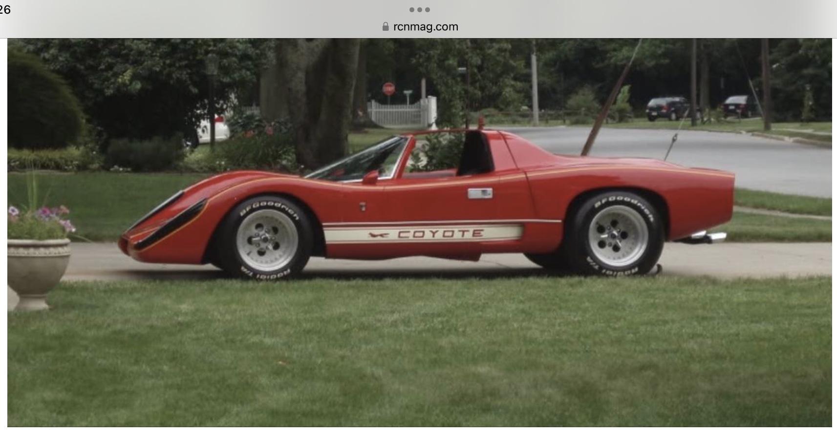

vamach1 Posted January 26, 2024 Posted January 26, 2024 (edited) Someone at MPC product planning must have said that Ford MKIV chassis could pass for a VW based kit car chassis. It’s not like kids buying kits would know was the thinking at the time I guess. Another source says they used a modified VW engine and not one from a Porsche. The sound was dubbed in to make it sound more powerful. This YouTube video corrects a lot of the misinformation about the cars. Edited January 26, 2024 by vamach1 2
Scale-Master Posted January 26, 2024 Author Posted January 26, 2024 Yes, that is one of the better info videos. You can see the difference between the first and other season cars in the two photos you shared. 1
