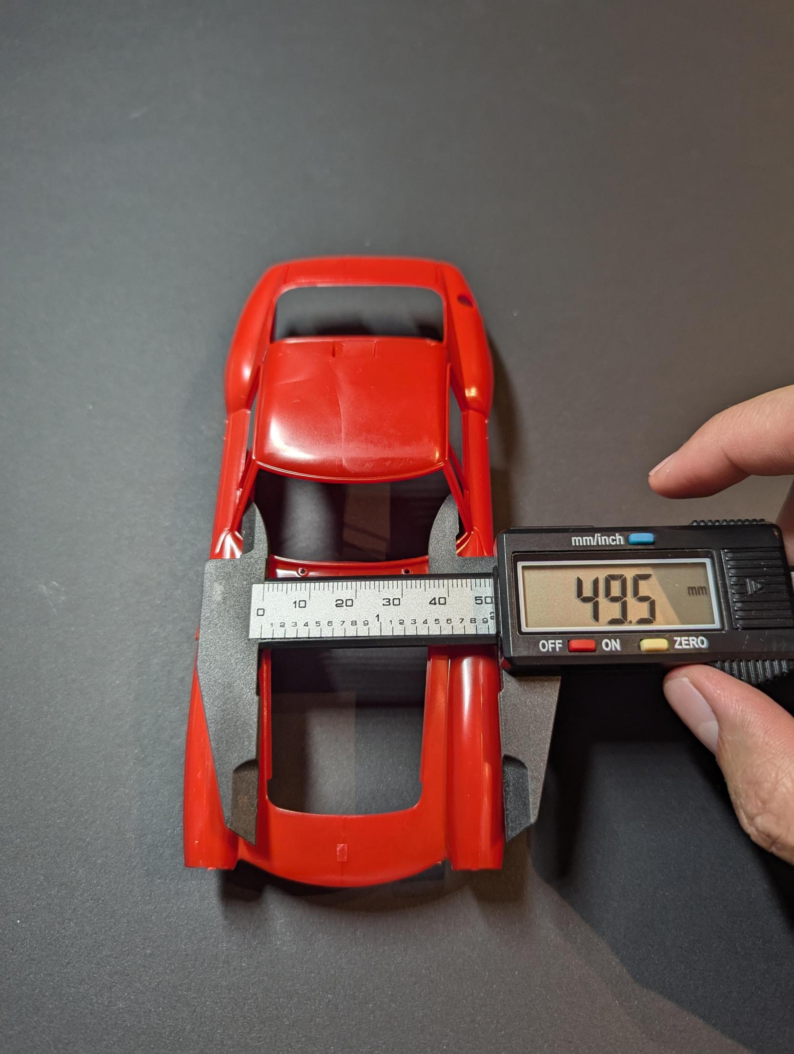

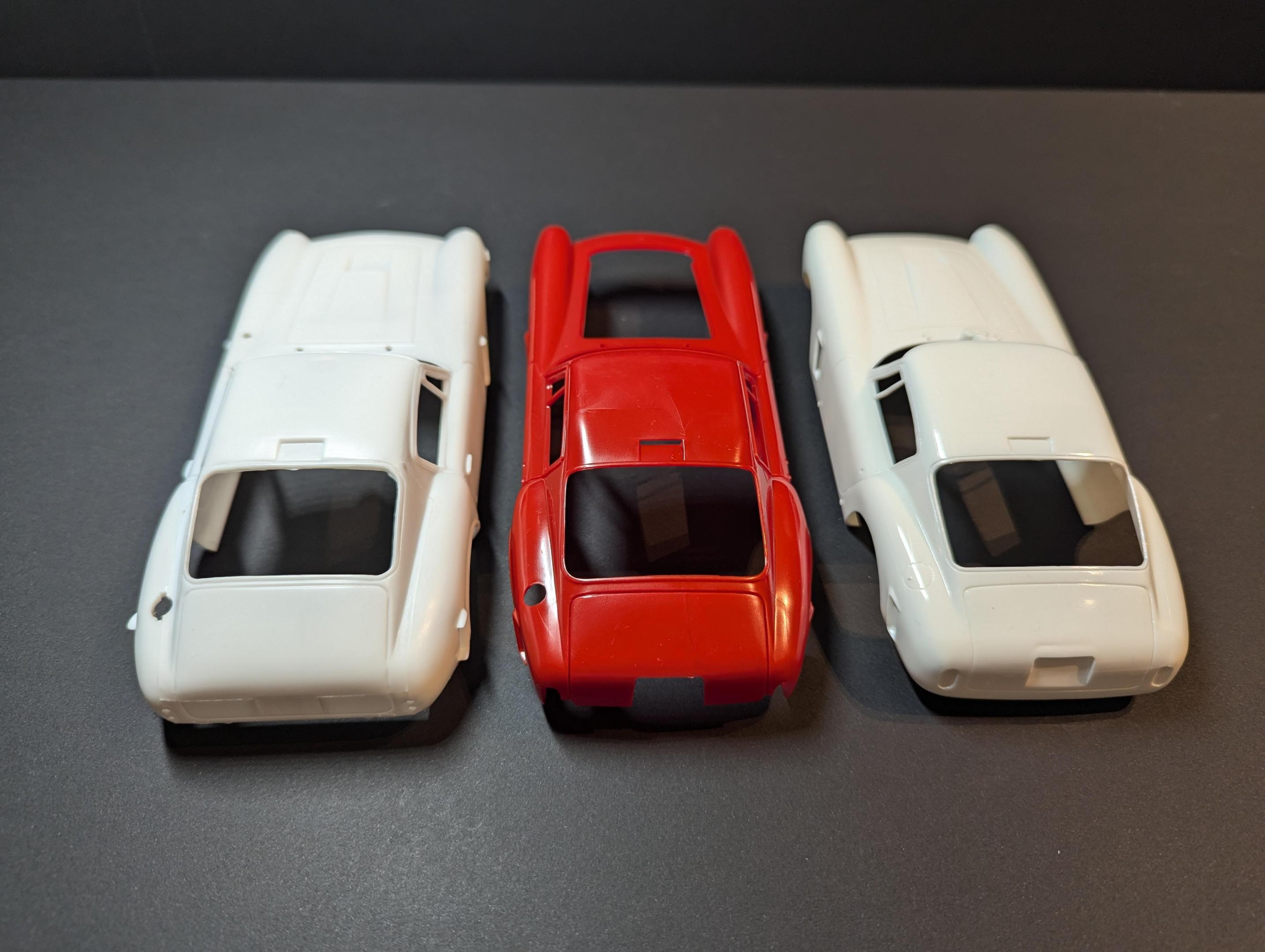

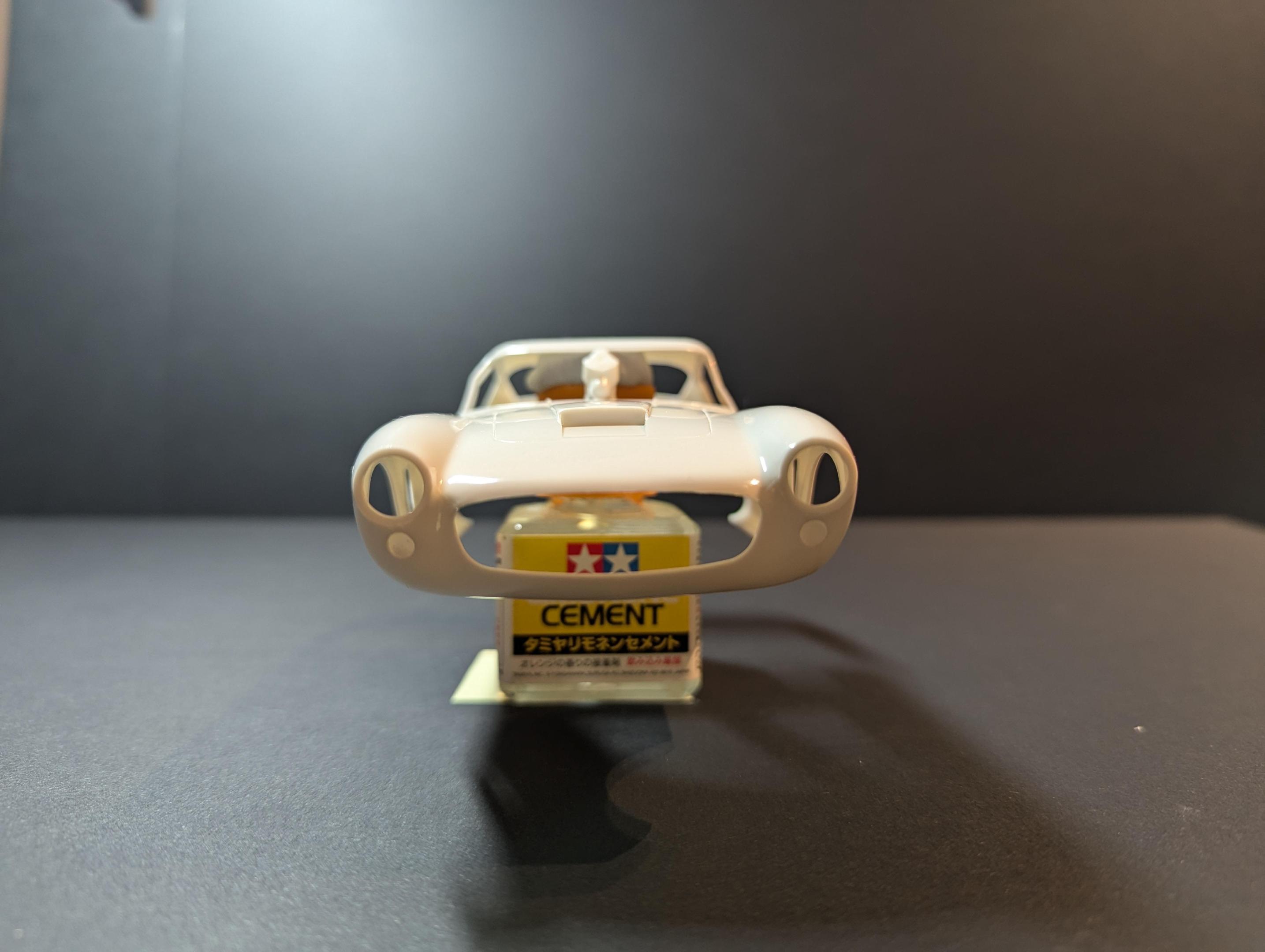

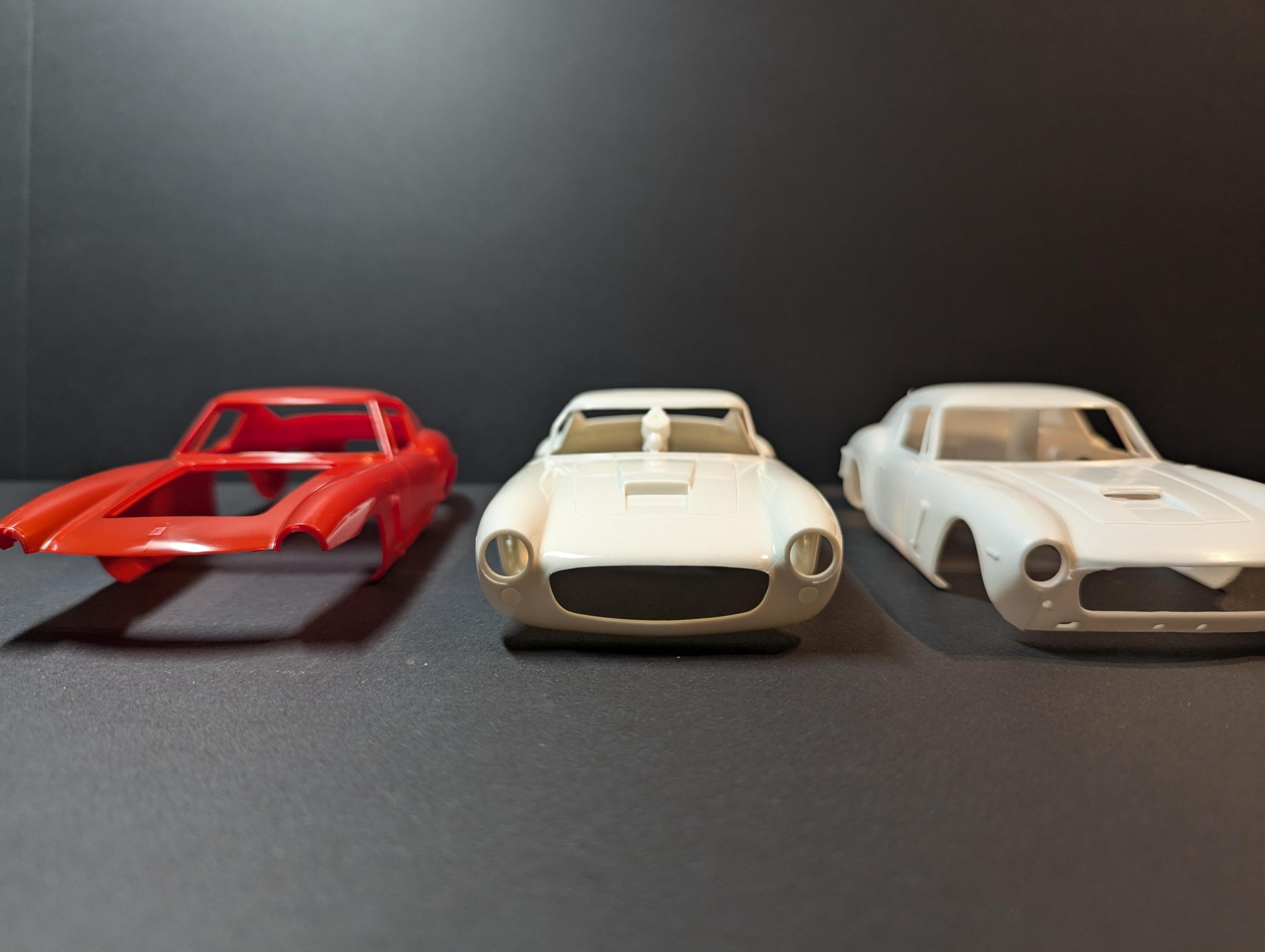

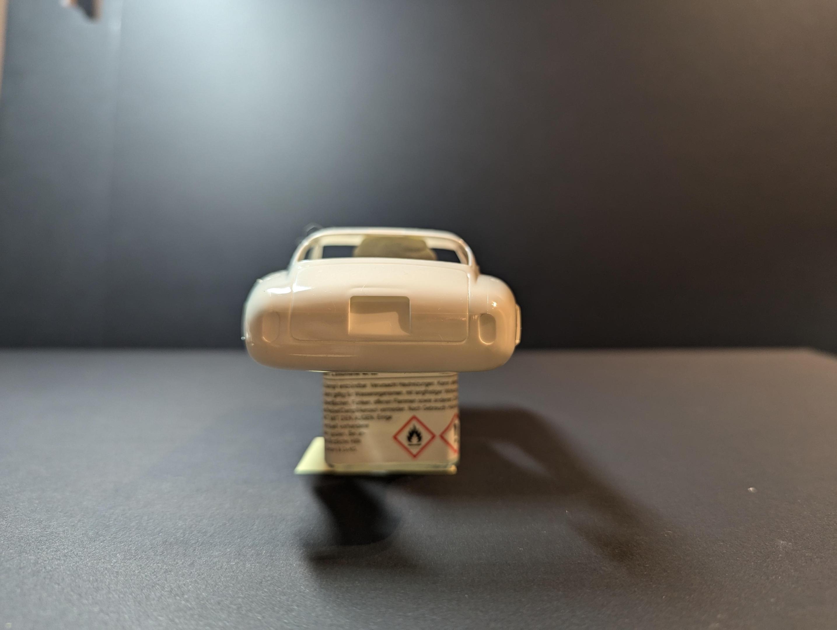

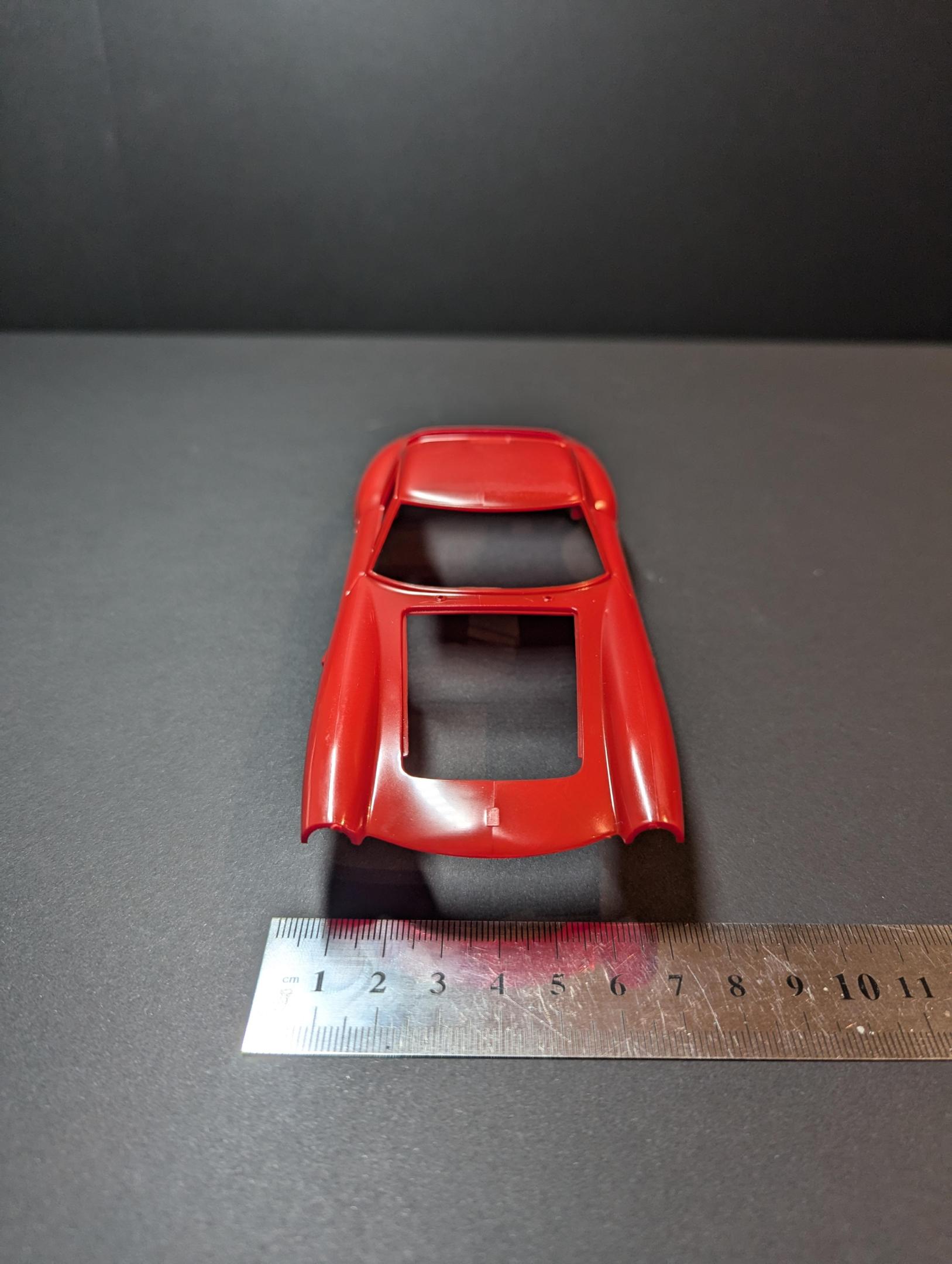

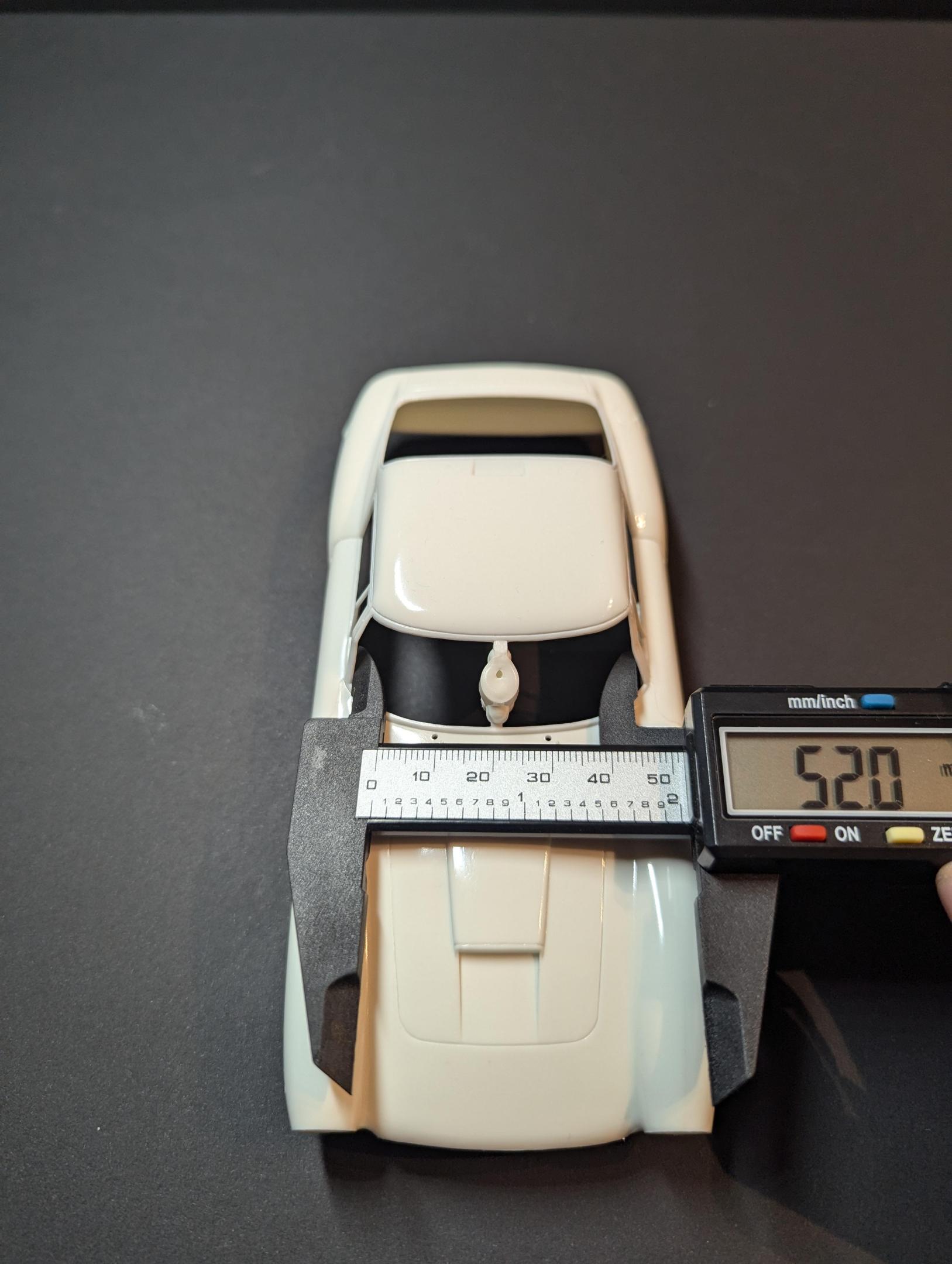

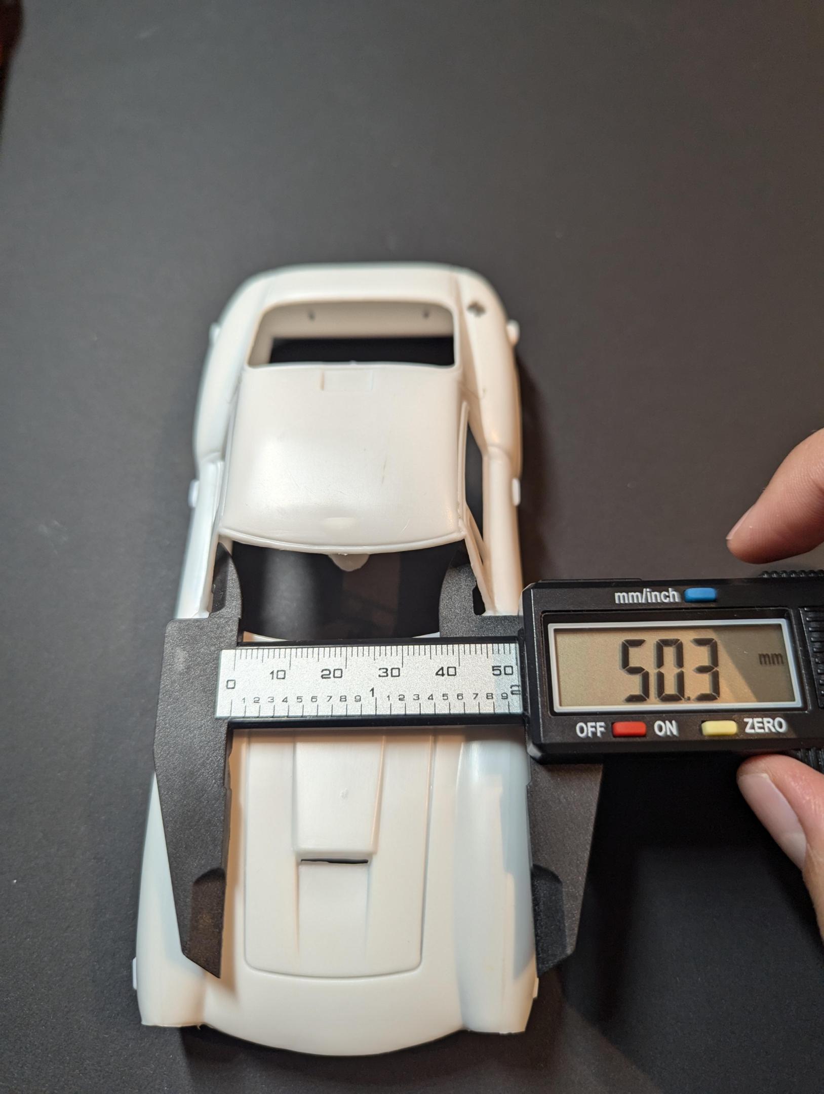

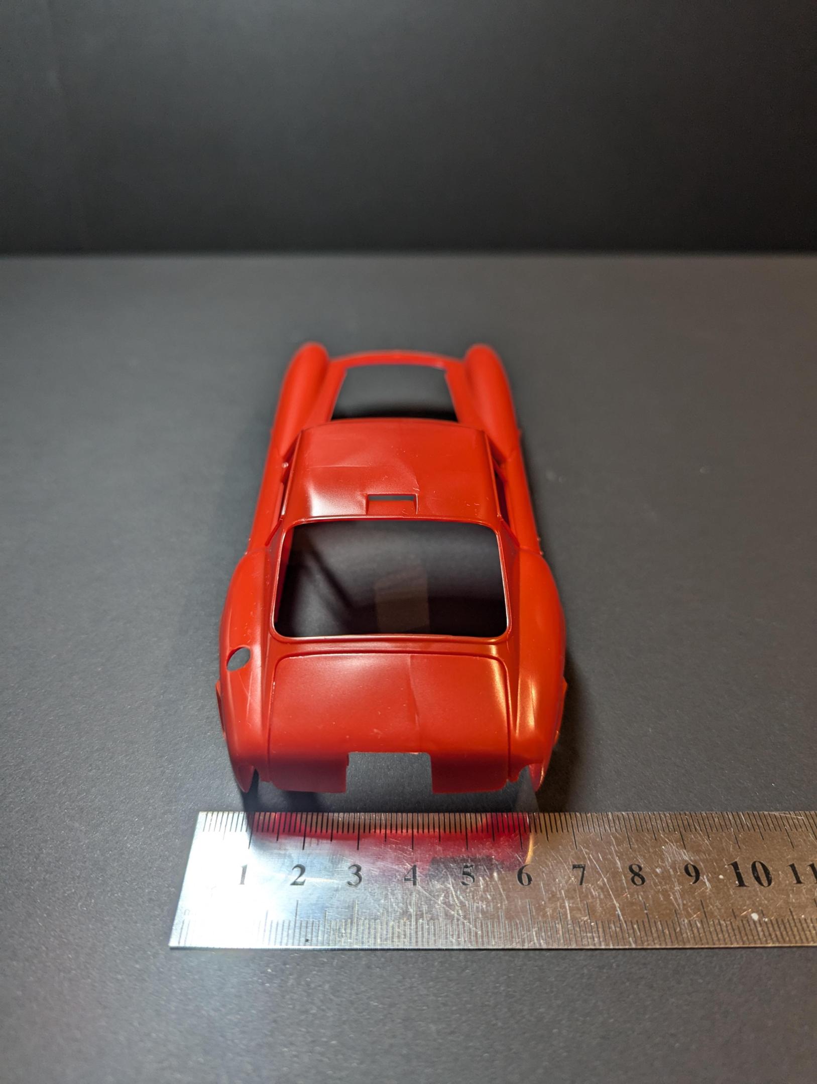

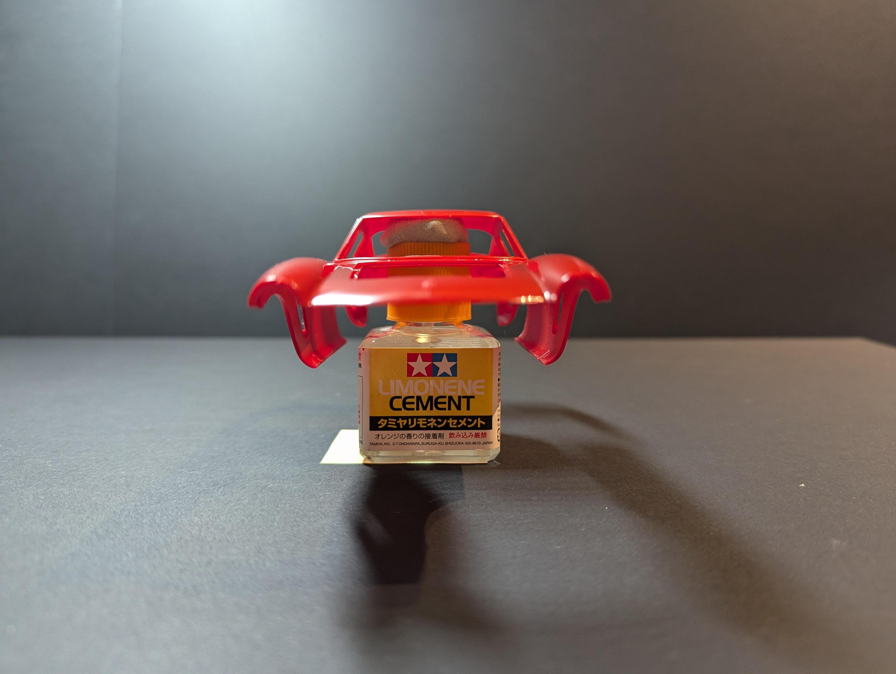

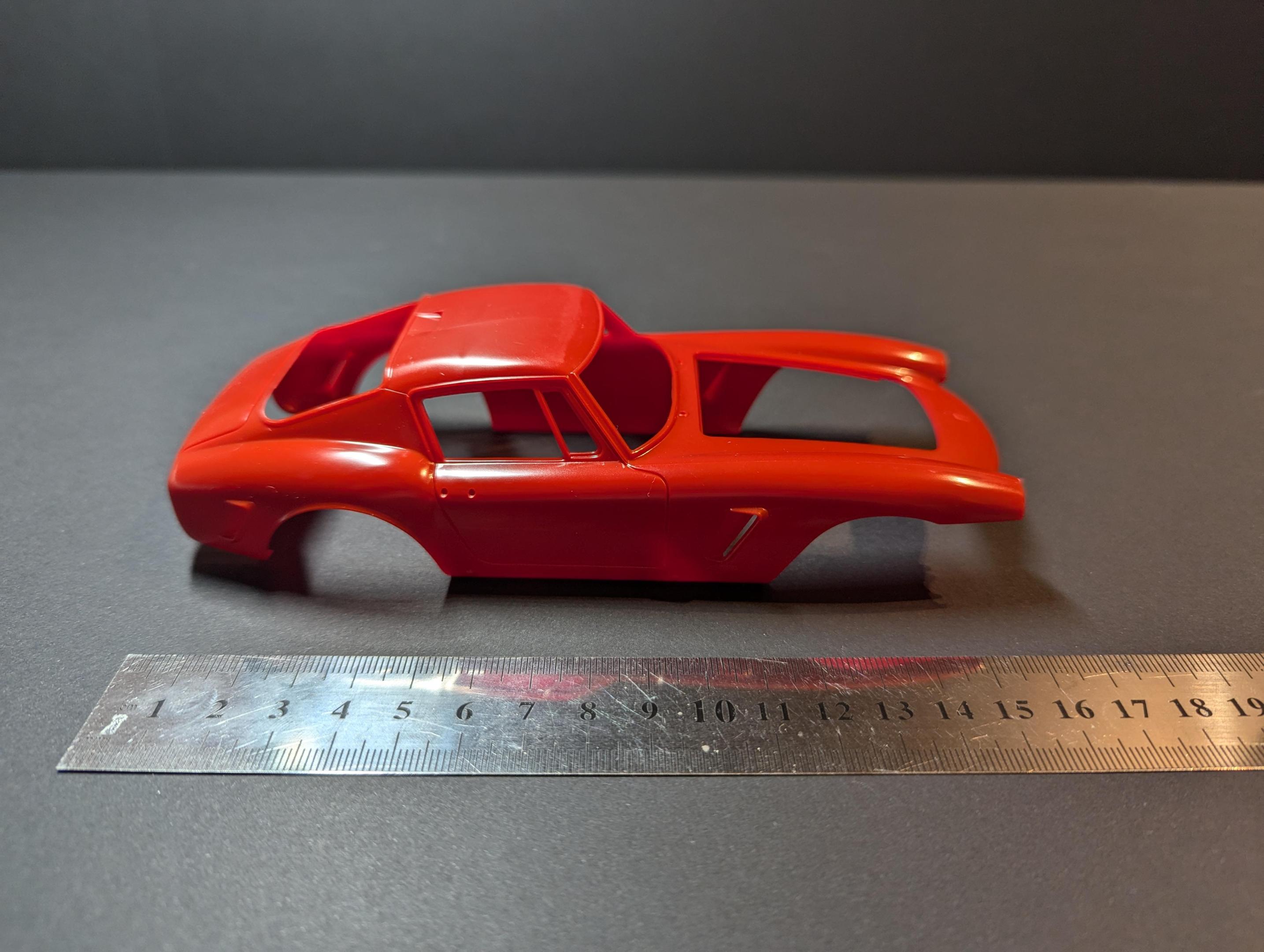

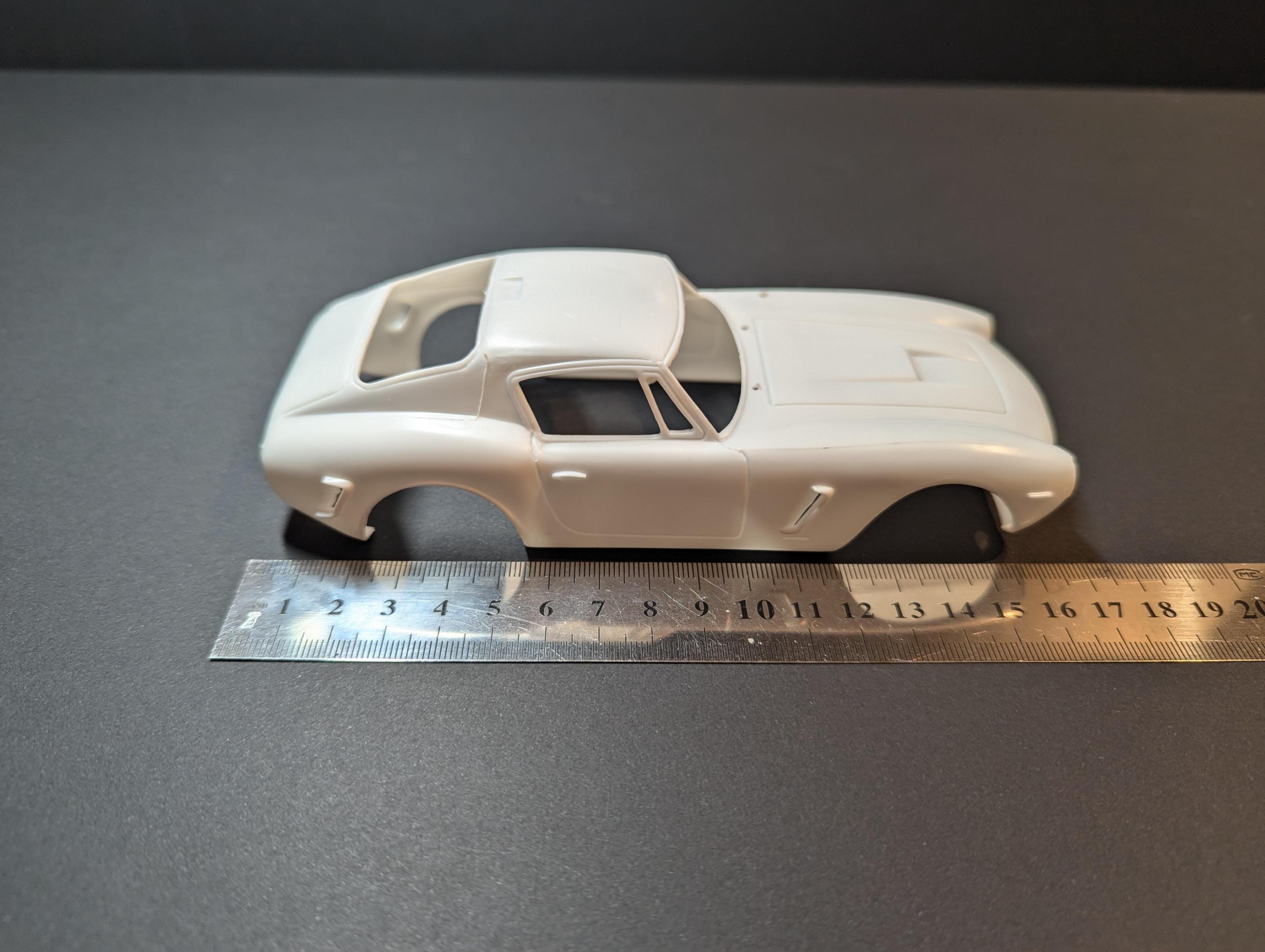

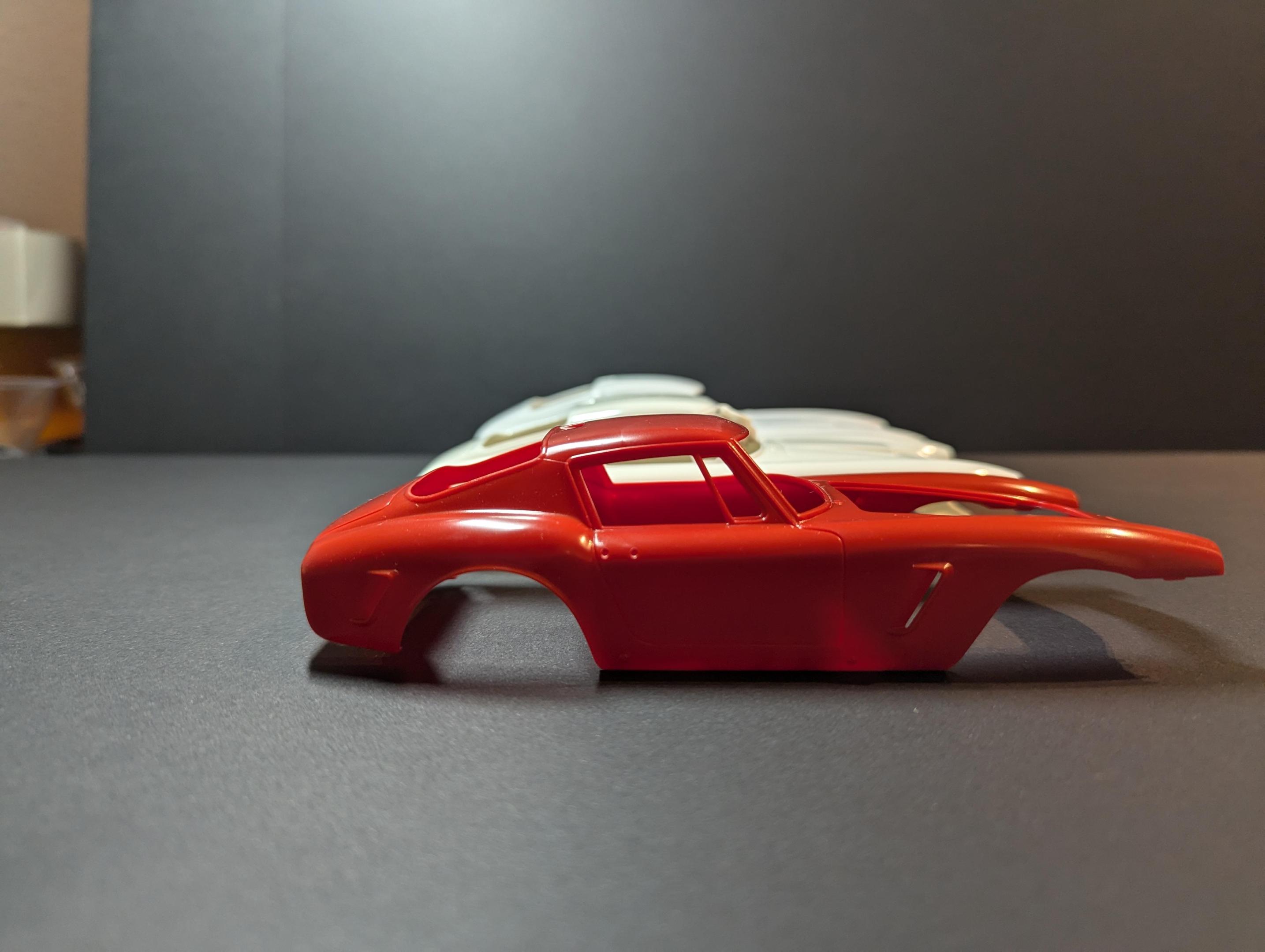

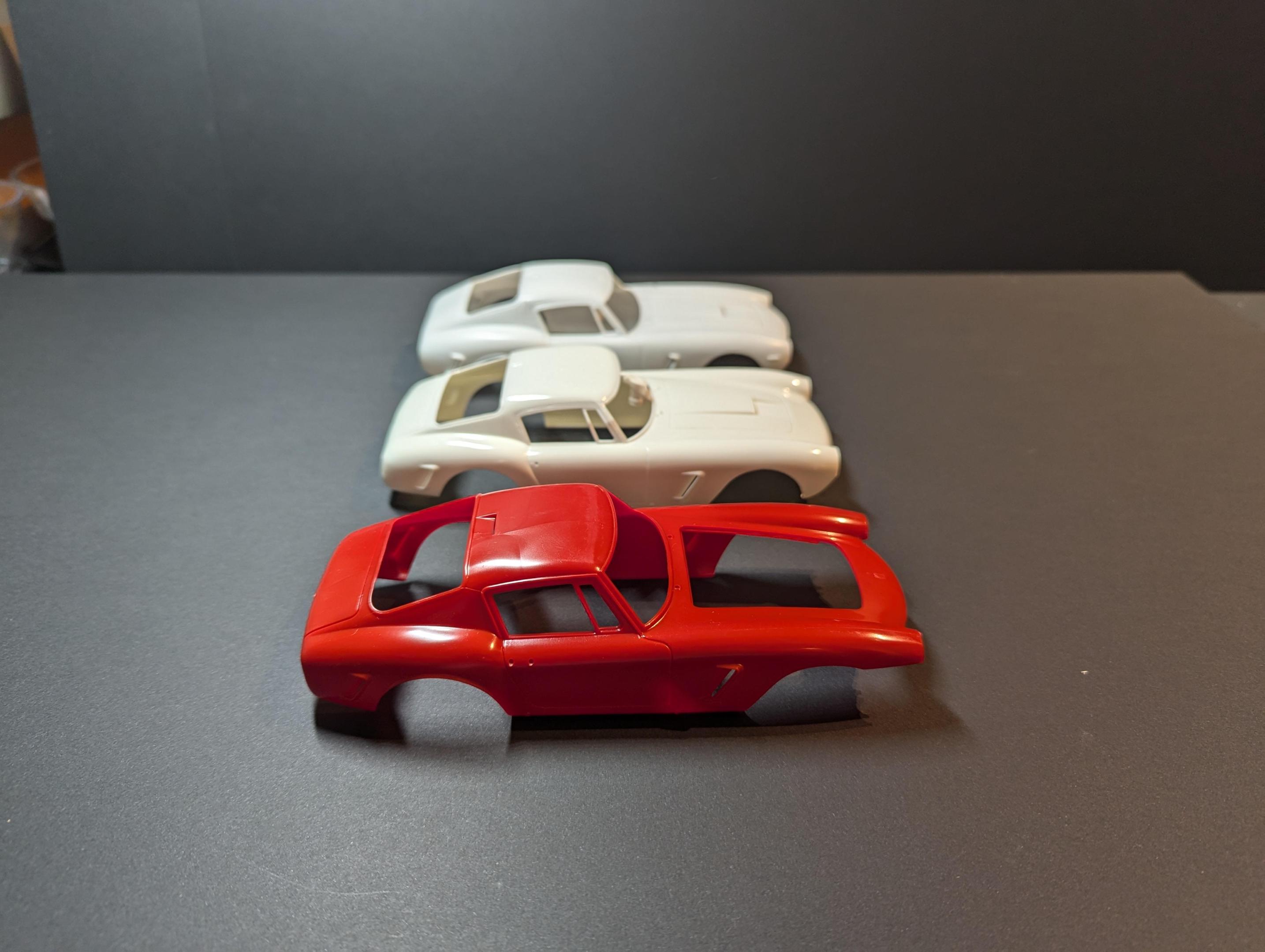

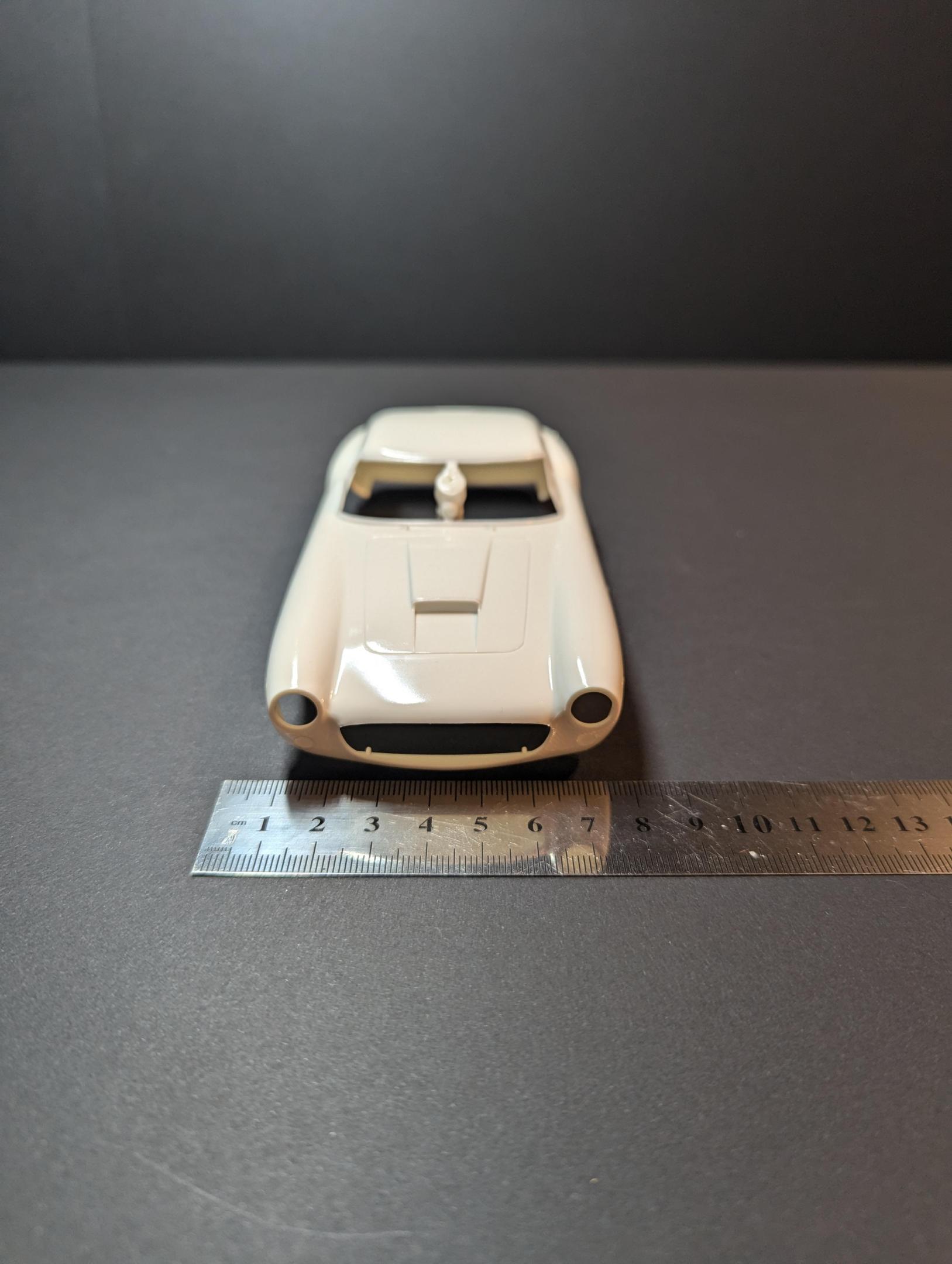

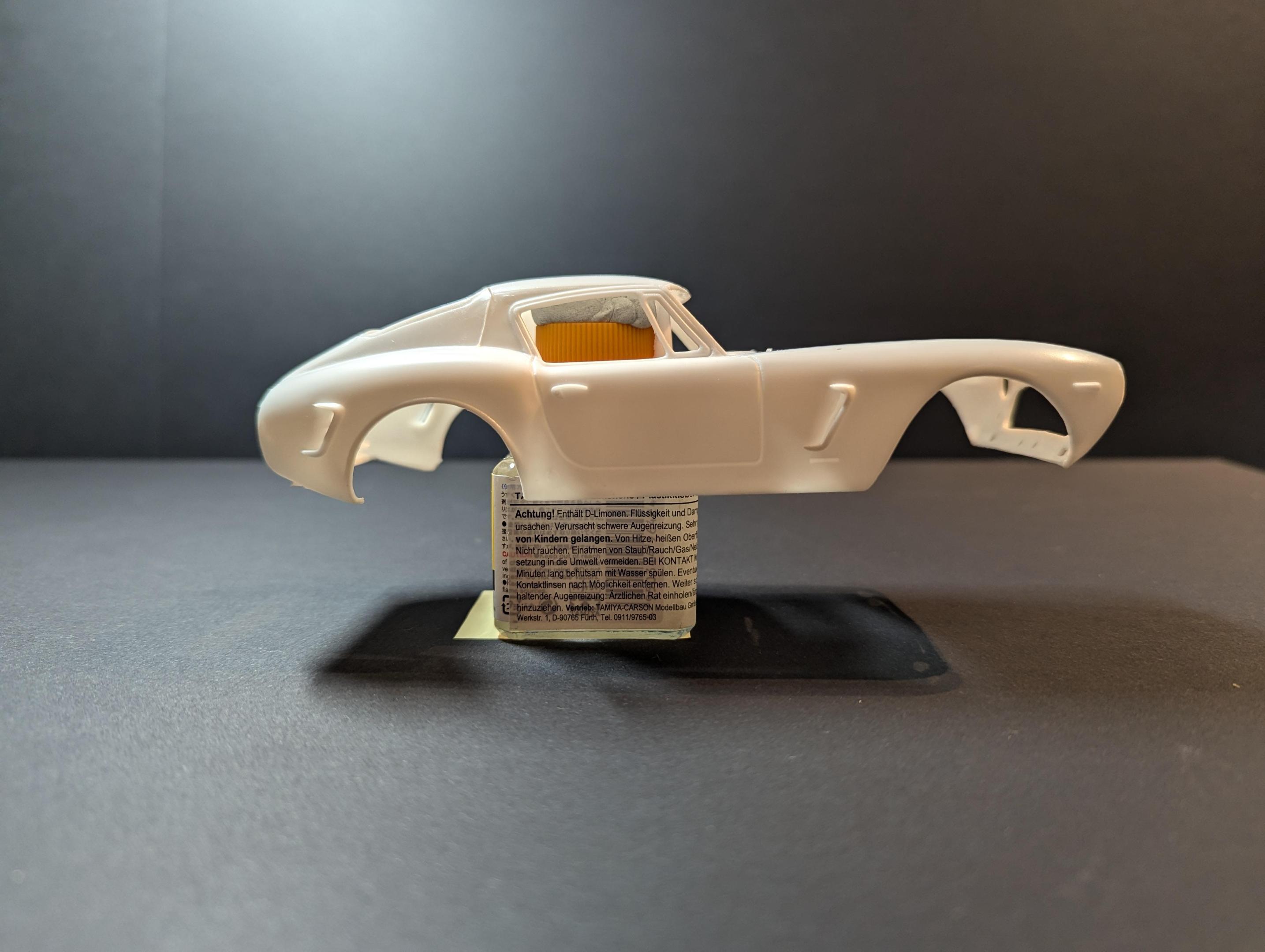

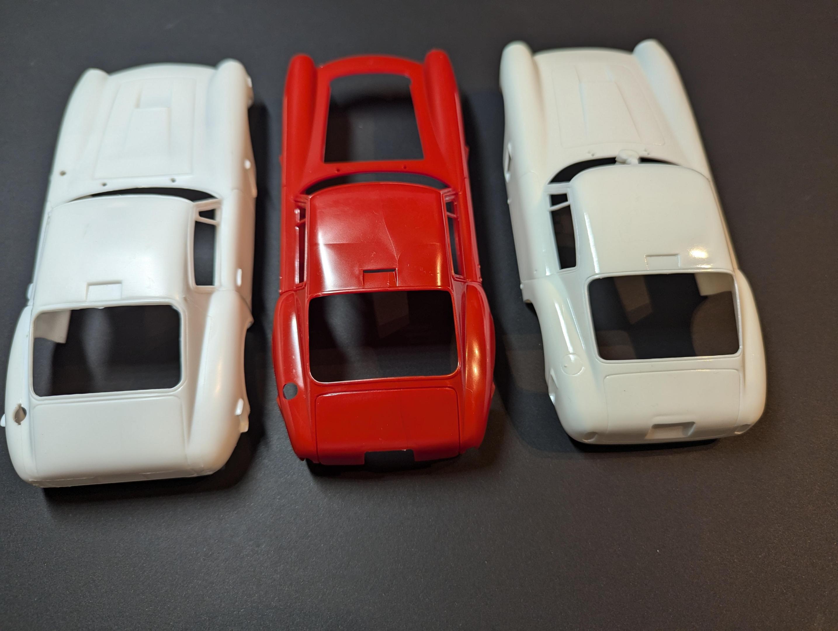

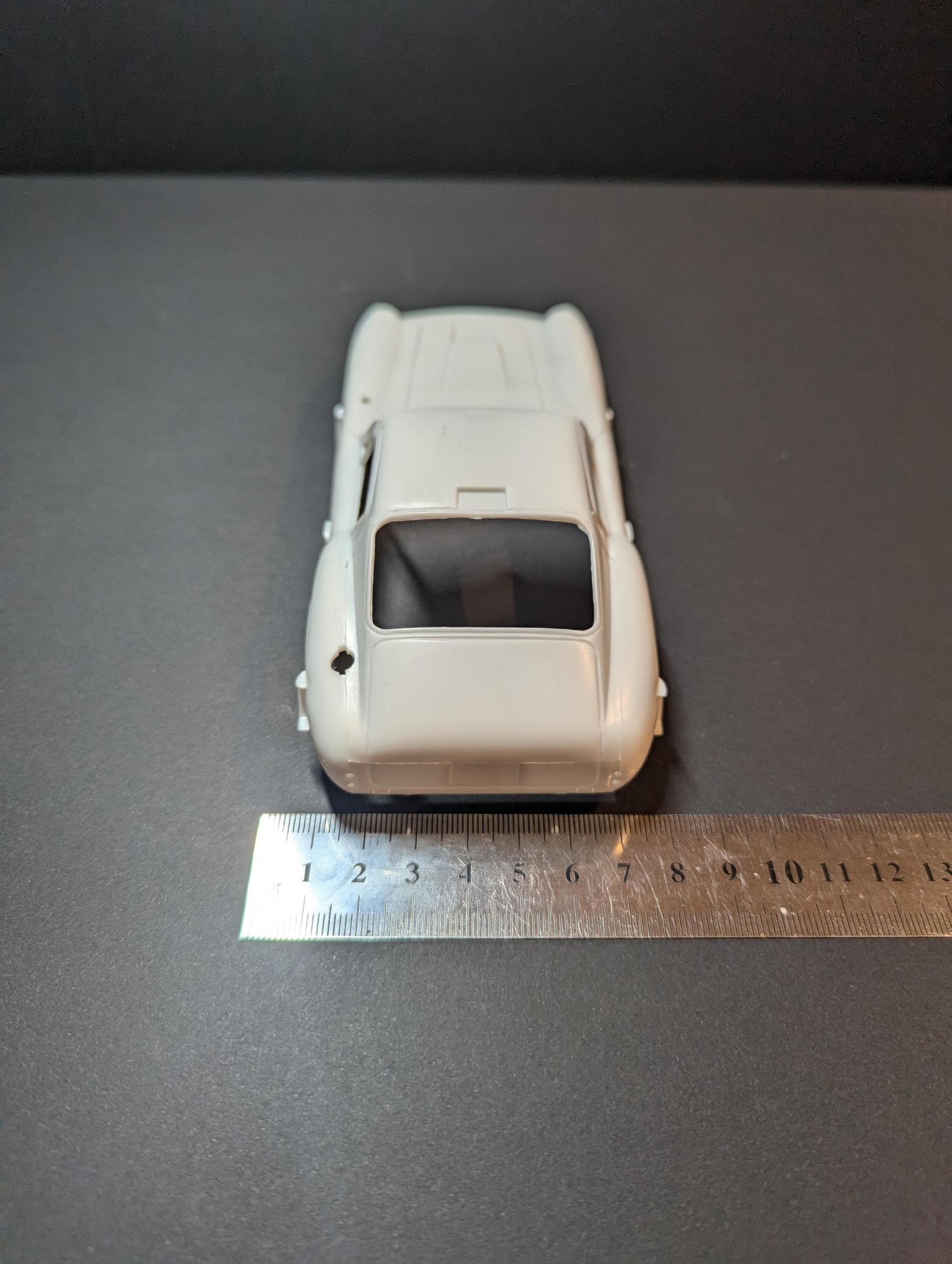

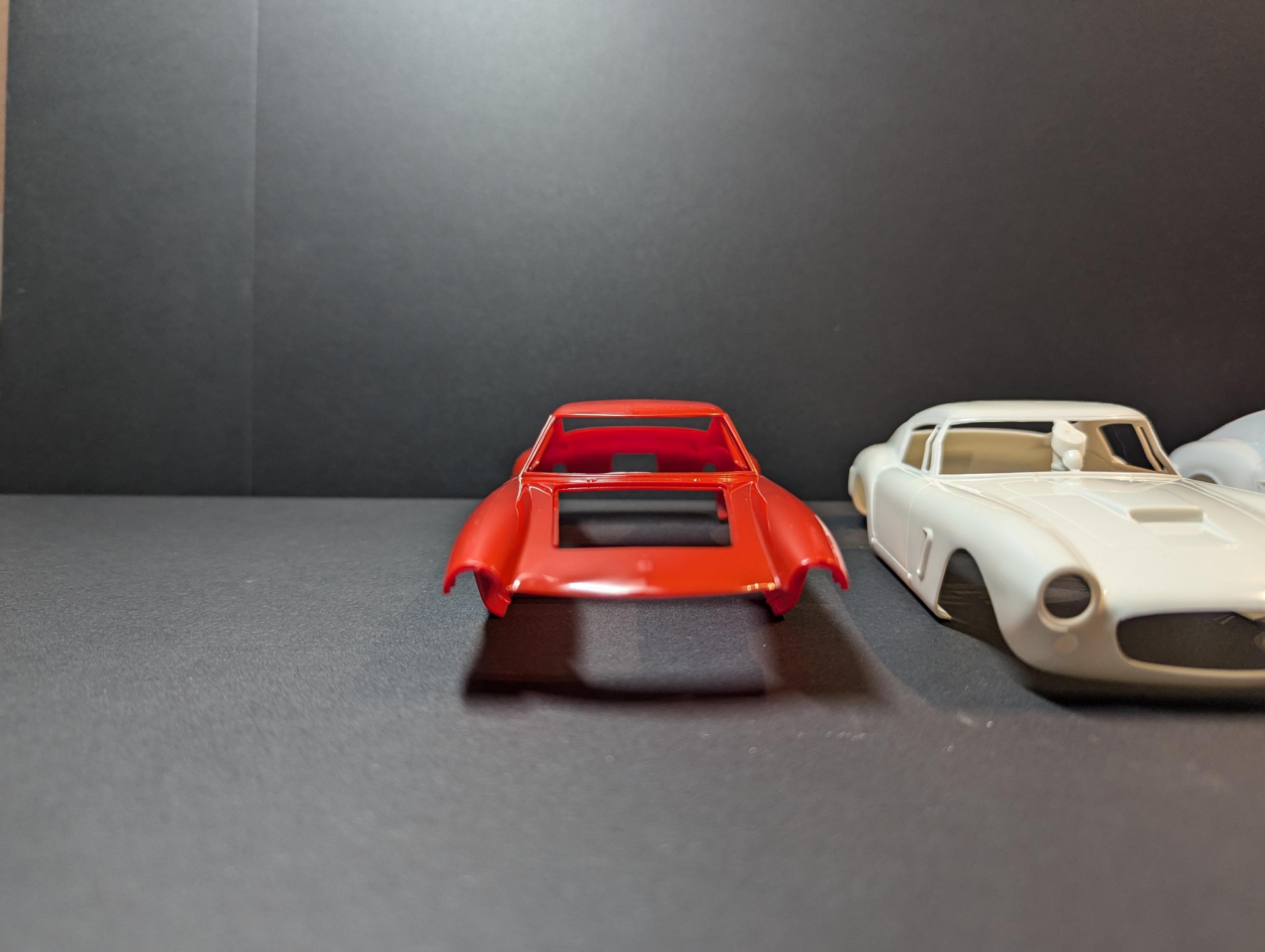

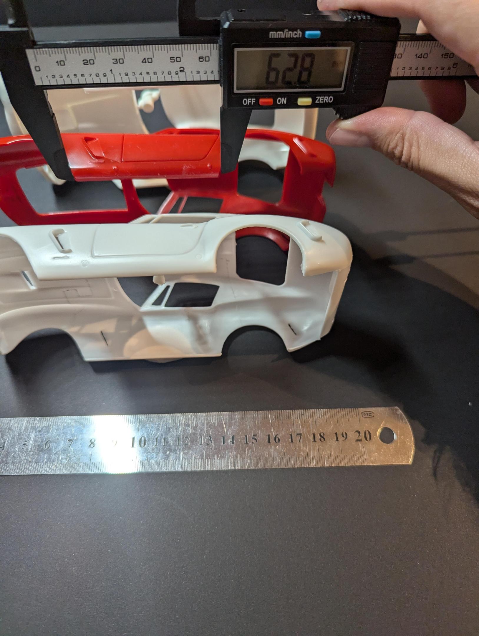

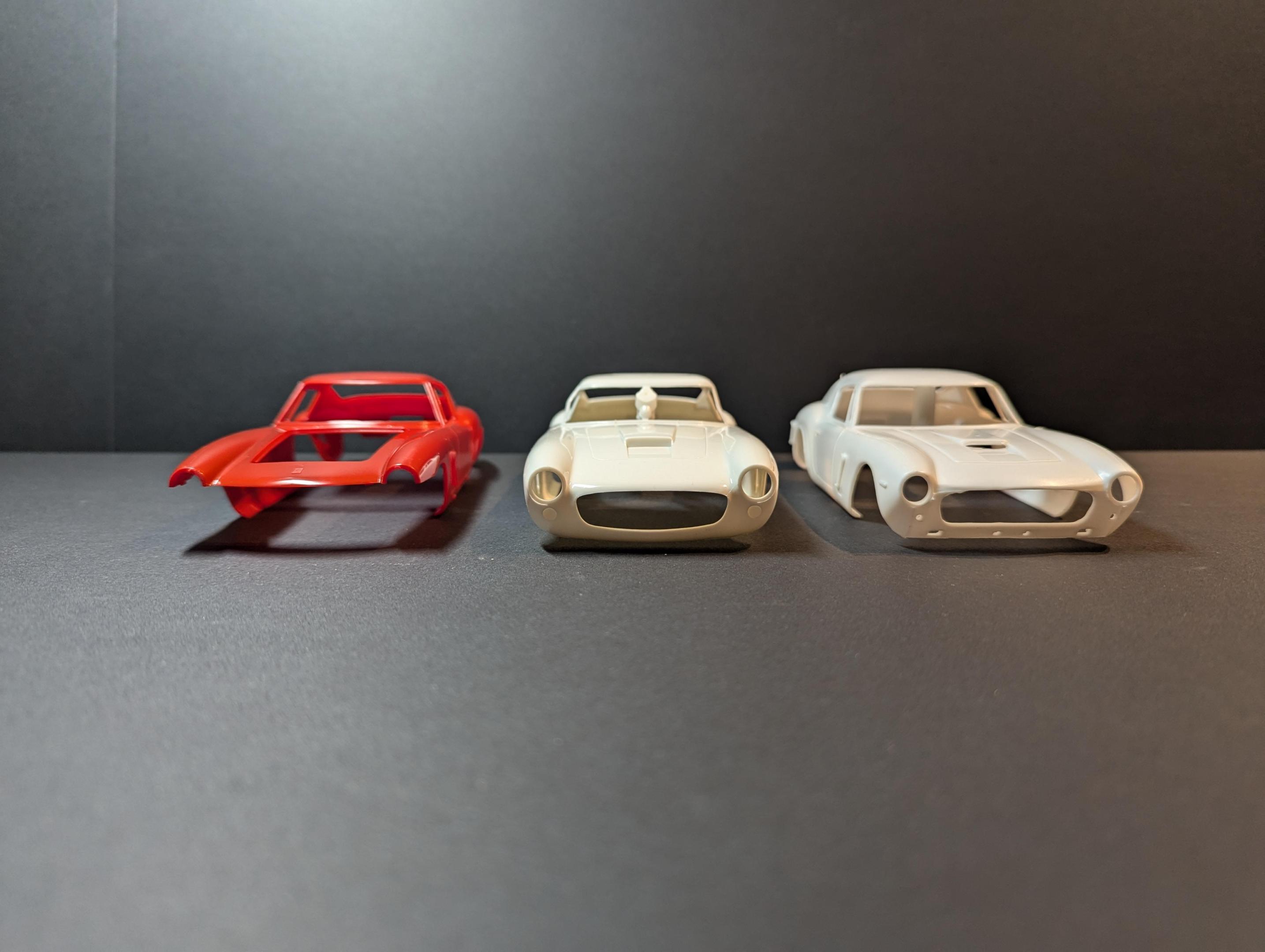

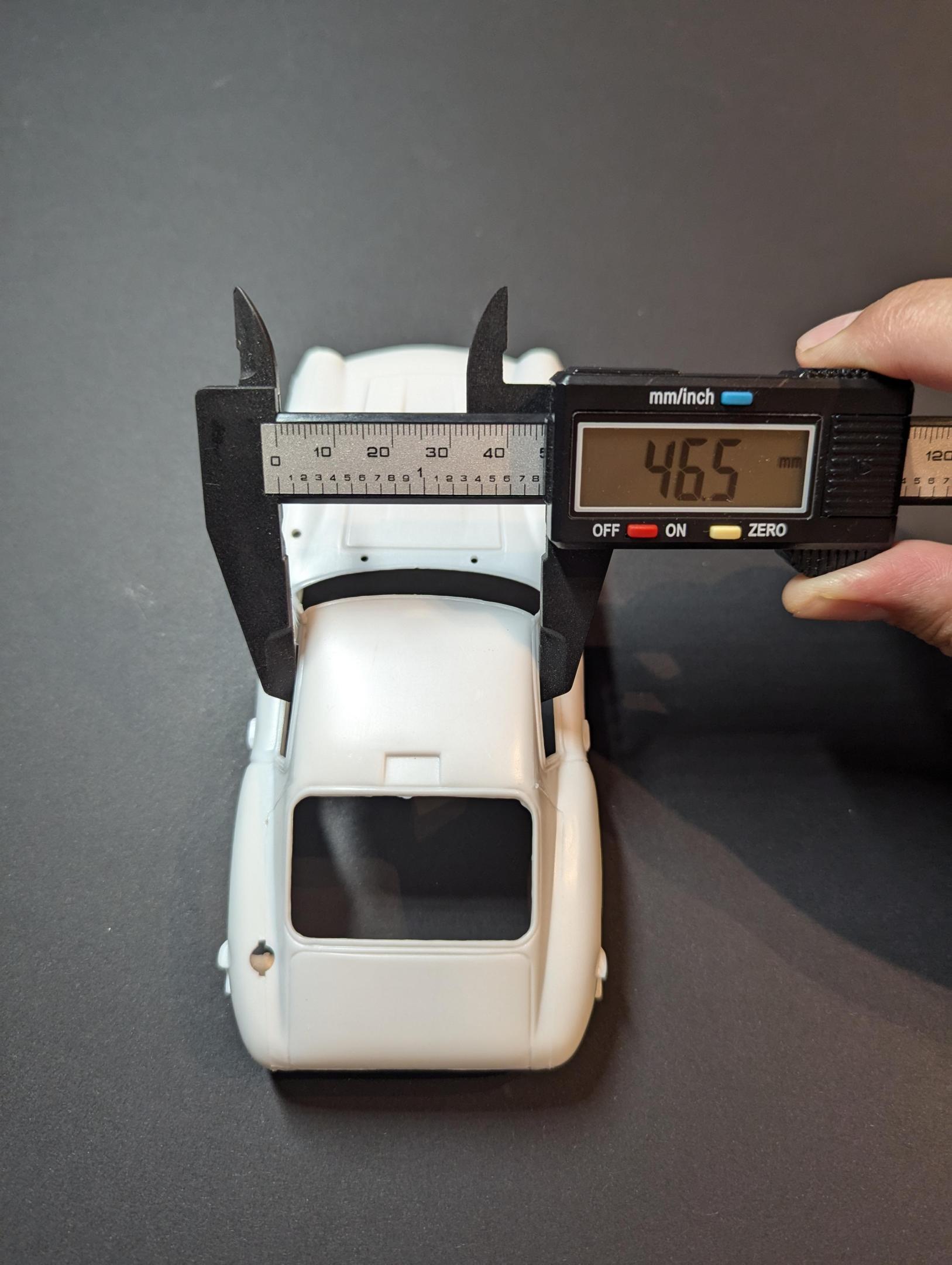

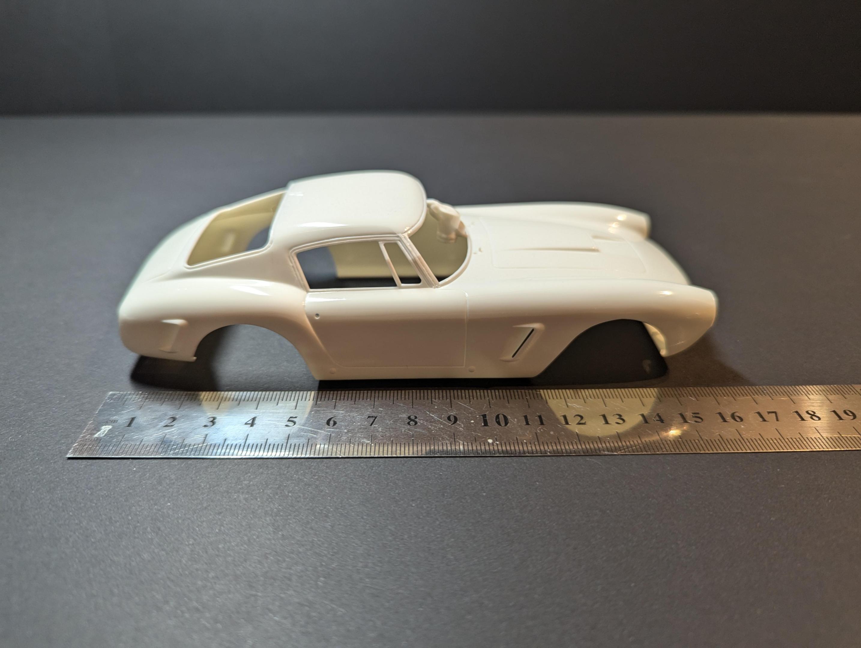

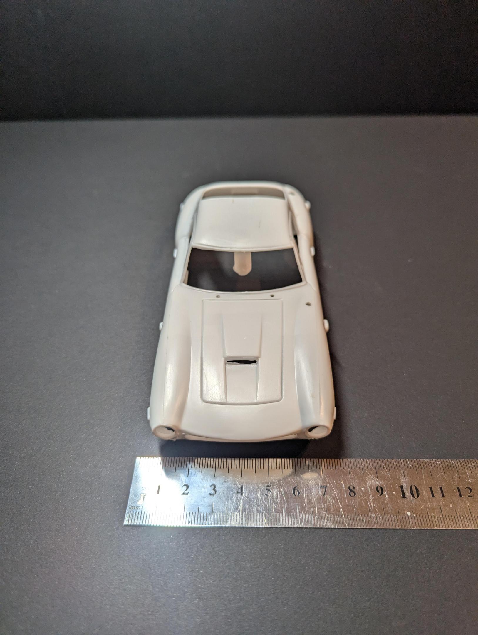

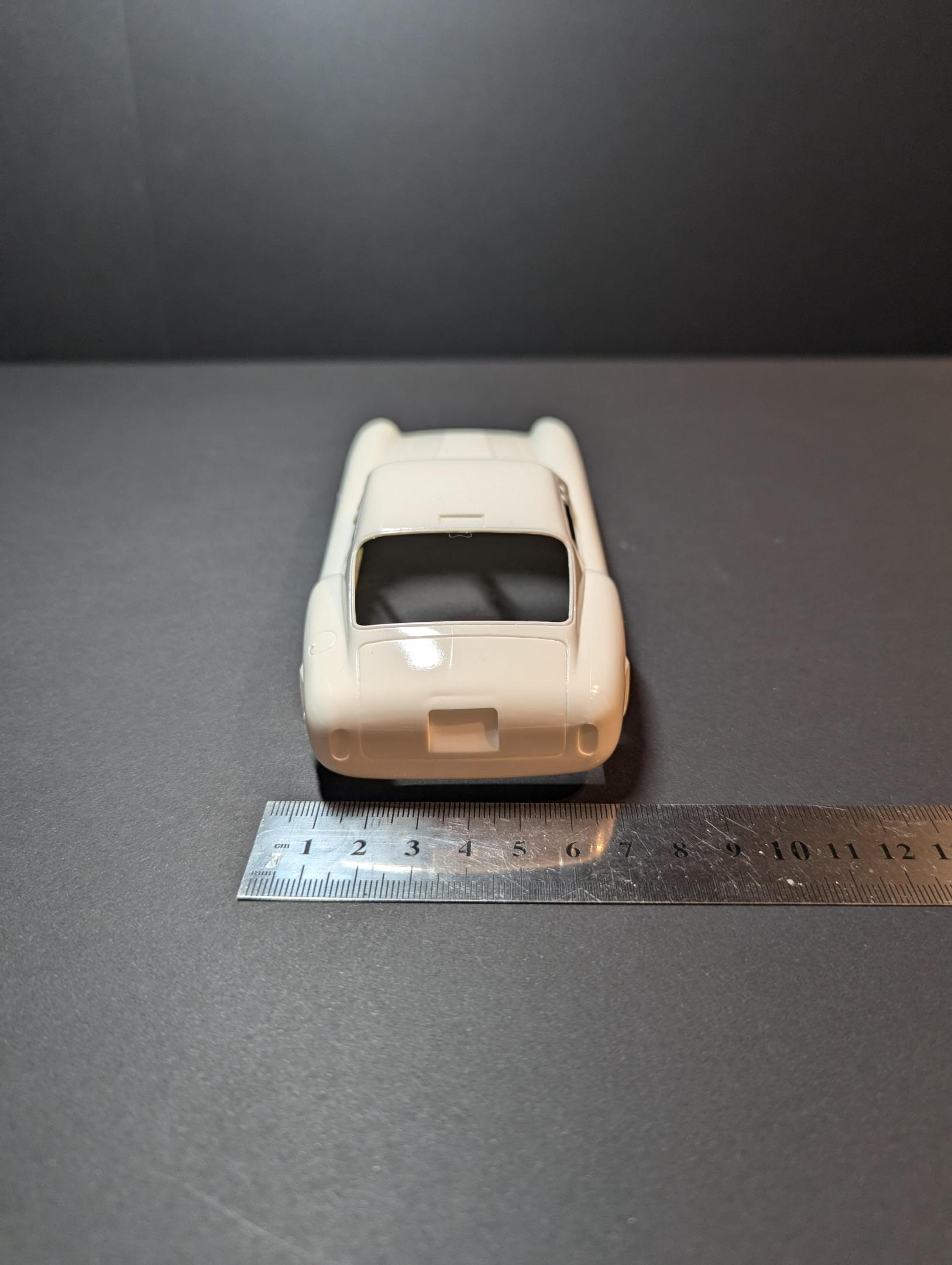

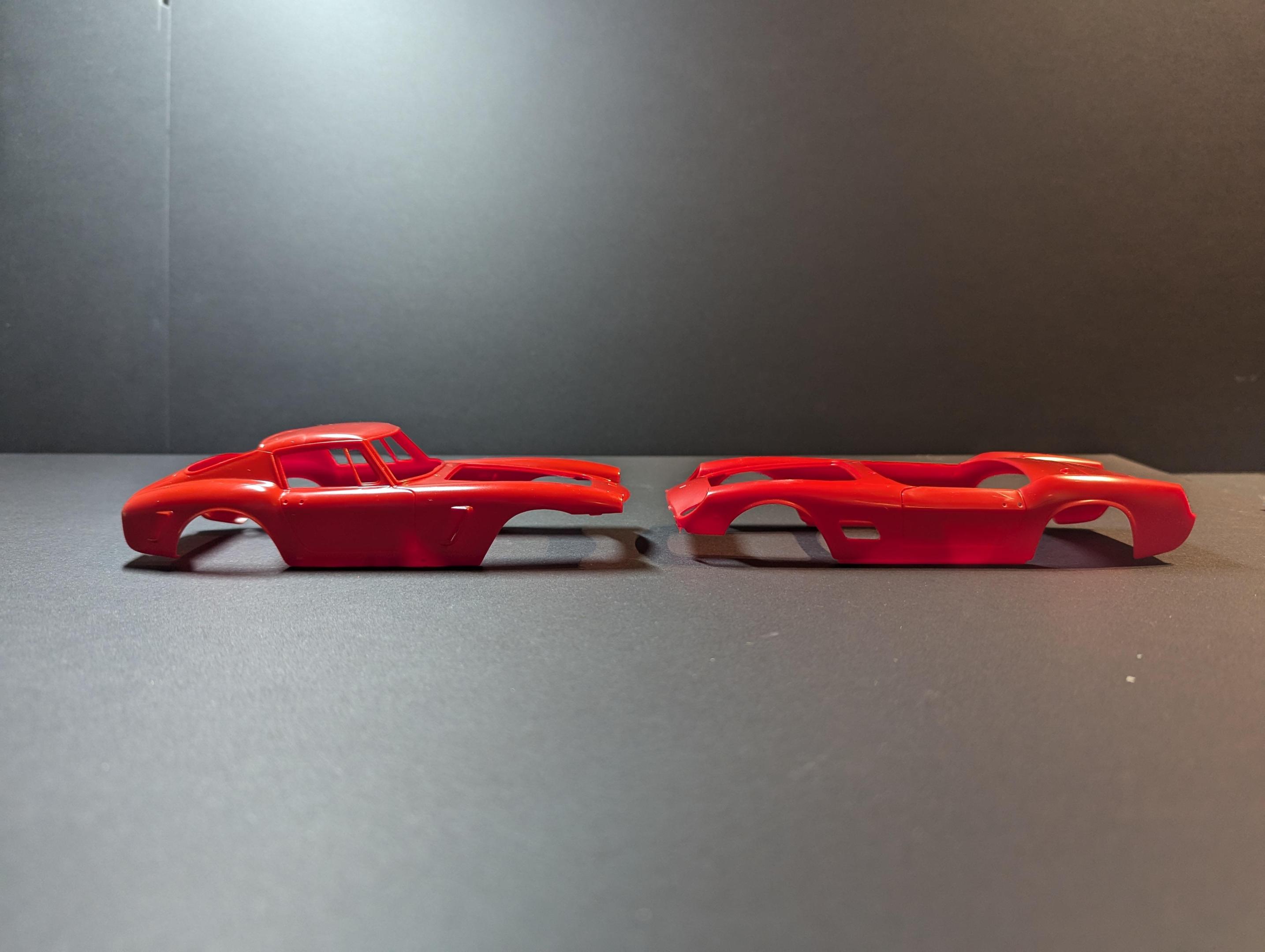

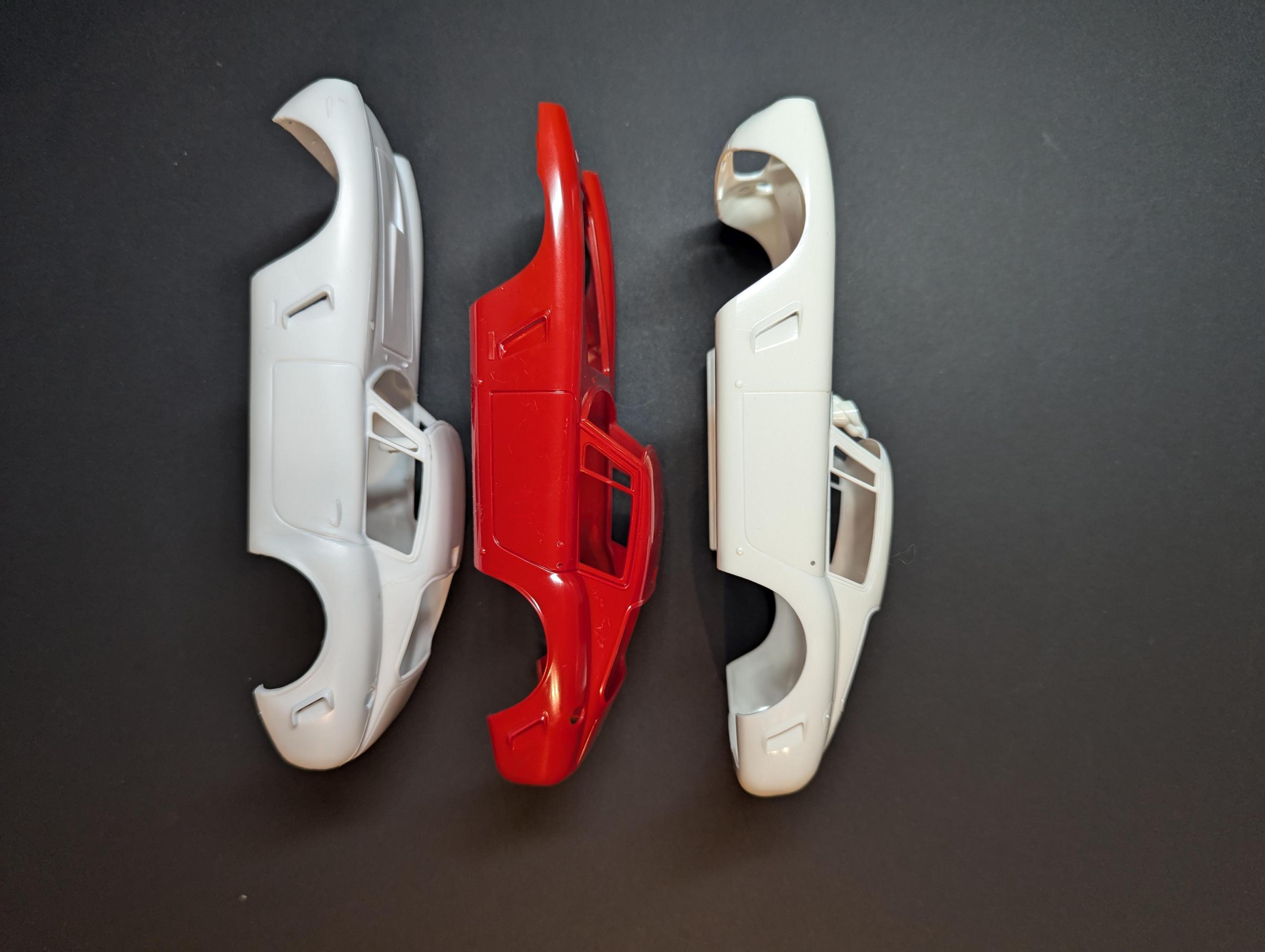

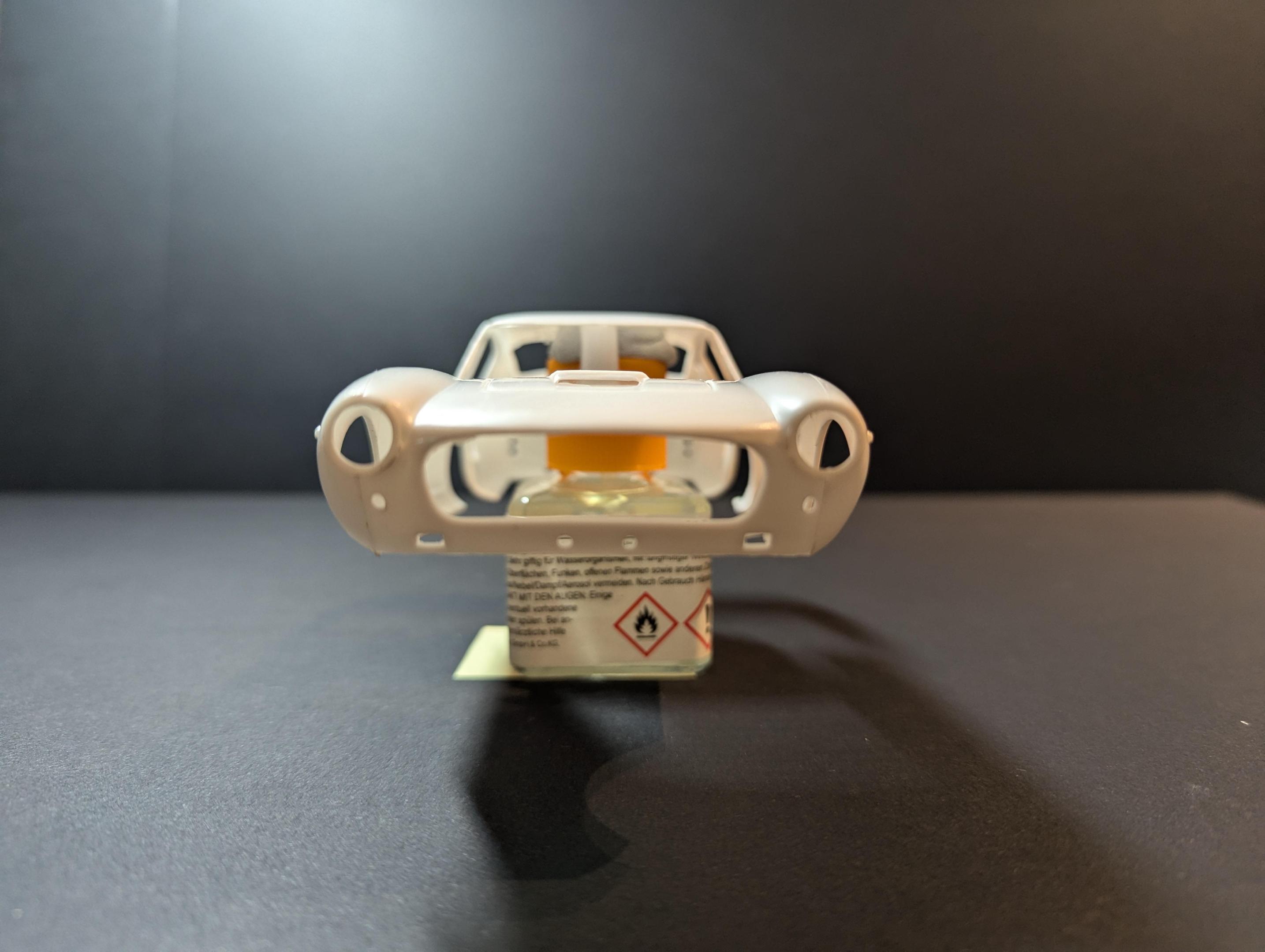

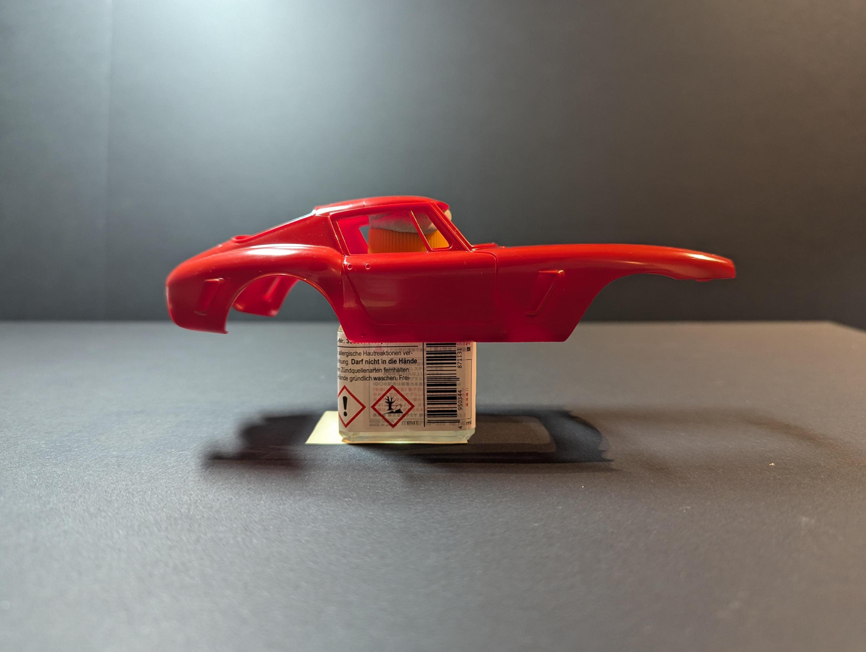

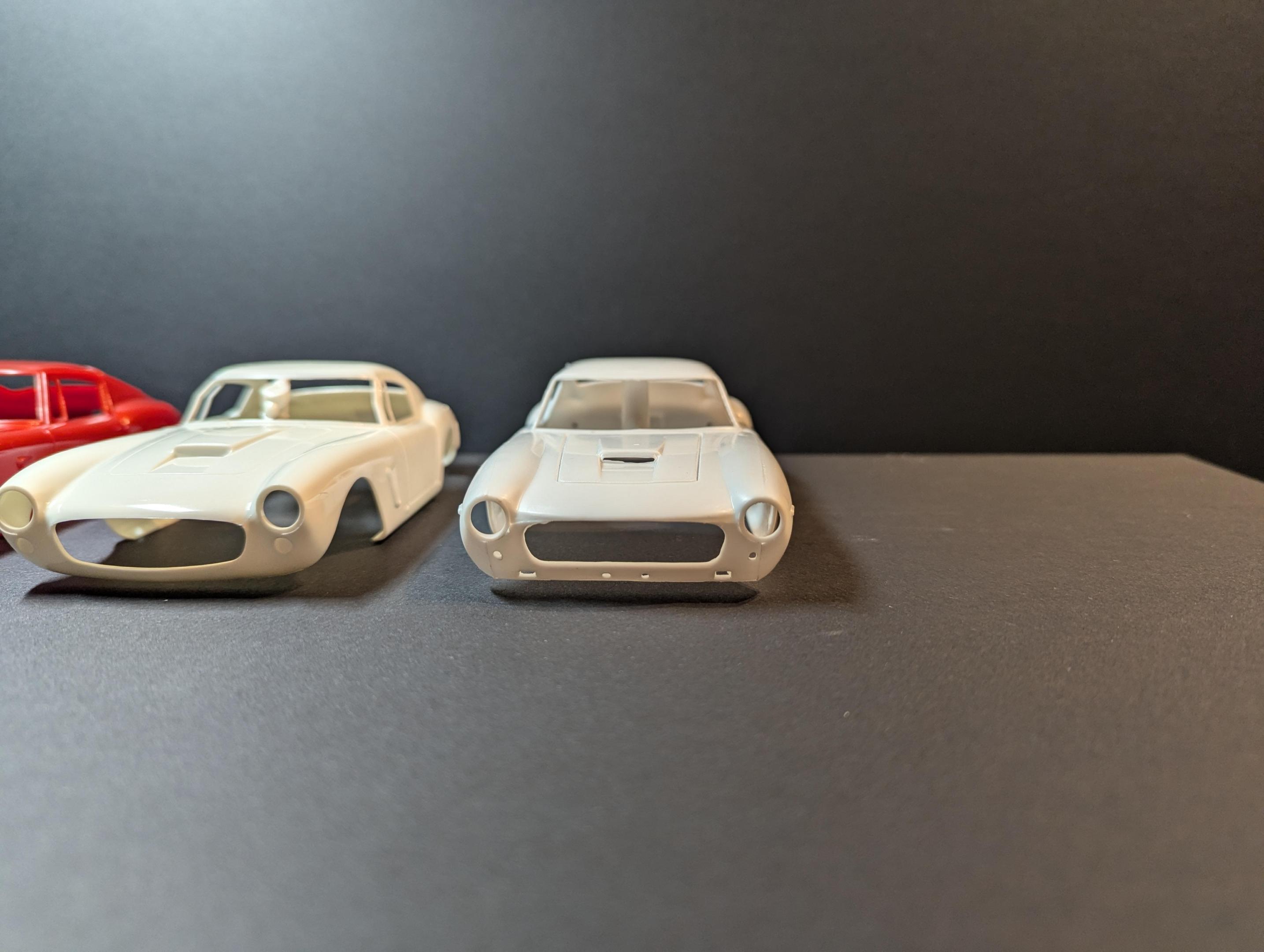

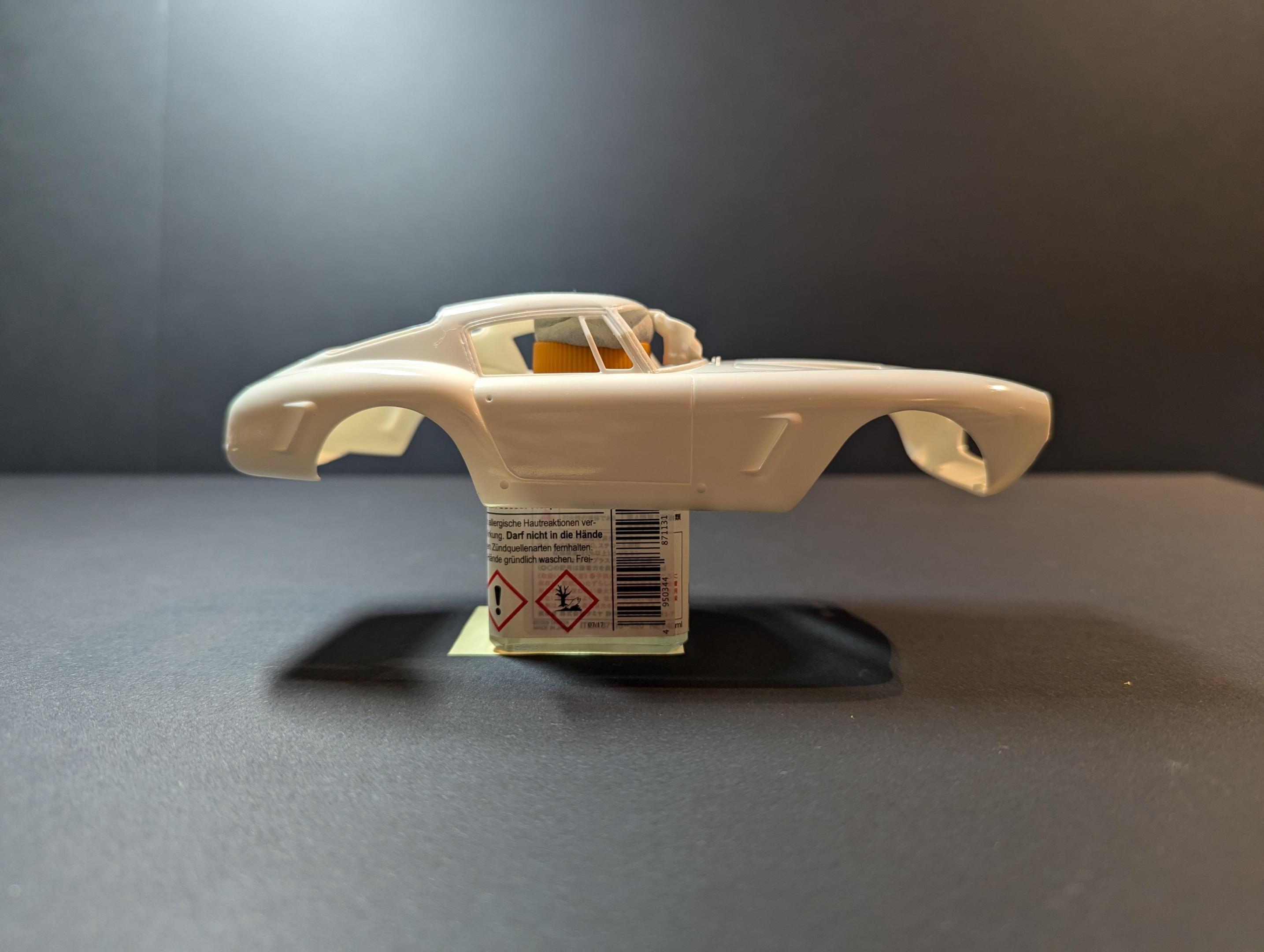

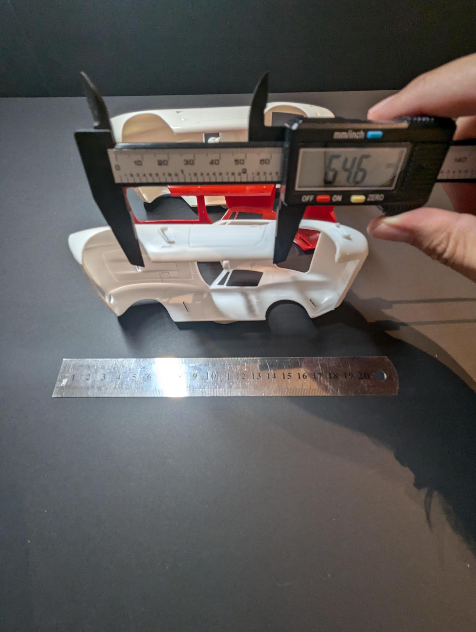

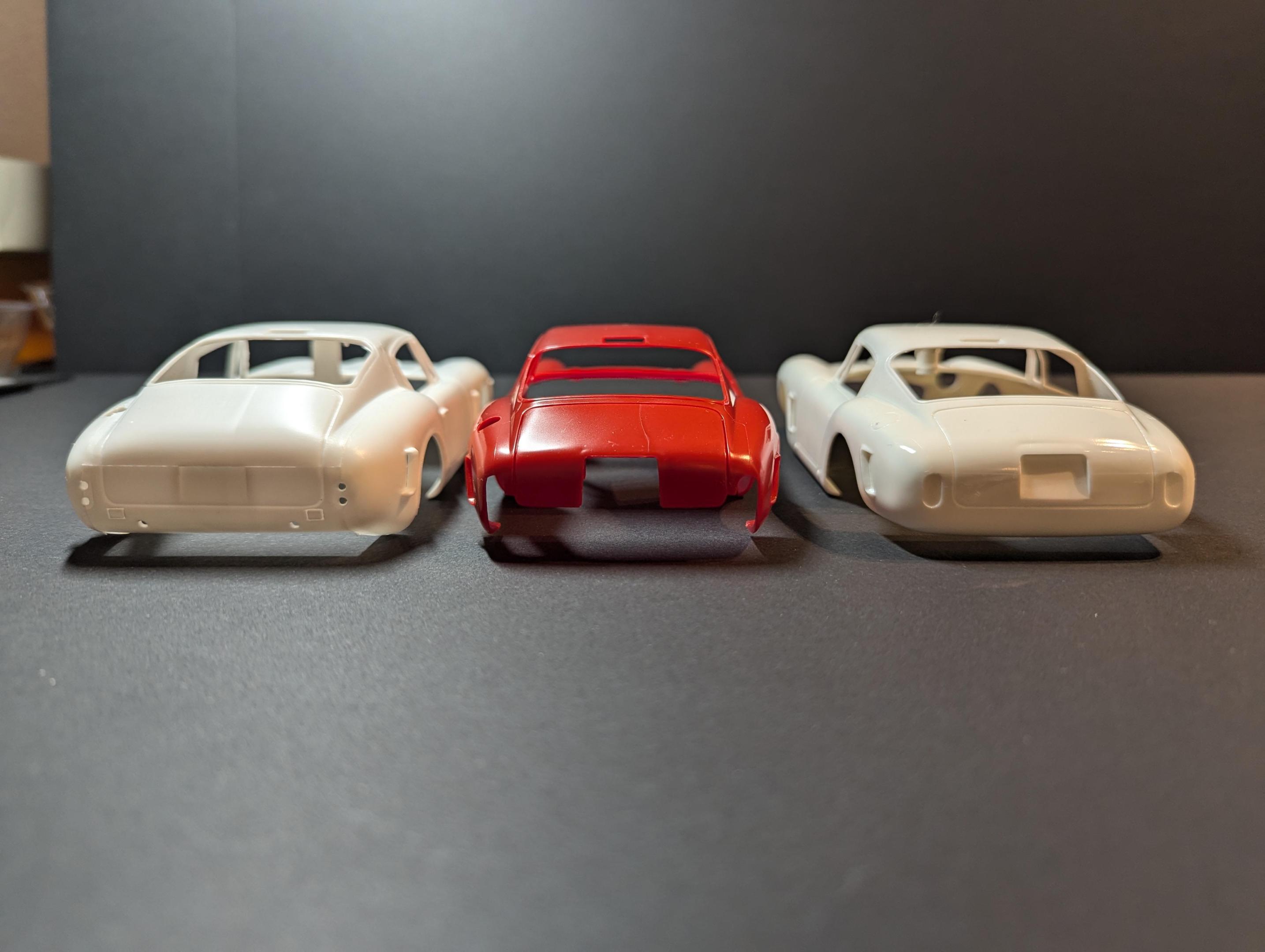

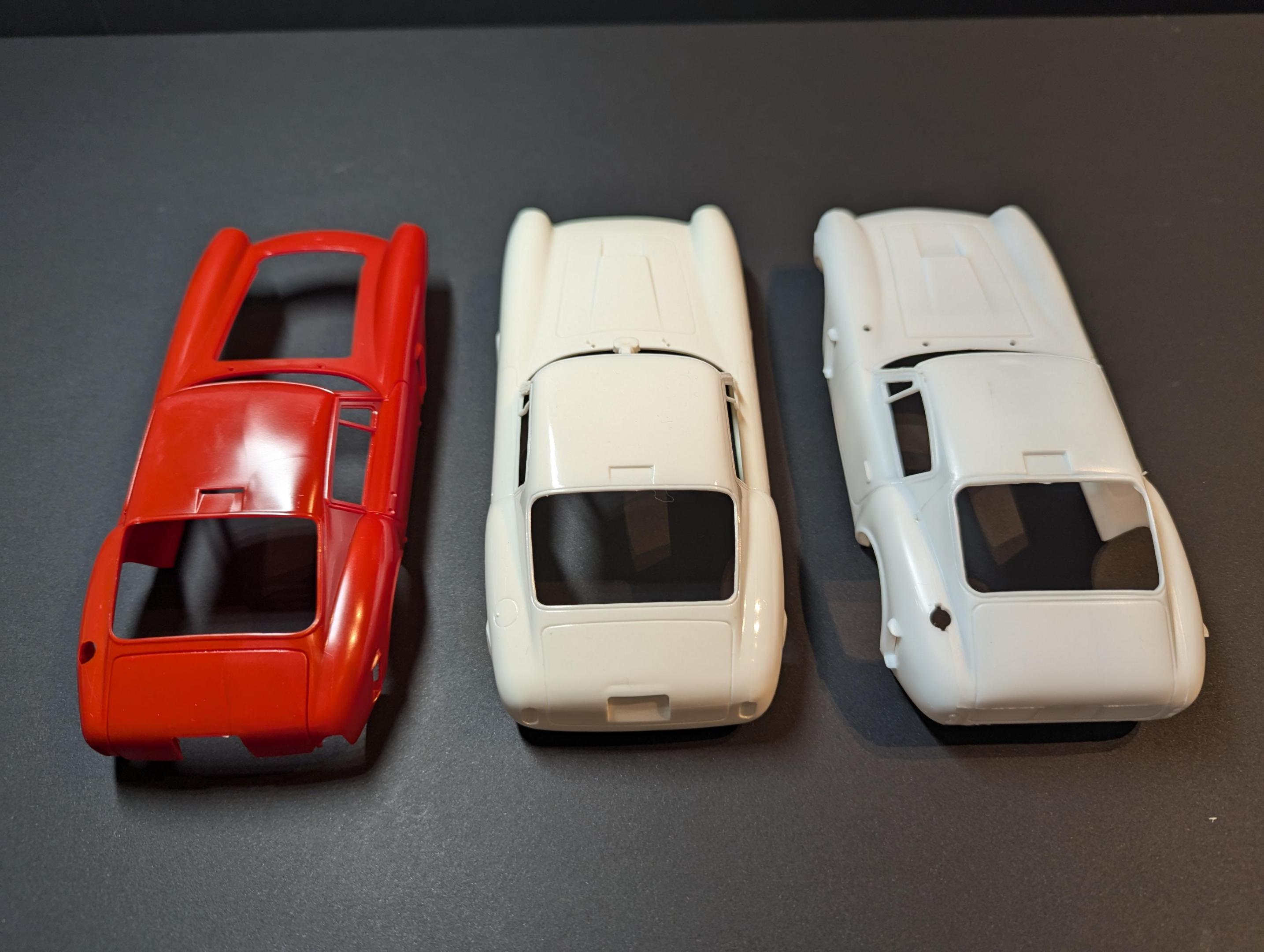

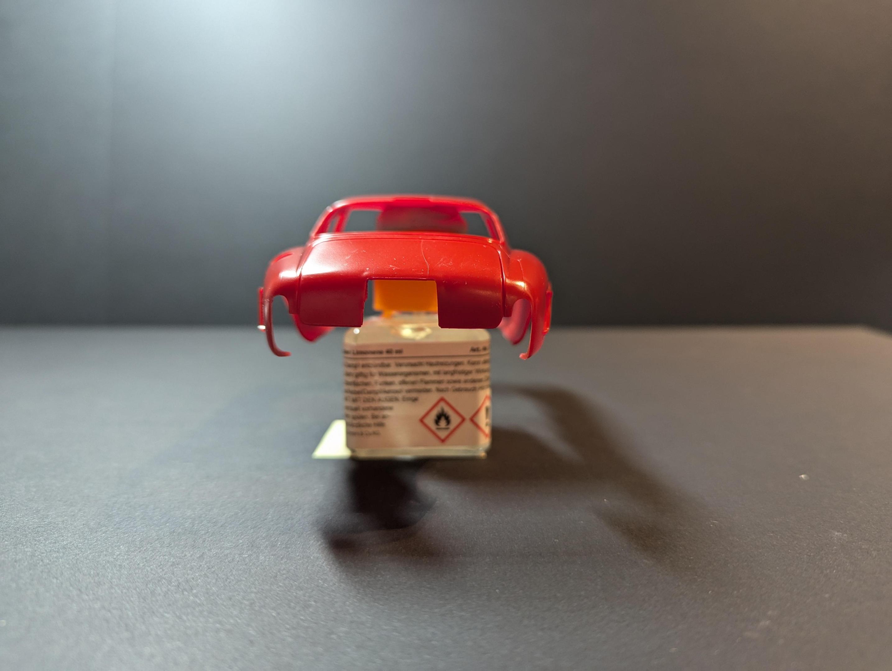

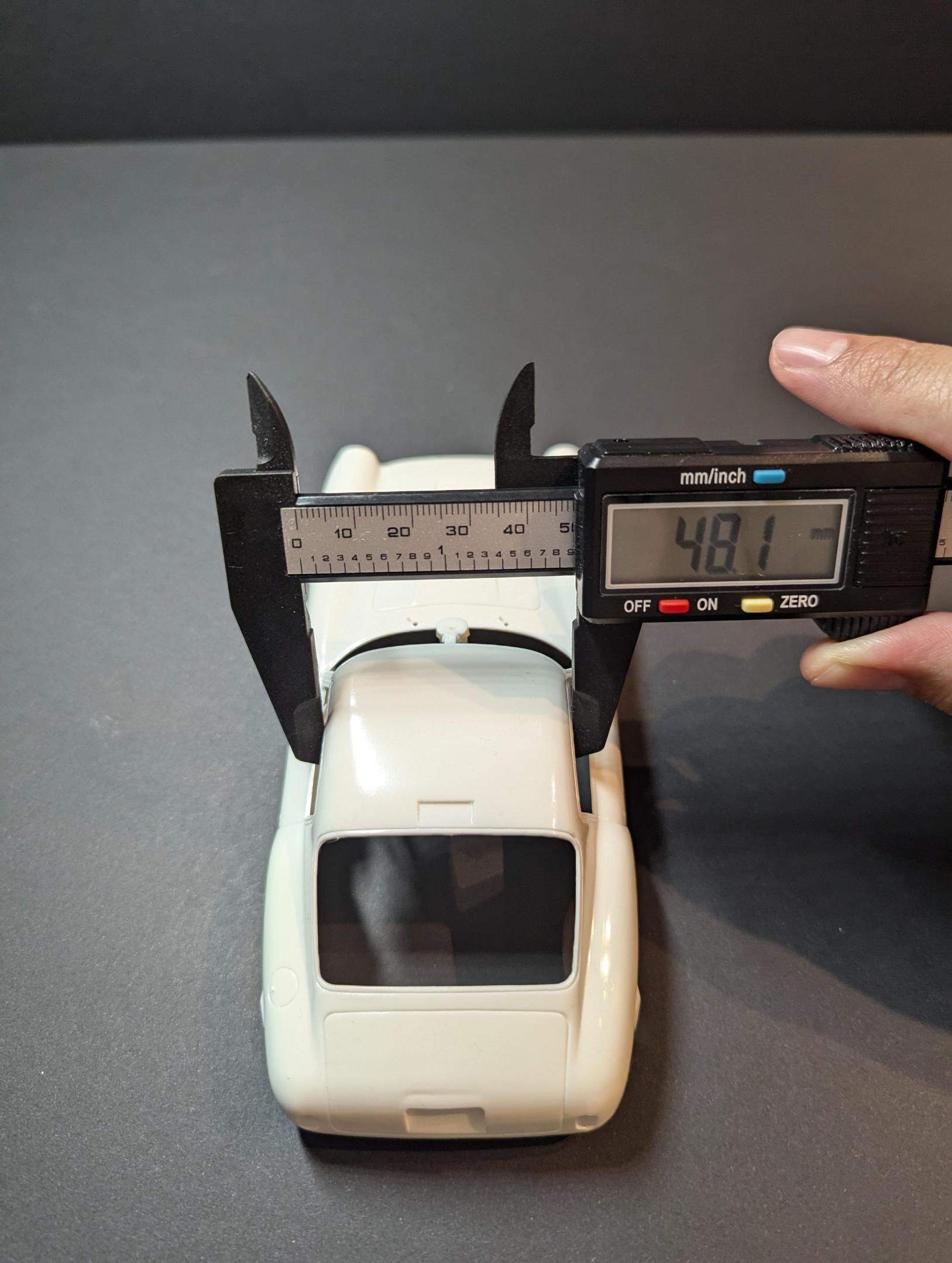

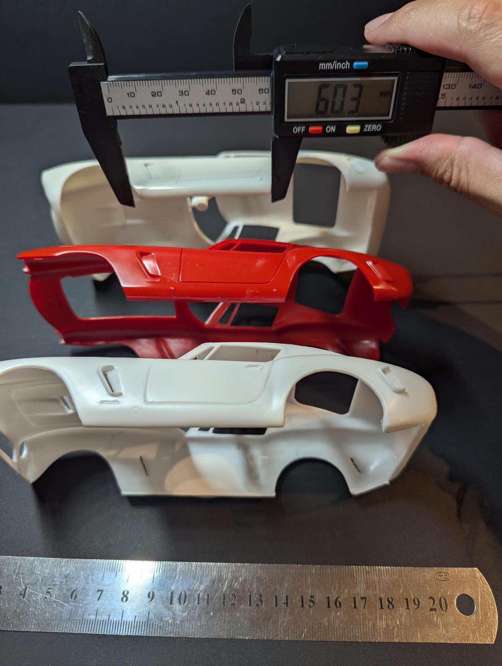

Hi All,
I finally had some time to take pictures of the three models and make side-by-side comparisons (I should have glued the bumpers to the Italeri kit, but I did not have the time).
The Italeri kit is the smallest among the three and, as discussed before, it is the one that most accurately captures the scale of the actual car. However, in my opinion, the Gunze kit better encapsulates the spirit of the car. By examining the pictures in "Ferrari 250 Grand Turismo" from HEEL, I noticed that while the Italeri kit is closest to the reference measurements, the back appears somewhat narrow. In contrast, the Gunze kit gives a more accurate impression of the car's essence, even though it appears broader and off-scale.
The ESCI kit occupies a middle ground regarding measurement but fails to detail the rear part satisfactorily. One observation from the HEEL book photos is that the car’s rear seems elongated, and the distance from the rear frame mirror looks smaller—something the ESCI kit captures. This artistic decision may explain why the model's rear is made wider.
One point of discussion is the arch on the front fender. In the Italeri kit, it looks more like a straight line, whereas the ESCI and Gunze kits depict it with a bump. However, looking at the car from the rear, as shown in the HEEL book, the front part appears to have a very round bump, similar to the Gunze kit, rather than the straight line seen in the Italeri kit. This might also be due to perspective, as the real car’s bump does not appear as curvy as in the Gunze kit.
In the pictures below, you will find ruler references where I took the time to measure various parts of the models for comparison.
Kit Design:
Overall, all three kits are good options if you want to recreate this remarkable car for your collection. To rank them, I would place the Italeri first, followed by the Gunze, and lastly, the ESCI.
In my personal opinion, the Gunze kit best captures the racing spirit of the car, despite being slightly wider than the Italeri, yet still closely resembling the car's design. The sculptors at Gunze typically do this to evoke a racing aura, which can also be seen when comparing the 250 GTO to Italeri's, Revell (Protar), and Fujimi's versions.
Bonus: Ferrari California and Ferrari SWB (Italeri Kits)

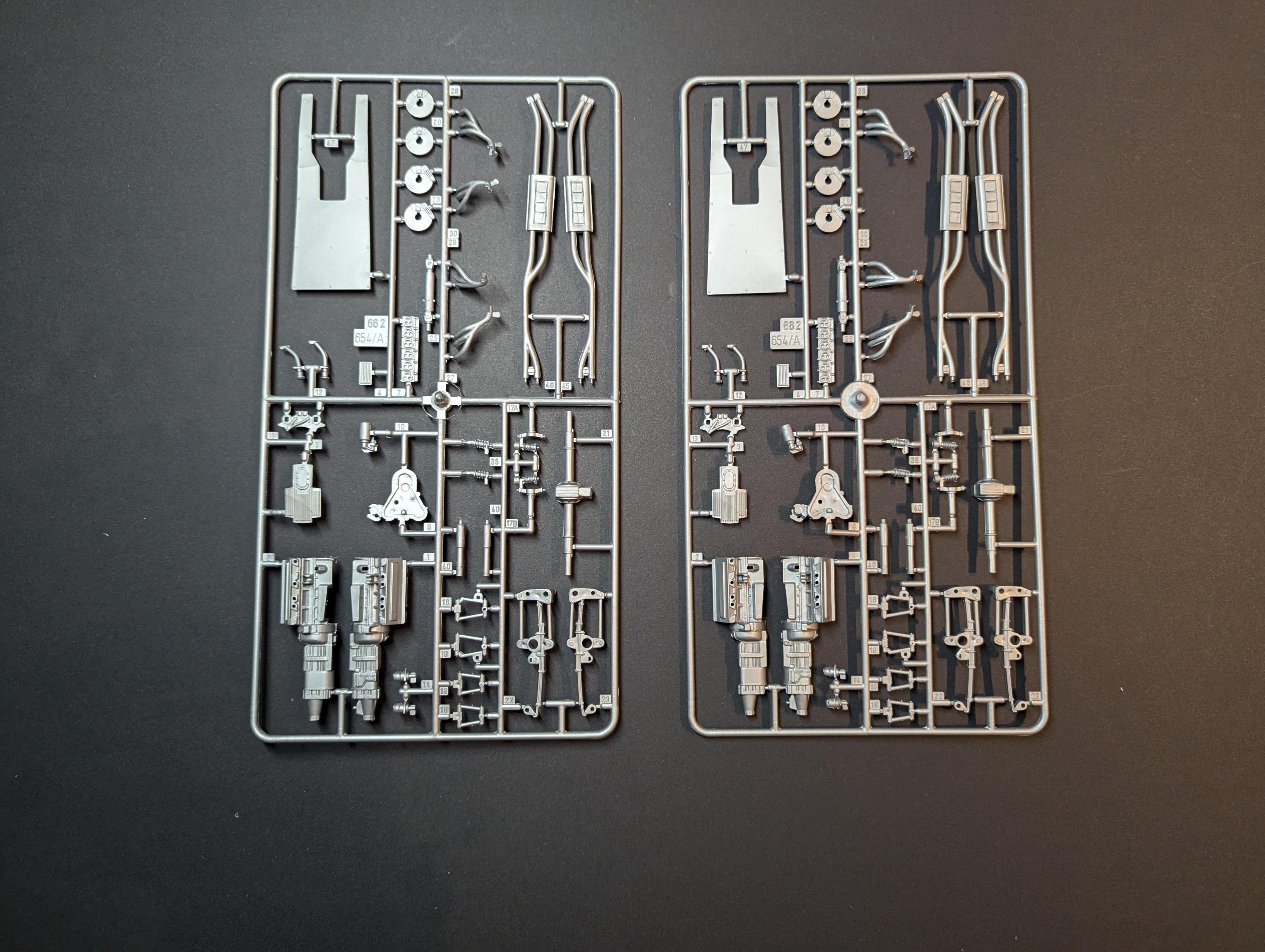

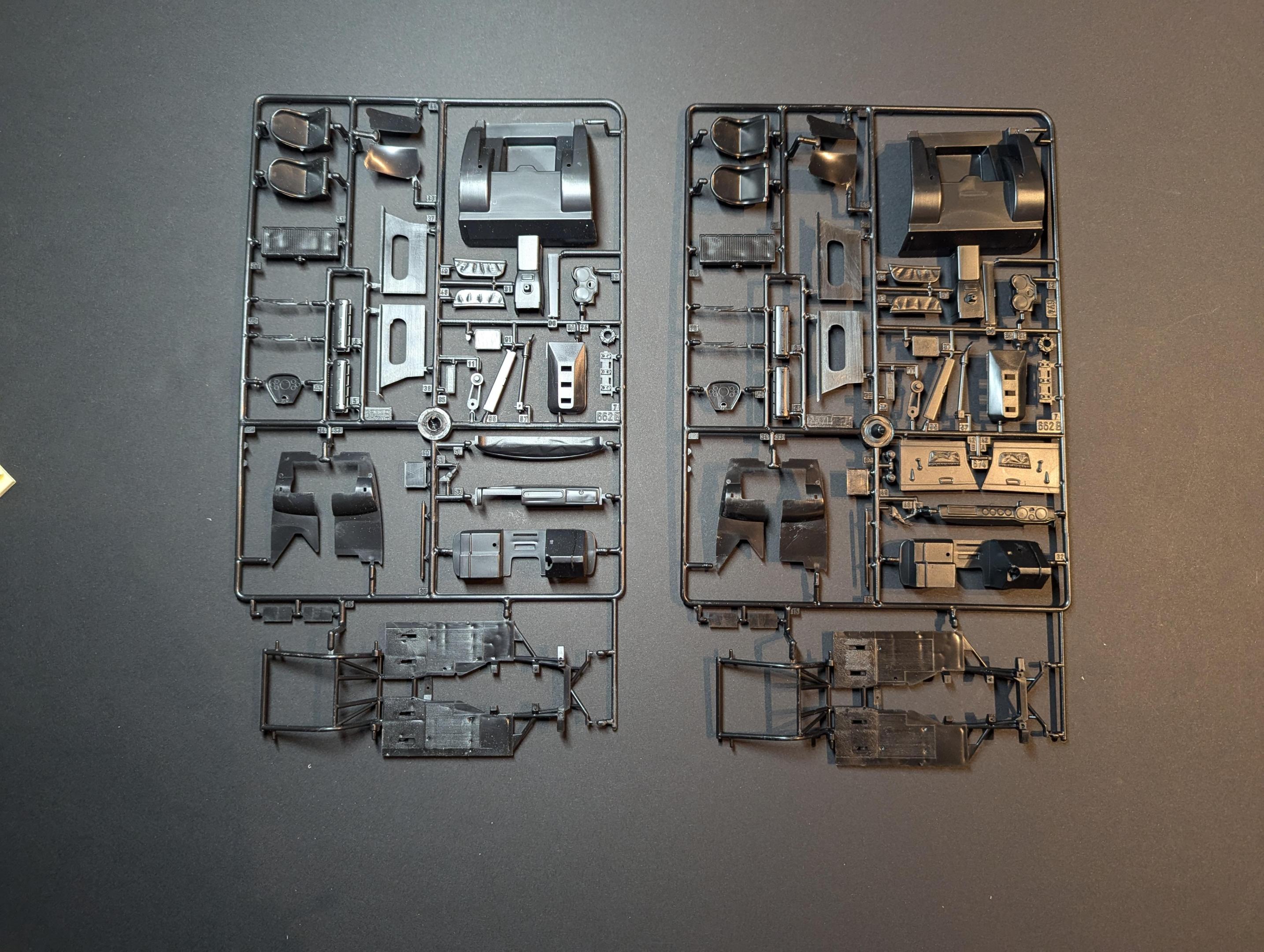

One noteworthy aspect of the Italeri 250 SWB kit is that it shares parts with another Italeri kit (the Ferrari 250 California). In the pictures below, I compare the engine, interiors, and chassis parts, and they are identical except for small modifications like door panels. This may explain why the sculptor needed the SWB kit's measurements to match those of the California kit (assuming the California kit is older given the numbering: 662 for California and 674 for SWB).

While having a look at the 250 GTO from Italeri, i also notice that they share the same parts for engine and and interior and chassis. While having a look at the data sheet of the cars provided on the HEEL book i make sense as the car shares the same wheelbase, making them at wheelbase aspects and engine design closer to the actual vehicle.
