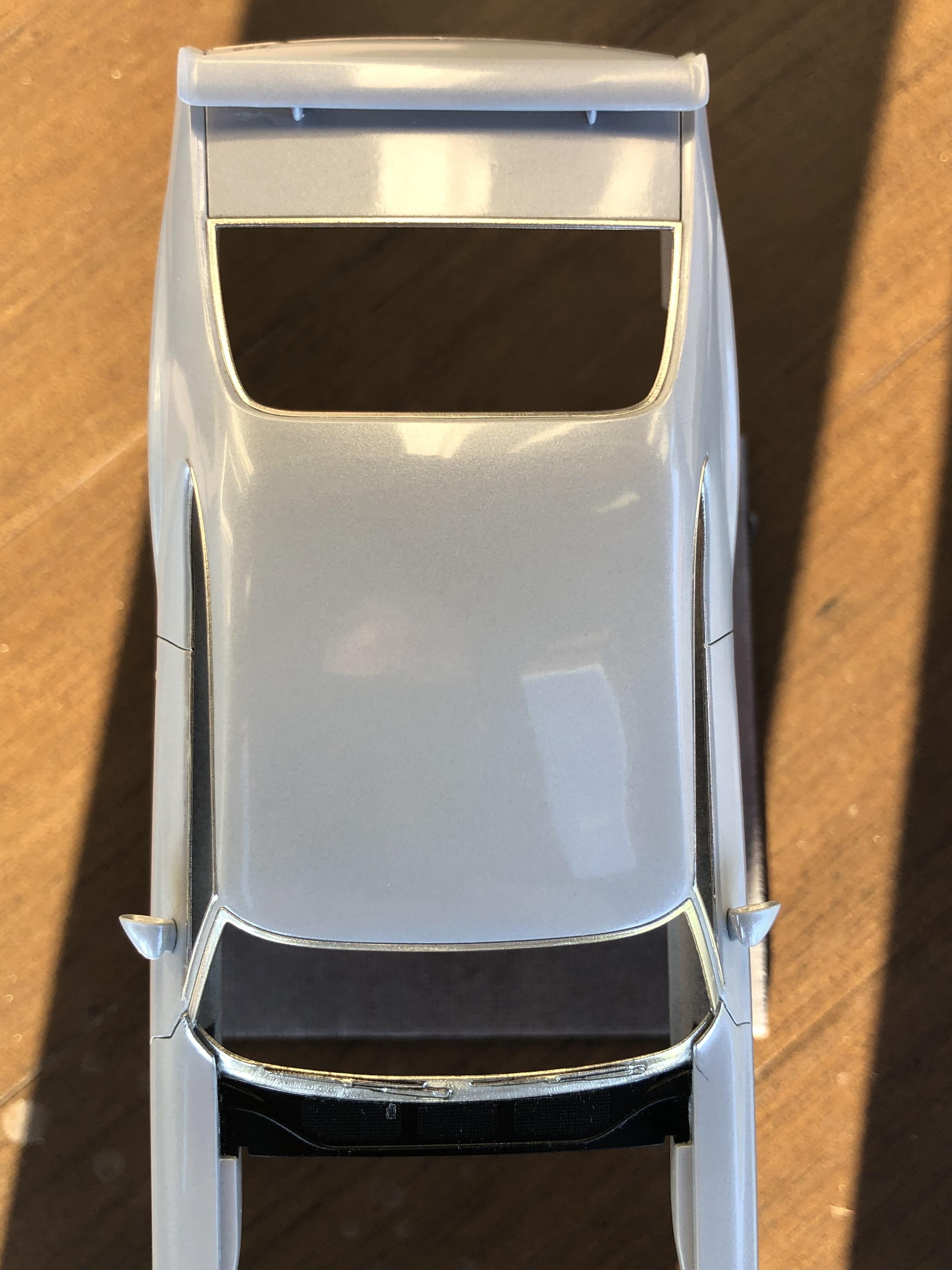

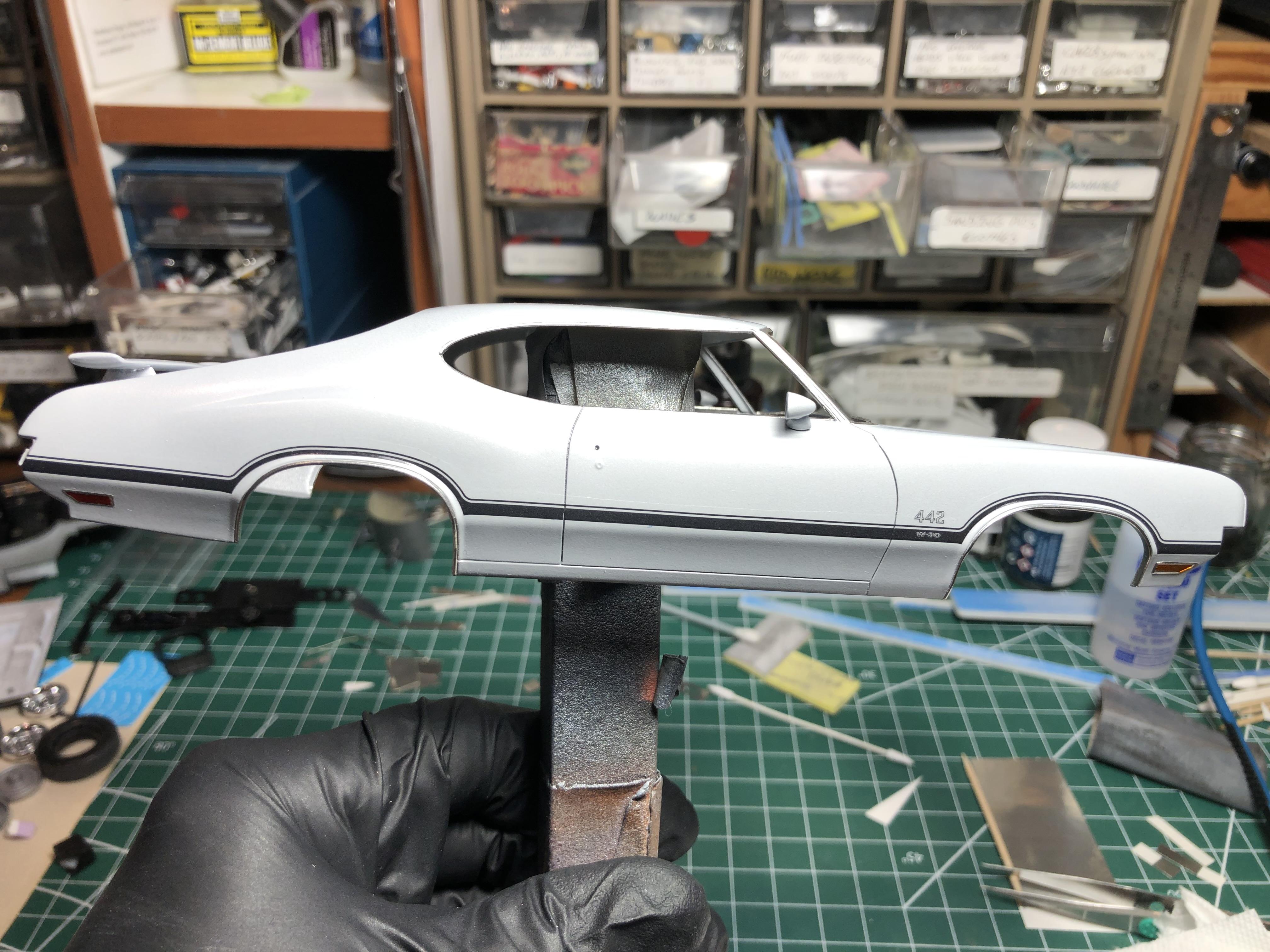

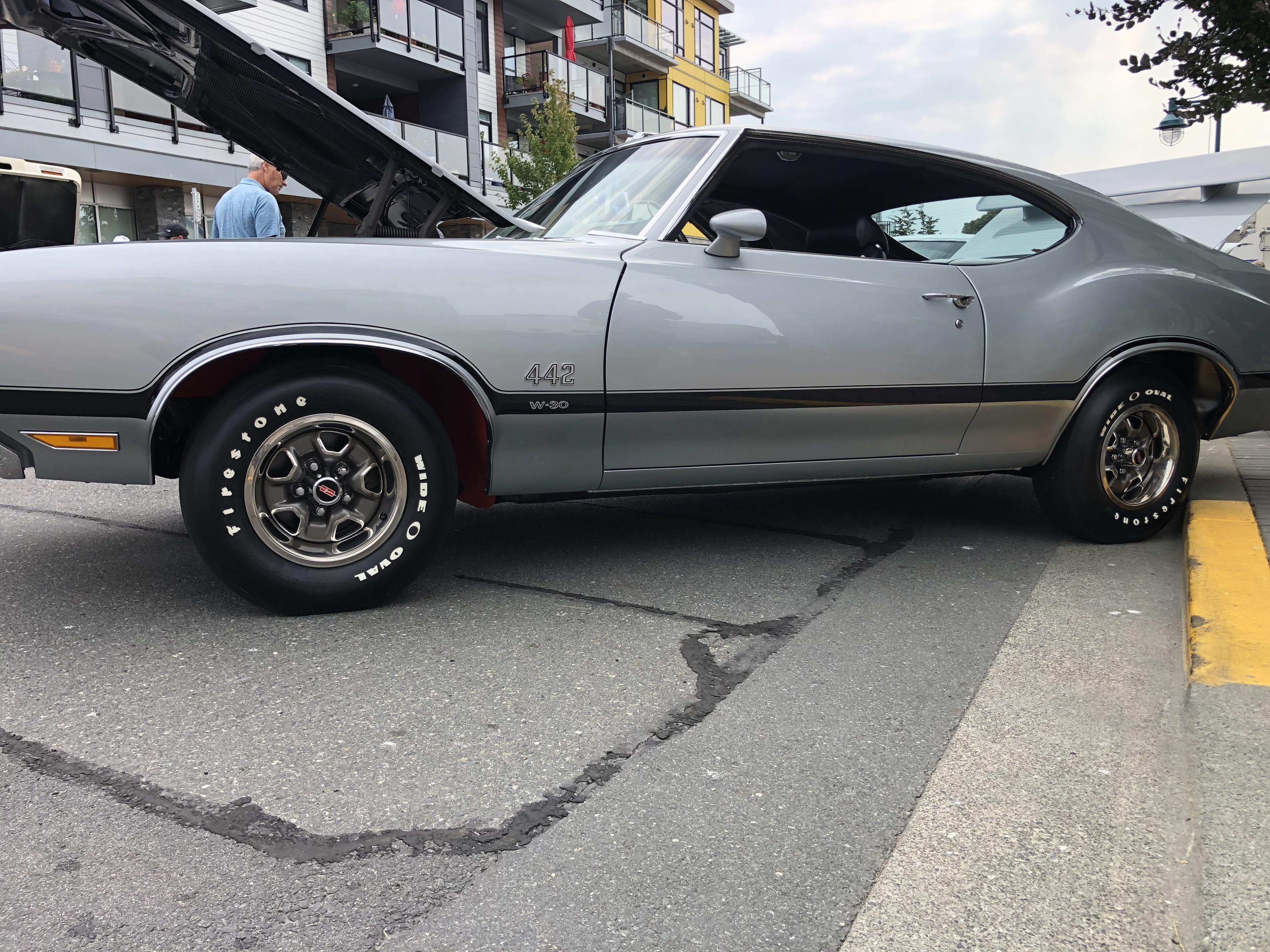

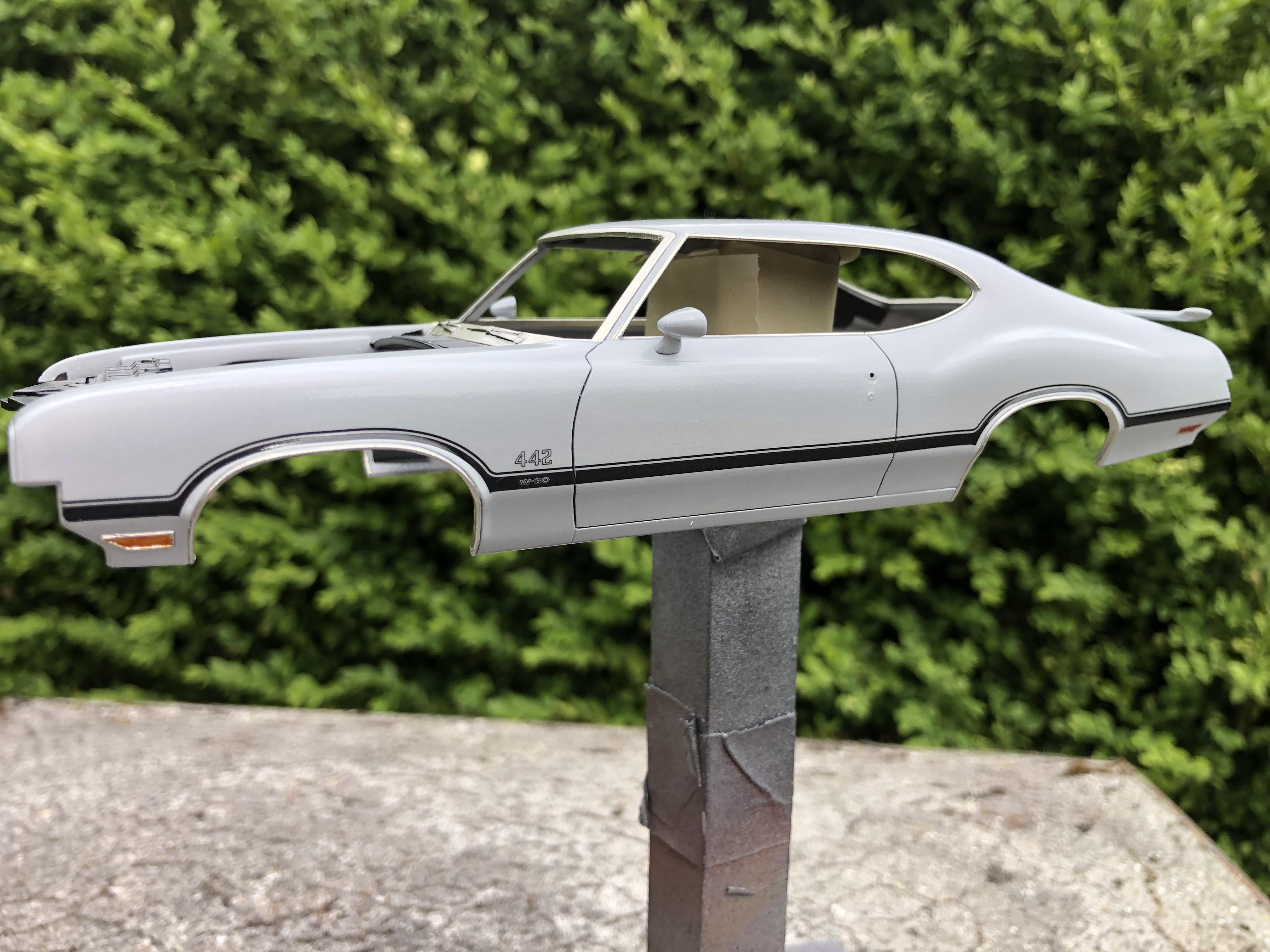

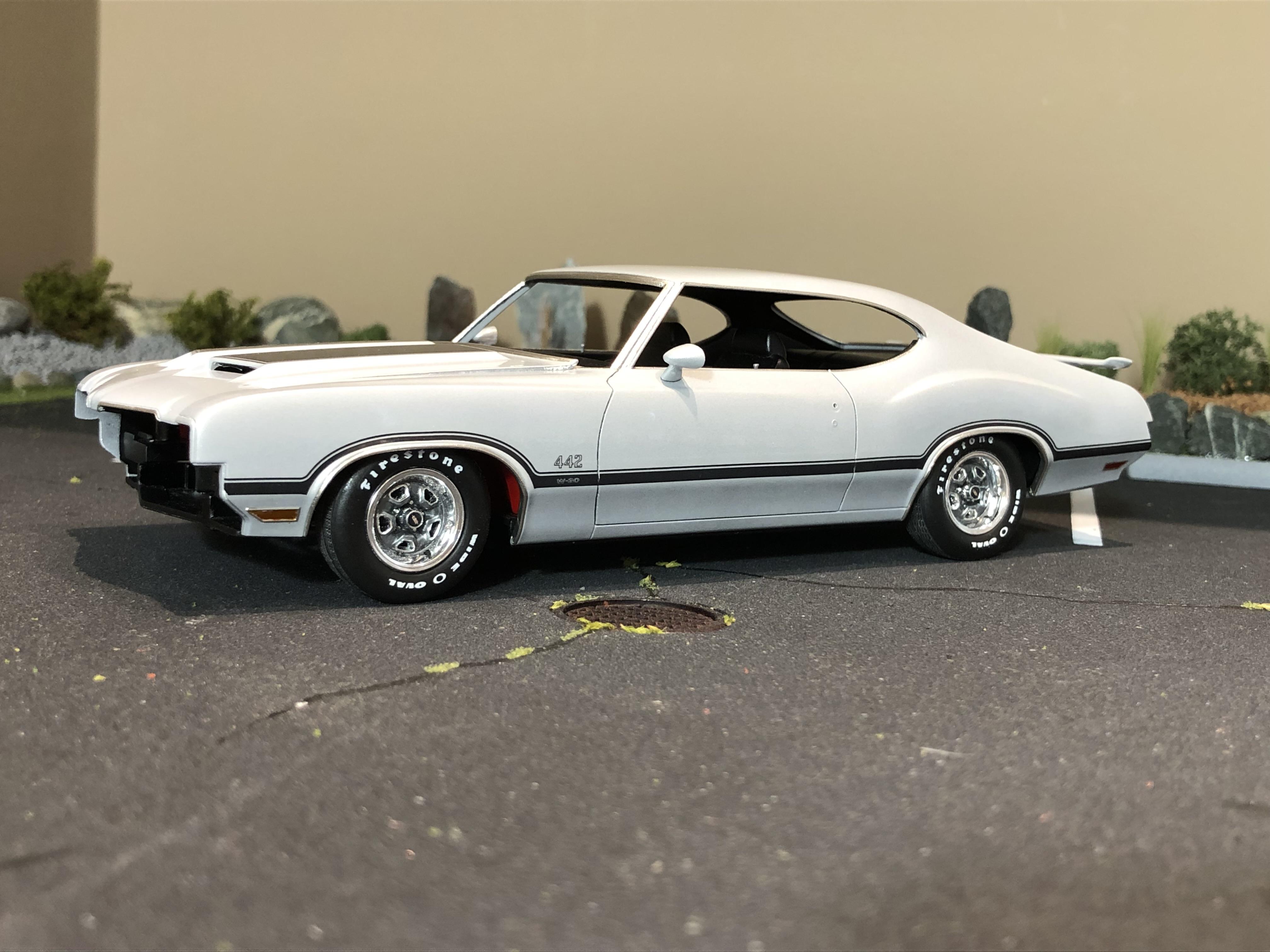

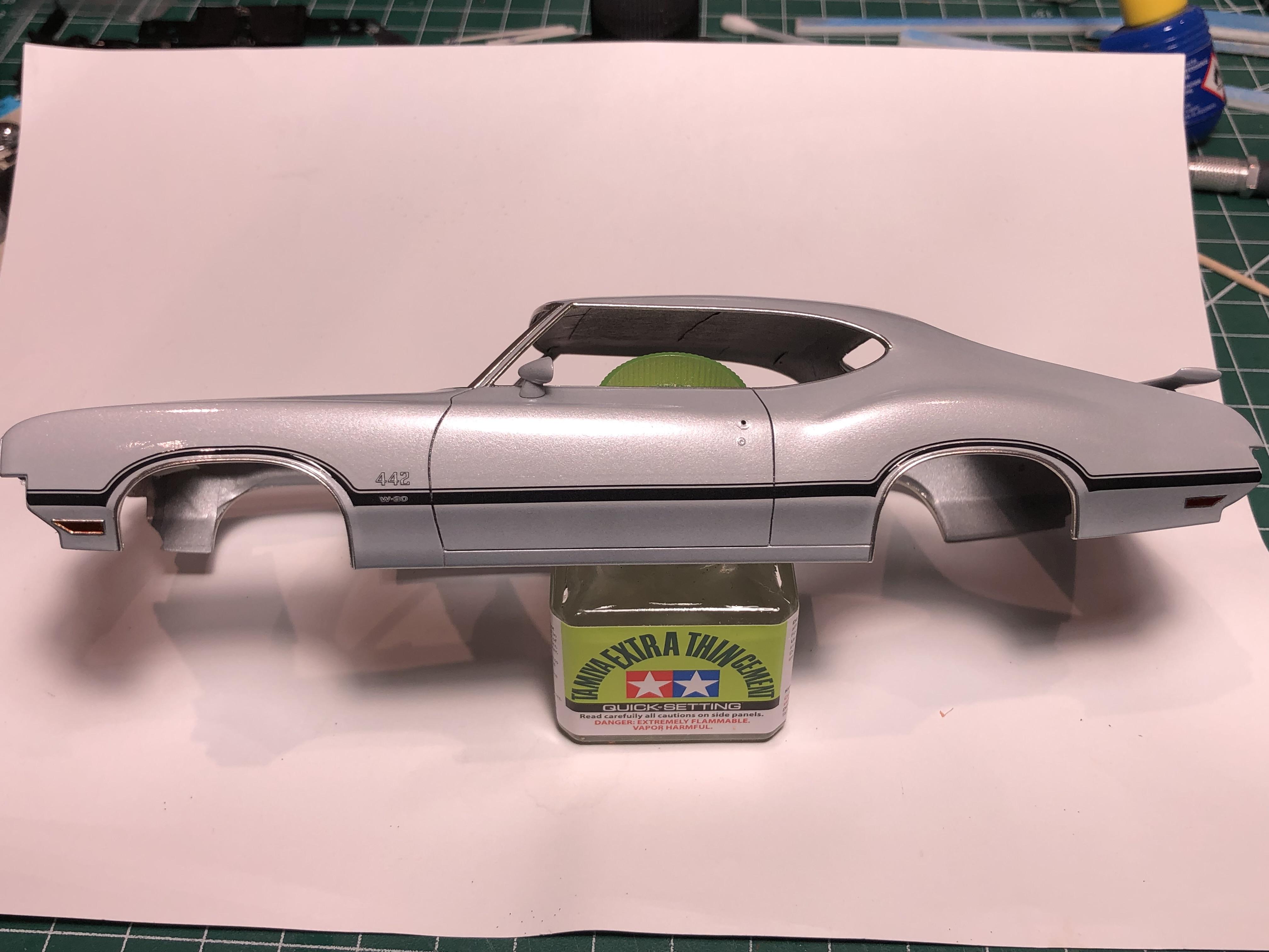

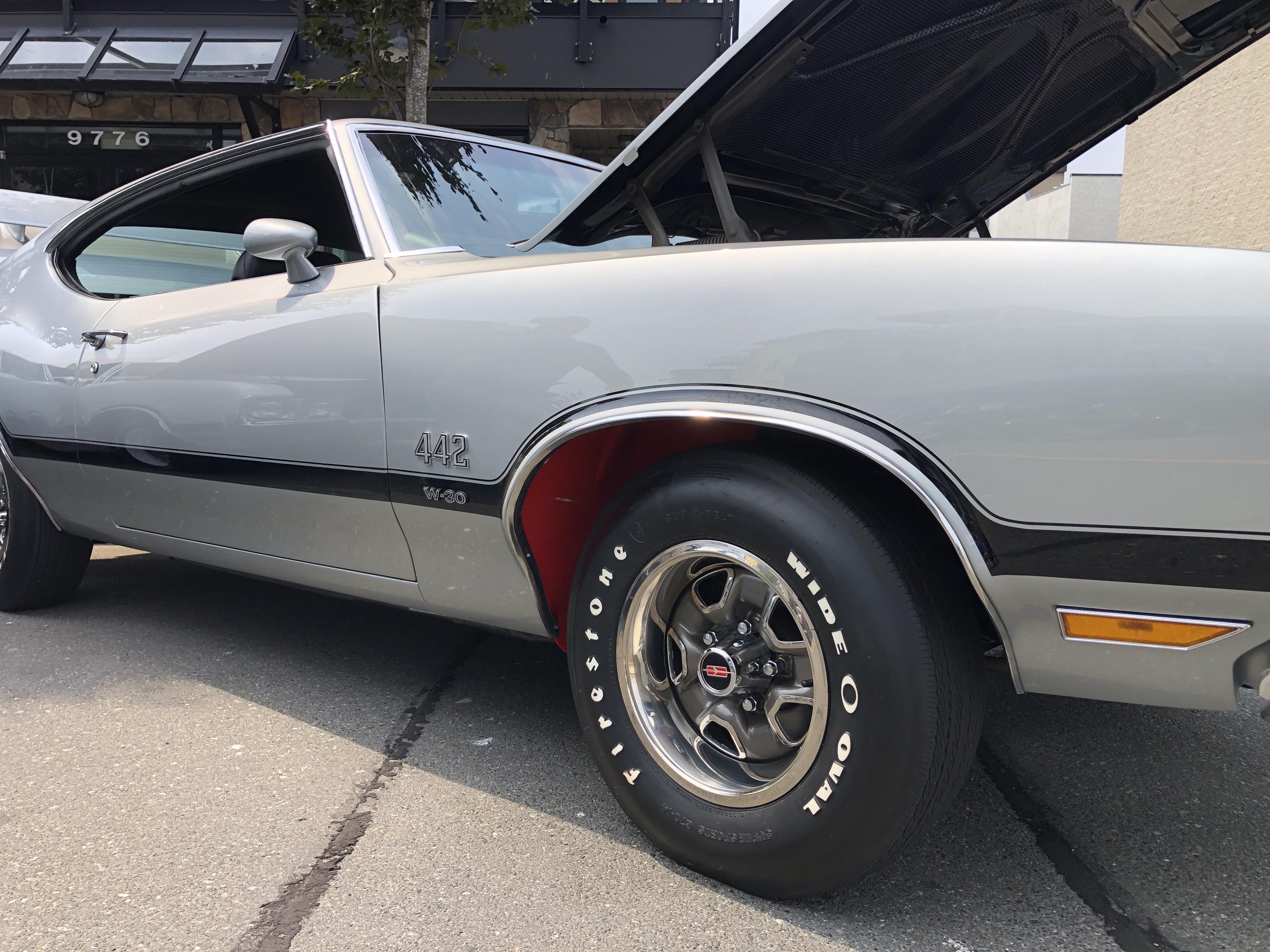

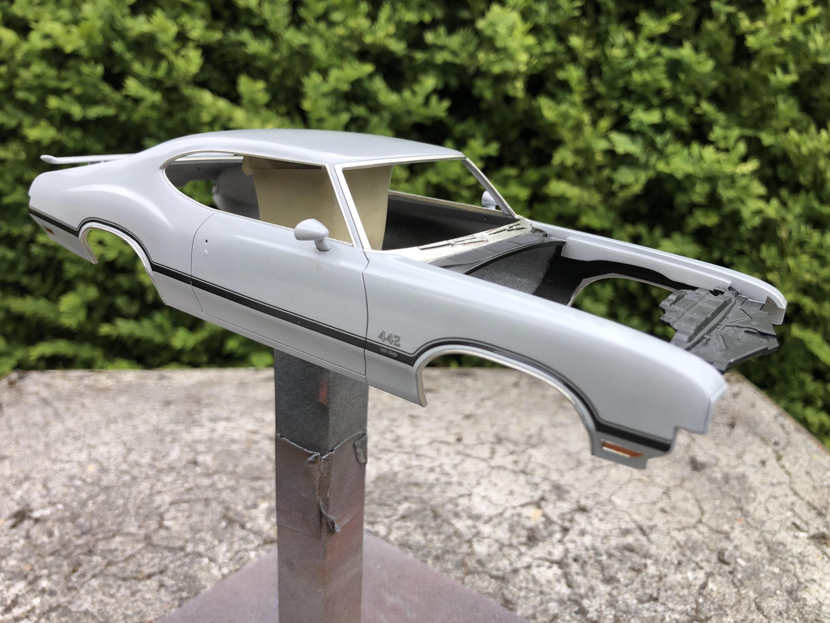

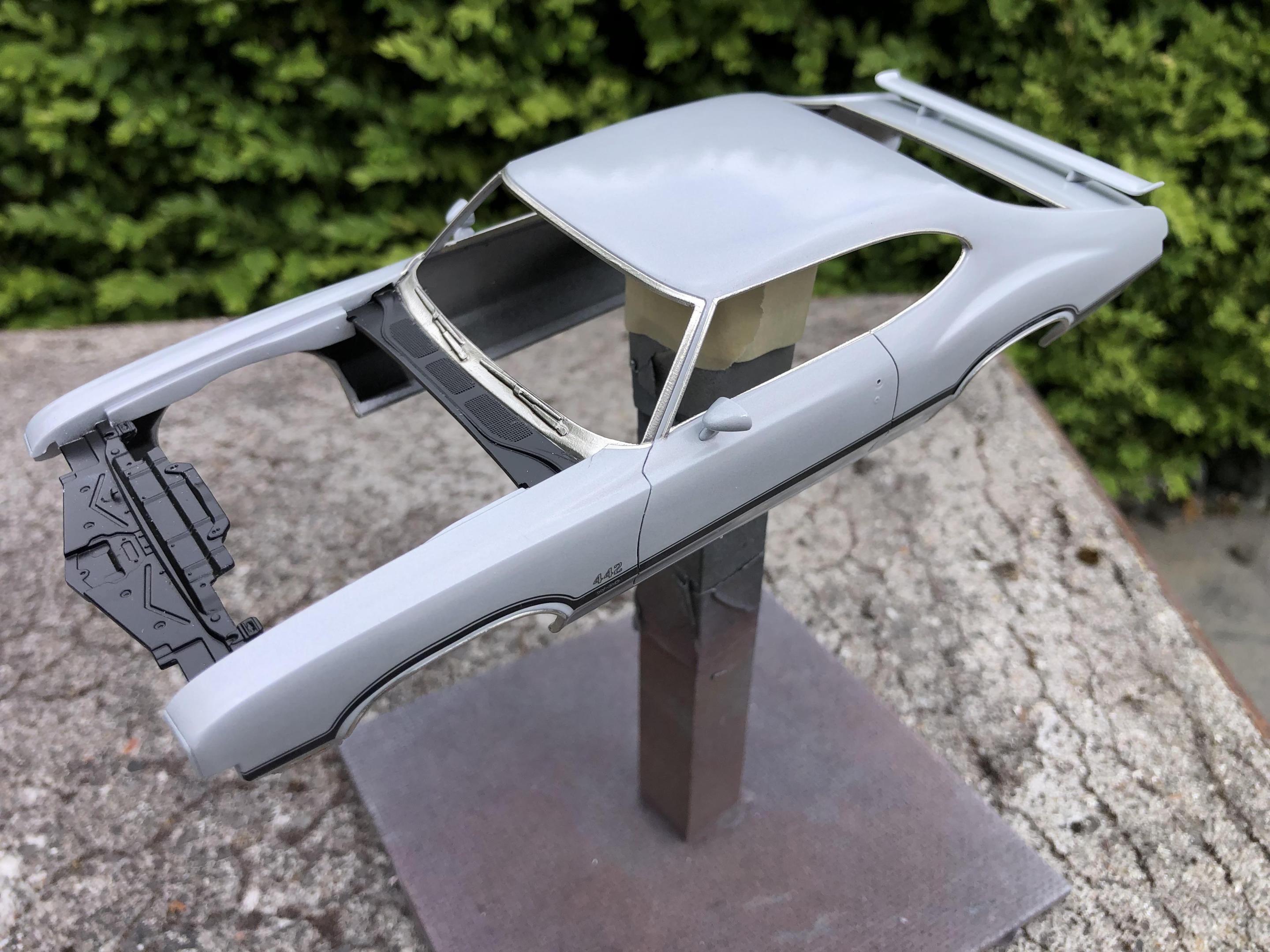

With all that said, I do have some progress to share. The real car is silver as you have seen. I wanted to get close to the factory colour, but was also trying to avoid using an air brush. Well, I think I painted about 30 spoons, but finally came up with a recipe that I believe is really close. The first two photos are Wayne’s car, and you can see how much the paint changes colour in direct light. There is quite a bit of white in the colour. So… here’s the recipe: grey primer, mica silver (3 coats), pearl white (2 coats), pearl clear (one mist coat), gloss clear (3 coats) All Tamiya except the final clear which is Mr Hobby. Tamiya’s pearl white is quite transparent, I knew that, and it worked in my favour here to lighten up the silver, and add a slight shade of white.
Wayne’s car:
before clear:
After decals, foil, and clear. The first indoor shots aren’t great so I took a couple outside as well.
I will let this cure for a week or 2, then polish it out. The colour isn’t “perfect” but I think it will be close. ??

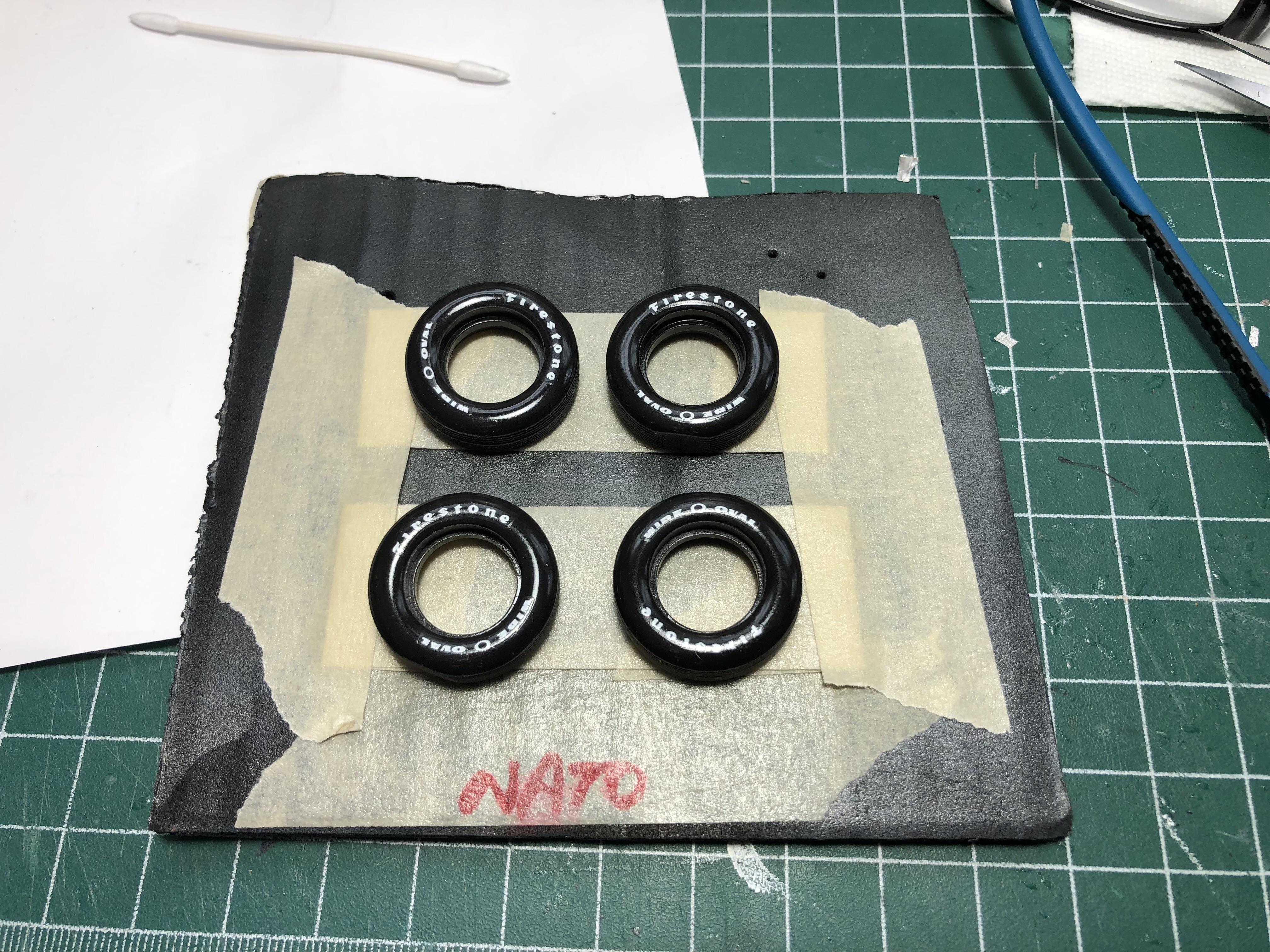

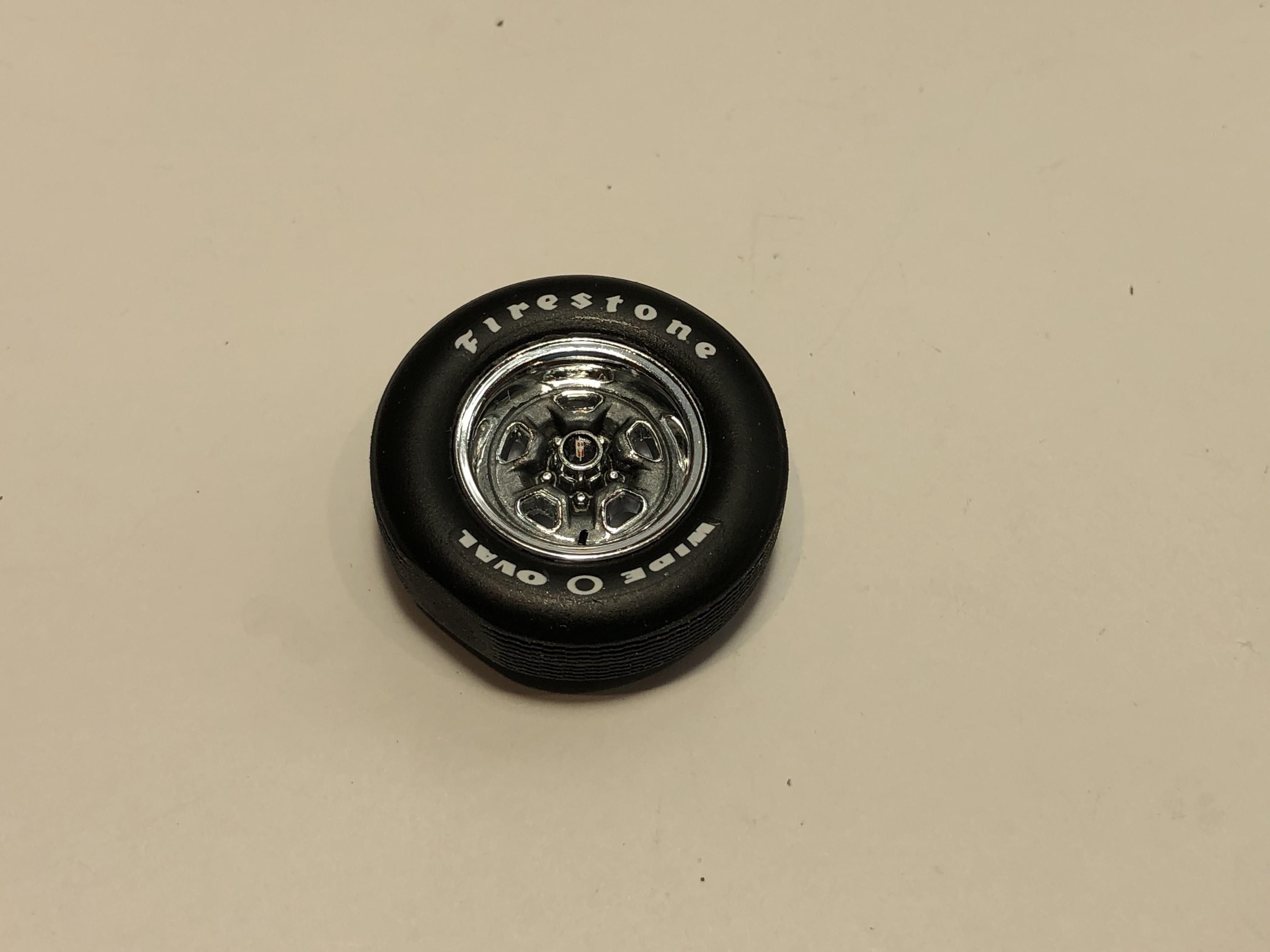

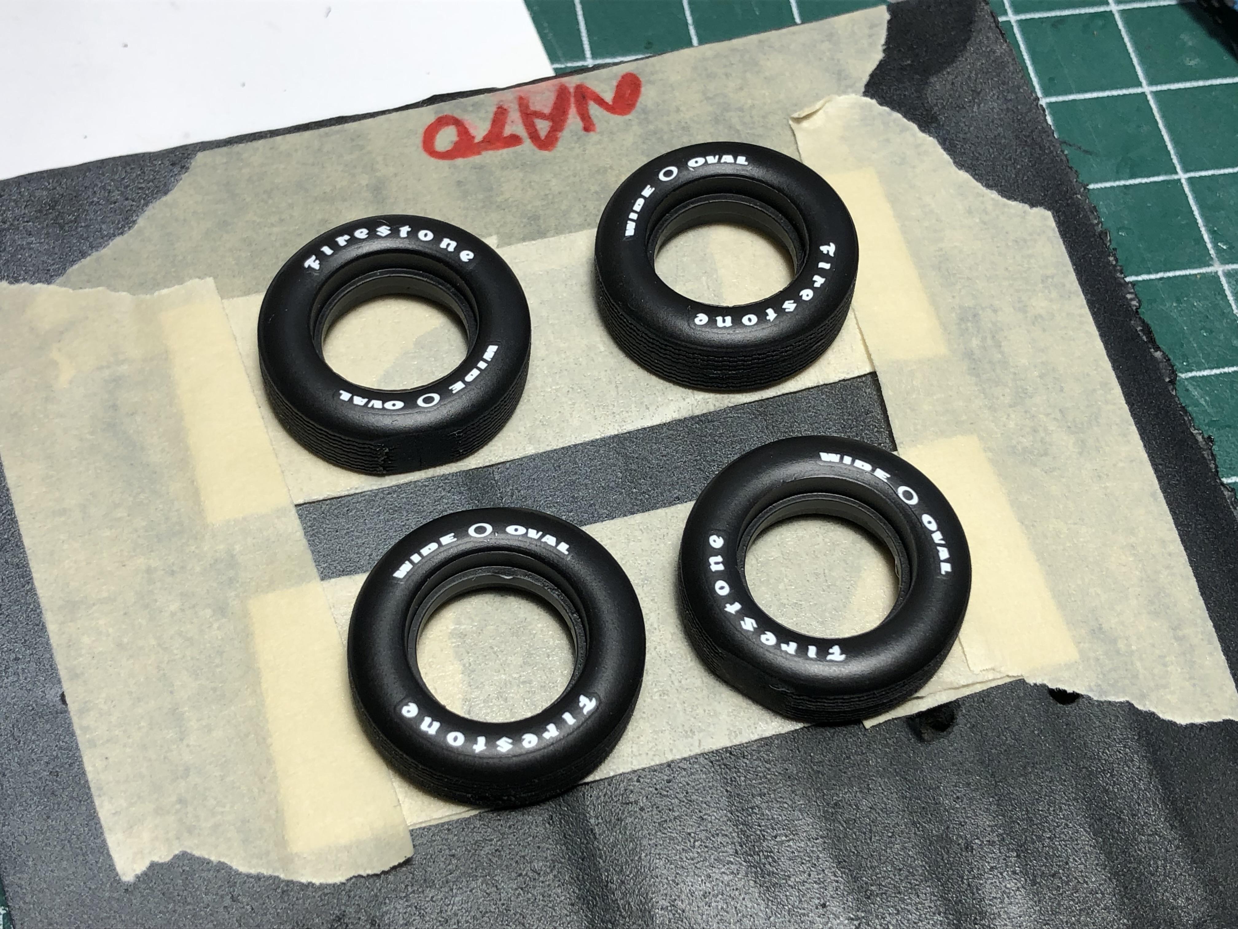

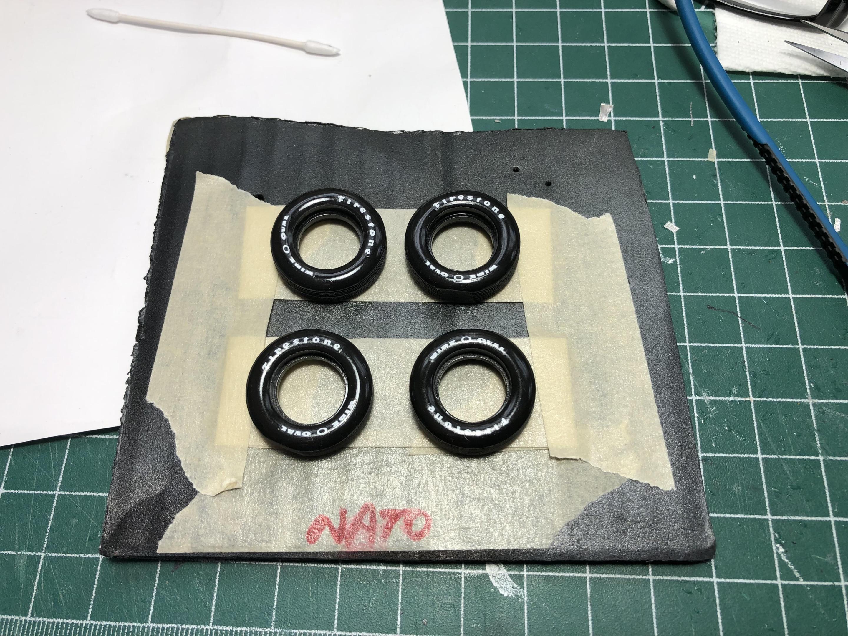

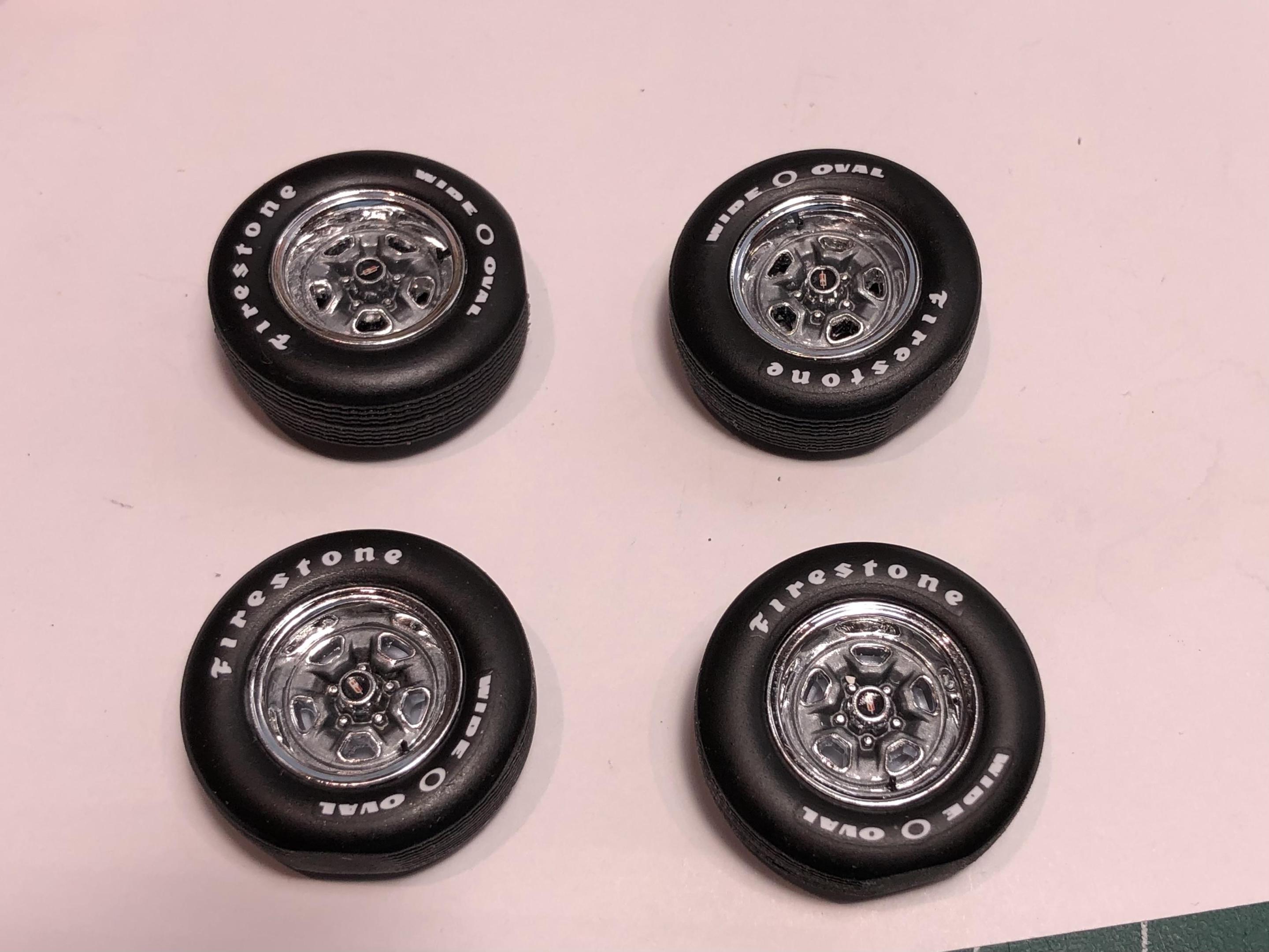

This is my first time using decals for tire lettering. I’m usually a black wall guy. I posted in the Q and A section for some advice and got some great feedback. The tires were first painted with Mr Hobby gloss clear, then decals applied, after decals were dry the tires were shot with a mist coat, then medium coat of Mr Hobby super smooth matte clear. This combo gave the tires a clean, but not TOO shiny look, just what I wanted.
gloss clear…
after matte clear

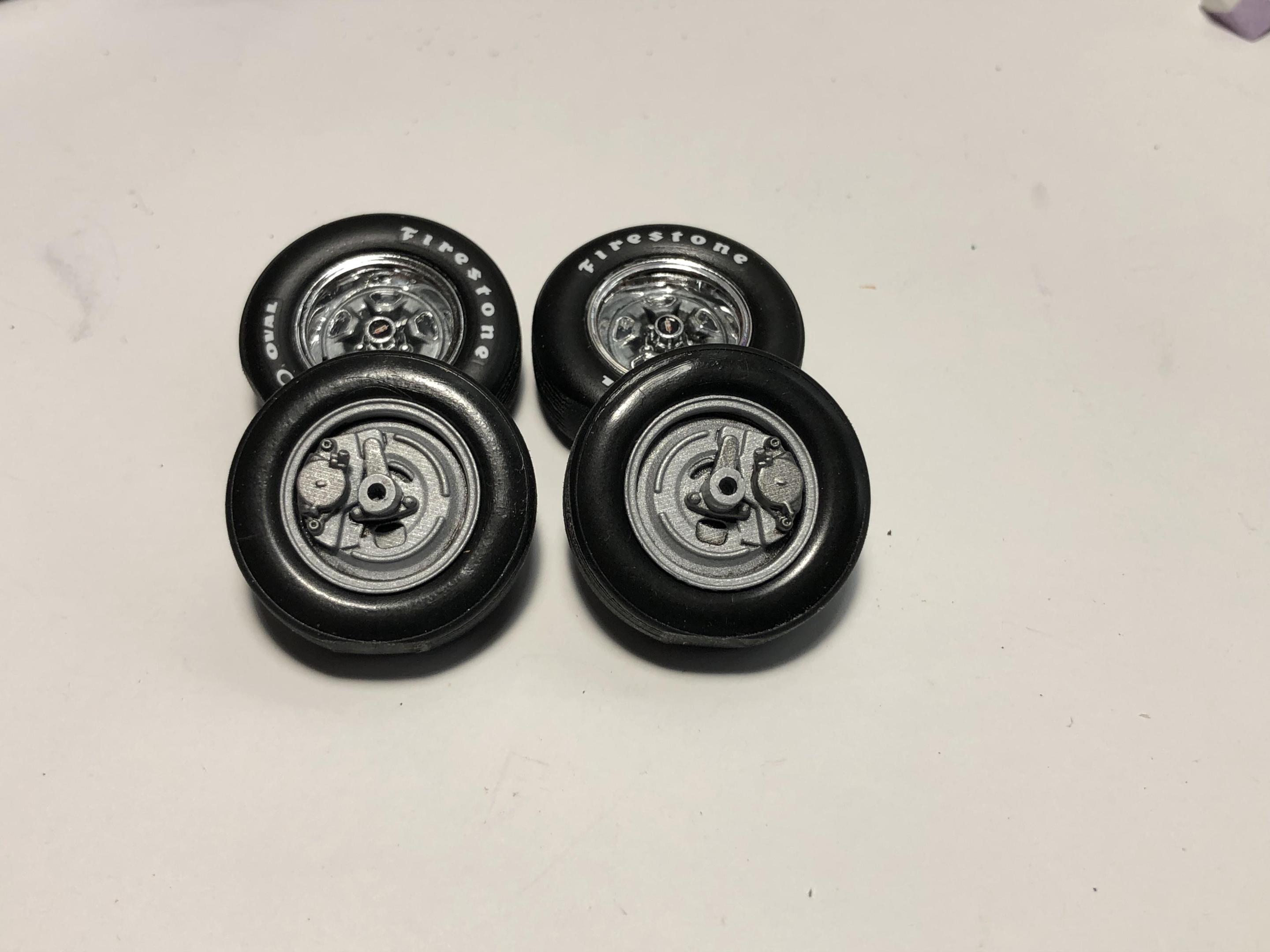

Wheels have been painted and detailed, including valve stems. As you can see, the tires have also been “flat spotted” which will give the car some “weight”. Some detail stuff… Wayne’s car has the valve stems lined up with the “O” so of course I thought I should do that. The centre cap Olds Rocket logo also points right at the valve stem, so…. ya, did that too. Details that will go completely unnoticed, but what the heck.
Not sure what’s happening with the camera on my phone, it’s seems to have taken on a mind of its own. Getting strange colours. New phone soon… Anyhoo
I placed an order with Fireball Modelworks, which included some nice factory front disc brake wheel backs.
So I think the only thing left to do on these is some clear on the centre cap decals to seal them, then install them. Oh.. I’m going to use styrene rod instead of the kits metal pins to install the wheels.

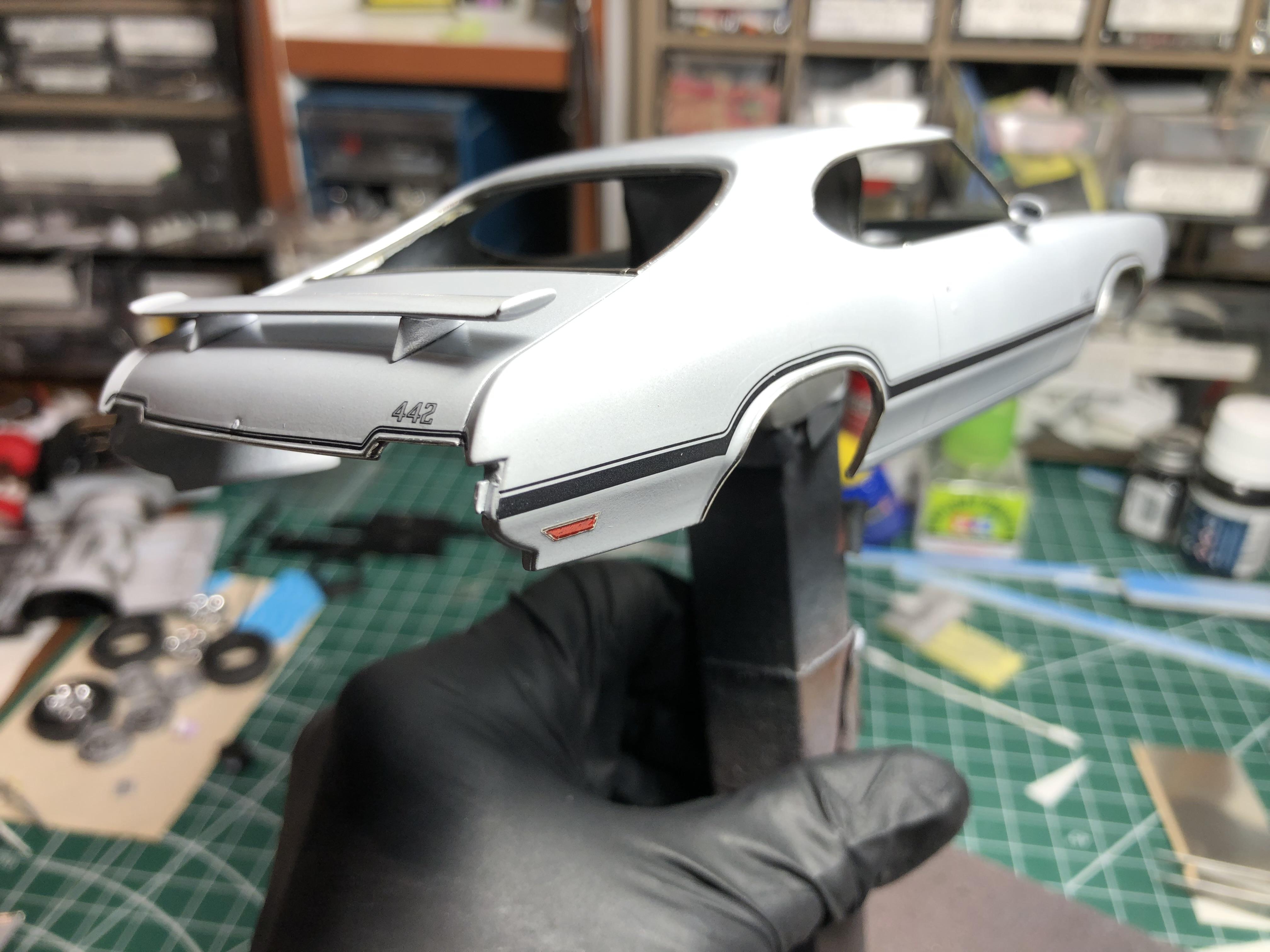

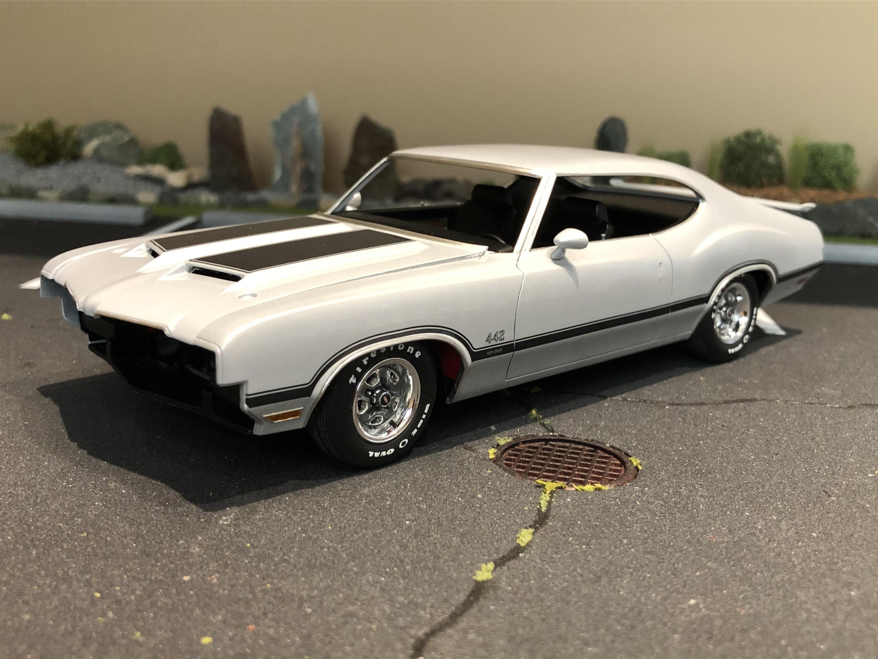

Got the Olds polished out. 3600-12000 cloths, polishing compound, then Adam’s wax. Still a little bit of clean up along panel lines and a few other areas, but it looks decent. Not the best photos, I’ll have better ones once it’s fine tuned.

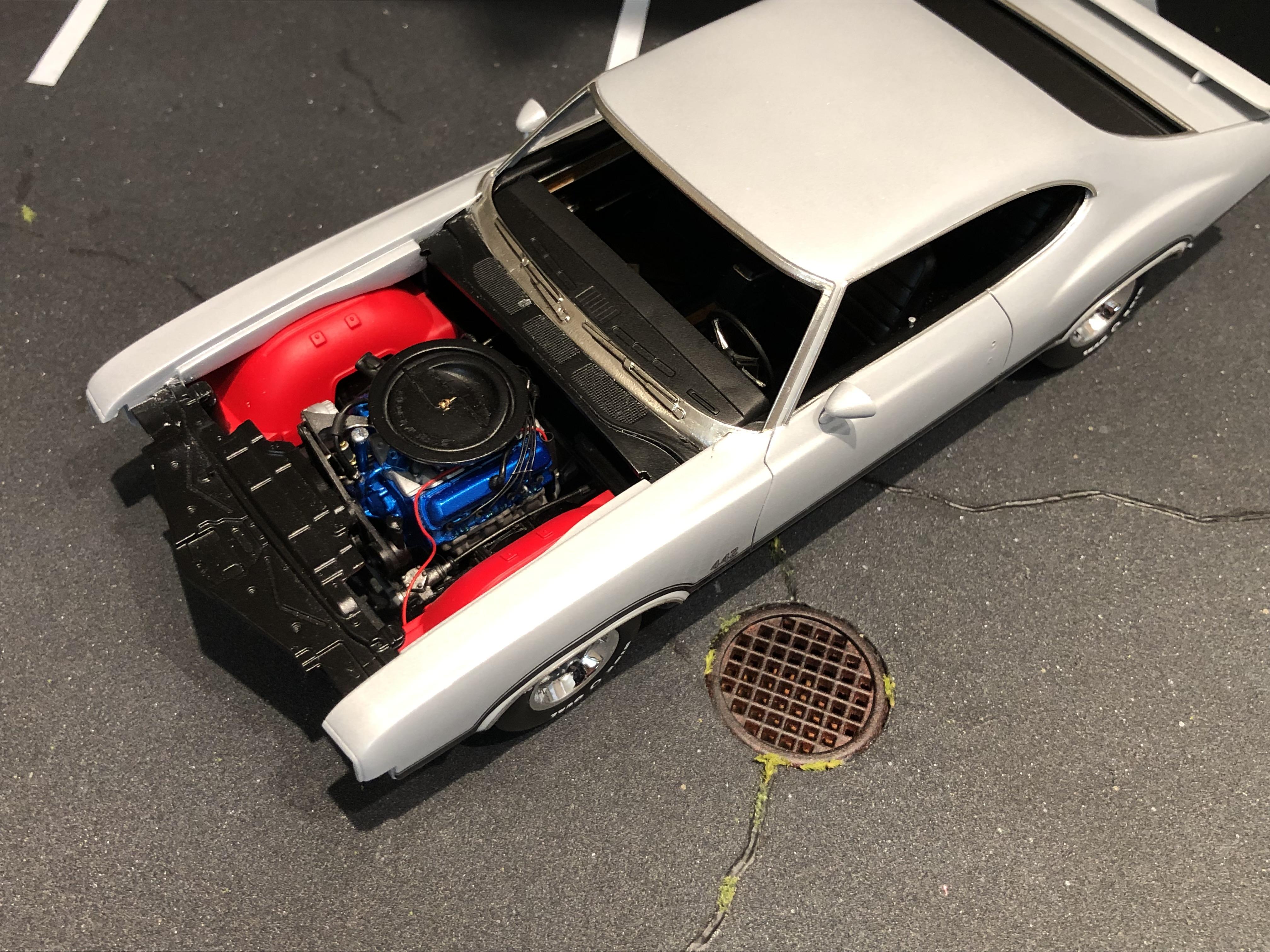

This time of year, bench time is always limited. But!… I thought a quick mock up was in order, a little inspiration for me to get this build wrapped up. I really like the colour, it has grown on me. One of my favourite things about these cars is the little peak of red in the inner fenders.
just realized the hood wasn’t sitting right, it does fit well. ??
