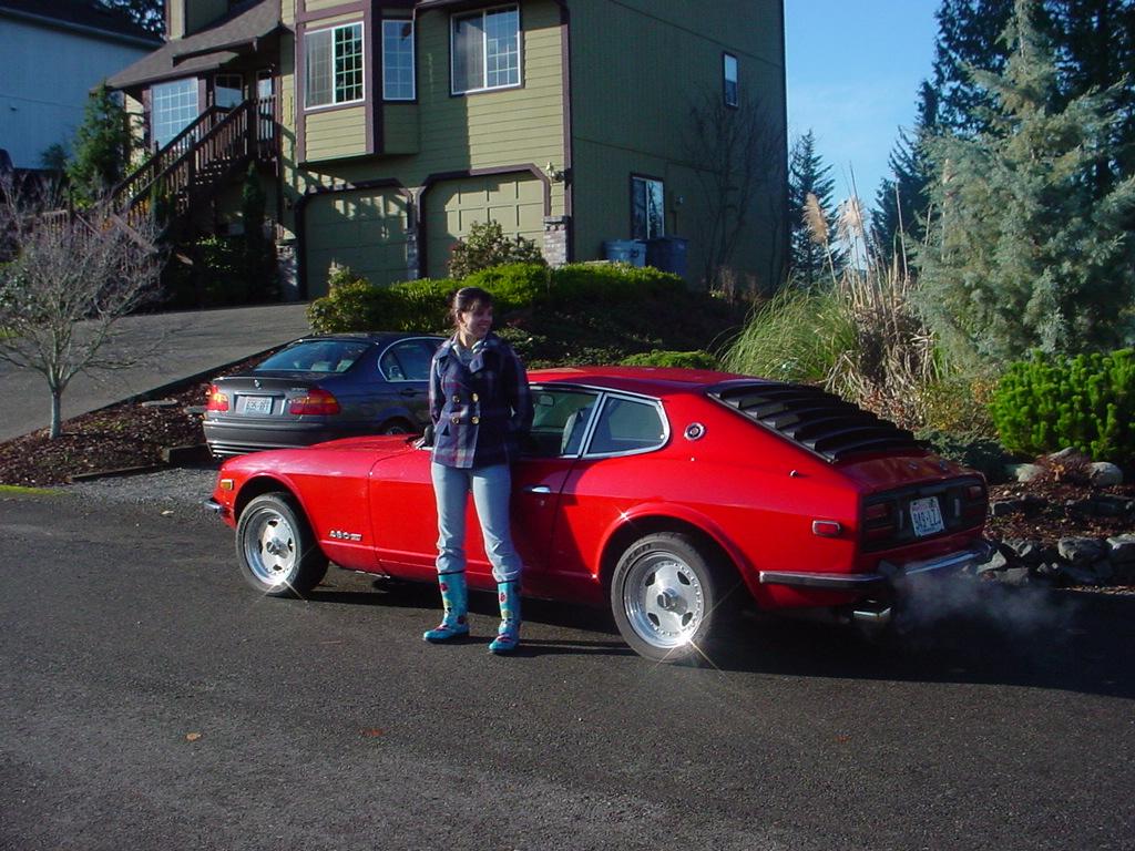

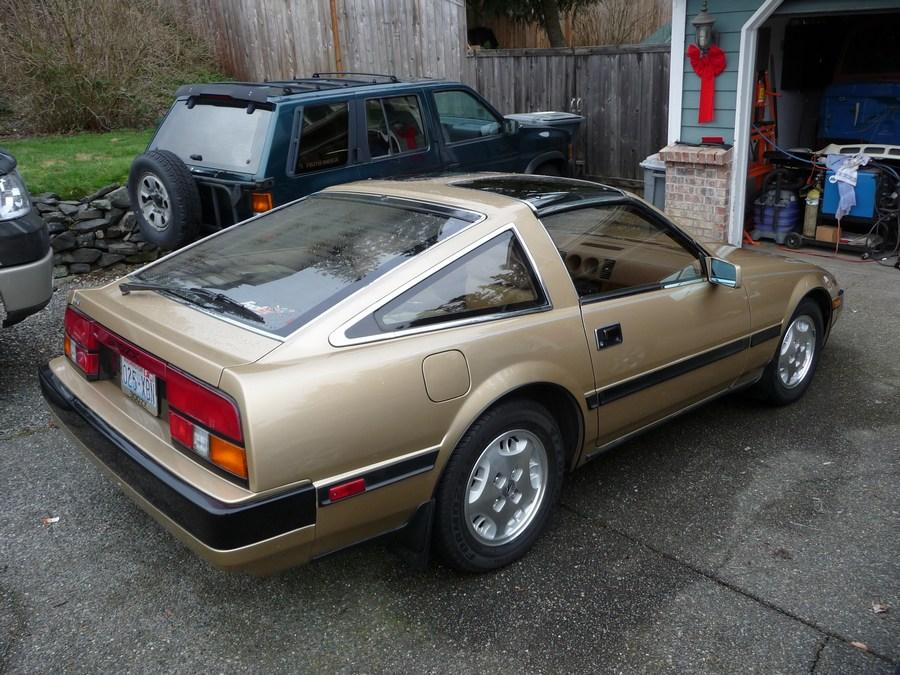

I will be interested to see how you pull these colors together. I have to say at this stage I'm a bit skeptical, but hopeful! Following this thread with interest however. I've had a few Datsuns in my day including an 85 300ZX and my daughter had a 280Z 2+2 "canoe".

Nice pair of 1:1s! I particularly like the 300ZX. I had a slightly detuned non-turbo version of the V6 engine in a couple of 300C sedans and a wagon that I owned 20+ years ago (A.K.A. Cedric in Japan).
I was slightly nervous about the colour combination too, and I went into it thinking that I could go over the interior with black if I had to, but see what you think below....
