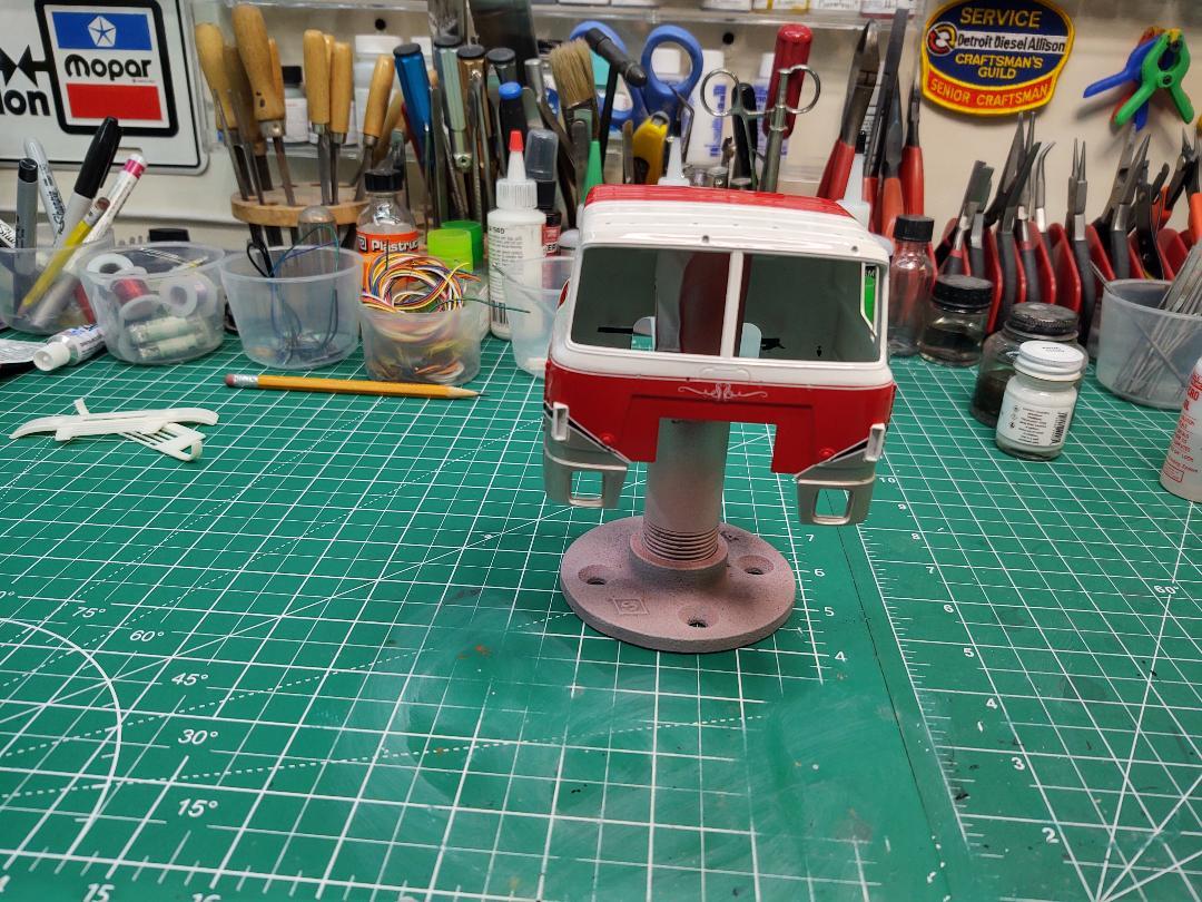

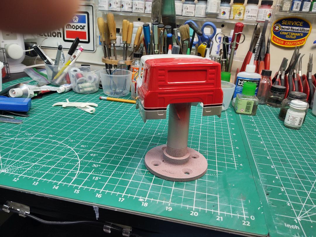

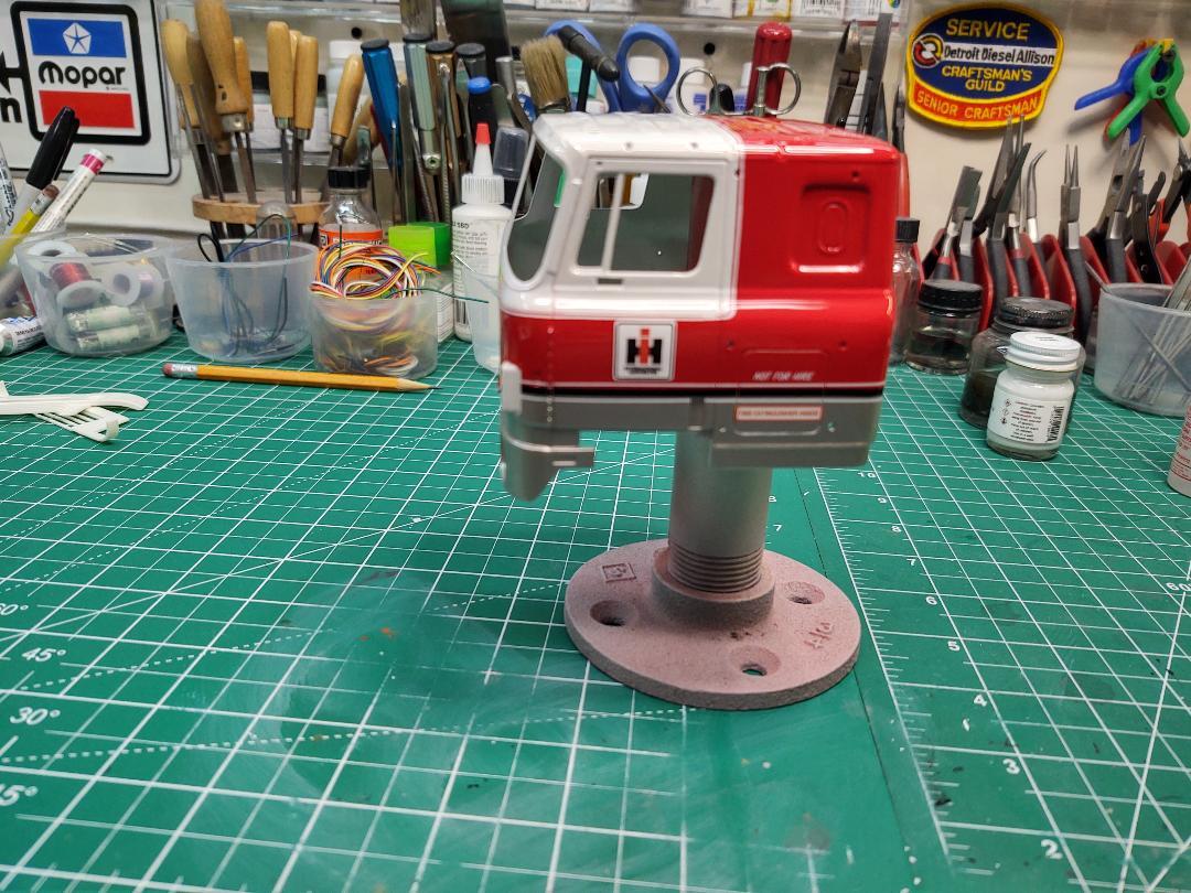

Scott Eriksen Posted February 13, 2024 Author Posted February 13, 2024 ..................shot the clear,,,,,,,,,,,,, now the interior while it bakes in the dehydrator 1 Quote
Scott Eriksen Posted February 13, 2024 Author Posted February 13, 2024 picture a little fuzzy ,,I'll take more after I put the details on the cab Quote
vincen47 Posted February 13, 2024 Posted February 13, 2024 Beautiful work. Love the added detail and those drive tires. 1 Quote
Firebuilder Posted February 13, 2024 Posted February 13, 2024 Very nice work. Does the dehydrator make the paint any harder then just letting it air dry for several days? It may be a new technique I have to learn about. 1 Quote
Scott Eriksen Posted February 13, 2024 Author Posted February 13, 2024 2 hours ago, Firebuilder said: Very nice work. Does the dehydrator make the paint any harder then just letting it air dry for several days? It may be a new technique I have to learn about. Drys faster ,harder , I usually go 8 hrs @ 95 degrees Quote

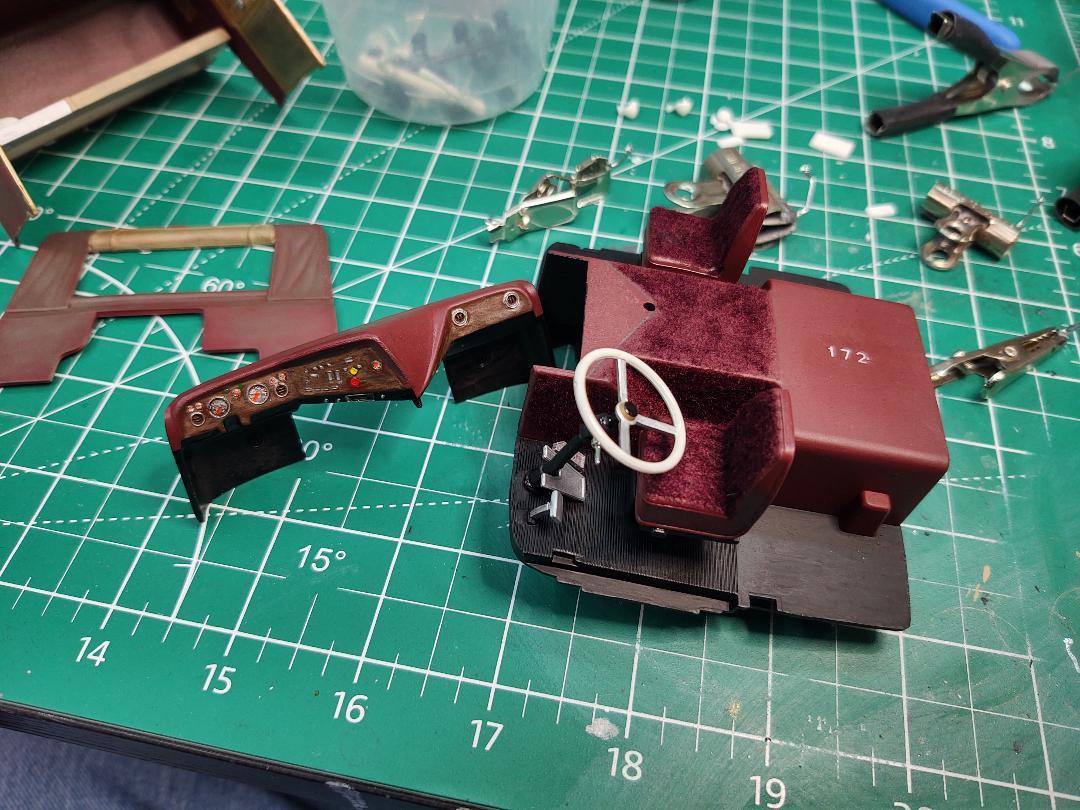

Scott Eriksen Posted February 15, 2024 Author Posted February 15, 2024 .............interior and some tidbits ,,,,,,,,,,,,,I had some 40 year old maroon flocking,,,so why not ! Tomorrow I'll start dressing the cab with the grille and maybe attach to chassis 1 Quote
Gary Chastain Posted February 15, 2024 Posted February 15, 2024 14 hours ago, Scott Eriksen said: .............interior and some tidbits ,,,,,,,,,,,,,I had some 40 year old maroon flocking,,,so why not ! Tomorrow I'll start dressing the cab with the grille and maybe attach to chassis Nice detail 1 Quote

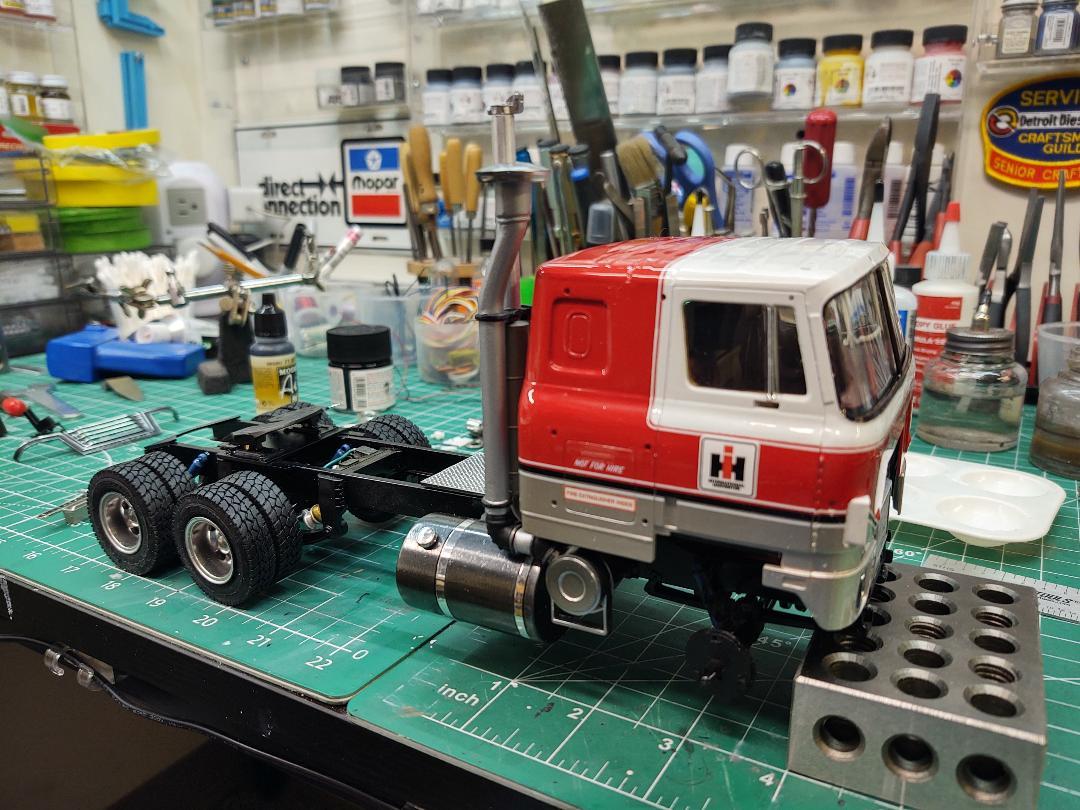

Scott Eriksen Posted February 15, 2024 Author Posted February 15, 2024 ....................cab is mated to the chassis 2 1 Quote
cifenet Posted February 16, 2024 Posted February 16, 2024 It is looking sooooo good right now! 1 Quote
Scott Eriksen Posted February 16, 2024 Author Posted February 16, 2024 ...............looking like a cornbinder should now........few more things to do tomorrow........have to mount the visor ,,really no provision ,,I was thinking brass rod and drill the roof,,totally forgot about it before paint .Have to put a few amber SigStat 9007A's below the doors ,pogo stick and trailer lines,mudflaps and quarter fenders 3 Quote
vincen47 Posted February 16, 2024 Posted February 16, 2024 It’s looking great. Love the paint scheme. 1 Quote
Pete68 Posted February 16, 2024 Posted February 16, 2024 10 hours ago, Scott Eriksen said: ...............looking like a cornbinder should now........few more things to do tomorrow........have to mount the visor ,,really no provision ,,I was thinking brass rod and drill the roof,,totally forgot about it before paint .Have to put a few amber SigStat 9007A's below the doors ,pogo stick and trailer lines,mudflaps and quarter fenders Did you paint those tanks dark metallic gray? 1 Quote
Scott Eriksen Posted February 16, 2024 Author Posted February 16, 2024 59 minutes ago, Pete68 said: Did you paint those tanks dark metallic gray? I used Alclad ,,painted with their gloss black lacquer 1st and then light coats of their chrome 1 Quote

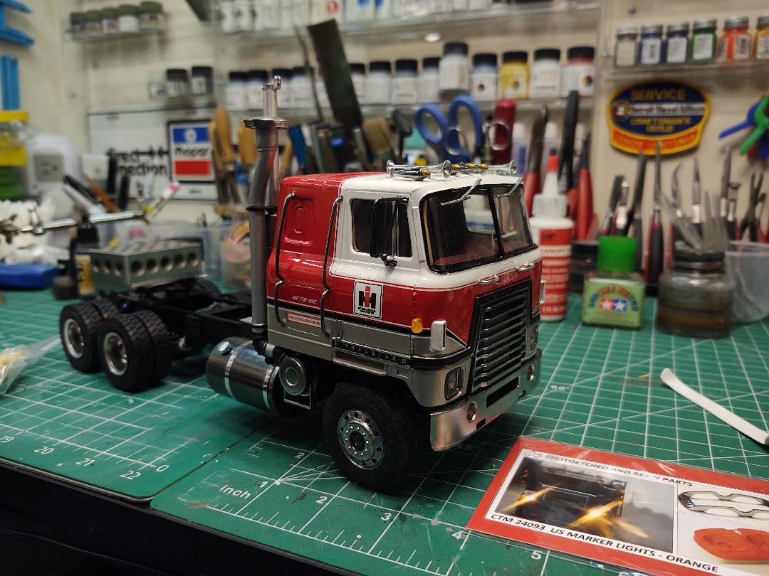

Scott Eriksen Posted February 17, 2024 Author Posted February 17, 2024 ...............done! ,, now on to the Moebius 53 ft trailer and paint to match 3 Quote
Scott Eriksen Posted February 17, 2024 Author Posted February 17, 2024 Speak Family Antique International Tractors & Trucks | Facebook Quote
Scott Eriksen Posted February 17, 2024 Author Posted February 17, 2024 For being a kit from 1975 this was a really nice ,enjoyable build and brought back a lot of memories 1 Quote
Scott Eriksen Posted February 18, 2024 Author Posted February 18, 2024 3 hours ago, Gary Chastain said: Outstanding build, well done Thanks Gary ,,I appreciate that ! The trailer is in progress I started another thread for that ,,same paint scheme with IH logos Quote
