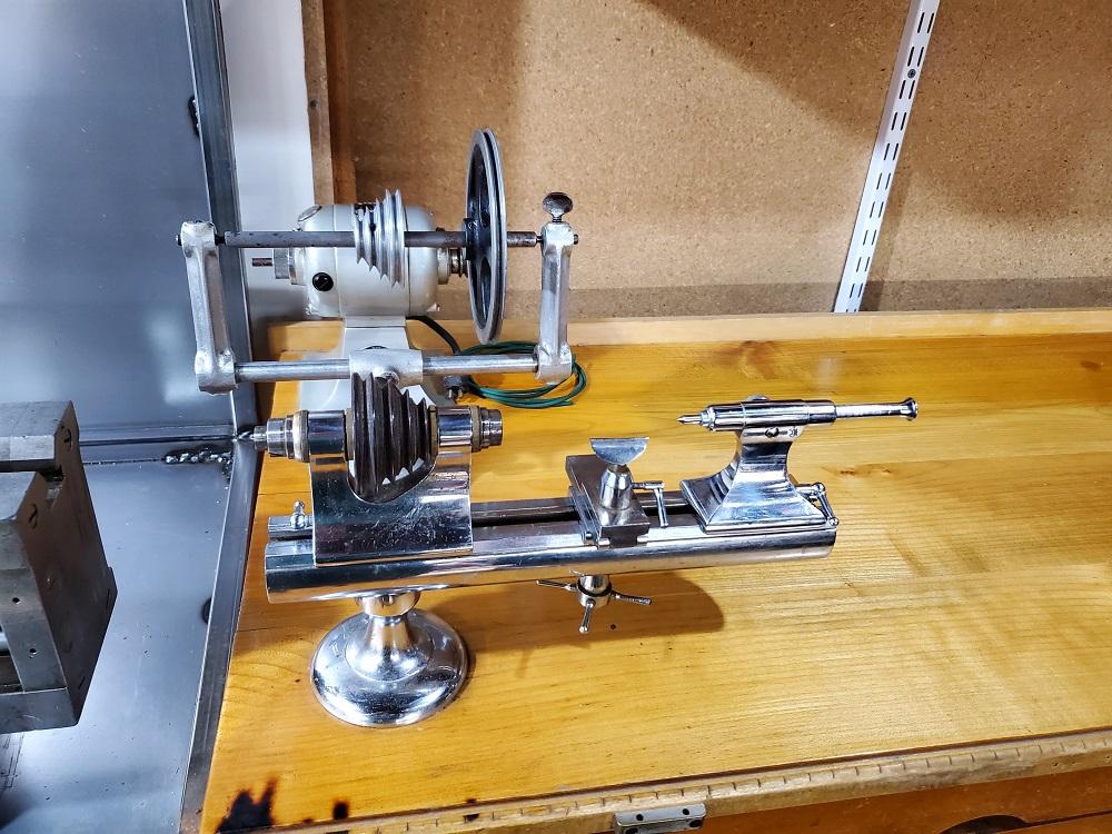

Aaronw Posted February 9, 2024 Posted February 9, 2024 (edited) I also have a watchmakers lathe, made by the Waltham Watch Tool Co sometime between 1890 and 1914. It was kind of an impulse buy because it was only 10 minutes from home and a great deal. I got the working lathe with motor, a cool jewelers desk and a bunch of jewelers and watchmakers tools and tooling for the lathe for $500. Pros - They are small, light weight and assuming they have been properly cared for they are very accurate lathes. The classic "8mm W-W (Webster-Whitcomb) style watchmakers lathe" like the one pictured above are pretty universal, so parts and tooling exchanges between brands liberally for the most part. They cost more than first appearances, but there are bargains out there if you are patient and quick when one turns up. Because of the type of work they were made for owners tend to be very meticulous in their care and use. Cons - They are fairly delicate, so it is easy for a careless prior owner to ruin them. Prices can be deceptive, you will see watchmakers lathes sometimes for as little as $250 making them seem like a budget lathe. That will usually just get you a bare lathe maybe not even a motor. What you get may be useless without spending a lot more money. Not unusual to find well equipped watchmakers lathes in the $2000-3000 range, particularly for one from a well known maker, if Swiss or German made add another 10-20% to the price. Considering that there are only a handful of manufacturers that still make these lathes, and the starting new prices run $9000+, then $2000 for a used one is actually quite a bargain. They are made to be mounted to a solid base, so not really portable. The base lathe is intended for use with collets, so the maximum size of round stock is limited to 8mm / 5/16". Collets have a very narrow holding range of about 0.1mm / 1/64" so you need a pretty decent number of collets. Collets are not cheap, used you may find decent ones around $5-10 each, new $40+ so if you get the lathe without collets, you can easily spend as much as the lathe for a useful size set of collets. The basic lathe also just comes with a simple tool rest for hand working material like a wood working lathe, not a cross slide like most other metal lathes. You can get chucks, cross slides and other accessories, but they are very expensive and often cost more than the lathe itself. They have a very small working size, generally 50mm (2") swing and 4-8" between centers. Edited February 9, 2024 by Aaronw 3 2
Aaronw Posted February 9, 2024 Posted February 9, 2024 On 2/5/2024 at 5:48 AM, Ulf said: Anyone who has experience with the Proxxon Micromot FD 150/E Lathe ? These are not common in the US, and very expensive over here compared to other small lathes. Based on comments from a Unimat list I belong to the Proxxon PD250/E lathe is pretty good, but comments about the 150 were not nearly so complementary. In the USA the 250/E retails for around $1800 making it much more expensive than other options. Pricing in Europe may be better since it is a local product. 1
Bainford Posted February 9, 2024 Posted February 9, 2024 1 hour ago, Aaronw said: I also have a watchmakers lathe, made by the Waltham Watch Tool Co sometime between 1890 and 1914. It was kind of an impulse buy because it was only 10 minutes from home and a great deal. I got the working lathe with motor, a cool jewelers desk and a bunch of jewelers and watchmakers tools and tooling for the lathe for $500. Pros - They are small, light weight and assuming they have been properly cared for they are very accurate lathes. The classic "8mm W-W (Webster-Whitcomb) style watchmakers lathe" like the one pictured above are pretty universal, so parts and tooling exchanges between brands liberally for the most part. They cost more than first appearances, but there are bargains out there if you are patient and quick when one turns up. Because of the type of work they were made for owners tend to be very meticulous in their care and use. Cons - They are fairly delicate, so it is easy for a careless prior owner to ruin them. Prices can be deceptive, you will see watchmakers lathes sometimes for as little as $250 making them seem like a budget lathe. That will usually just get you a bare lathe maybe not even a motor. What you get may be useless without spending a lot more money. Not unusual to find well equipped watchmakers lathes in the $2000-3000 range, particularly for one from a well known maker, if Swiss or German made add another 10-20% to the price. Considering that there are only a handful of manufacturers that still make these lathes, and the starting new prices run $9000+, then $2000 for a used one is actually quite a bargain. They are made to be mounted to a solid base, so not really portable. The base lathe is intended for use with collets, so the maximum size of round stock is limited to 8mm / 5/16". Collets have a very narrow holding range of about 0.1mm / 1/64" so you need a pretty decent number of collets. Collets are not cheap, used you may find decent ones around $5-10 each, new $40+ so if you get the lathe without collets, you can easily spend as much as the lathe for a useful size set of collets. The basic lathe also just comes with a simple tool rest for hand working material like a wood working lathe, not a cross slide like most other metal lathes. You can get chucks, cross slides and other accessories, but they are very expensive and often cost more than the lathe itself. They have a very small working size, generally 50mm (2") swing and 4-8" between centers. Very helpful information Aaron. Thanks for the comprehensive reply.
