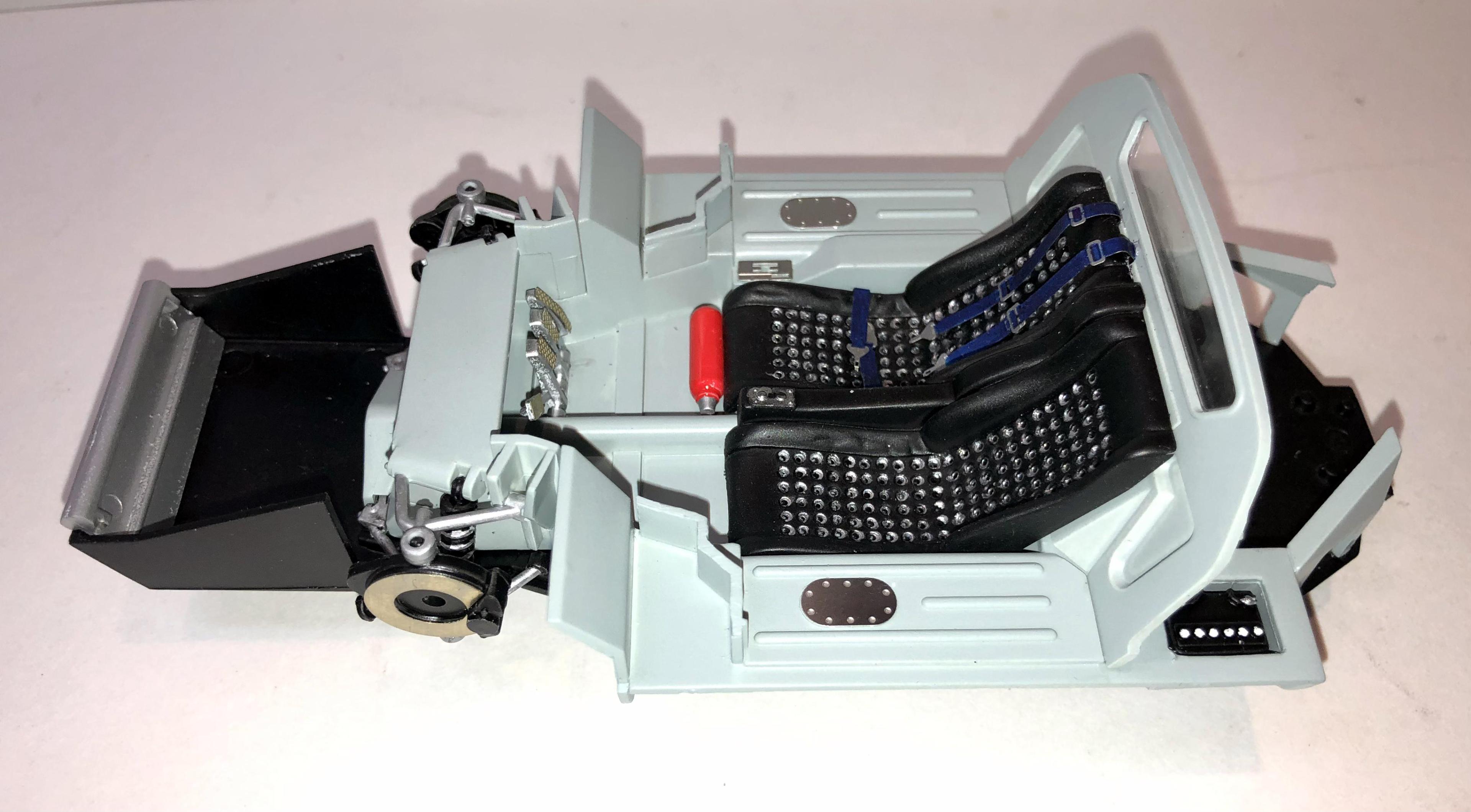

Phildaupho Posted February 8, 2024 Author Posted February 8, 2024 (edited) This build has evolved to be how it look if I actually owned the real car rather than a replica of how it looked at a moment in time back in the 1960’s. Although the actual car was eventually restored to being white with green stripes it does not have any other aspects of the Comstock livery. Photos of GT40 MKI interiors are few and far between. The only photos I could find of the car under the skin are of the restored car. I like how the light blue colour of the tub is a nice contrast that allows other components to stand out rather than everything being painted black. Like the restored car and road versions, the battery is located in the engine compartment area. For extra detail, I am using photo-etch from Acu-stion and Studio 27 and the excellent decal sheet from Vintage Racing Miniatures [VRM]. A friend built what I consider the ultimate GT40 1075 a number of years ago. I remembered that he even drilled out all the holes in the seat. I decided to do the same. To paraphrase The Beatles in A Day in the Life – Three hundred holes in GT40 seats And though the holes were rather small I had to drill them all Now I know who many holes I’ll never drill again I did not turn me on Edited February 9, 2024 by Phildaupho 3
Chillyb1 Posted February 9, 2024 Posted February 9, 2024 The Beatles parody lyrics made me laugh out loud. Thanks for that. Also loving the model.
